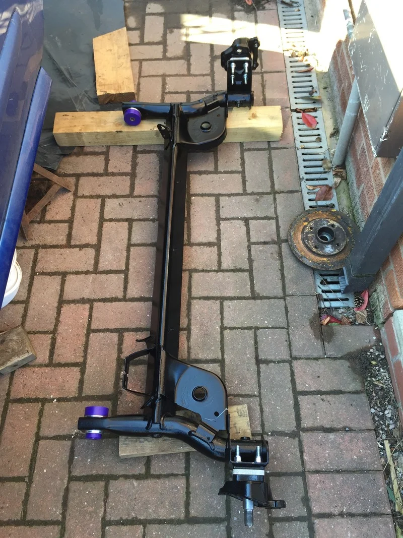

▪️Freshly powder coated rear beam
▪️Powerflex beam bushes

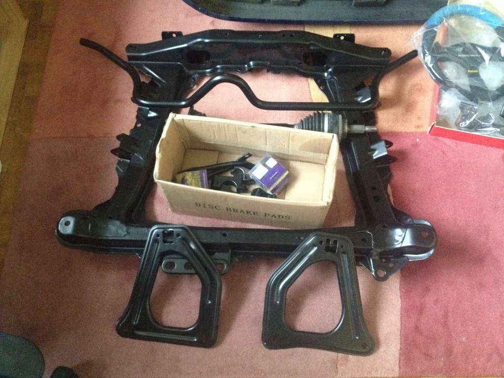

▪️Powder coated subframe with repair/strengthening washers
▪️Powder coated anti roll bar
▪️Powerflex anti roll bar bushes

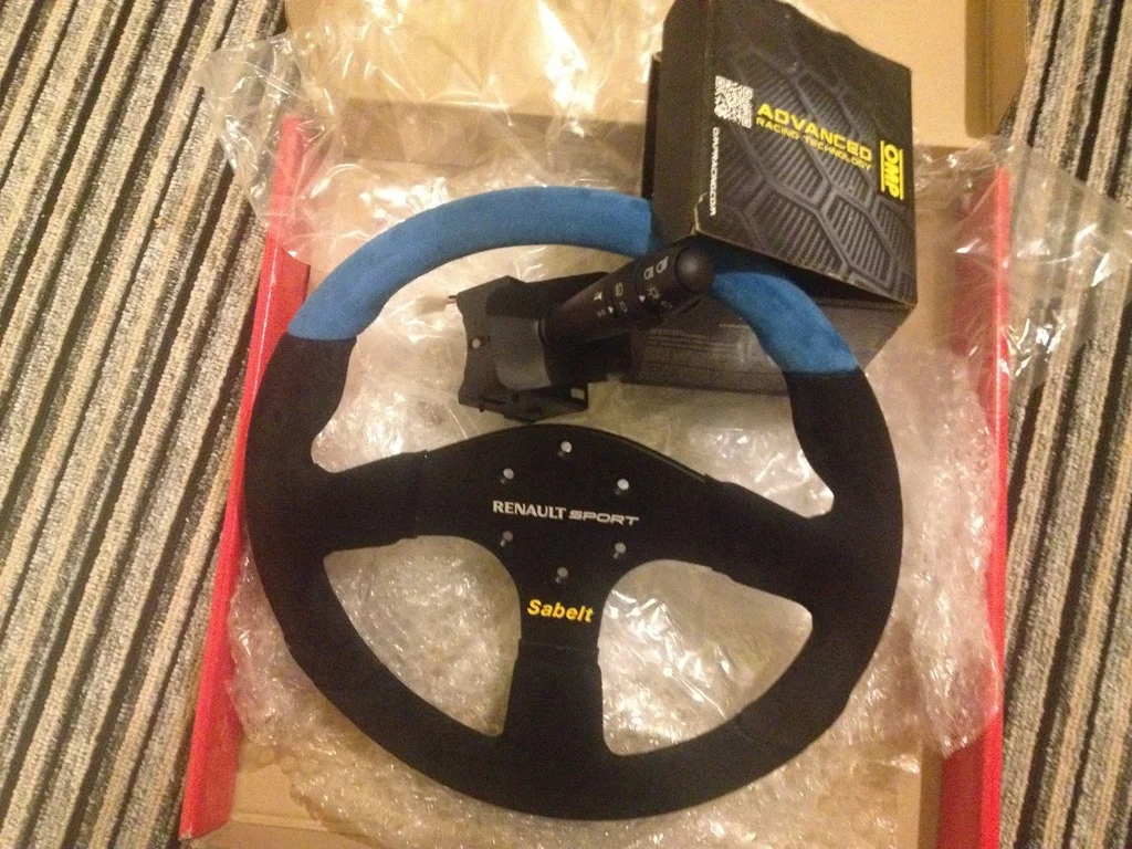

▪️Sabelt wheel and OMP boss kit

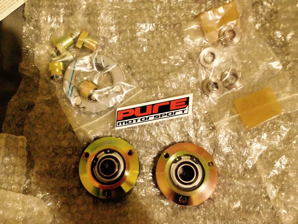

▪Pure motorsport top mounts + strut brace

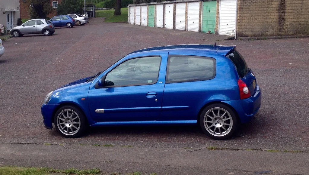

Phil started with the car..
In pretty good shape.

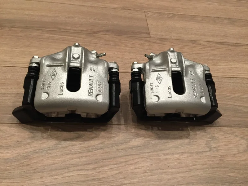

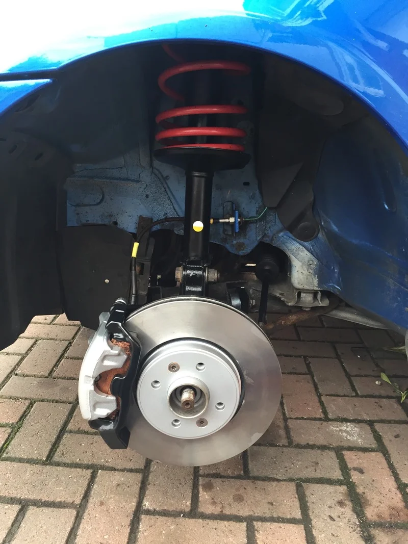

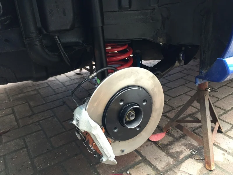

He then set about sorting out the running gear..New rear calipers, discs, pads Goodridge braided hoses, Powerflex bushes, Eibach sport line springs.
Then he'd added new front callipers with a few extra coats of paint, new slider kit and powder coated carriers.
Eibach sportline springs and new cup shocks went on along with cleaned up and painted hubs, new bearings, Brembo HC discs and Mintex 1144 pads

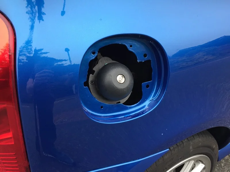

He'd then noticed some rust around the petrol filler so it was cut out and replaced.
New filler flap fitted and painted
Along with the commen dents removed from the bonnet and some paint chips blown over

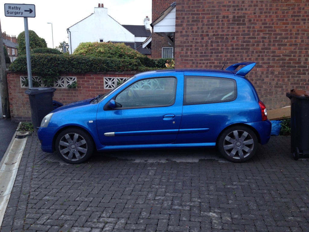

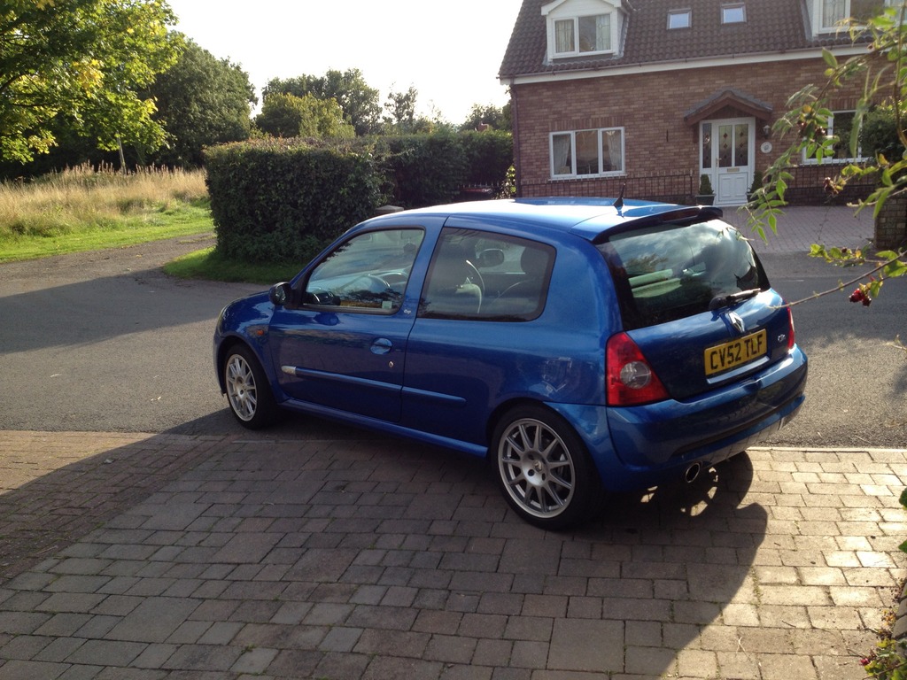

Car bought and I started making a few little changes.

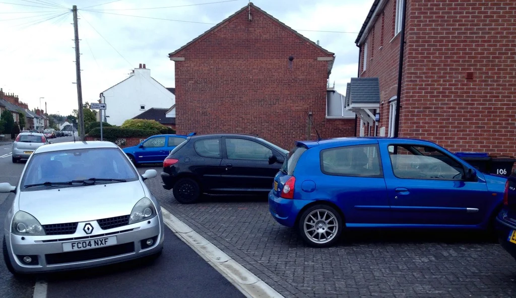

Before that she was given a 200+ round trip to collect pick up a little 182 for @Dano'
The previous owner had a neighbour whos 182 was so sick it had to be parked outside the local surgery

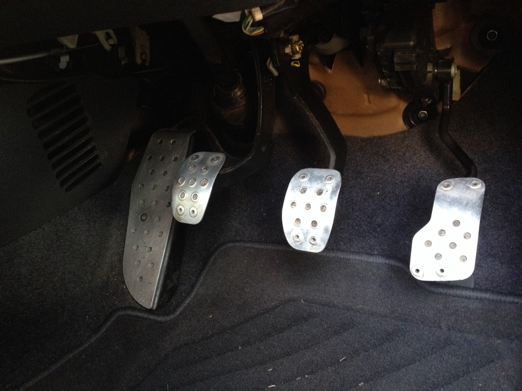

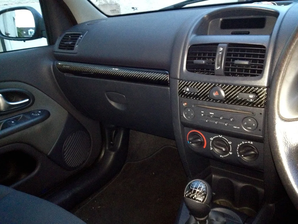

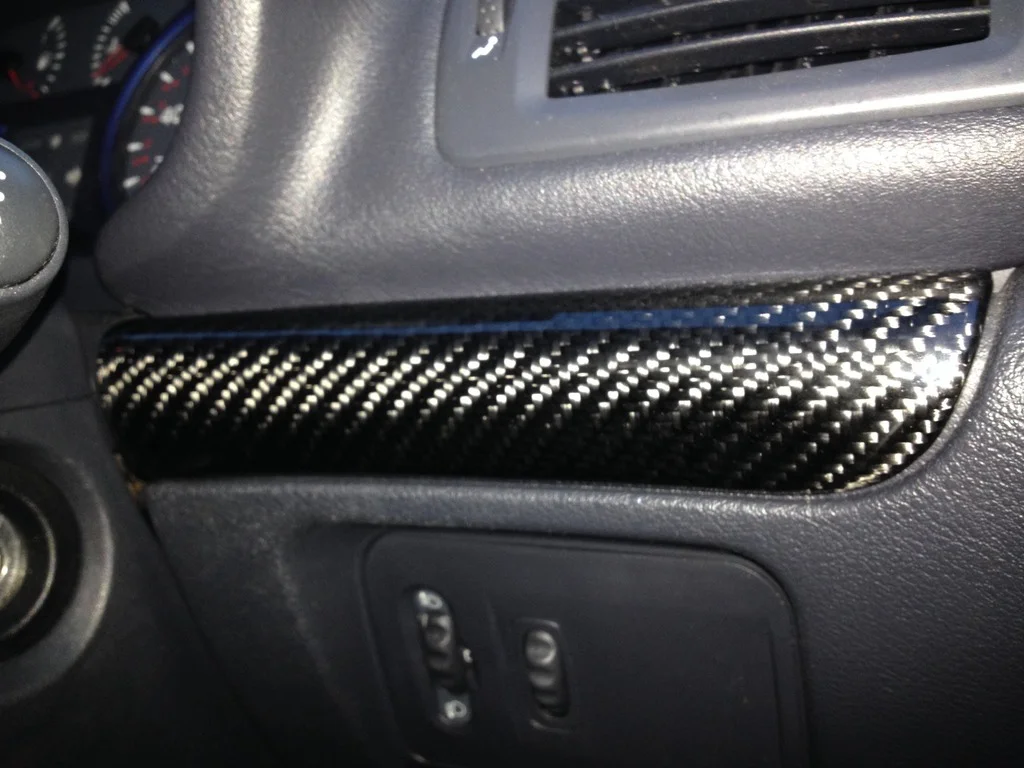

Home and it was time for a quick strip. I mean strip change...out came the cup ones...in went...
Ones that I'm really not to sure about. Anyone want to buy some interior strips?
Got around to removing the halfords style badge

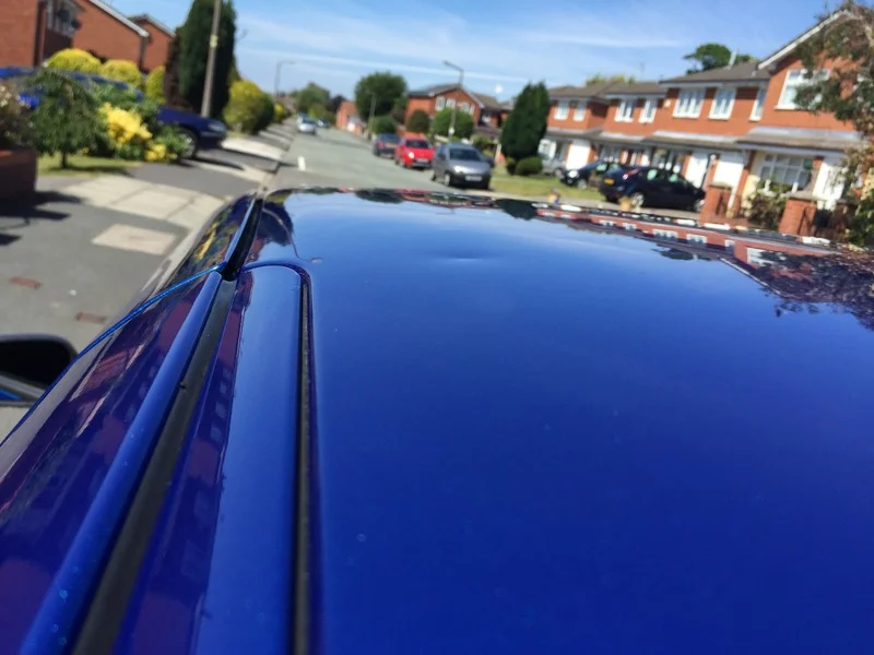

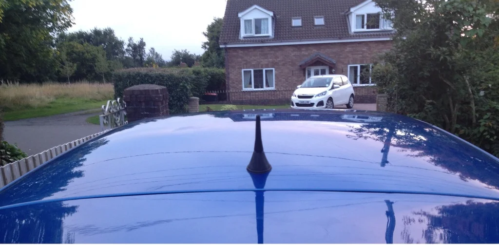

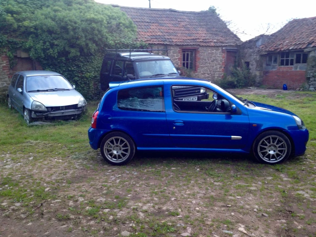

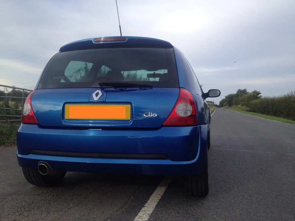

On went the S2000 ariel and while we're at it...Second pic here shows the dent that was there when Philly W owned the car....his dent guy did a good job as you can see below.

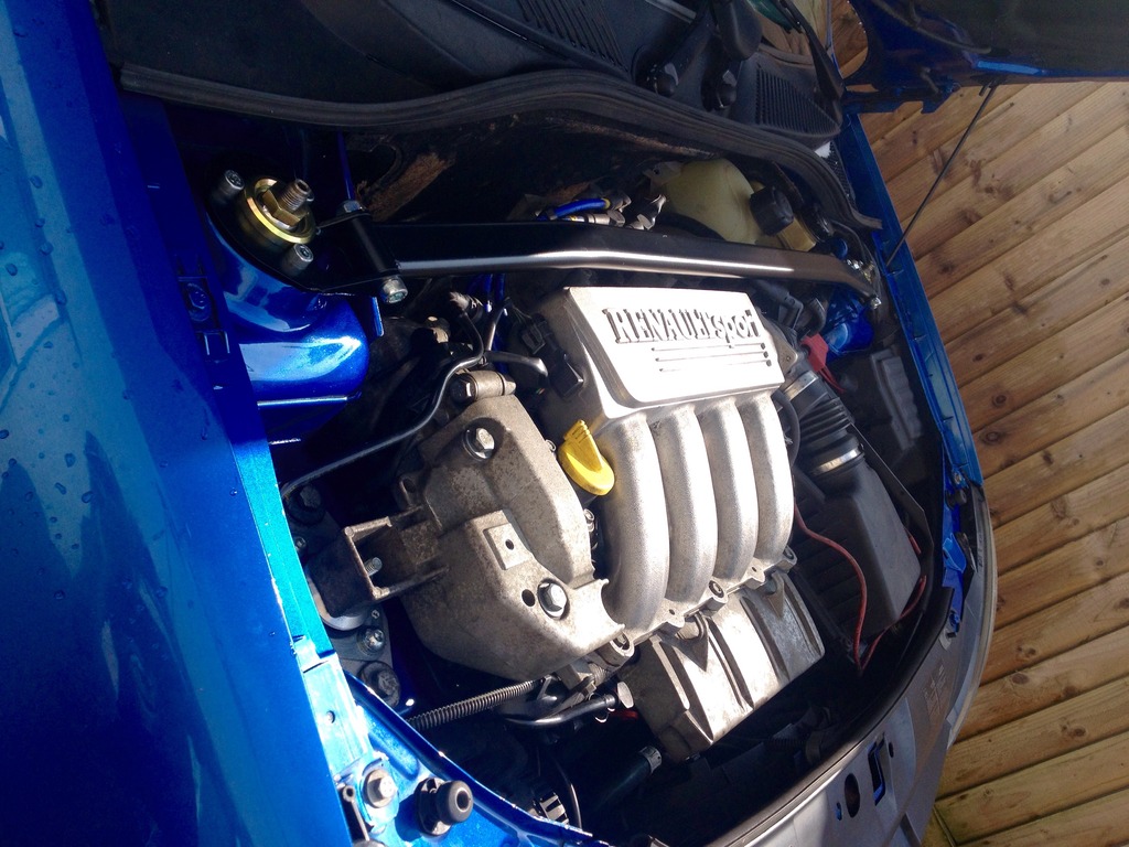

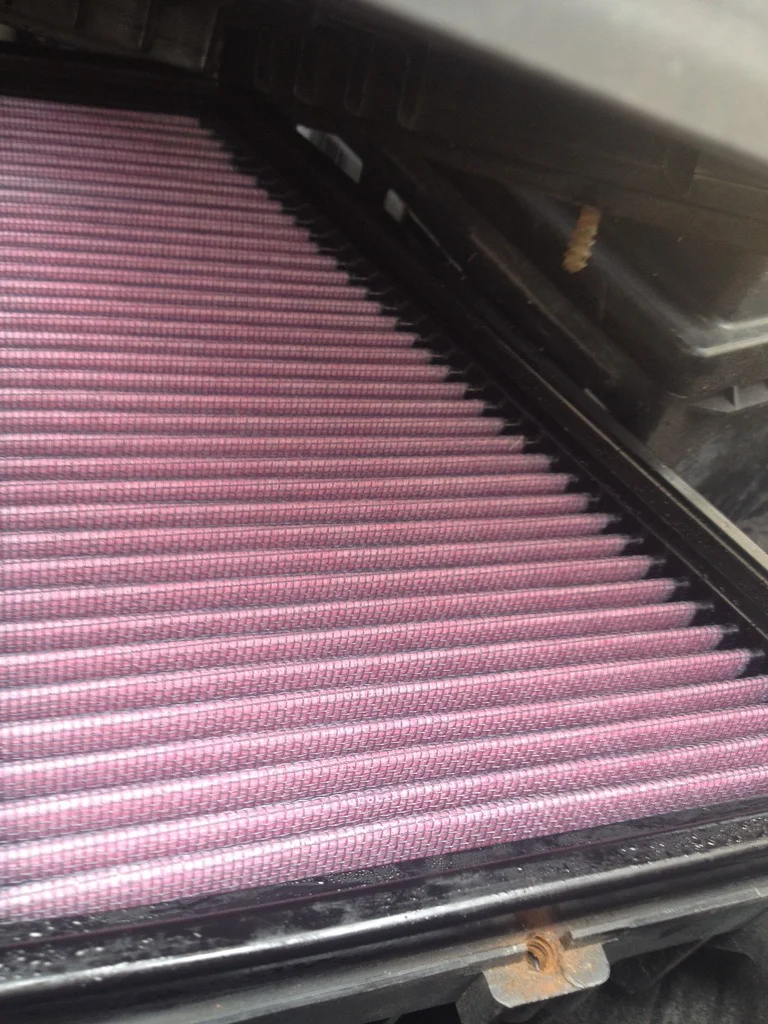

In went a new K&N panel filter then after a nose around on here at what seems to work for people.

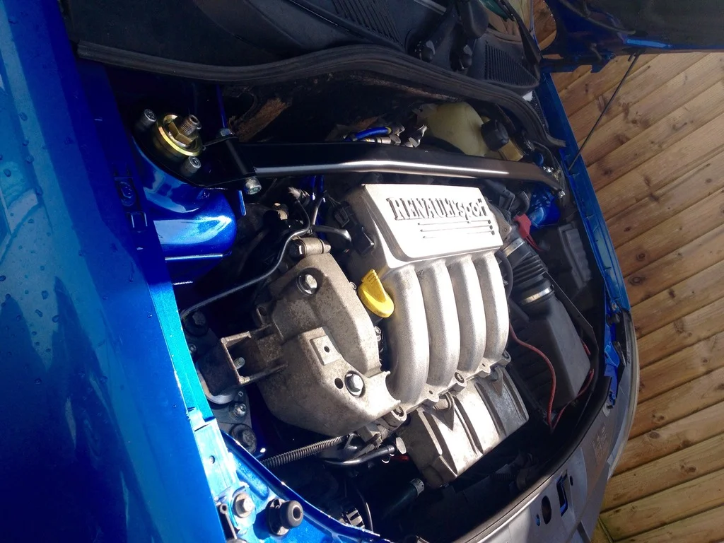

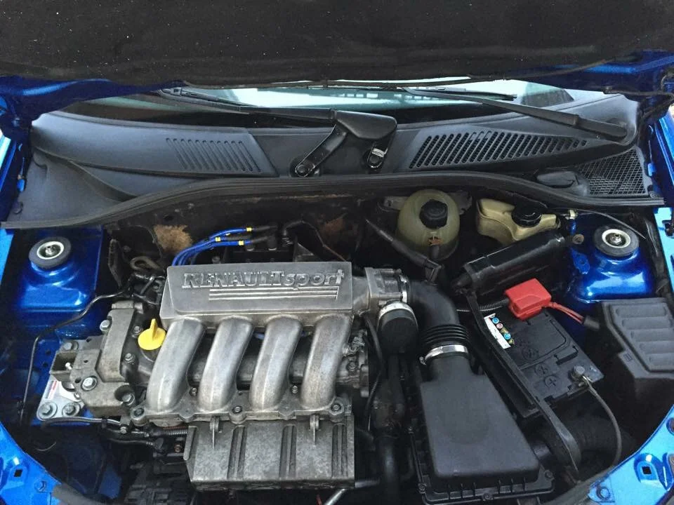

On the agenda is tidying up the engine bay a little. It's just picking where to start...help? Though first of all I'll be the car to a good deep clean and detail.

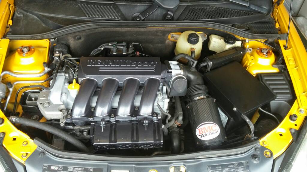

As for engine bay ideas... yours looks neater from the off with the lack of AC pipework [emoji106]
Satin black battery cover maybe?
Clean/renew the coolant tank? I need to do this too, mine looks shabby! Coolant needs changing on mine next service, so I may fit a new bottle at same time.

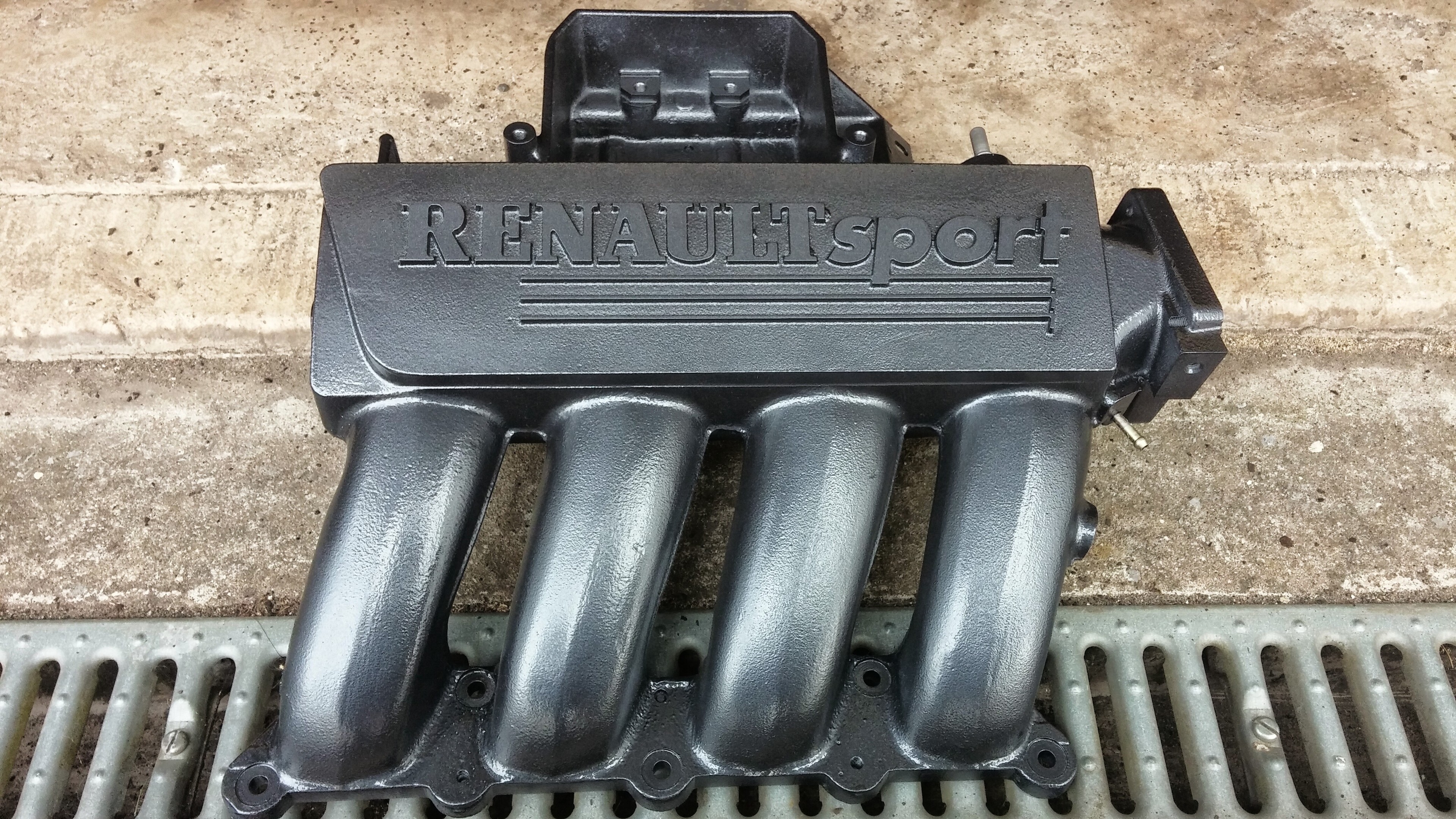

Paint the inlet manifold and fuel guard for sure. While inlets off you could paint top of cam cover too.
I primed then painted my inlet rover graphite grey I think it was, from halfords
My bays nothing exciting. I need to do my fuel guard again as I didn't prime it properly and paint didn't take to it in some spots [emoji20]

I've been toying with the idea of having the inlet, fuel rail guard and cam cover powder coated. Might pinch the matched inlets from the Berg if that happens though. but then I like the clean...bare metal look too. Torn on this one.
Desperately want to replace the carpet on the firewall as it looks scabby as hell. Cleaning the coolant tank and power steering tank needs to happen for sure.
Painted is my preference.
Powder coating is ideal!
Don't think you can paint/remove cam cover without effecting timing or something else. I was looking to remove mine to paint but was told not to.
So painted mine in situ.
Yeah. Rob all the parts you can off it! [emoji106] [emoji41]
Filters
Wales - South
Hmmm....I don't think I have the patience or skills to paint it.
Inlets and fuel guard no problem. Rocker cover maybe not.
I don't think taking the cam cover off on the engine mount side makes any difference to the timing but I could be wrong and in for a ripping now.🙈
Don't really want to take much more off her :sweat: It pains me to see such a low mileage car not on the road. I'm so very very tempted to save up fix her and track her. But then I could do with some cash so stripping her may be the way. ARGH!

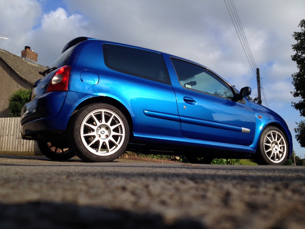

Another day of playing with asthetics. Had a bit of free time on my hands today so gave the car a good clean to see what's going to be needed to bring the paint work back to life. Needs some paint correction and swirl removal...maybe a touch of paint in places (that's just be being picky) aside from that she cleans up rather well.
Took a quick little walk down to the yard then to get a few more bits from the berg. Knabbed an ally footrest to match the pedals. Started clearing the pedals out of 12 years worth of mud from the holes and decided then to start polishing them up.
As everything on the car is pretty much sorted and solid, I've started looking in to the possibilities of chasing power.
Don't think I can afford anything to crazy at the moment so might just stick on some matched inlets an RStuner map.

The cam covers easy to paint mate! All you need to do to paint it is remove the inlet.... which you'll be doing anyway [emoji4]
Flick through my thread if you like, pics of how I did mine on there. Basically get a big dust sheet/old double duvet maybe.... Cut a hole in middle of it and drape it over your front end with the hole over the cam cover and masking tape around the edge of it.
Brake/carb cleaner on the cover, clean and jobs a good un. Spray away! Or just clean the cam cover and leave it at that.

Steering wheel + boss kit, subframe, ARB + bushes, top mounts and strut brace is going on in the next couple of weeks.

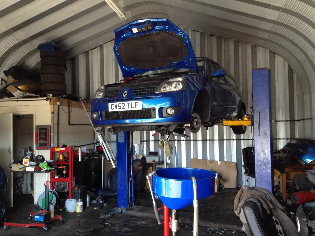

Rene went to SJM Automotive for a few bits and bobs Last week. Whilst down there we spotted a few more things to add to the list of "things to do" the rocker cover gasket has sprung a little leak so is being replaced. Dan mentioned the possibility of fitting the R172BP285 cams from the old Iceberg at the same time along with the bergs matched inlets.......this would mean having to swap the ECU and UCH, how ever it's tempting me highly! As the Cam cover, rocker cover, inlets and rail guard will be coming off I'll be painting them up though undecided on colour yet.
The 5th gear syncro is on its way out and has a little crunch at times so will be replaced too. Seeing as the subframe will be dropped again for this, the steering rack bushes are coming out and some fresh oem bushes going in. A new subframe mount bush is on the way too as the olds on it's last legs. That'll be everu bush and mount replaced for new then. Tightness!

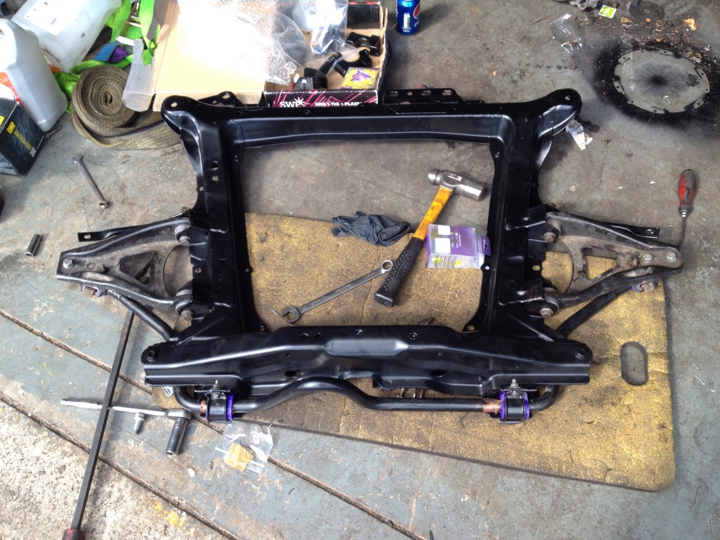

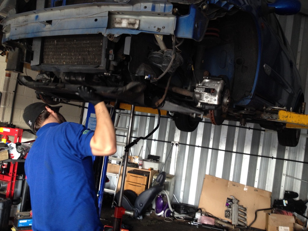

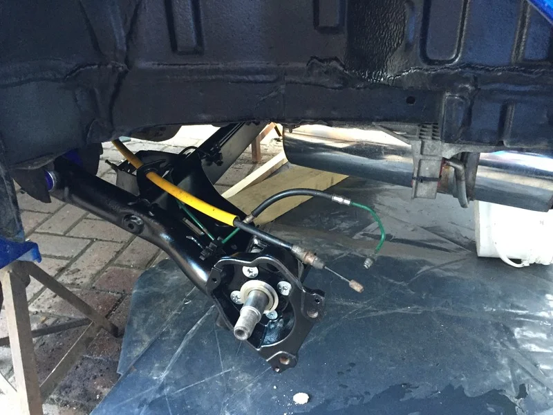

Off came the old subframe

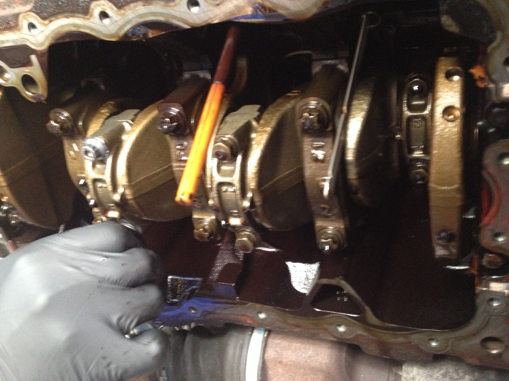

Off went the sump, ARP rod bolts fitted along with a new sump seal. Dan cleaned out the oil pump which was pretty clean already.
The new subframe and antiroll bar went on, some new powerflex ARB bushes. Wishbones were cleaned up again before fitting, they'd covered little to no miles sine Phil fitted them so would of been pointless to replace.
Last up was the PMS top mounts and Strut brace. As time was pressing on I didn't get any pictures of it being fitted or the subframe being fitted either but...
I did get one the day after, took the time to give the engine and bay a little clean up whilst the sun was out, then before the welsh rain hit I gave the car a quick was and temporary seal to protect the paint until I get a chance to properly have a go at it.

Popped down to filters place to service my Clio at weekend but nothing went according to plan, so basically ended up doing nothing apart from having a chat. Ha ha.
Got to have a look at the cup for first time though and it looks a cracking example! Really nice one! [emoji106]
