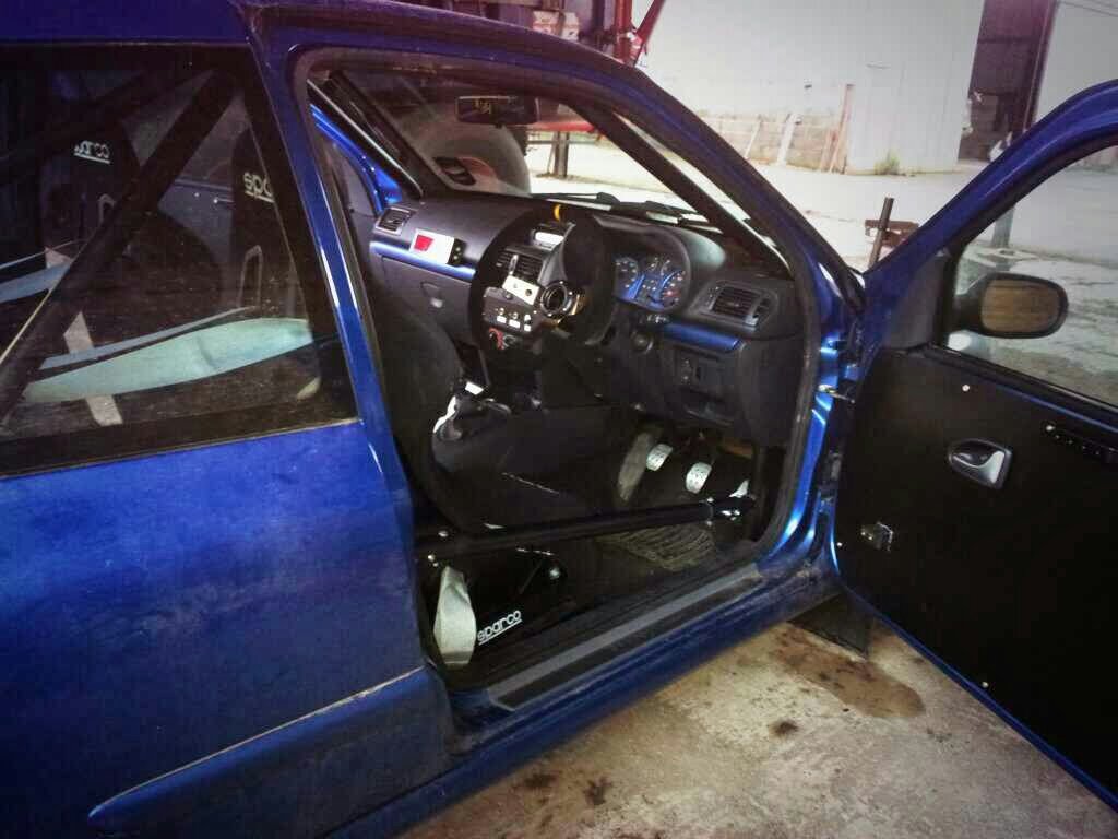

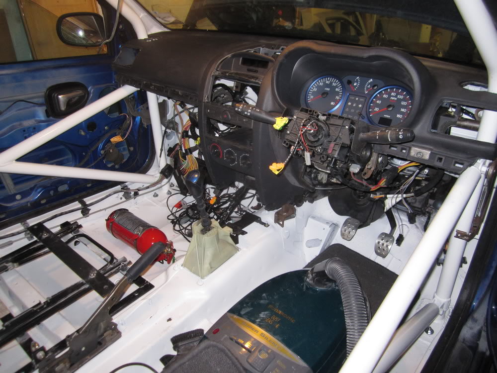

I'd get one that goes behind the dash myself. I actually wanted a dash dodger when I bought mine but OMP had changed the design without me realising so I got a behind the dash job, but with hindsight I much prefer what I got.
Mine is the OMP 6 point bolt in one FIA approved (>= MSA from a regs point of view). Not sure if they do it any more after a quick google.

Same cost to buy and install I would say. The only difference is the labour to remove the dash - which would be quite a bit (few hours) I expect if you got someone else to do it.

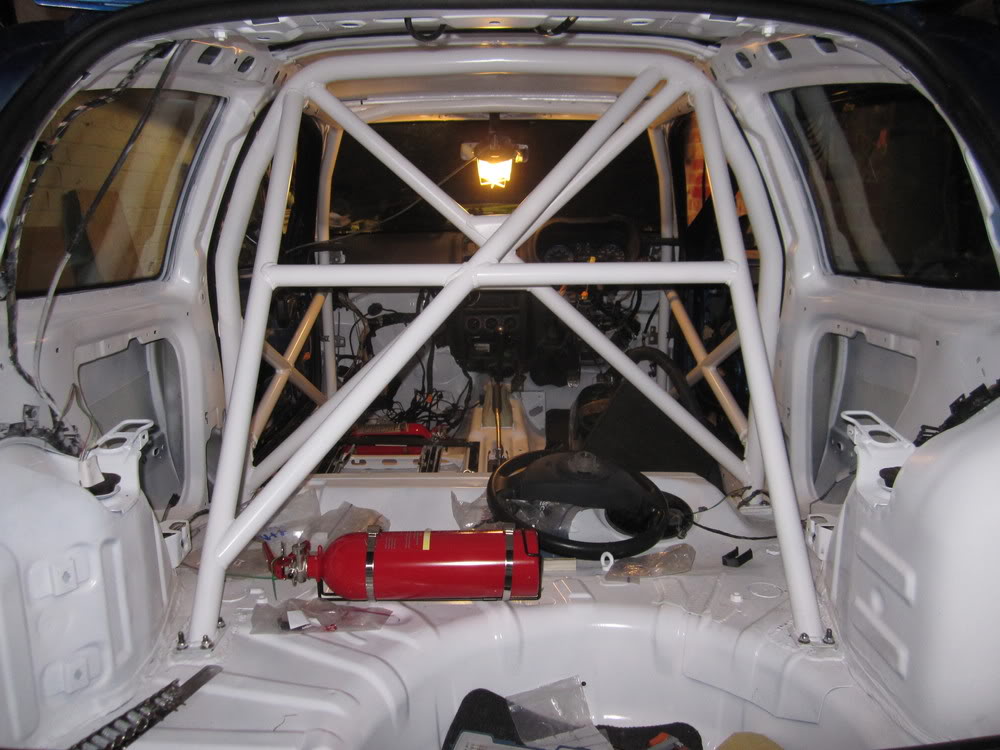

If I did it again I'd probably go for a full on weld in, but I'm happy with what I have.
Powder coated and ease of fitting are the pro's but the con is a cage that doesn't help hold the shape of the A pillar in a roll, brings the crumple zone closer to the drive and passenger and doesn't look as tidy in the car.

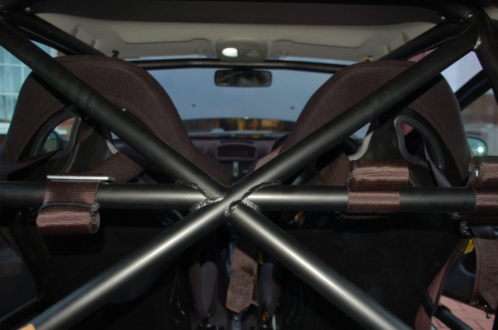

I looked at all sorts of cages when I was getting mine, the Oreca seemed the best fitting one that required "extra" work but went for the SD cage in the end and it was pretty easy to fit
