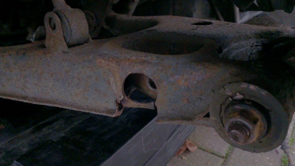

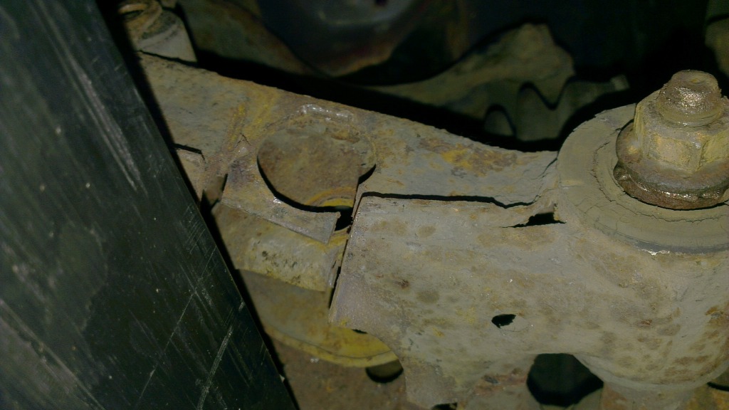

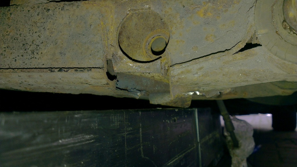

I've already got a spare wishbone, that's not the issue. We can't separate the wishbones from the hubs, and we can't separate the hubs from the driveshafts due to rounded hub bolts. And I can only use the driveshaft that's on the chopped up wishbone due to the diff.
Awesome work mate, had a skim last night about to read through and catch up.
You still got the hub nut issue or is that solved? If it really does persist, grind two sides dead flat then wang a nice big spanner on it.
I've just decided to get someone to weld up the wishbone. It's a relatively simple repair and I trust he can do a good job having already done the sills on this shell (and they're f**king immaculate. Seriously, looks factory fresh!)
Also while he's doing the wishbone I'm going to ask very nicely and see if he can 'alter' my straight pipe slightly. I've got the mini-skirt bumper, so the exhaust I've got now looks a bit boring tbh!
Hmmm, I'd get that hub nut sorted too whilst it's at the welder then mate, get him to weld a nut to it or similar so you can wind it off.

What does this hub nut look like? You always give up to easy with things like this!
I bet with a smaller socket and an impact driver you'd wang it off easy. Just last week we had a t30 round off, then it rounded off an allen key we smacked in, then we really manned up and smashed a t50 or something in, tried again, and bobs your mothers brother.
I concur with the smashing technique.
I have a load of spare sockets I use/sacrifice for this.
If something won't come off, find the next size down and pound it on like your getting a Lancashireman off you're gran.
Well that's the thing, I've had nothing anywhere near the right size to even have a go with. And it's round. Like properly round - not just 'oh the corners have gone a bit, I can't do it'.
