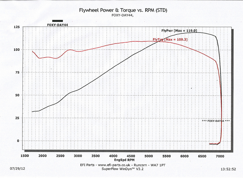

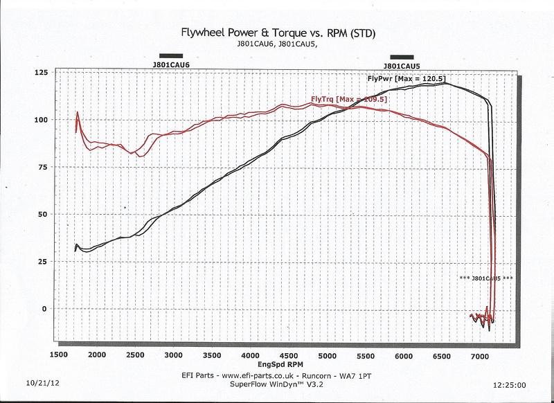

I did take part in the NW EFI rolling road day on Sunday, just to see if I'd lost or gained any power and to my surprise I'd gained a whole horsepower and a half. Rolled 120.5bhp and 109.5lb-ft which is excellent considering the 115bhp book figure. (Accurate RR too, Chris' 200 ran 187, and 1*2's were running 160-175ish).
MX5 RR2 by joe.drewery, on Flickr
Compared to last time:
MX5 ATF by j0eyD, on Flickr
Pleased. Not exactly a smooth curve, but meh. It's got a straight pipe, I'm not expecting miracles!
