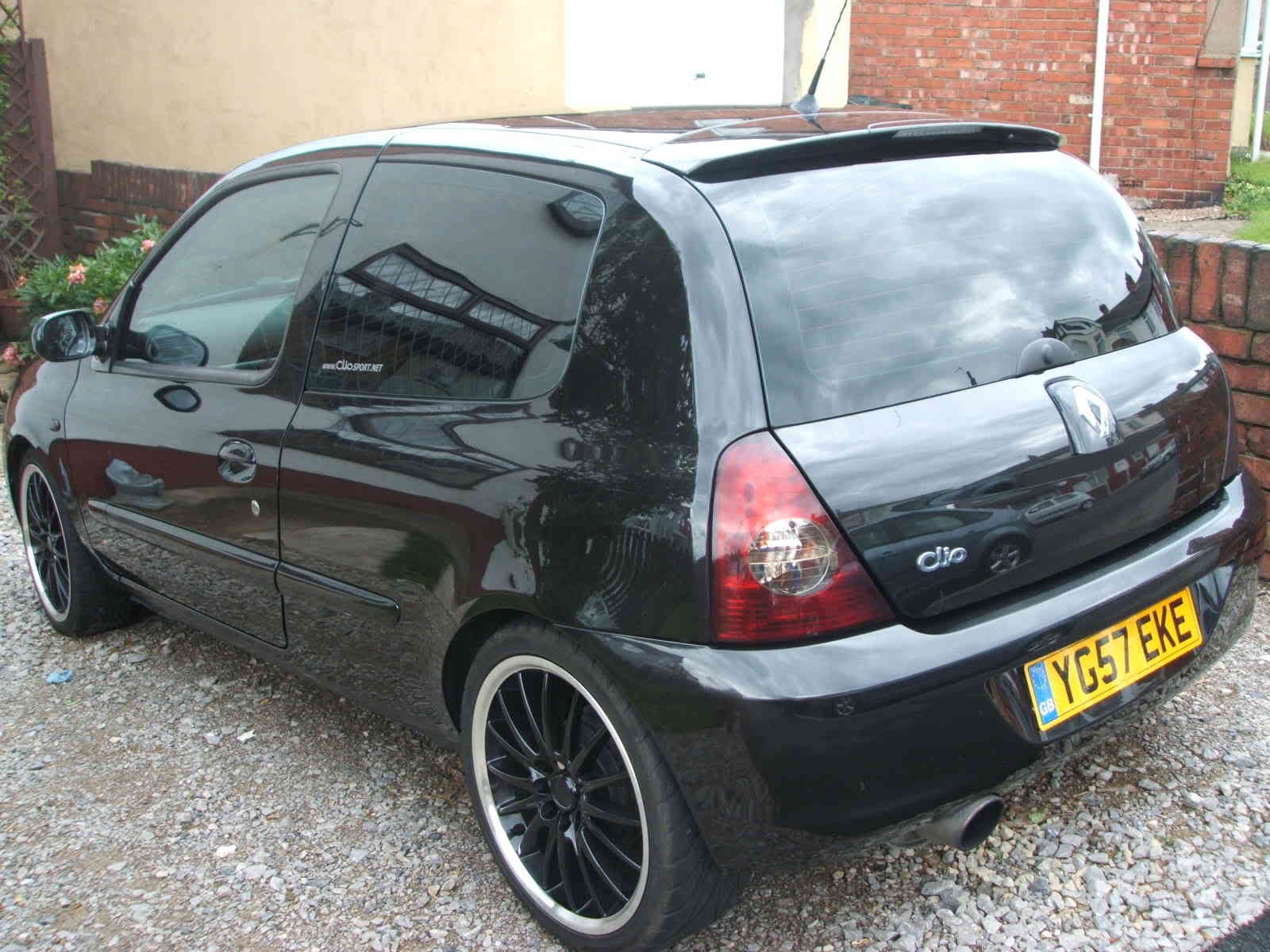

Right im after some advise?
Im going to re paint the alloys so they are all black,
now do i repaint the hole alloy or shall i just repaint the lips,
Can anybody give me some pointer on painting alloys aswell please?
Thanks tomno

I'd paint the whole alloy, as you may not get a perfect match if u do the lip on its own.
Nitromorse will take all the original paint off or sandin them down. Primer them sand em down again then spray them, and finally laquer them. The prep is the most important part so dont do a quick job when ya sandin them down and that otherwise its gona look b0ll0cks, You will need few layers on each stage mate aswell. Hope that helps
