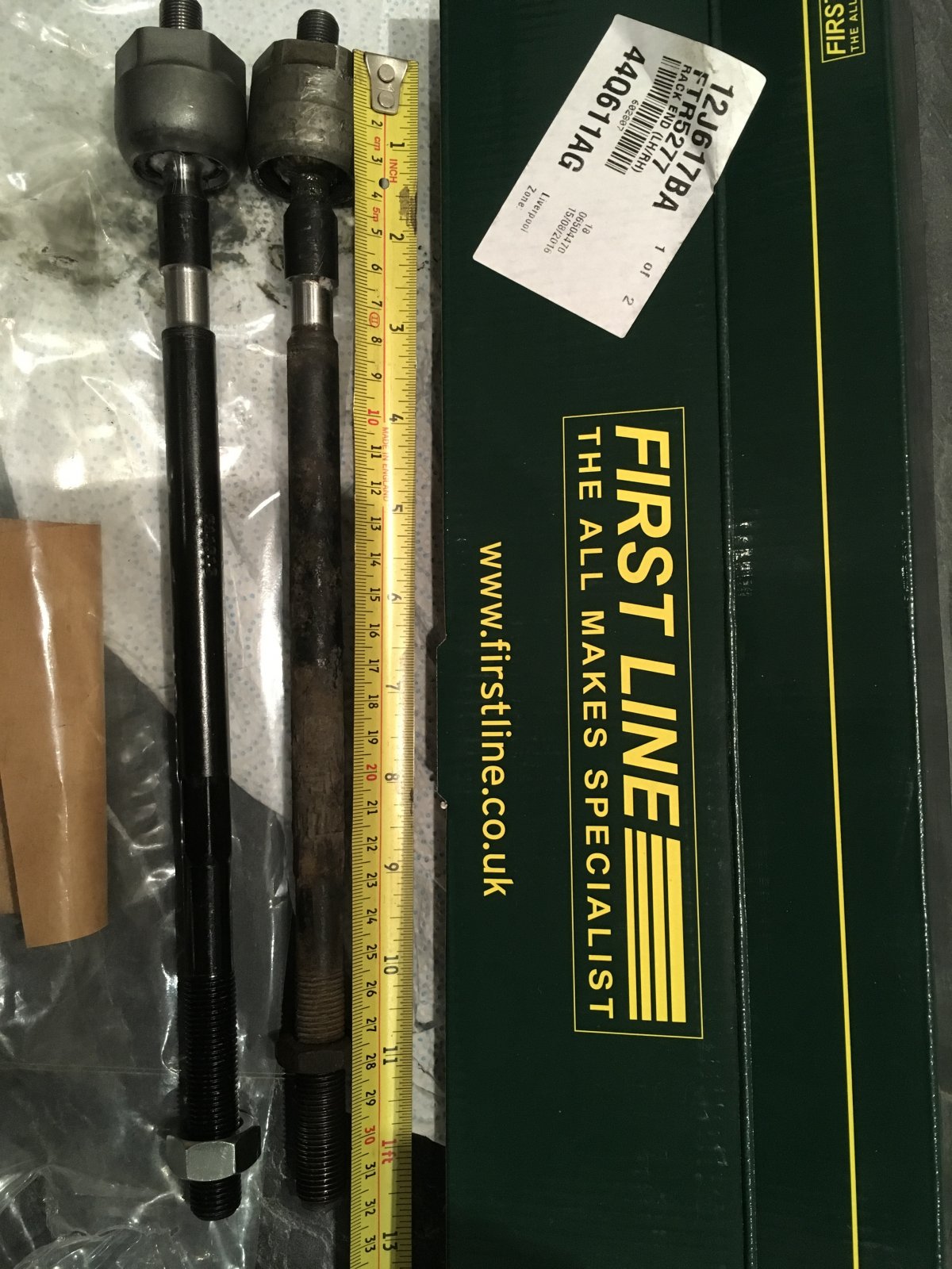

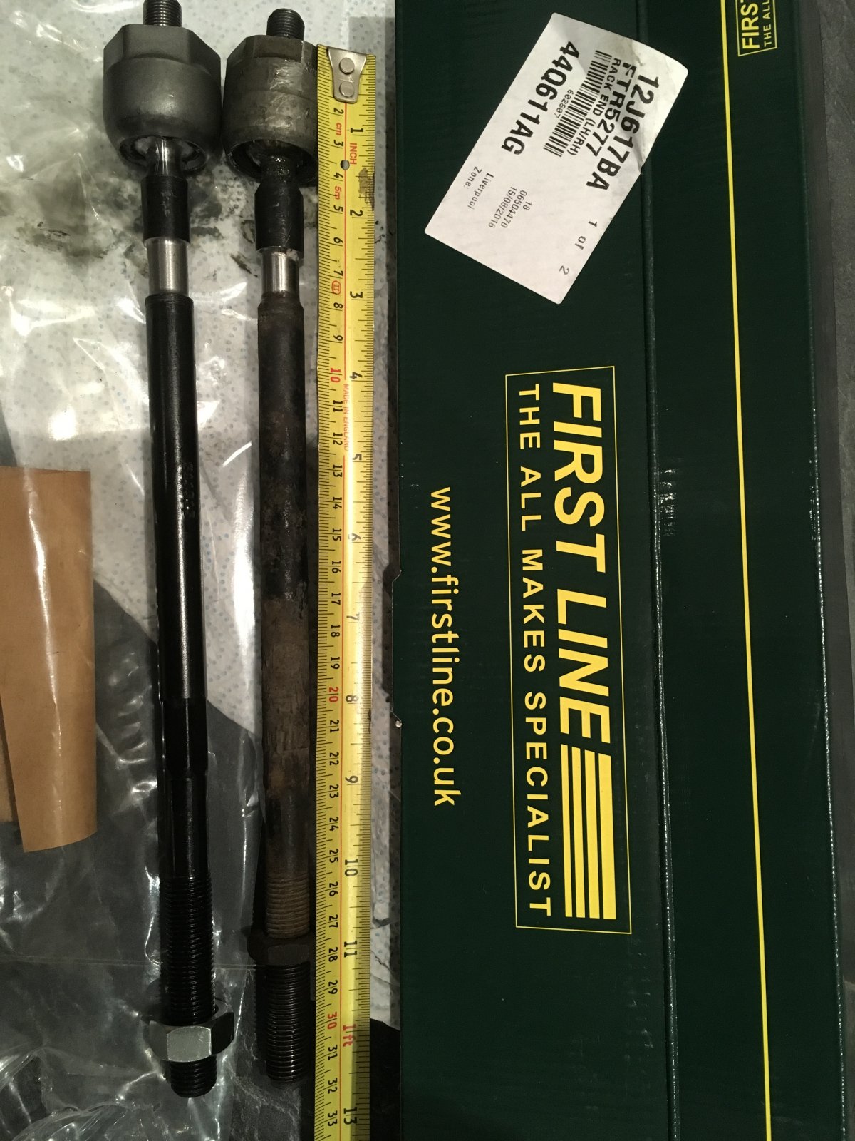

Not much going on here due to ECP! ordered some inner track rods and gaitors and a brake fitting kit.The delivery arrived today and when I picked the box up thought it was light ! opened it to find No inner track rods just a note saying to follow wtf! I assume they are on back order.
No probs because I can get on with the rear brakes but no there's only 2 bloody pad clips not 4 grr.

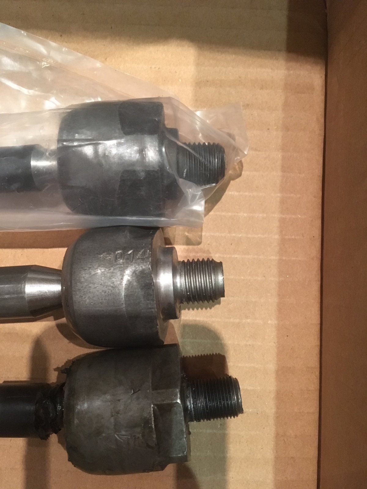

Any way what size thread are the TRE 's I presume 8mm but x 1.5mm or 1mm pitch thread ?

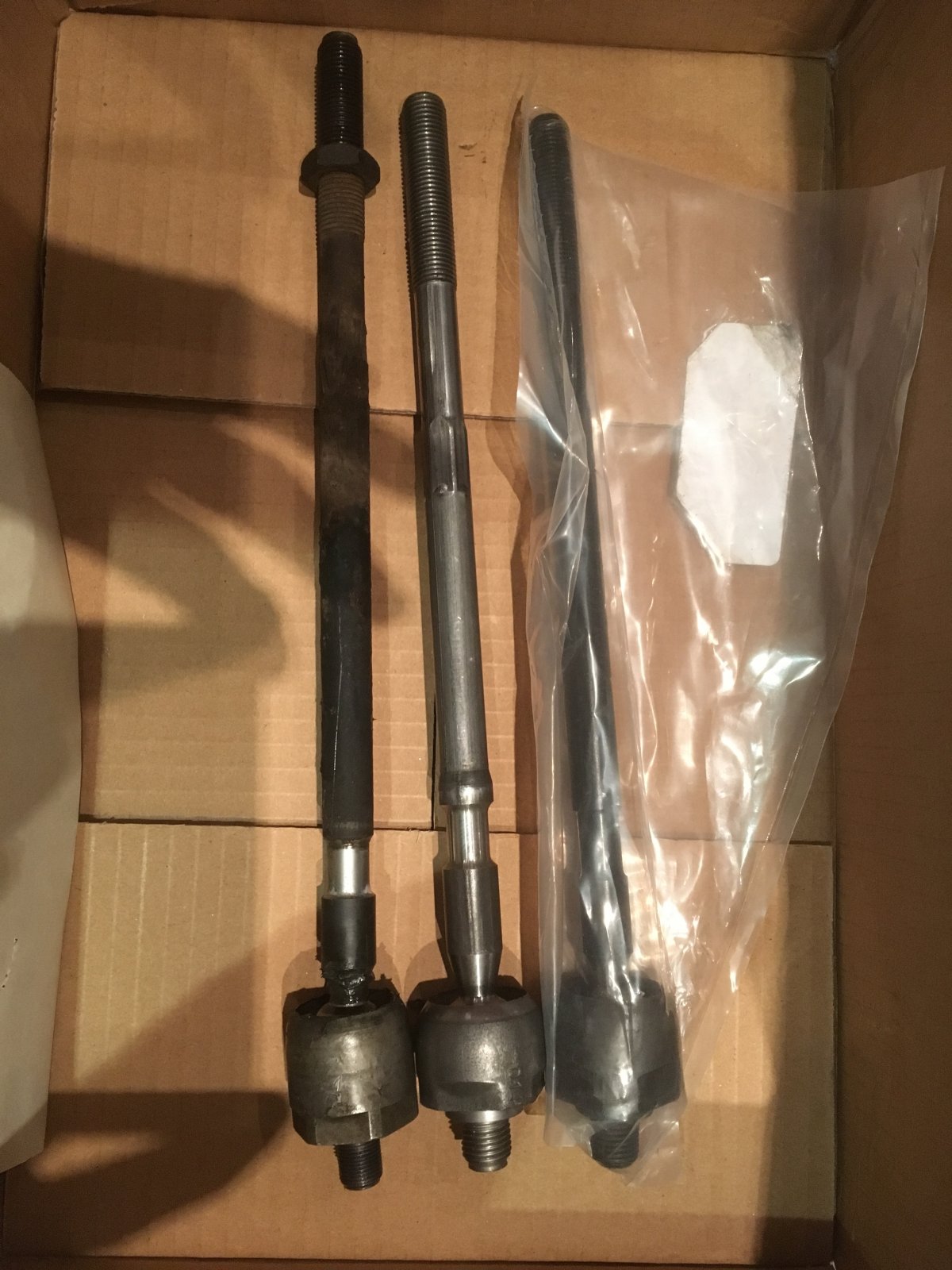

Do you have a part number ? ECP should deliver today if there wrong I need some asap. I have read somewhere that Kango ones fit ?
The left hand one is off mine near side middle one is Lemforde other is unbranded!!!

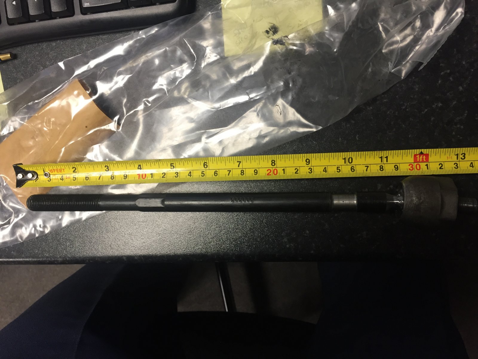

Where from ? just tried micksgarage but can't find the right part they are 320mm from end of thread to the face that goes on the rack.

That would be great but I've just ordered some, let me see if i can cancel them, how much for the ends?
I have just emailed to cancel them anyway so hopefully its quick enough.

Did you buy this from Blackpool? Was looking at buying it same time as I got mine if so, plans so far look good, please update when you get correct track rods as I've got a feeling I need some and read about 16,000 part numbers of the correct ones so far lol, cheers [emoji106]

Yes this was from Blackpool, you bought the other one I was after on ebay !
Will let you know on track rods I think I found the right ones on micksgarage but have cancelled my order.
I got qh ones. I'm sure the code was for the kangoo but they fit the 182

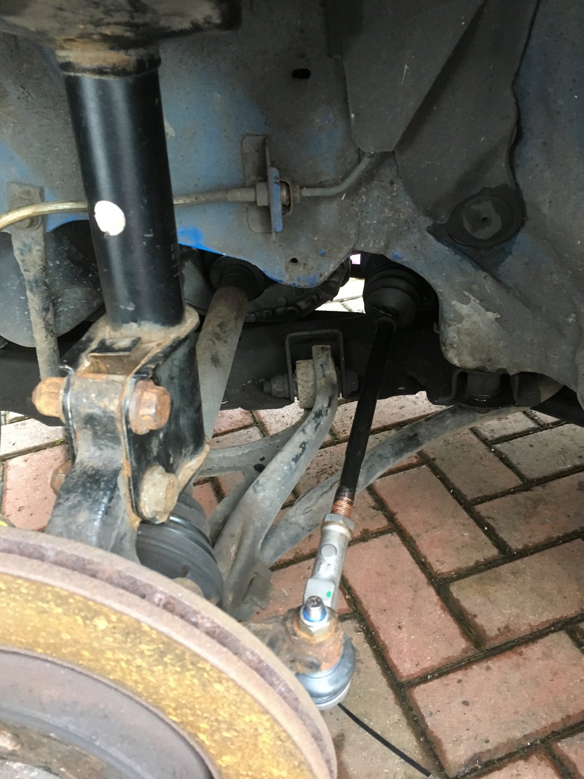

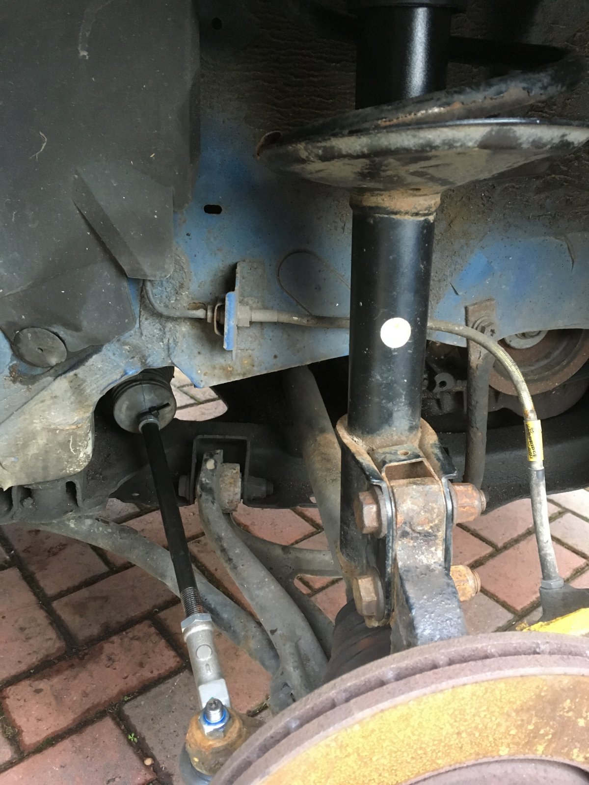

Today I fitted the inner and outer trackrods, the rubber boots were a pita to get on the rack but otherwise all straight forward enough especially with a tre tool.

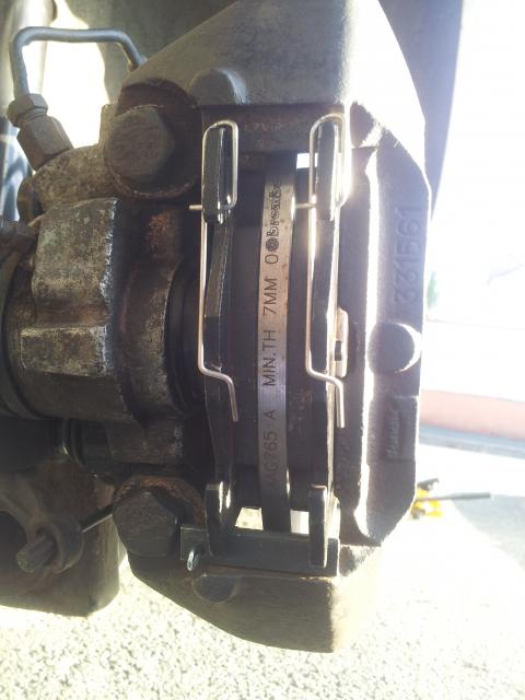

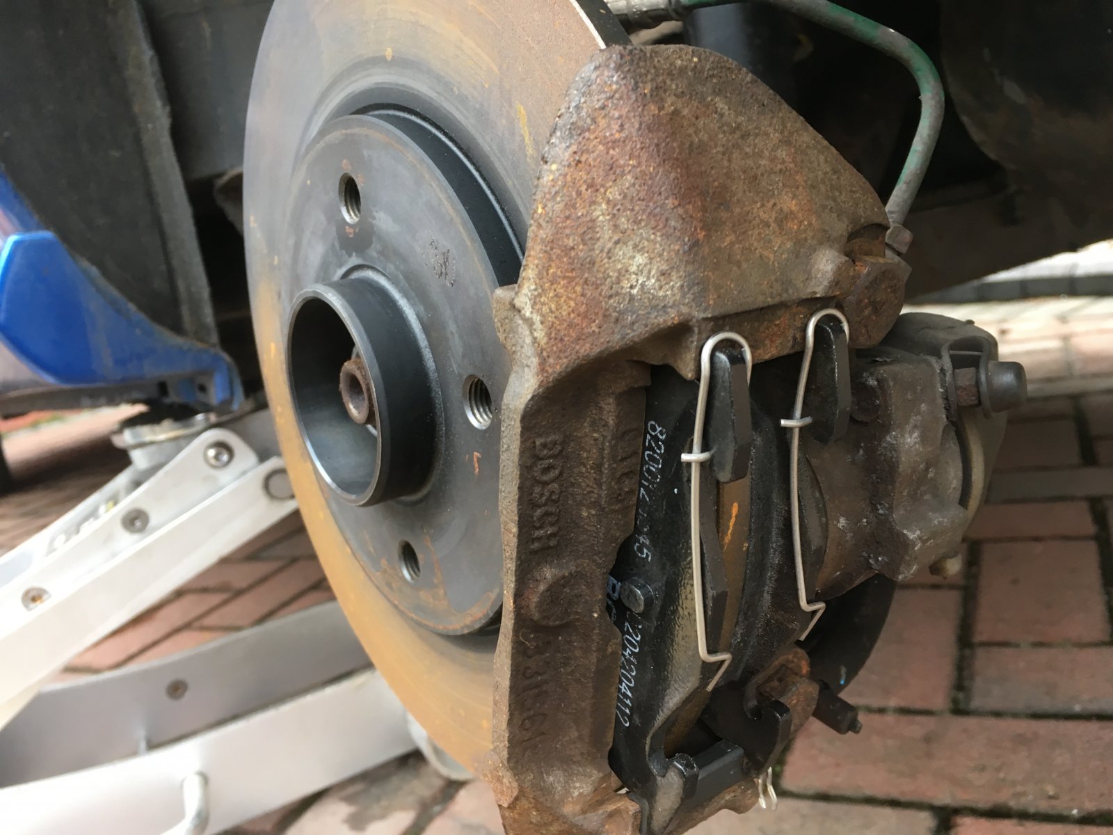

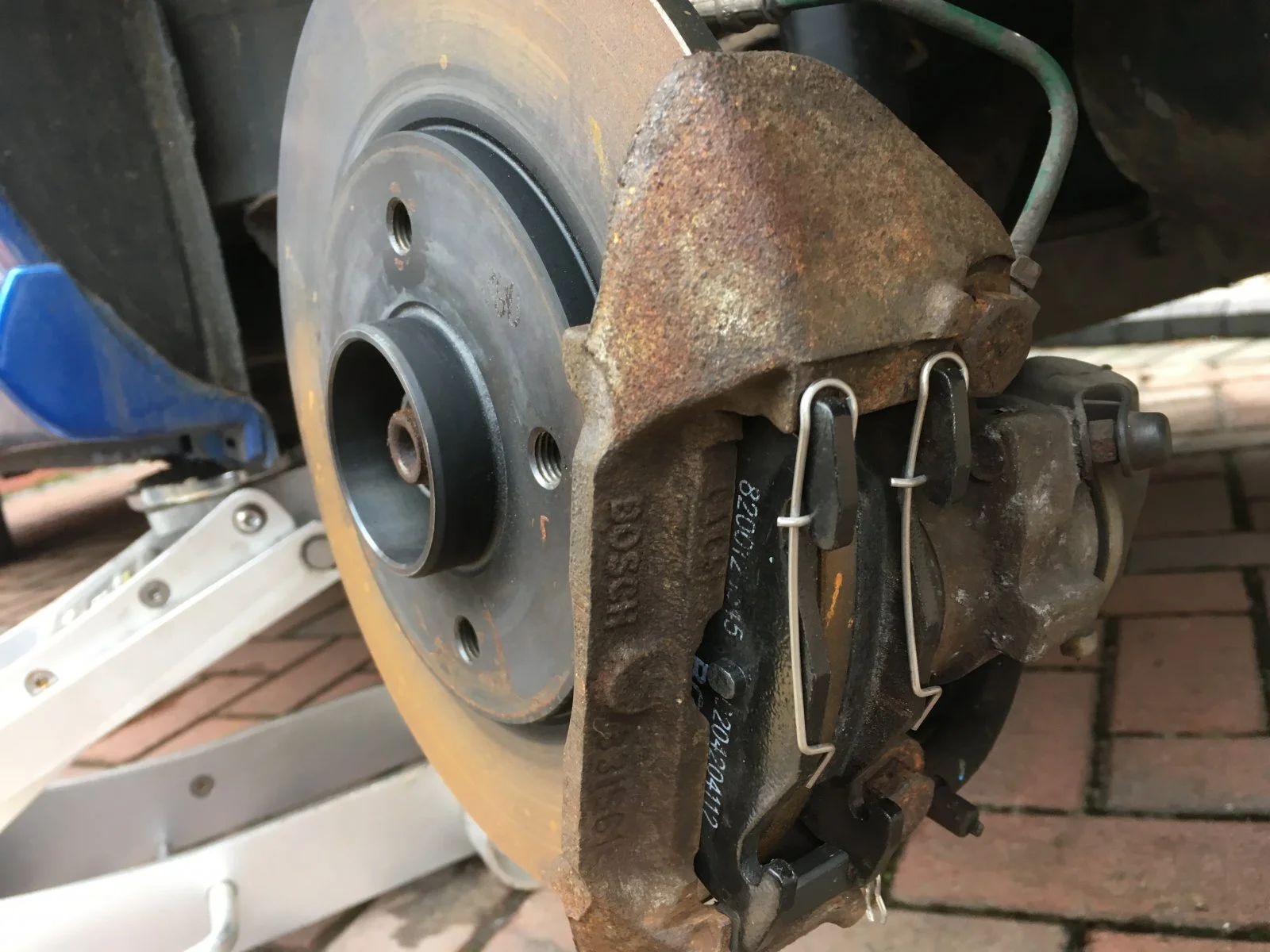

Then moved on to the rear to finish off the new discs and pads also used new fiiing kit from ecp.
Refitted the wheels then realised I'd not fitted the dust caps to the hubs so had to take them off again, this is because stripping it down a few weeks ago and not getting round to finishing them off and my senile old memory failing lol

Good stuff pal but just a note that the little push clip for the bottom metal rail that support the pads, it pushes through the bar and not like a ring/split pin style like you've done in the pic above. Needs to be right as you don't want the pads coming out trust me! :)
