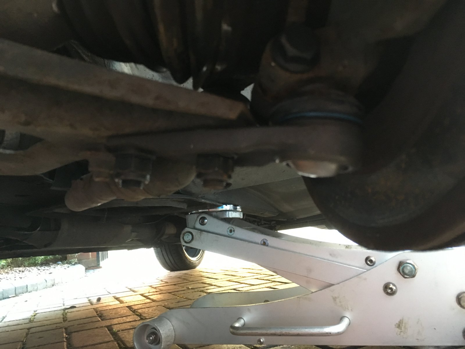

Just a small update, fitted some new ball joints which were a pig to do and I managed to nick one of the cv gaiters so will all have to come off to fit a new gaiter :rage:

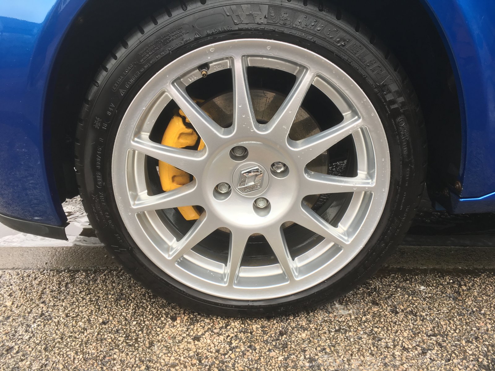

I gave the car a good clean today and it scrubs up really well, looks fantastic for 15 years old.

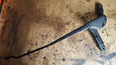

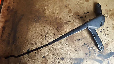

Needs the wiper arms changing as there's a lot of slack in the pivot points on the double arm @cs_dave

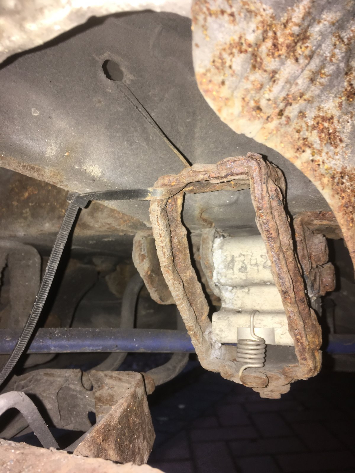

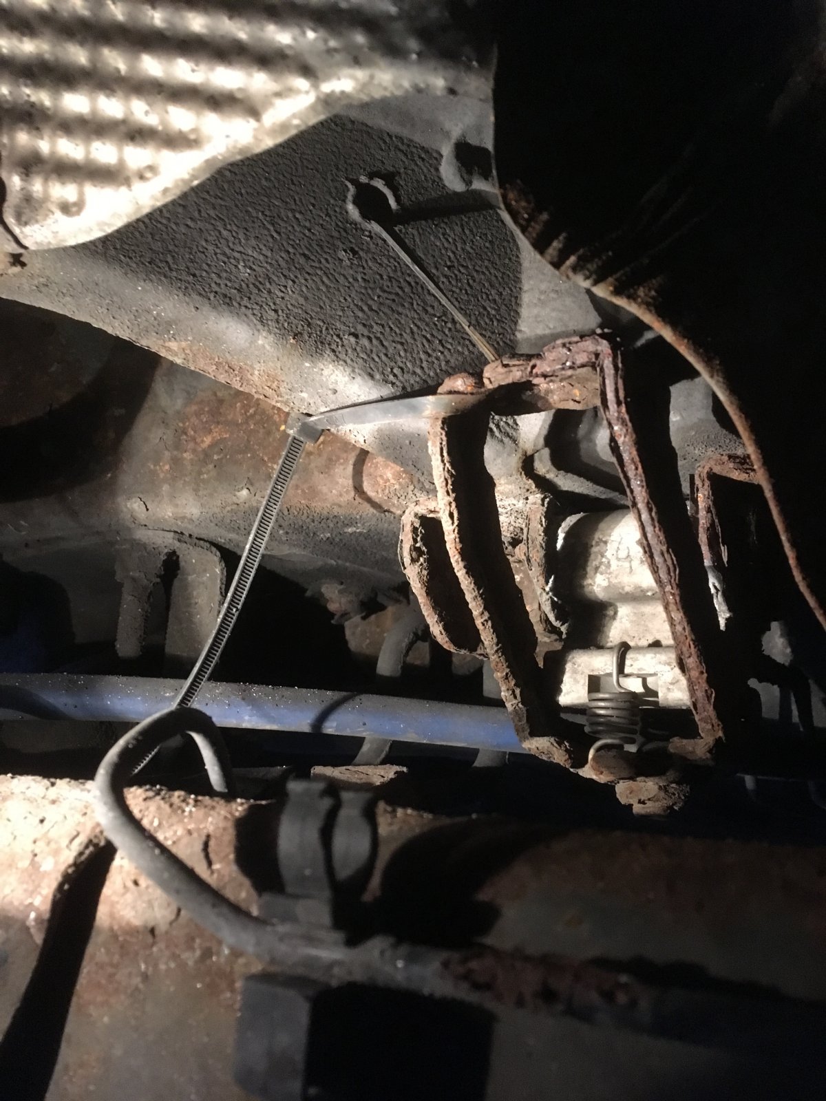

Checked the compensator and it was cable tied up, cut it off and freed up the lever which works with the spring and feels ok. I removed the off side pads and found the piston was quite difficult to turn back in but after a lot of freeing off got to move ok checked the arm for the handbrake and was ok. Tried the brakes a few times and it was a lot freer than before.

That compensator looks a familiar site... ha
My guess is that the majority of everyday road Cup's will be going or have gone through the same mate. The rear calipers don't do a lot and for the price I'd replace them and get some fresh fluid etc in. Good time to have a look at the rest of the system and not need to worry about it again in the near future.

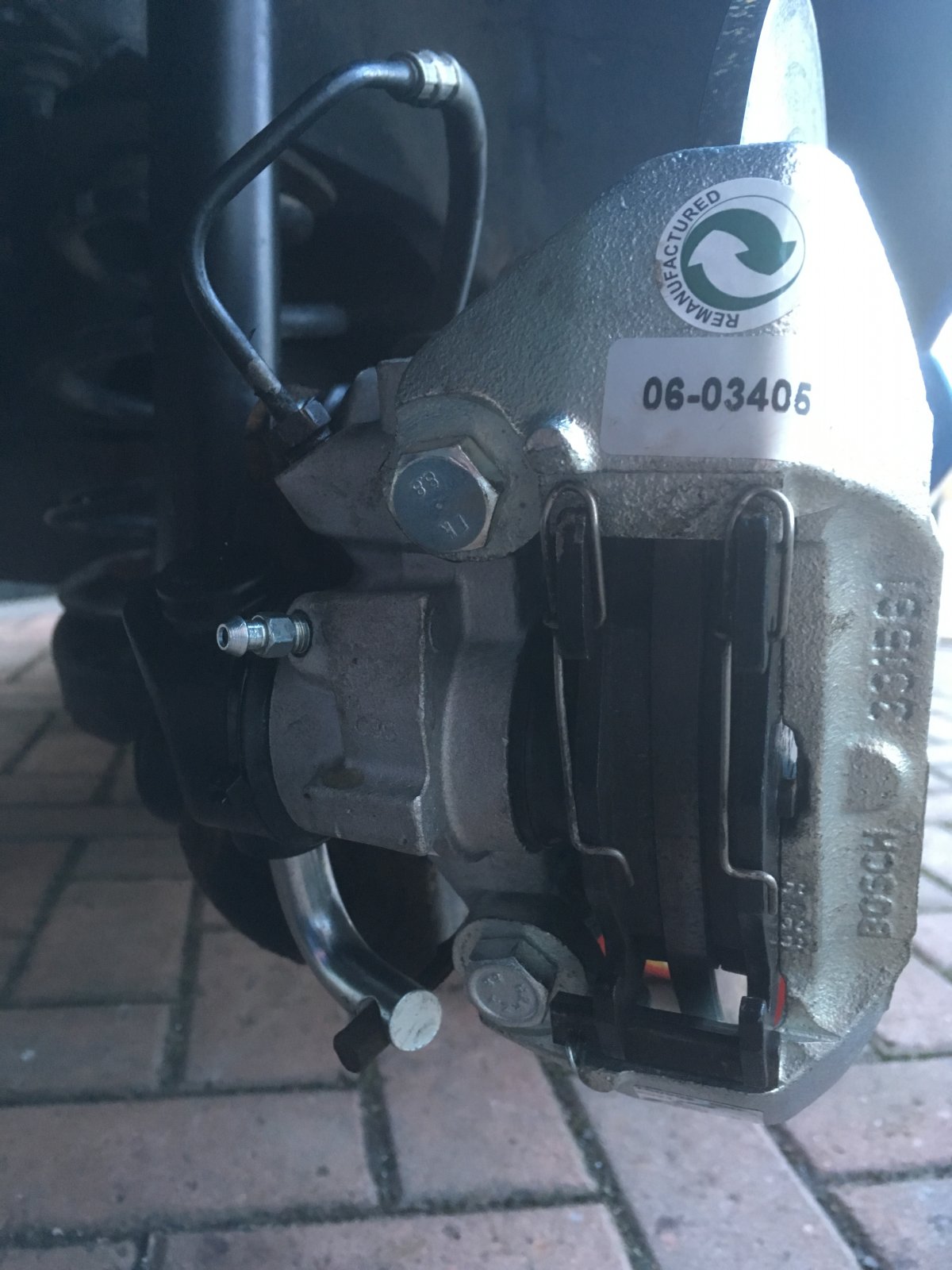

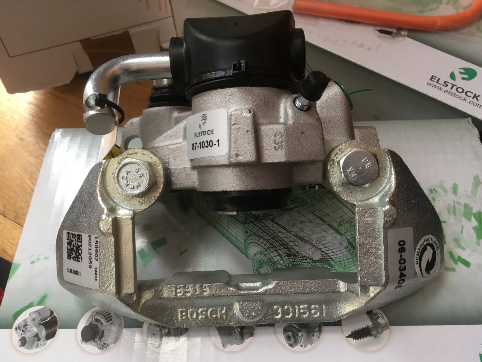

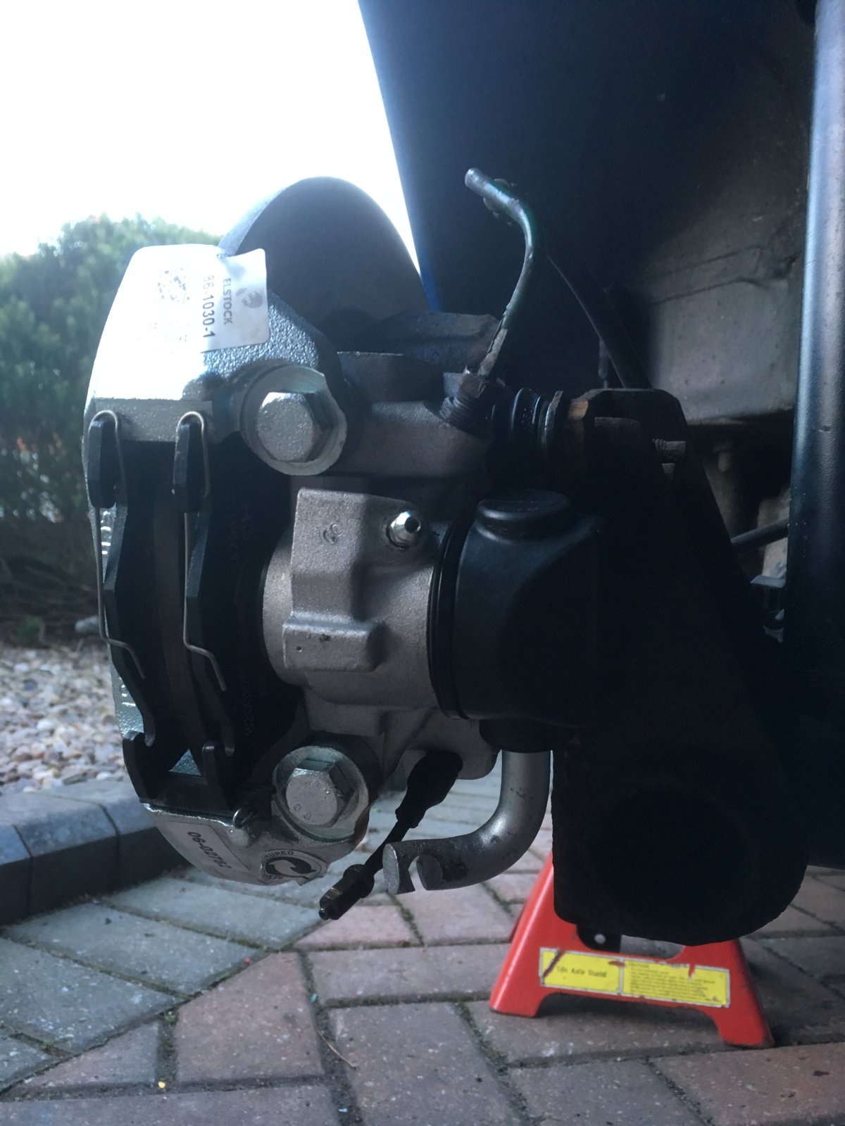

So the saga continues !
The replacement calipers arrived and look pretty good so set about fitting them, I did the near side 1st and after reading @Chris_Beer 's brake thread I also bought an 11mm flare spanner as I just new a sheared pipe would be waiting for me!
Took it very easy undoing the brake fluid pipe going clockwise anti-clockwise managed to remove it and fitted the new calipers , refitted the pads etc and could not get the handbrake cable back on as I adjusted it last week so I think it's a bit tight. I pressed the brake pedal a few times to get the piston out but it was still binding grrrr I freed off the mounting bolts so that it would move and they retightened them and all was well.
Now for the offside, same thing with the brake pipe so managed to undo it enough to remove the caliper but found that when fitting the new one it wasn't going to tighten without snapping the pipe so I whipped it off and used a blowtorch to heat it enough to free it off, yay !! Rebuilt the calipers and fitted the handbrake cable. Sucess.
I bled the system this afternoon which was fine except the wind blew the friggin brake fluid container over spilling it all over the bloody drive (Mrs Shiftspark is not very happy with me ) then the near side front was 'kintight quite how you can get a bleed nipple that tight is beyond me. Then onto the off side which was the same f in tight and yep it sheared clean off. This car is getting on my tits right now.
Any how the pedal seems ok so thought I'd nip out for a quick test drive and the battery is as flat as a witches tit ffs.
Ha !
Enjoyed reading that mate... serious flashbacks! Well done getting the brake pipes free, I wouldn't of needed to replace mine if I used heat on them like I did with the compensator 😧
Can't believe the bleed nipples didn't snap before if they did them up that tight ! Ridiculous, only mean't to be nipped up, they are tiny.
RE: Handbrake - I had to loosen mine off massively to get the cables over the levers, then you can adjust them accordingly to suit (not too tight remember!)
Get yourself a battery charger (don't bump it and stress the alternator out!) and also some brake cleaner cans for the fluid and keep Mrs Shiftspark happy :wink:
It will be worth it if thats your problems sorted pal :smile: Calipers look good!

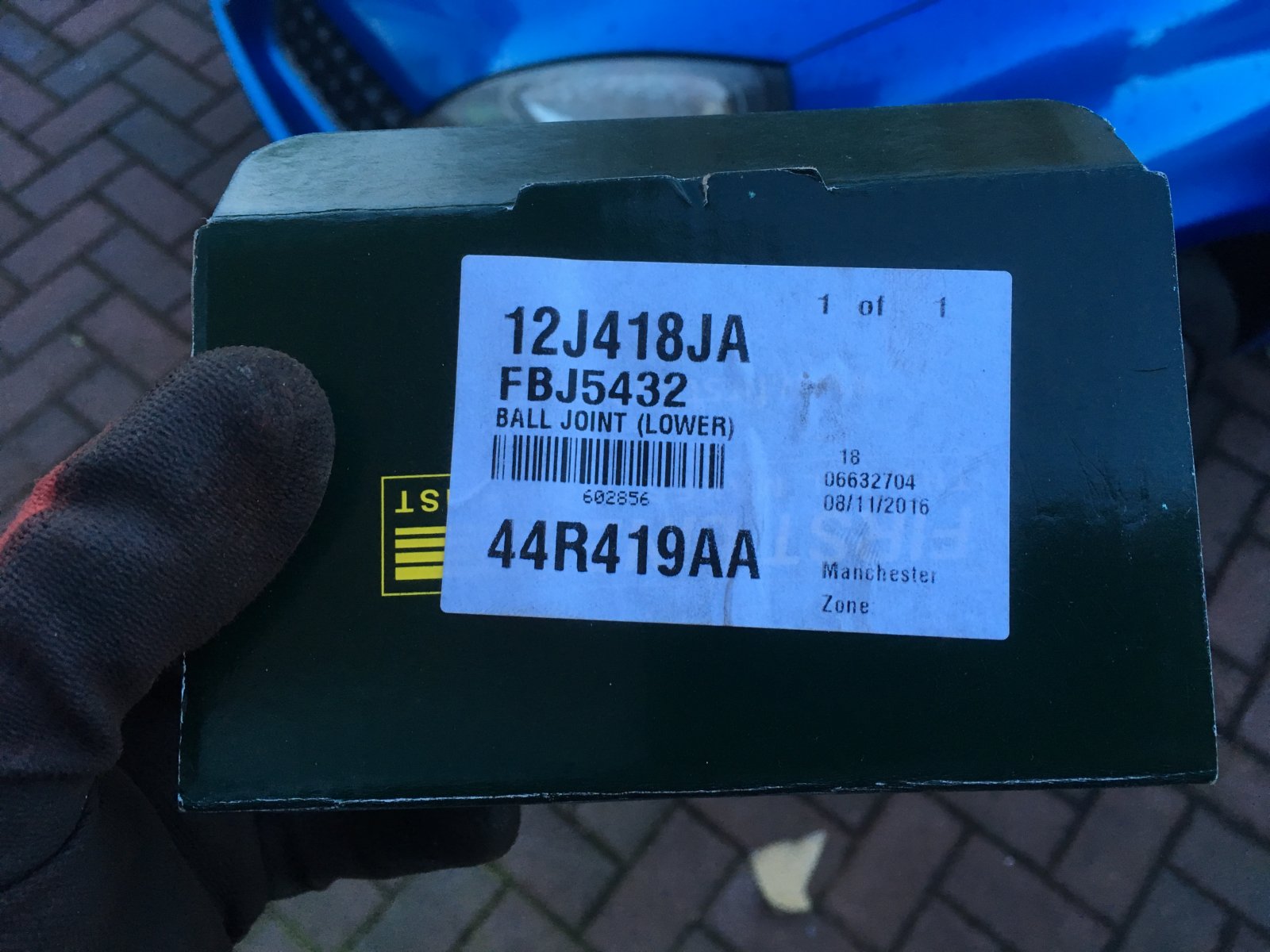

Clios coming along well.Im away to order track rod ends and ball joints.Are these ones you got cheaper than renault as the prices there seem quite pricey.
shiftspark
  R53 GR86
Yes the non genuine are cheaper but you can't get just ball joints on there own from Renault as far as I know as they come with the bottom arms.

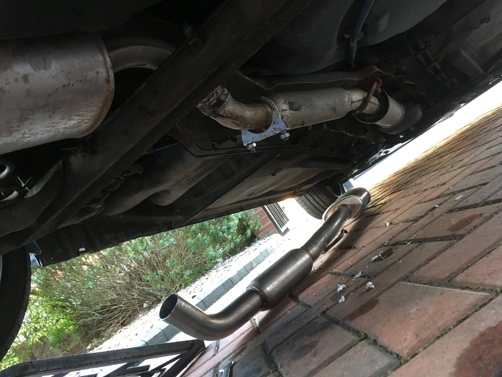

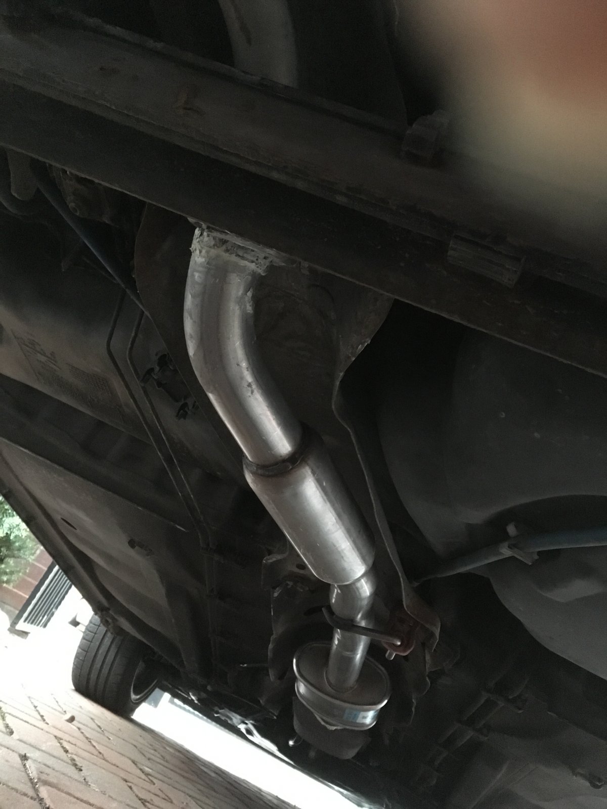

Another day toiling under the Clio ! Removed the old ktec exhaust and decat and fitted a cat and replacement exhaust that I have bought from the sales forum. Fitted new mid mount and cat to exhaust kit and the old one had bolts and bits missing from it. It was a pig of a job to do and if it wasn't for my 11 year old trainee mechanic who held the bolts in place whilst I fitted the springs and washers I would never have managed it. Still it cost me a £15 Xbox game all for 30 mins work :tongueout:
Not much left to do now just a cv boot and change the front calipers over to my gsf refurbed ones and were good to go. Oh and swap the matched inlets over.

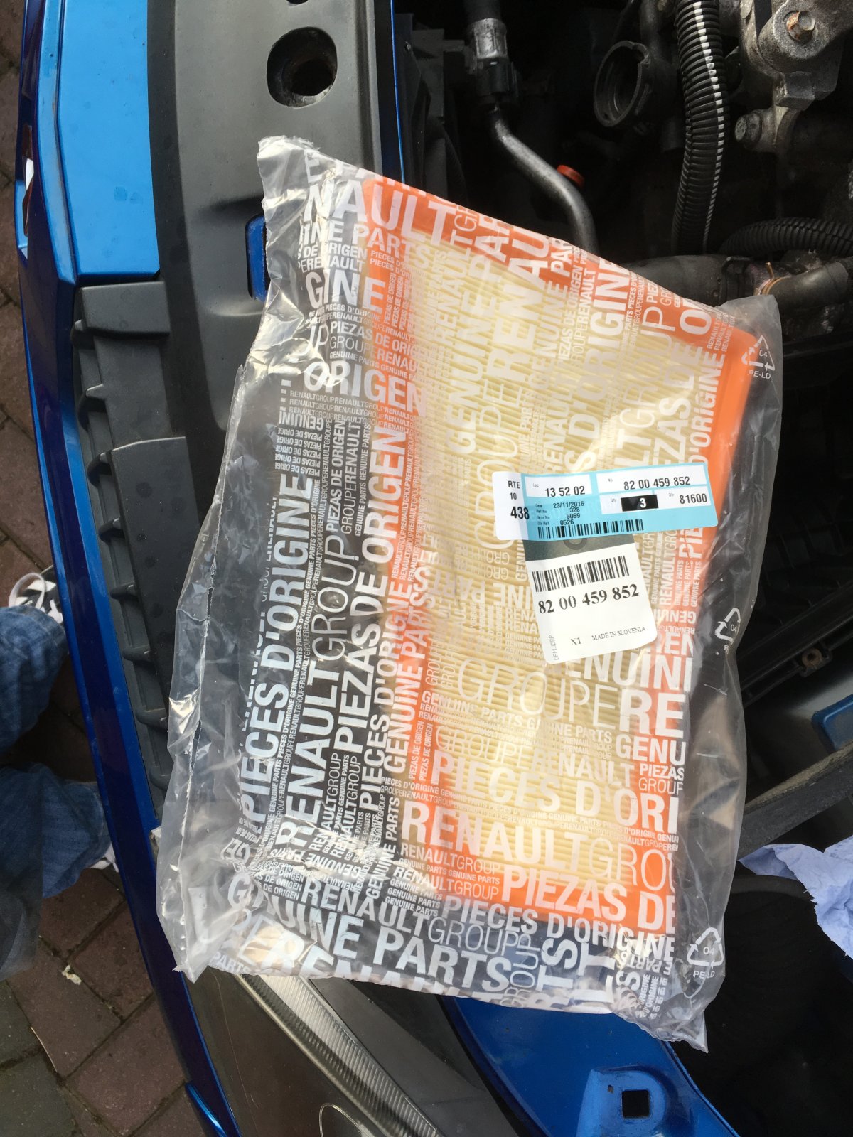

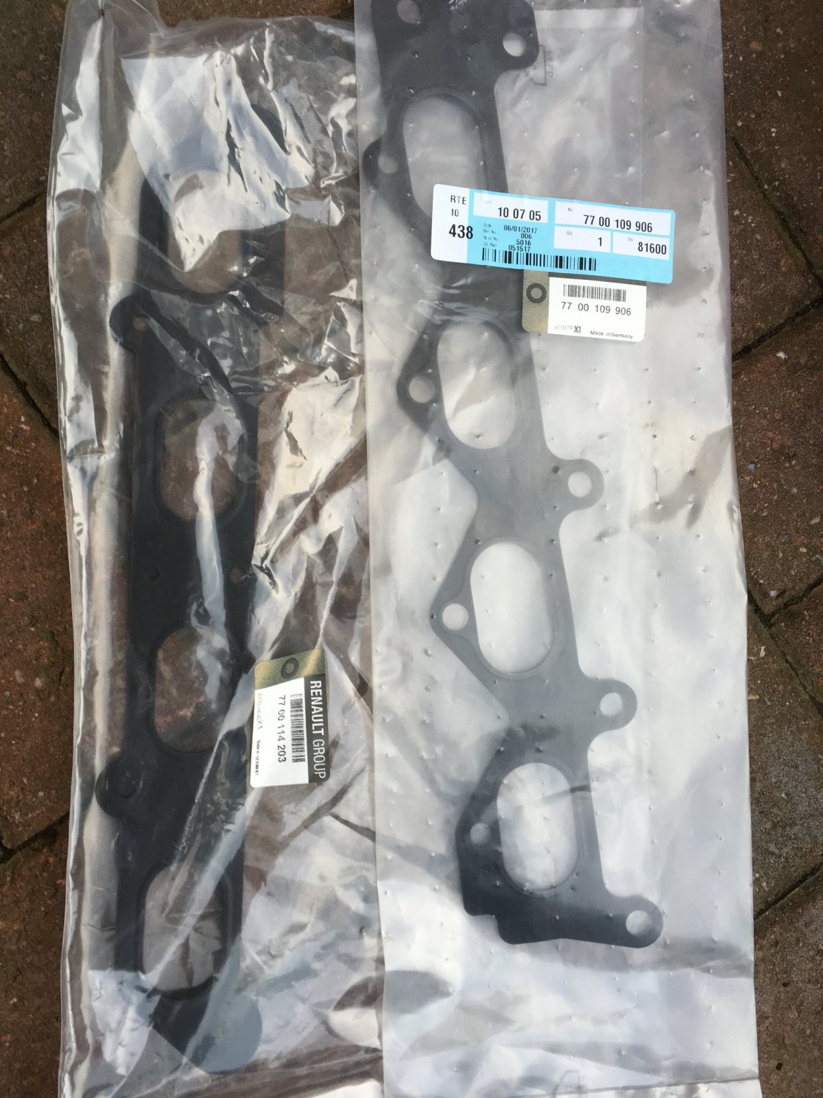

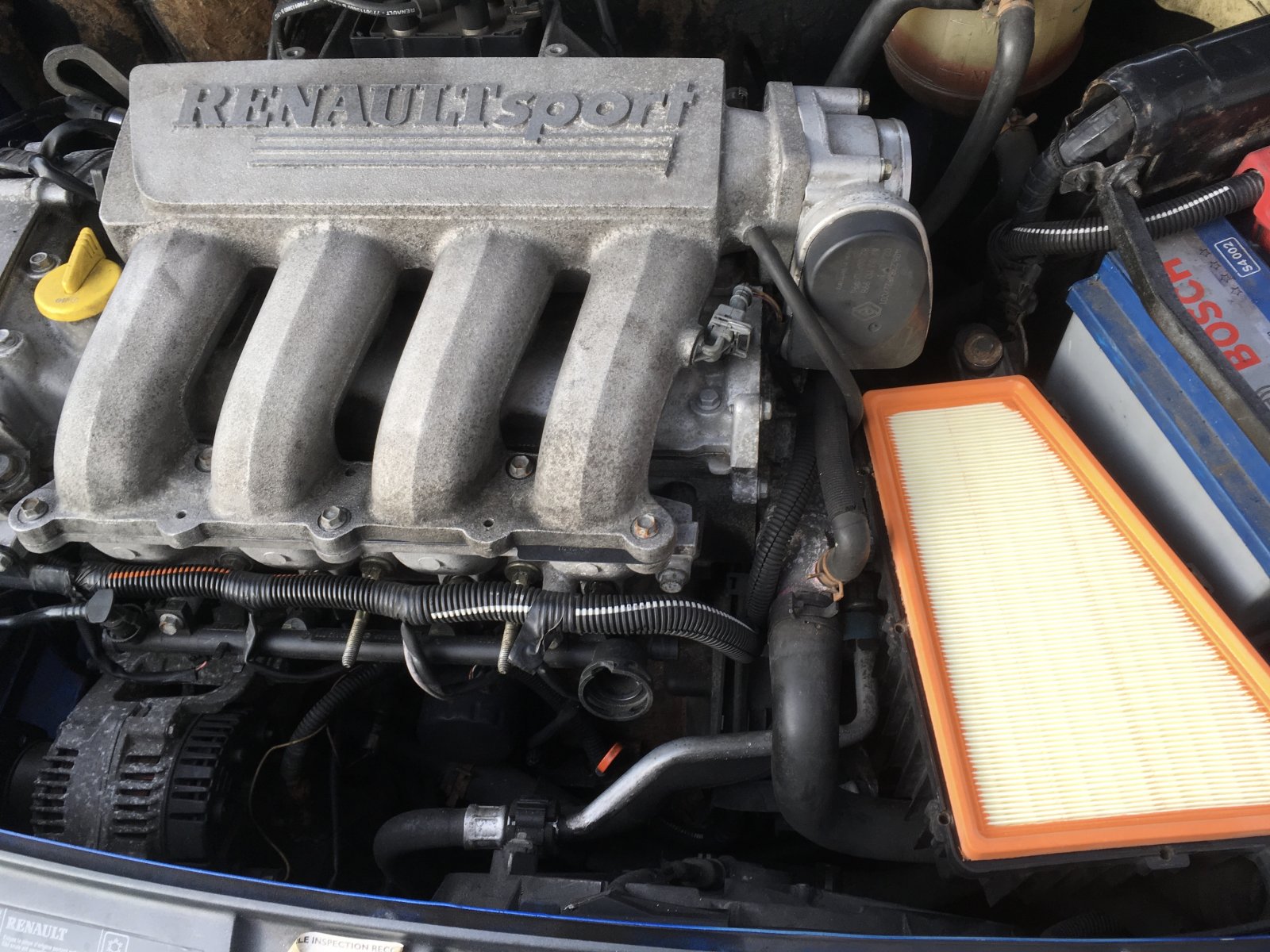

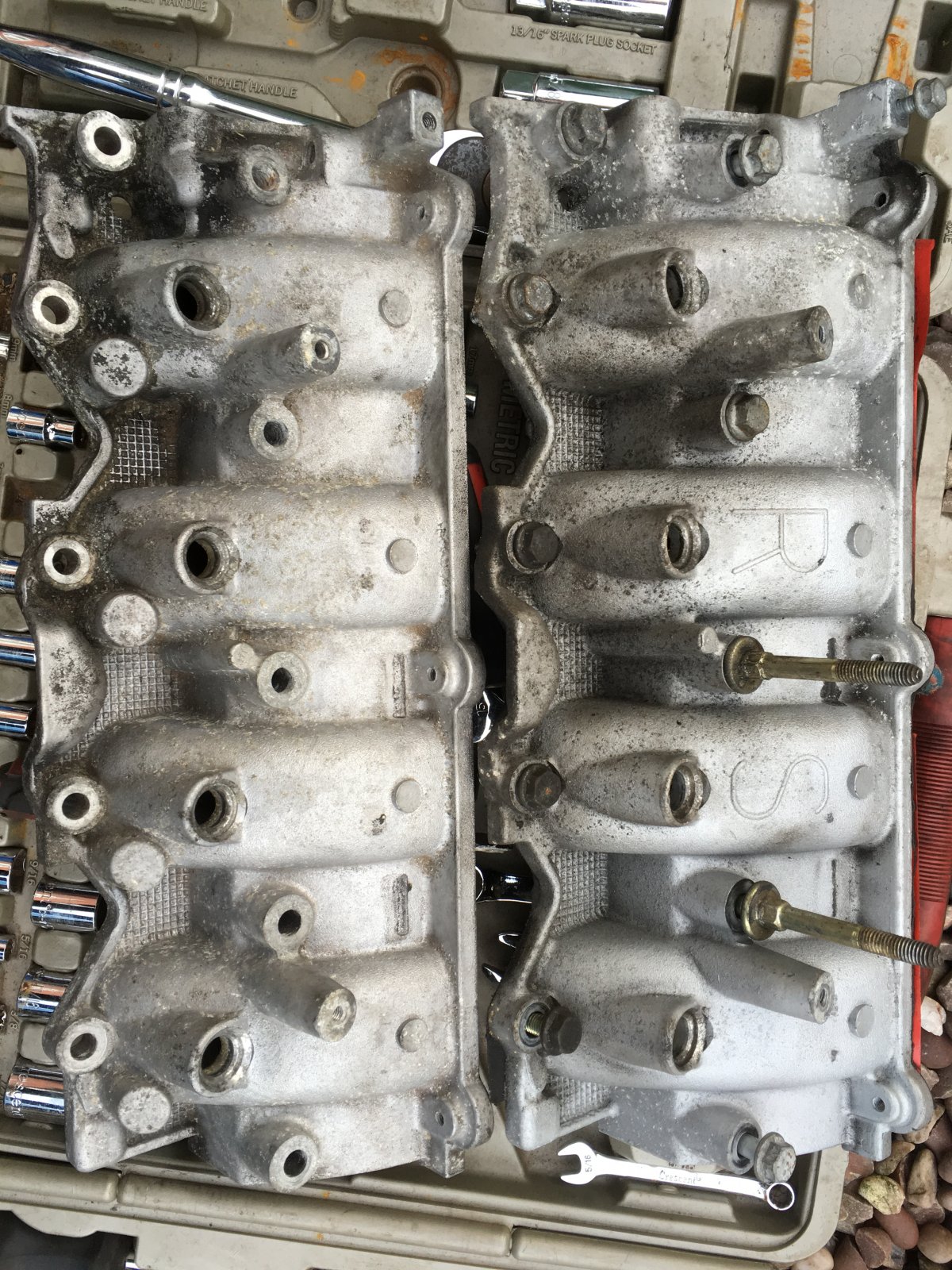

I have changed over the blowing centre box to a new one bought from eBay it fits ok and doesn't bang on anything. The only problem was the recess in the flange wasn't deep enough to take the rim on the cat so I had to use a couple of gaskets and loads of paste for now.
Also swapped the matched inlets back to standard and fitted a new air filter whilst I was in there, the car doesn't seem any worse off for loosing the inlets and decat.
My new M1144 pads arrived so I will fit them at weekend and bleed them again to get rid of the long pedal and drop the oil, the gearbox oil was done last week when the cv boot was done so that's it for now.
