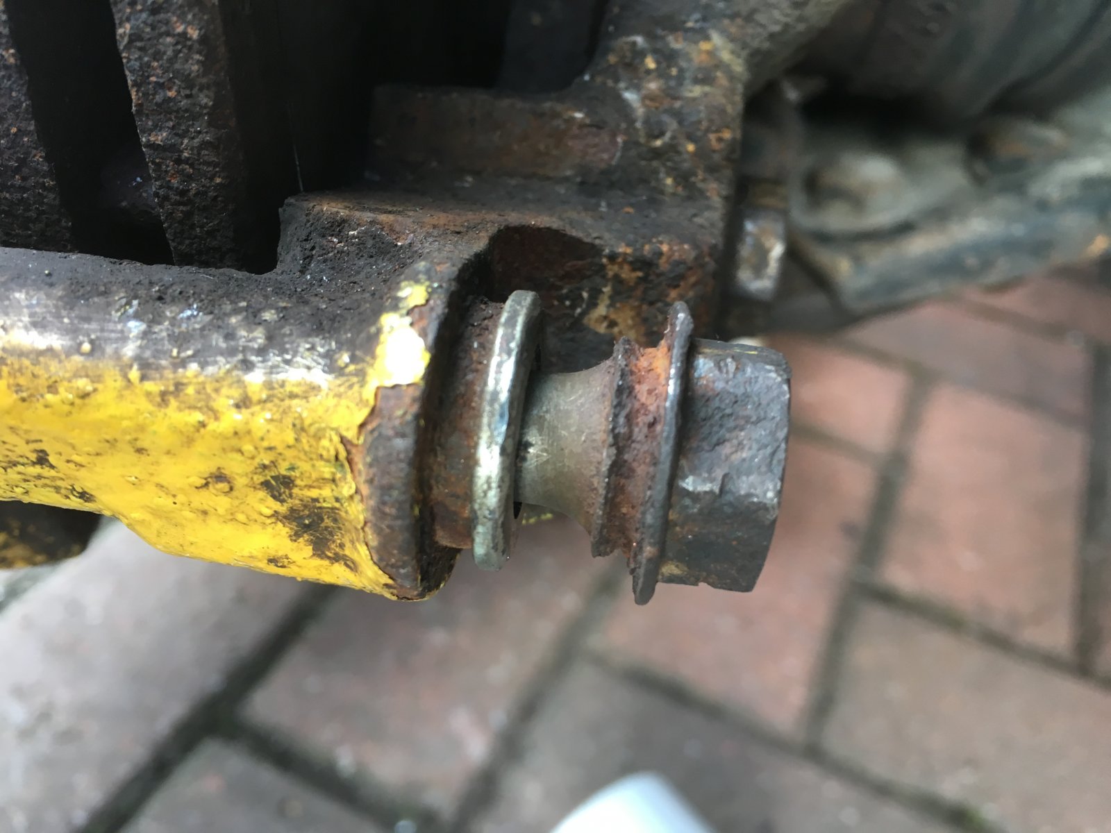

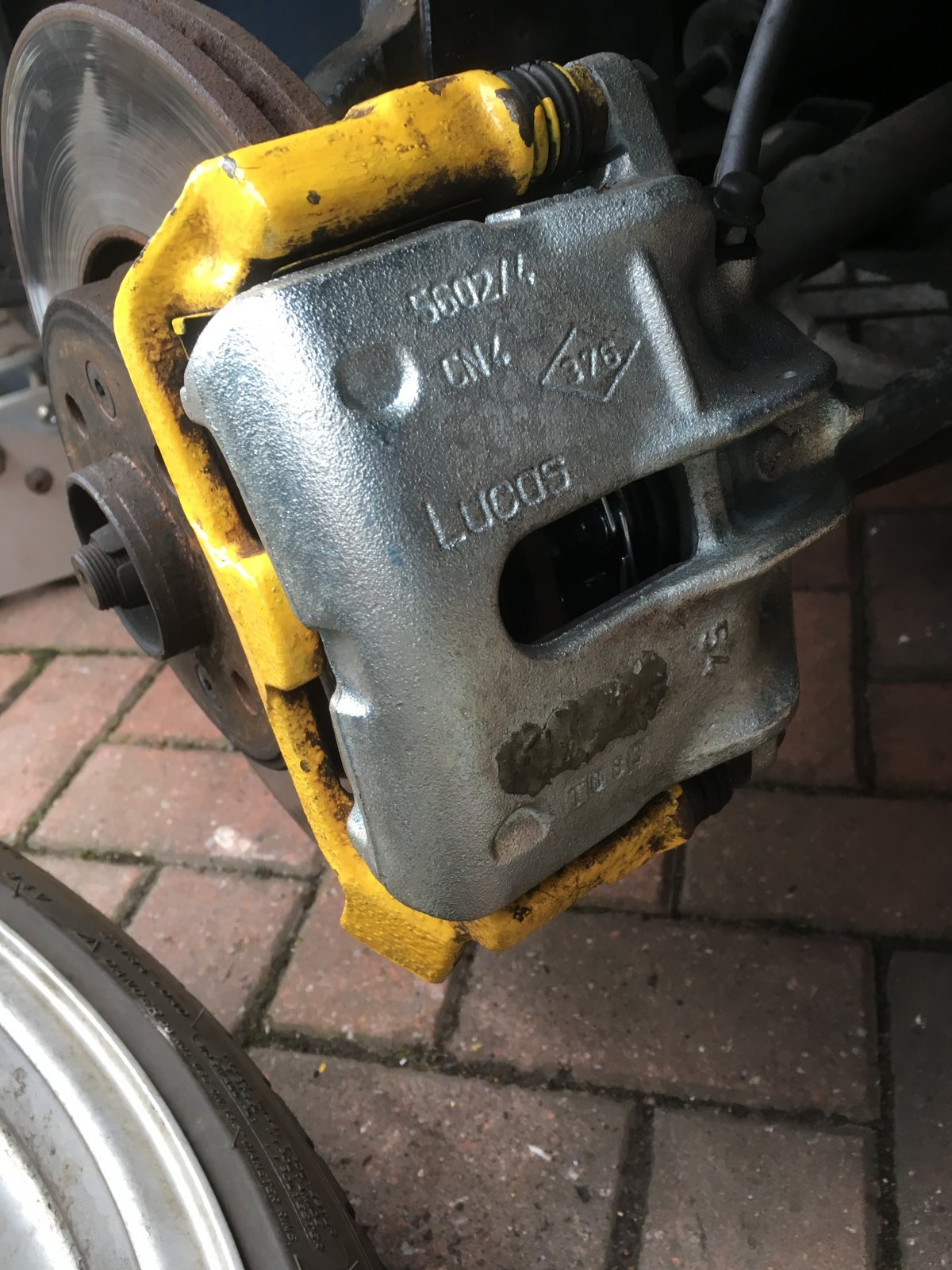

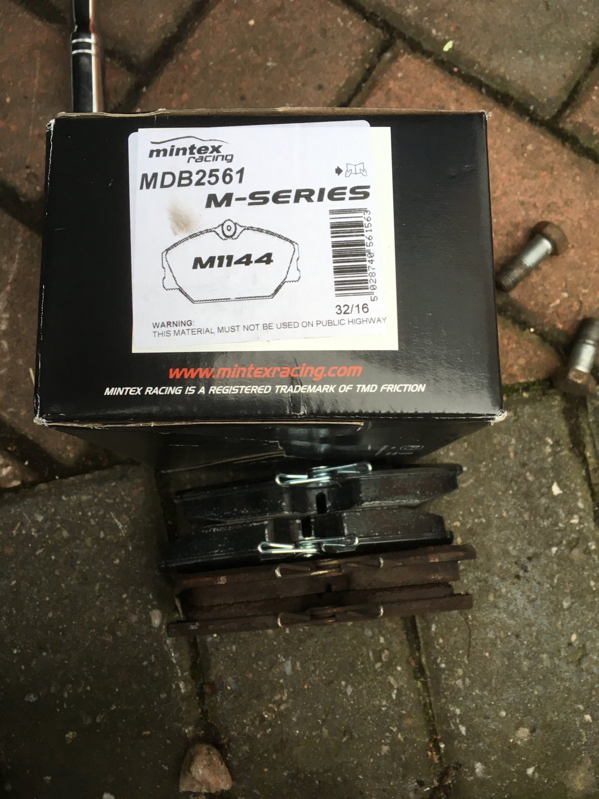

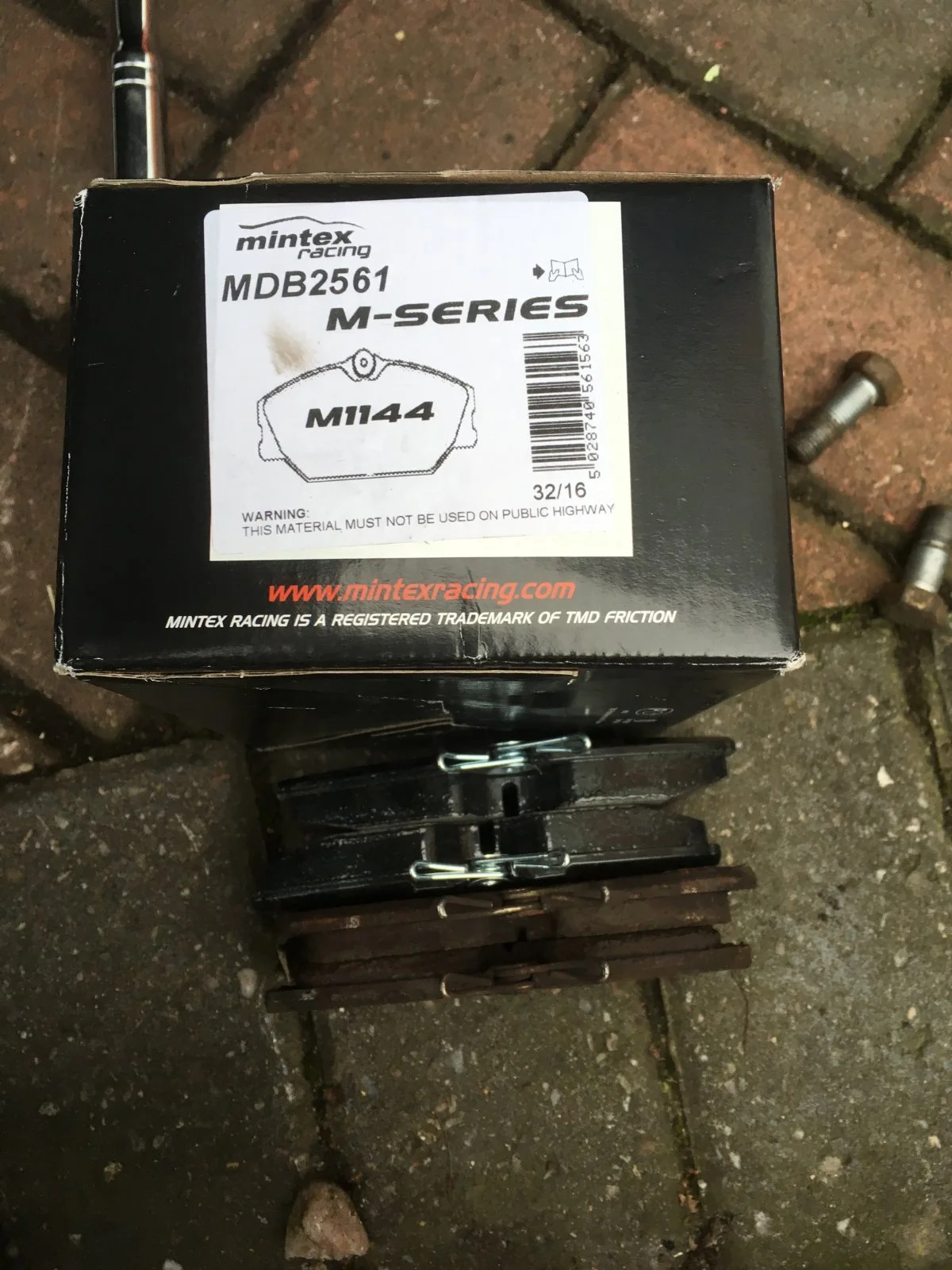

I had a free couple of hours this afternoon and thought I'd better make the most of it as the weather is turning wetter the next few days. So I fitted the mintex pads , near side 1st all done in 20 mins or so. Moved on to the offside and could not get the caliper back on as it was hitting part of the casting ??? anyways after another look I found the bottom caliper pin was seized solid preventing the caliper sliding grrr :tired: after a bit of work I got it out and gave it a clean up and wiped a smear of copper grease on them and it's moving freely. On reflection I should have sent them to Bigred for a rebuild but hey :openmouth: Fitted the pads and they are 100% better :smile:
Hopefully they won't need bleeding as the pedal is back near the top.
Let us know how you get on with the 1144 I was toying with the idea of them but read mixed reviews for track use so got the 1155 instead [emoji106]
They will be fine as they will not got much heat into them as we only do single laps at a time.

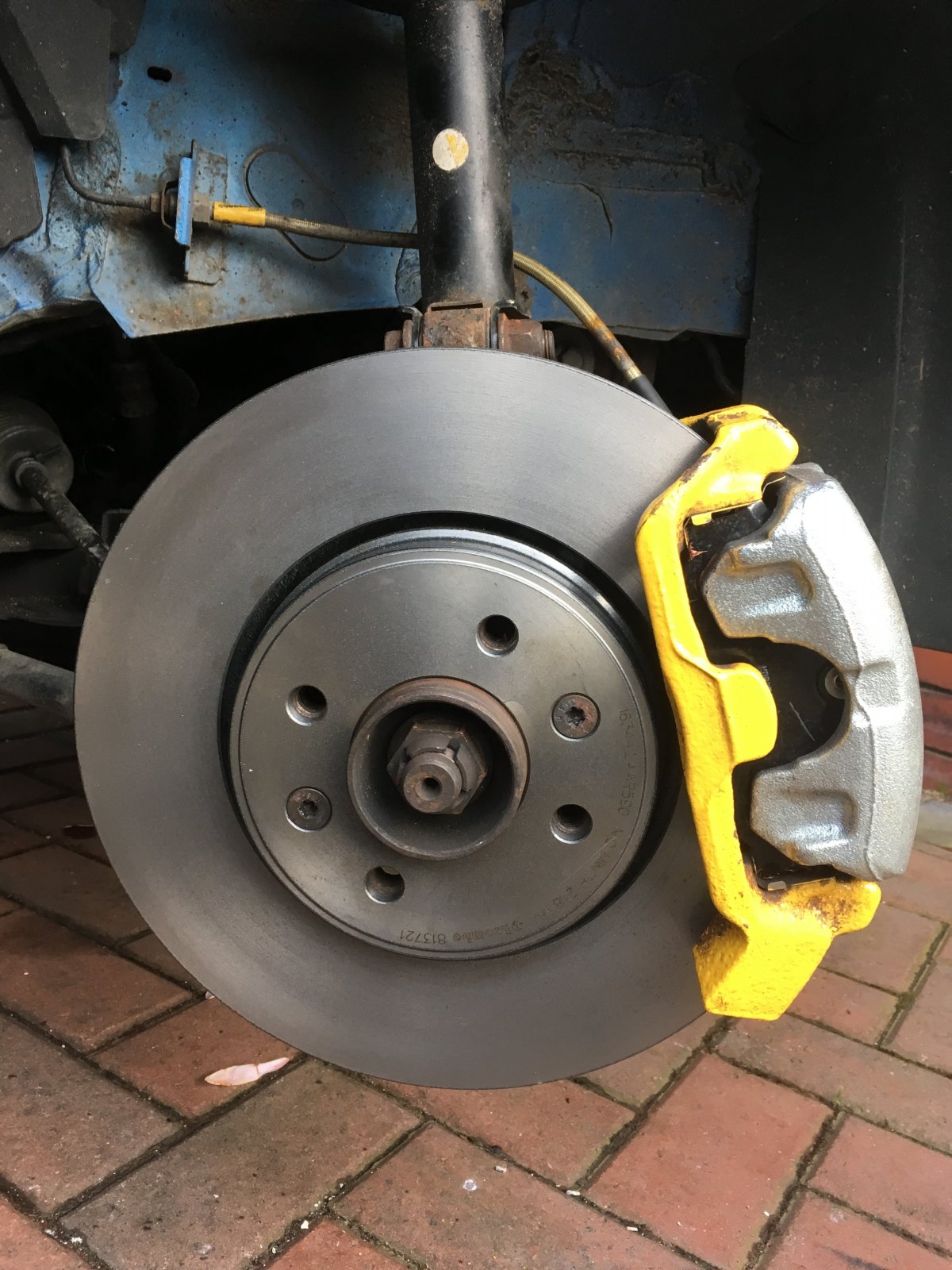

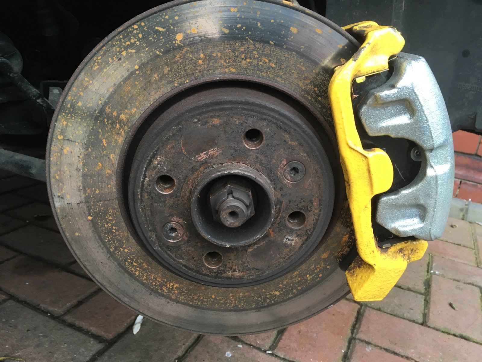

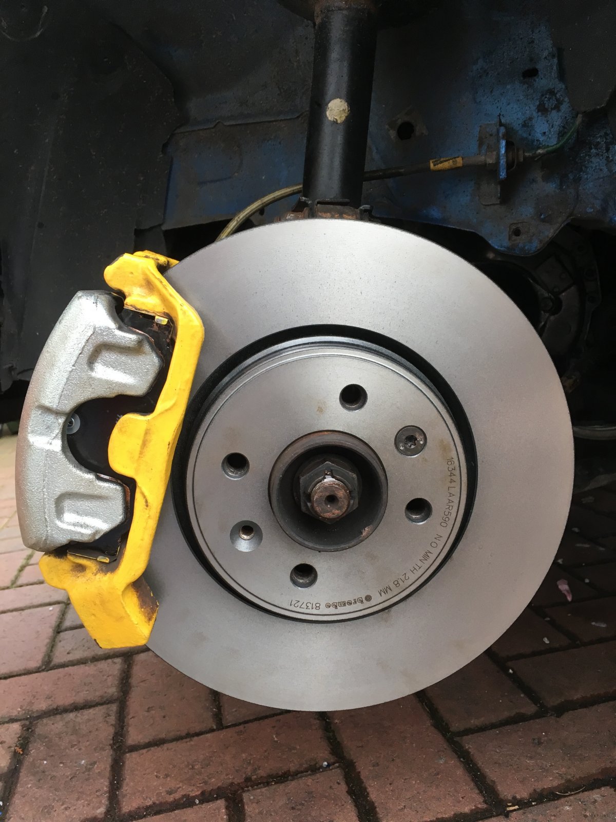

Fitted some new front discs today thanks to @George@RTR_Parts I paid at 5pm and they arrived next day at 9:30am which is superb service :up:
Cars all ready for Saturday at Anglesey just got to load up tomorrow night with a few tools just in case then up at 5am :sleeping::sleeping:
A few pics of the old vs new discs.

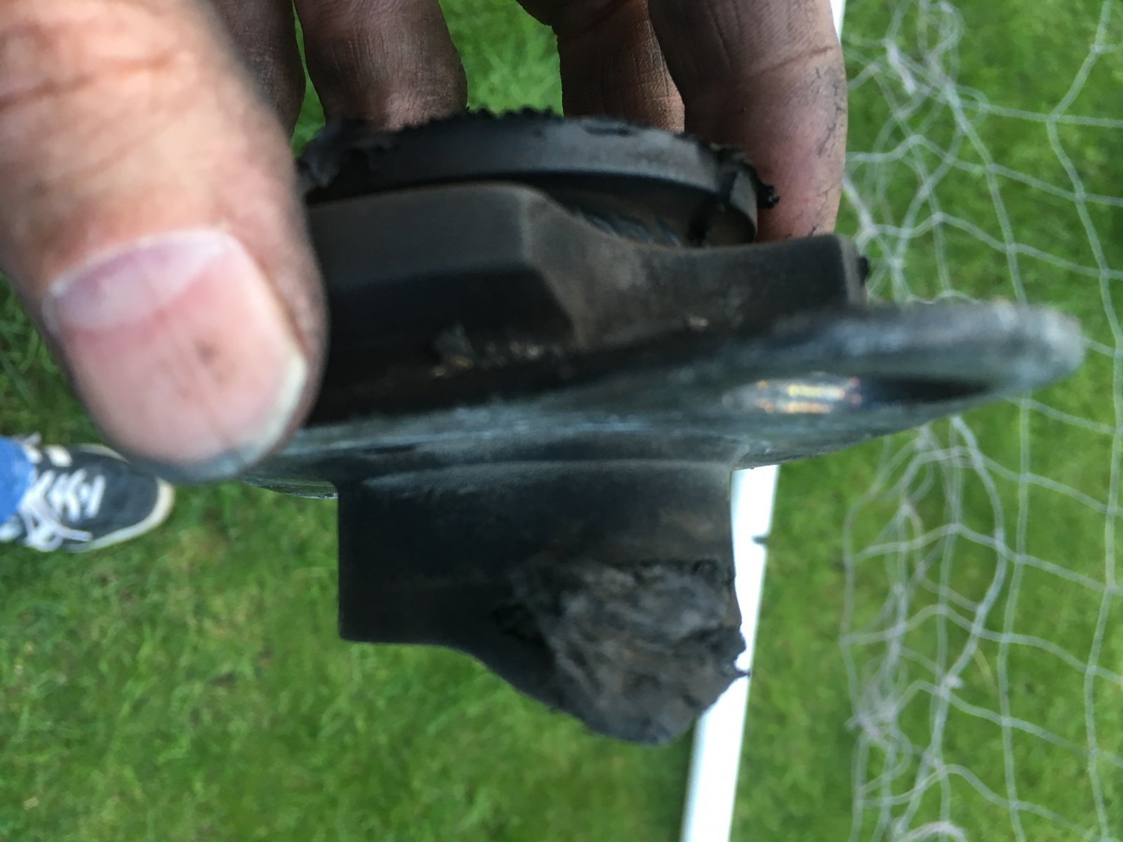

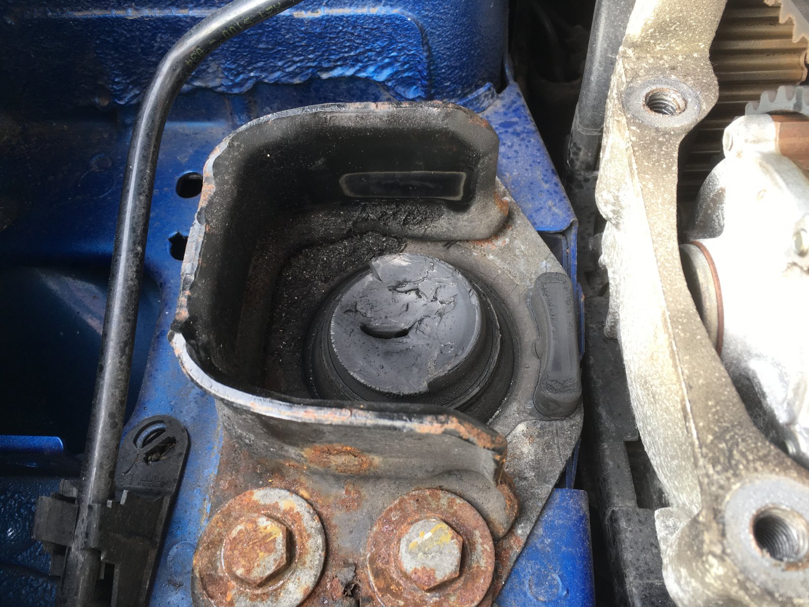

Not updated this for a while so here goes, I noticed that there was a knock coming from the engine under hard acceleration and when changing from 1st to second so bought some Febi mounts a while back to change them as I thought they were just tired ,well the gearbox wasn't too bad but the top engine mount was in 2 pieces :hushed: so I am glad I changed them over.

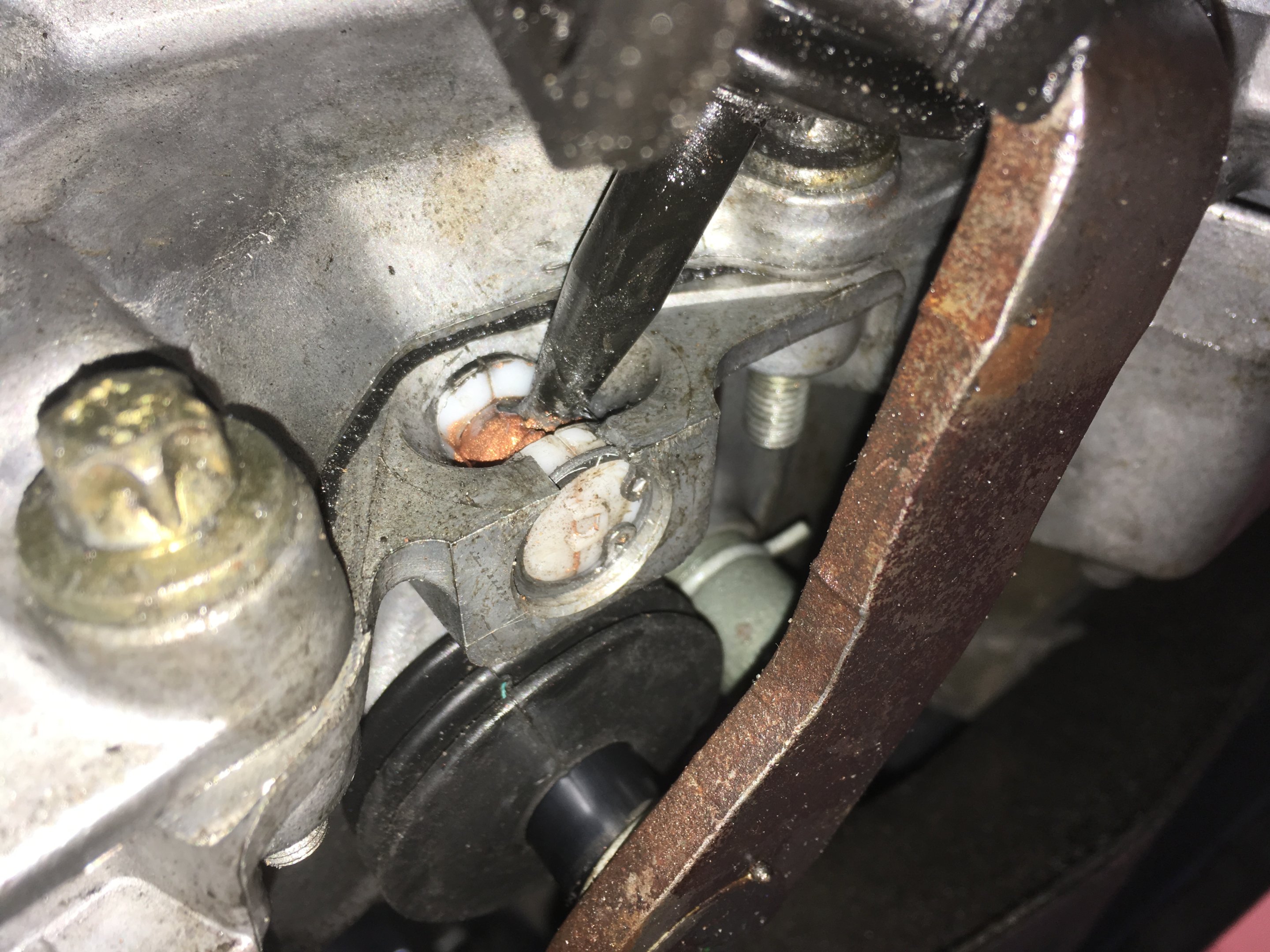

The gear change was a bit vague at Aintree so I have fitted a new bush at the gearbox end to tighten it up and changed the oil and filter.
As I have finished my season it's now SORN whilst I decide what to do next year.i would like to go back into modified but it's too expensive at the moment so it may be up for sale over the next few months.
Here's the bush I changed
