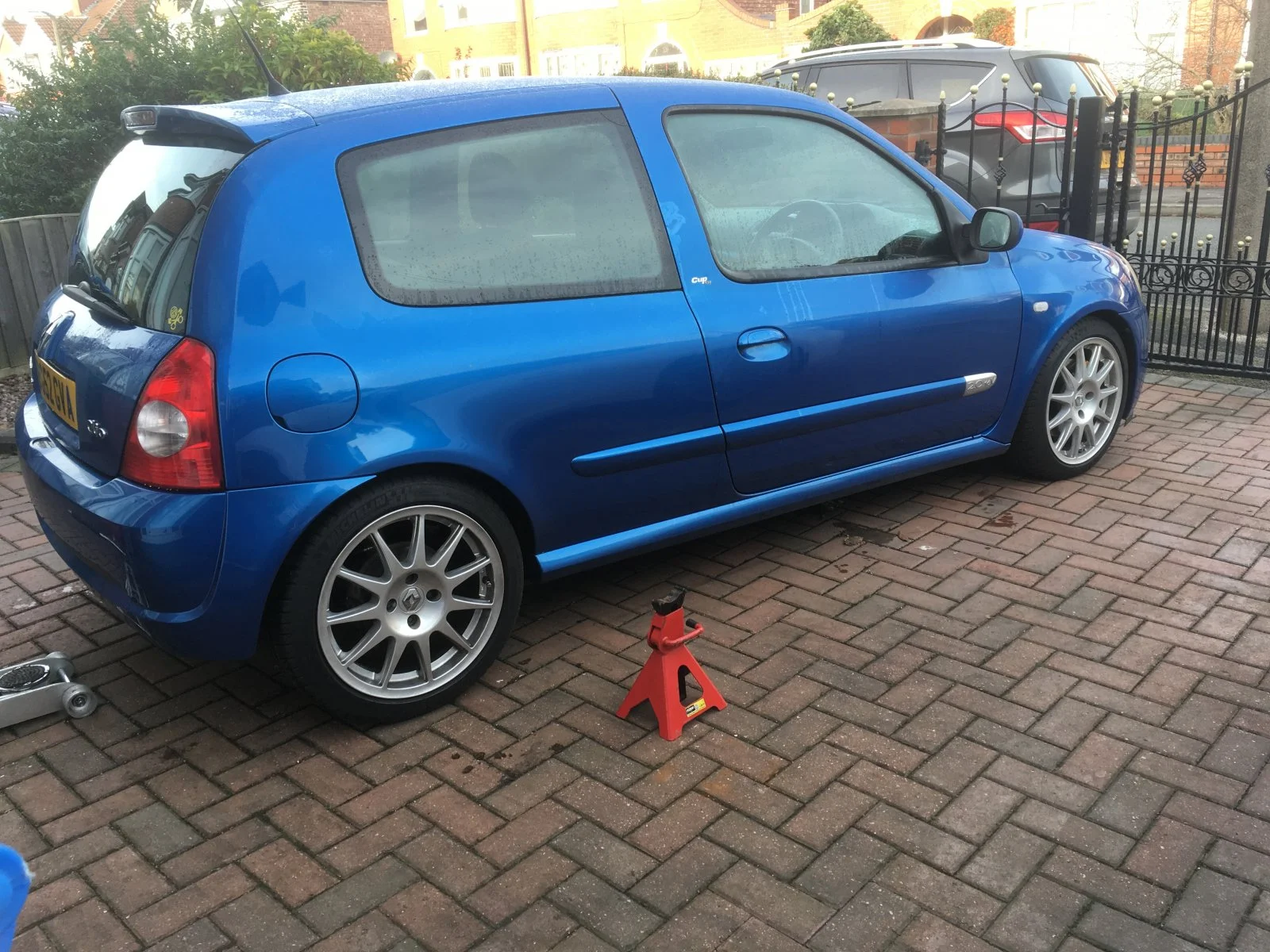

Parts that I have removed are 2118s (already sold) B14's , ktec stealth exhaust, decat, APD inlets.
So here's what I have bought so far Turini's and nearly new dampers and new wheels bolts from another we'll know Cup @cs_dave also picked up some inlets and cup springs and standard back box on my way home from Dave's.
Spent a few £££ at @renaultpartsdirect including a service kit,exhaust mounts,rear discs and pads, track rod ends ( more about these later) and top mounts.

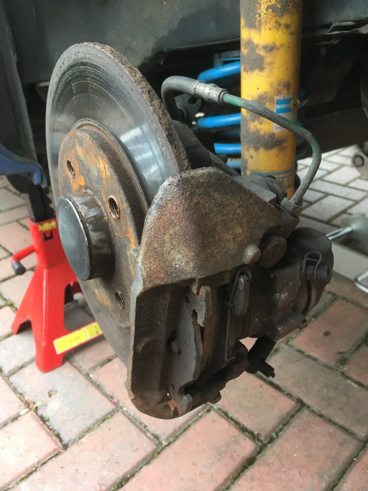

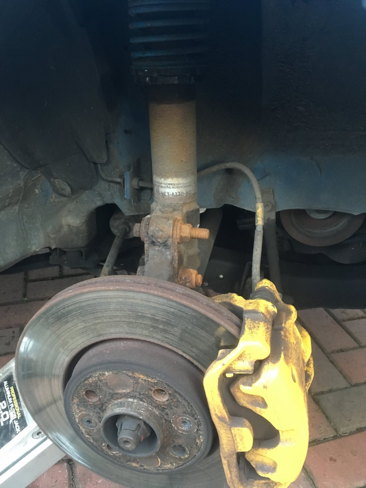

So today I set about changing the suspension over and doing the rear brakes.

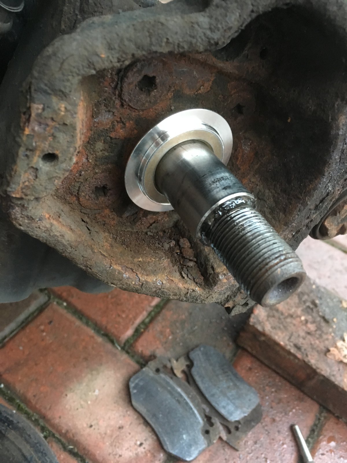

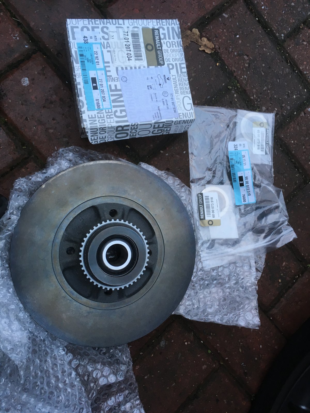

Here are a few pictures of the rear discs etc as you can see the black grease and missing clips
As I had bought new a new disc and pad kit I thought the washers were included but weren't so I will have to order a couple along with the missing clips. So it all went back on after freeing off the hand brake and sliders.I fitted the standard springs and shocks and moved on to the front.

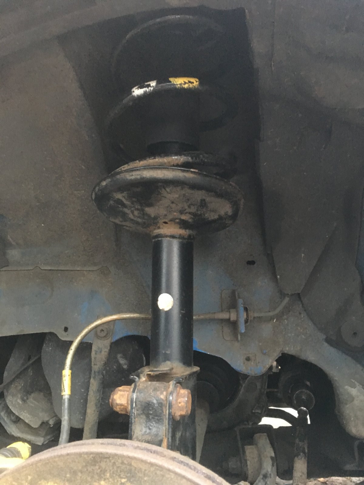

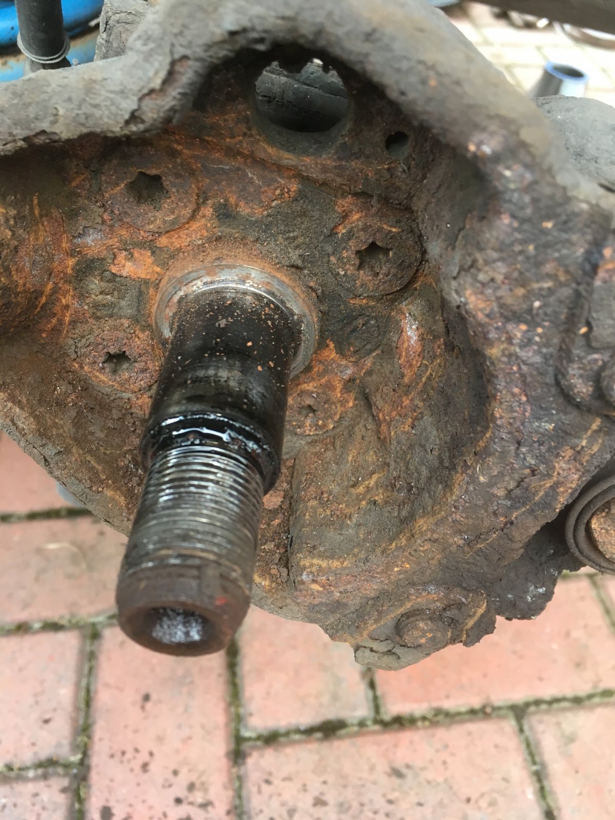

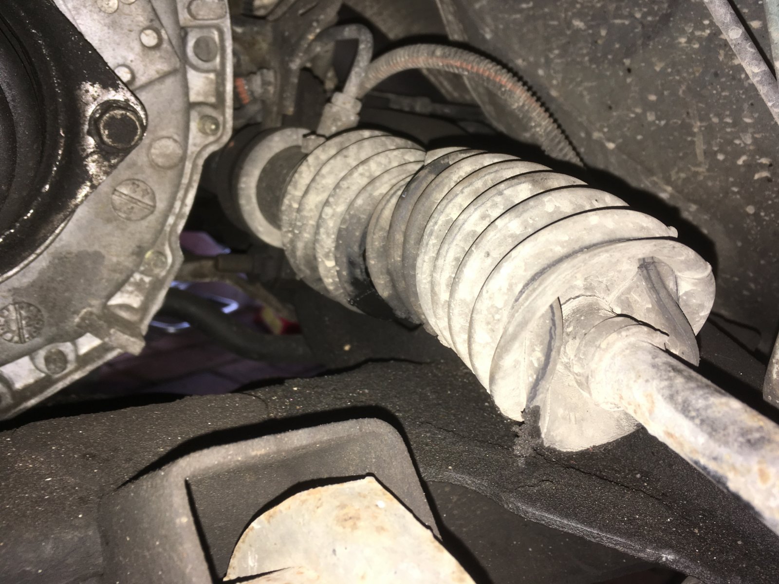

So on to the front, I removed the wheels, hub bolts and removed the track rods ends to find some play in the inner steering arms ! so now I need to replace those as well as the top mounts, TRE and bottom ball joints. Its starting to add up the ££ already.
There seems to be no definitive answer on which are the right inner arms and as the gators are split I will get them from renaultpartsdirect I also will need a tool to remove them.I have been told these are 32mm so will get one of these from eBay.
http://www.ebay.co.uk/itm/Steering-...322979?hash=item2cb7aff4a3:g:X~0AAOSwpDdVQnbS
I had to cut one of the TRE off as I couldn't get the nut off,quite why the genuine TRE don't include a nut is strange ? anyway a few more images for you.

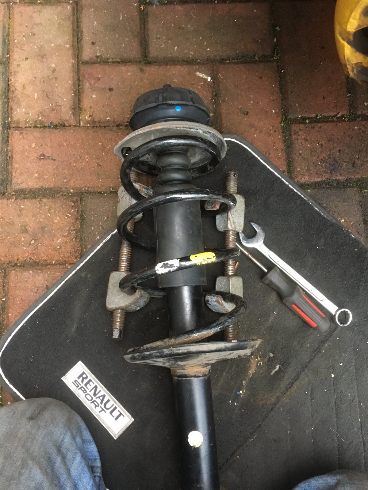

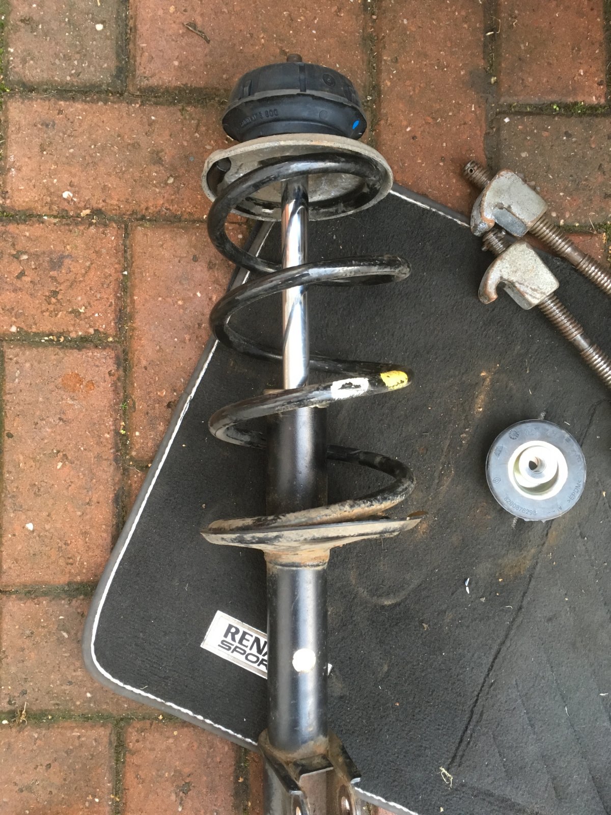

Managed a couple of hours today so fitted the front dampers and springs with new top bearings and bump rubbers.
Note the obvious mistake on first fit lol
So second time around correctly built up and fitted ! Even managed without spring compressors to fit them back to the arms. Need a couple of new bolts as the top ones are passed their best.
Then as it was getting dark I moved on to the rear discs. I bought new spacers as the originals were missing , I've ordered a new brake fitting kit that's not arrived in time so just assembled the near side for now.
