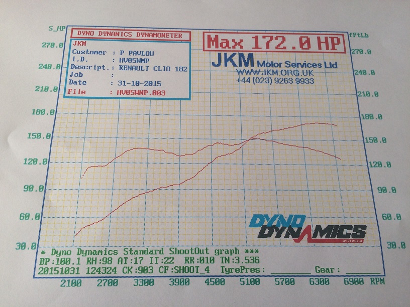

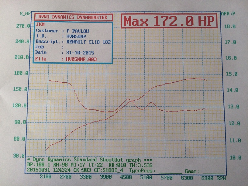

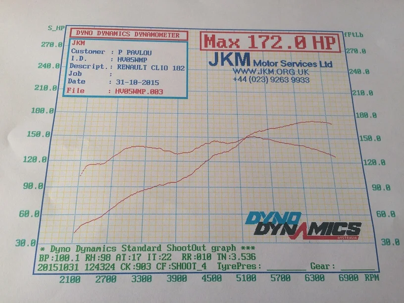

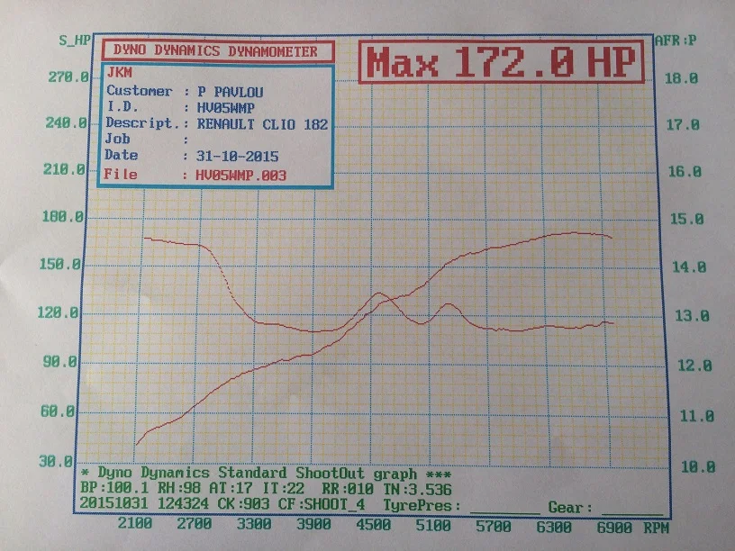

I'm back from dyno. Can i ask from the people hat they can extract useful info from the graphs to tell my what they think?
Graph 1 - Power/Torque
Graph 2 - Power/AFR
Graphs

Shove some injector cleaner through it and get it remapped.
172 is a really good number for a standard car :up::up:
I'm going to say it's already been mapped looking st the fuelling
That's why I asked as the AFR doesn't look stock to me.
I'd agree, mine made 173 at Surrey RR with a remap.
I cant comment. the only that i can say is that the guy that i bought it from he didn't mention anything about remap. i still have his original advert. The owner before him was a female and had it from new.
