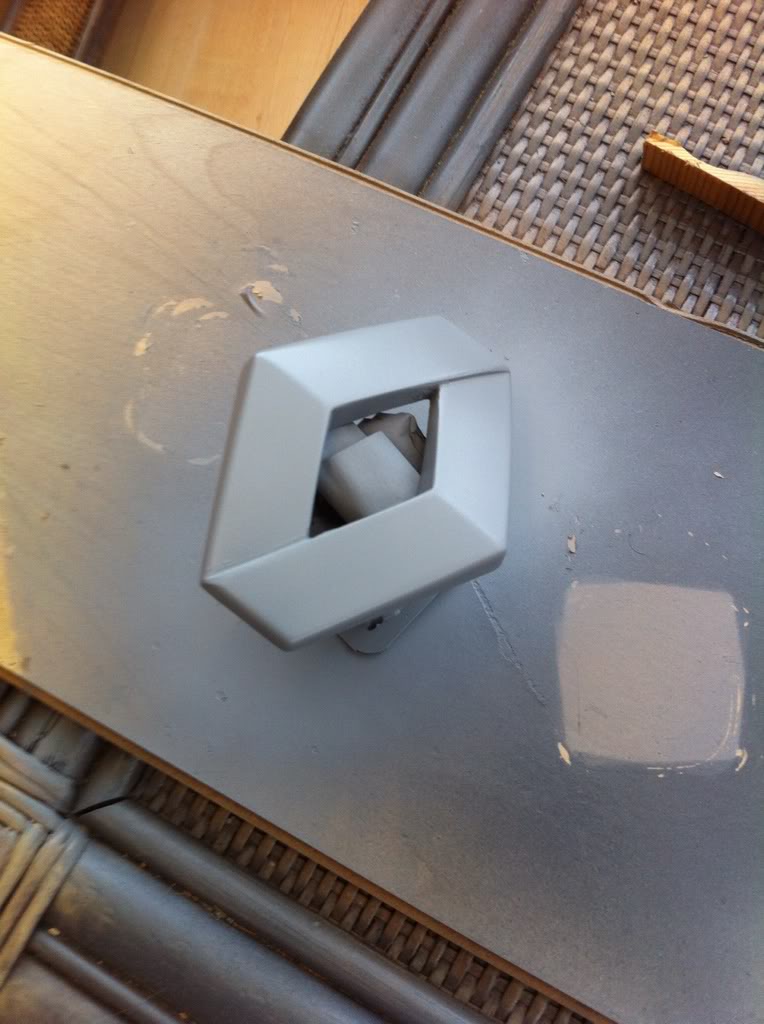

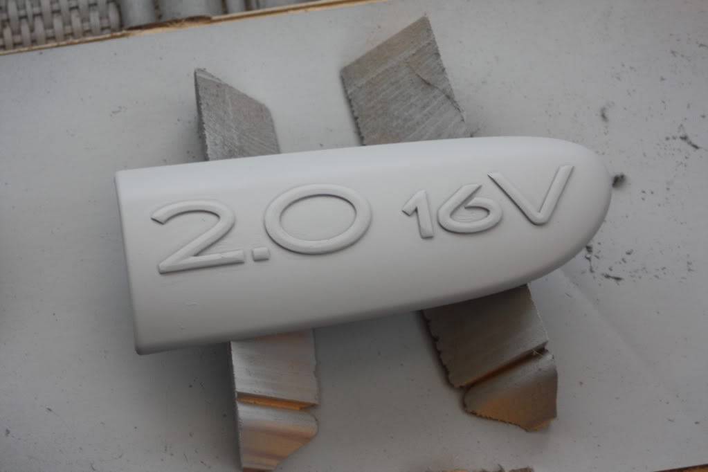

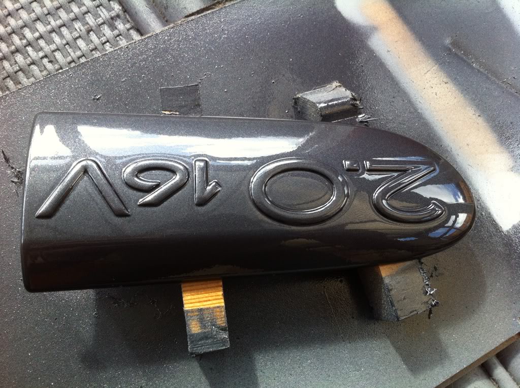

My 1st attempt at spraying bullets, badge and gear knob insert
  Inferno 225 cup
Thought I'd post up and thread of what I've done,
.Sanded down using various grit paper
.primed using grey primer
.sprayed using Peugeot steel grey.
I must say I'm over the moon with the turn out.
Heres the pics
C+C Welcome
Hope you like
Dr HMS Derv Destroyer
  MK1DTi/vivaro/corsa

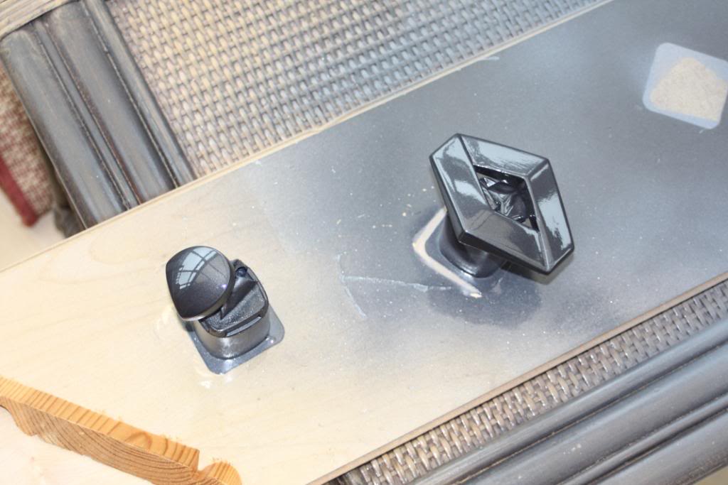

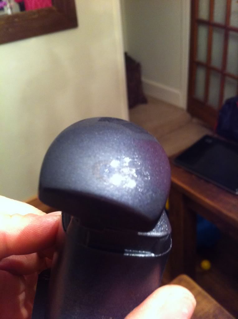

Looks good mate. Door bullet looks like you could of done a heavier coat of clear so it's a tad more smoother. BUT for a first attempt, that's a pritty decent job there :)
  Inferno 225 cup
Ive not done clear yet bud that's the 4th go over with steel grey soon as they dry I'll be doing the clear coat.

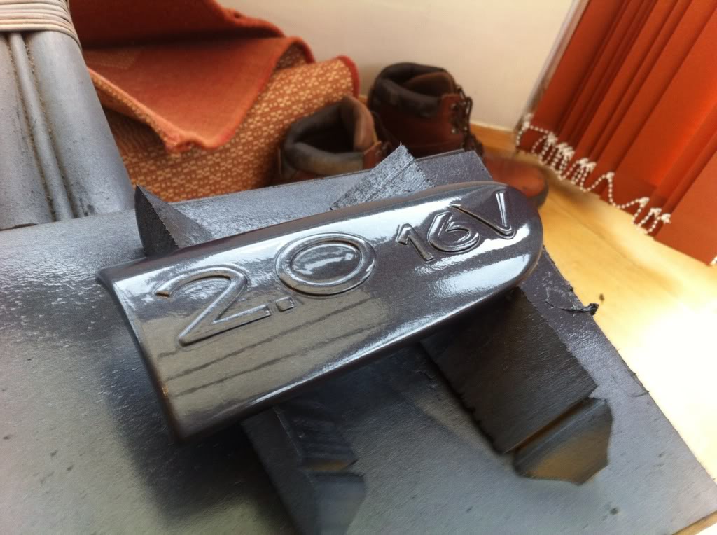

As said, needed a more even coat of lacquer, orange peel effect, but fair play for first effort!
Saying that get some 1200 wet and dry, take it back a little and polish it up.
Will look 100% better.

Since the pictures of done 2 more coats of laquer and will do a couple more depending on how they look when dry, if look the same I'll take the advice Of what you said about 1200 wet/dry and polish up.
Cheers
  MK1DTi/vivaro/corsa
I would go 1500 wet and dry seems as they are small parts tbh. But need a good 2 days to harden up before you attack it with sand paper. All depending on the finish if your happy with it and what not :)

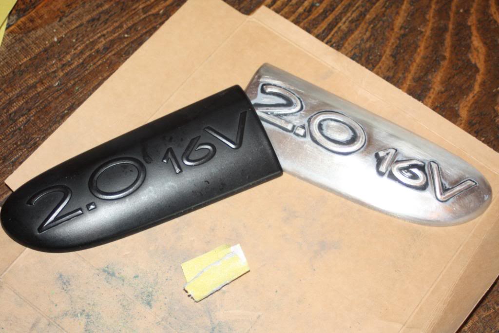

DaveDreads
I had no clue what I was doing when I started to spray my badges,
but with research on here and a few f*ck ups, I got them all finished to a standard I was happy with.
These's nothing like f*cking one of them up 3 times and having to start all over again
to teach you how it's done properly. :eek: lol
If I was to do it again i'd find it alot easier, but I doubt i'd get a better finish than i've got now tbh.

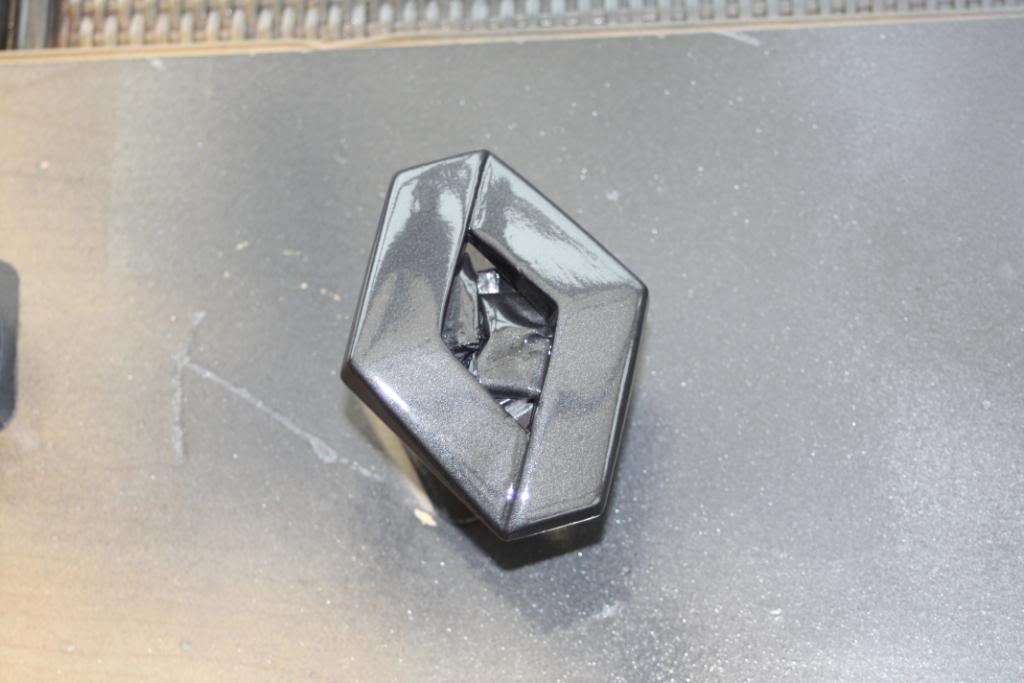

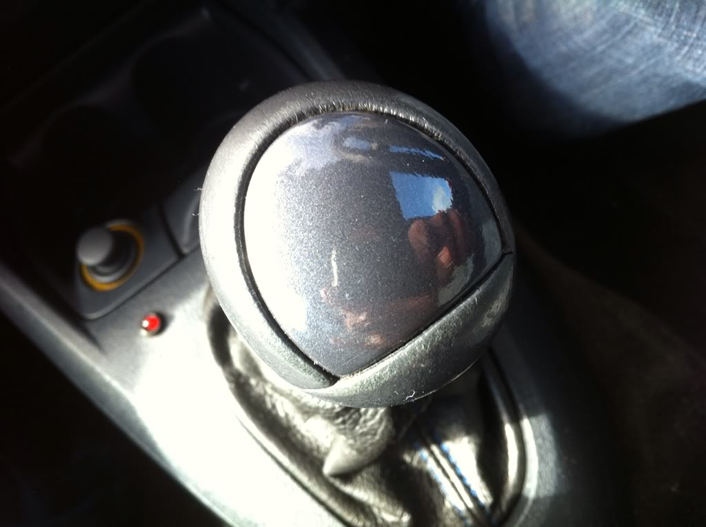

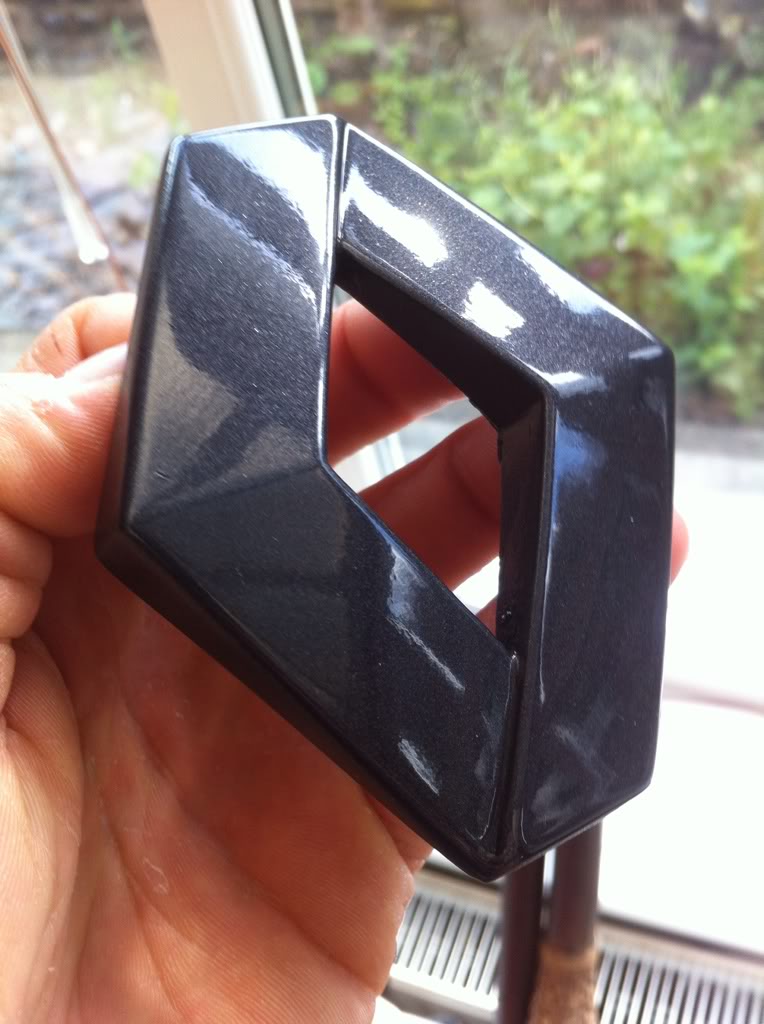

Right then, I did a last cost o laquer this morning and this is the finish on the diamond and bullet.
I take some better photos with my 450d later as the I phone pics do not do any favours.....but like I said 1st attempt and a few lads advice on here and I really am impressed and want to do more things now, and will be having my wheels don't in the same colour as I love the finish.

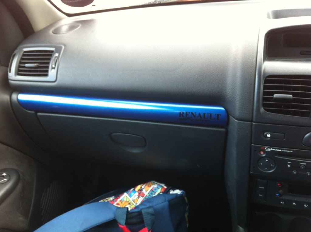

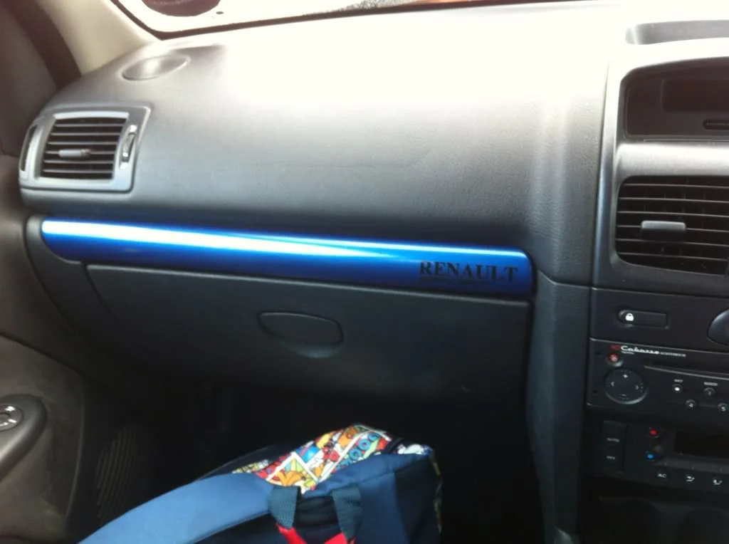

Looks like a decent job for a first attempt mate. I want to spray my badges and bullets. Not sure what colour though yet. Got a carbon wrapped diamond at minute which my mate done for me. That looks good tbh.
Good choice of colour though. You going to do the dash strips too?
  Inferno 225 cup
Thanks mate
They are already arctic blue chap, other wise they would of been done :( ha
Thrust-Rated
President of the KMAG fan club.
  F31 35d, Berlingo Na
Ah I see. Do they look good arctic blue? I want to do mine that colour. Upload a pic if you don't mind. Cheers mate.
Thrust-Rated
Cheers mate. I think that is now on the to do list.
Bullets
Dash strips
Gear insert
Keep up the good work ;)

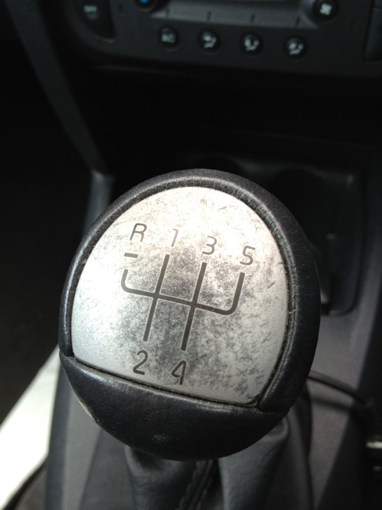

Here's my gear insert as it is now. Horrible :(
