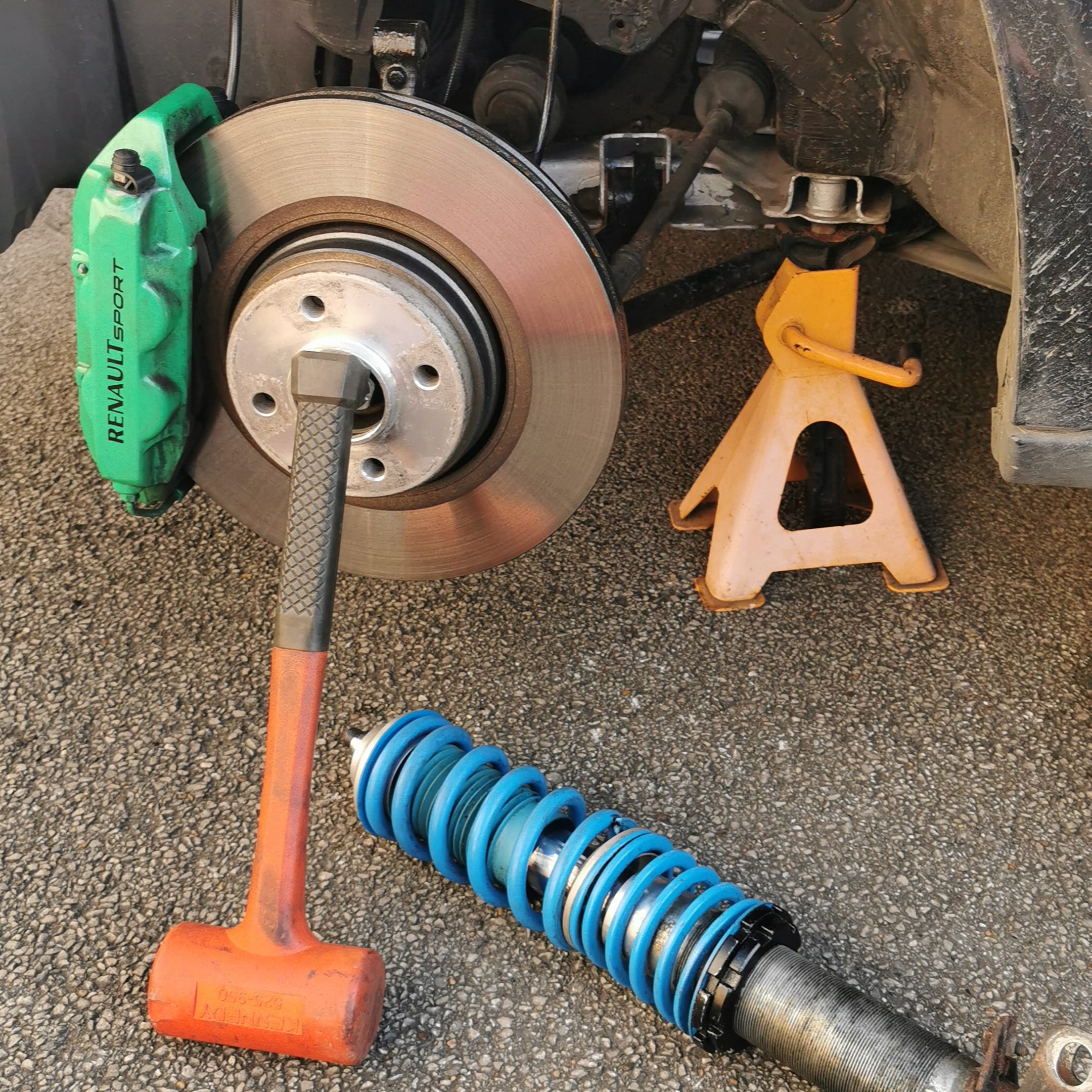

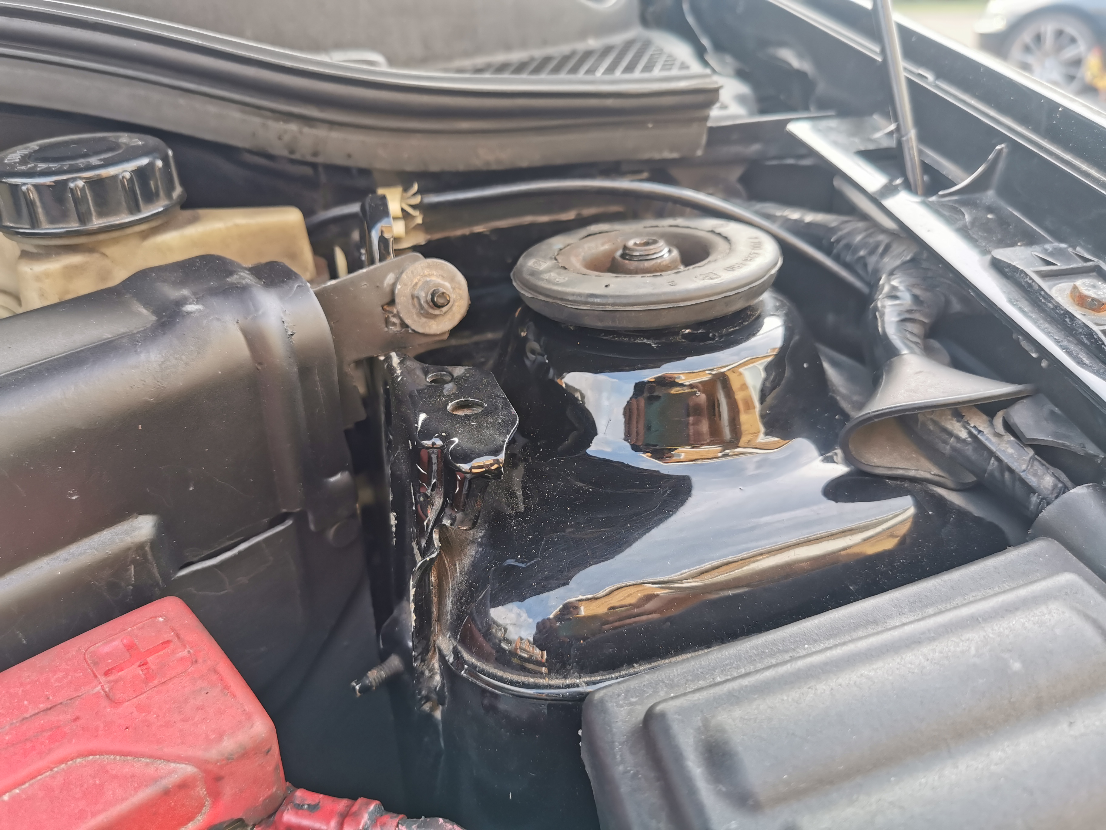

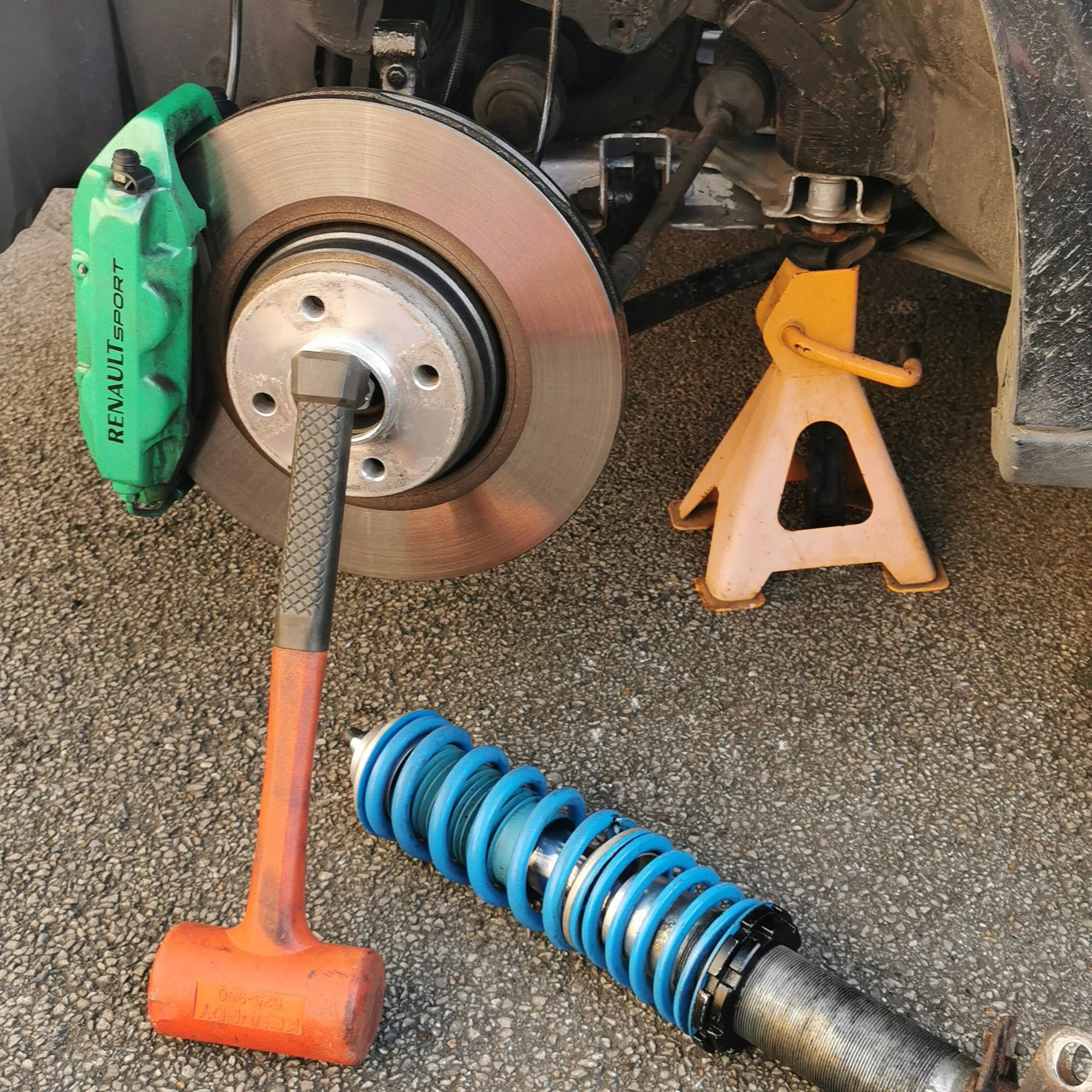

Still chasing the knock I decided to swap out the pms top mounts to check the bearings. A nice and easy job to whip the B14's off and swap the mounts to standard renault items that I had in my stash.
The pms bearings were fine but the rubber mounts will add a little bit of much needed cushioning on the god awful roads in Rotherham that I now have to travel.
With everything put back together I went to torque the wheel bolts and the passenger side wheel moved a bit, and there was the clunk! There was about 10mm of movement back and forth but I couldn't seen what was moving. When I came out with the matches the neighbour was out and asked what I was doing so I showed him and he kindly had a look under the car while I pushed the wheel and quickly spotted the problem, the ball joint was loose on the wishbone. This wasn't evident the other week when I had the wheels off and spanner checked everything and the knocking only started after I had the alignment done, but they wouldn't undo the ball joint surely?
The rubber mounts are bloody ugly things but after a quick blast on some country roads I can confirm that my knocking noise is gone, the car still steers straight and nasty bumps don't sound like I've just driven into a wall like they did through the pms mounts! Hopefully it will just work for a while now. The belts are still due though.

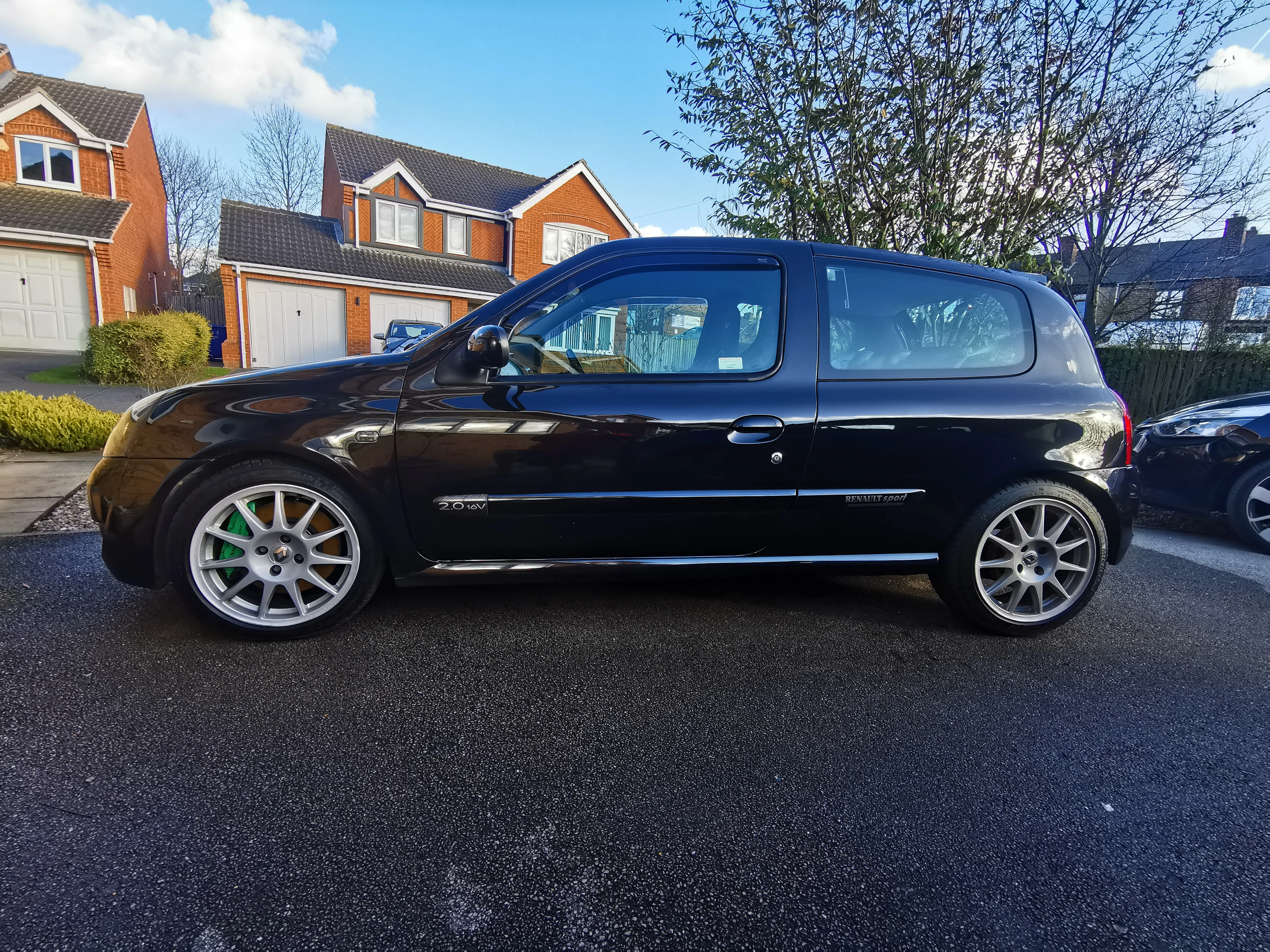

Just to prove that it does work and can get me to places. It was mucky again by the time we got there.
And it refused to start when I wanted to got home too 🙄. Bit of wiggling sorted it though. So glad I wasn't in a field full of car enthusiasts at the time. 🤦

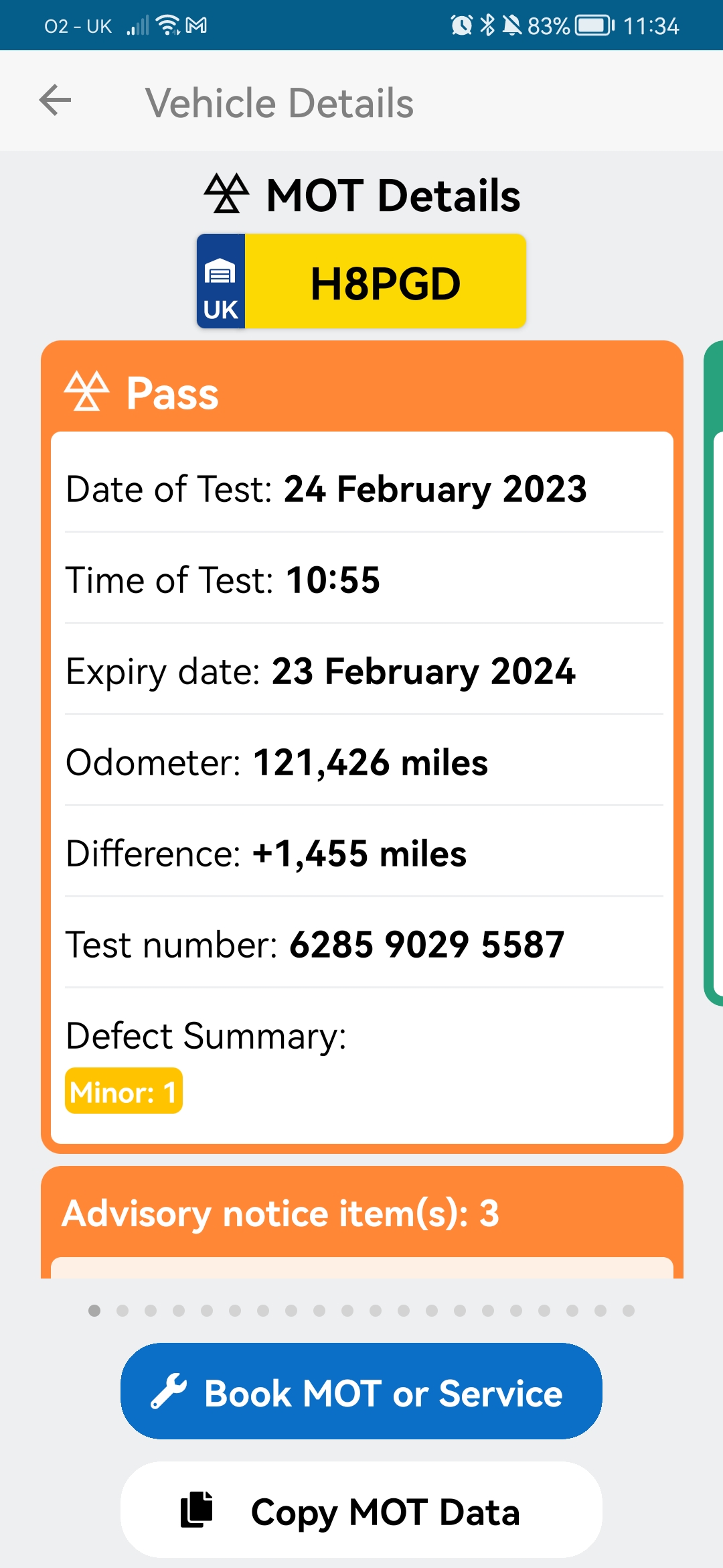

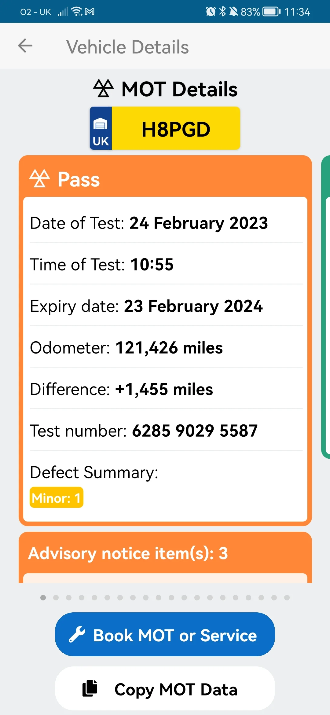

Mot passed today. My tester had a visit from DVSA so no cheating. After 20 mins of revving the emissions actually passed, now that's a first 😂.
Advisory for cup brake light not working, misting on the headlamp and slight damage to the windscreen (a 6" long crack😆). Not bad for its first voyage after been stood nearly a year. Its going to be my daily for a while until the 200 is fixed and then one needs to be sold, or turned into a track car🤔.
