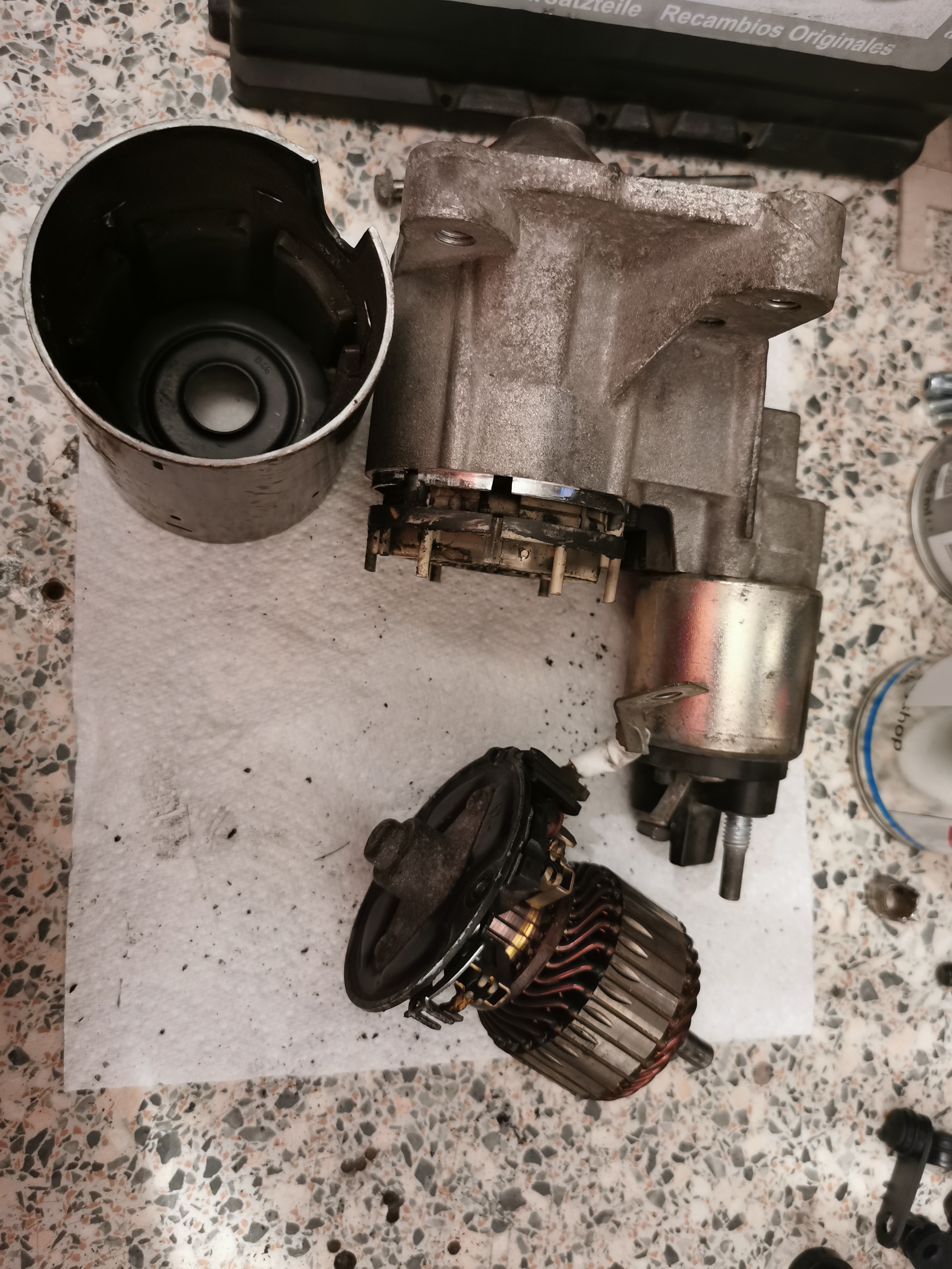

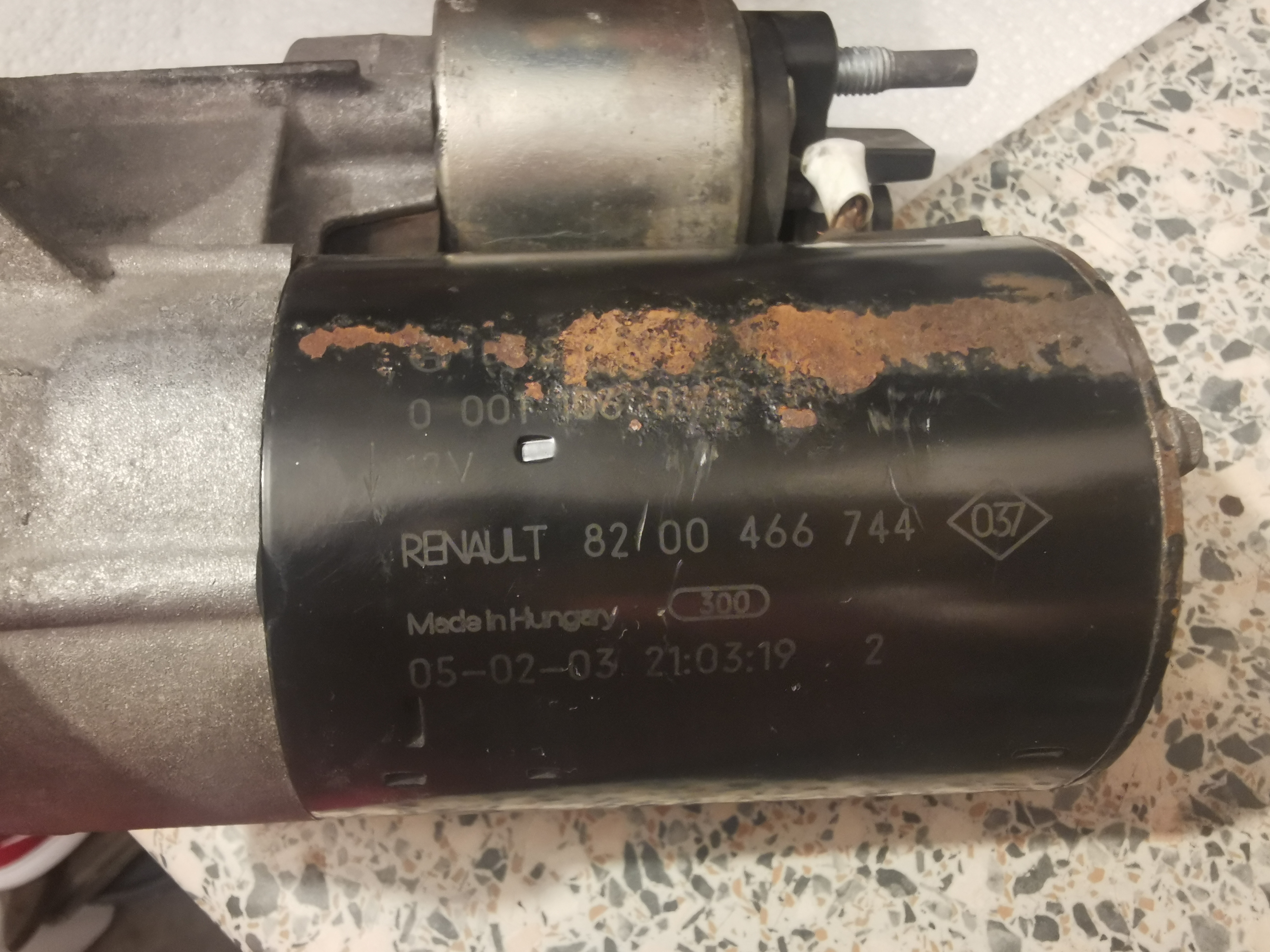

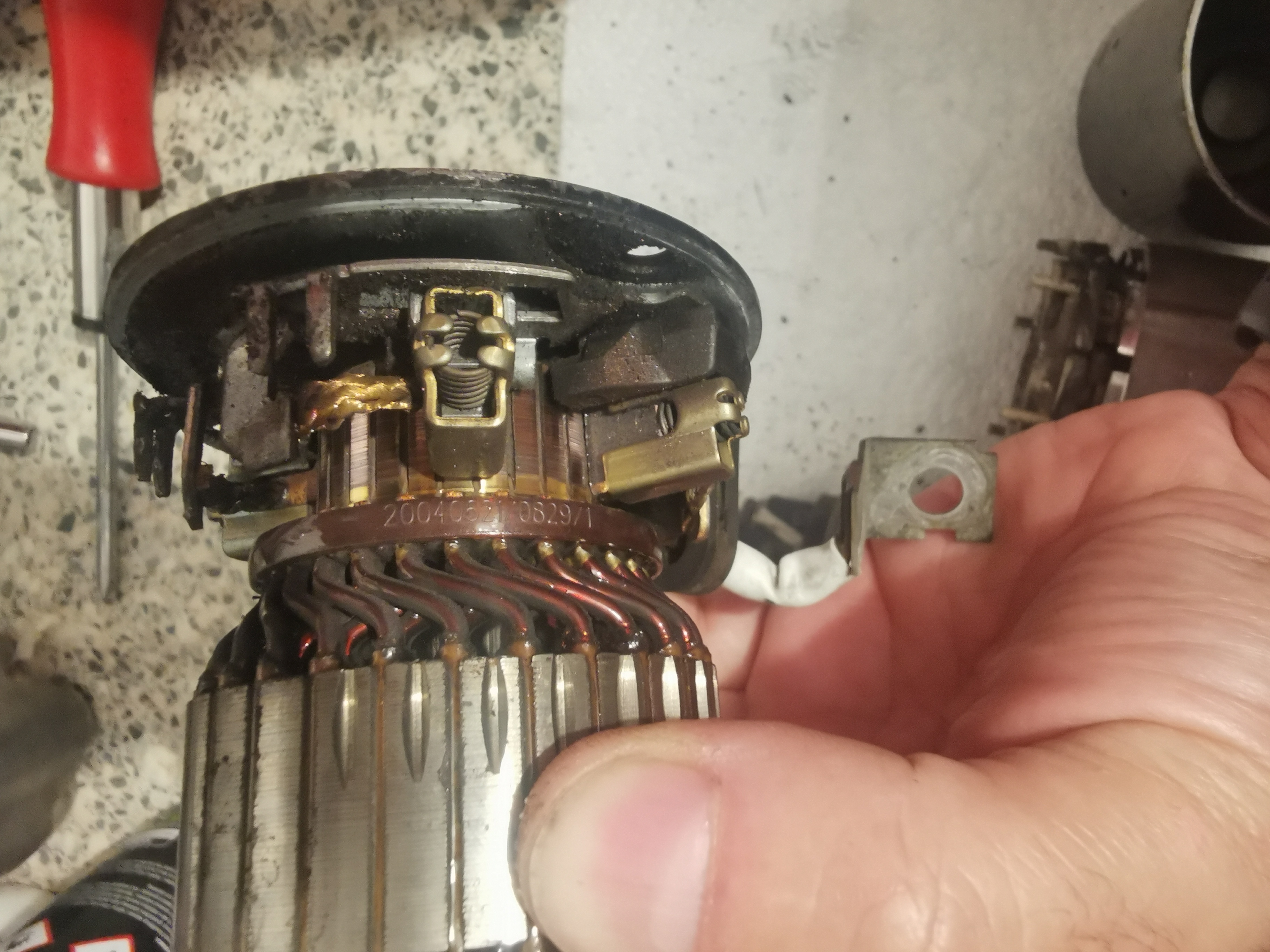

Old one seems a bit slower maybe? I remembered seeing a post on here about replacing the brushes in the starter so looked into that. Well that particular post wasn't quite accurate in saying its a bosch 110 series starter.
Above the Renault part no is the bosch number, in the rust. They all start 0001 and it's the next 3 numbers that designate what series it is with the last 3 numbers designating the fitment. So it's clearly a 106 not 110.

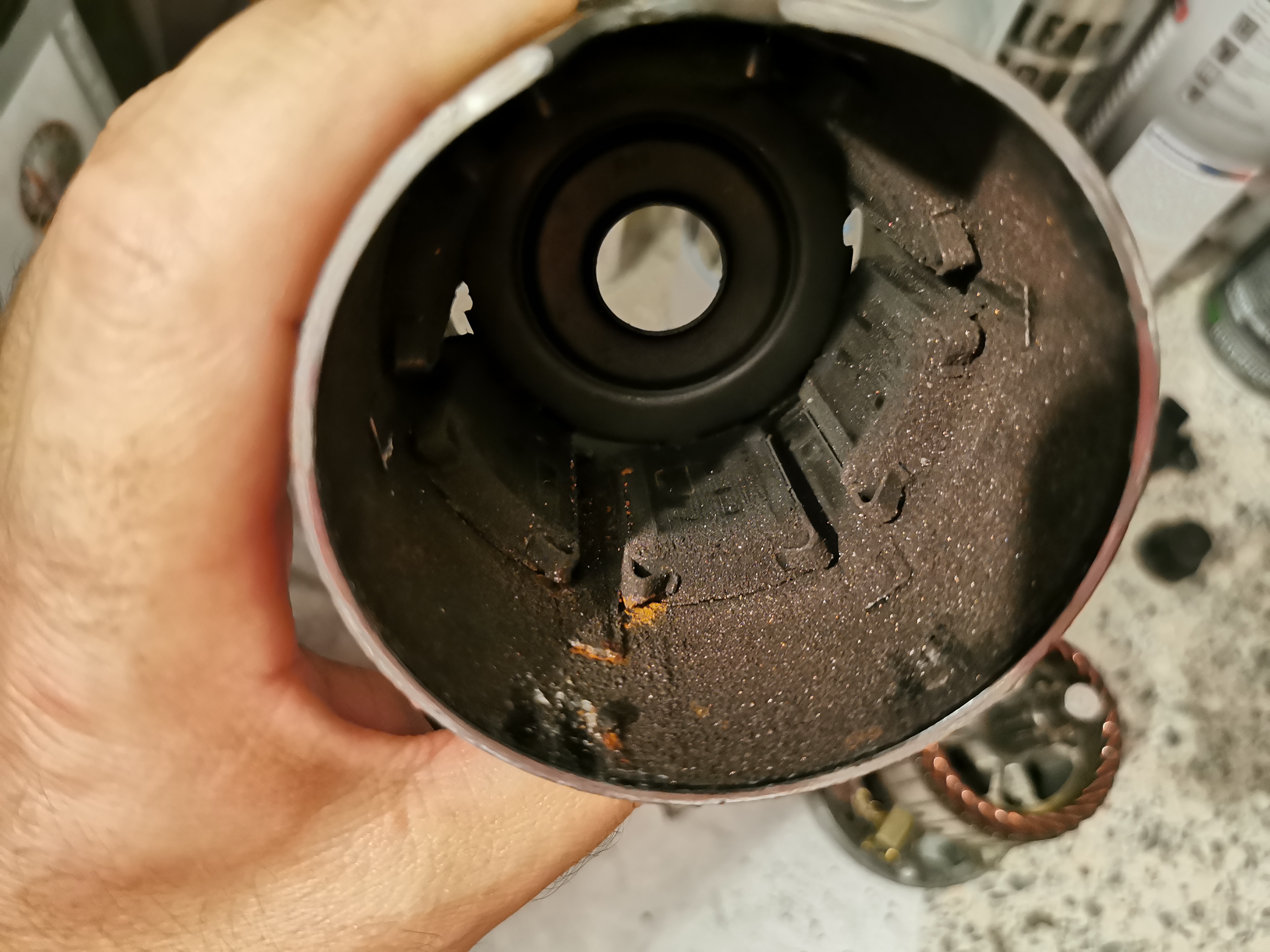

After watching a couple of YouTube vids on refurbishing a starter I pulled.it apart to see what's what.
Thers lots of crap inside it that can only be wear. But the brushes have loads of life left.
So I guess I'll clean it up and reassemble it and see if it spins any better. I might even refit it and test it out. Should be pretty easy now the cars in thousands of bits.

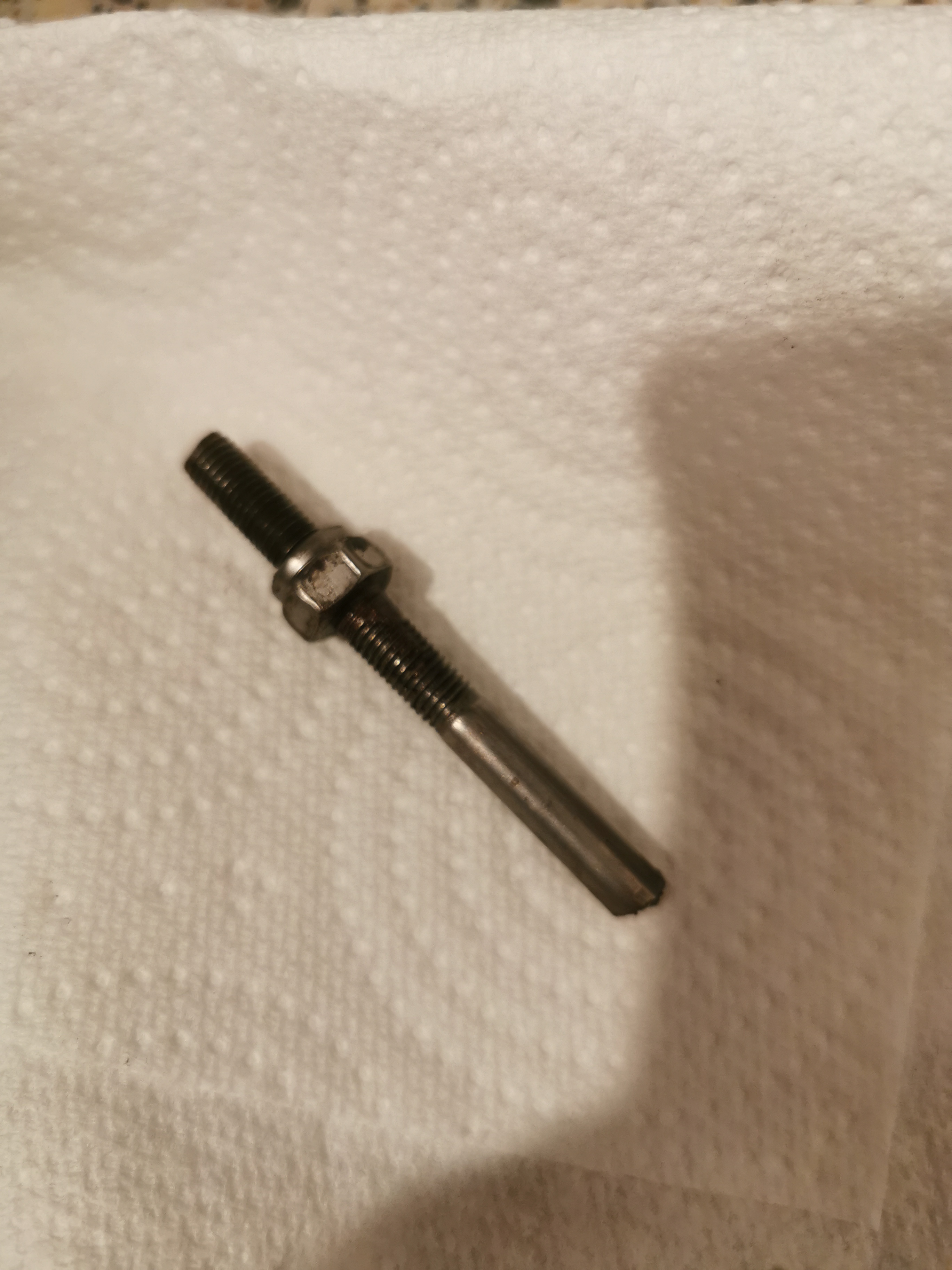

Put the front wings back on this morning and had a check through the bags of bolts I have left. There's 1 nut and bolt that I can't find a home for! I labeled it as air con pipe at gearbox end, but I'll be buggered if I can find anywhere a nut and bolt would fit near any pipes🤔.

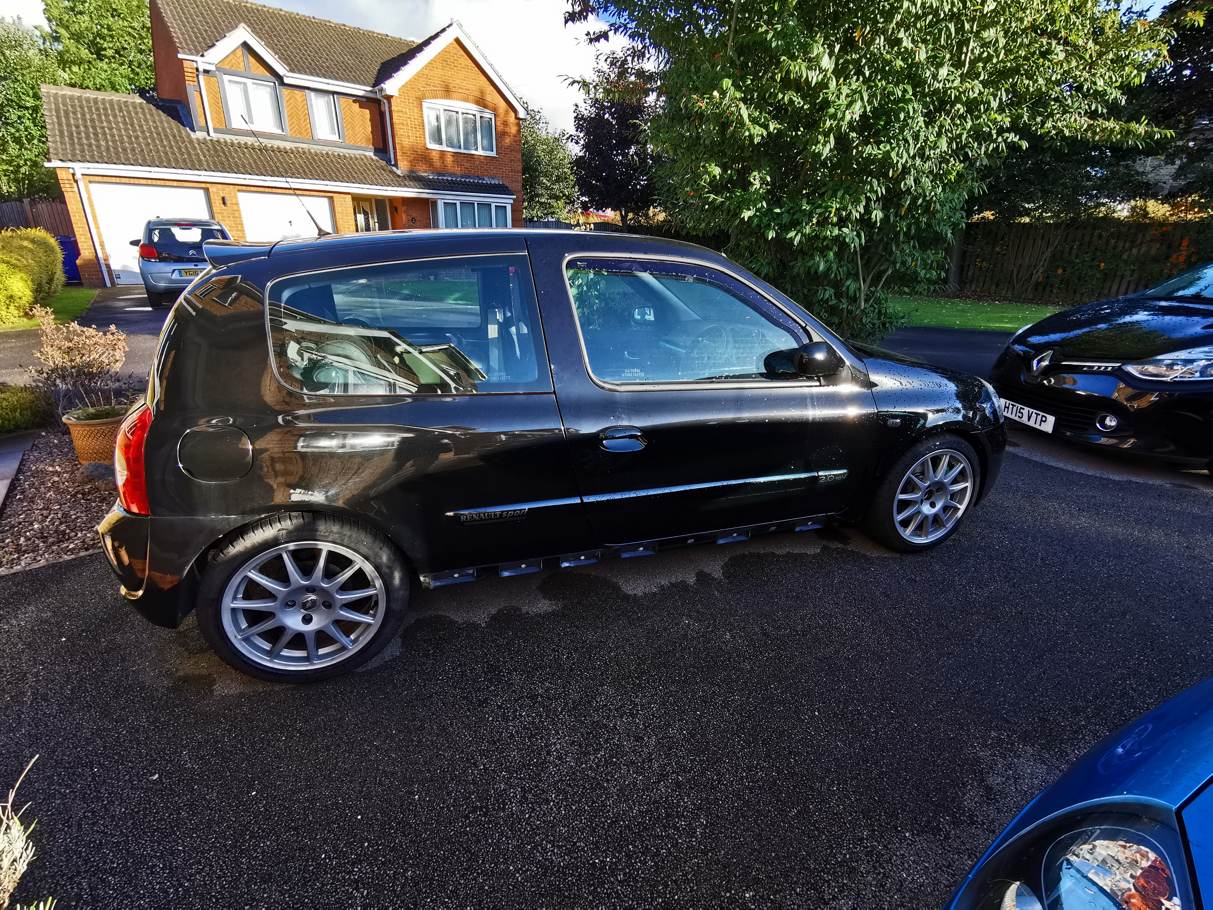

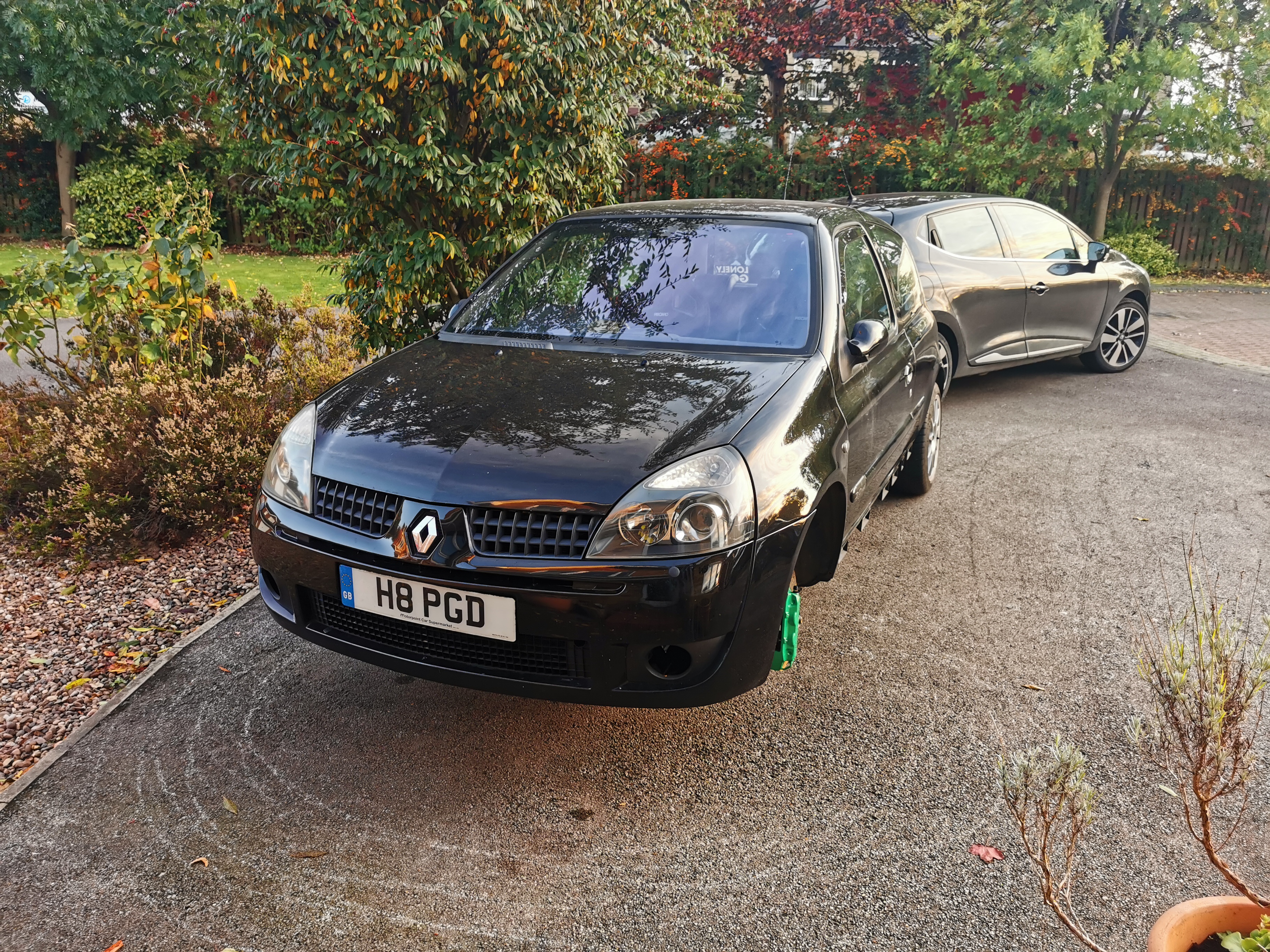

Picture taken today, the day the MOT ran out! 🙄😂 Cat refitted. Those two braces that join the subframe to the chassis that I forgot to clean up and paint refitted. Arch liners and engine undertray refitted. Headlamps and bumper back on. Wheels on and touched ground for the first time in half a year. Damn I'd forgotten how low the front end was, the bonnet has been at waist height for so long😆. The handbrake was stuck on and the rear discs were pretty crusty but they freed up easily and a bit of wire brush action cleaned the discs up nicely. The rear end will need a tidy up at some point in the future as it's a crusty mess atm.

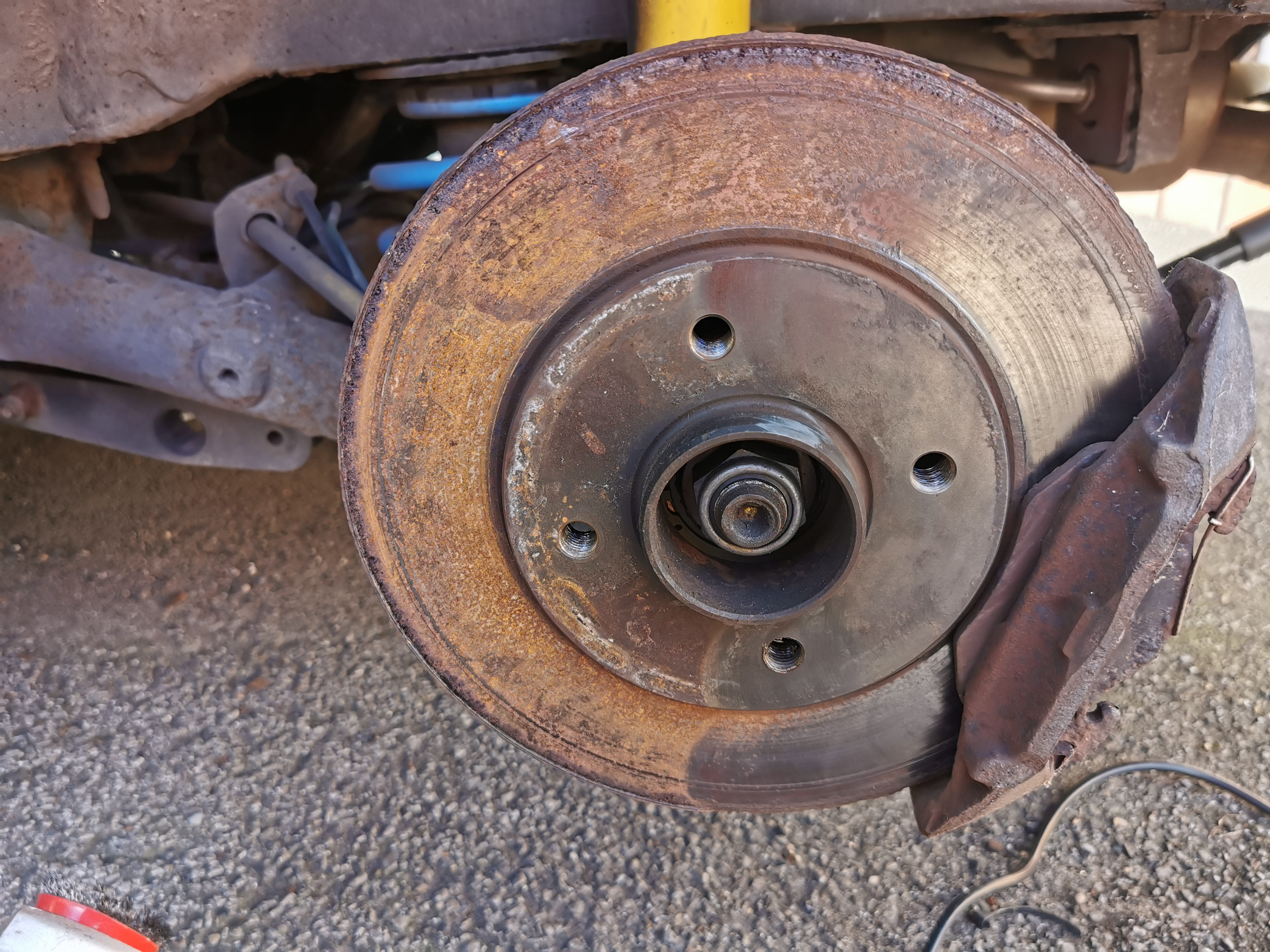

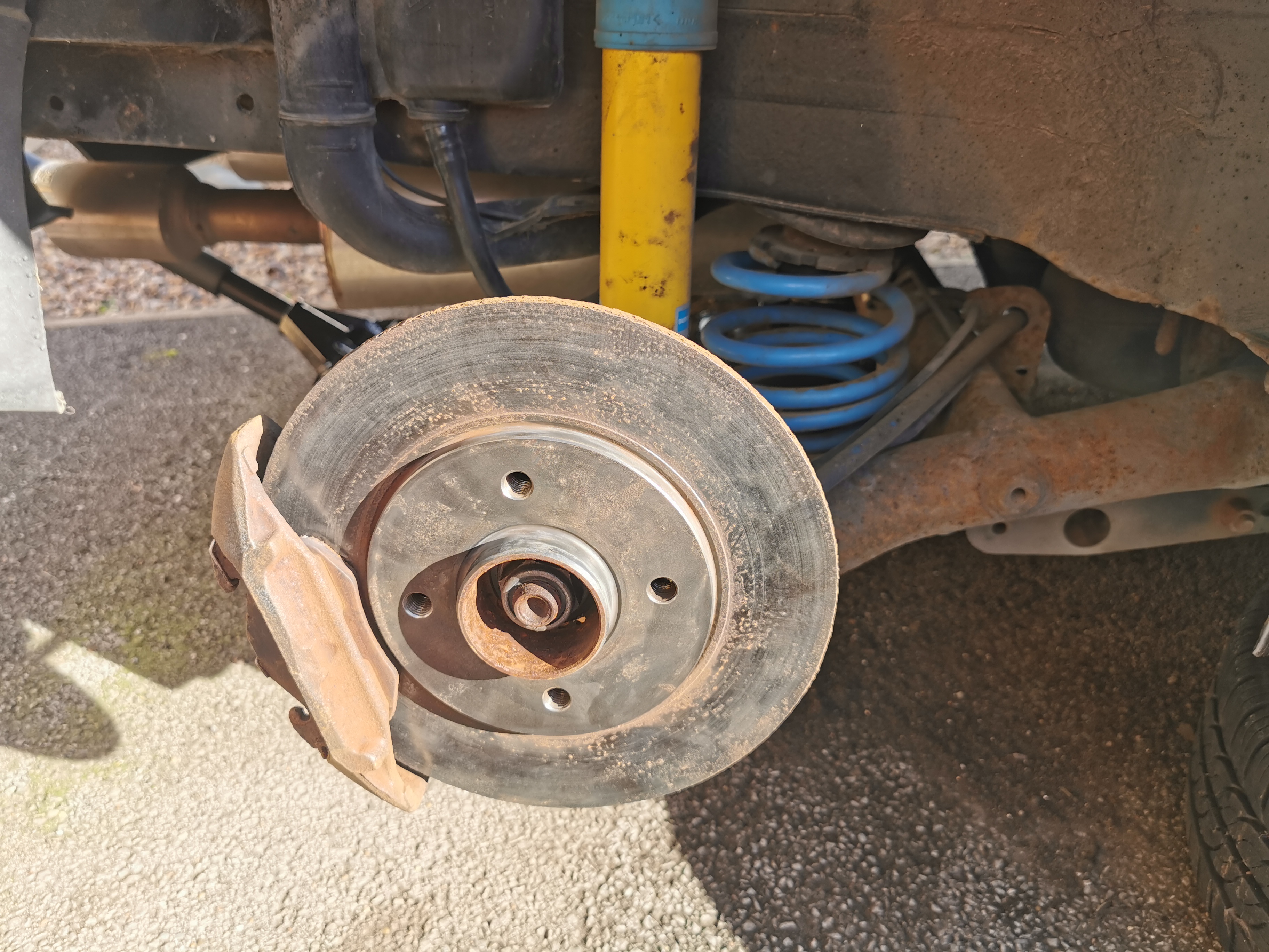

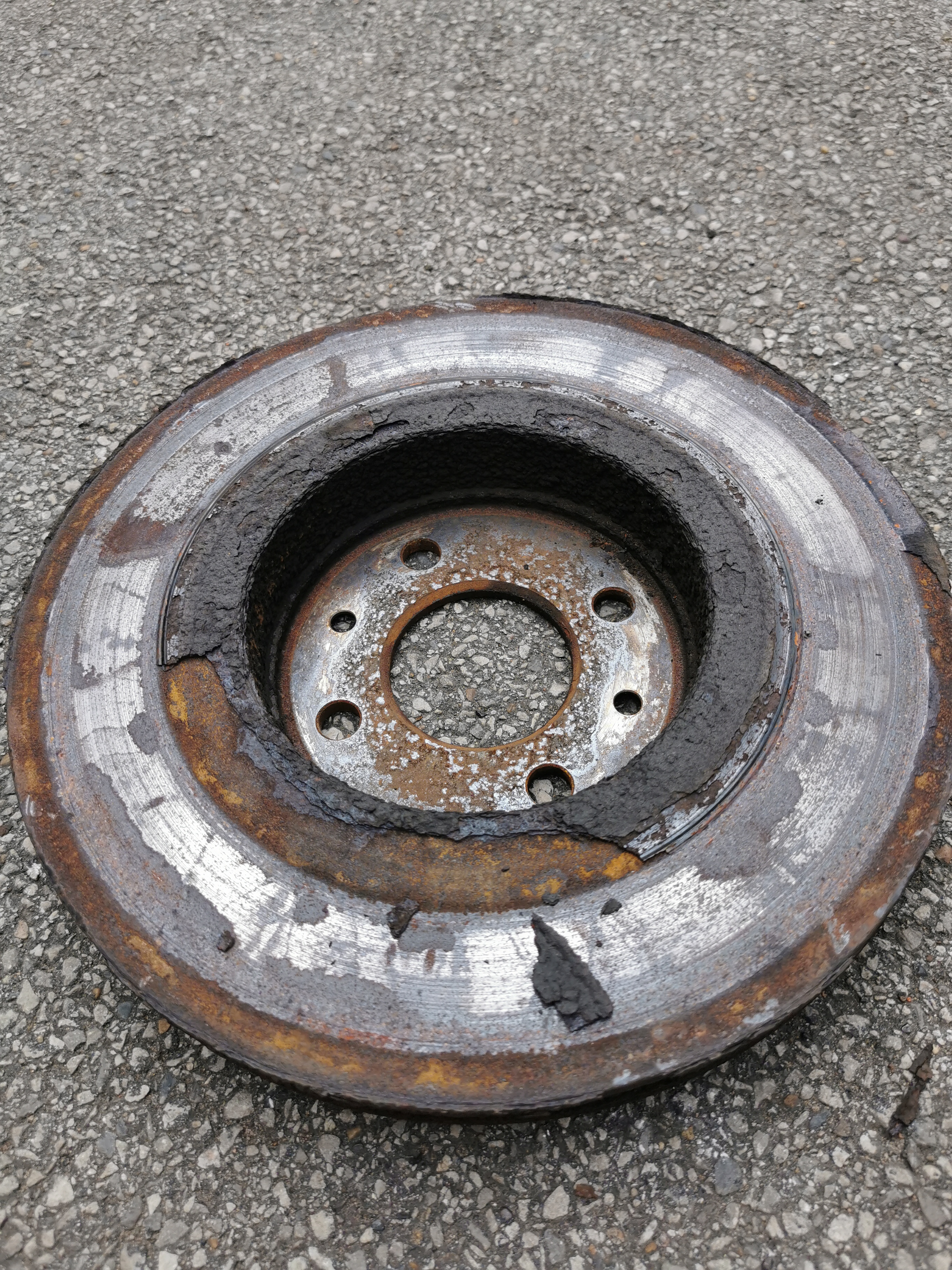

Time for a roundup of the last few weeks. When I stripped the car for the dead gearbox I discovered that the front pads were nearly dead and the discs were ready for the scrap man.

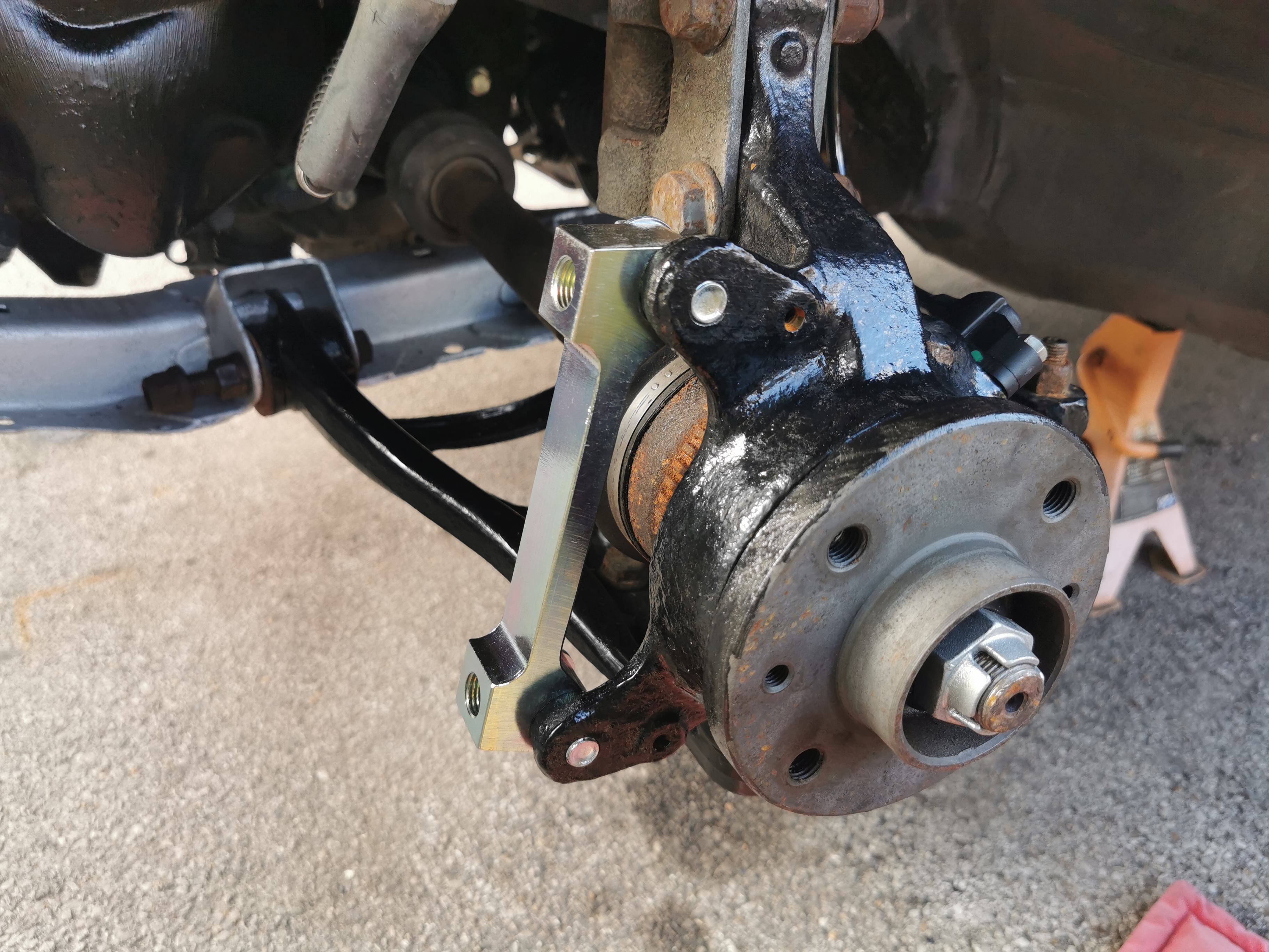

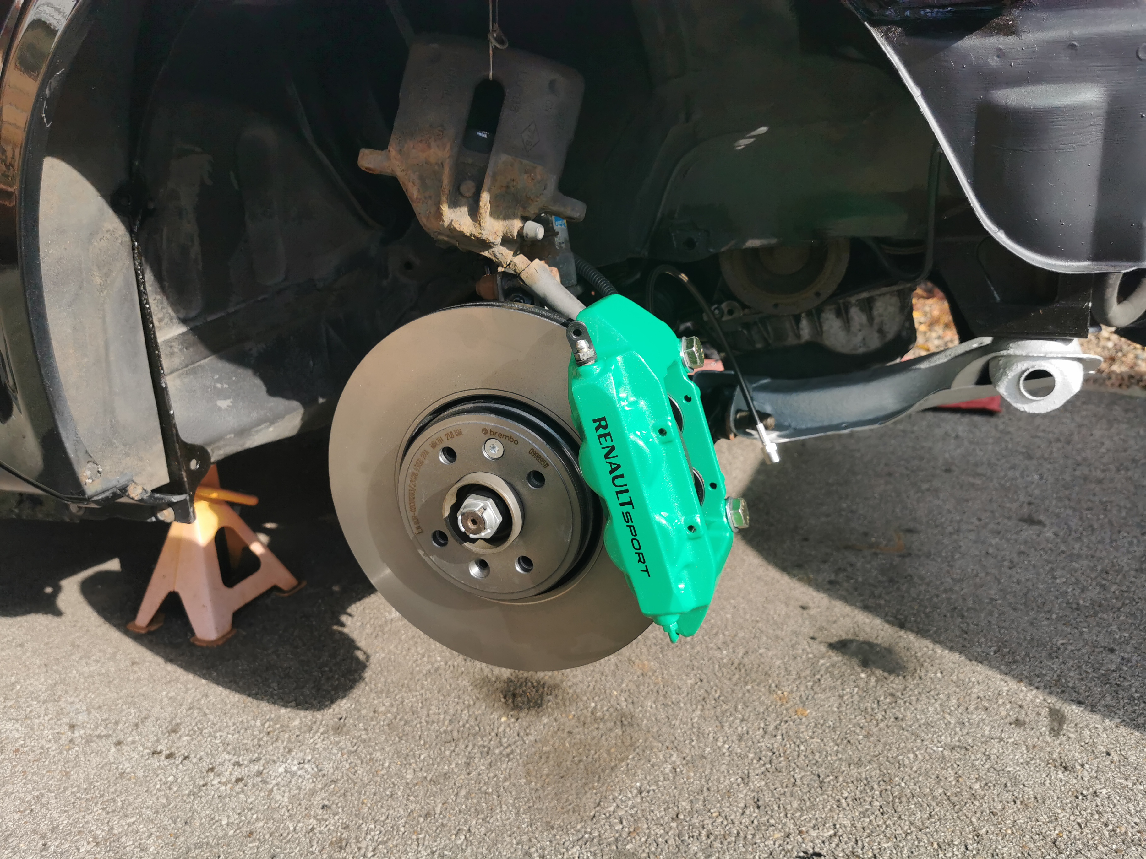

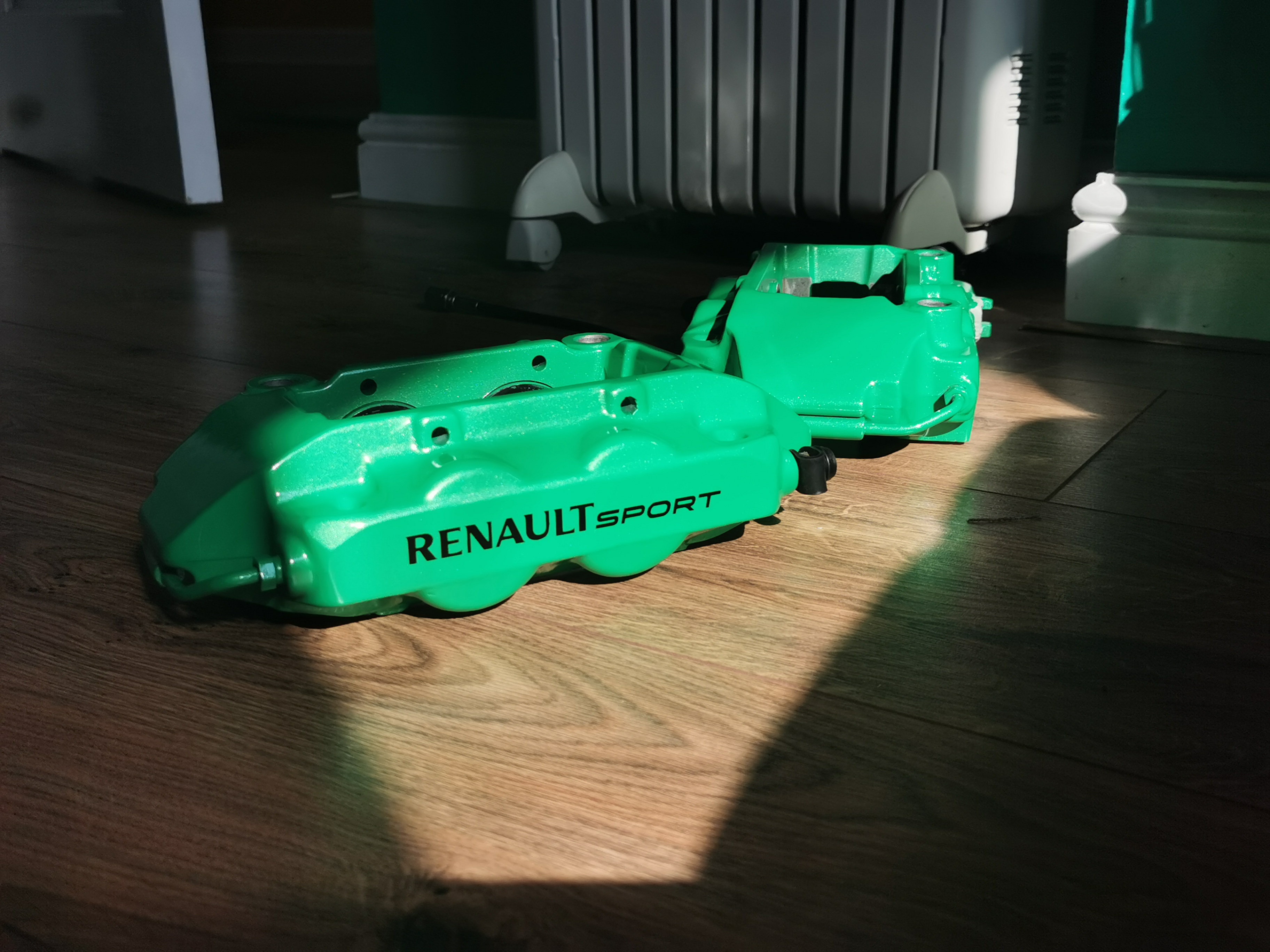

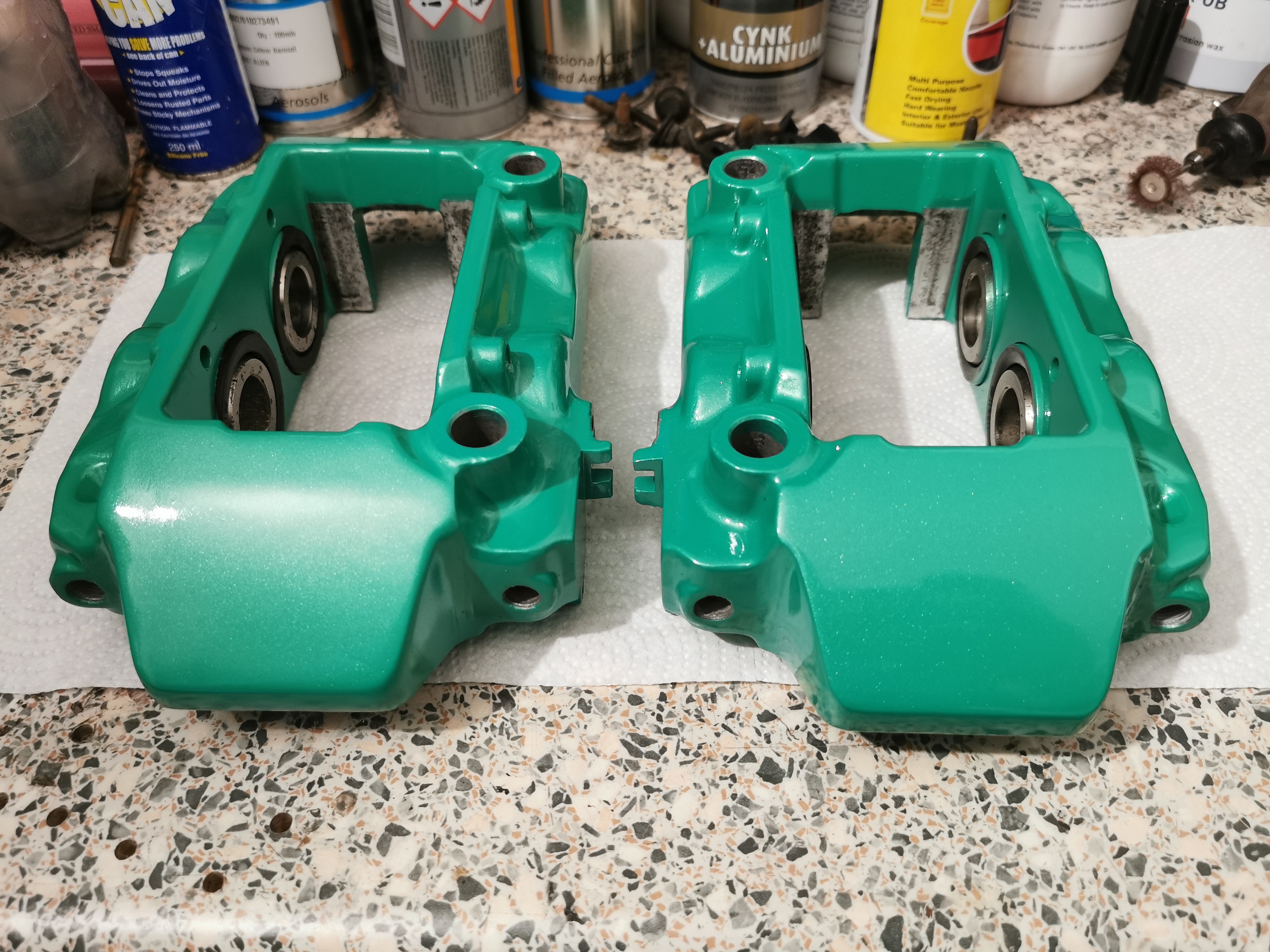

They are the only front discs the car has had on since I bought it in 2016 so they've not done bad 😆. Time for new ones then and as I've had a pair of brembo 4 pots since 2018 it was about time they were fitted. I'd stripped and prepped the calipers for paint ages ago so gave them a clean up and made them look pretty with some alien green and some high temp lacquer. Avoiding the usual brembo graphics I finished them with some period correct Renault Sport stickers. I'm sticking with the turini's so went for some 300mm discs and custom brackets as I've machined 5mm off the calipers so they can be fitted to 280mm discs if I choose to do so. Fitted them with some braided hoses from proline.

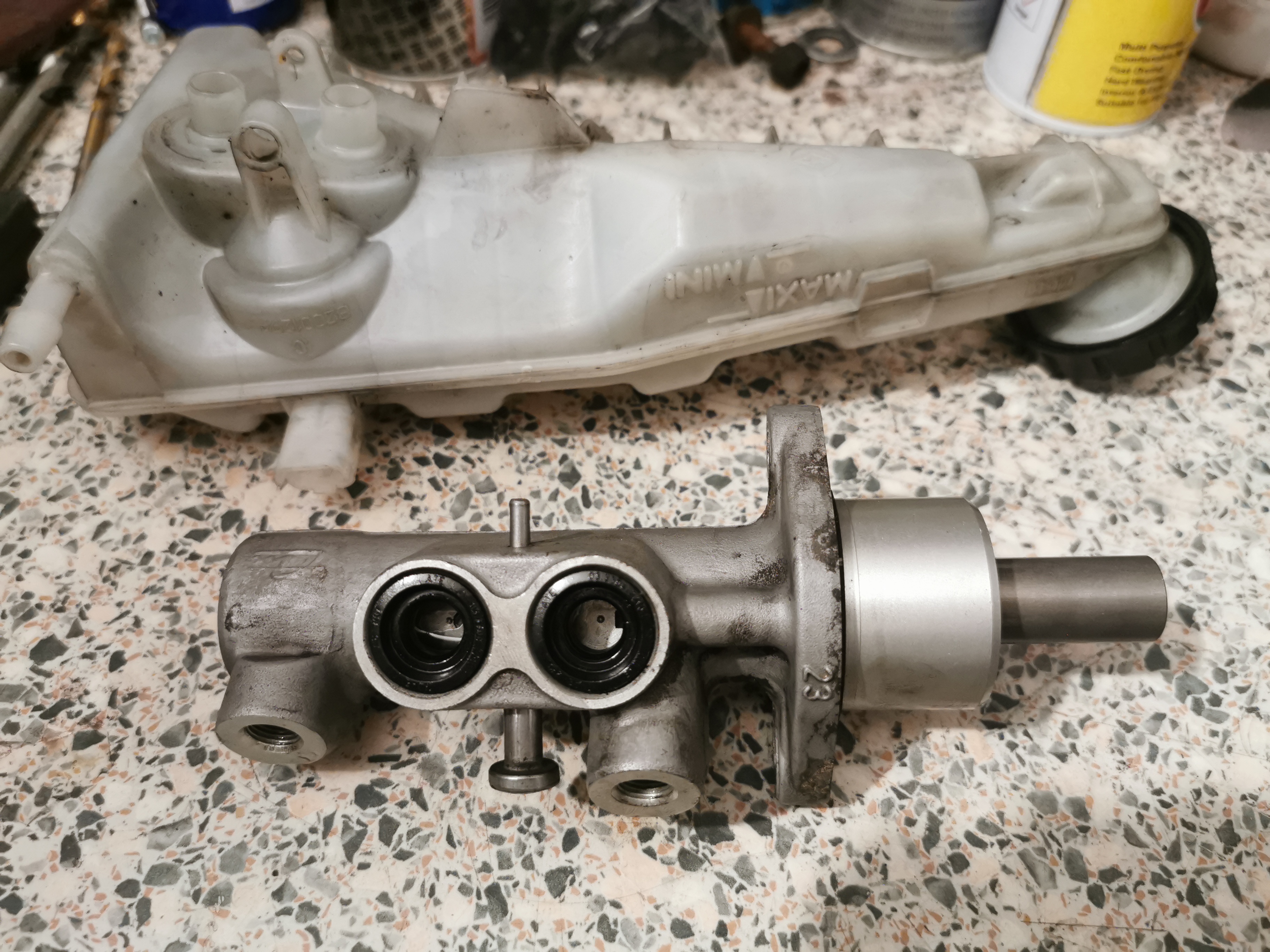

With the possibility of a dead master cylinder I decided to buy a 197 master to fit and what better opportunity than when someone else would be doing it😆. 2 hours after delivering the car I got a call saying the brakes were working after a good bleed with a pressure bleeder and someone pumping the pedal and they asked if I wanted the master swapping still? 🤔 Well as its supposed to give a better pedal feel than the original one with brembo calipers and I'd bought it already then why not? According to the Internet its a straight swap, according to my mechanic the unions were different and the 182 reservoir didn't fit either. So it's either not a 197 master I've been sold or the Internet is wrong.
Anyone I'd that? Thers no part number on it unfortunately 🤷‍♂️. At least the original one wasn't dead so it was refitted and the brakes bled up again. After a week away it was ready for me to collect. Insurance was sorted as I didn't bother renewing it when it ran out during the cars prolonged rest on axle stands and surprisingly a quote from the same company was £80 cheaper than the renewal quote 👍. With the garage only a mile away I set of walking when I got home from work, nervously wondering what it would feel like to drive it again after so long. Then I walked home again as I'd forgotten to take the reg plates with me as I'd transfered my personal reg onto it while there was no insurance admin fee to be paid🤦‍♂️. Plates fixed and I'll paid I was told that they had to bump start the car a couple of times as it refused to start, and yes it refused to start then too. They had looked into it and reckoned the starter was playing up, brilliant. I drove it home anyway. The tracking is miles out, it had no windscreen wipers or MOT or tax and it was raining. I parked it on the drive and rang to cancel the MOT test. I guess I'd better buy a new starter then. At least it stops now. 😁

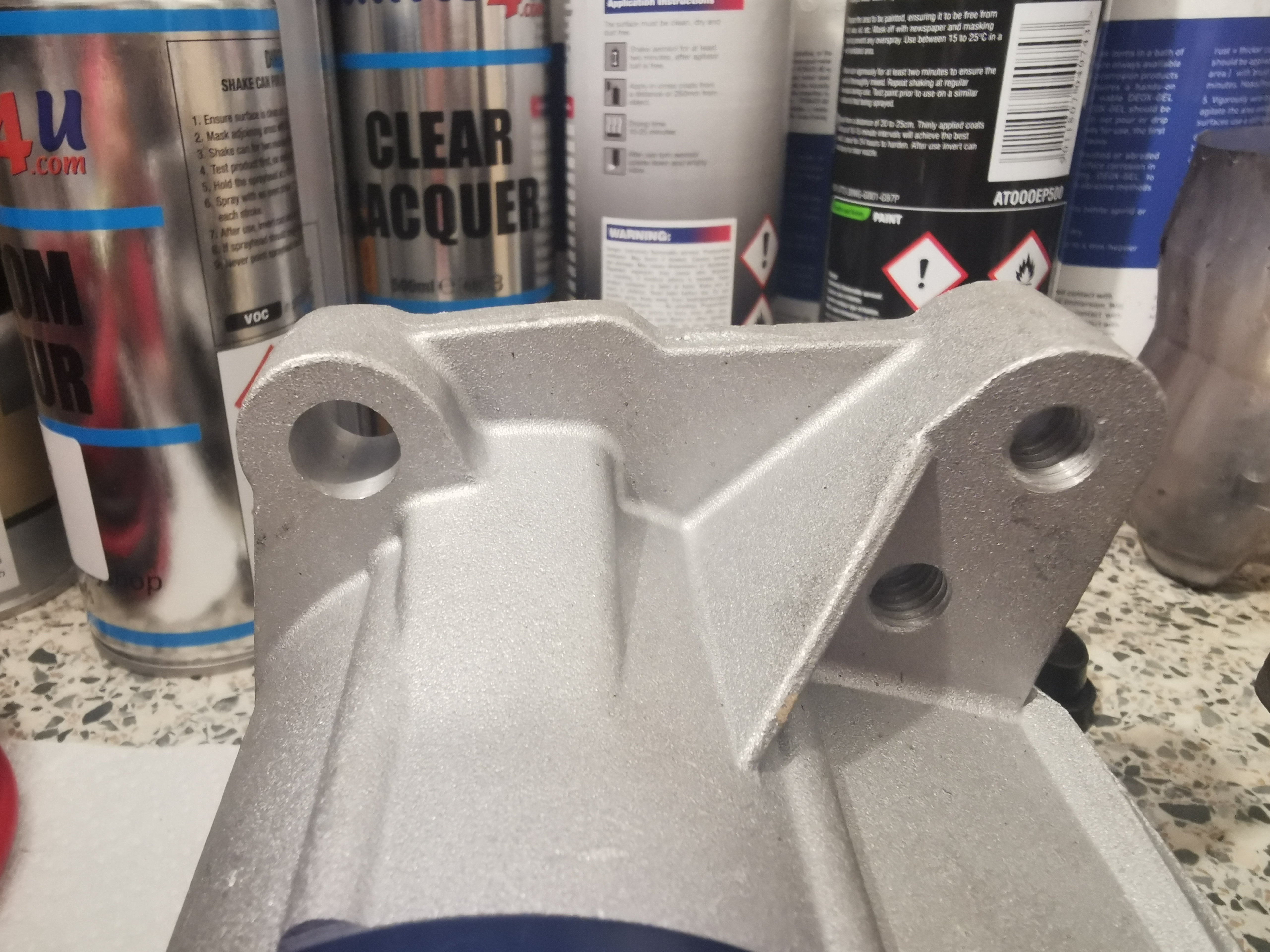

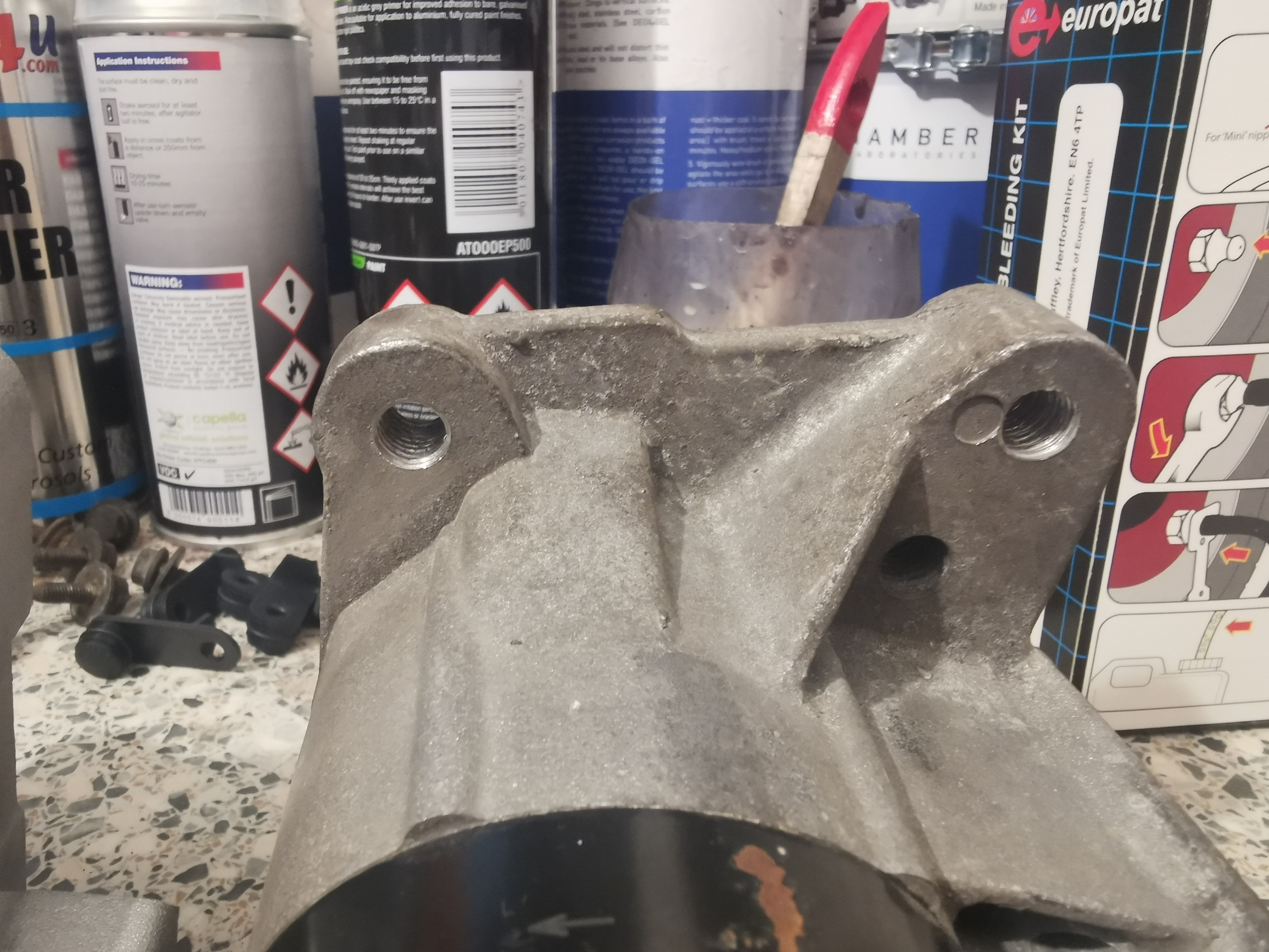

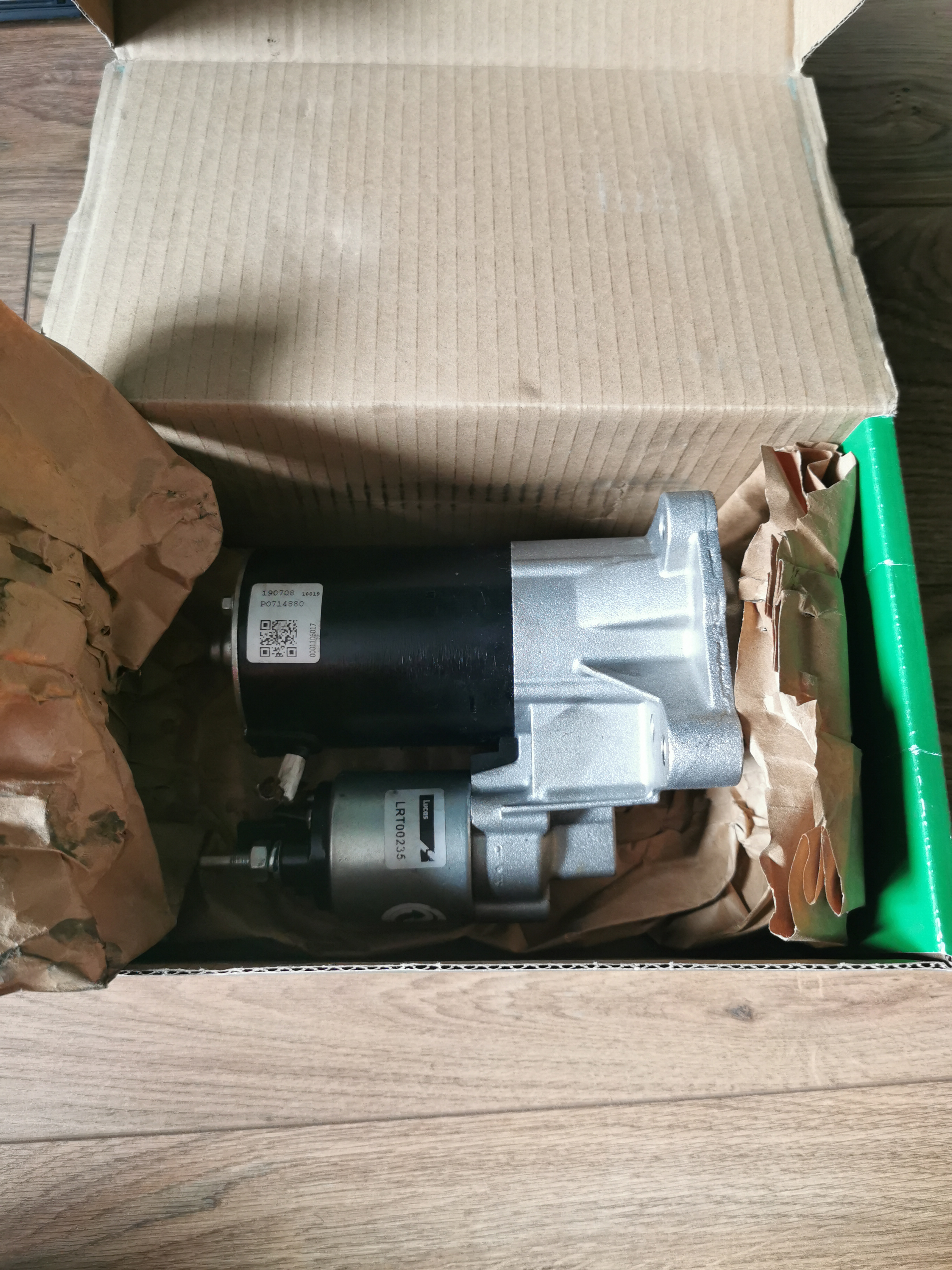

Having previously whipped the starter off I knew how to do it so ordered a lucas one from euro car parts ready to fit it while the weather forecast was good. I collected it on my way home from work and had a quick look to make sure it had the 3 tapped holes for mounting and wasn't like the one I'd bought previously. As a refurbished unit it should be right and it did indeed have the correct holes, phew.

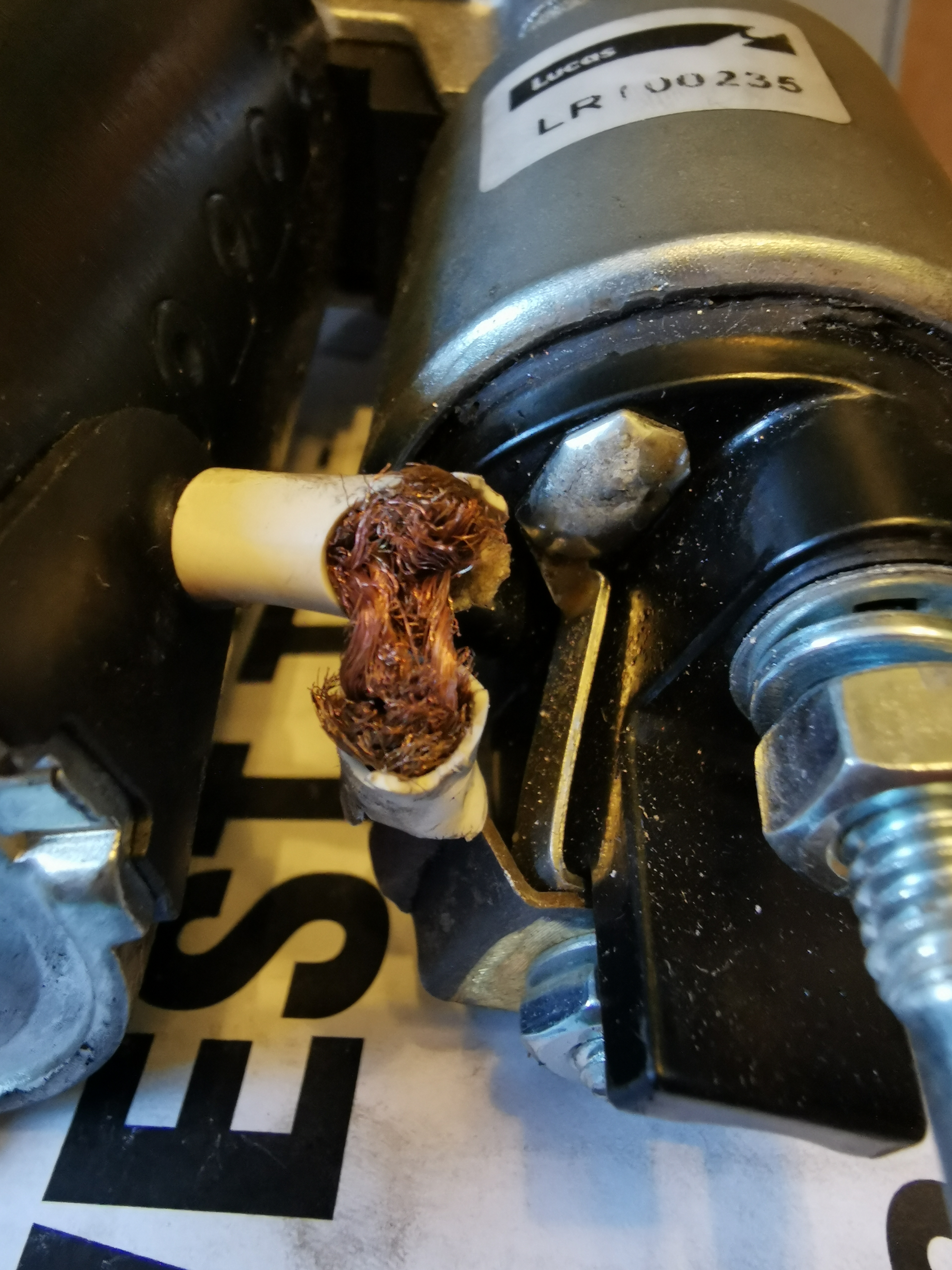

So friday I started pulling bits off the car again ready to swap the starter. I went to get the new one and found this;

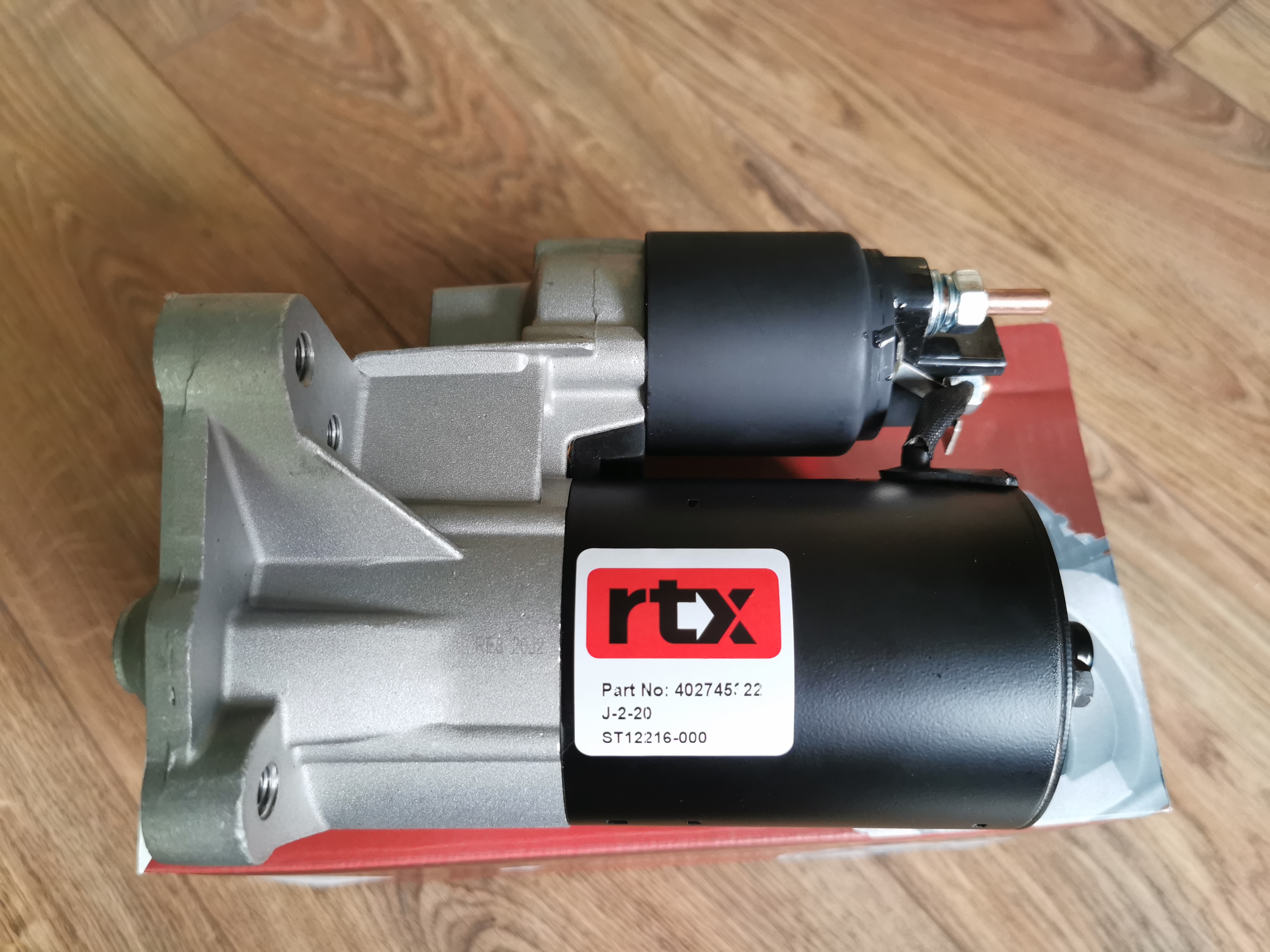

The power cable was fucked. Tools packed up in a huff and an early start on Saturday to get to ecp before all the mongs. Monday morning they said they'd be able to get me a replacement. f**k. Alternatives? Yes they had an RTX one in, so from the dearest to the cheapest but f**k I just want to get the car sorted now. I asked if it n was a new one but apparently they are all refurb now, I want to check it then I said, "but the box is sealed!" yeah f**king no chance I'm leaving without seeing the bloody thing. Opened it up and it looked like a brand new unit, miles better than the lucas one that's 3x the price!

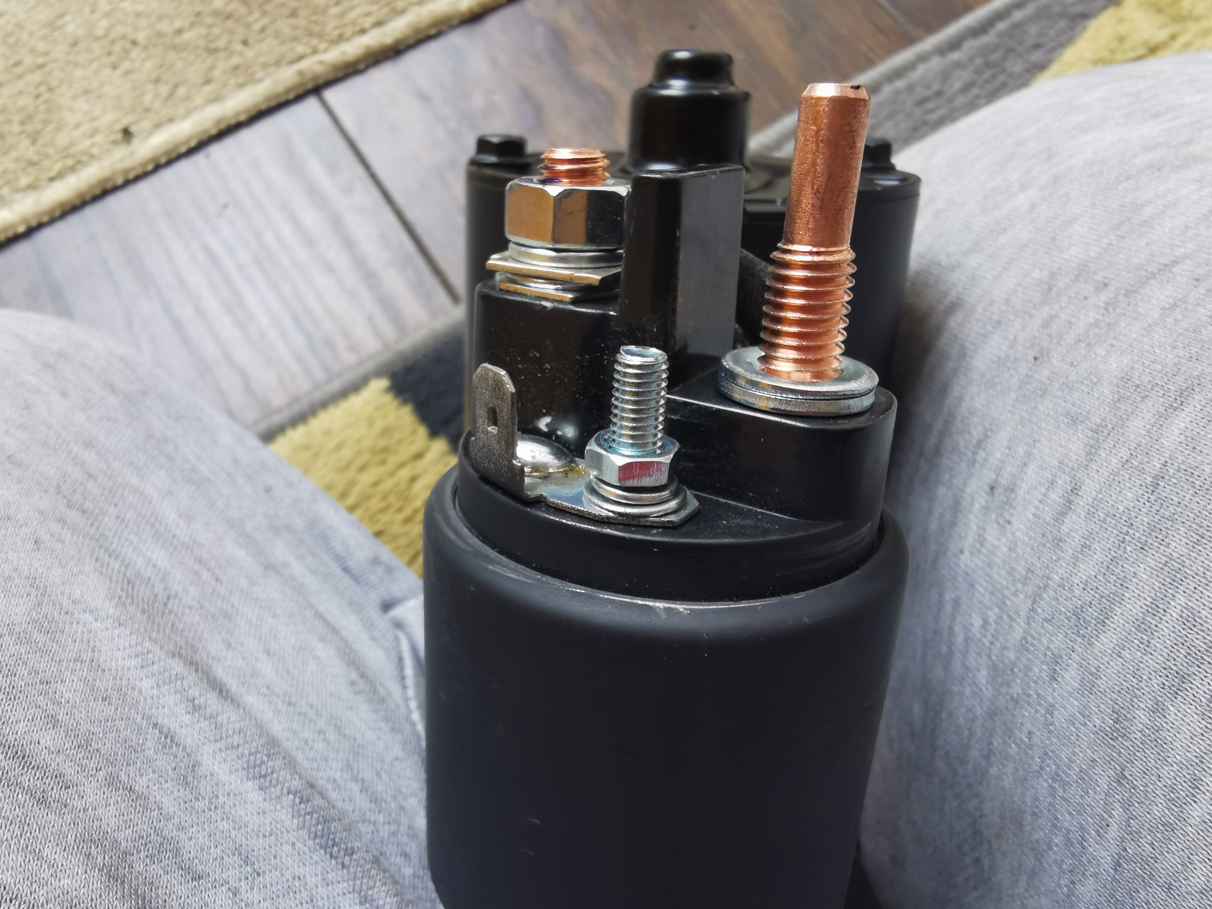

Looks good to me so off I went to fit it. Old one wrestled out and new one fitted easily enough and when I connected the battery the bugger started spinning😳. If anyone has the same issue with a replacement starter it's caused because the pattern ones have a smaller stud that touches the main power cable connector when it's screwed on tight. This smaller stud is part of the solenoid connector so with power added off the starter goes!

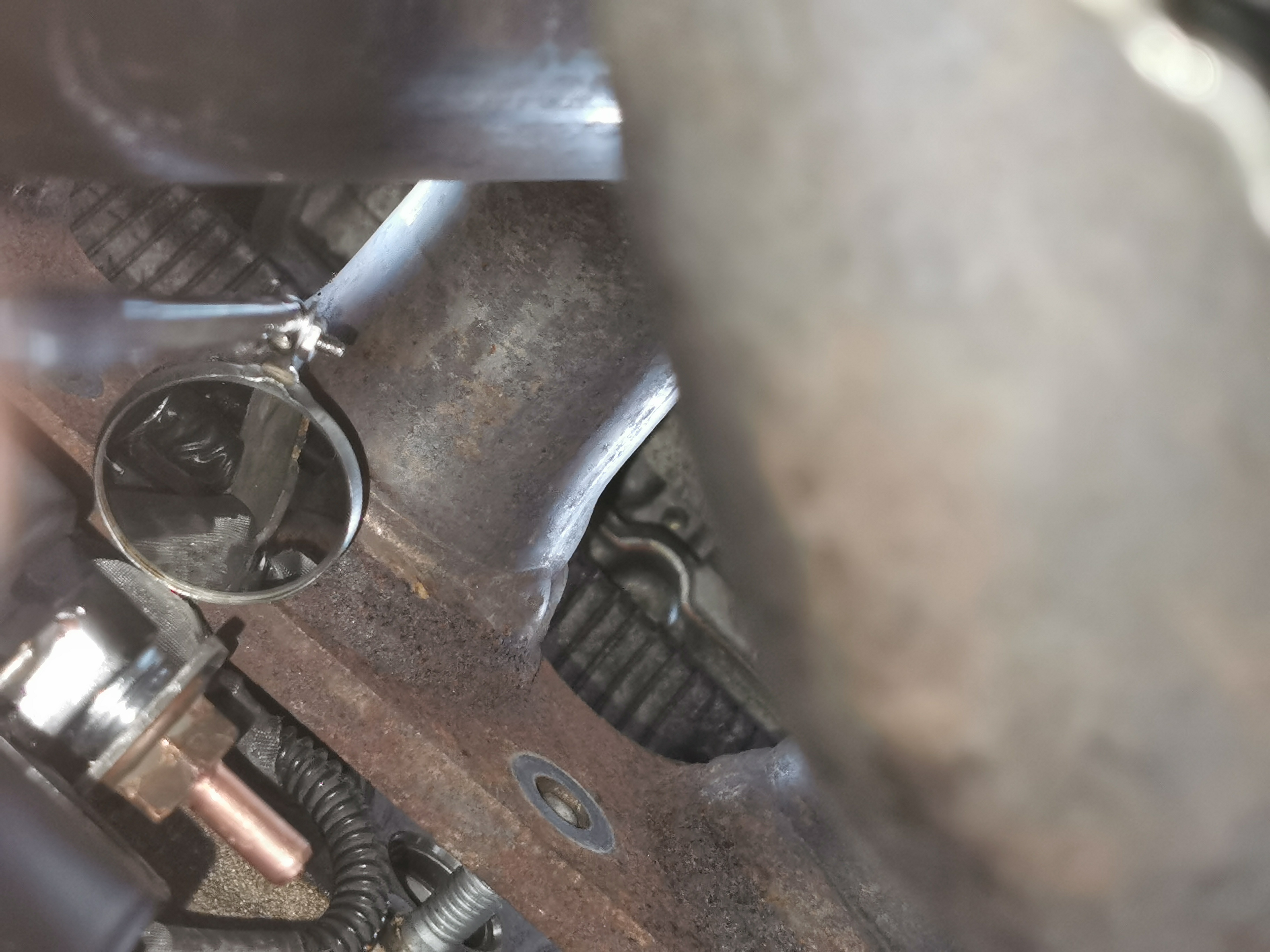

And here it is wrapped in insulating tape and fitted.
That's it hidden in the mirror and covered by the main power connector.
