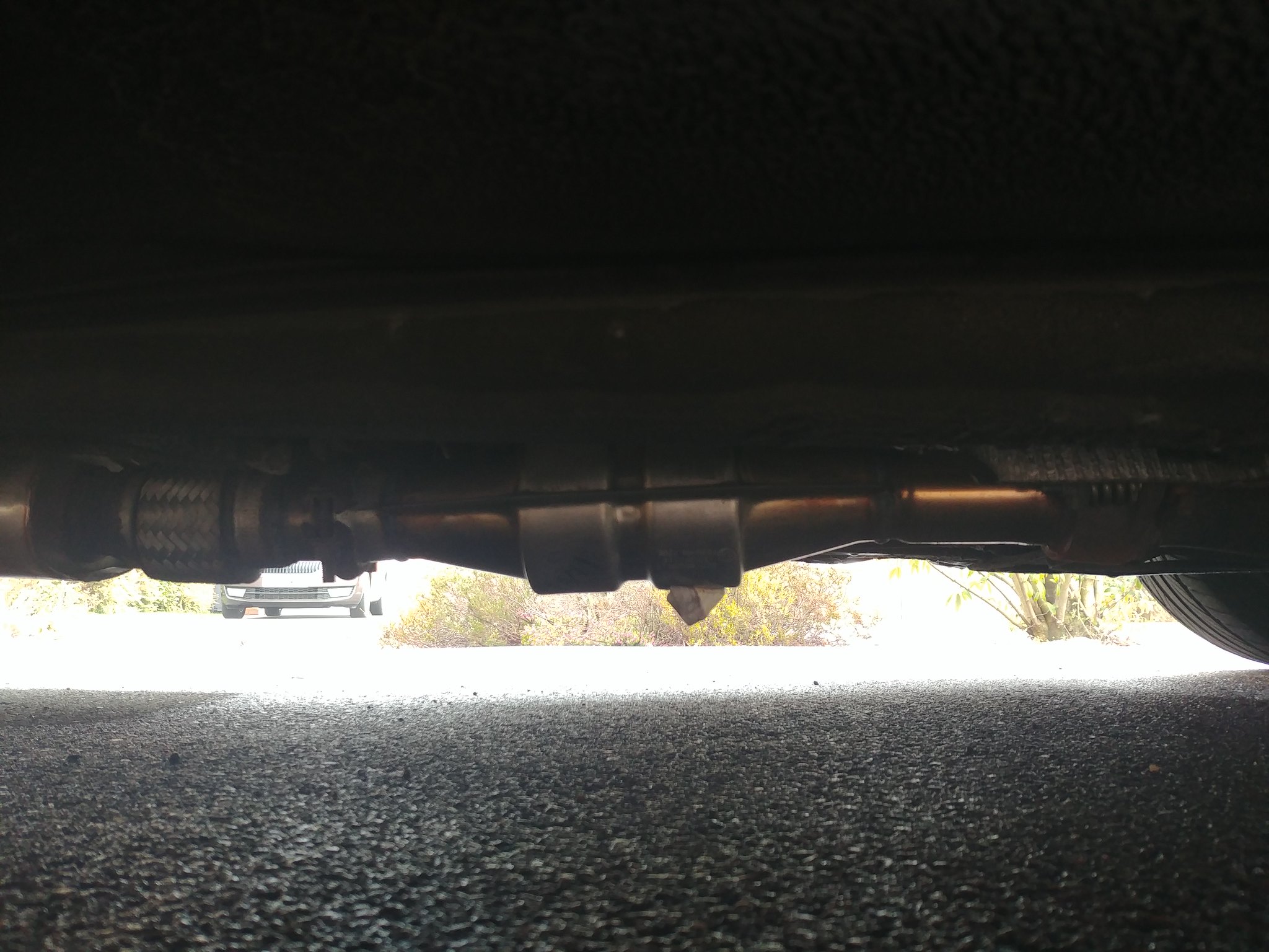

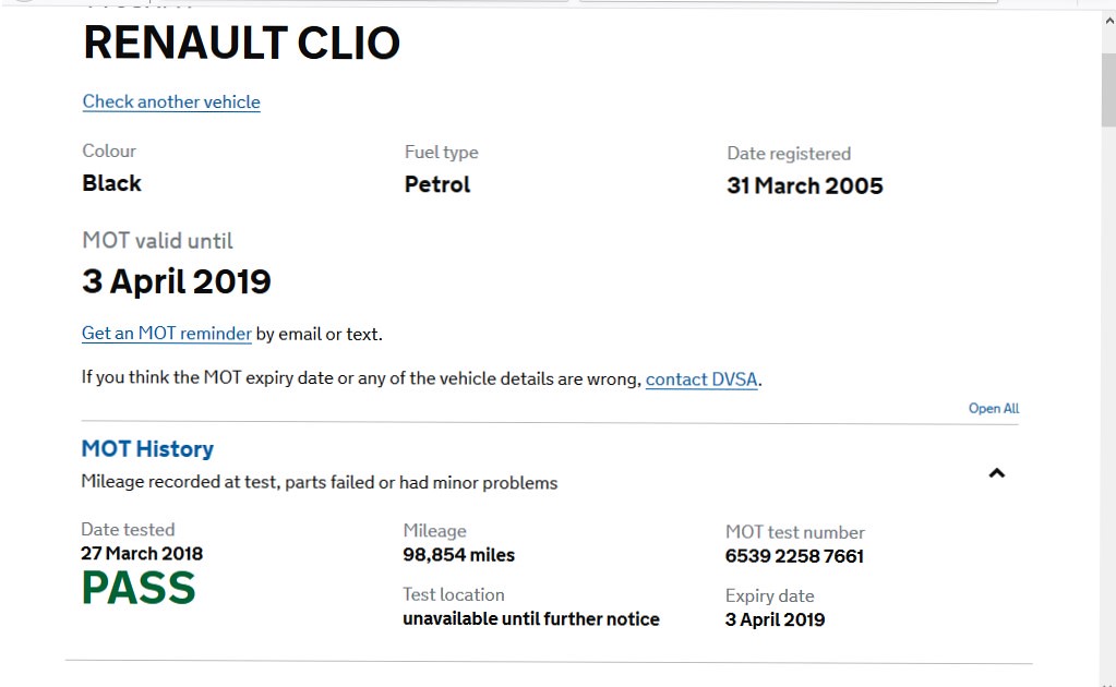

MOT was passed eventually. The car was away for 5 days in all. The handbrake got fixed but it turned out it also failed on emissions:weary:. I told my mechanic to give it a good pasting before it went back but it still failed. I'd bought a used cat the other year to clear the permanent eml I had on and it turned out my original cat was empty so this time I said f**k it get a new one on there. Of course cat's for a 182 are'nt a stock item so another day wait for it to turn up. Did well in the end though. mot pass by Paul Dent, on Flickr
And just checking the cat is new:smile:

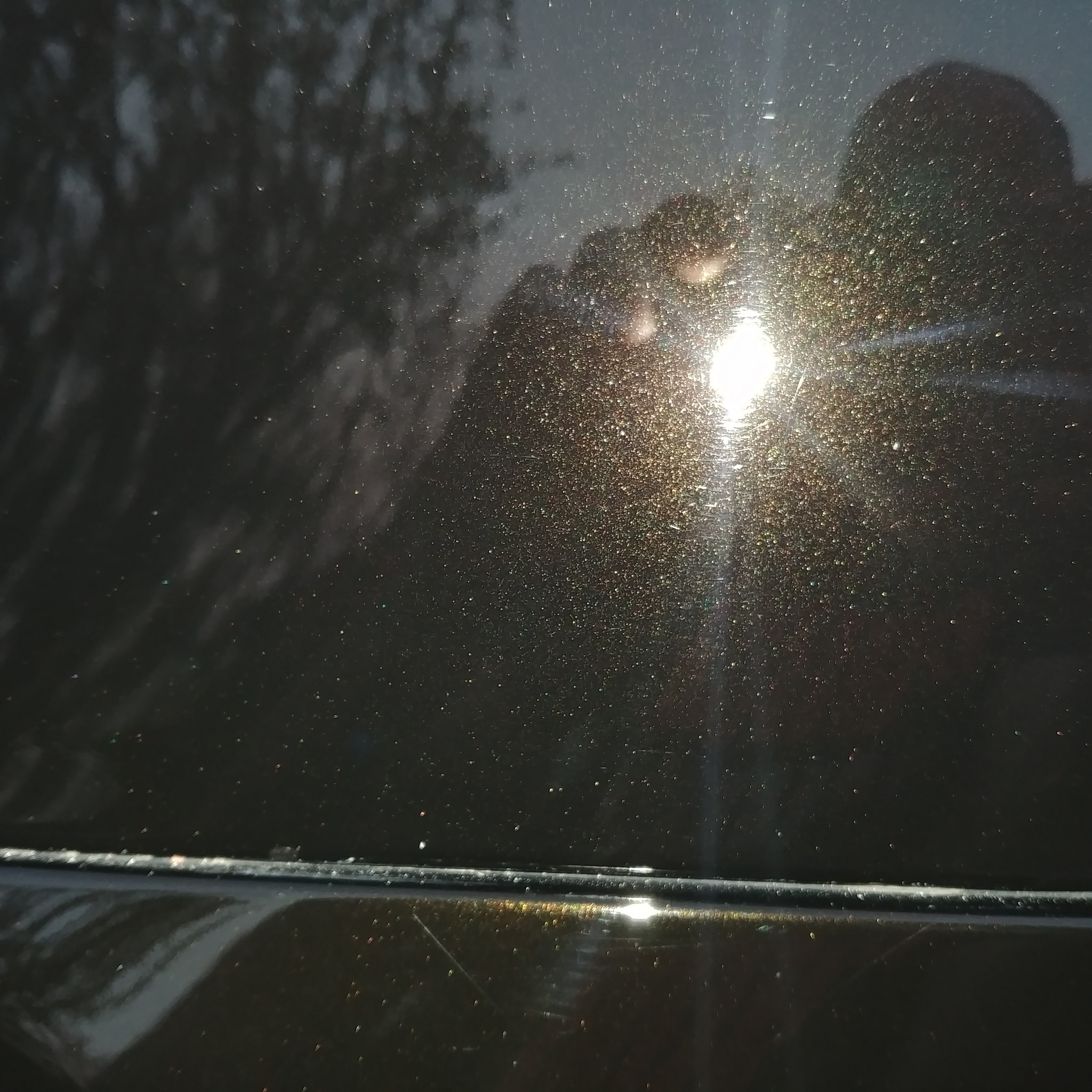

Gave it a wash, poiish and quick wax with some megs stuff ready for Newby Hall tomorrow. The weather forecast is good so I'm hoping to see some gold pop after been at it 4 hours. Really needs attacking with a da though.

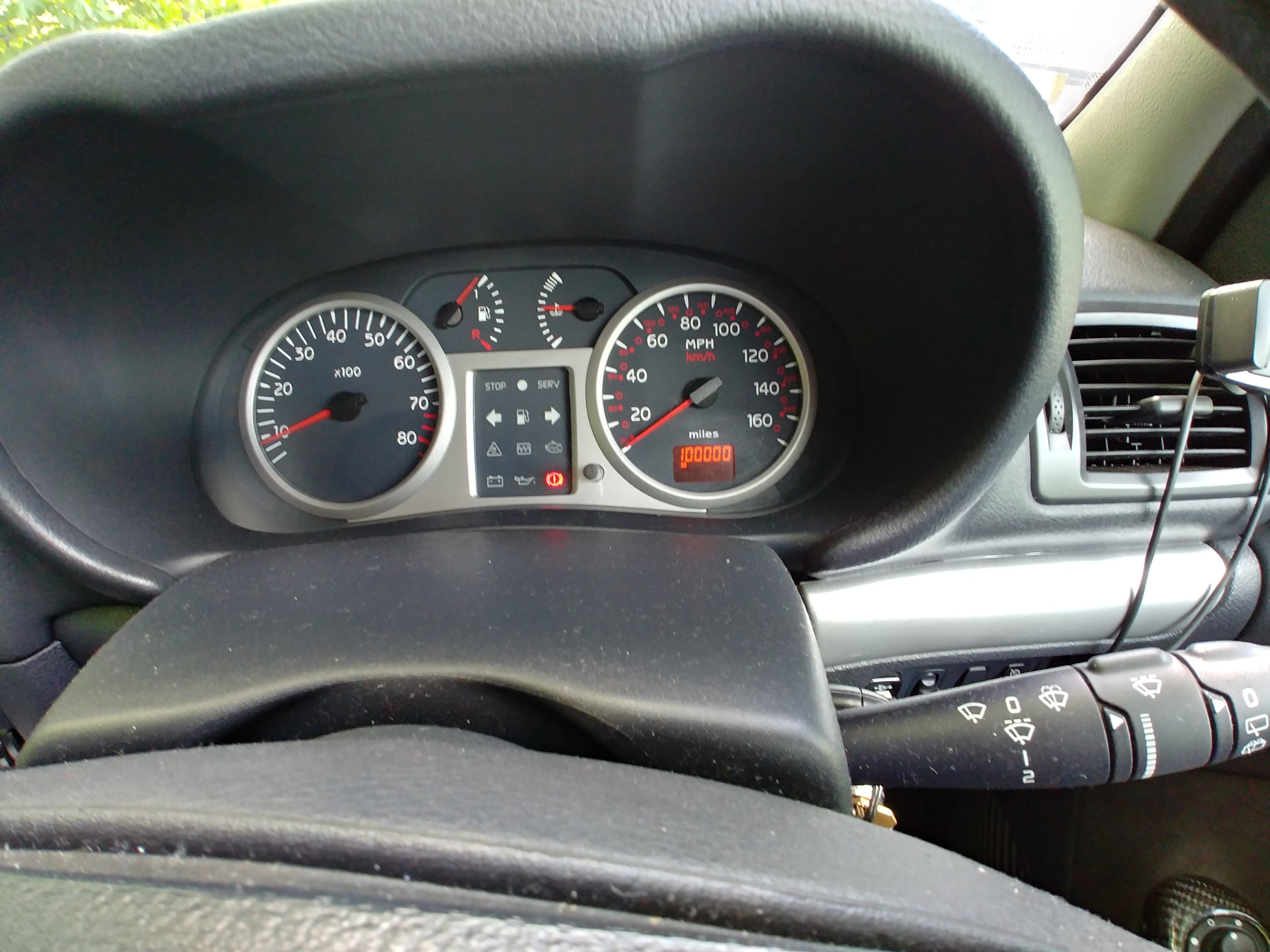

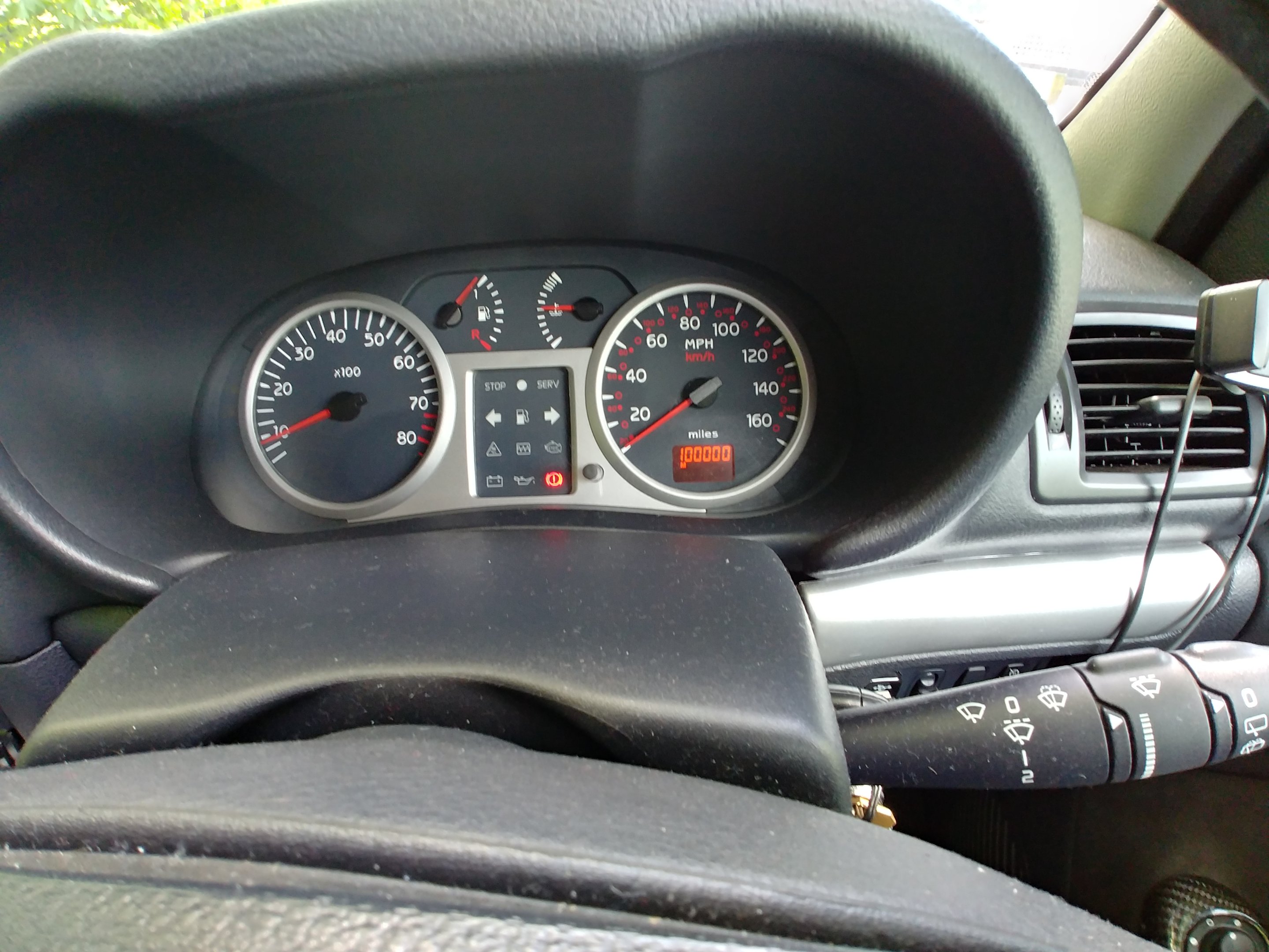

100k in the bag! I can't wait to get the suspension refreshed and wipe away the old car feeling it currently has. It's given me very little hassle over the last two and a bit years so definitely deserves it.

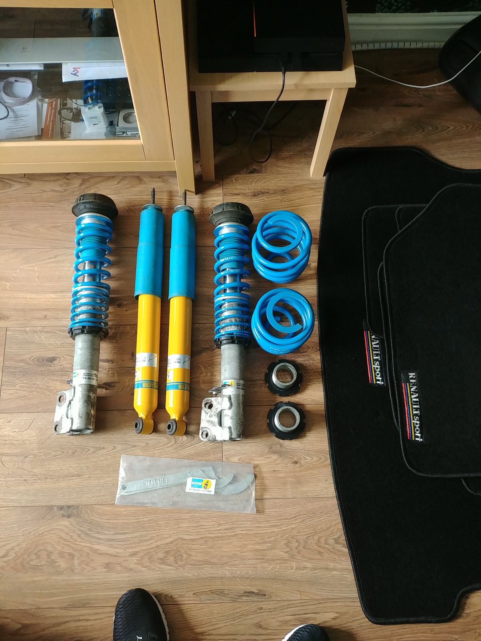

One day some of these bits will get fitted. One day.
I had a drive down to @Coops Mk1 to collect the B14's today. Pleasure to meet you sir and to have a chat and nosy at your varied clio collective!

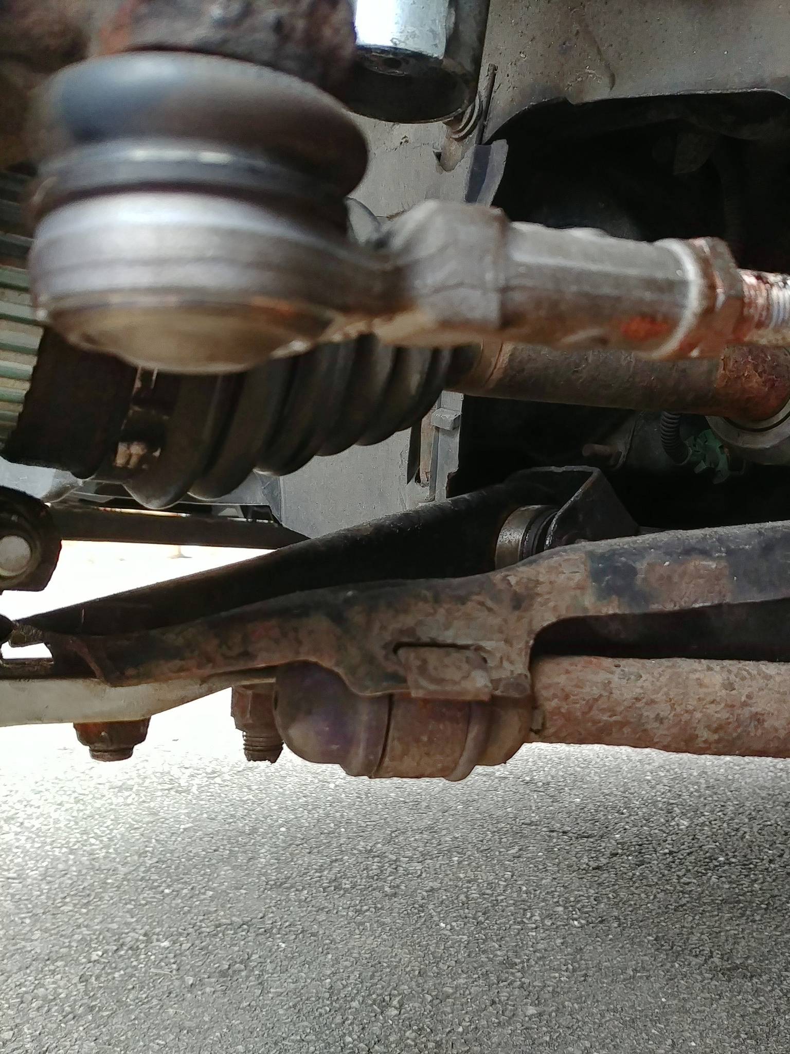

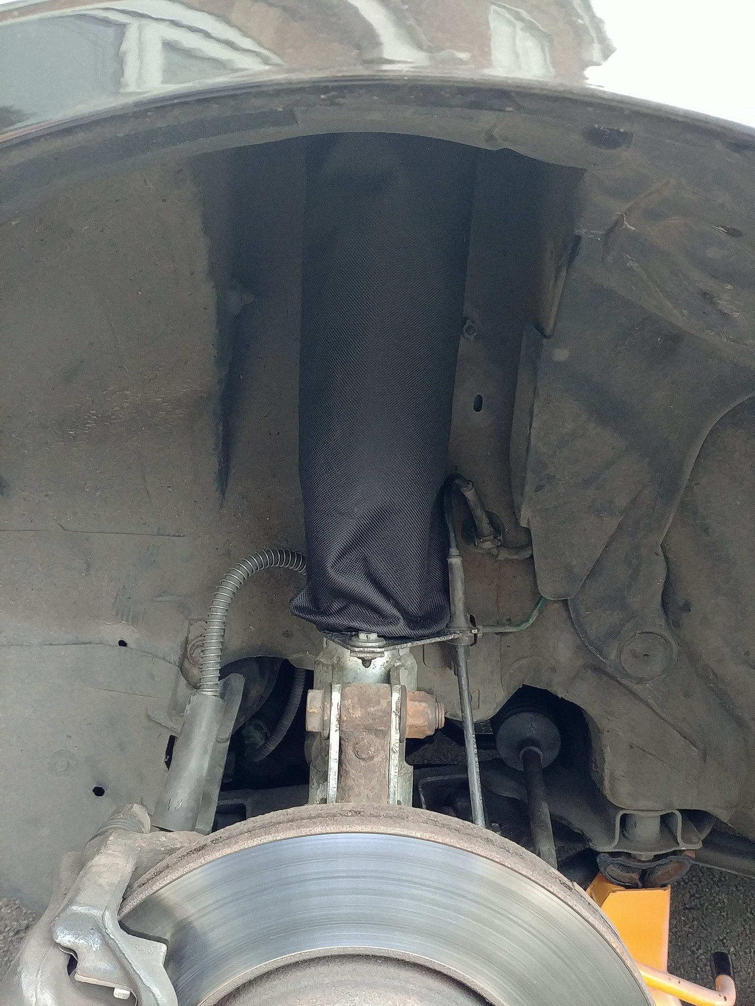

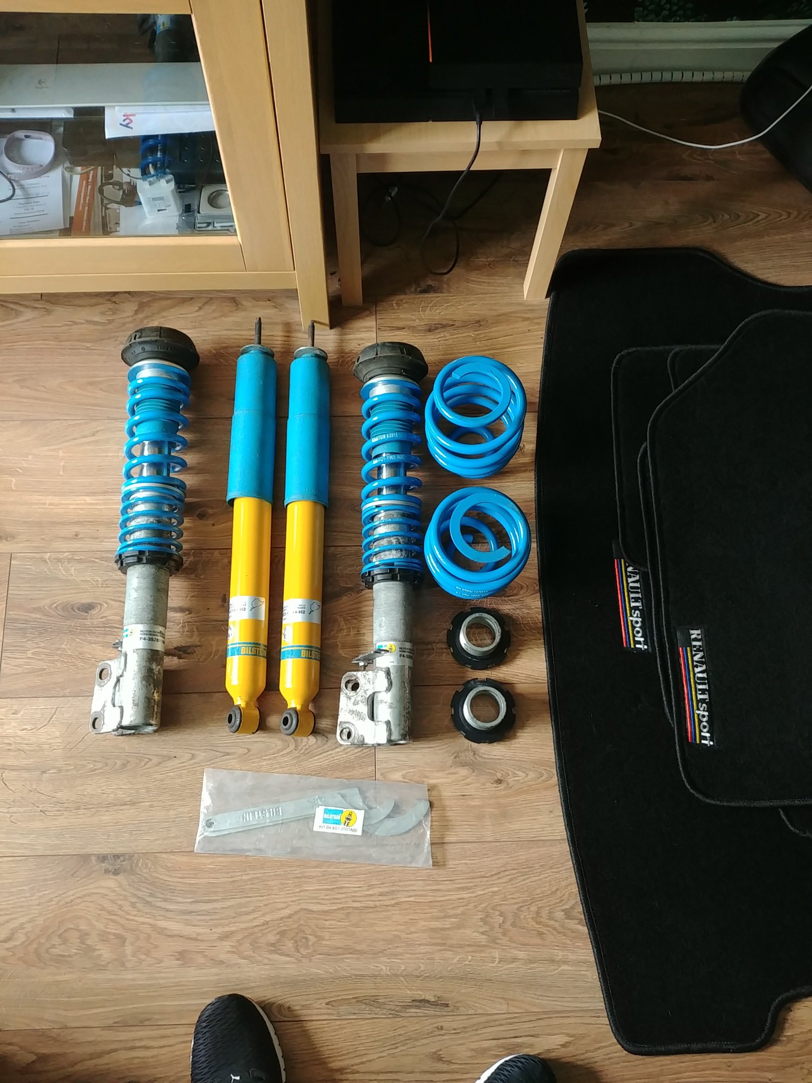

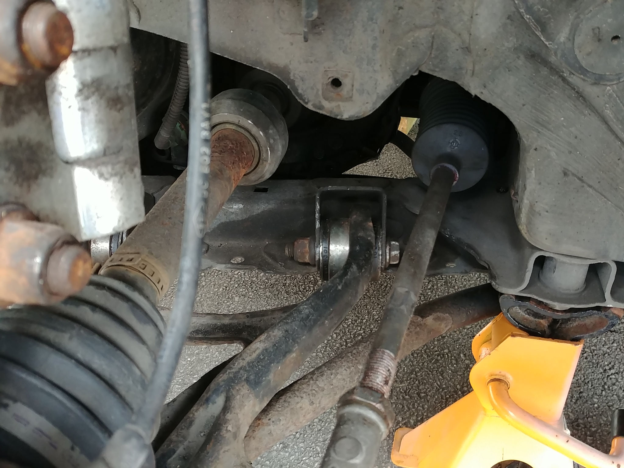

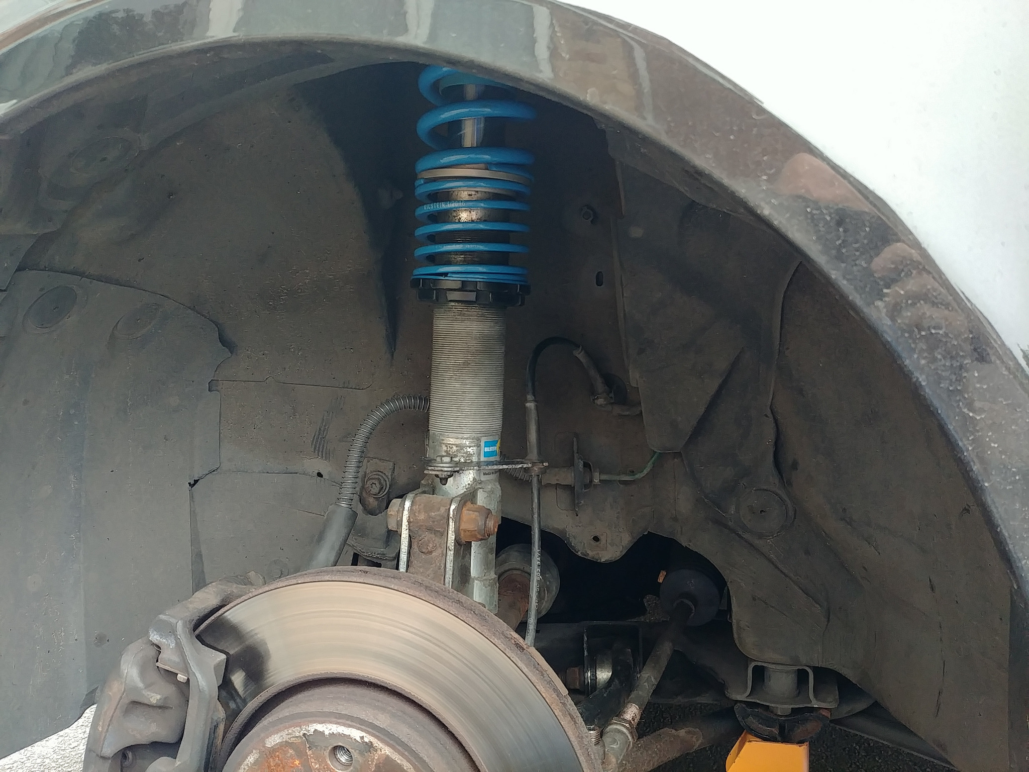

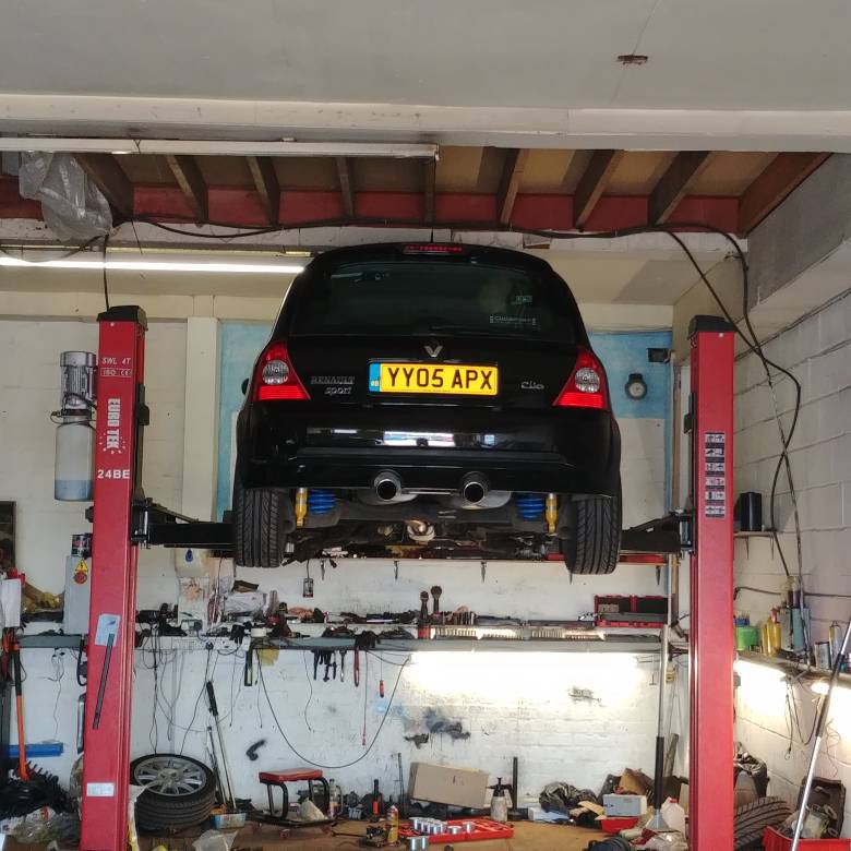

So after a bank holiday Monday that somehow ended up as a bit of a piss up with 2 neighbours on the front lawn what better way to start Tuesday than a 2.5 hour drive at 5am? I had booked the car in with @bloke to have the collection of front suspension parts I had accumulated fitted. A steady drive north only hinderd by the Manchester motorway network being s**t I arrived at what would normally be an ungodly early hour for me to be out of bed?. Up on the ramp and Carl laid out the parts to be fitted. New genuine track rods and ends, new front abs rings, black series wishbone bushes and lemforder ball joints, black series arb bushes, black series steering rack bushes, new upper engine mounts and the B14's I aquired 3 days prior! All went well with no major hiccups, probably the biggest annoyance was me distracting Carl while deliving into his knowledge of future potential mods?. The arb bushes were'nt fitted bacause Carl spotted that I already had purple bushes on it. Bonus! The work still took a little longer than Carl planned but the car went up and down like a yoyo trying to set the ride height similar to the cooksports that had been removed. It's still a little bit lower than i would like but I'm going to leave it and see how it goes. How low was your RB @Coops Mk1 , scraping???. Many thanks to Carl for the work, I would still be on my back swearing at it now probably!

A nice steady drive home on the motorway and the car felt very different. There's a bit more noise and vibration but the ride over bumps is much smoother. There was also a twitchyness to the steering I did'nt have before, which became a problem when the sat nav advised I leave the motorway and had me on some bumpy B roads. As the tracking had'nt been checked I hoped that was the issue, but an odd knock and the steeringg pulling when manouvering did'nt fill me with confidence. I got booked in a couple of day later at a local place and his words were "it's miles out mate". He did say that after replacing all those parts it was never going to be right though. A quick adjustment and we went out for a test drive. I had'nt even got out their yard and I knew it was sorted. No twitching, no knocking, no pulling, just great feel, grip, ride and roadholding. Just what i wanted. I was well happy?. The last job to do was fit the covers on the front coilovers. I need a new jack now because mine is too high to get under the car?. i had to use the scissor jack to lift it a bit! i got these covers off ebay and the guy will make them any length and diameter you need for £22. I went for boring black because he did'nt have Bilstein yellow!

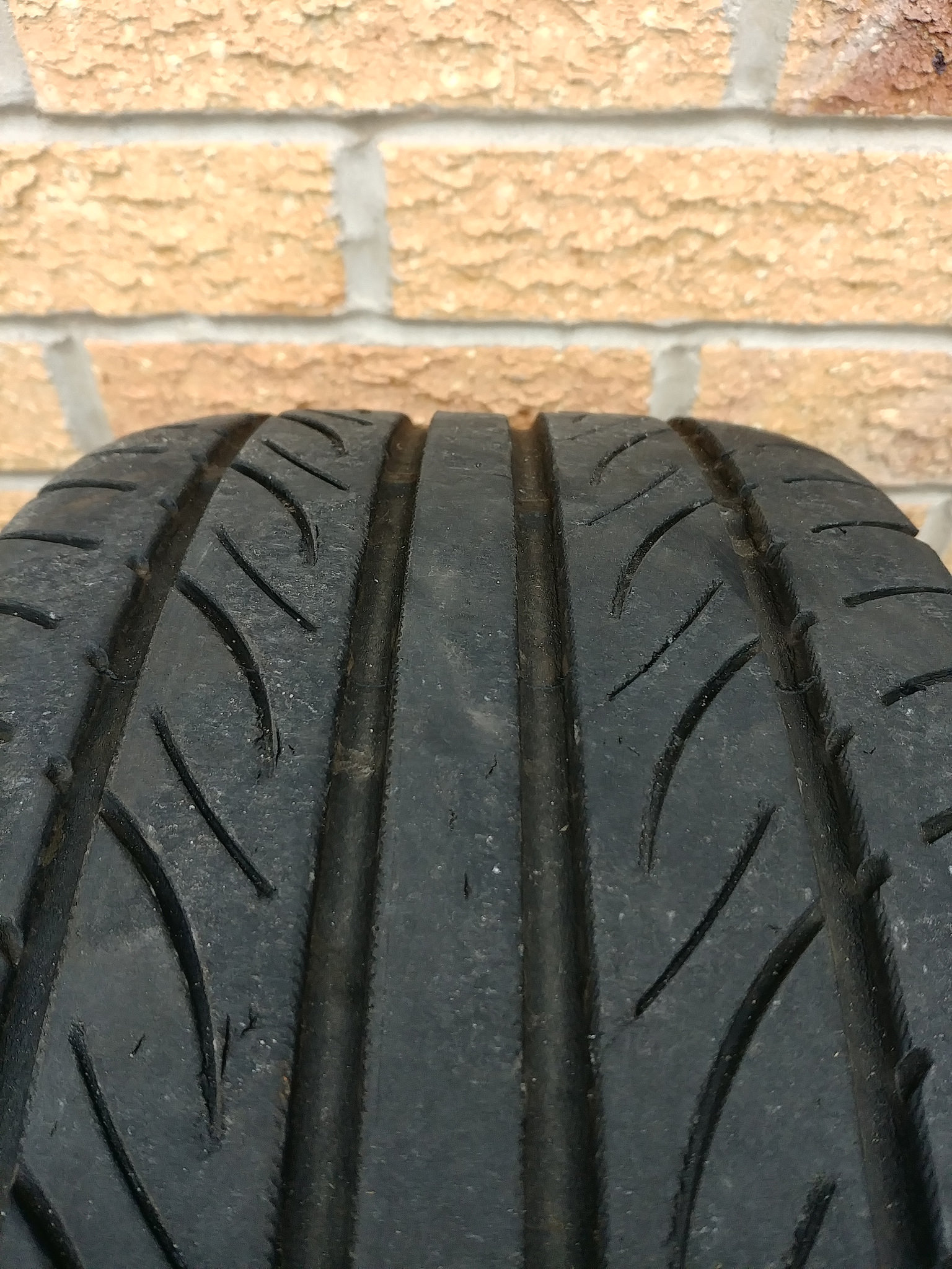

Front tyres looking are looking a bit worn now. Not good as they were only fitted last year. I'm gong to swap them to the rear so I can replace all 4 at the same time, probably with PS3's again.

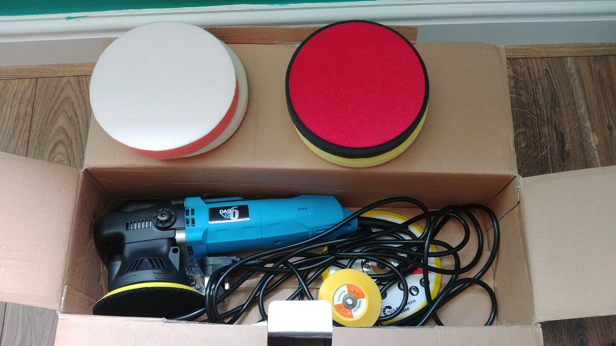

i managed to get the car looking half decent for SCITP the other week but theres plenty more work needed. Thanks to @cstarby I've added a Das 6 to my arsenal. i'm excited and nervous to have a go with it!

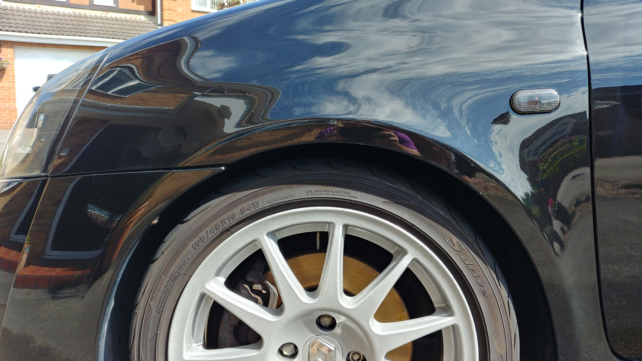

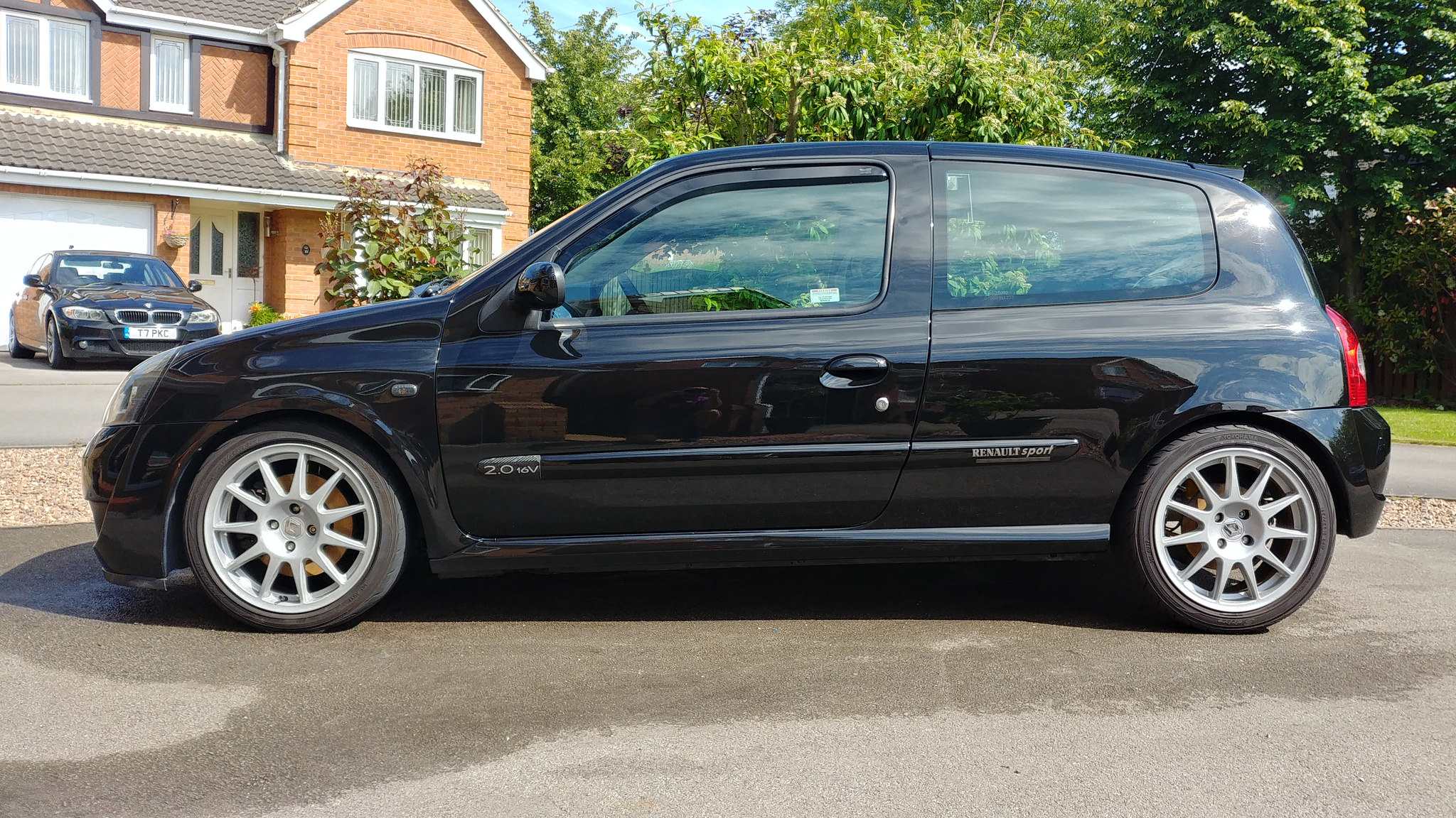

Yeah the back looks ok but the front is probably a bit low. Maybe.
As for spacers, well we've been there before and it was'nt a pleasant experience. I have been thinking it could do with some though.

Nice update Paul! Bet it really felt a lot different after having the tracking done. I don't think the black series make it that much harsher tbh.
I have to agree with @imprezaworks, it's a little too low at the front.
It's hard to judge with you being on 16's, you maxed out on the rear adjusters? Maybe try removing the silver insert and just leaving the black ring in place.
I've been running watfields spacers and wheel studs for ages and not had a problem like you experienced. I think you didn't torque your wheel nuts ?

Tbh pansy, can't believe you raised them, should of gone lower if anything ?
They would'nt go any lower. Chav??

Looks good Paul, maybe a bit too low on the front but easily sorted.
What you doing with the arb bushes? I need some for mine as I noticed last week that my current ones are all cracked.
Thanks, I've had a measure round it today and the drivers side rear is 10mm lower than the passenger. The front doesn't look too bad to me actually, although I think the camber needs looking at and it could do with spacers on. I'll address the height next weekend as busy today.

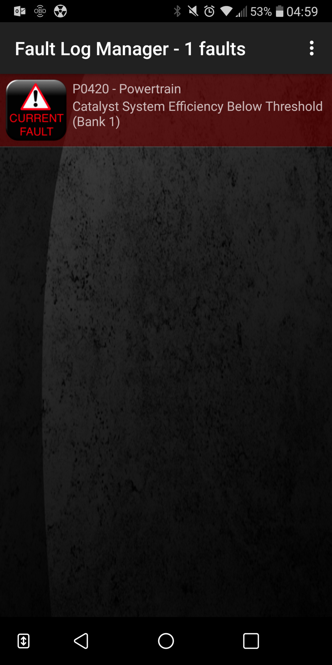

Eml came in this morning when I was a mile from home. And stayed on. Did a quick scan and got this:
Could my cat be fooked after 3 months and 4k miles? I think I'll be back at the garage on Friday for a refund.
