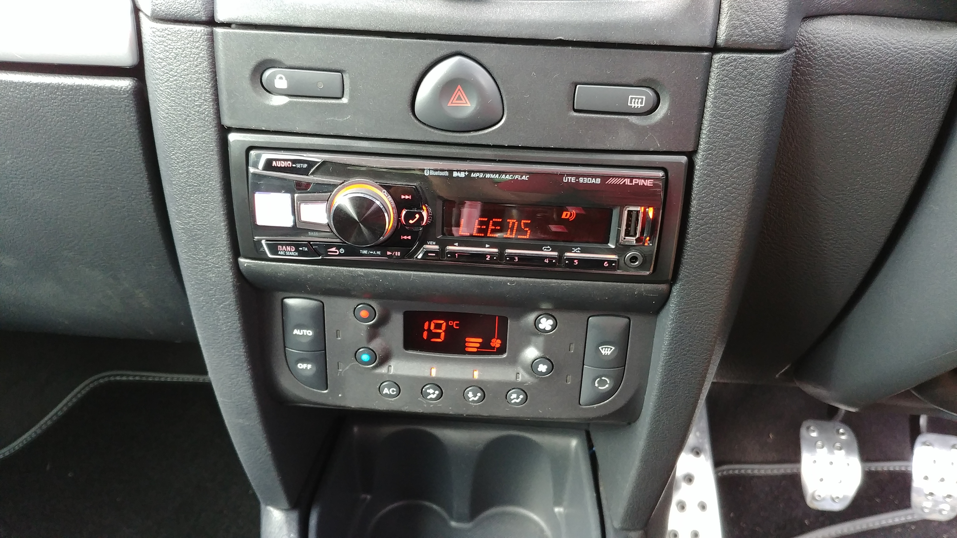

I managed to get the radio fitted too, I've no idea how it all works and after 2 ariel solutions dab reception is still s**t. Looks like I'll be replacing the roof ariel at some point.[emoji30] Pics too follow.

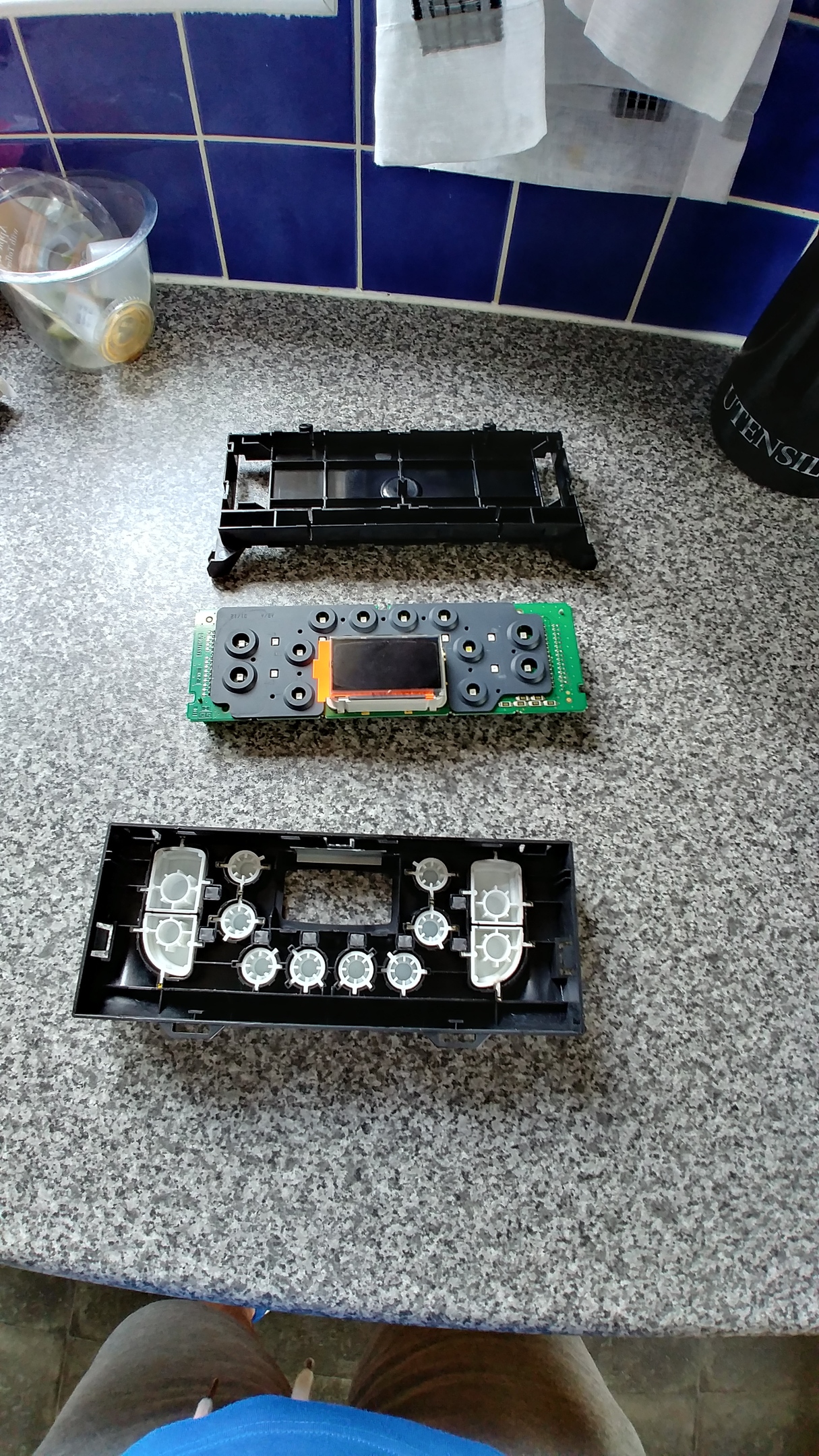

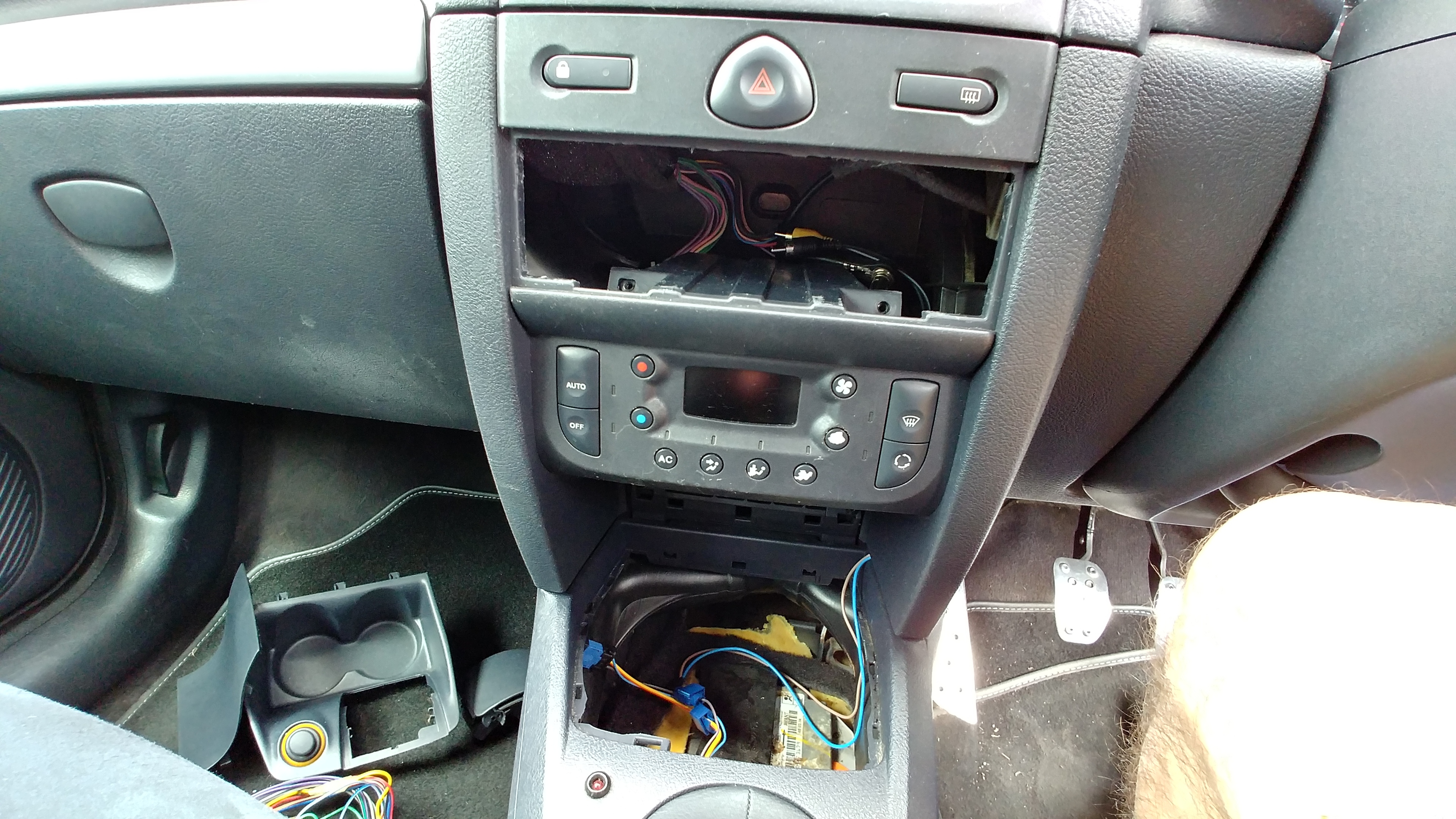

Work on the list of jobs slowly progressed too. I'd bought a climate panel to replace mine as my buttons were scratched off and there were some small scratches on the unit. Unfortunately the replacement was worse but the buttons were perfect. So I decided to just swap the buttons over. Great fun pulling half the car apart to get at the climate panel!
An exhausting day on the clio. by Paul Dent, on Flickr
Both units pulled apart and swapping the buttons over. Note to anyone planning on doing this, don't remove ALL the buttons at the same time unless you have a pic of where each one goes:laughing:. Each button will only go in one hole but it takes twice as long finding the right hole that way!
Progress by Paul Dent, on Flickr
The alpine is in and working, I still have no idea how to use it and DAB reception is still s**t.

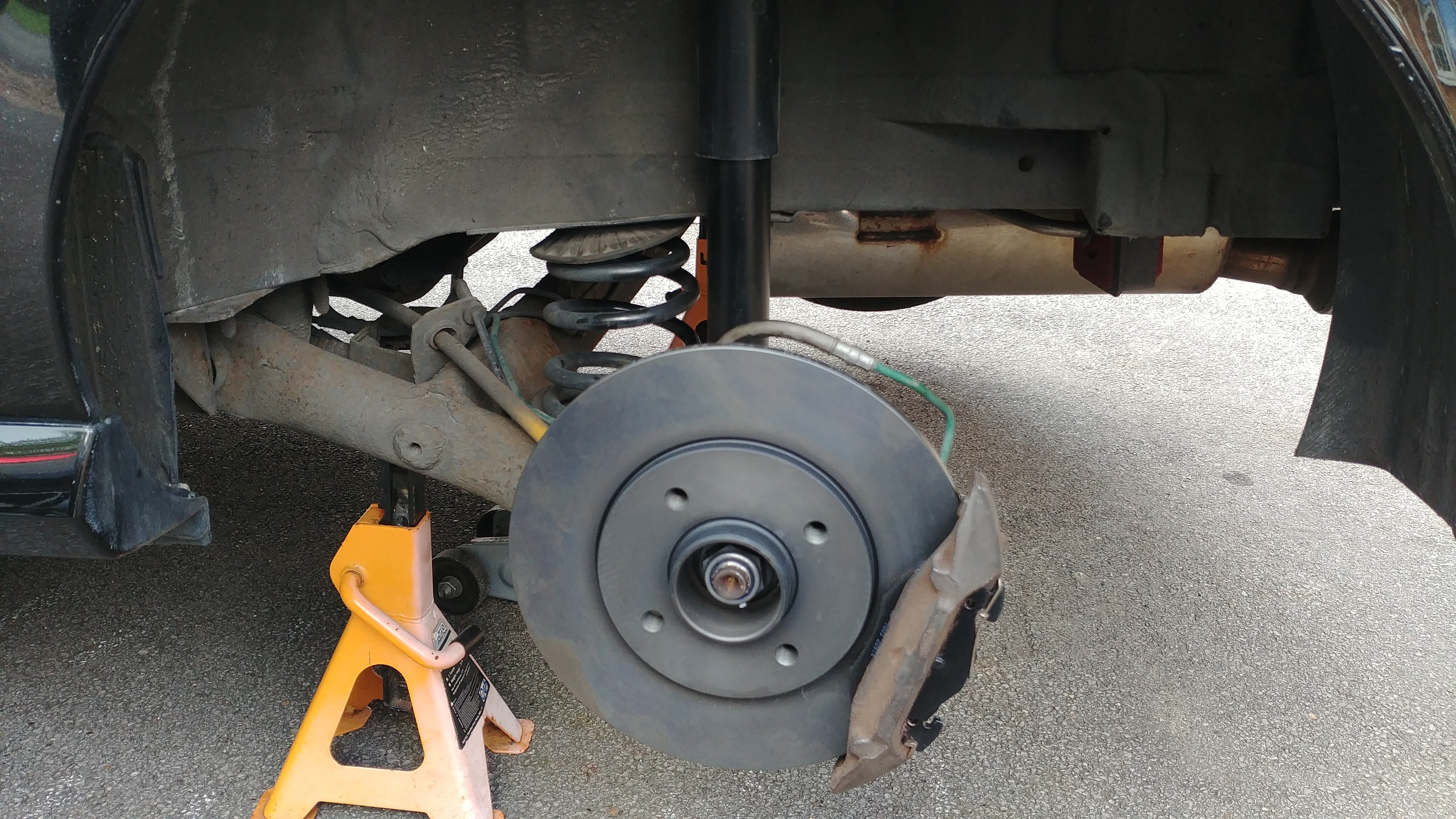

I'd had the week off work so set about changing the brakes and fitting the sub axle spacers. I bloody hate torx head bolts:rage:. What a s**t idea it was to put those on there Mr Renault! Apart from that it was an easy enough job. Amazing how such a small piece of aluminium can make such a huge difference to the look of the car.
New discs and pads fitted and all was good. I think I need to paint my calipers at some point though, especially as they are more visible through the turinis.

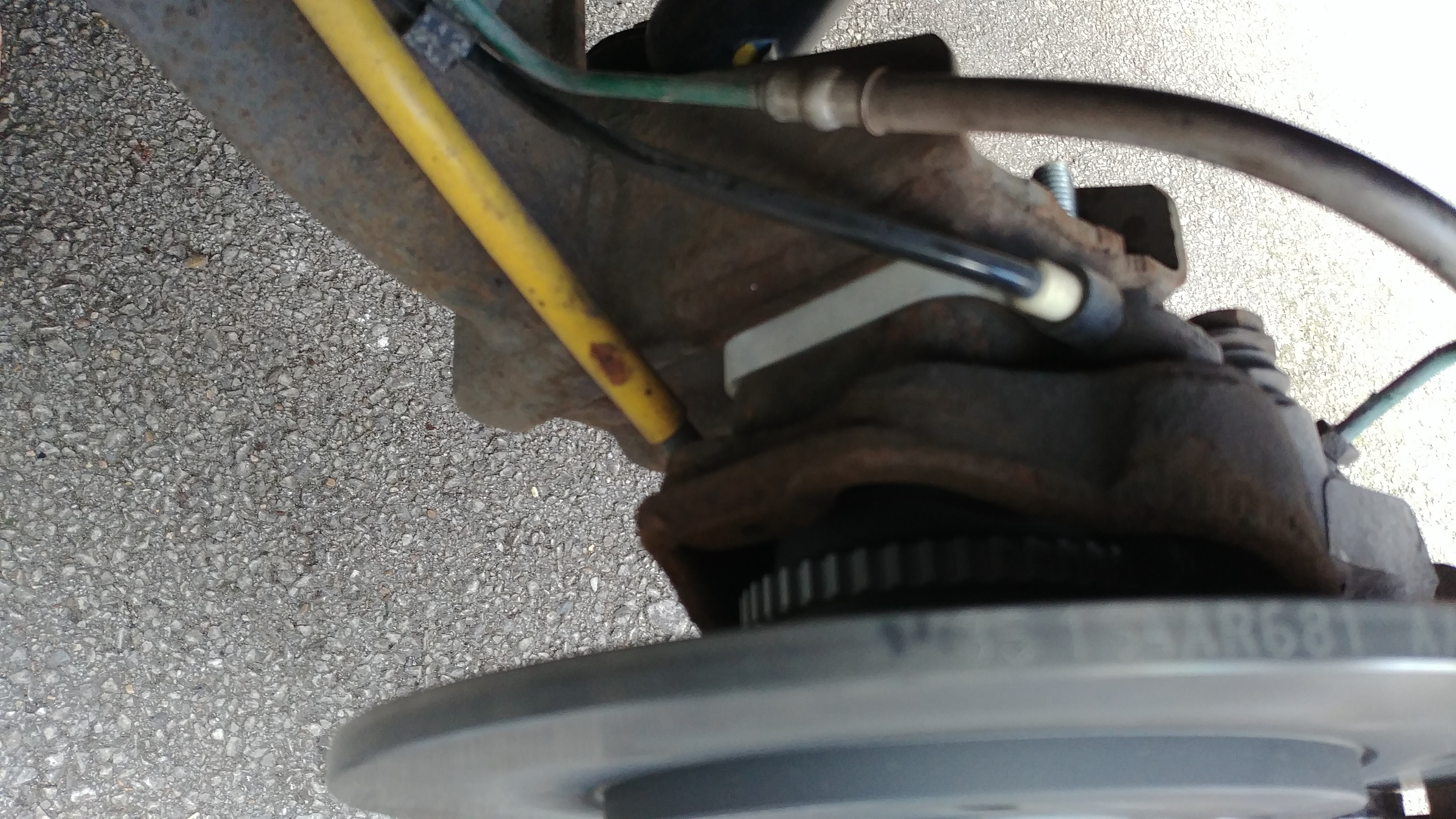

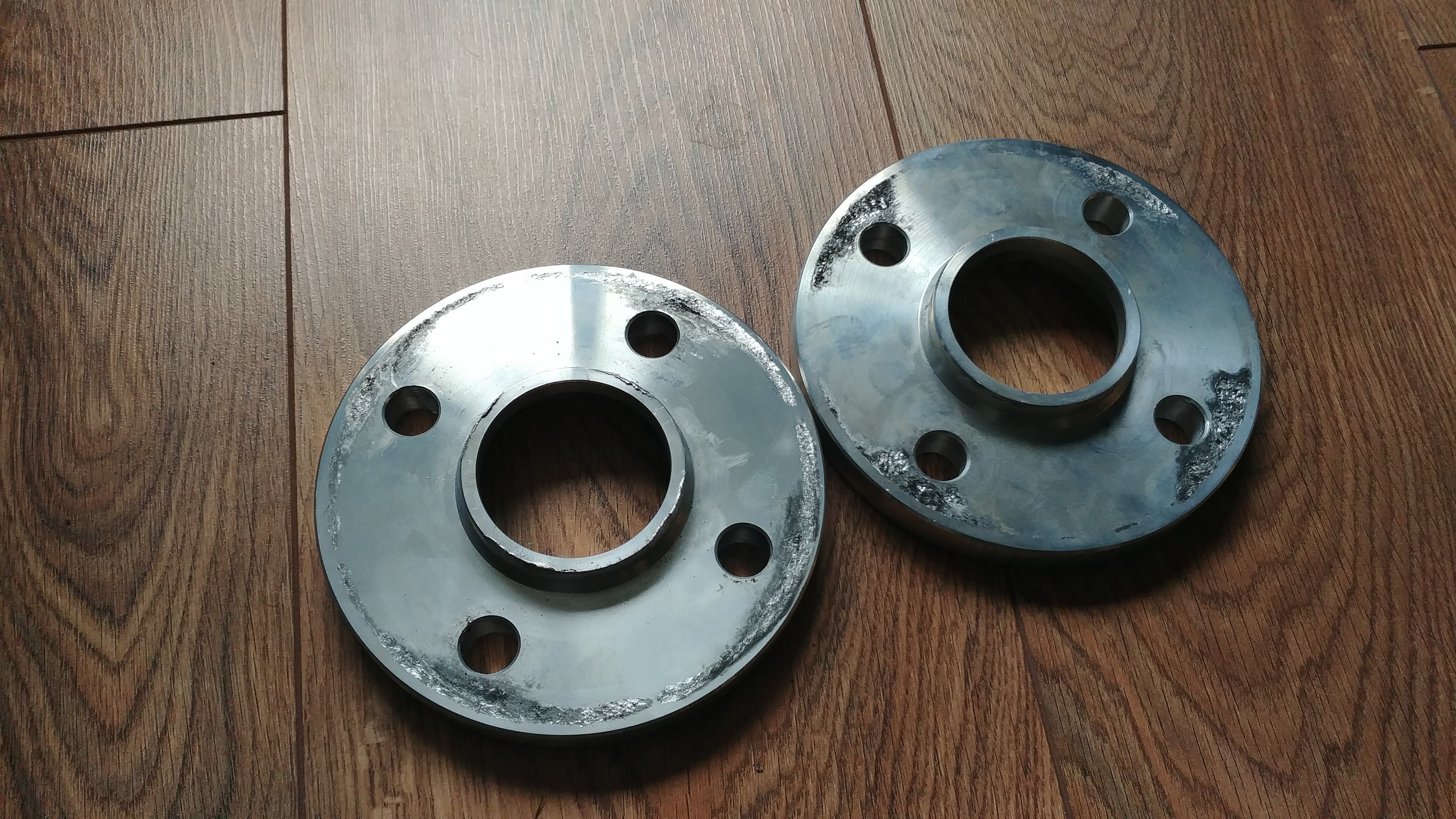

It's a good job I bought new disc spacers and nuts as neither side had a spacer and one side had a plain nut on.

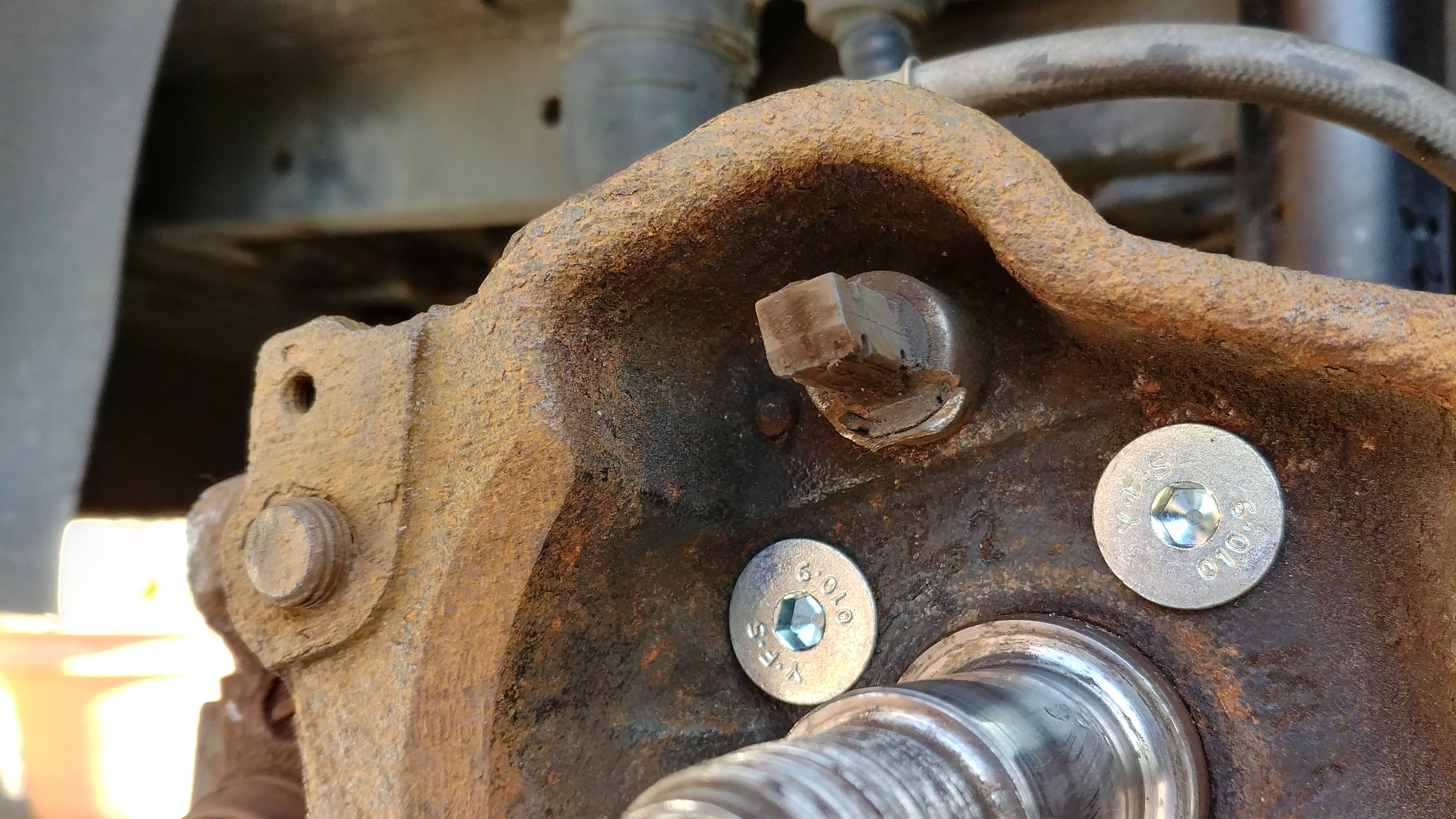

And what happens if you don't have the spacers on? Your ABS sensor gets chewed by the ABS ring! I expect that will fail at some point. I'd already had the other side one replaced and soe how it had not been worn by the ABS ring. Bloody good job as it cost £120 from Renault:flushed:.

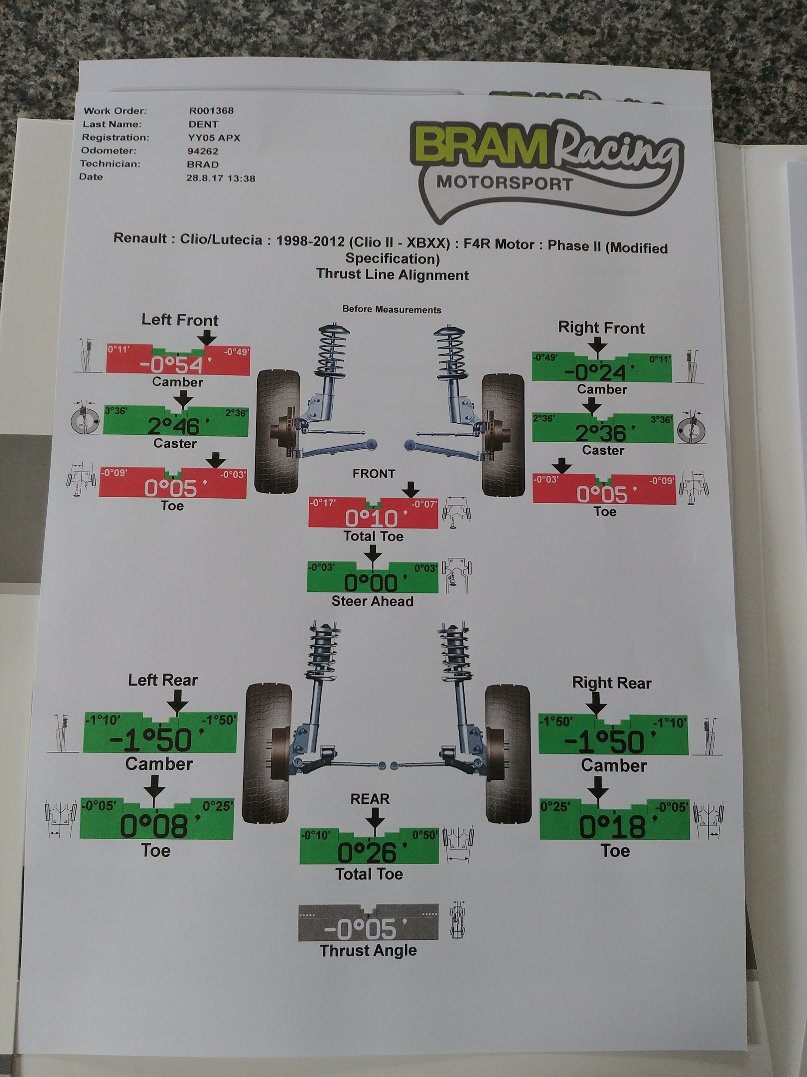

After that self inflicted scare I thought it would be wise to get the tracking checked. I managed to get a slot at Bram Racing on bank holiday Monday. Brad is a sound guy and the hunter aligment is a very fancy thing indeed. @Sj1782 had been there the Friday before and Brad reckons my clutch is very heavy, compared to every other car he's driven:laughing:. Doesn't bother me too much but will be intresting to see whats in there when it needs replacing. Anyway, the robot showed this:
Why that pic is the wrong way up I have no idea, it's fine on flickr! So toe and nearside camber need adjusting so I was advised to get some camber bolts and go back for the adjustments doing. Bolts are with me now so I need to get back there and get it all in the green.

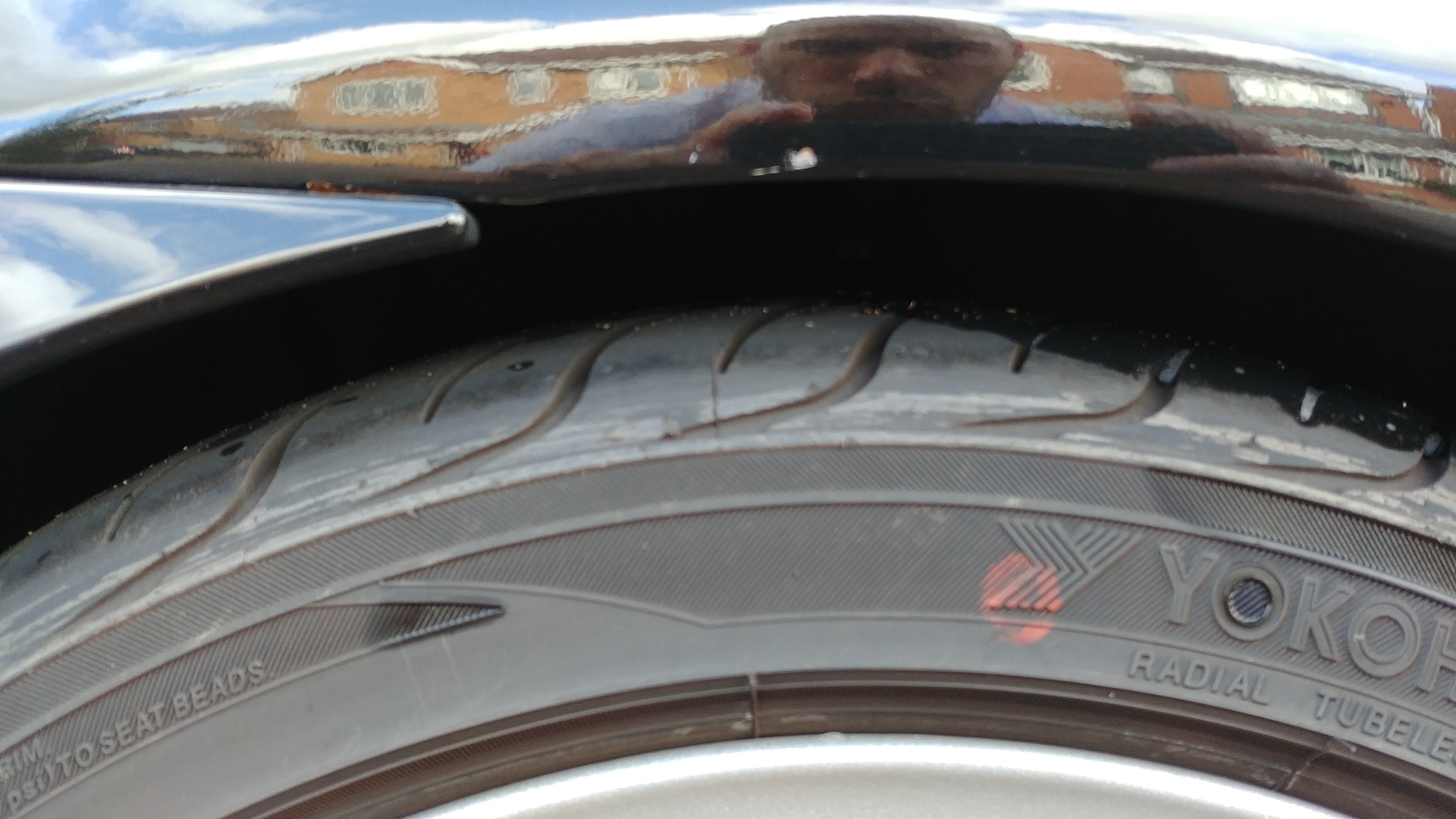

Happy that the suspension isn't buggered I decided the wheels look a bit lost now without the spacers. I did think that 15mm was a bit too much though so started looking at 5mm spacers. Then I had an idea!

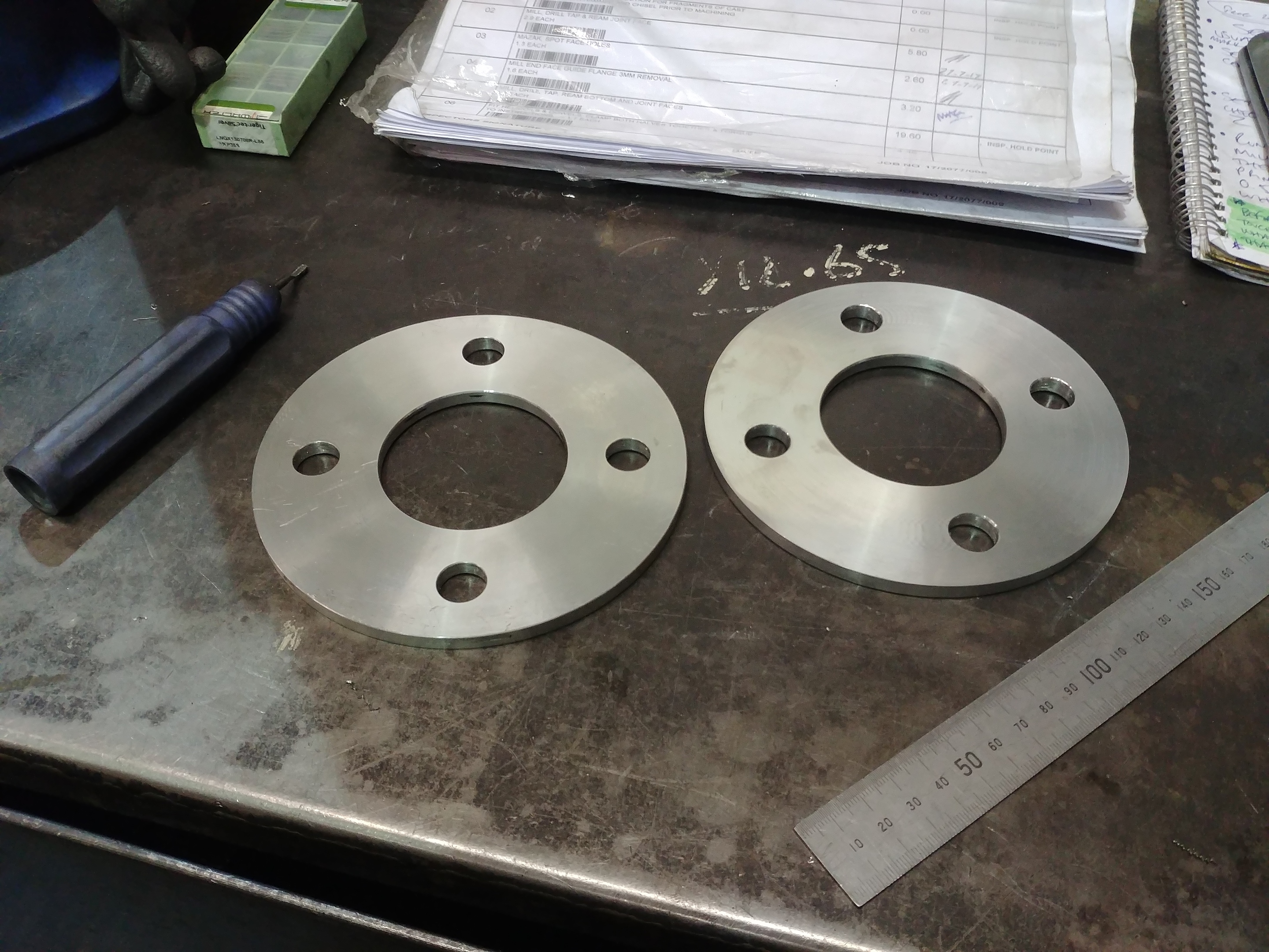

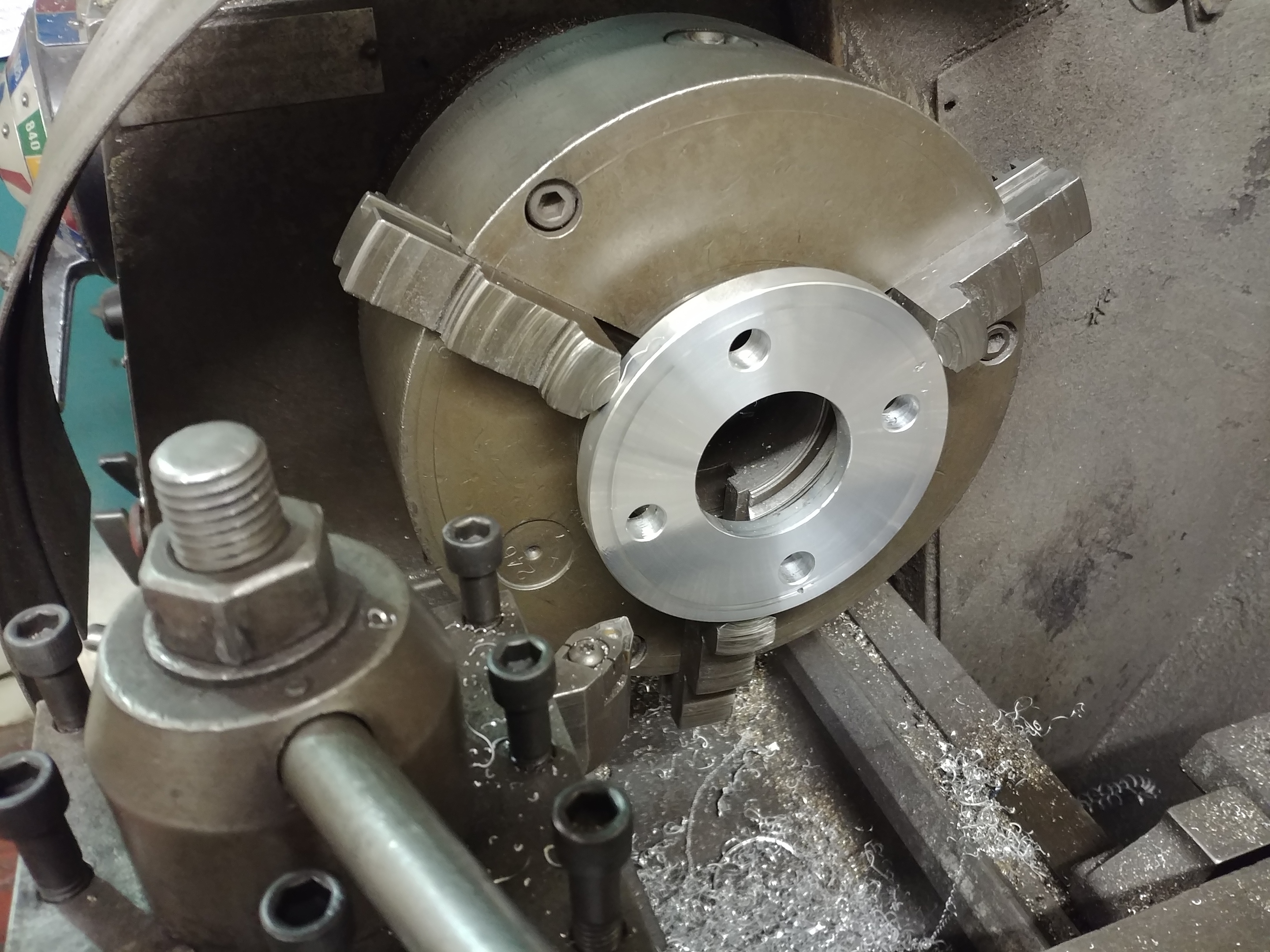

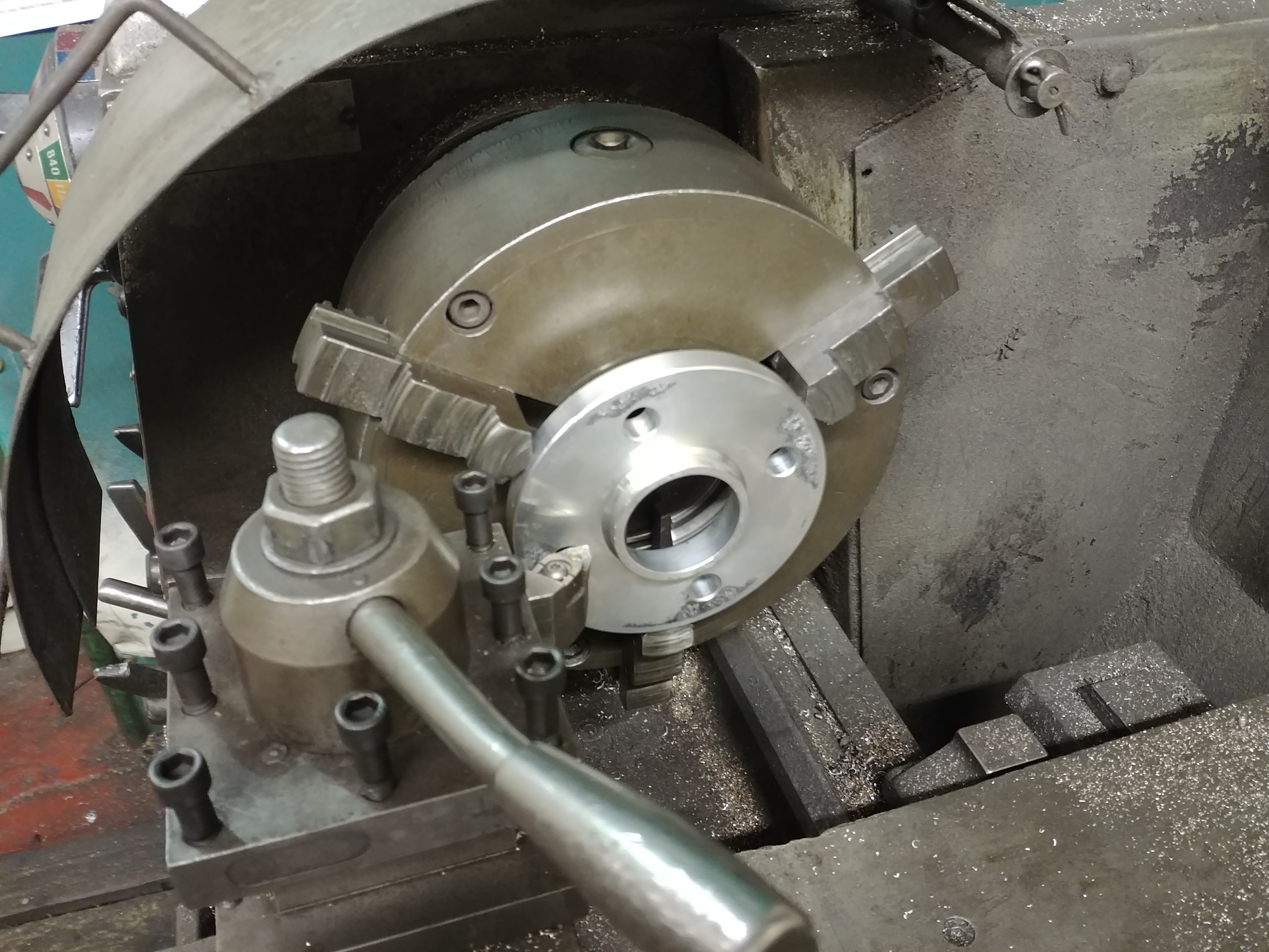

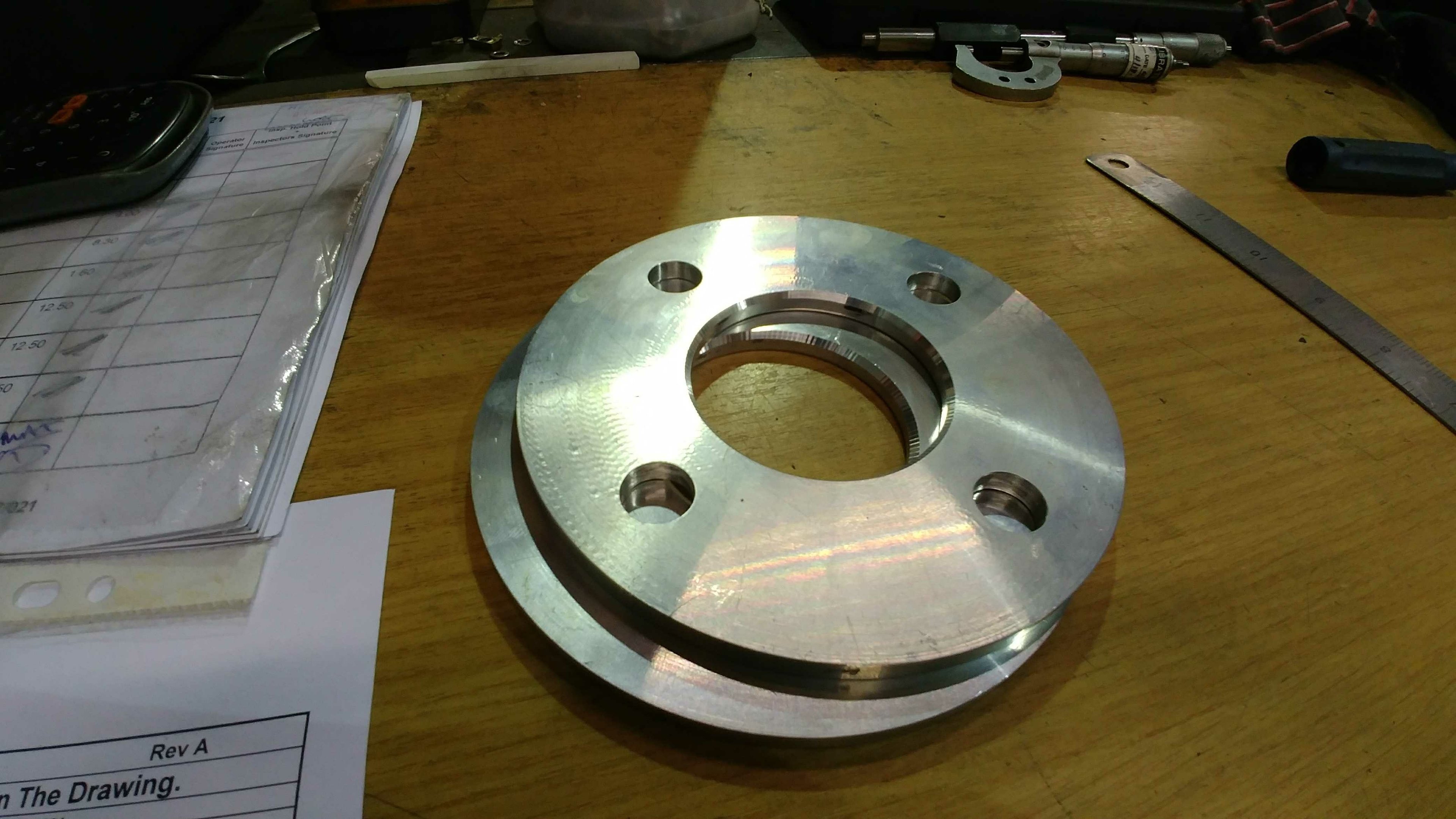

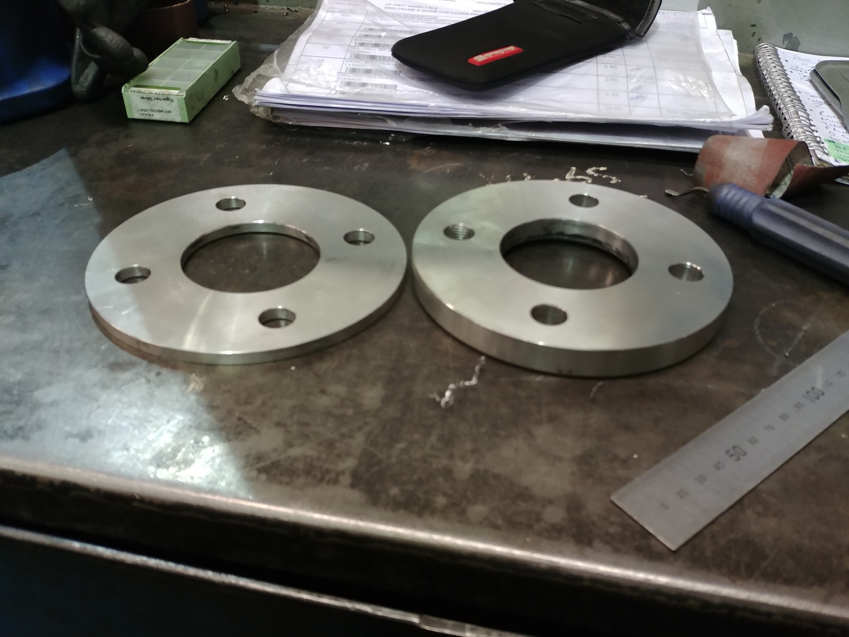

As the spacers were fucked anyway I may as well turn them down at work. It only took me half an hour to remember how to use the lathe. Well it was 26 years ago when I last used one! Good job turning is a piece of piss. :cool:
Finished at 6mm thick and a lovely job, if I do say so myself:laughing:. I've just got to summon up the bravery to fit them!

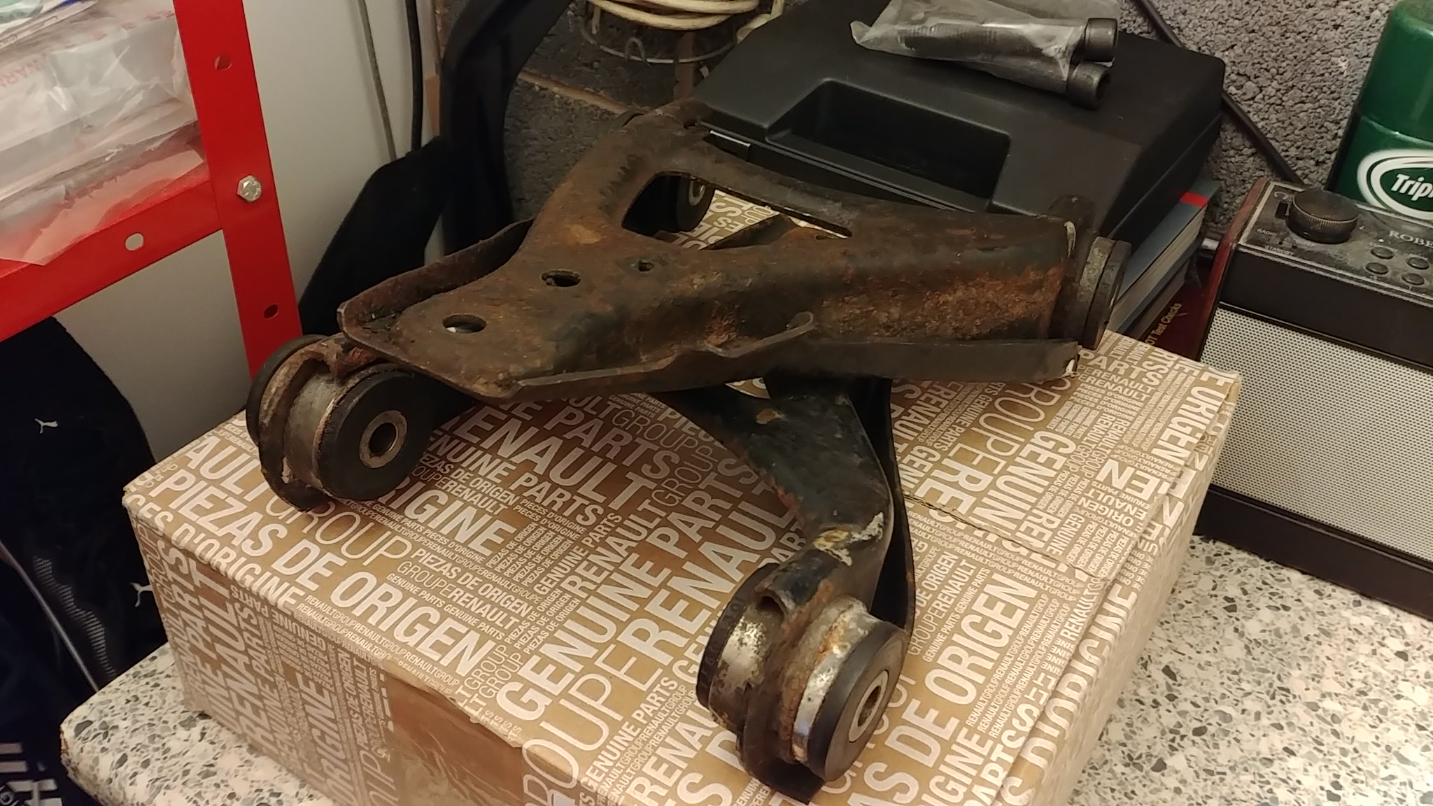

What a bunch of c***s! I've still not looked at the rear suspension, I'd forgotten about it until yesterday when on my way home I heard the tyres scraping on the arch. This ain't the time of year to be pulling the car apart on the drive though!

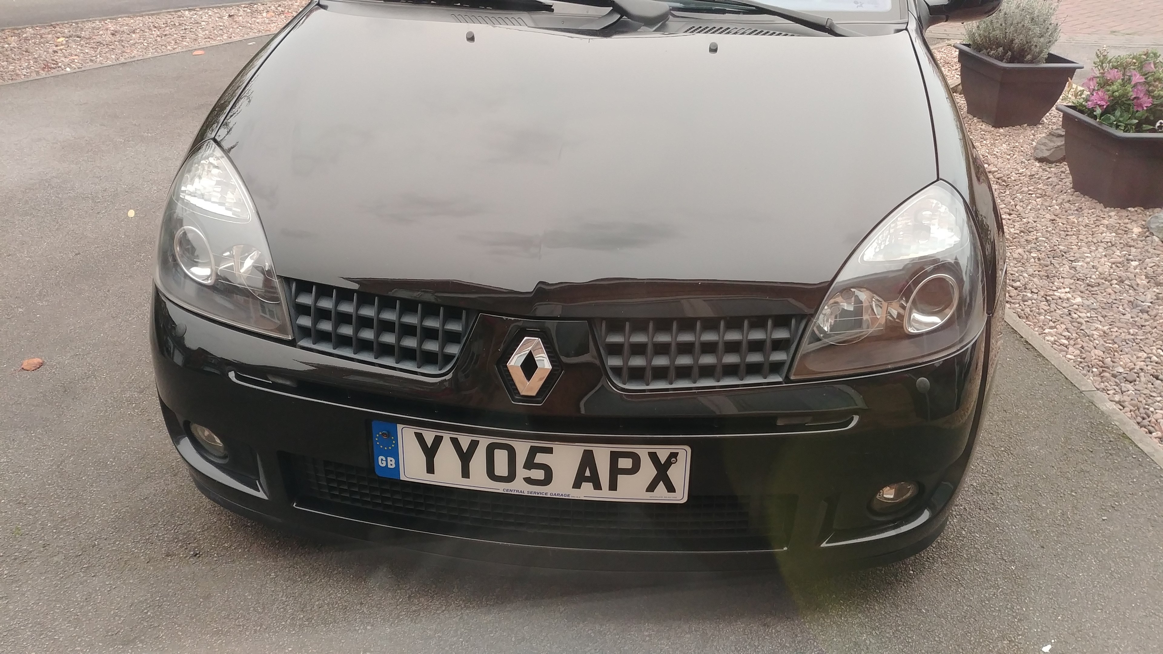

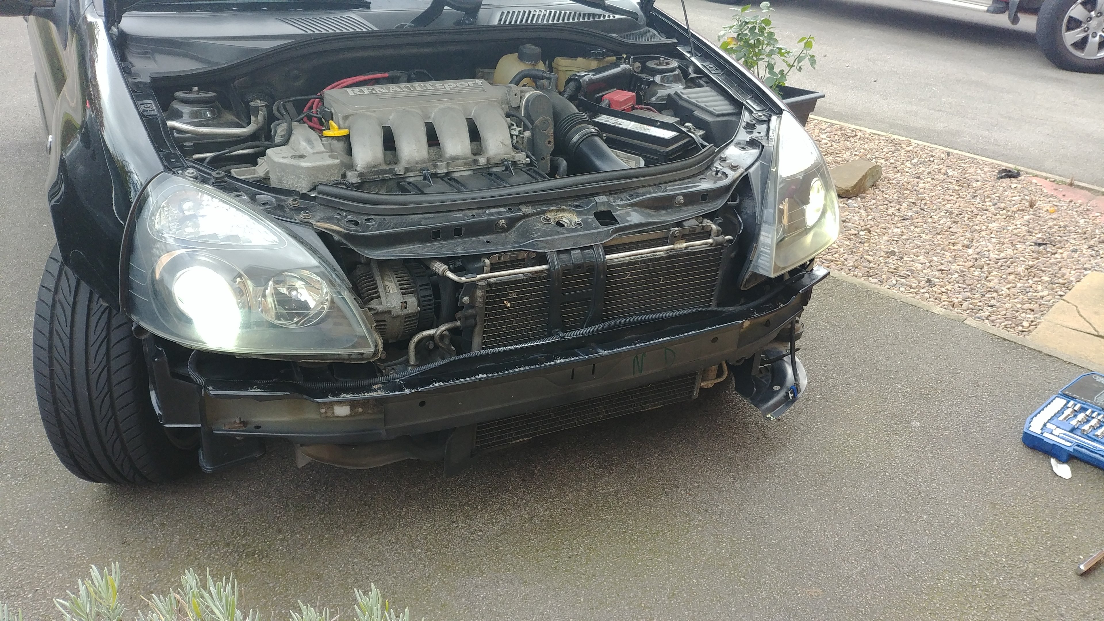

When we went to cars in the park at Lotherton the other month I noticed that my headlamps were different colours. I'd given them a polish before trax so it wasn't because of the lenses so I ordered new bulbs. I had a quiet Saturday (meaning the wife was out ) so set about changing them. Bumper off and lights out I carefully swapped the bulbs. The old ones were a matching pair so seemed odd that they look different. A quick test before bolting the lights back in and... they are still different colours! It must be s**t in the lens or something so looks like I'll be hunting for a new headlamp at some point.
While the bumper was off I decided to see if I could reattach the drivers side arch liner that had fallen off. I'd already got some new speed clips and screws and after a bit of trimming off the edge that had worn down rubbing on the road it turned out it would fit back on☺️. I'm just waiting for some clips to secure it to the inner arch then I'll refit it to keep the winter crap at bay a bit.
Last job to do before refitting the bumper was to remove the headlamp washers. I saw going to do this before the MOT, in March! All back together and a quick wash and some SRP on the bumper where the washers had been for the last 12 years and it had been a reasonably productive Saturday.

Why the headlamp jet removal? Was they leaking or you wanted a cleaner look? Either way, they look better.
Odd about your headlamps being different colours though.
Clio_fool
There's always jobs to do Paul. It's just weather you can be bothered to do them!
Lol, I find myself seriously lacking the motivation to crawl around on the floor under a car these days!
The headlamp washers have not worked in my ownership so easy option to remove them. The headlamp colour is a puzzle. I tried a different ballast and ignitor and I even plugged them into the opposite side but the passenger light was always duller. There's other jobs I want to do first so they will have to do for winter.
