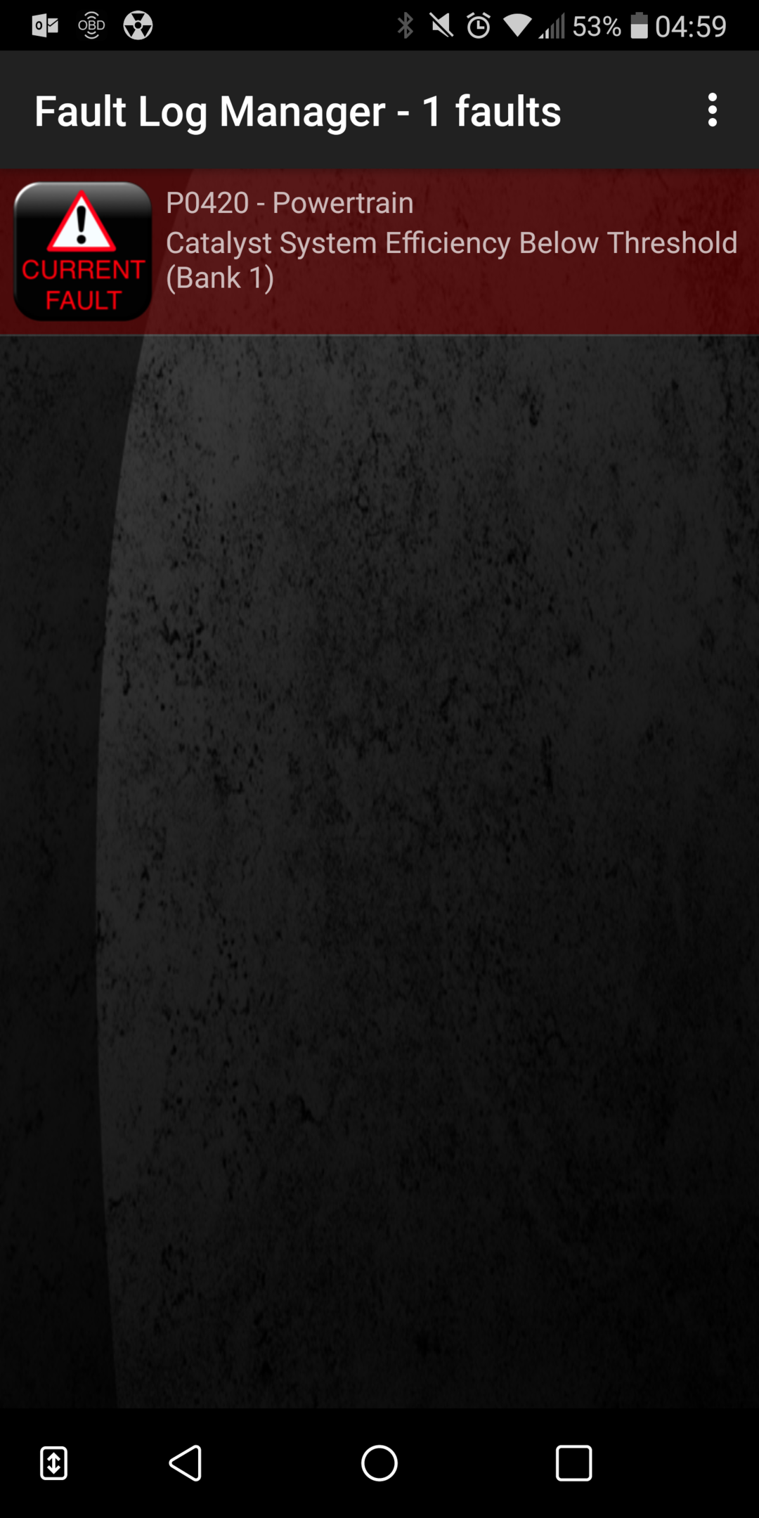

Eml came in this morning when I was a mile from home. And stayed on. Did a quick scan and got this:View attachment 1375846
Could my cat be fooked after 3 months and 4k miles? I think I'll be back at the garage on Friday for a refund.
Was it a genuine cat you fitted as I have heard the non standard cats can be very hit and miss unfortunately mate :(

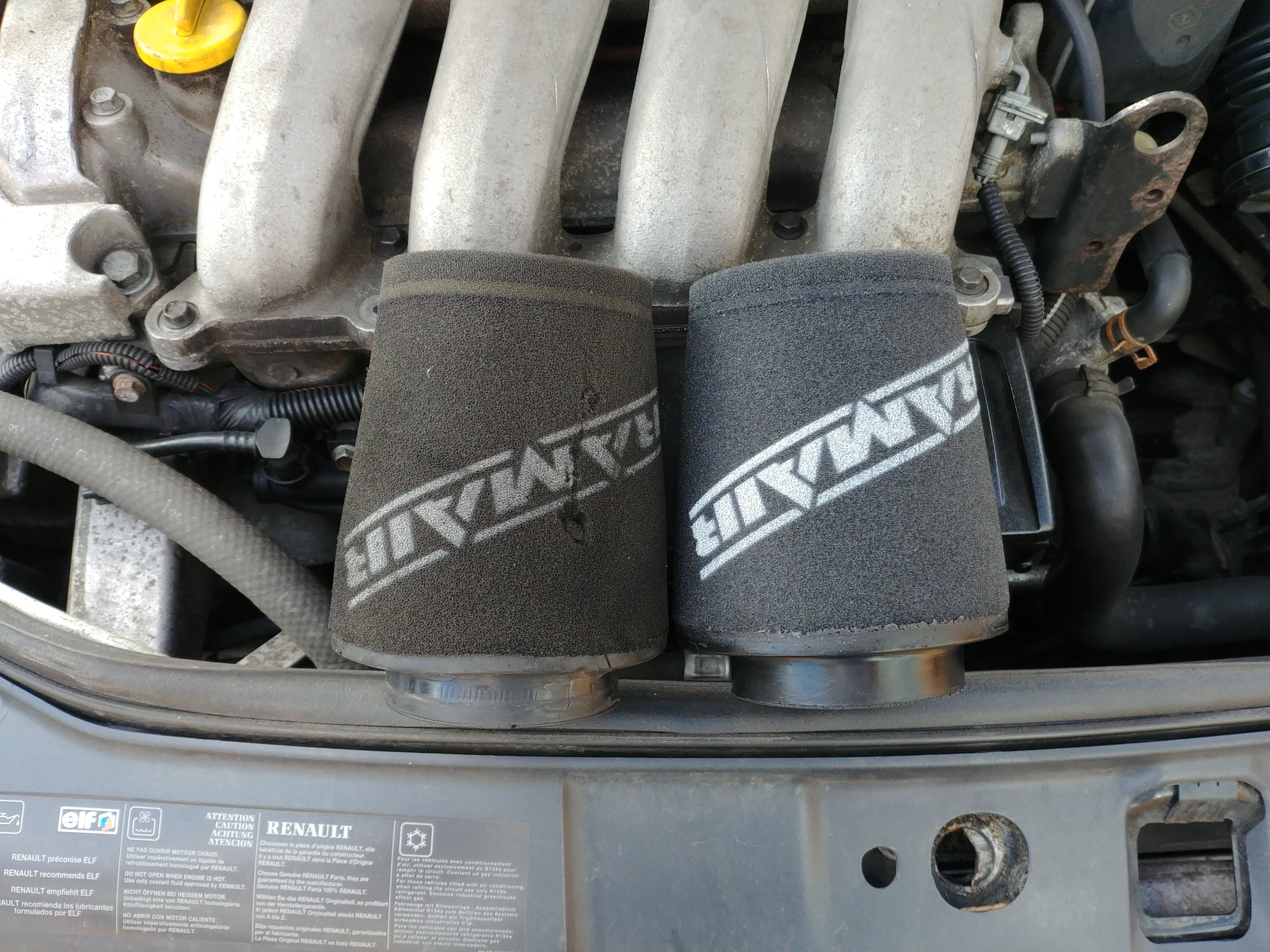

Nothing much has happened with the car, not even washed it for ages?. Bought a new air filter as I noticed mine had a split in the rubber base. Stuck with the ramair one but had a struggle to fit it. The neck was smooth and greasy and the jubilee clip kept slipping off. I had to recruit my son to hold the filter while I held the clip and tightened it. Jesus you'd have thought I'd asked him to crawl under the car and clean it with a tooth brush?.
I didn't think the old one looked too dirty but side by side is a fair bit darker.

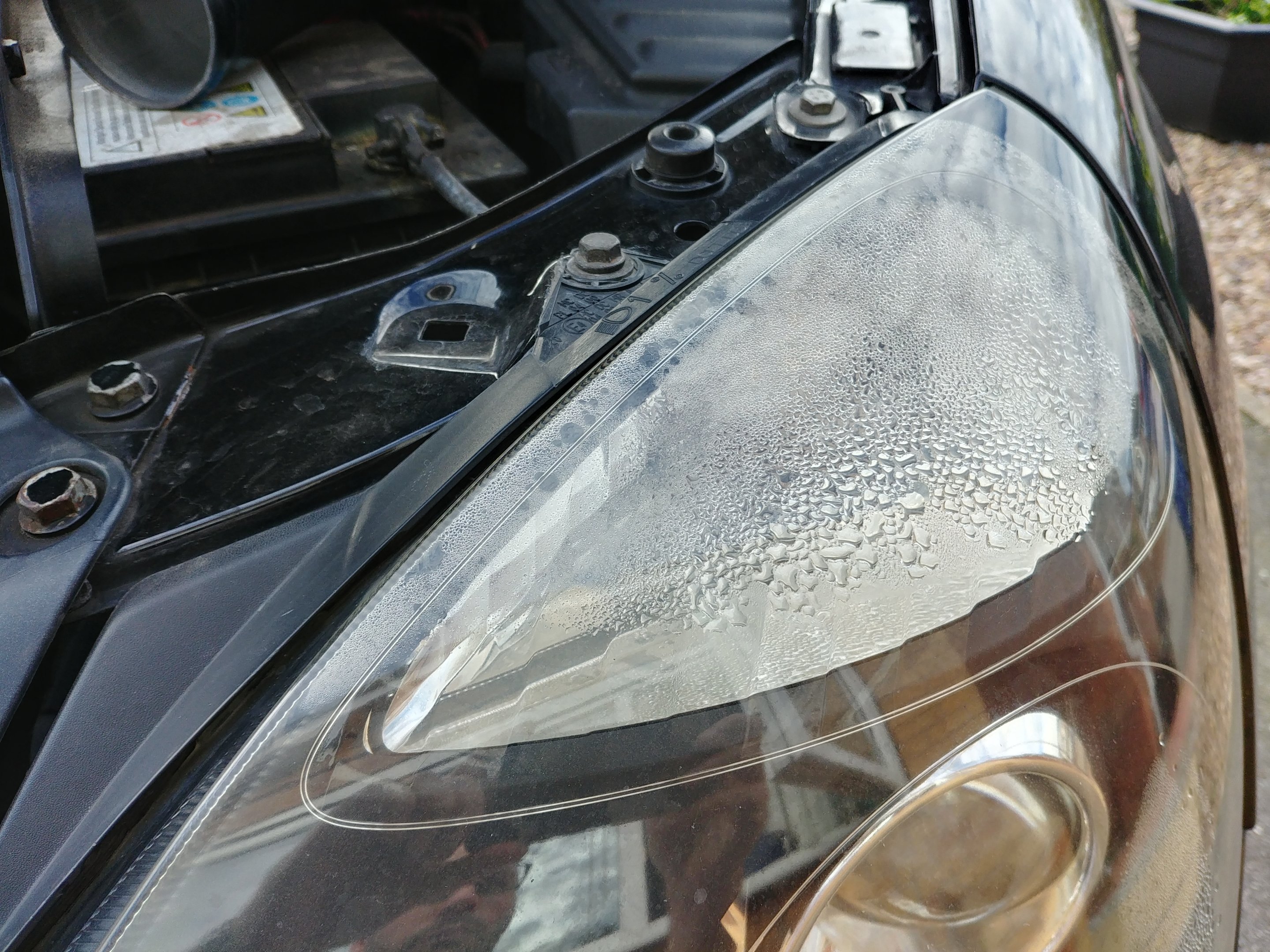

One thing that will be fitted is new headlamps. I'm picking a pair up next week and they will be going straight on. Mine are really getting on my tits now.
The other night that was fully covered in water droplets, yes it's on the inside!

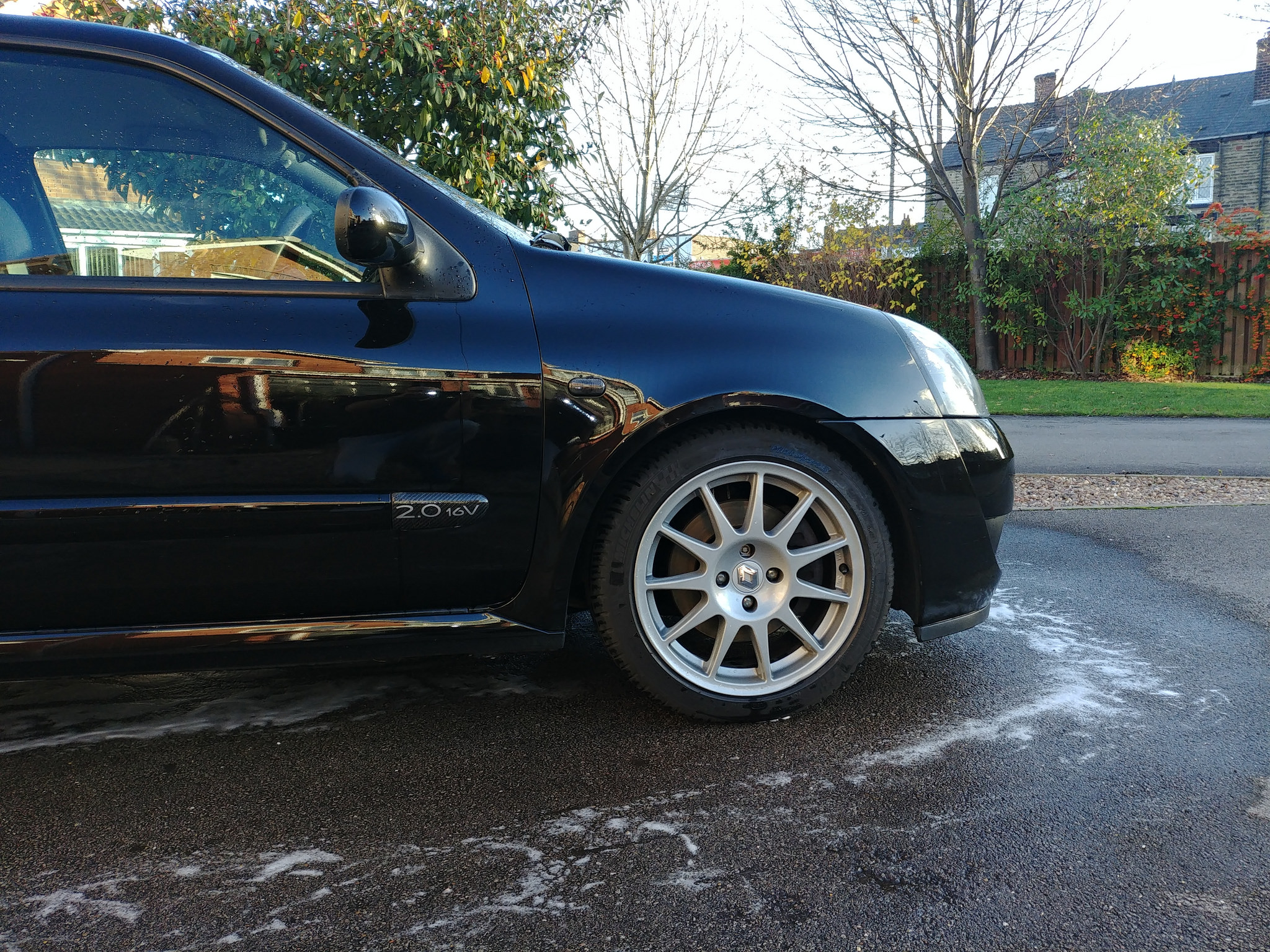

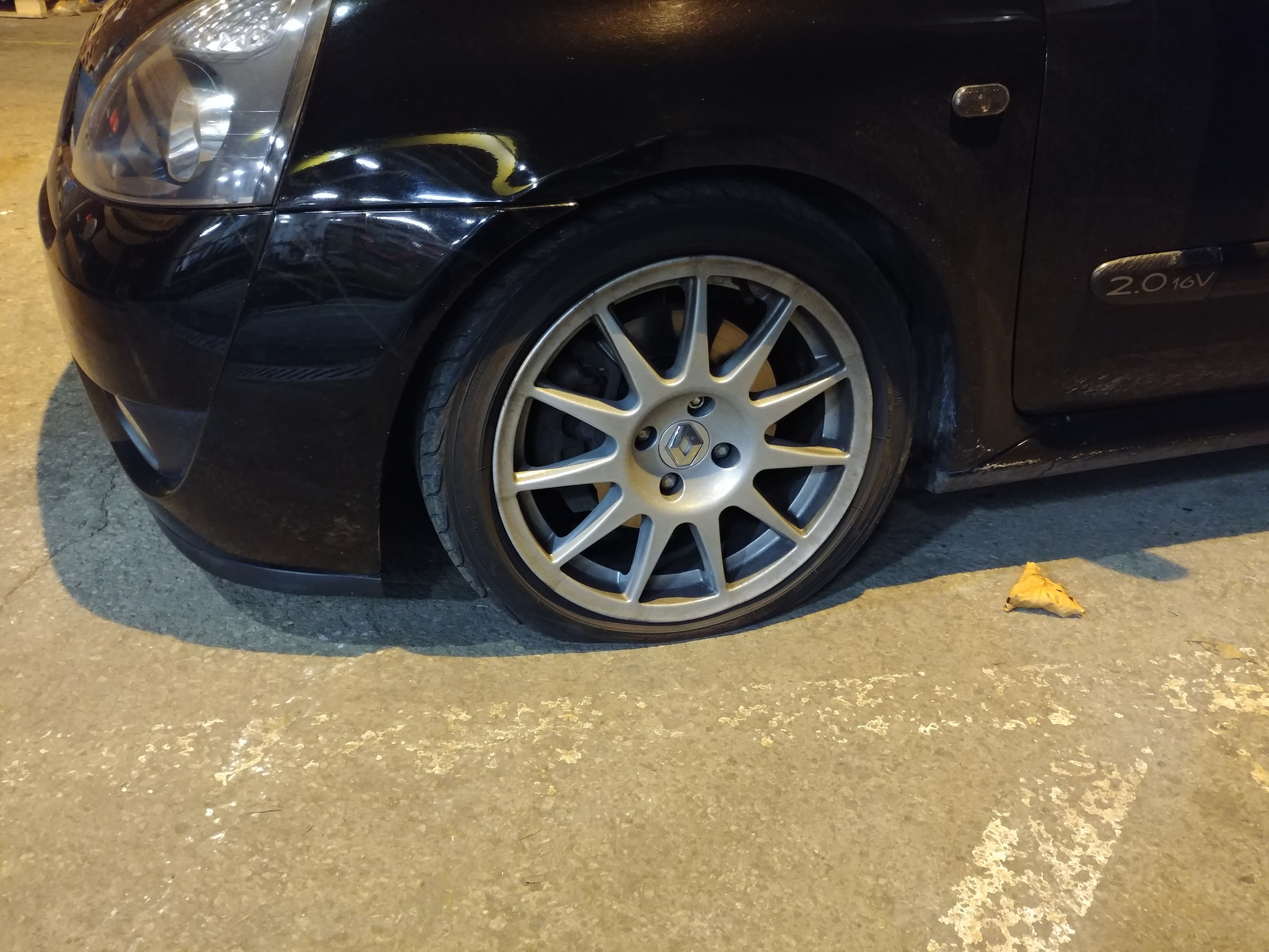

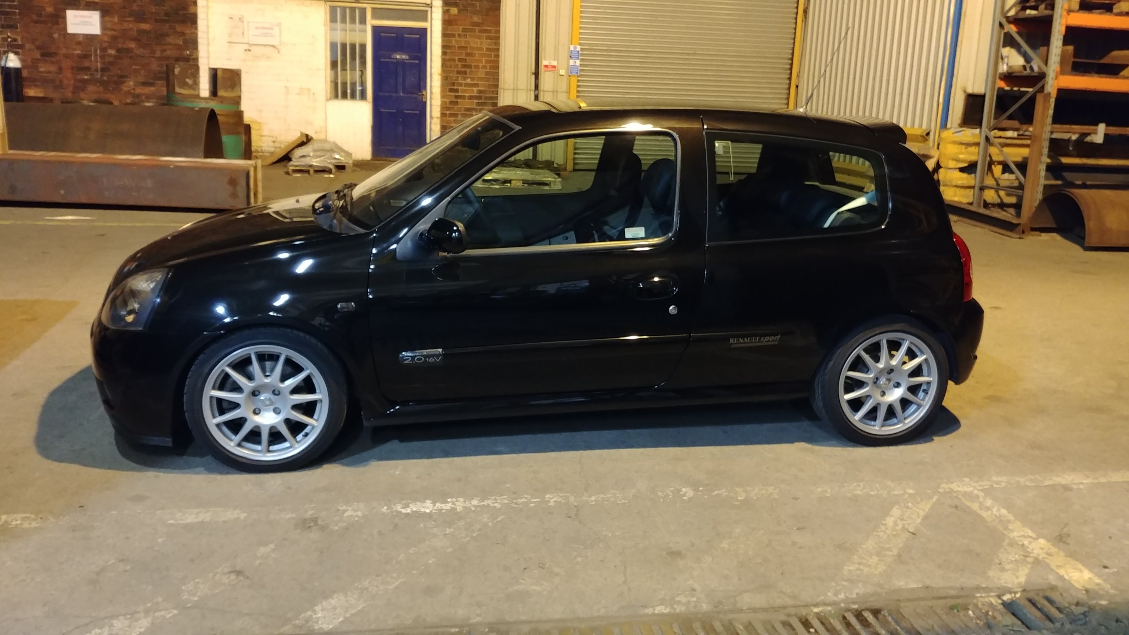

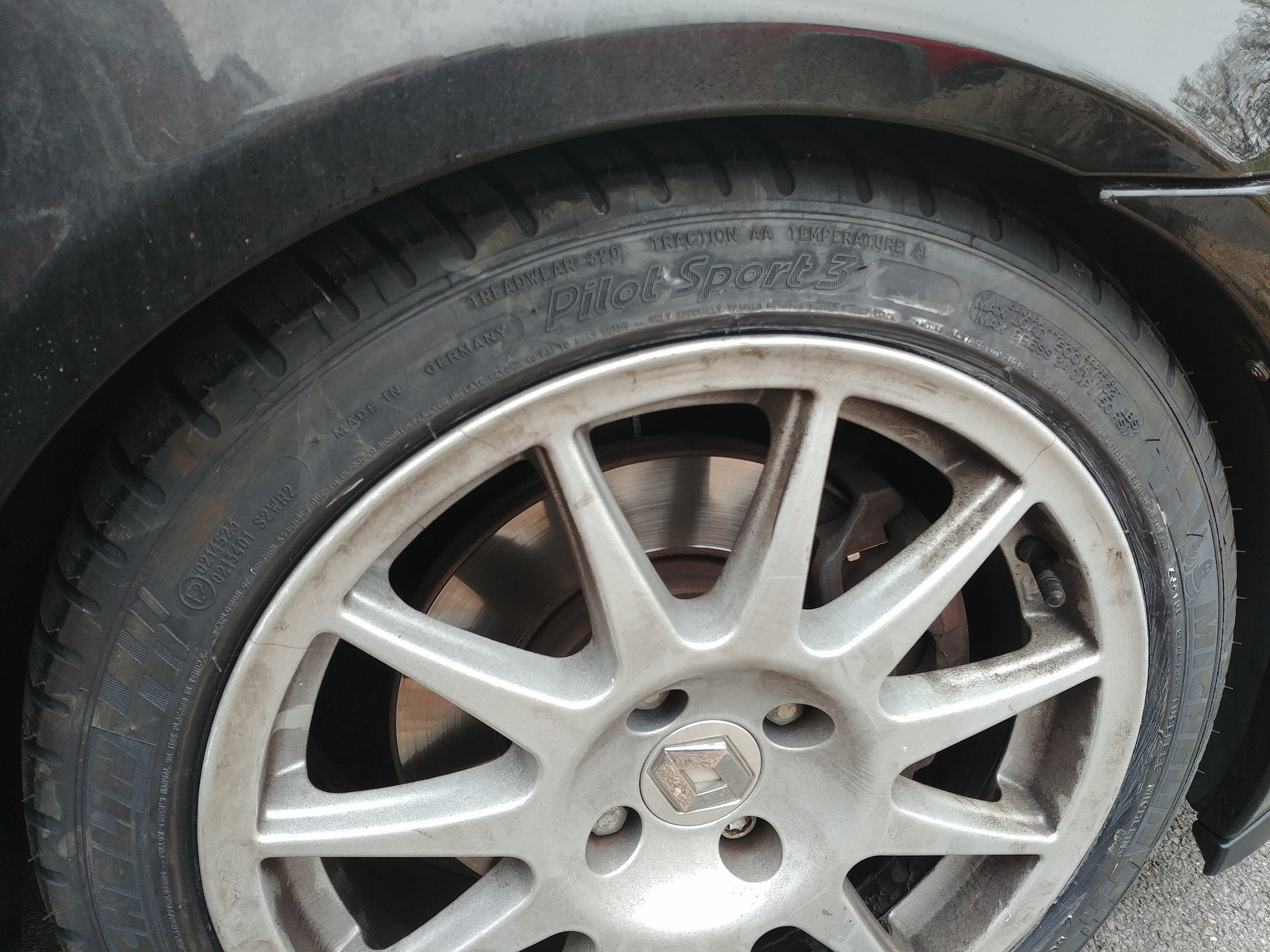

Got a puncture last Thursday night. Looked like I picked up a screw in the yard at work?. Luckily we have a tyre pump on the compressor and the tyre stayed up long enough for me to get home. So Friday I took the wheel off and went to kwik s**t for a repair. Out comes the special gauge and surprise surprise it's too close to the edge for a plug. All they had were budget crap so off home I went to search for a replacement. Annoyingly all the big tyre places could'nt get me a tyre for 5 days and only one could get S-Drives. So I rang a local place I've not used since they broke my locking nut key years ago and they got two Michelin PS3's for me the next day!
20181105_123849
Yeah I know, they don't look new?. Car is filthy as usual. Current mileage is 104291so lets see how long they last. The yokos have been on just over a year and probably had 3mm left. I've averaged 24 miles a day since the car hit 100k and not much of that has been for fun. ?

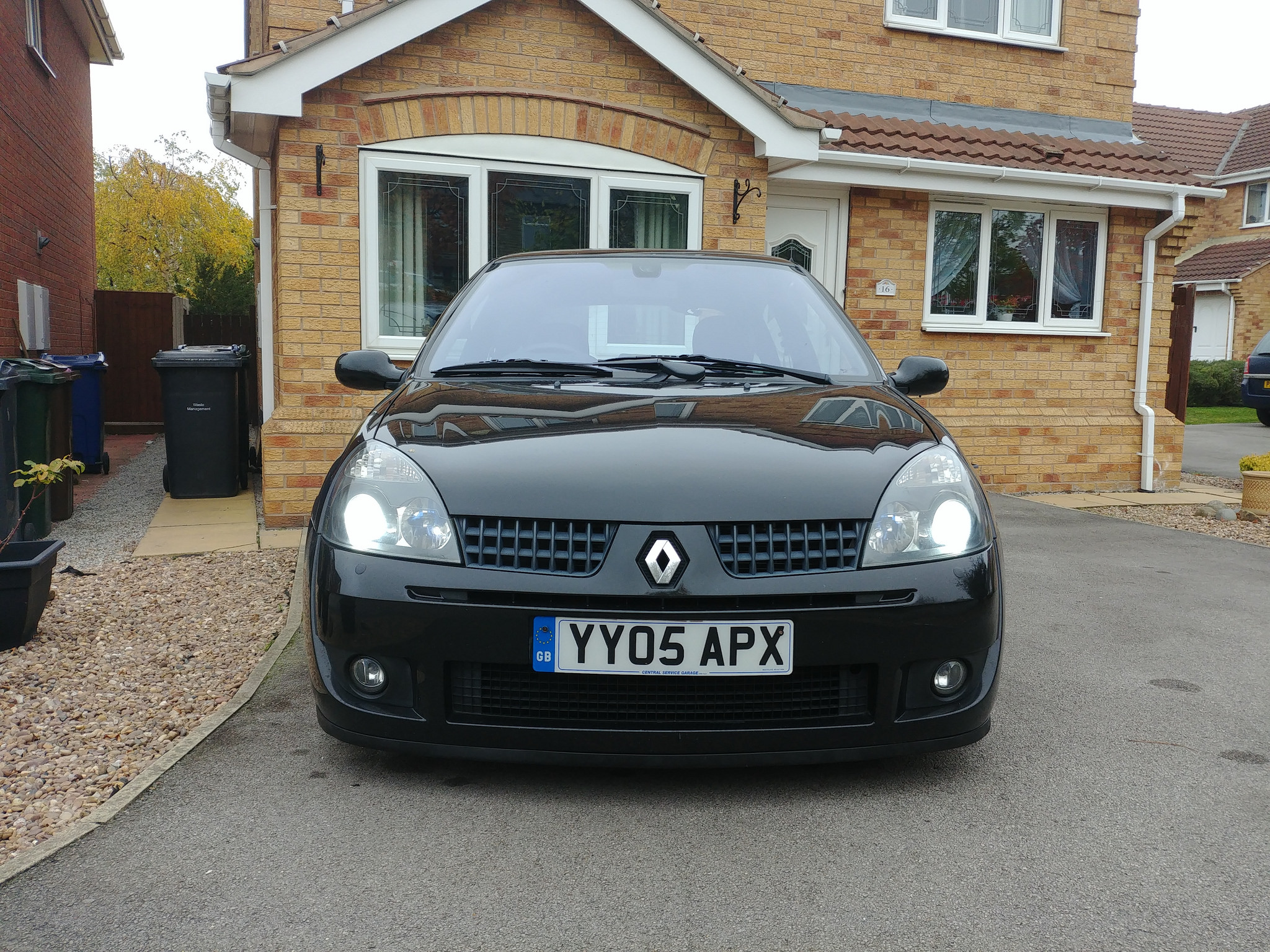

In other news the gold fish got flushed as it no longer has a home?. I collected a pair of headlamps from @dCi_rep last week and swapped them over immediately! Thanks for the good deal Kyle?

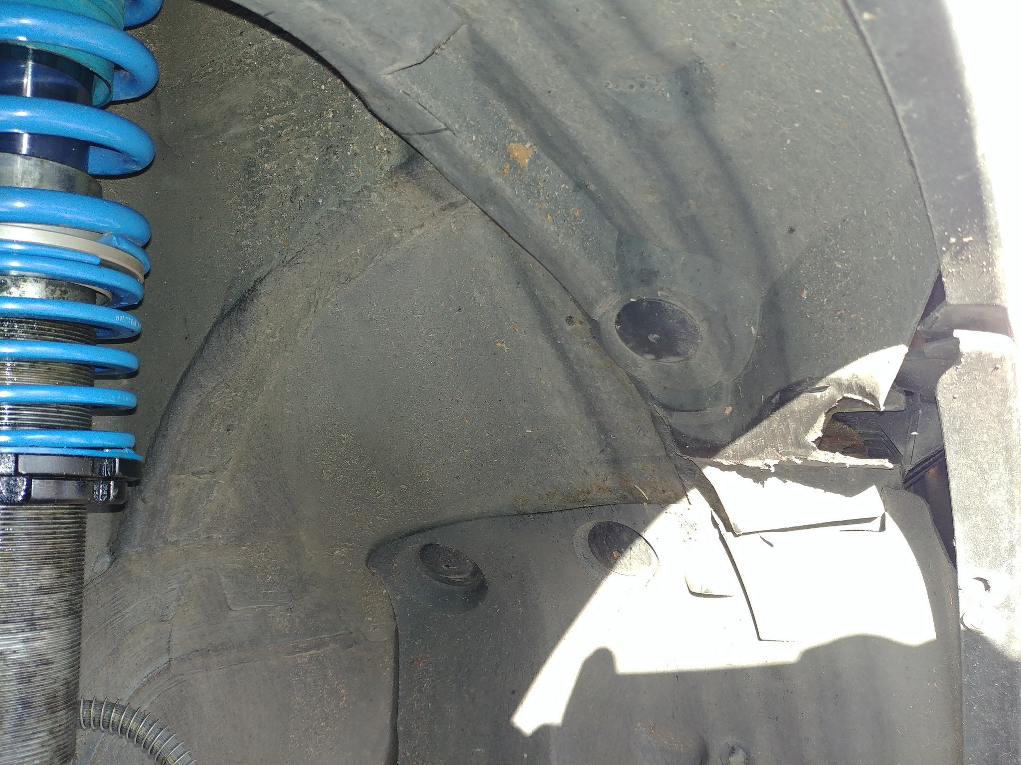

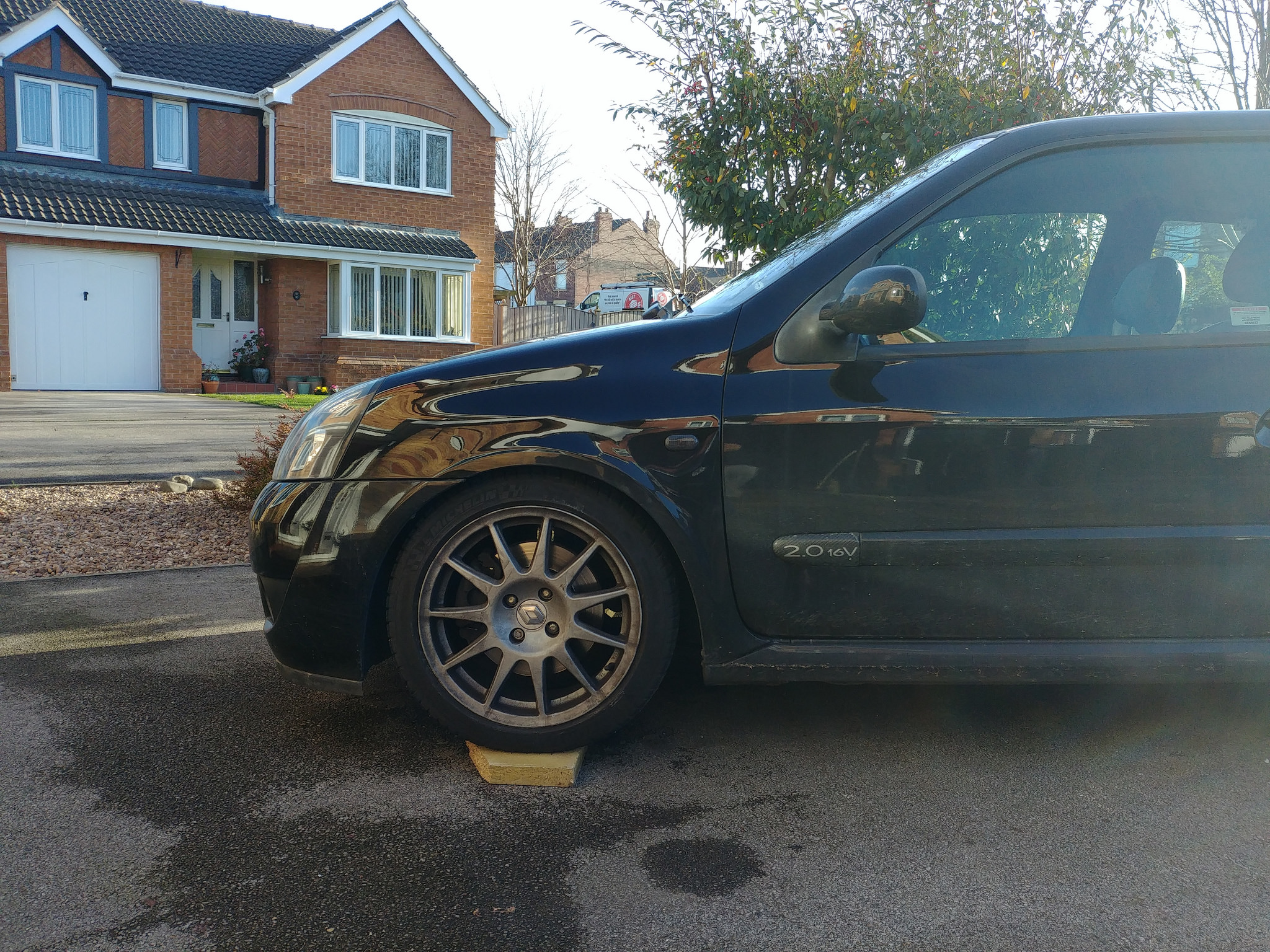

Ive got the same rubbing from when i got the PS3's fitted,also had S-Drives on before.Strange as same size tyre
Yeah very strange, I'd even say the S-drive have a more square shoulder to them so if anything they should rub. Maybe the PS3 diameter is slightly bigger?

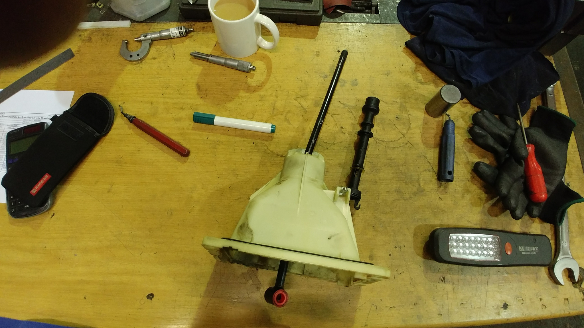

While the car was up in the air I had Carl fit my scenic shifter. Now I've had this a long time so it was due some progress!
20170921_032158 by Paul Dent, on Flickr
I had also purchased a MK1 172 shifter as I wanted the ball for my frankenshifter. God knows how I didn't lose it as I must have bought it over 2 years ago now?

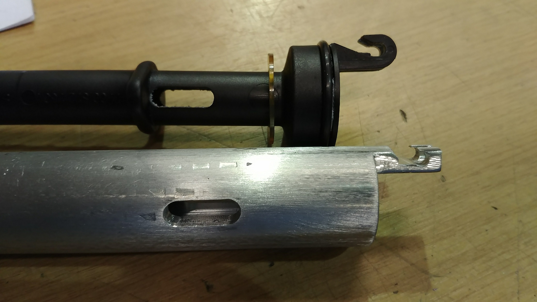

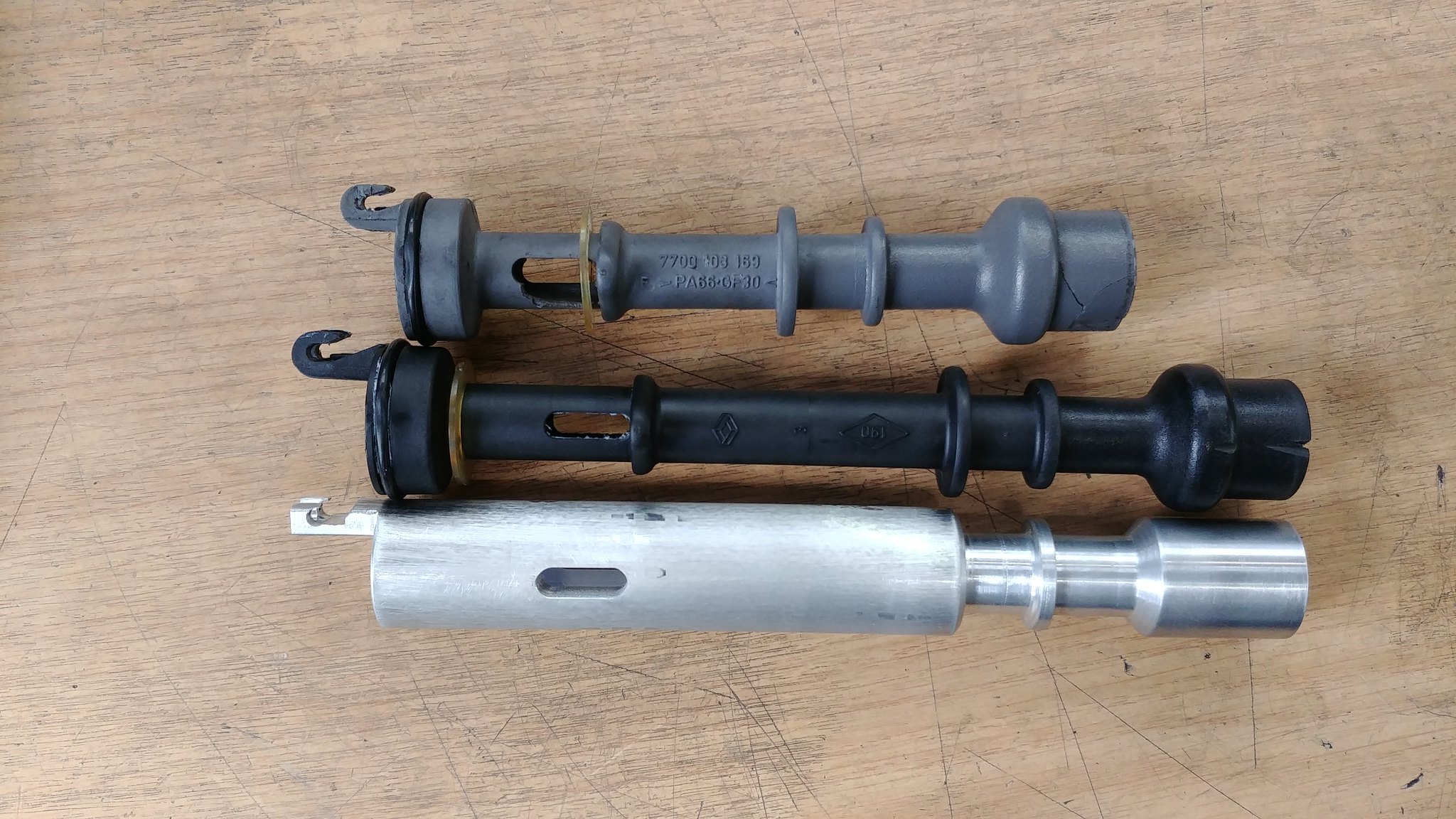

Every custom shifter needs a fancy outer shaft, right? So a siutable aluminium tube was aquired? and back on the lathe i went.
20171012_013144 by Paul Dent, on Flickr

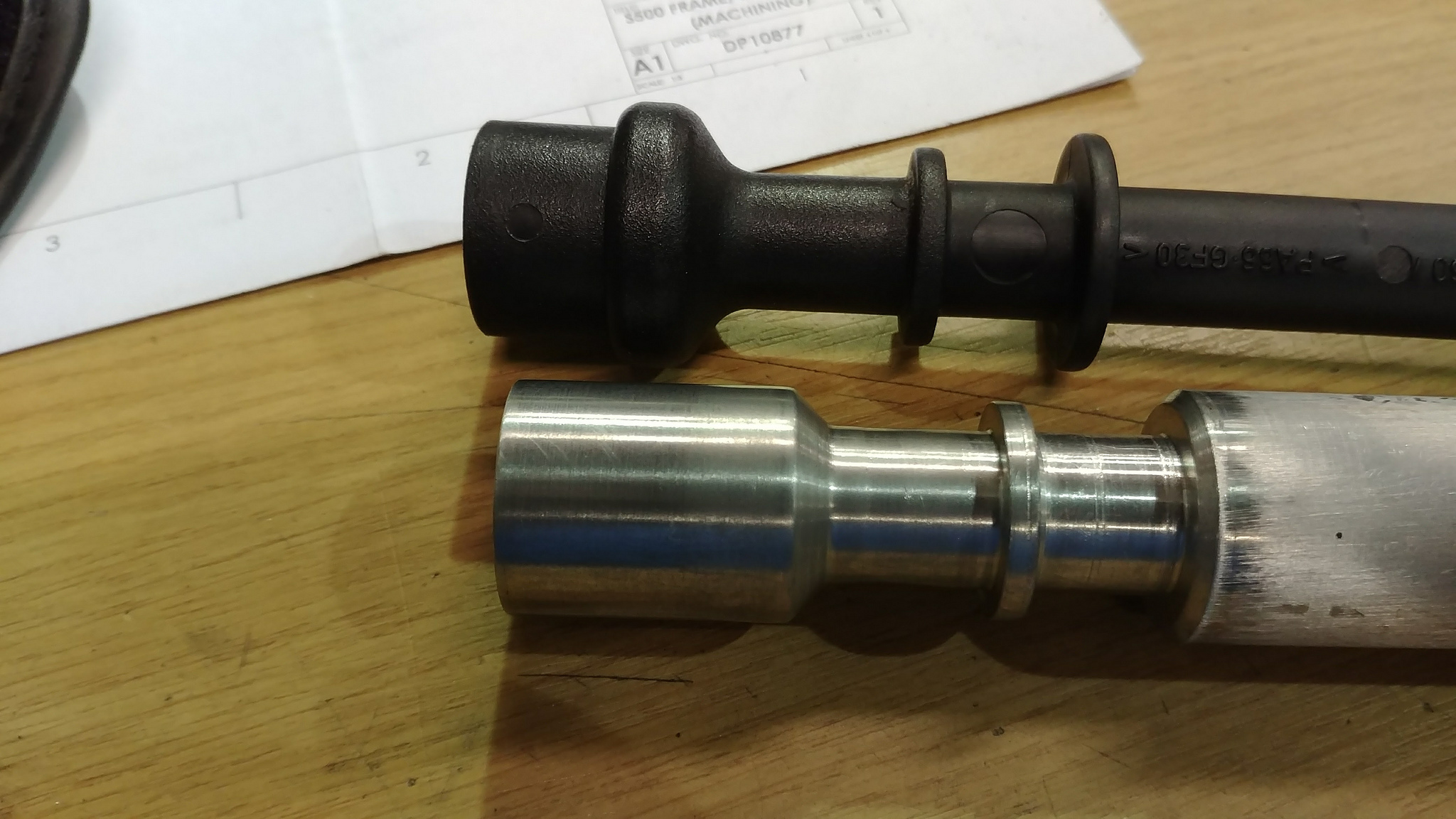

I'm not a fan of the extra shaft length visible above the gaiter so I made it to the same dimensions as the original scenic outer. However the original lift up taper didn't feel right with the ball so I extended that a little and it feels perfect now it's finally fitted. That leaves the lift up reverse ccable to secure somehow. I could have tapped a hole in the shaft and secured it that way, but wheres the fun in that? And I have a milling machine at my disposal so...
20171012_005804 by Paul Dent, on Flickr
A neat little notch made for the cable to sit in and the slot for the pin milled in the sides. Lovely!

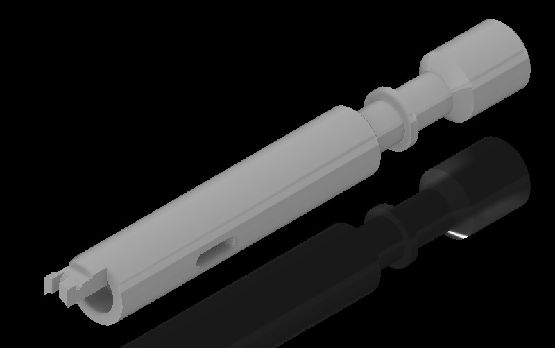

Clio, Scenic and Oss outers together so you can see how much taller the scenic one is. And I even did a CAD drawing of it for future refrence!
Shifter outer CAD by Paul Dent, on Flickr

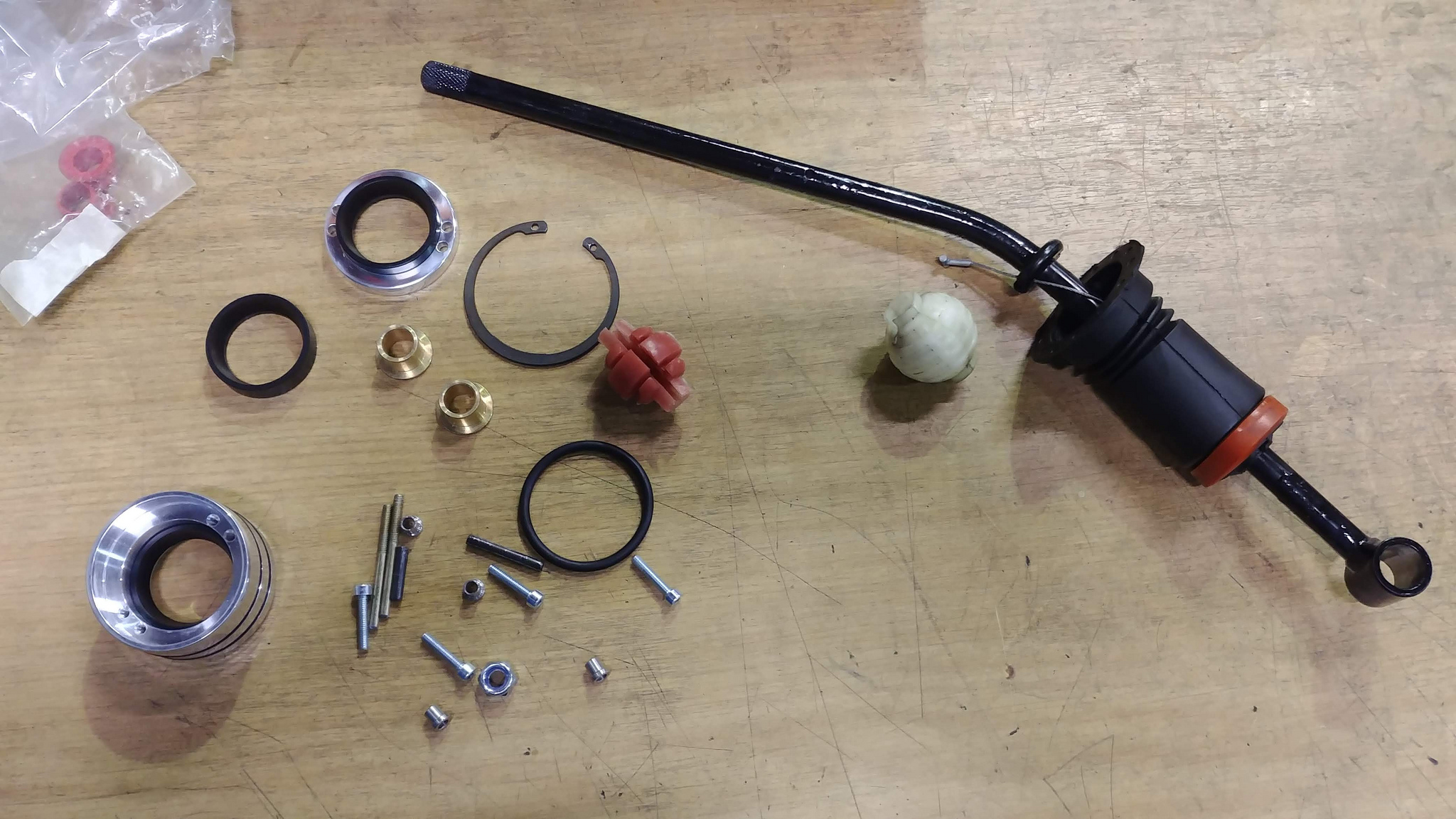

So that's the top half sorted so onto the oily bits. I looked at the standard ball and it didn't seem like it would suffer from wear so replacing it with a new one wouldn't make any difference to the feel of the shift so I planned to fit a Yanoo stiff shift kit. Yanoo recomends the adjustable stiff shift 3 acompanied by brass bushes for the lower pivot and short shift to keep the change action similar to standard. The full kit popped up for sale on CS brand new for a discounted price so I jumped on it and it was tucked away in my parts box for a few months. I've got to say it's a quality piece of kit and very well made and now I've actually used it I would say it's definately worth the asking price.
20180713_185219 by Paul Dent, on Flickr

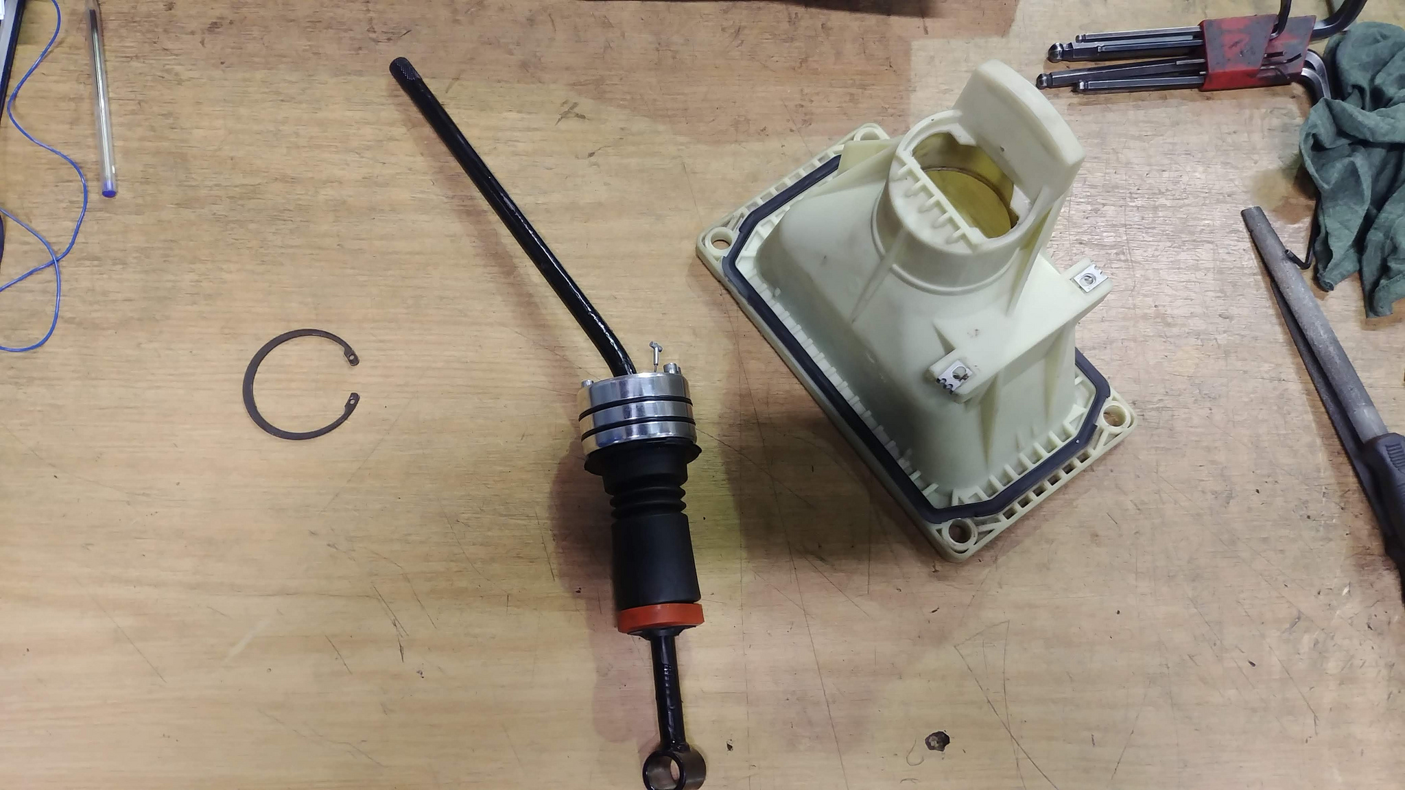

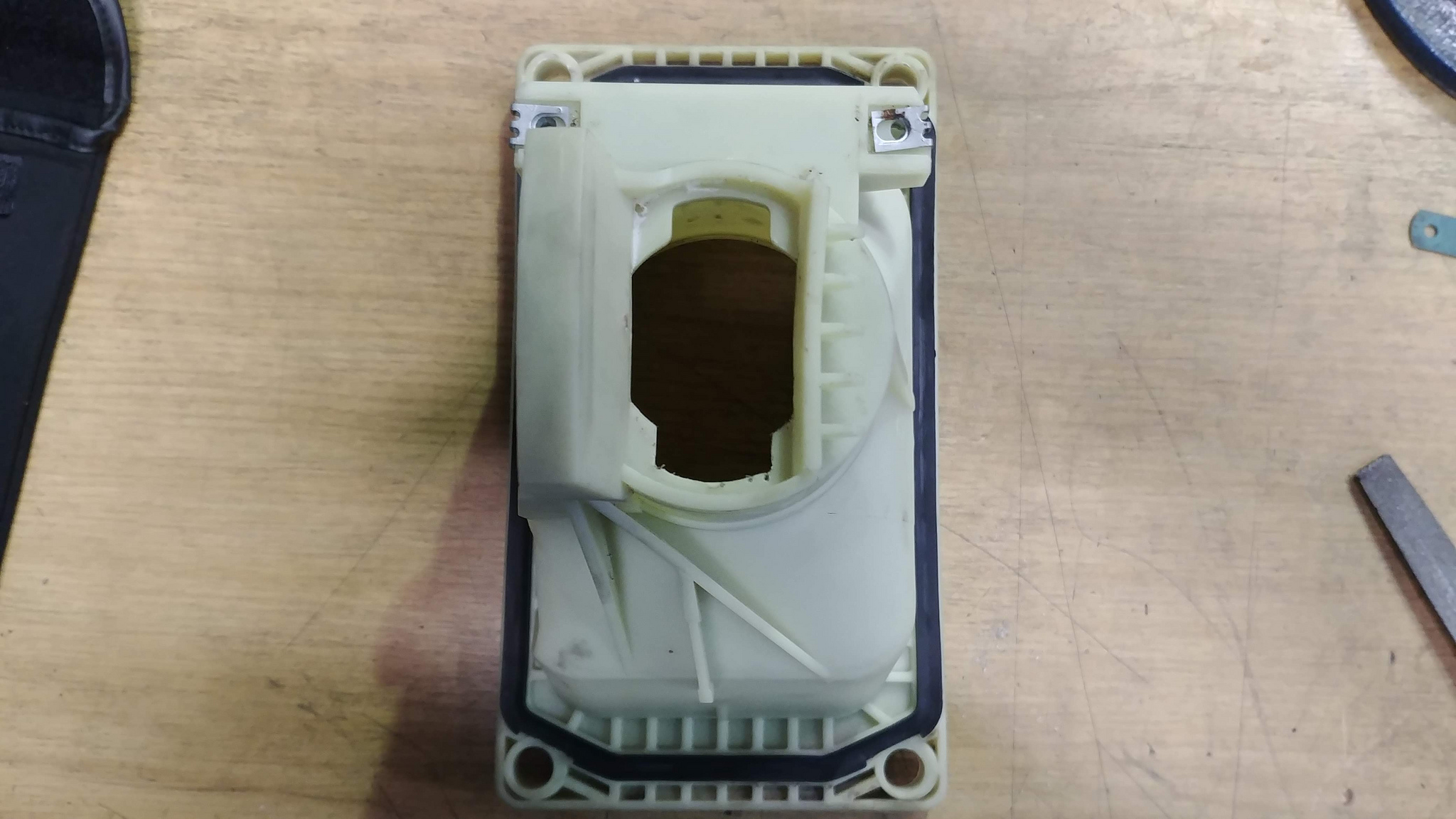

So clio and scenic levers removed from the housings and ready to be stripped to the bare bones and replaced by stiff shift 3!
20180815_010718 by Paul Dent, on Flickr
Very easy to fit the kit and reassemble the shaft into the housing. The housing only needs a notch making for the adjustment screws on one side. That big circlip to hold it all in turned out to be a 2 man job though!
