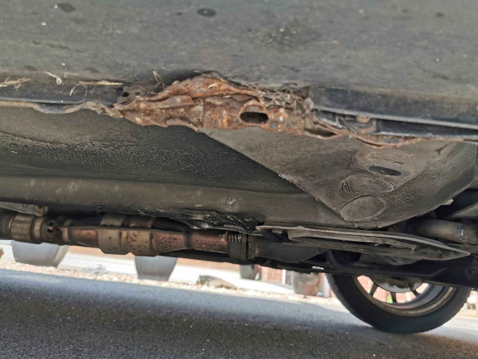

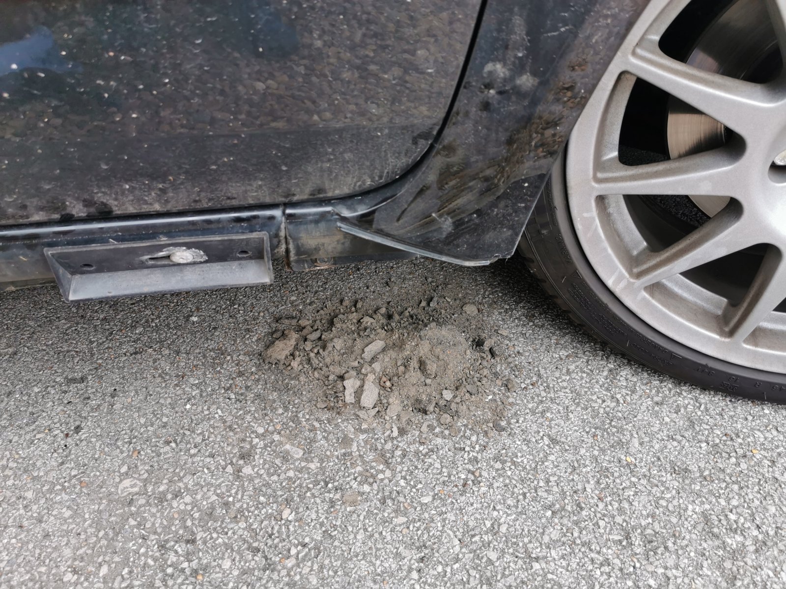

Noticed a gap by the side skirt a while ago but couldn't figure out what was the cause.
Well I figured it out today and it ain't pretty?.
Jacking point is completely squished. FML?. I'll have to take the side skirt off to sort it without risking damage to the skirt.

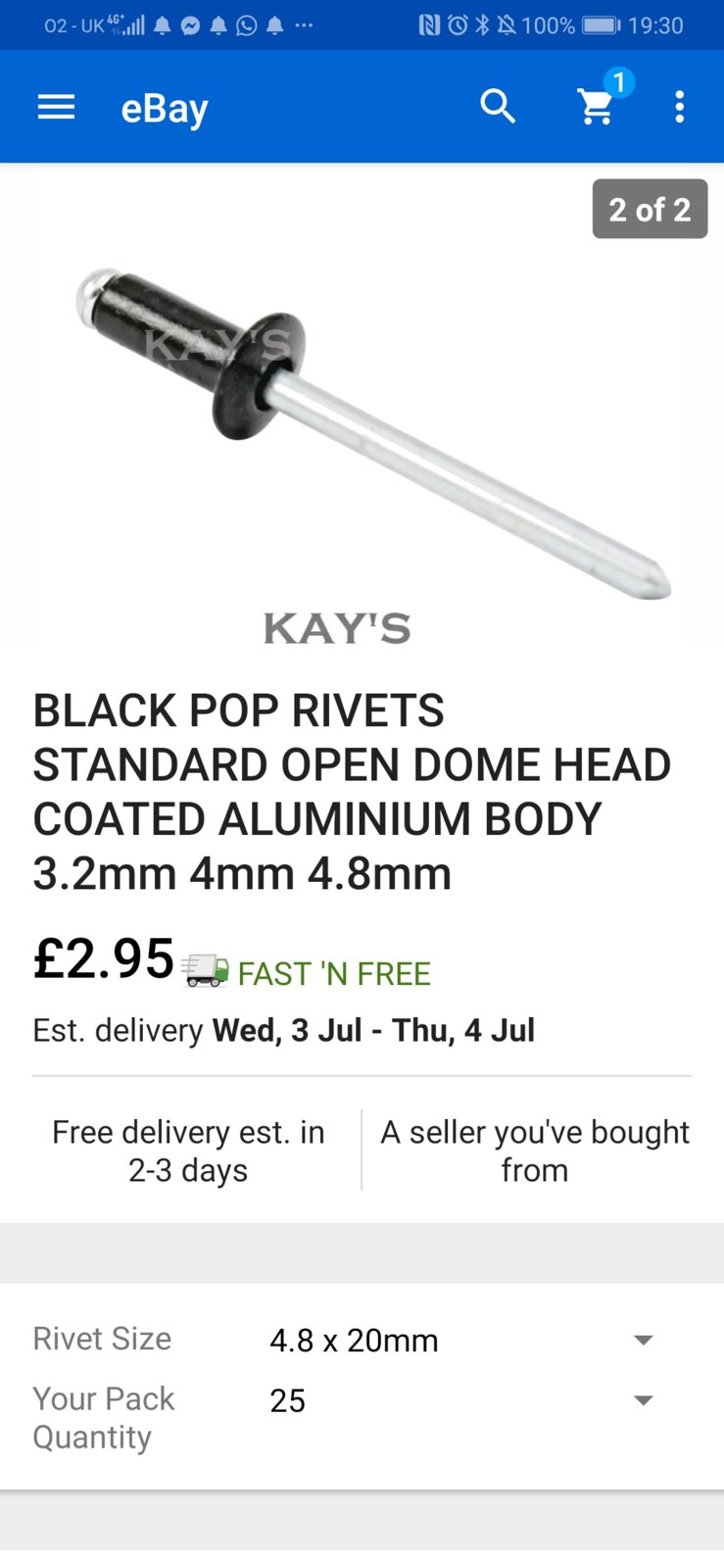

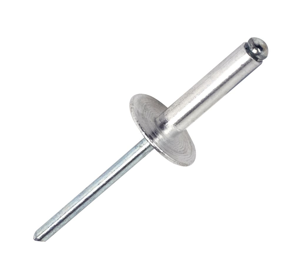

I had the same paul. All I did was remove the side skirt (2 torx on the edge behind the wheel and a few rivets down the skirt and it pulls off) and then use some mole grips to twist the jacking points as straight as I could. Then refitted. Just buy some normal rivets from toolstation or similar and paint them black. No one will know. Think I used 4.8mm x 20mm or 16mm, I cant remember now.

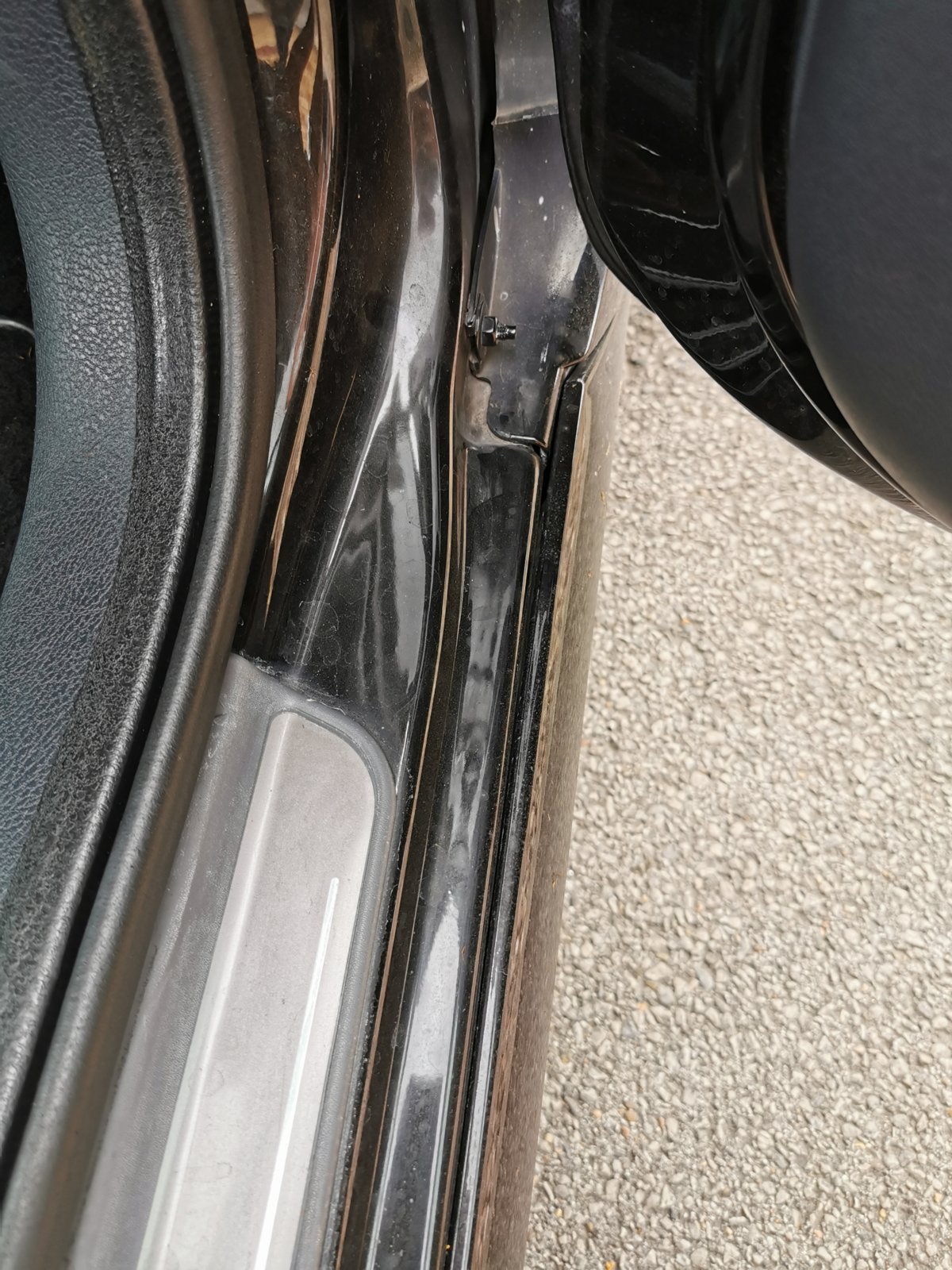

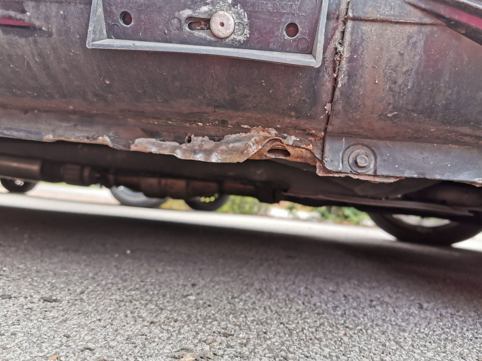

I took the side skirt off today and straightened out the Jacking point as best I could so the skirt will sit right again. It needs a proper fix before it gets battered even more when it needs to go to a garage for anything. At least its not rusted into dust yet.

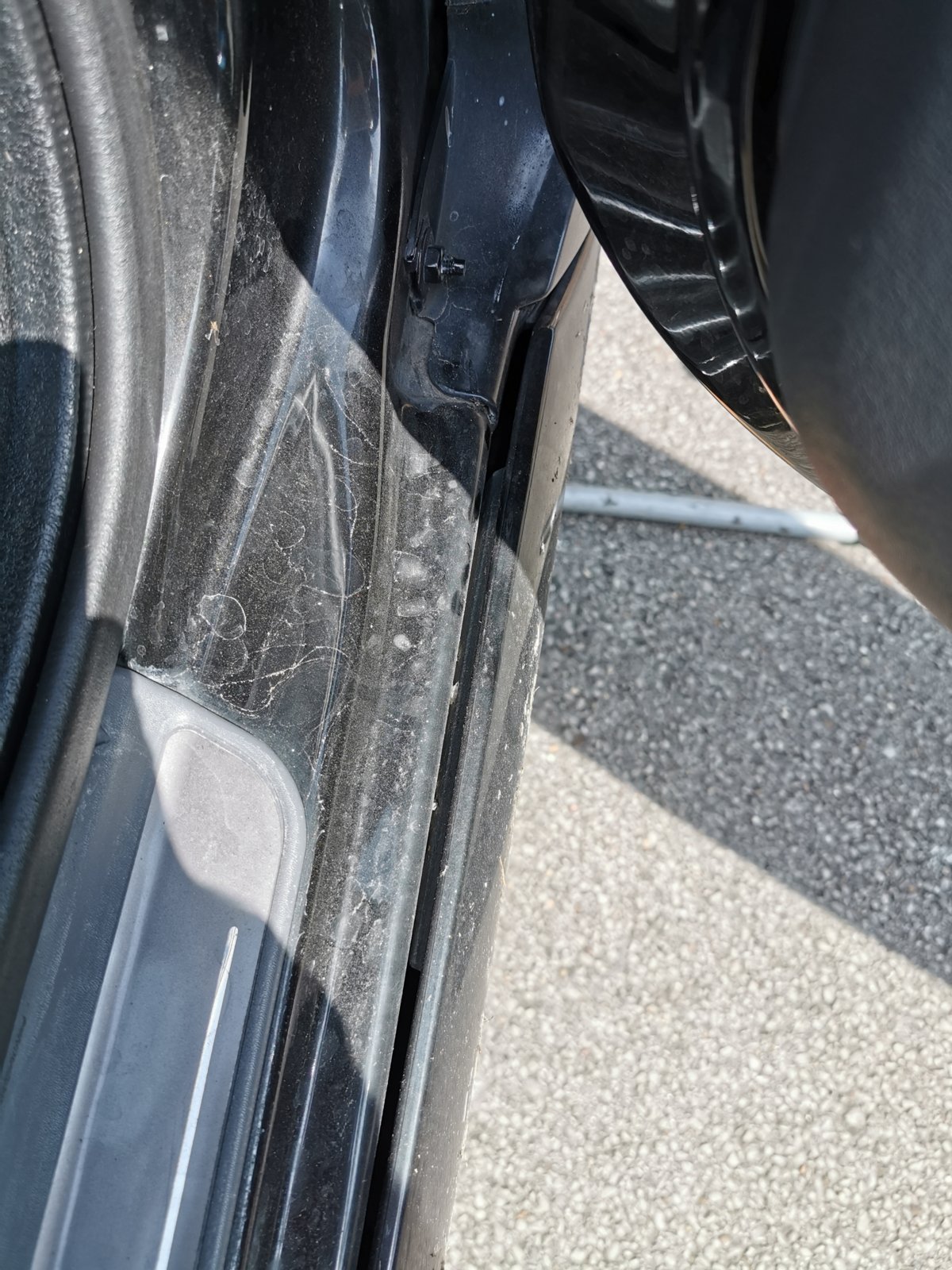

While I was there I undid the two bolts at the bottom of the front wing and holy cow was there a lot of crap in there!
I'll have to do the other side at some point as it's an easy way to save a couple of kg's! ?.
I then gave the car a quick wash and once it had dried I slapped some hammerite on the bare metal. I've got some bolts that will fit to hold the skirt on until I sort some rivets for it (probably in a year or so?) which I'll do tomorrow.

4.8x20 rivet are the ones you need mate.
Thanks mate for your help, I will get some ordered.
frayz
I’ve just ordered a box of black 14mm head peel rivets for these. You ideally want to use Peel rivets as they’re designed for clamping softer materials such as plastic and wood.
I’ll be doing this job soon and spraying the sills with Bilt Hamber before refitting.

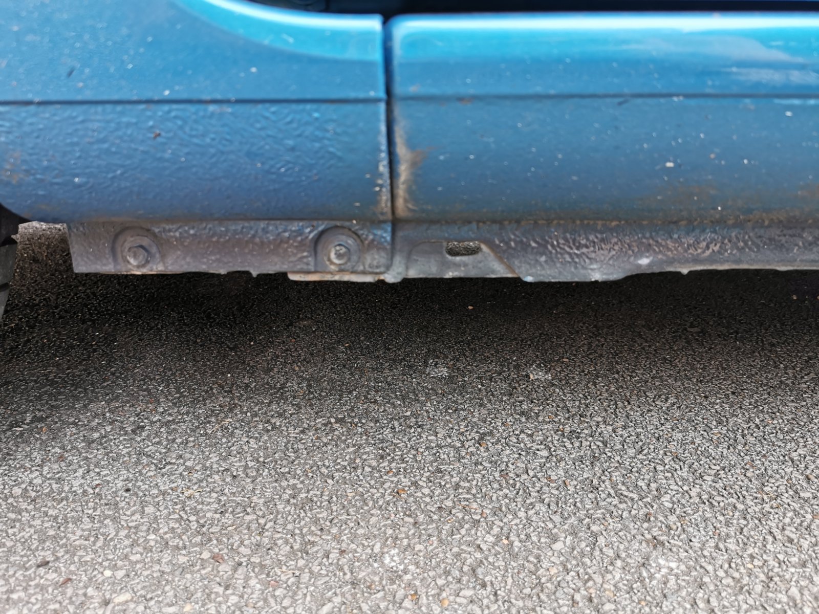

After having my leg stitched back on I refitted the side skirt and the big gap has gone?. I'll remove the other side one at some point just to clean all the crap out as it seems worth doing with all that accumulated that fell out.

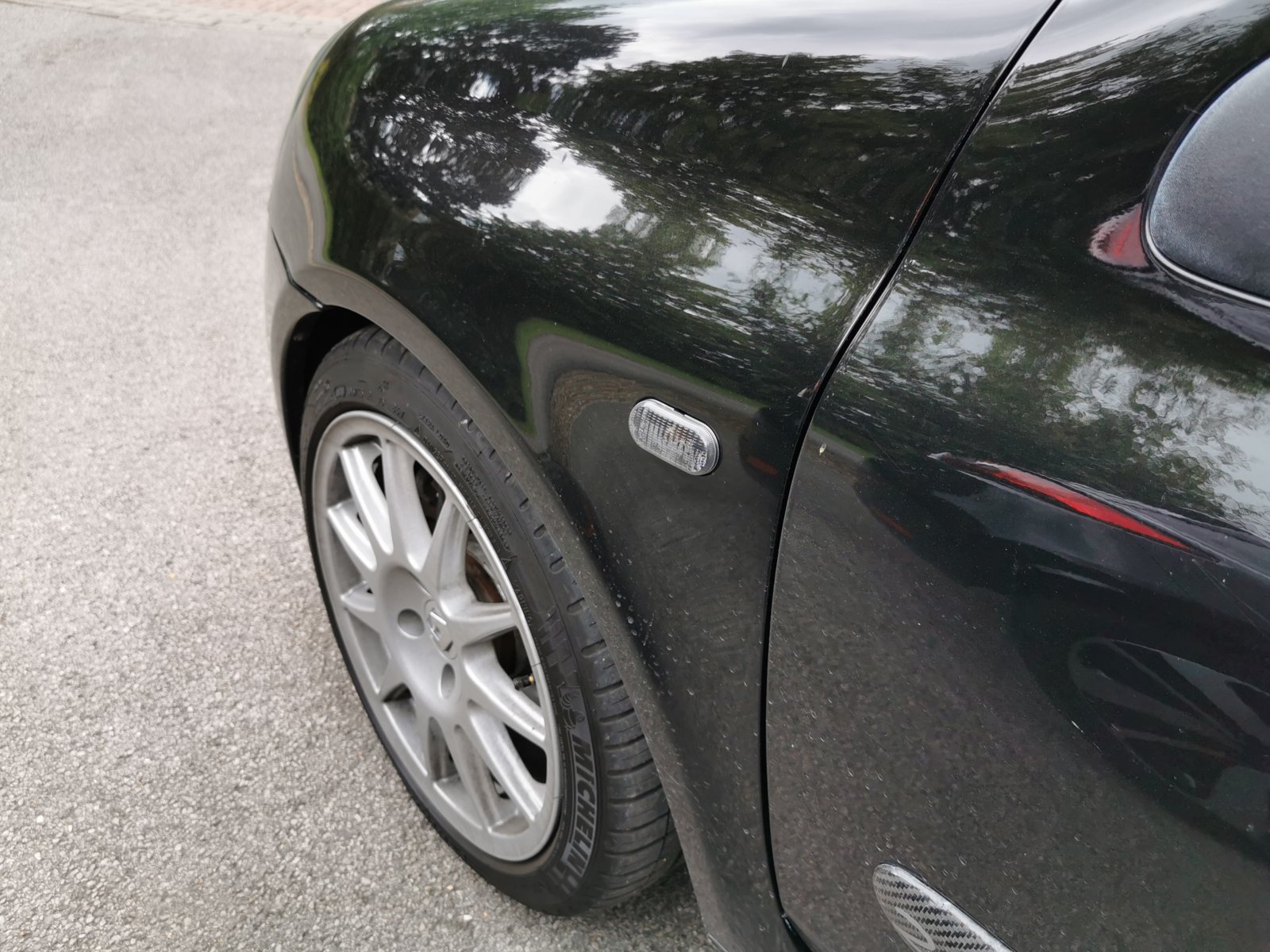

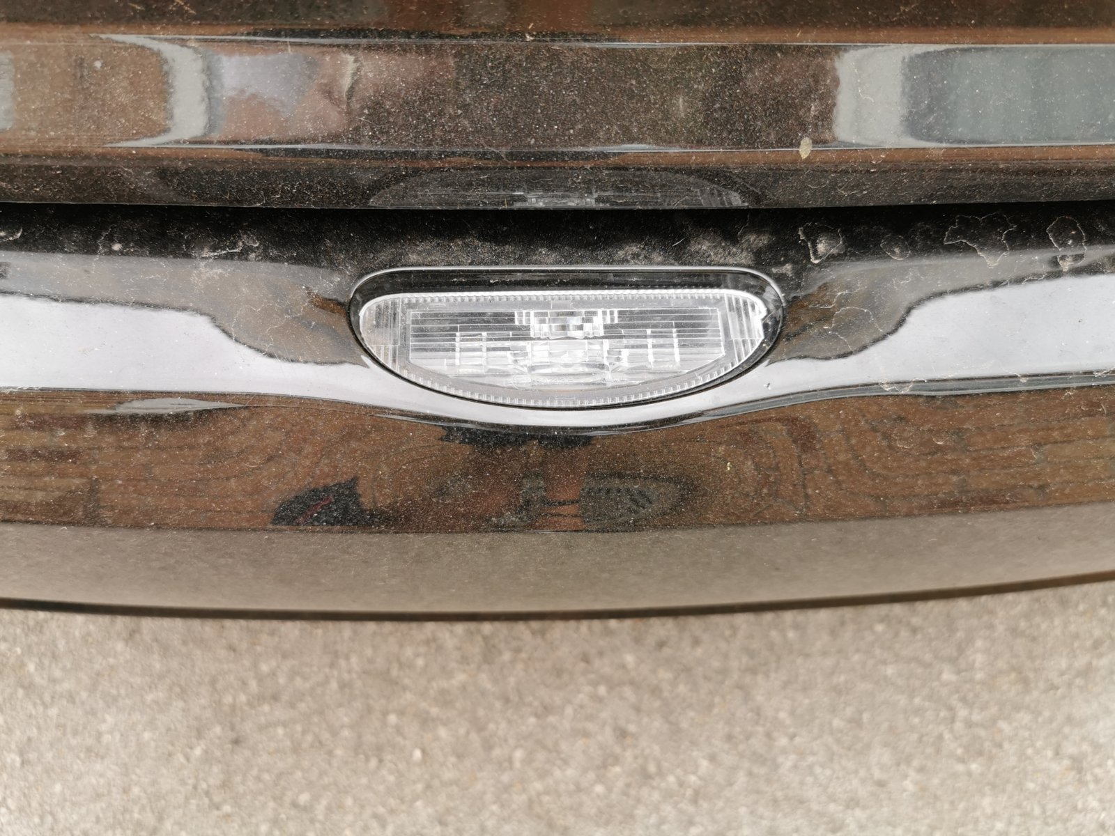

Before CSF I actually fitted some new parts I'd had in my box for a few months. On went a brand new number plate lamp, which didn't work because the connector was full of green corrosion. A bit of contact cleaner and a bit of wire and it was fixed and looking much better.
I'd also removed the side repeaters previously to clean behind them and they'd never really sat flush so I ordered some new ones. I agonised over clear or tinted but decide to stick with dark ones in the end. They didn't sit flush either but a little bit of trimming of some tabs on the back had them fitting perfectly.

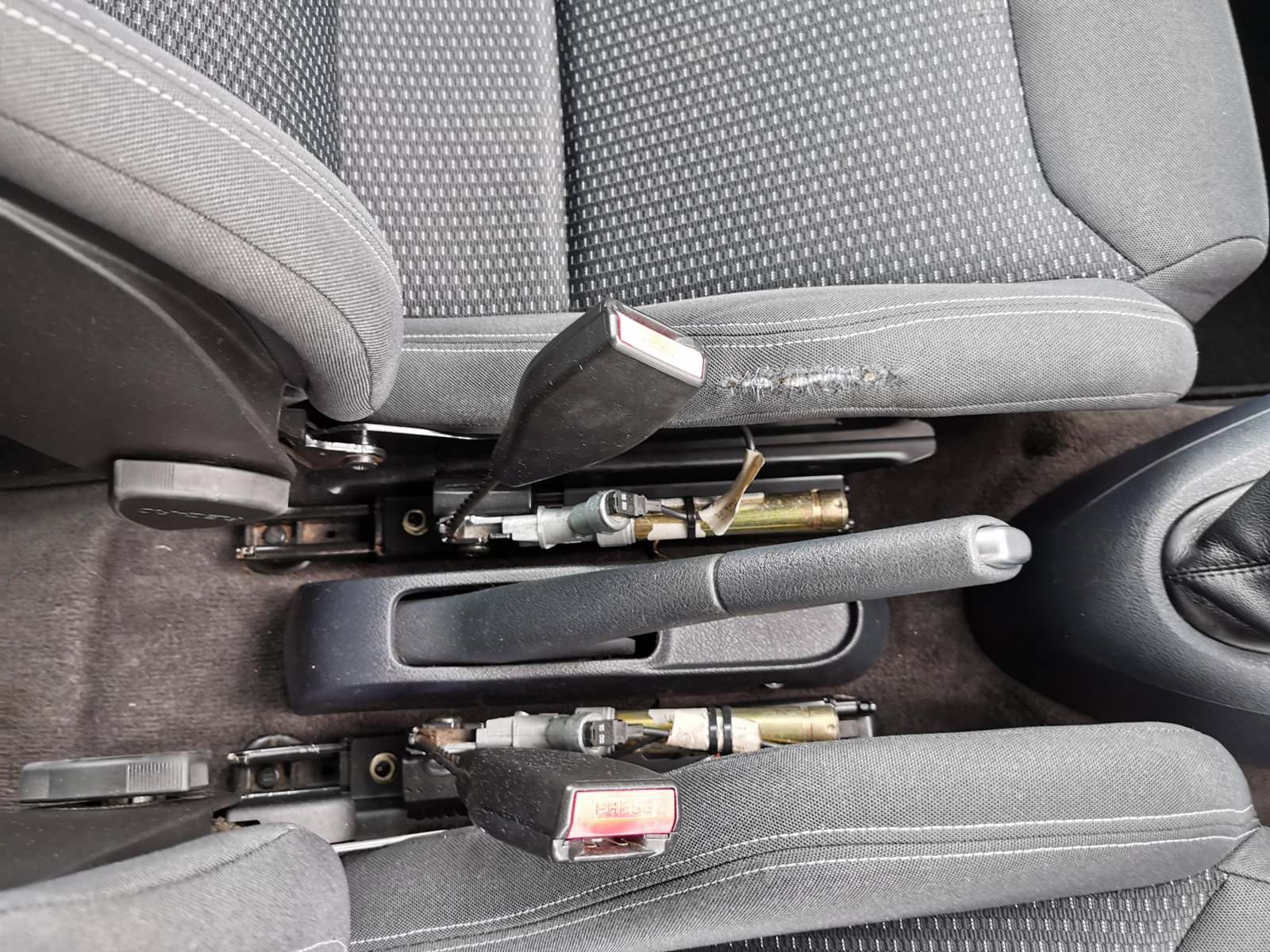

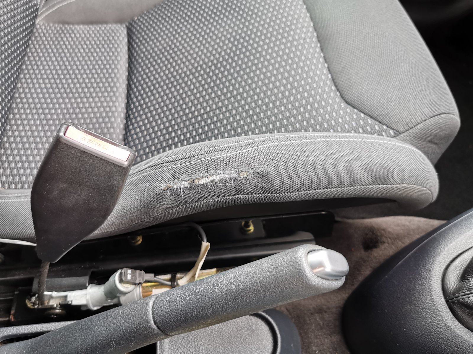

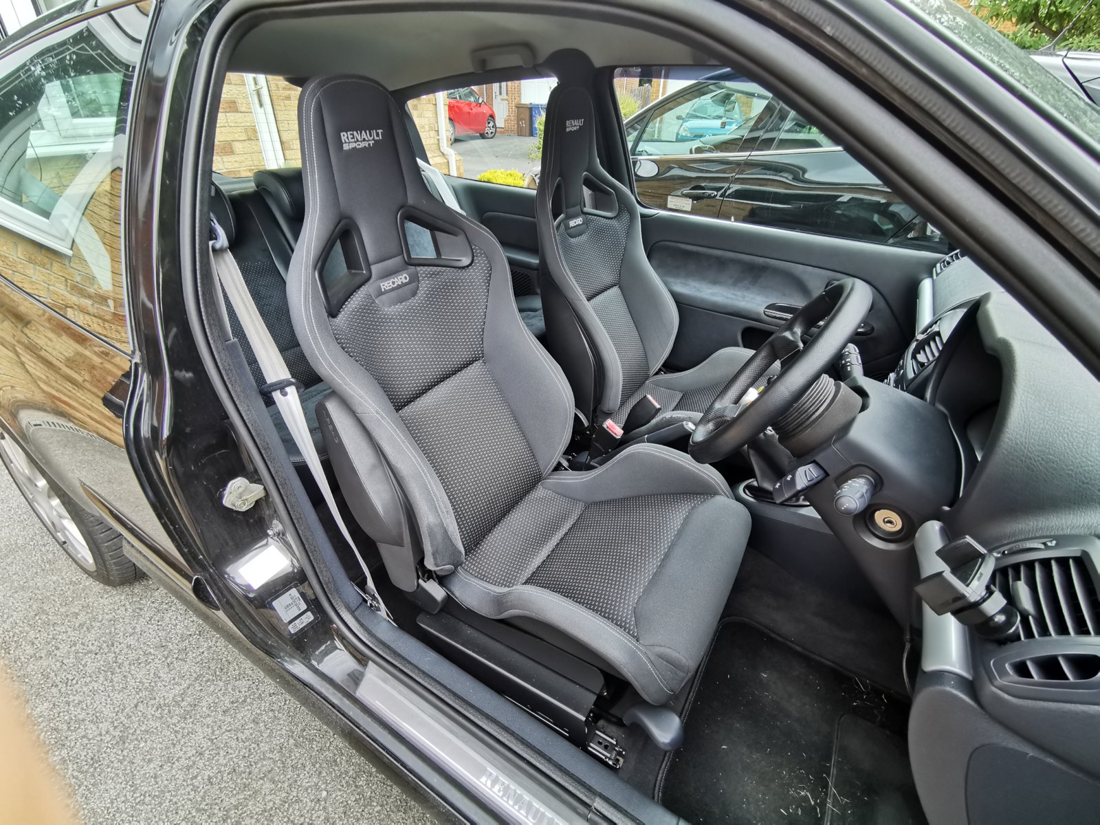

The last thing I had to do before CSF was fit my new seats. And as I was asked several times at CSF, yes Recaro CS Sportster do fit in a mk2 clio?. All you need are some quality adaptors from @JON FOZ and deep pockets. ? I bought a pair that had been removed from a 197 F1 prior to the car being sold! The centres of them match the 182 seat centres quite nicely and they definatly look more at home than EVO Trendlines do?. Unfortunately being from a Renault they included a hole in the drivers base bolster. Only one hole in a pair of seats seems quite good going though so I'm not too unhappy about that! I've done a pikey stitch up to prevent it getting worse until I look into a retrim probably next year and I've swapped the bases so the worn one is on the passenger side now. The frames had 2007 stickers on and both bases had 2009 on them so they were obviously replaced under warrenty before.
They are super comfortable for a slim guy like me and the lower seating position is much better too. I'm well happy with them. Thanks to @mossyv6 for letting me have a test sit in his storm grey last year?.
