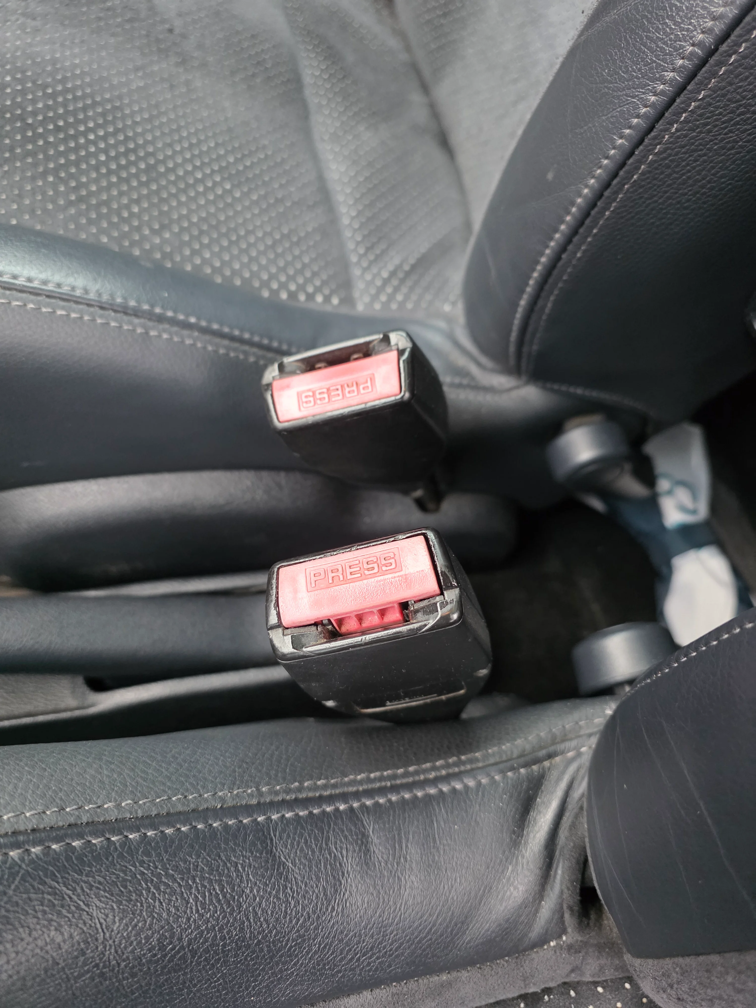

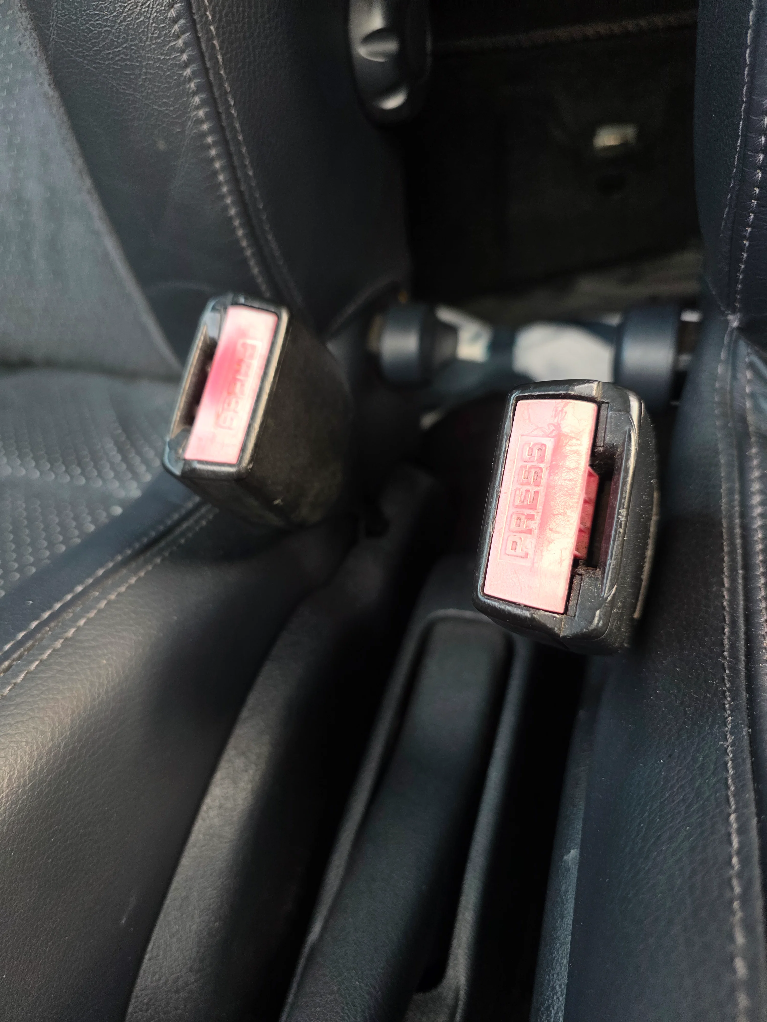

I’ve admitted defeat with the buckle buttons. I tried a few different ways of cleaning up the Laguna ones and nothing is perfect. I cleaned them up and I have used a red marker, some red paint and also tried putting some lacquer on top of the red paint. The paint was applied using a touchup brush and it’s not ideal. So, I had a look today at taking apart one of the buckles that is currently on the car, one of the original ones. The parts look almost identical but given the position it’s in, in the car, I’m not confident of removing it and not damaging anything within the mechanism. So, defeat admitted and if I want to make these buttons look better I will have to do them whilst they are on the car. I can take the button surround off very easily, but it’s obviously going to be a little awkward working on it where it is. There’s a few hours worth of work involved and to be honest if I want them to look any good I would have to use some spray paint. I think this is going to be a job when I have plenty of free time on my hands so this is on the back burner for next year. Let’s face it, it’s not really the biggest issue that I have.
