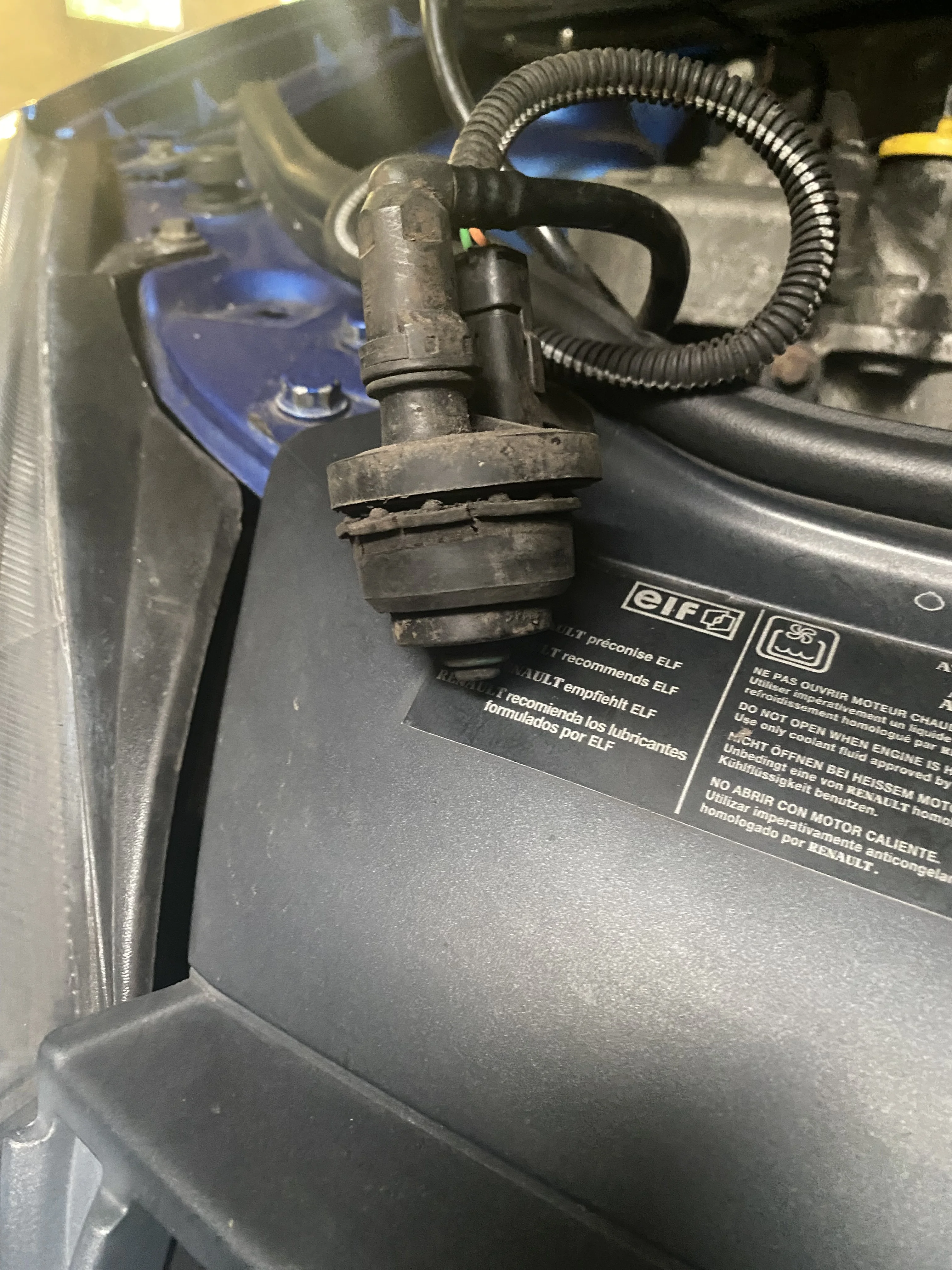

Maybe one job has been sorted out today. I had a look at the top of the carbon canister from inside the engine bay and when I touched it it was just sat loose. I undid the clips that hold the wiring and the vent tube and lifted it so I could blow into the end to make sure it was not blocked. I cleaned up the seal as best I could and lubricated the very small old ring. Everything looked okay except for that big seal being very worn. I placed the top back over the canister and gave it a push down with a long screwdriver and it seemed to click into place. Hopefully this has solved the problem, but I will keep an eye on it just in case it comes loose again.

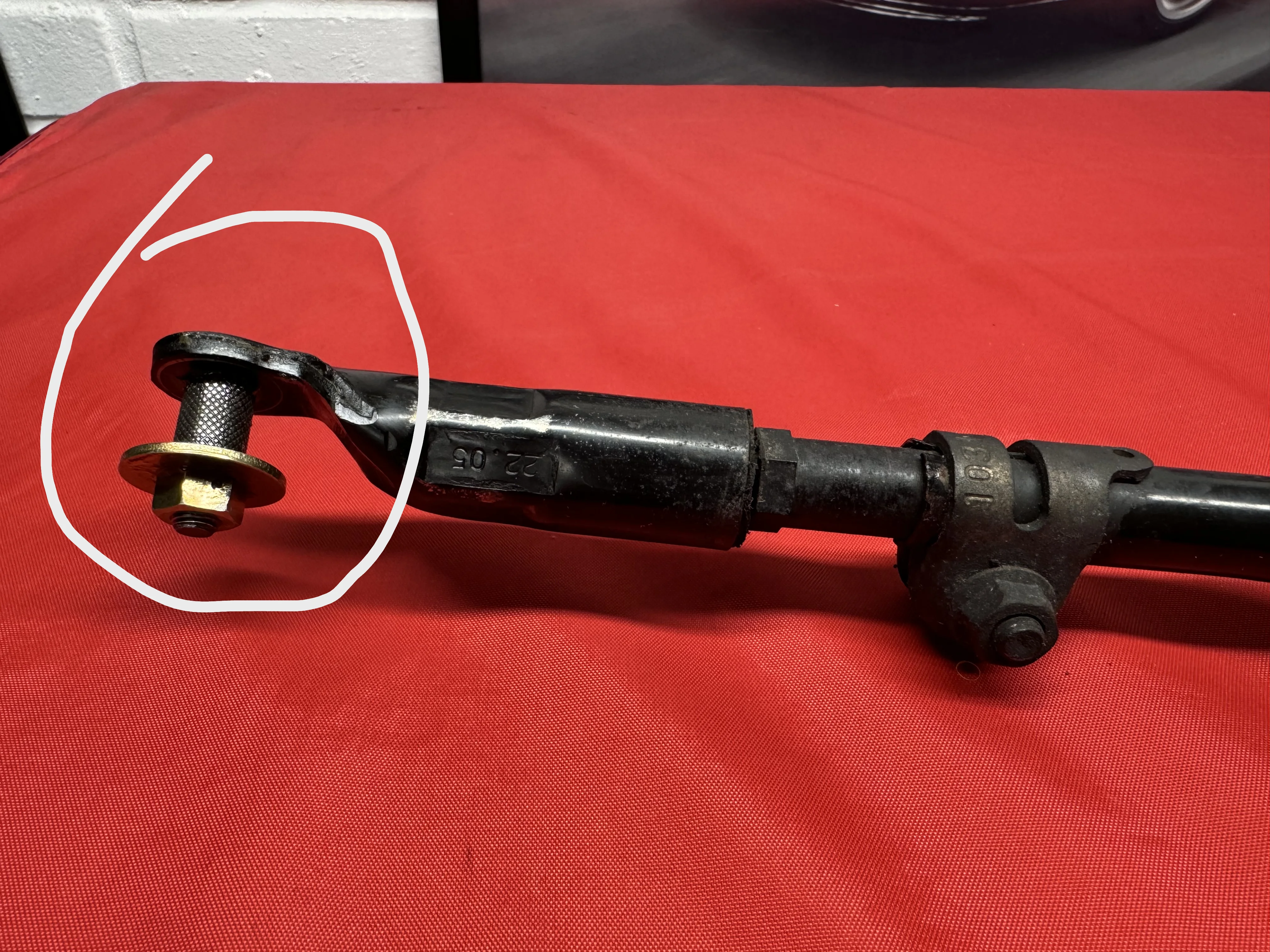

Right, first up is the gear linkage . Even though this has had work done you can see on this video that there is still play in this joint. The nut is tight and after I took this video, I put a little bit of copper slip into where the gap is. The car changes gear really well and there are no issues with the gearbox (Mark rebuilt it so we know that it is 100%). Is this amount of play in this joint normal? If so, I can forget about this end and just focus on sorting out under the gear stick.

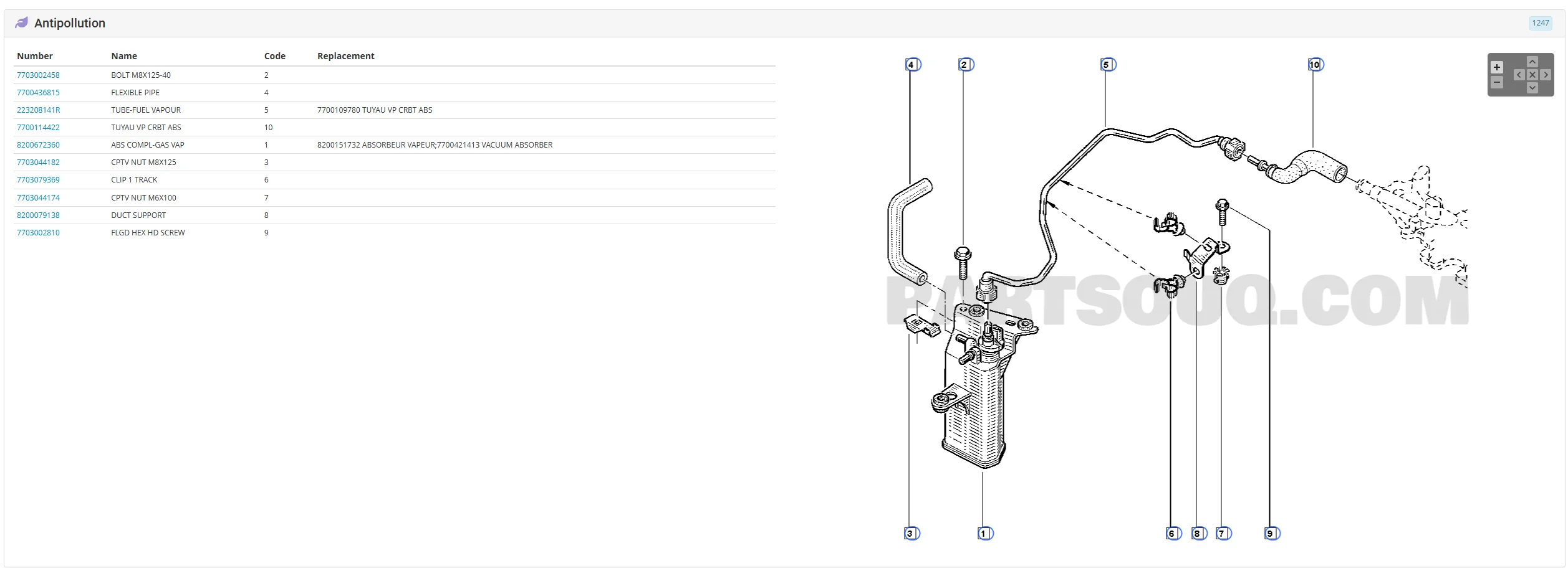

And finally for today is the wonderful carbon canister. So, I’ve reattached it, took the car for a drive and when I came back I can hear this clicking noise from the fuel tank area when I switched the engine off. I’m guessing that this is excess pressure being released somewhere and because it’s making a noise that is why the carbon canister was disconnected. What are my options on this? I’m guessing that I can’t just blank off the rigid black plastic pipe that leads from the engine to the canister itself so should I change the valve that pushes into the carbon canister? Or should I leave it as it is now or just do the whole delete thing?

What exactly was changed on the gear linkage? and was it like-for-like? I have come across different versions that are not compatible. To answer your question no that amount of movement is not normal.

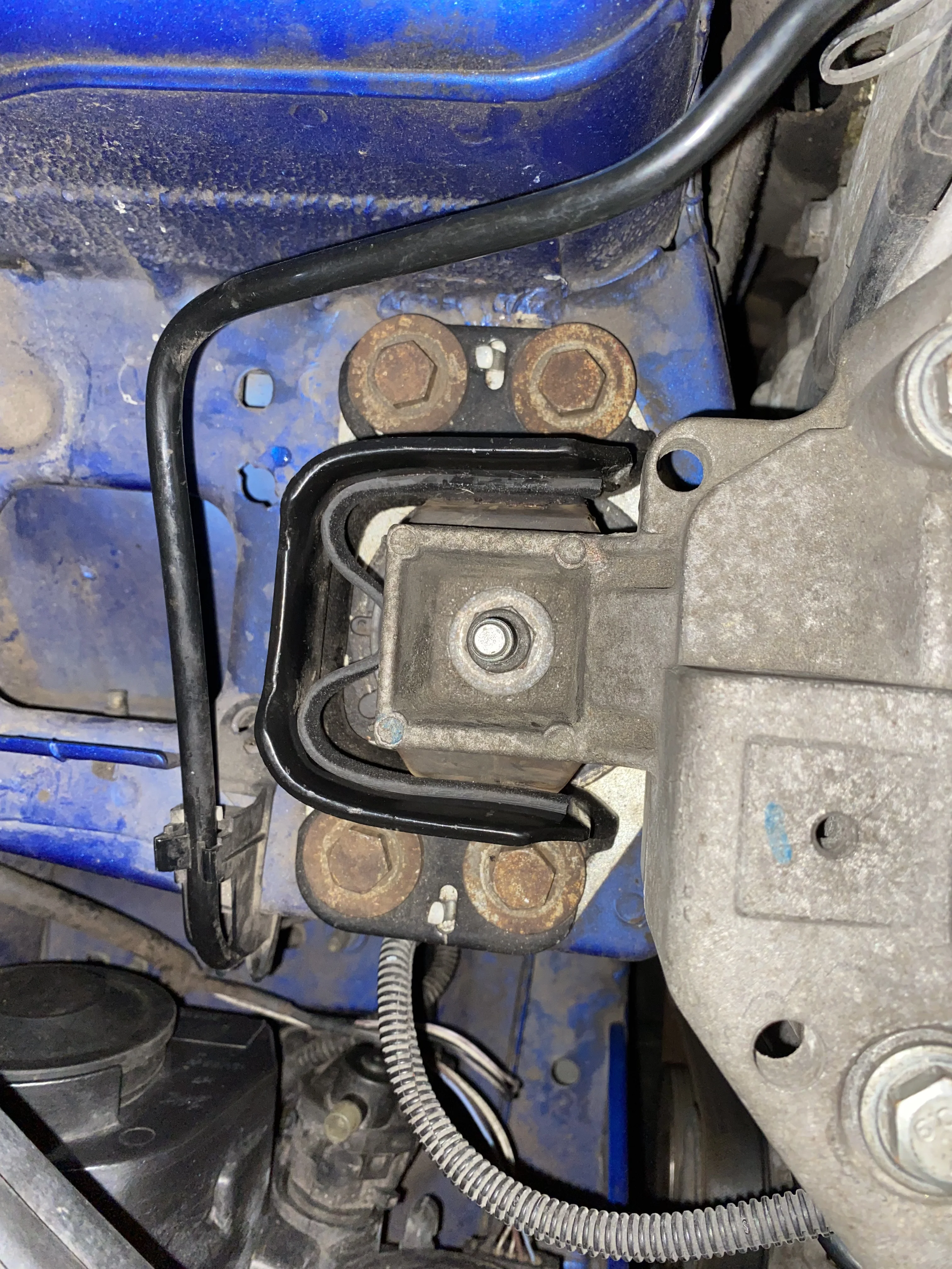

Regarding the engine knock when moved, it shouldn't do that either. To me it sounds clonky metallic - could be loose fuel rail guard or a loose engine mount assuming its definitely in the bay.
And I have never heard a fuel tank vent/pressurise like that, the carbon canister should click but that's the wrong end of the car.... I would start by removing the canister and blocking the sensors holes and see where that gets you to troubleshoot. At least that way the tank is venting to atmosphere and can't pressurise.

I'm going to pull the top of the canister again and see if the noise stops. I only noticed this issue when it was very warm recently as I could get a whiff of fuel every now and then. I'll be back.....
Ok. I popped the valve out of the canister and just left it so that the rubber o-ring is loose on top of the hole, so i that it's not in fully. After running the car for about 2 minutes I switched it off and there's no sound from the back.
Carbon canister open to air should throw an EML light if not plugged (I think) - maybe the solenoid is goosed hence it not venting and pressurising the tank.
No idea if that's true but it sounds plausible.
I've read through a lot of posts on here about it. I agree that it could be the solenoid but I don't have an EML on and have never had that. I think the easiest thing to do is to get a new solenoid and fit it as all the other parts look fine. I think this car was owned by people who when they found a problem just disconnected or removed it.
My parts cannon is fully lubed!
If no EML then just remove the canister and zip-tie the faulty solenoid out the way 👀 Think how much faster it will be with the weight savings
I'd rather that it works and I don't want to remove parts that are original. I'll get a new part, try it and if it doesn't work i'll sell my arse to get a GR Yaris.
My solenoid was hanging in mid air and no eml :LOL: usually only comes on if valve faulty or removed.
The clicking was annoying with no canister so i removed it and fitted a resistor to keep ecu happy.
It seems that if the electrics to it are ok and it's left hanging you'll never know there's an issue unless you smell fuel.
I had the same on my 1.2 but thought it was dead - similar story with the mashed rubber seal. Resistor is a good shout to tidy it all up.

Looking at my video of the gear linkage again I can say i've no idea what was done. I can only guess that there is a bush inside that fits better than the previous one simple because the gear change is better and there's less noise than before. It's still not perfect in that the noise it makes is not what the car should be doing.
However.....I have an idea. I am going to buy some brass washers and fit one of each side where there is movement. There is enough thread on the linkage to allow for that and it should stop all of that movement. I'm going to try this first before going onto the gear stick bushings as that will be a job someone else will do (Birchdown won't thank me for it lol). The photo is obviously not from my car but it shows where I'll fit the washers.

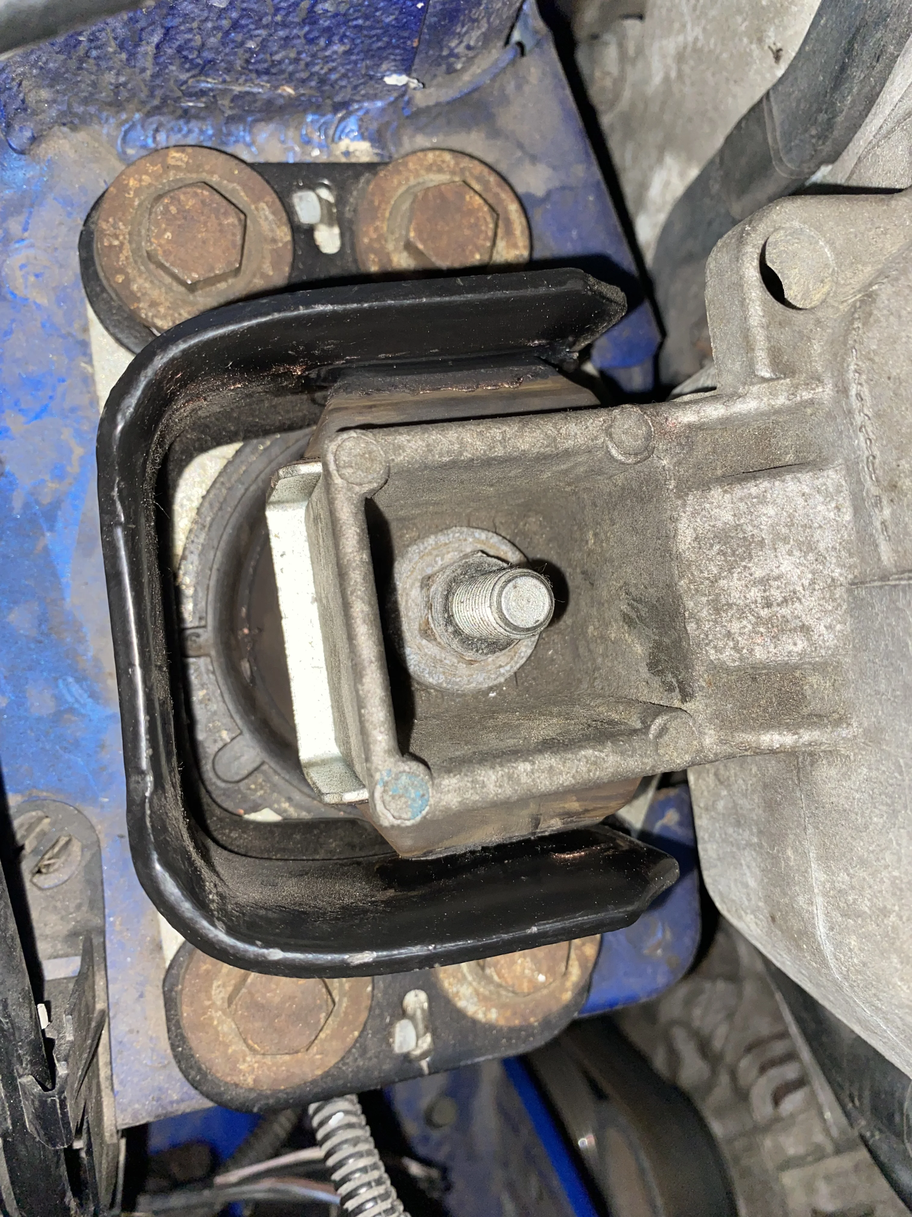

I could rock my engine by hand before replacing my top engine mount - now it's solid - but It didn't make that noise.
It definitely wasn't from an engine mount (all four have been renewed) and it seemed to come from the exhaust area at the front....which is close to the gear linkage. I'm sure all the problems are from the linkage.

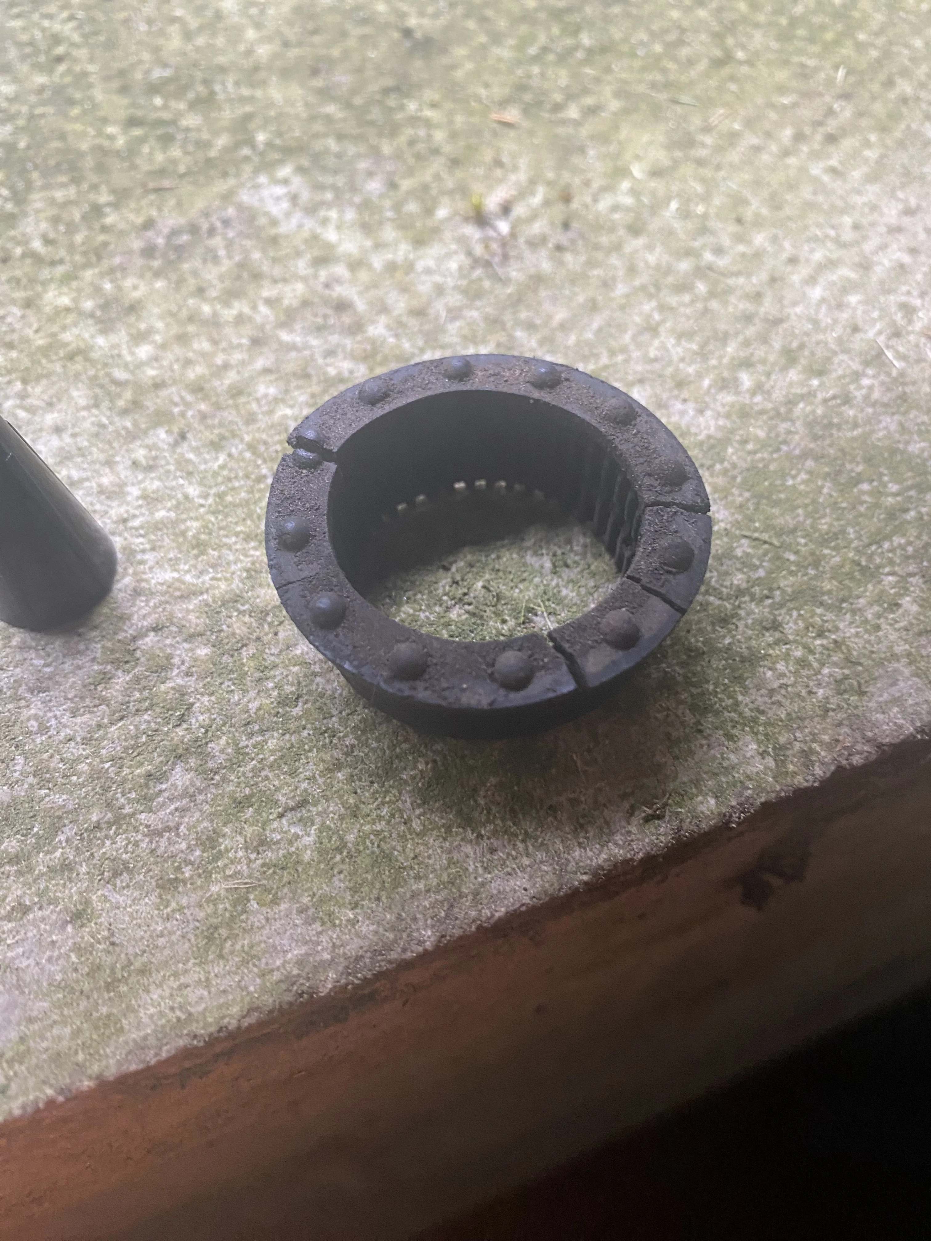

Regarding changing the bushes and bits that are under the gear lever, does this require the exhaust to be removed? It certainly looks like it from pictures of the underside i've seen.
Can anyone tell me what kit is needed to replace the bushes under the gearstick? Is there a kit or do I have to get the individual parts? I think I’ve done everything forward of this point.
Had the same issue previously and managed to eliminate around 70% of the wiggling by replacing the bushing you mentioned, along with the two-piece bushing by Mick from Diamonds. Planning to purchase the repair kit and give it another try over the winter.

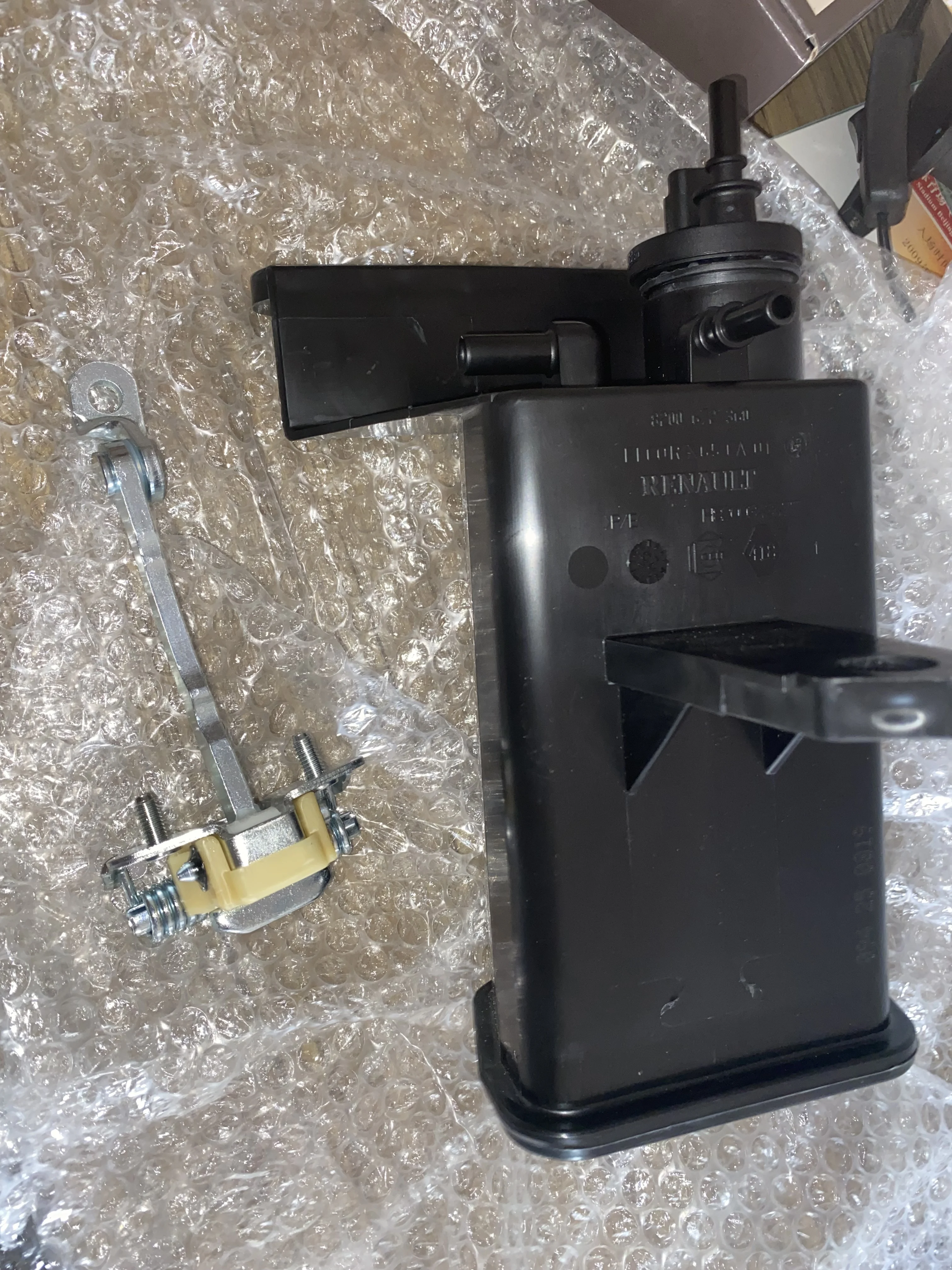

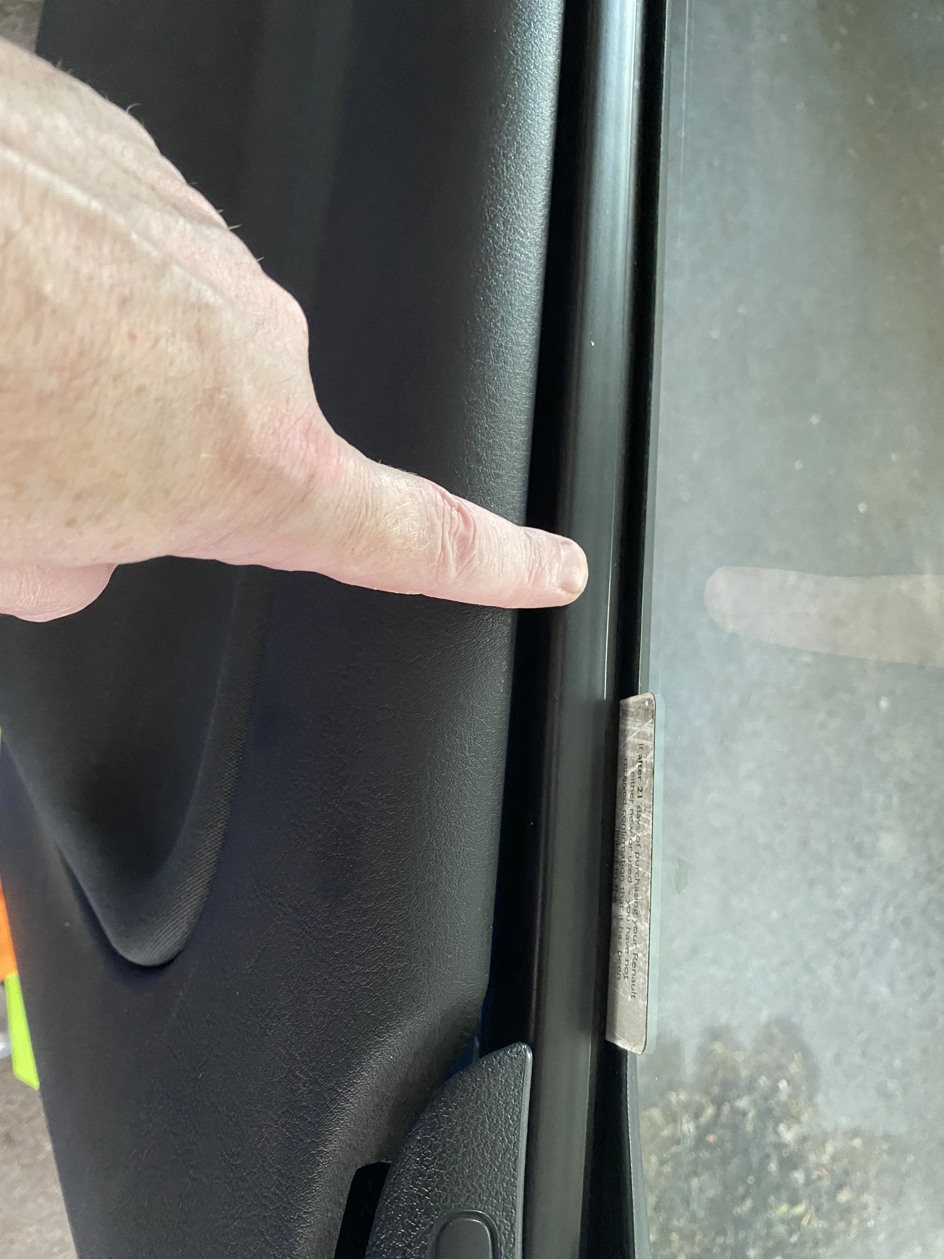

I’m just fitting the new door strap. Everything has gone well but I can see why my door card is not fitting properly on the top right corner. When I did my window regulator some time ago the top piece of trim shattered. I replaced it with a non-Cup item, but I’m sure that the original item has a lip on it that the door card grips hold of. I can’t resecure my door card in the top right corner without that. Does anyone have one?
The door strap went on really easily, that was probably because I had the door card off sorting out a rattle in the door and also looking at how to secure the door card in top right corner. So, door strap on all the other bits and pieces were re-fitted and I also checked all the connections for the electric door mirrors and the electric windows. I just gave them a squirt of WD and made sure that everything was moving correctly and then checked their operation before I re-fitted them. As above I had a problem re-fitting the door card because I’m sure that the piece of trim I got is not a genuine cop item. Also, there is one little plastic clip on the right side of the door card that holds it in place and although I had a brand-new clip, it wasn’t strong enough to hold the card in position. I’ll have to get the correct door strip because I don’t want to start drilling into the door and the door car to secure it.

I also mentioned that I had a clunk from the front right side of the car, but it didn’t always do it. Whilst looking for the squeak, I was pulling the engine back-and-forth with different amounts of force and this clunk was coming from the top engine mount. It’s a new mount and everything is tight, but as you can see on the photo the front rubber is actually away from the body of the mount. I had some hard rubber material that was from that broken door strip that I mentioned above so I’ve cut a piece and put it in between the rubber and the body of the engine mount and I couldn’t make it make the noise again. If it’s eliminated it then I can have this looked at when the car is in for the next service.

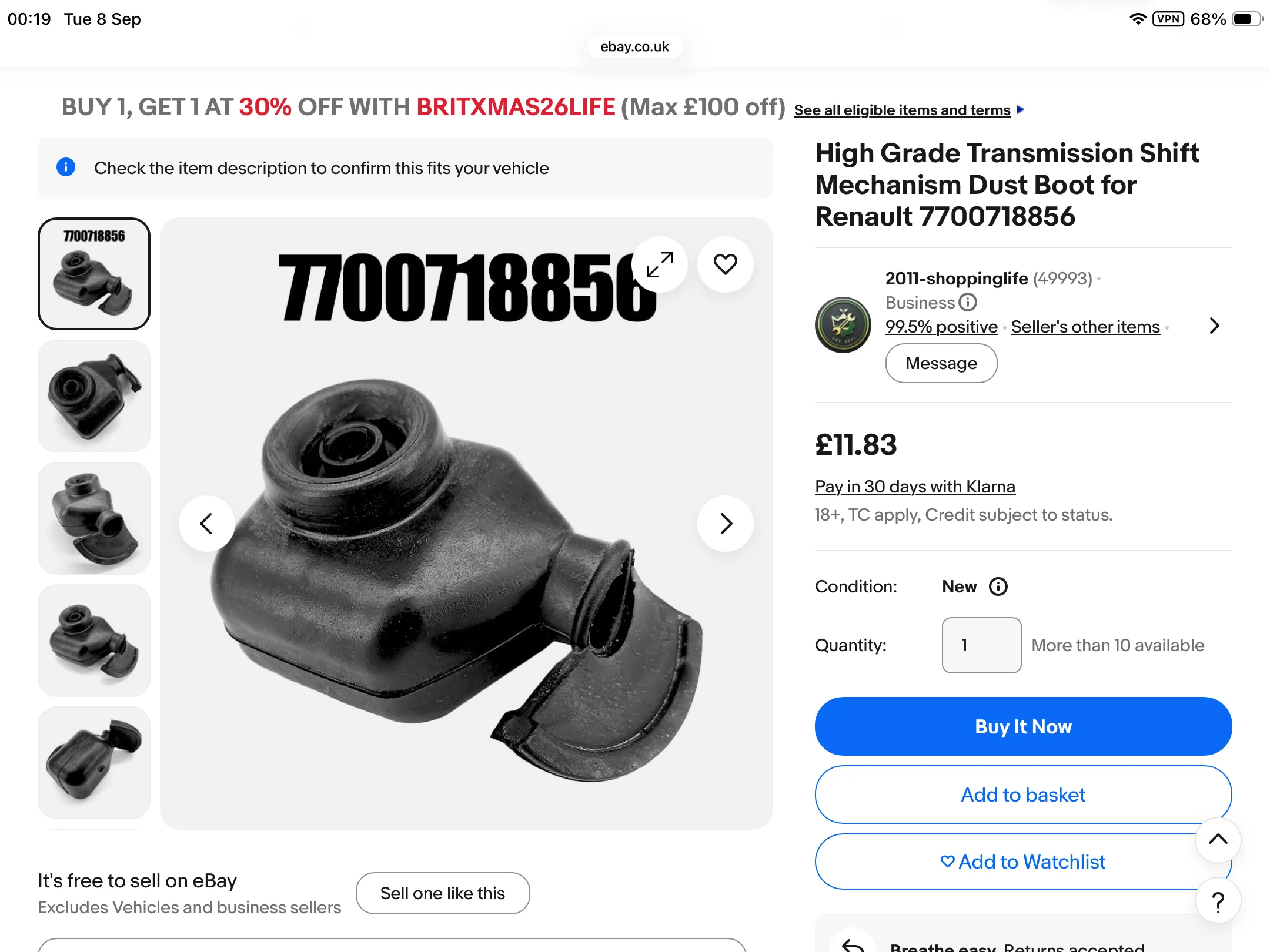

Cheers, Matt. There's a couple of bits that i've just been looking for that are impossible to find...those clips, a clutch pedal cover and a rubber cover for the gear linkage.
