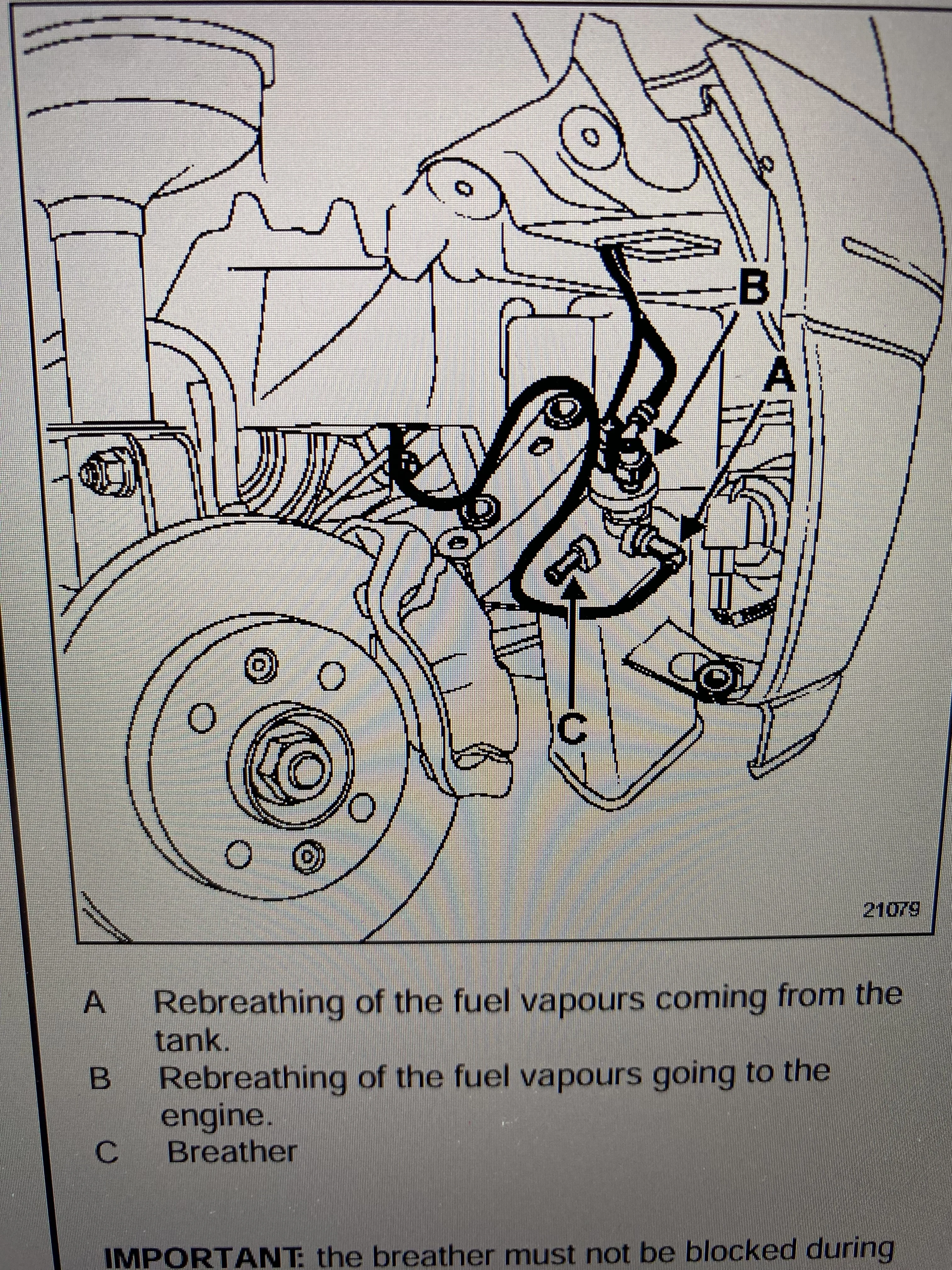

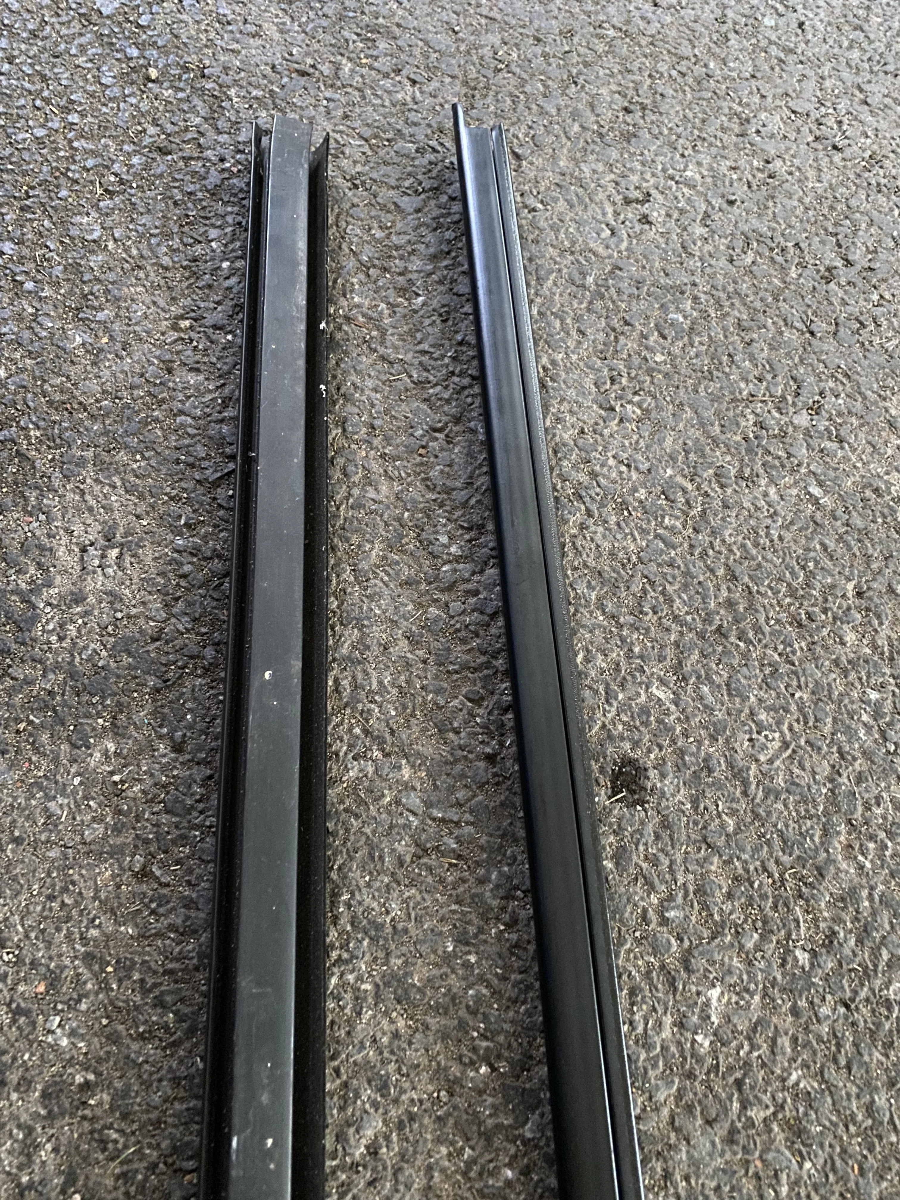

My cheap(ish) 172 Cup
Yeah, i've just checked a few photos and they are almost exactly the same. It's a pity I didn't know this before as I've just had my carbon canister delivered from EuroFrance. eBay it is!
CS to the rescue, again! Thanks(y)

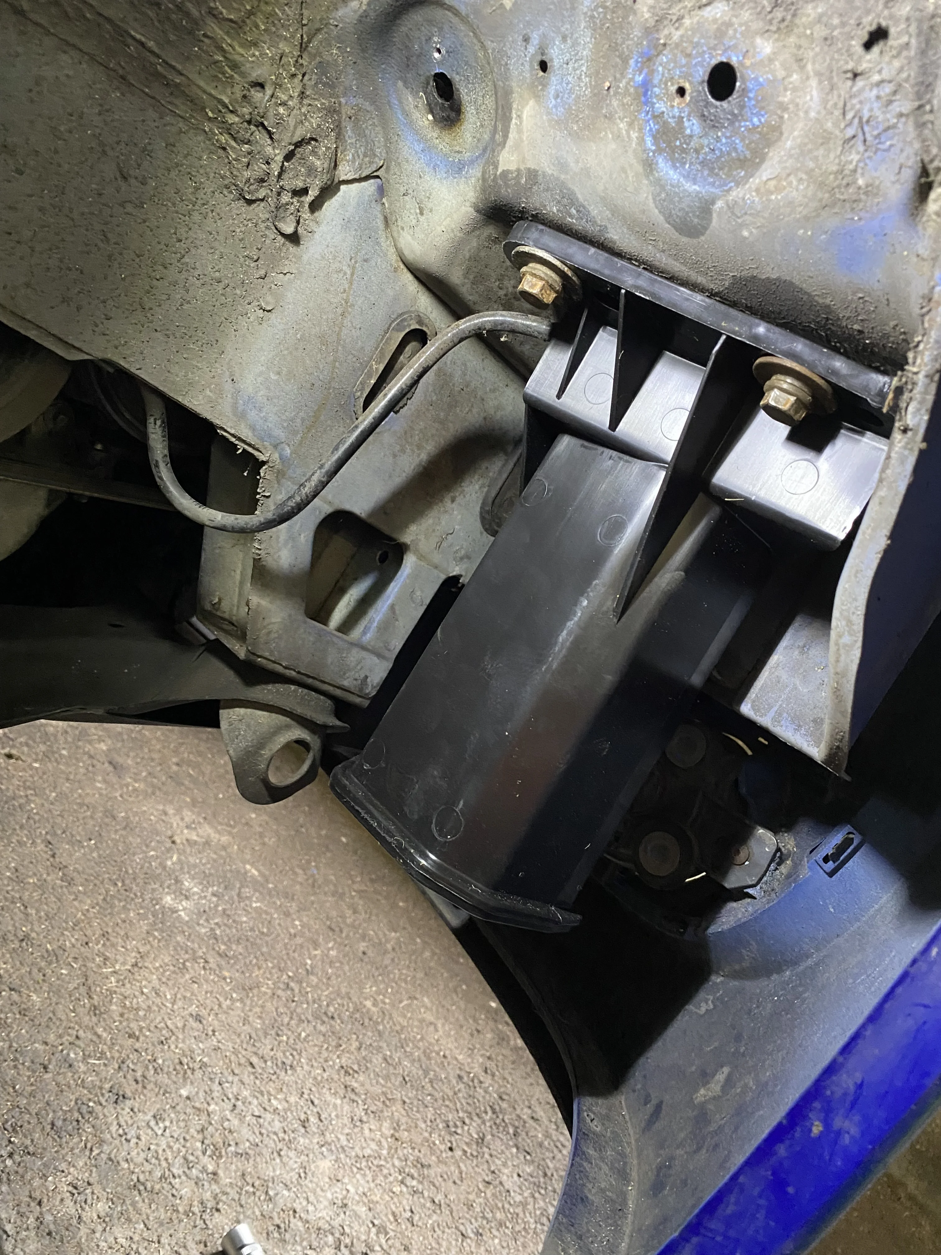

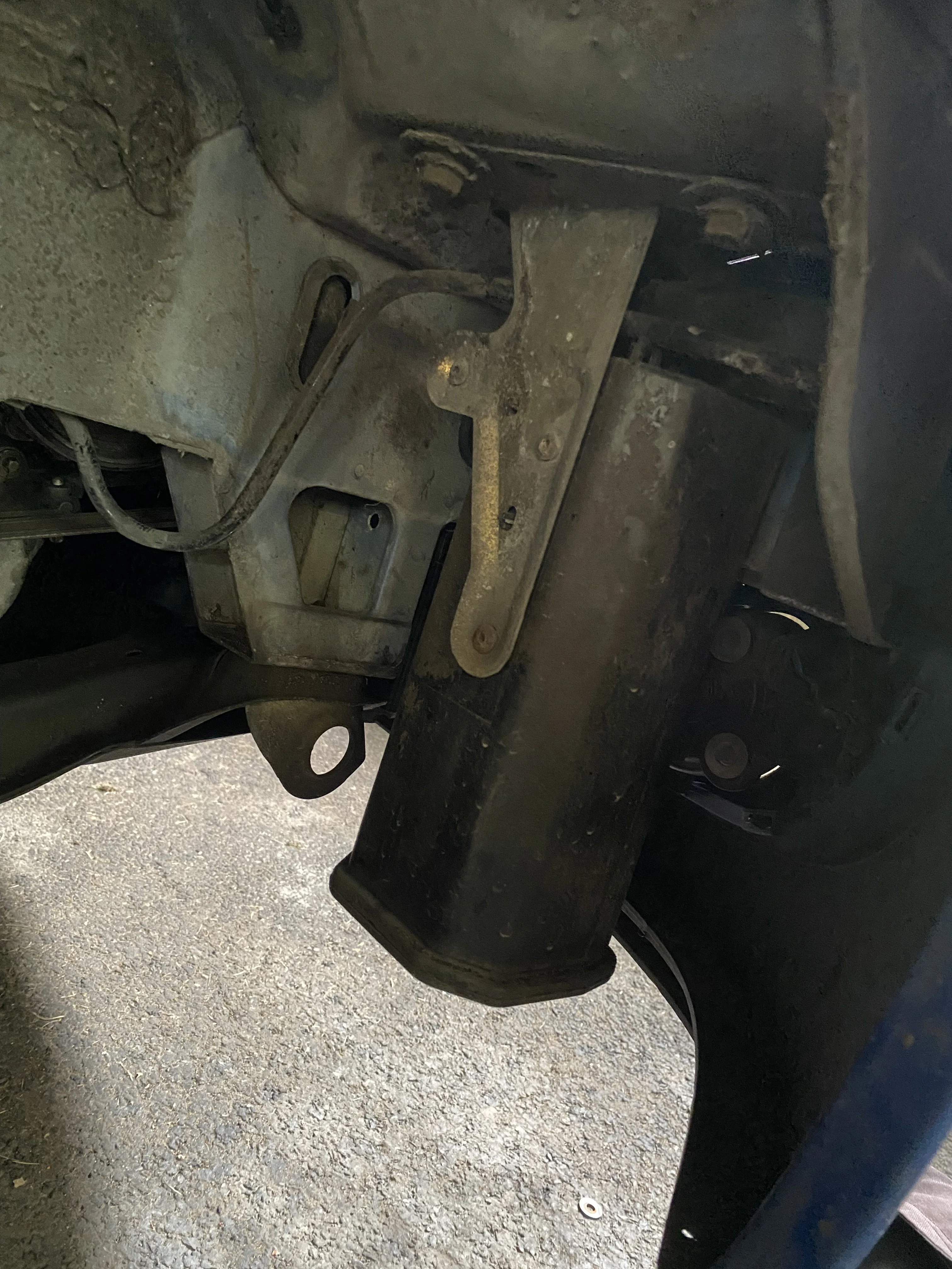

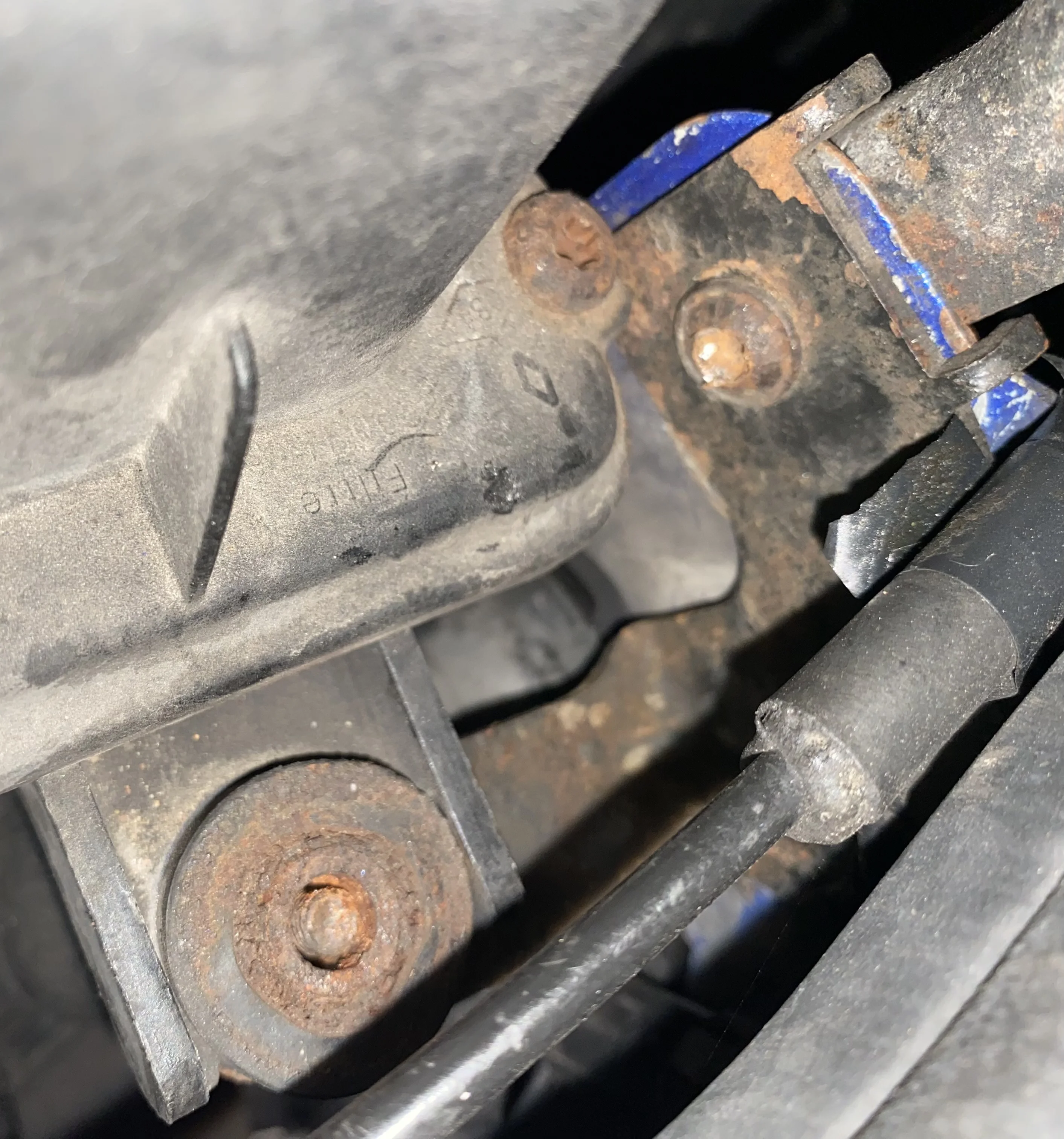

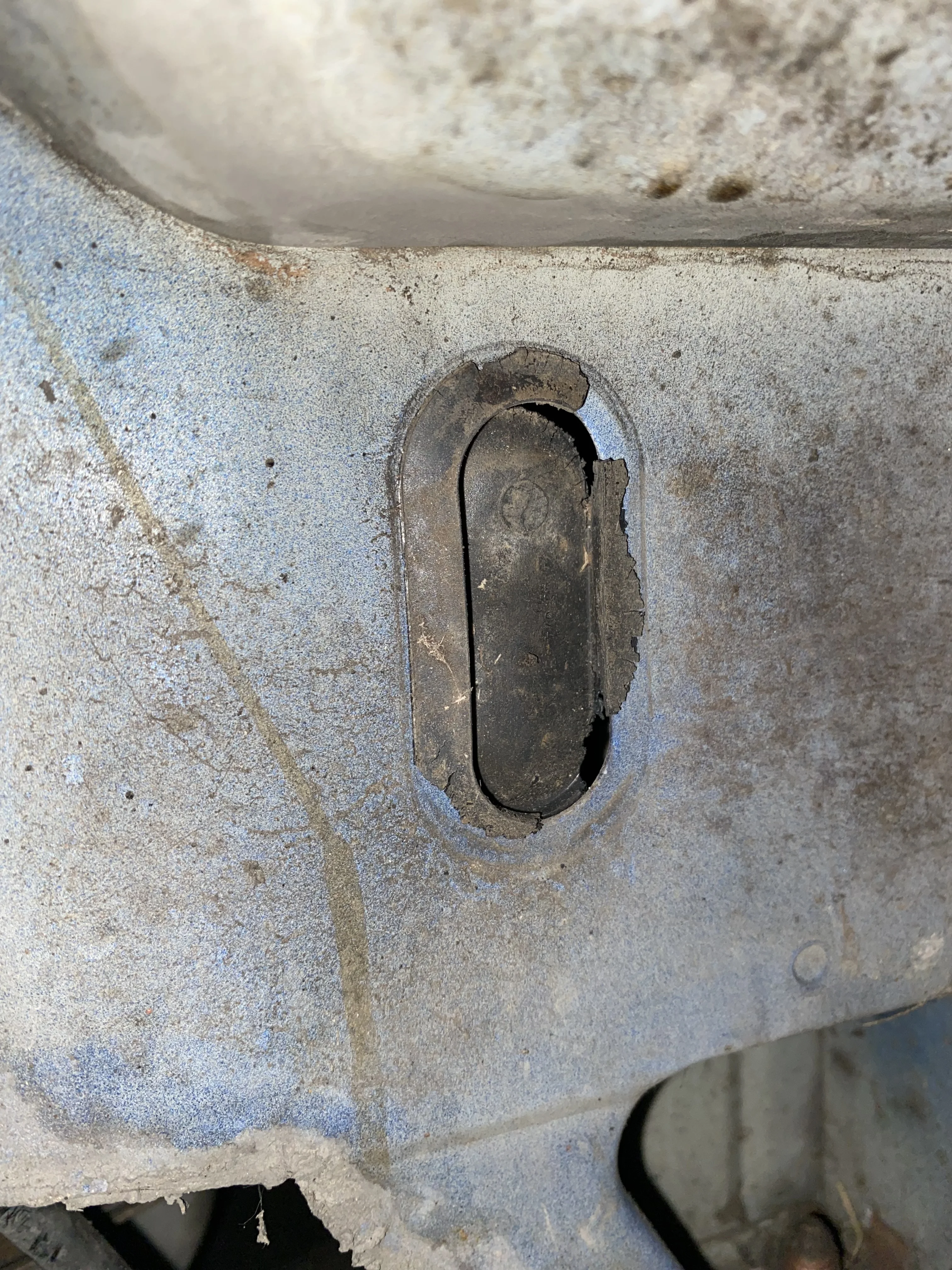

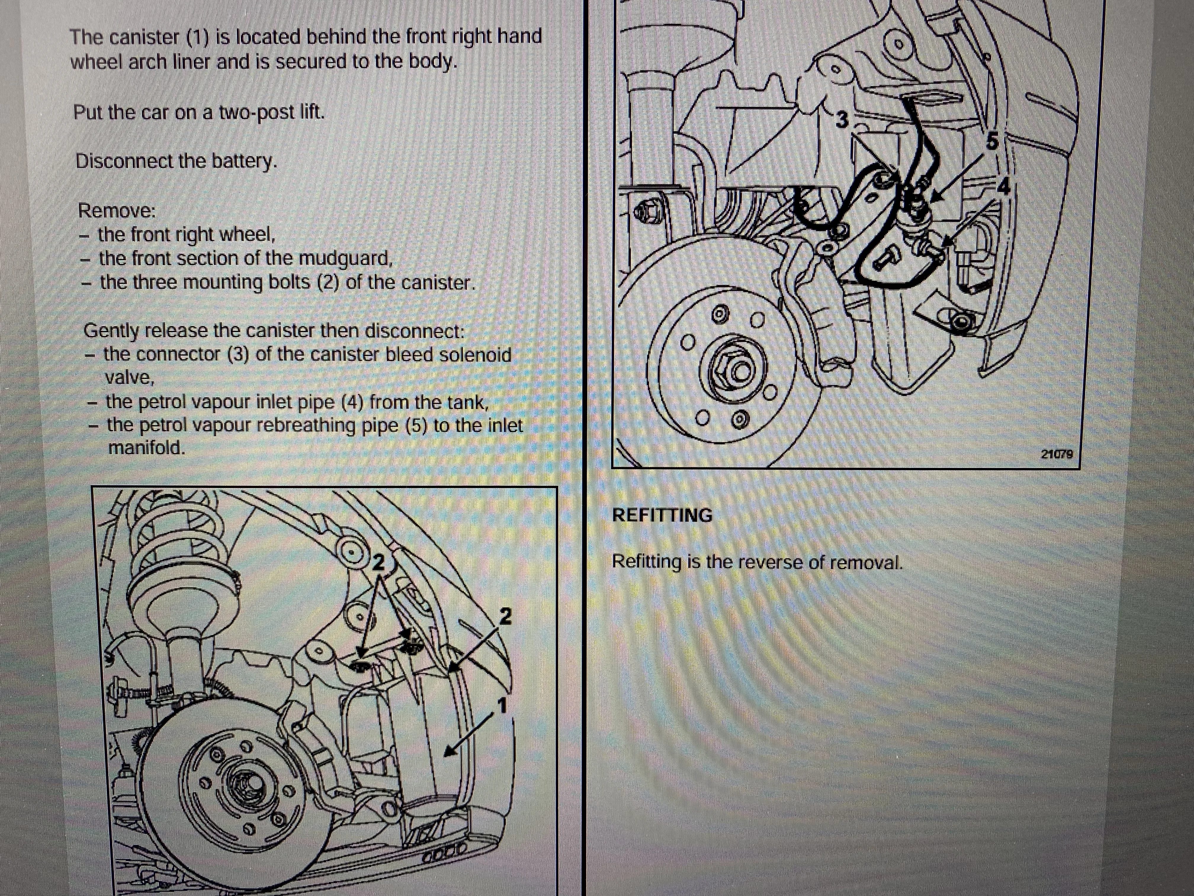

Today was carbon canister day… yay!

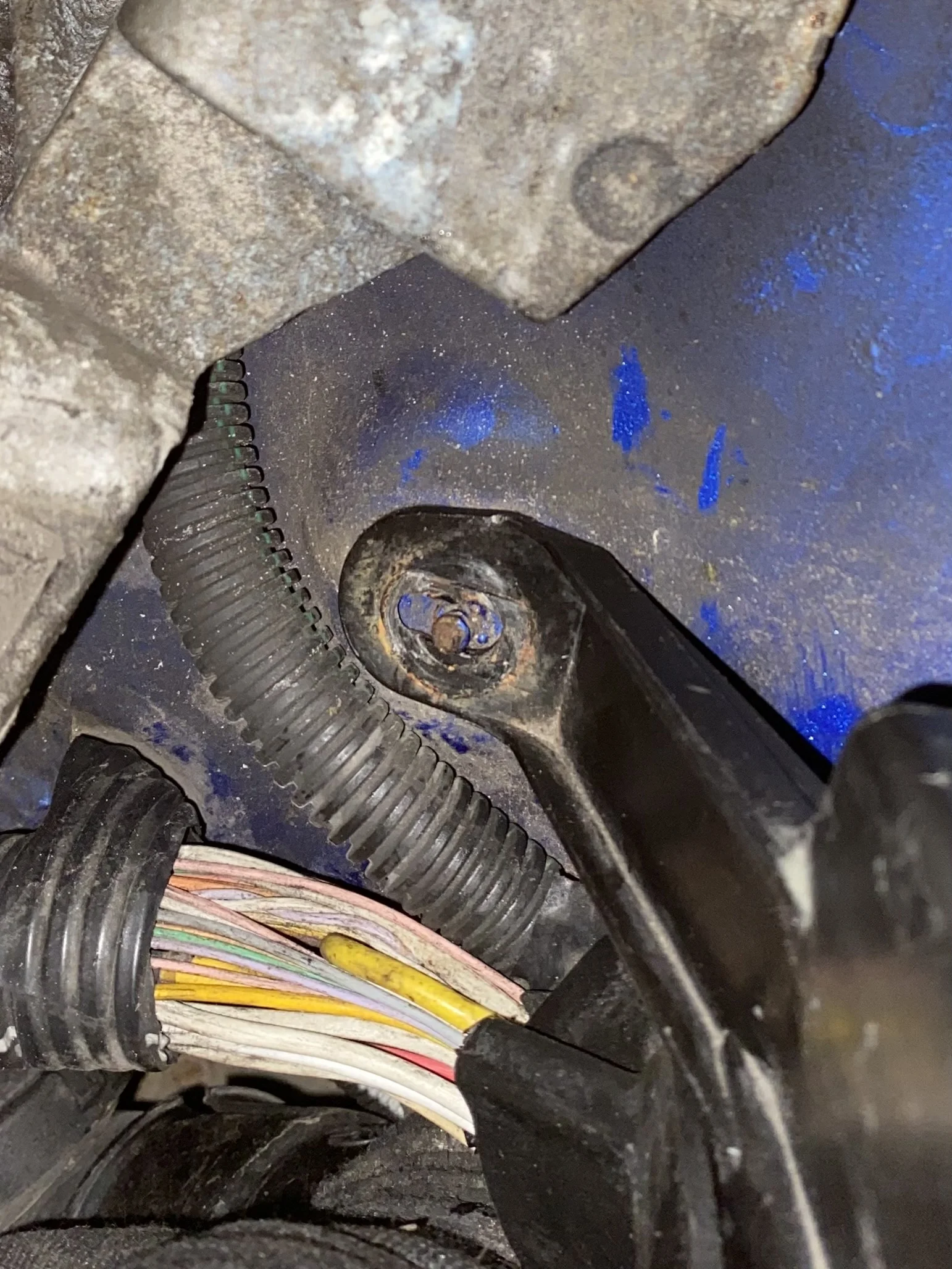

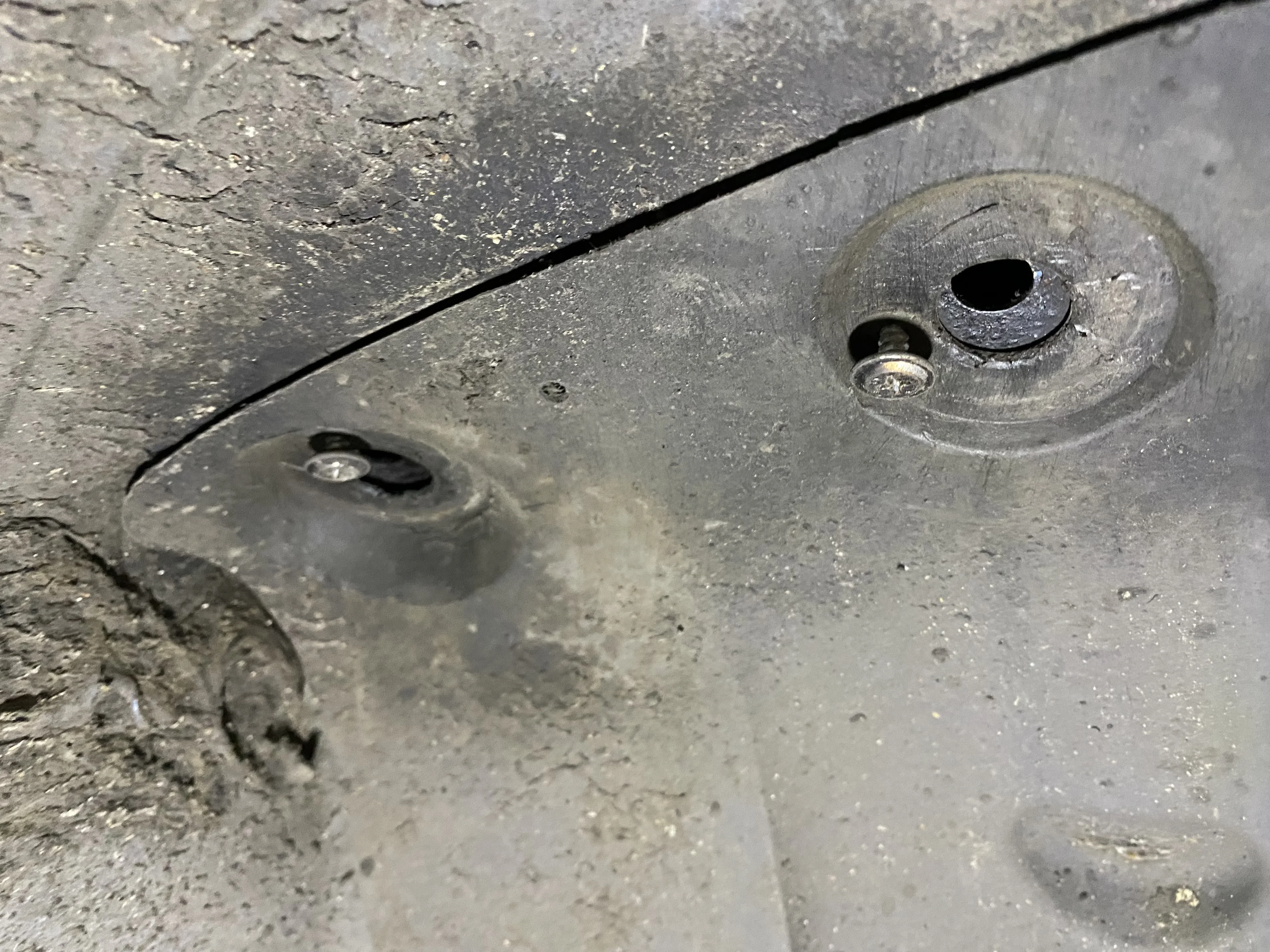

I got the car jacked up and removed the front arch liner. Note on the photos the extra screws that were put in by someone in the past even though the two bungs would hold it in position really well. Also, you can see the wear on that rubber grommet in the arch…that’s what 23 years does to a car!
The canister itself came out relatively easy and the return pipe from the fuel tank unclipped without any hassle. Side-by-side, you can see how the design of the canister has changed over the years. I’m tempted to put the original one on eBay just to get a little money back, and going off some of the old parts I’ve sold in the past I wouldn’t be surprised if someone buys it. So, with the new one fitted and all the connections refitted I started the car and let it run for a few minutes. It ran fine and upon switching it off there wasn’t that loud clicking from the fuel tank. I know that these canisters tend to click from the front when they are done but when I refitted the loose solenoid to the original canister a few weeks ago, the clicking I heard was coming from the fuel tank.
I couldn’t find a guide on CS for doing the canister so I’ll put a few photos here just in case anyone decides to fit their own and has any issues. The only problem I would see if somebody was fitting one would be that the front bolt of the three that holds the canister to the car may be a little tight to get off. Mine was tight but it was not really any hassle. The biggest hassle is fitting the little screws underneath the bumper that hold the arch liner in place. I’ve also got a manual for the car so I’ll put a picture of what the instructions are for changing the canister.

What in the pikey f**k has gone on here
Exactly! The arch liner on the other side also has a screw in a strange position. I have a feeling that whoever refitted the arch liners had worn out bungs and they weren’t confident they were going to hold the liner in place.
I’m convinced that in the past this car was used for something and then had almost everything re-fitted. I’ve no idea whether it went on track but everything I found with this car since owning it suggests that someone was tinkering with it and they didn’t really care about doing things right.

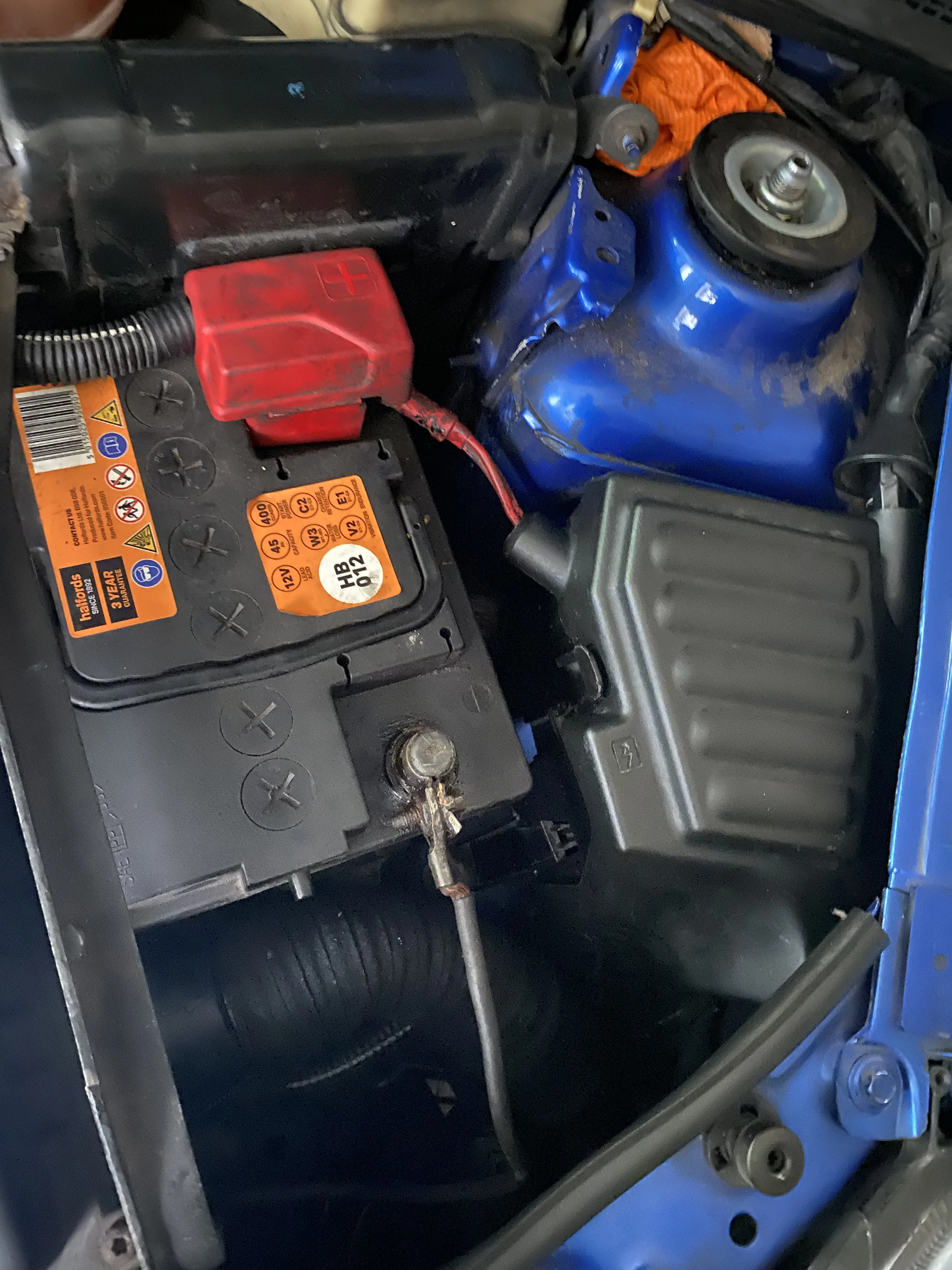

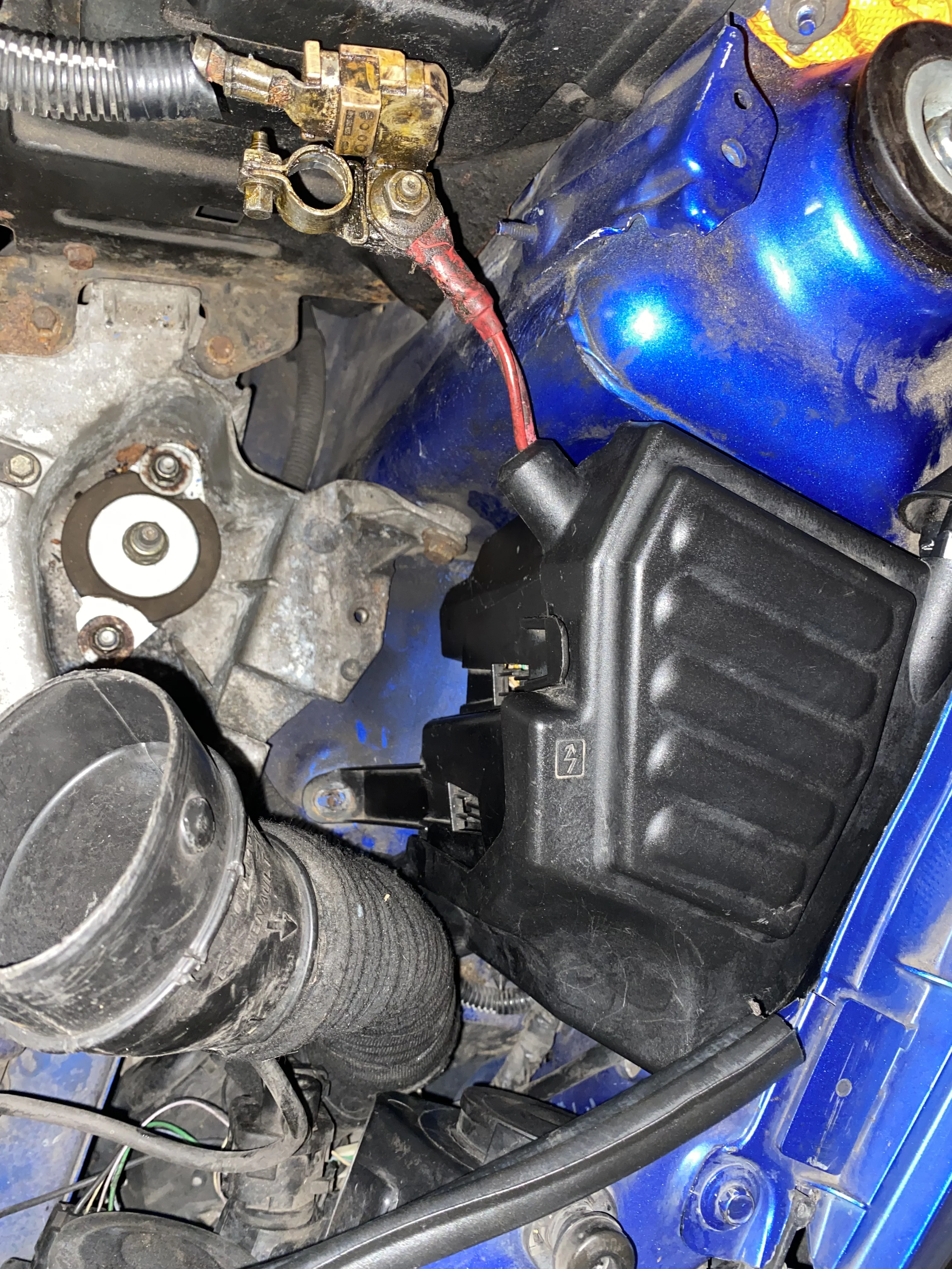

I fitted the fuse box that I bought from a member on here. I had the original fuse box off in the past and repaired it but it was noted that a piece was actually missing. Upon closer inspection the piece hadn’t broken off but had been removed with a hacksaw. More evidence of a numpty working on this car in the past!
I had to remove the battery to get the old fuse box out and I noticed that one of the nuts was seized which holds the bar for the ECU holder. There was no chance that was coming off but luckily enough I could get the battery past it. There’s also another securing point for the air box which is missing some thread and the same for the actual fuse box itself. I’m not OCD but things like this really irritate me. The rounded nut will take a bit of effort to get out and the other two threads that have broken off will need to be replaced, one of them I’m sure we’ll have to be welded. There’s not a chance I’m stripping everything down to weld the nut on that I can do without.
Everything was put back together and I tried all the electrics in the car and then started it. Everything seems to be fine so I’m hoping that when I drive it next time nothing will go wrong. I’m not holding my breath as moving 20 plus years wiring is always a risky business!

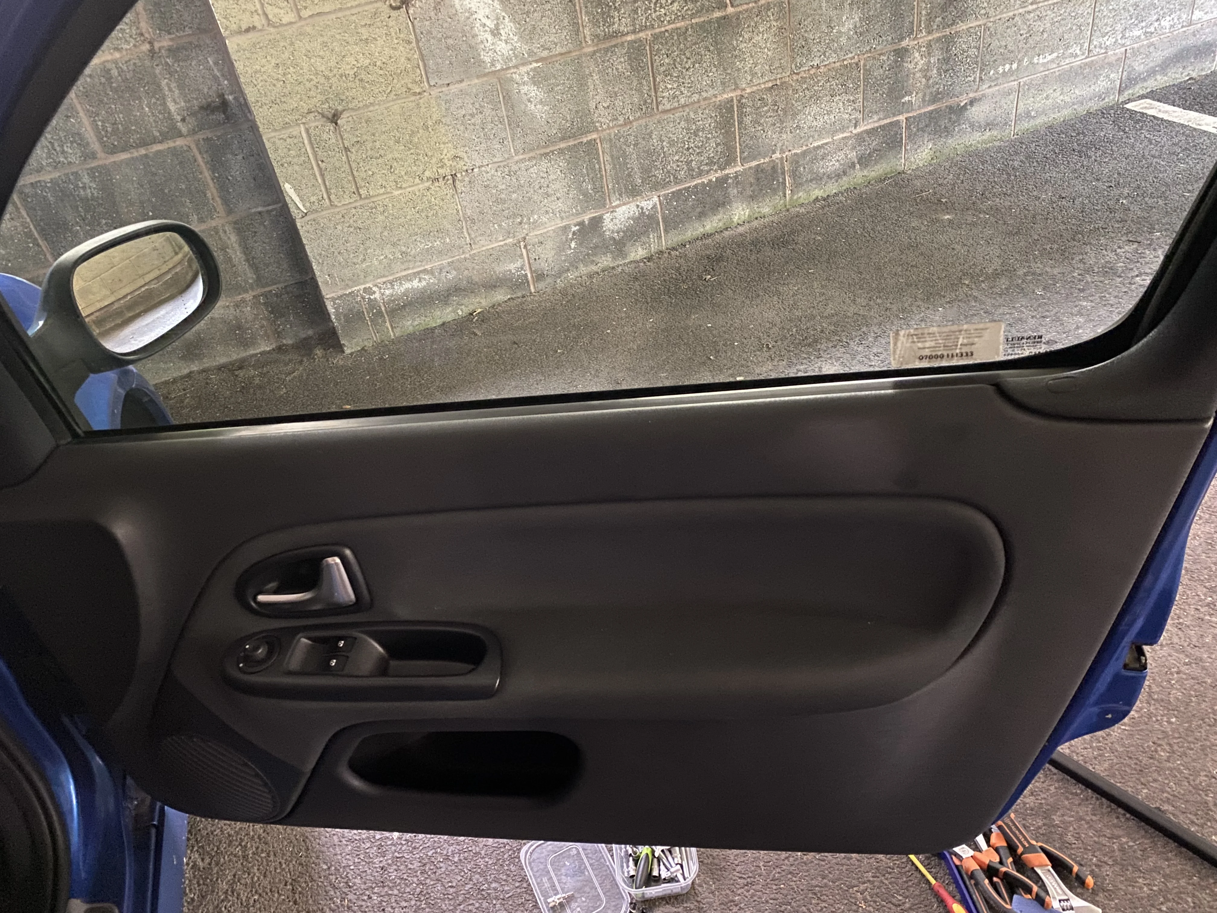

Today’s job is to replace the driver’s door top piece of trim that shattered when I removed the door card to do the window regulator last year. At least I think it was last year because I’ve done so many little crappy jobs on this car that I’ve lost track. I’ve replaced one or two of the plastic clips for the trim with some OEM items and once fitted, everything is tight and in place. Even the vertical piece of trim that sits above the door card has gone on much better now. I checked it all with the passenger door and everything matches up.
I got lucky with the piece of trim because it’s difficult to find this part anywhere now. It has to have a lip on it to hold the door card properly, as you can see in the photos. The people who sent it sent it to the post office and not to my parents home, and because of this they said that they will refund the money and offer a discount on anything else in the future. It was only a few minutes from my parents home so my dad picked it up as he was walking past. A little bit of a bonus I think.
Anyway, everything is back on and it works and hopefully there is no rattle from inside the door. I did check everything and made sure that nothing, not even a plastic part, was loose. We all know there’s no chance that this door won’t rattle!

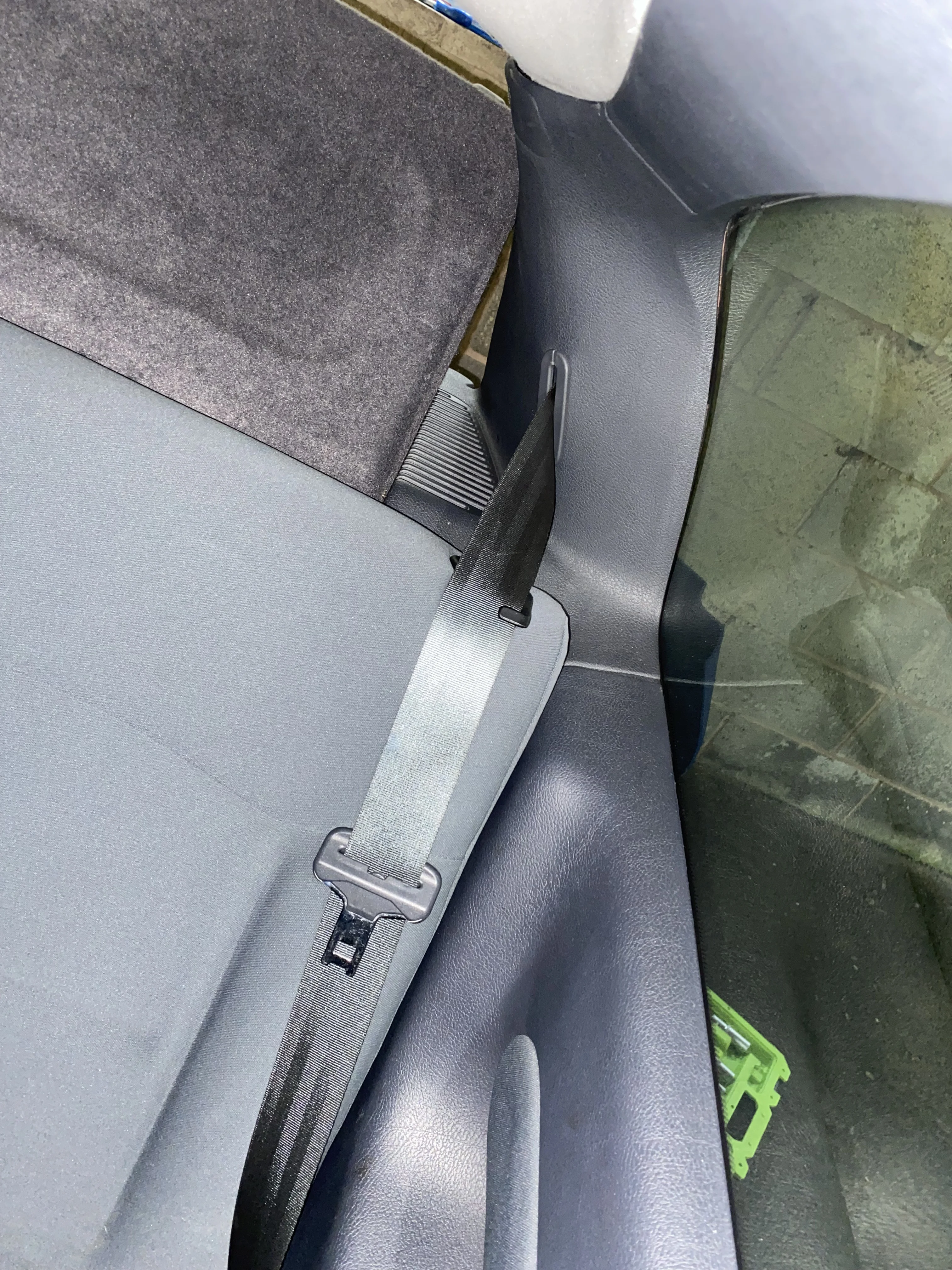

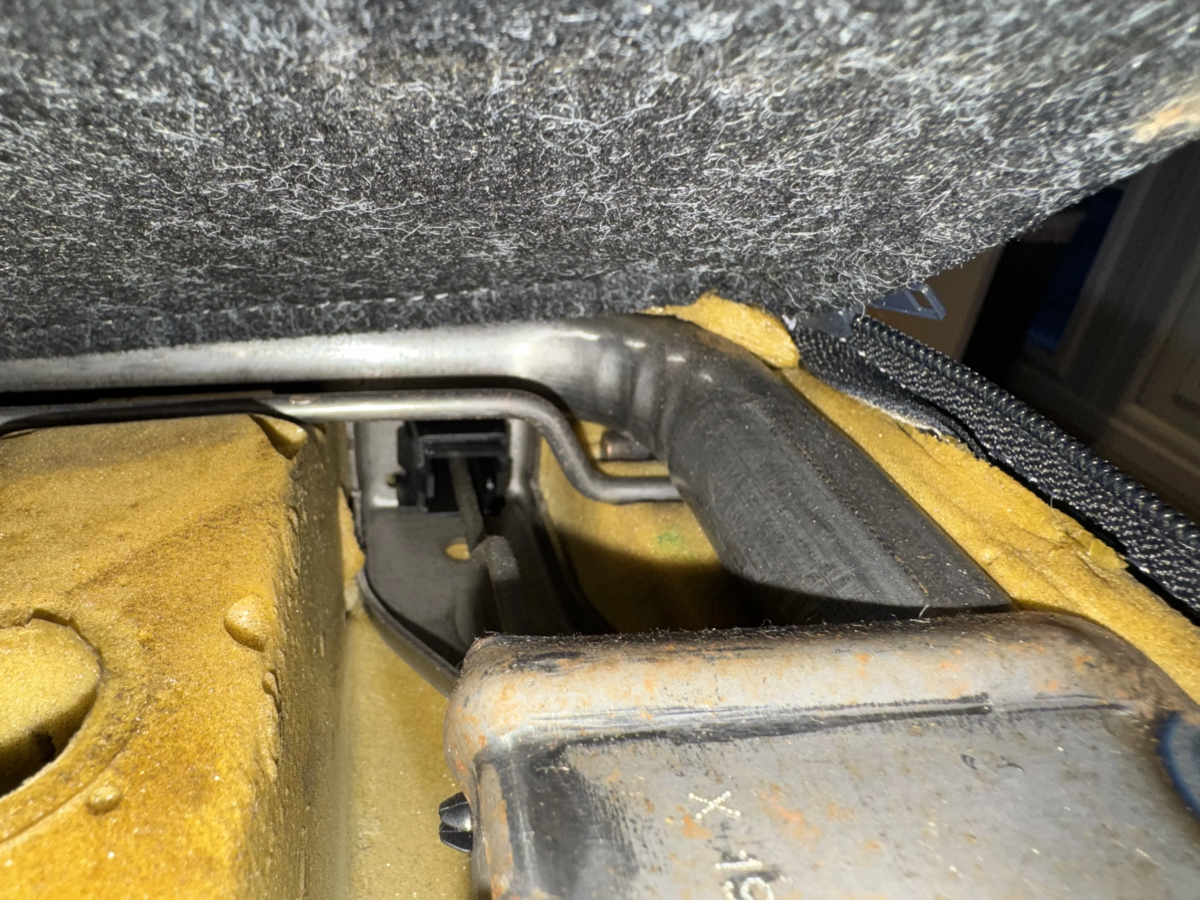

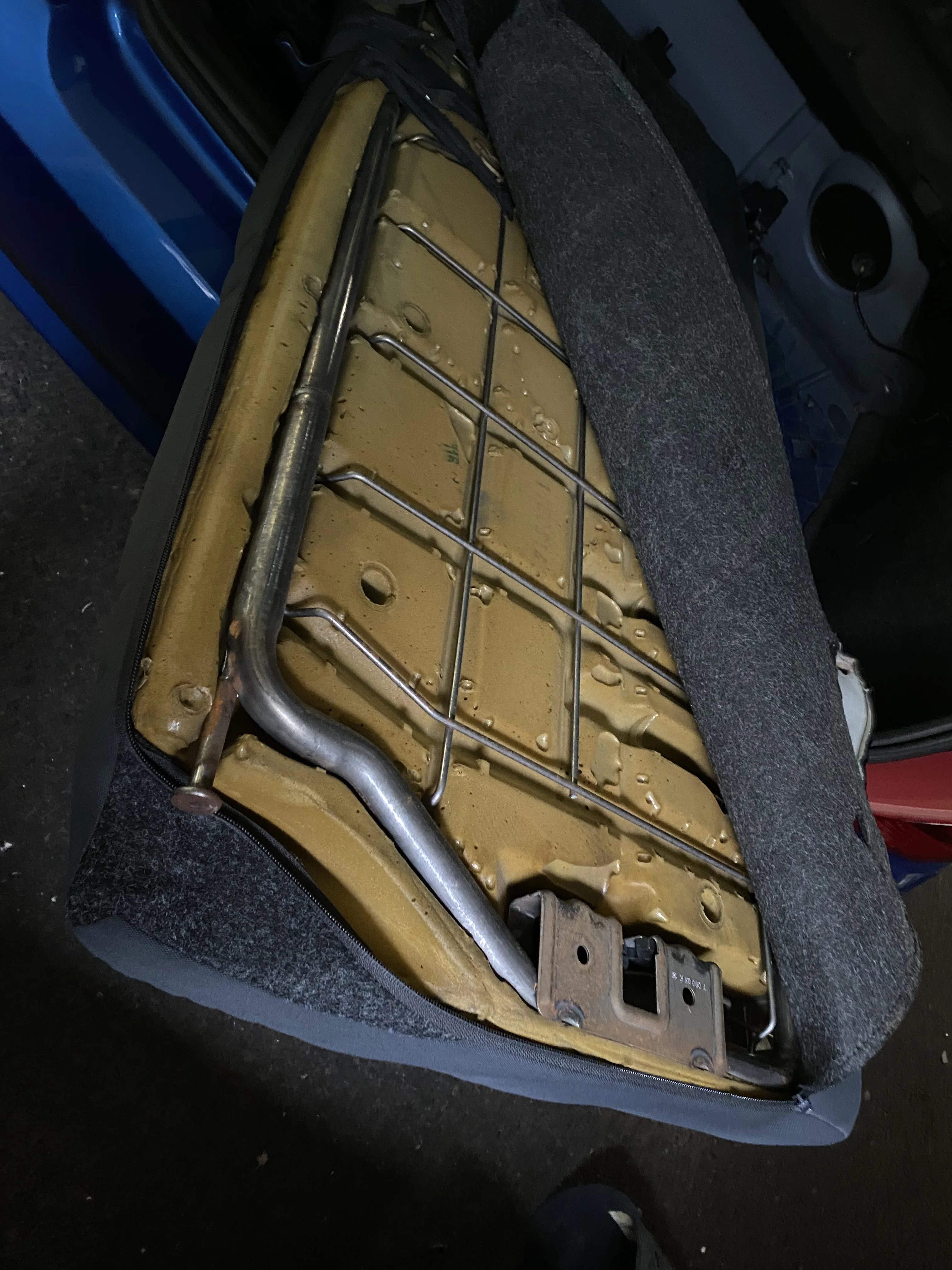

A few small jobs done today.

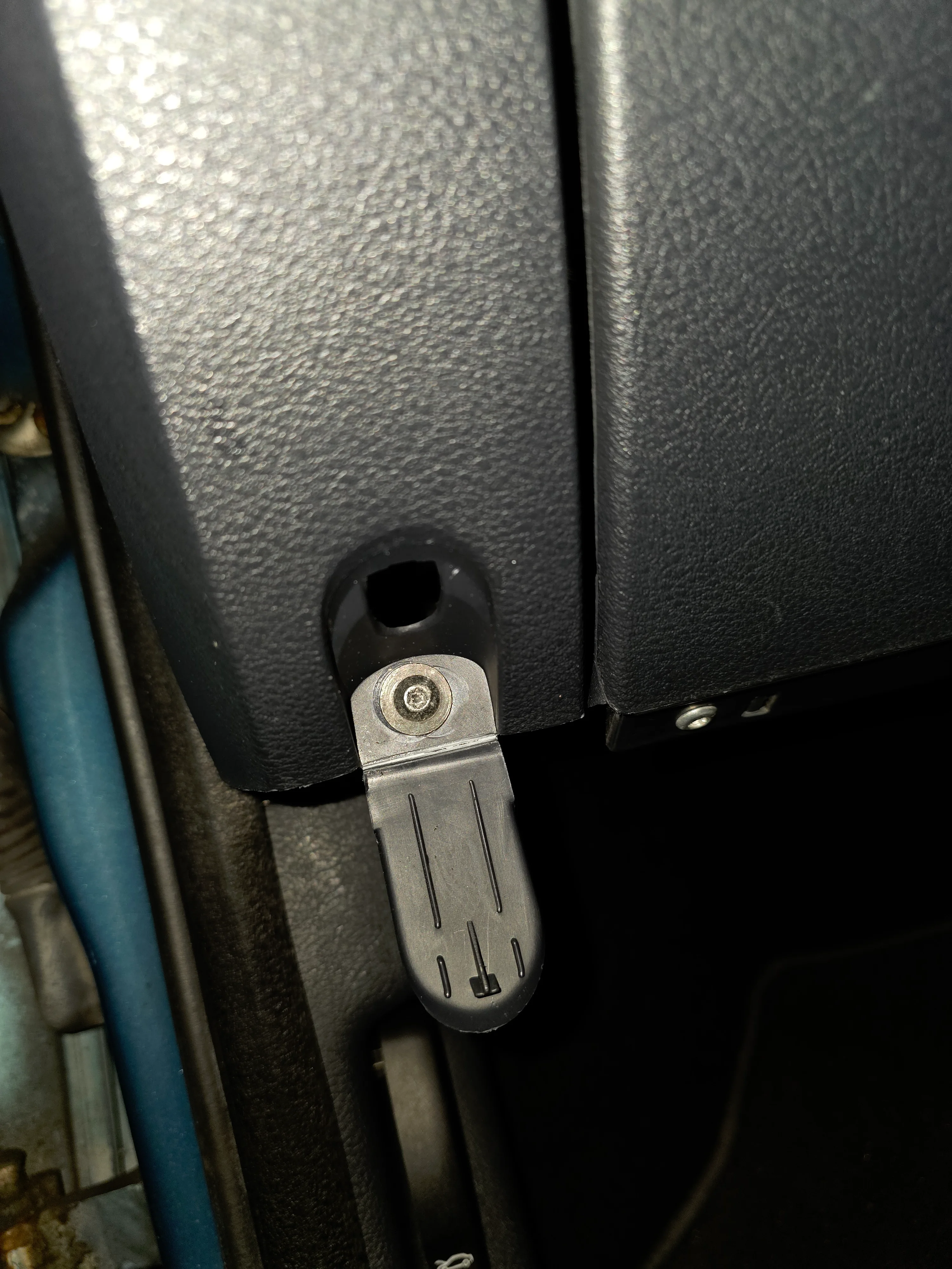

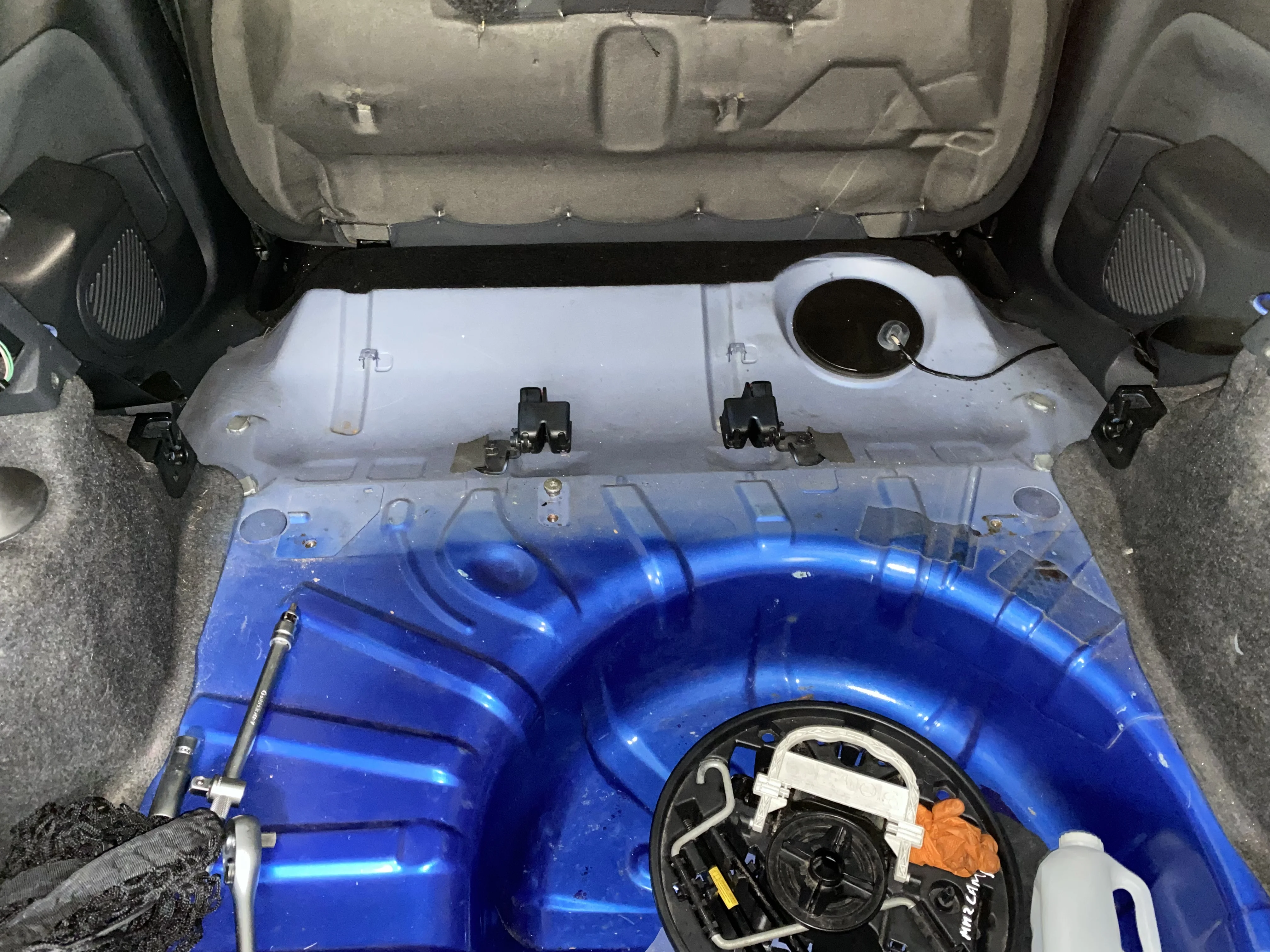

First up was to fit the rear seat release buttons that I got from eBay this week. Thankfully I had used some copper grease on the bolts that hold the ISO fix bar in position when I removed the rear seats and panels to check the inside of the rear wings last year. These came out easily and the rear seat simply lifted out of the car. The zips were a little tight but they came undone and it was easy to release the old damaged buttons from their position. On with the new ones and it probably took me about 30 minutes to complete. It was by no means a major repair, but it was something that bugged me since I’ve owned the car.

Now, there are another couple of issues that I’ve had recently that I’m trying to resolve. First is a noise from the back of the car which I was sure was a rear shock absorber. I’ve posted in the suspension section about this, but it looks like both of the rear shockers are leaking. They are only about 2 1/2 years old so I’m really disappointed in their performance. I think I’ve only ever had my dad in the back of the car once, and a set of golf clubs every other week. These must be really weak items for them to fail in about 24,000 miles and I’m sure they are genuine items that I had fitted.

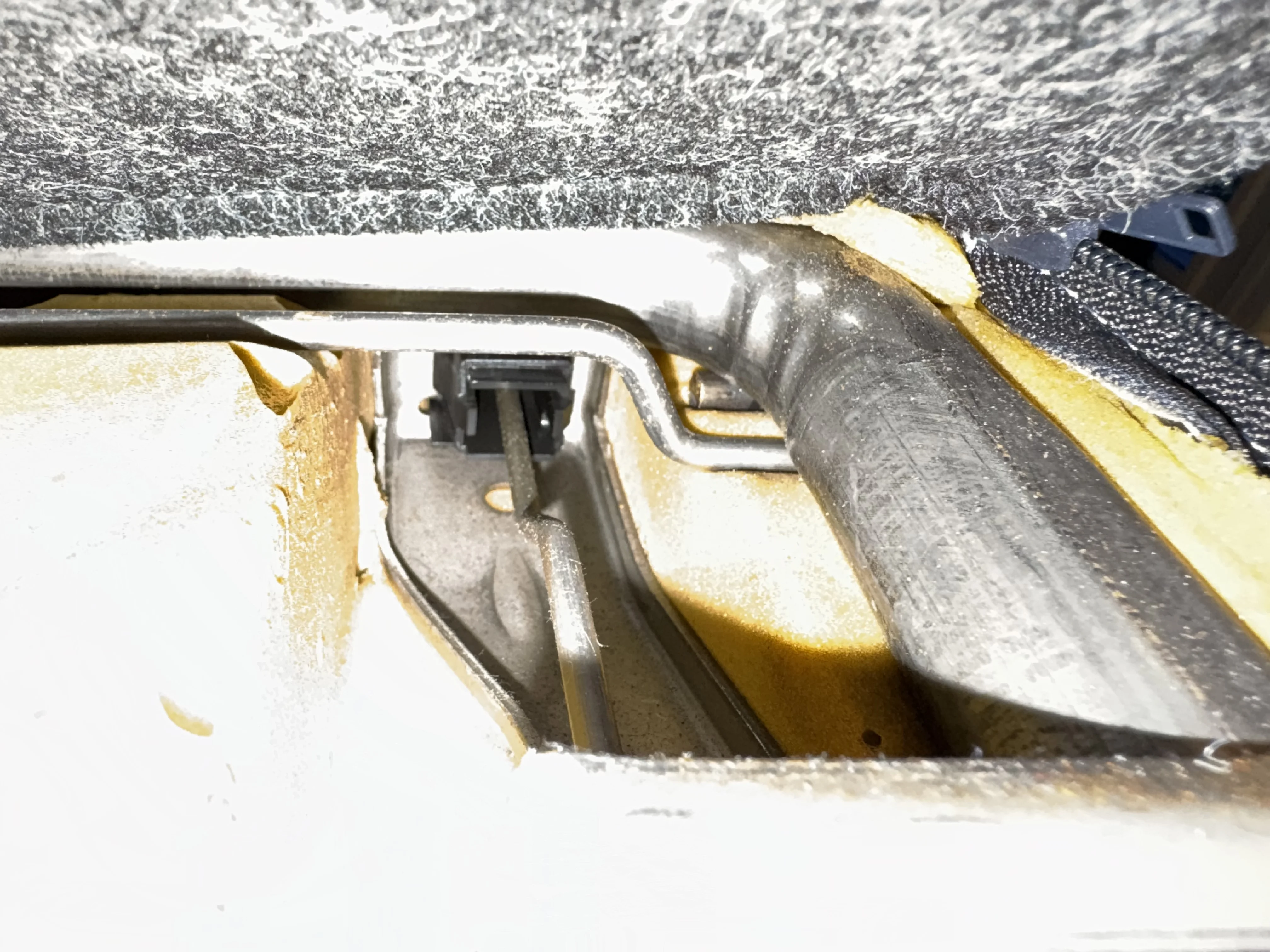

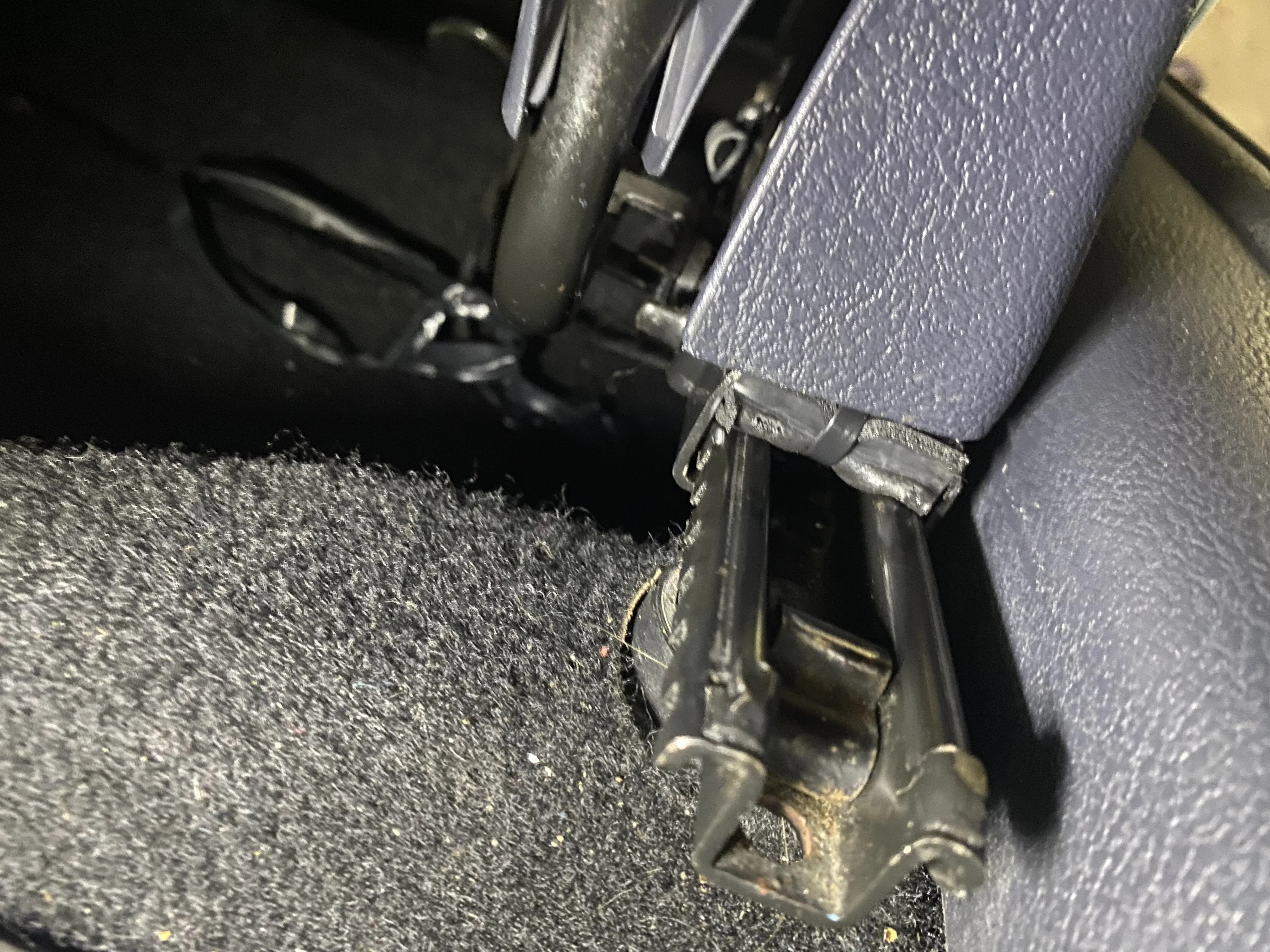

I also have a rattle that is coming from the front passenger seat. I’ve had a really good look at it today and it just seems that the plastic looking bearings that are part of the seats ability to slide forward are worn. I’ve greased everything up, but if you move the seat back-and-forth gently, it makes a clunking noise. I don’t know if there’s anything that can be done with this, but I will post a video up in the interior section just to see if anyone has an idea of a fix.

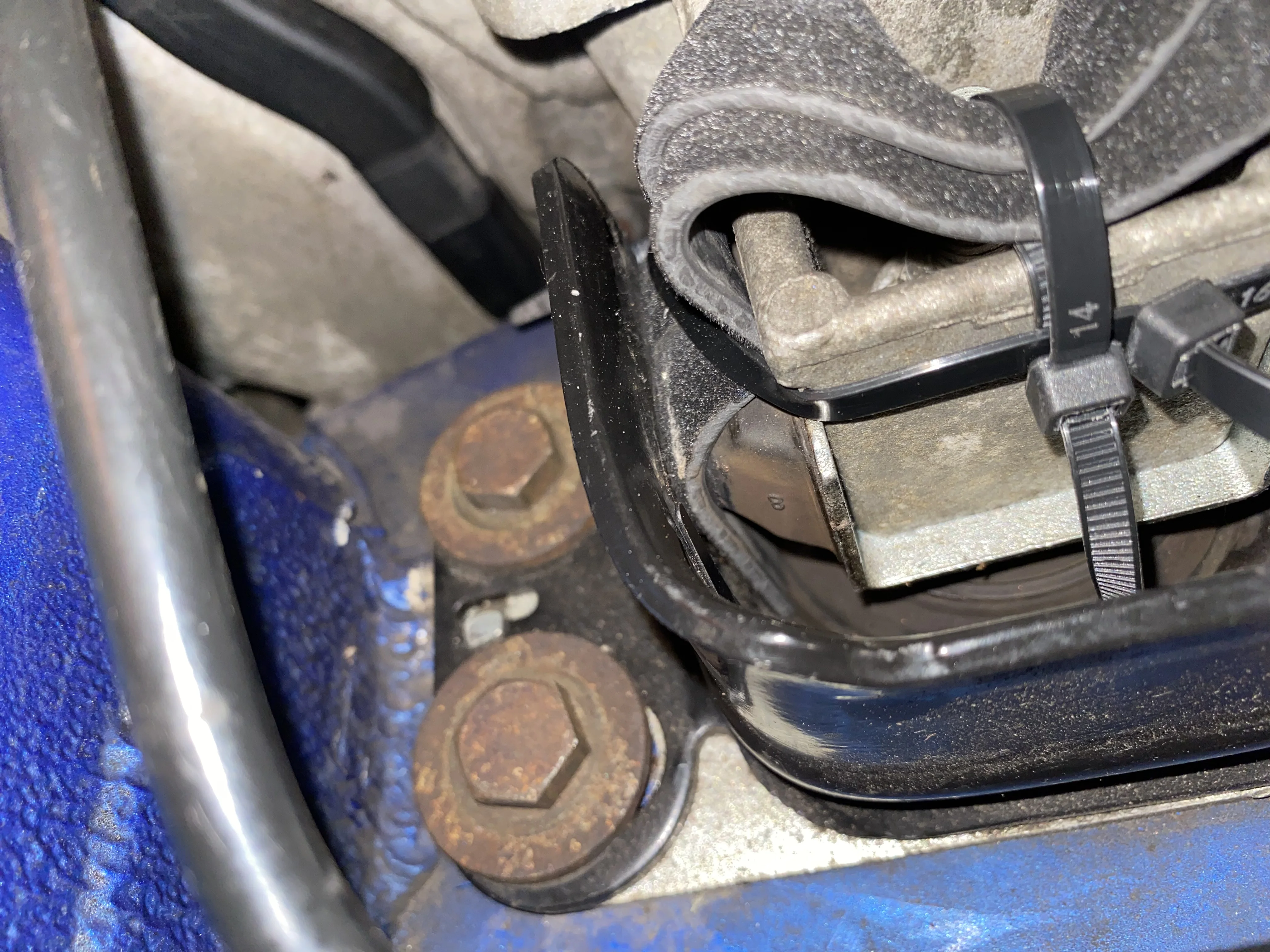

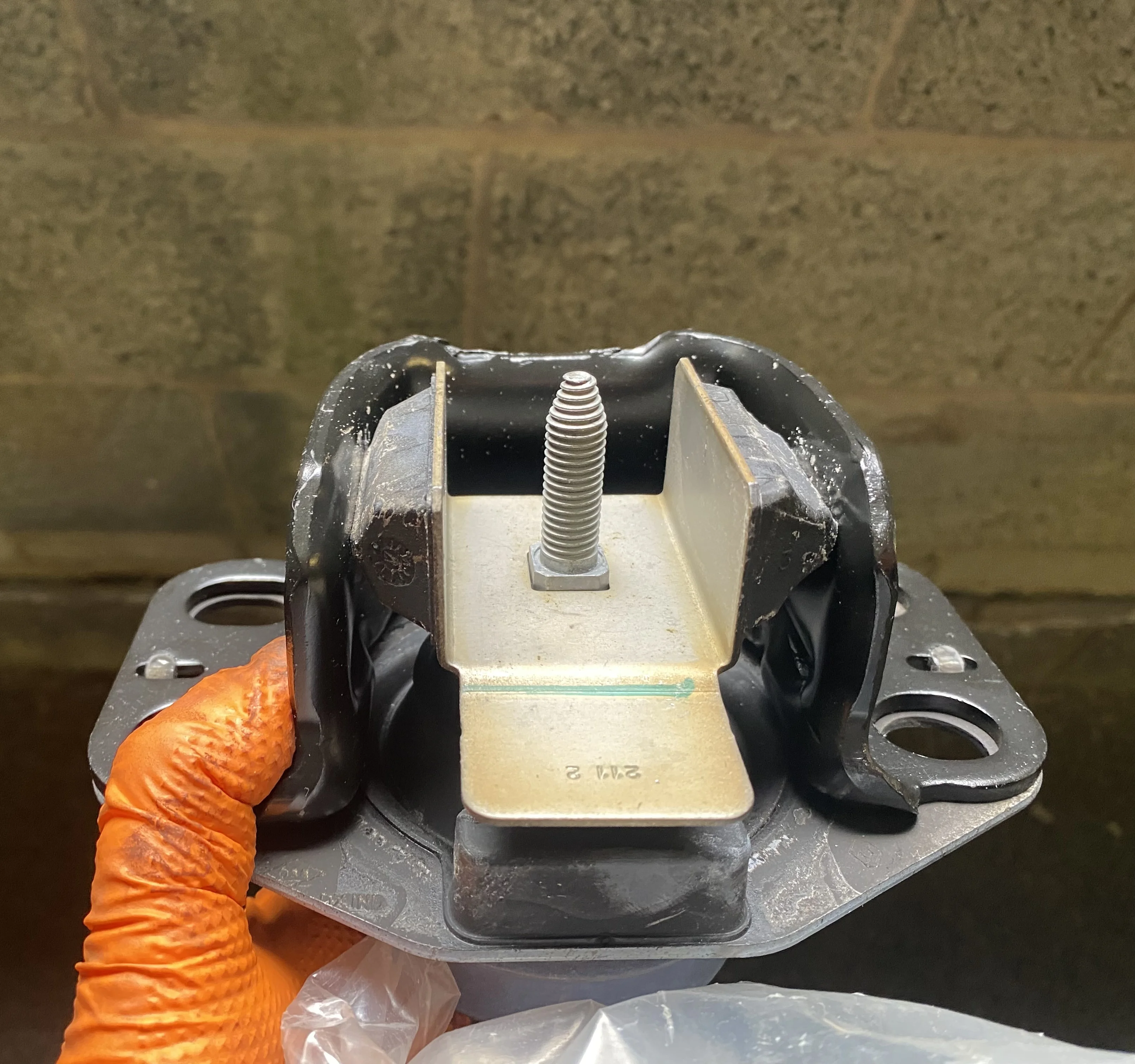

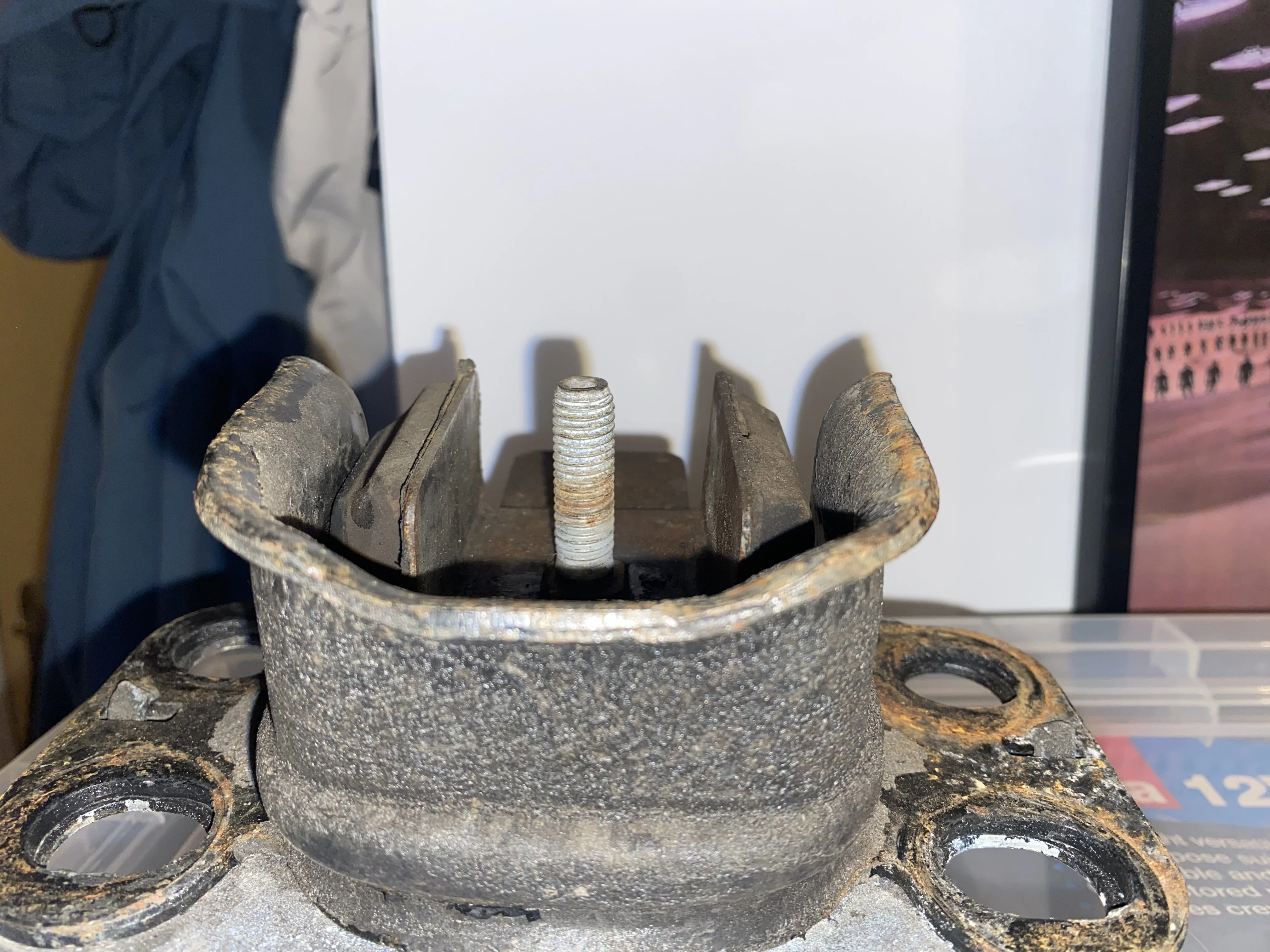

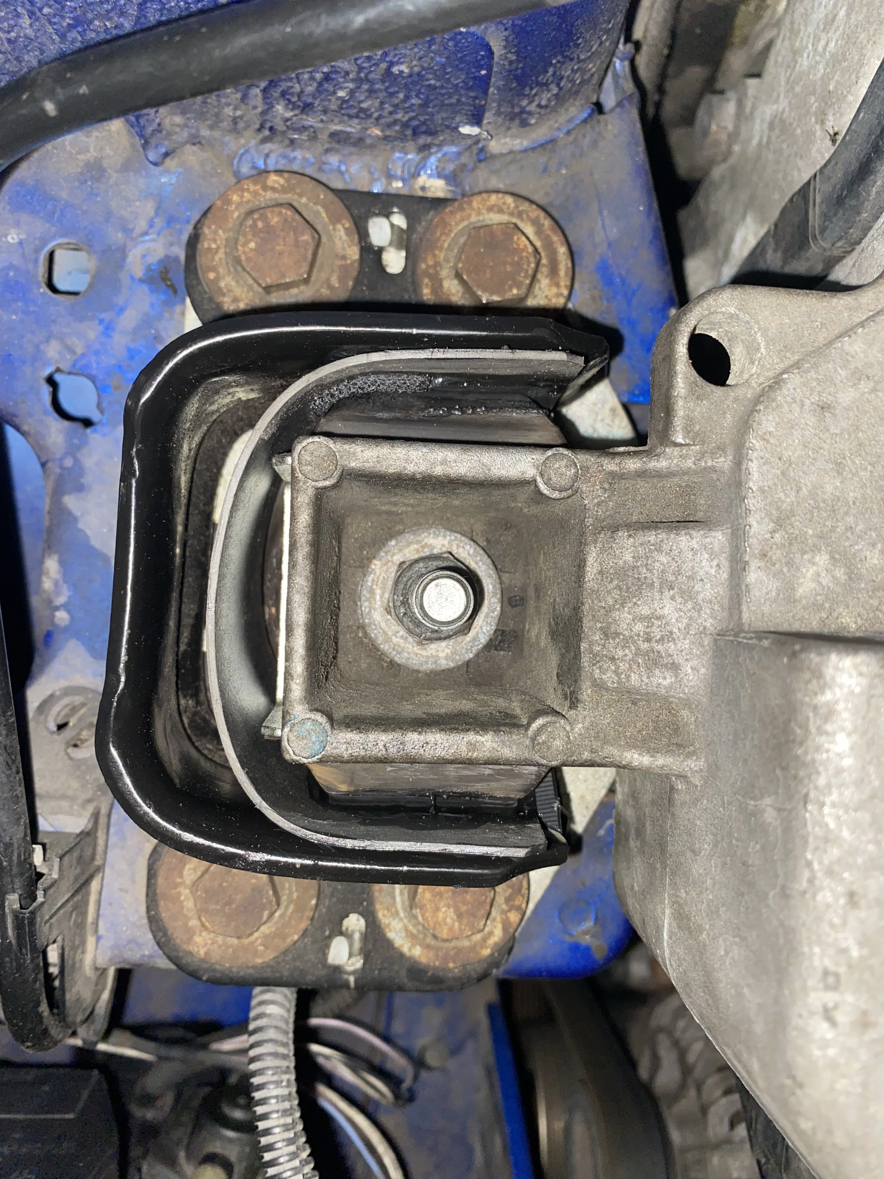

Also, I have the knocking noise from the top engine mount that is on the driver side. I’ve already mentioned this before, but I’ve double checked today and every nut and bolt is tight. I’ve moved the engine back-and-forth so it makes the noise and I’ve put my finger on all of the places that I can to feel anything that is loose. There is nothing at all that is loose that is accessible without removing the mount itself. So, I’m certain it is the bolt that is in the centre of the mount and there is a problem with it that is inaccessible and I’m guessing that this is going to require a new engine mount. Once again, this is a genuine item that was only fitted last year. I’m unsure if there’s anything that can be done to reset the position but I’ll post it here just so that people can give me their opinion. For the moment I have put some pieces of rubber trim in between the rubber buffers that make up part of the mount. With these in place, with some cable ties to make sure they don’t fall out, there is no sound from the mount. I’m guessing that the only solution to this is going to be a new engine mount but please let me know what you think.
I just checked what I had fitted and the engine mount is Febi part that was £37 and has lasted about 14 months and 12k. A genuine Renault part (6000073669) is £92 and can't be as sh1t, can it?
A new issue this week and that was the noise coming from the back. I’ve posted in the suspension section and put that there was a different sound from the rear which forced me to check the rear shock absorbers. They are not that old but they both appeared to have oil leaks. I managed to get a new shock absorber last night from @photo_ed and I fit it today. I did read several posts on how to do this and I followed the instructions. I had also read that the shock absorbers should be primed before you put them on. I did that and I noticed that there was a very little difference between the resistance on the new shock absorber and the one that I took off. With the shock absorber now being extended, I had to use my trolley Jack to gently raise it so I could put the 18 mm bolt in. Everything was put back together with copper grease applied to the large bolt and the road test gave the impression that everything was well again. I did check the other shock absorber and strangely there doesn’t appear to be any sign of the oil that was leaking down it. The car was dry underneath when I checked the other day so I highly doubt that this was any kind of moisture that a dripped down. It’s a little bit baffling but then again this is a Clio!

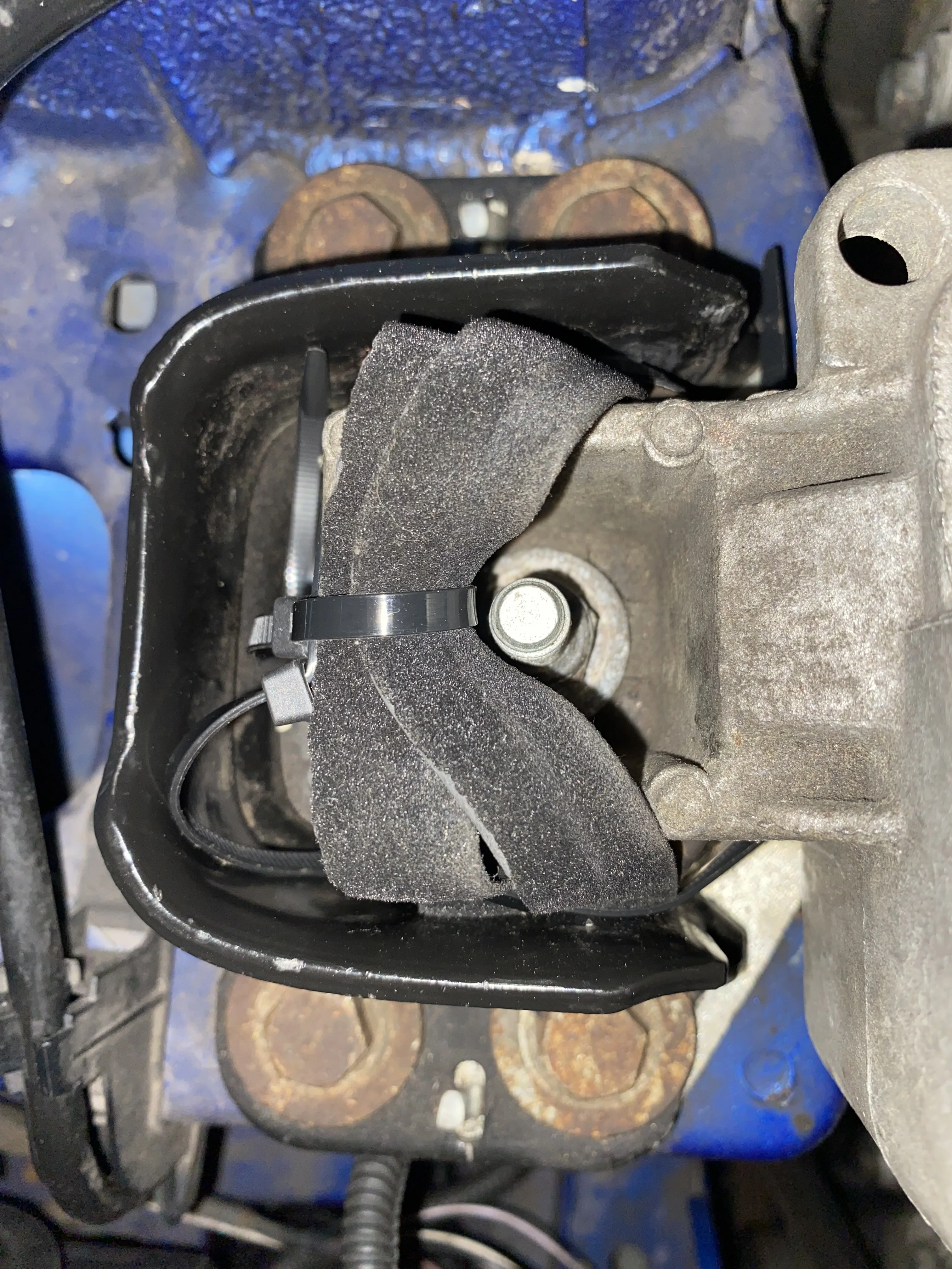

I made an insert out of some hard plastic to go between the rubber bushes on the top engine mount. These are now securely in place as the last effort had moved slightly. I’m pretty sure the engine mount is shagged so I will get a new one but I may leave it until the next service before it’s fitted. It all depends on how much this one starts to bug me. I do have another another engine mount here but it was fitted to the car previously and it made a silly squeaking noise. Yes, another noise that I eradicated that I don’t want to come back! If I’m desperate, I can fit this but I had to helicoil one of the bolts that go into the top of the engine as part of the mount and I’m really not in the mood at the moment to start doing that and faffing around. I’ll let this one play out.

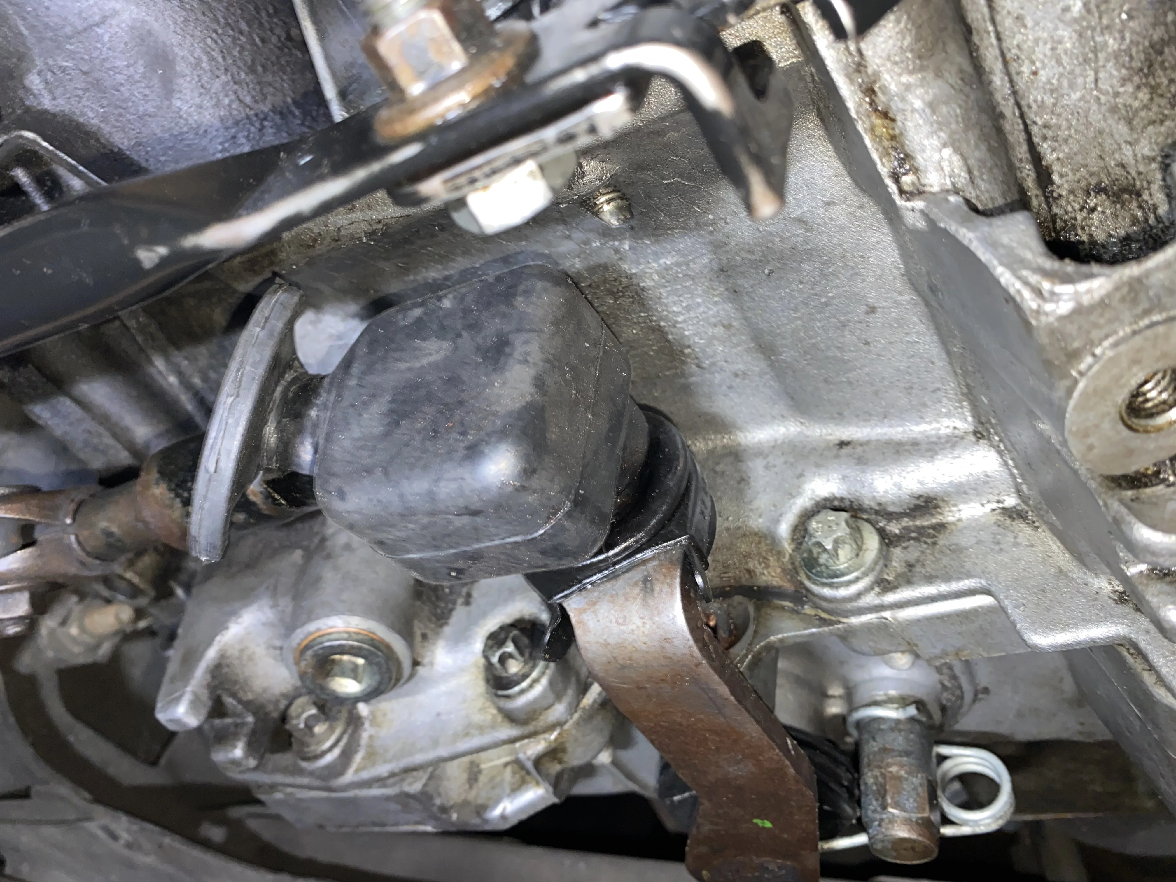

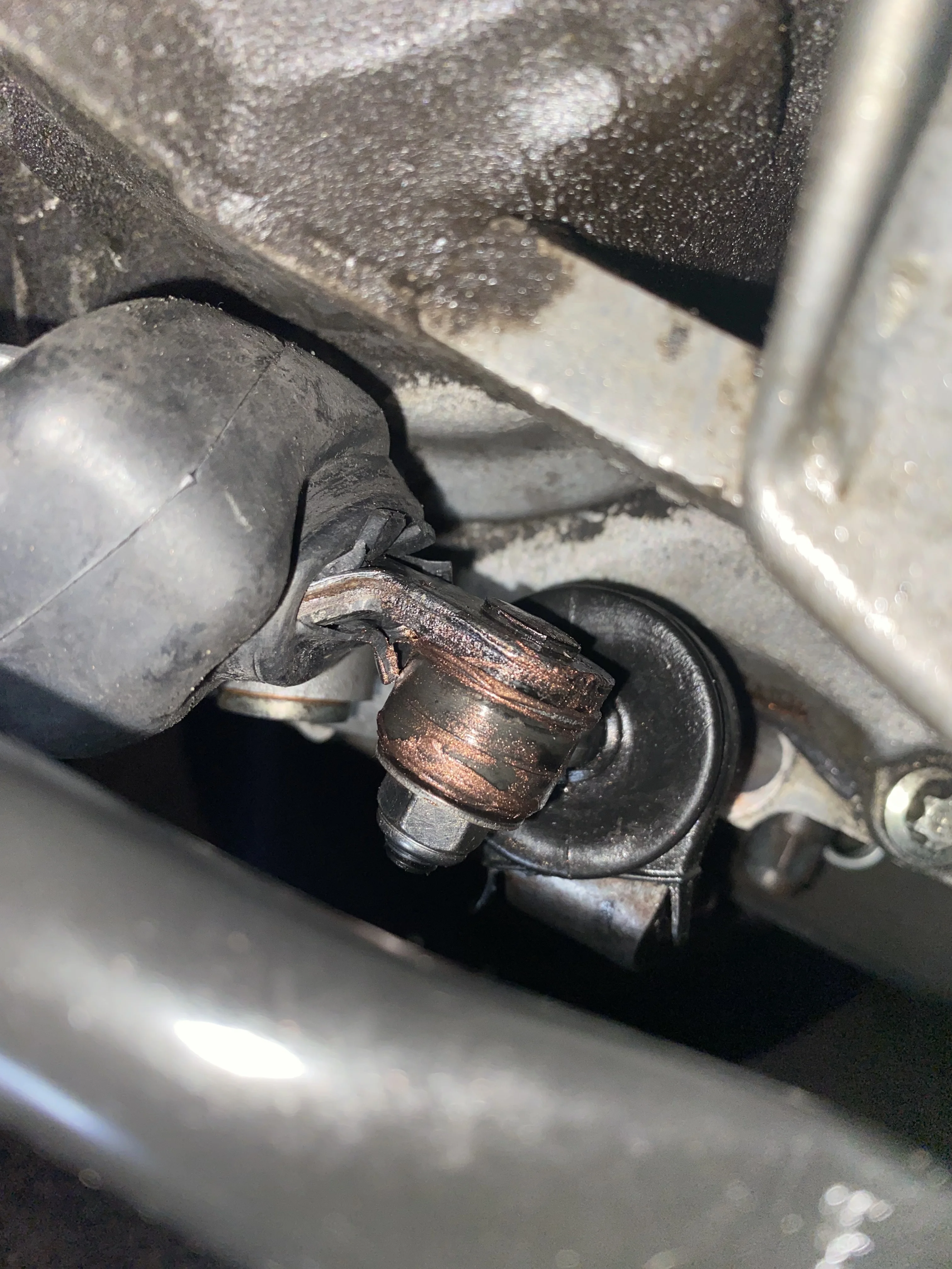

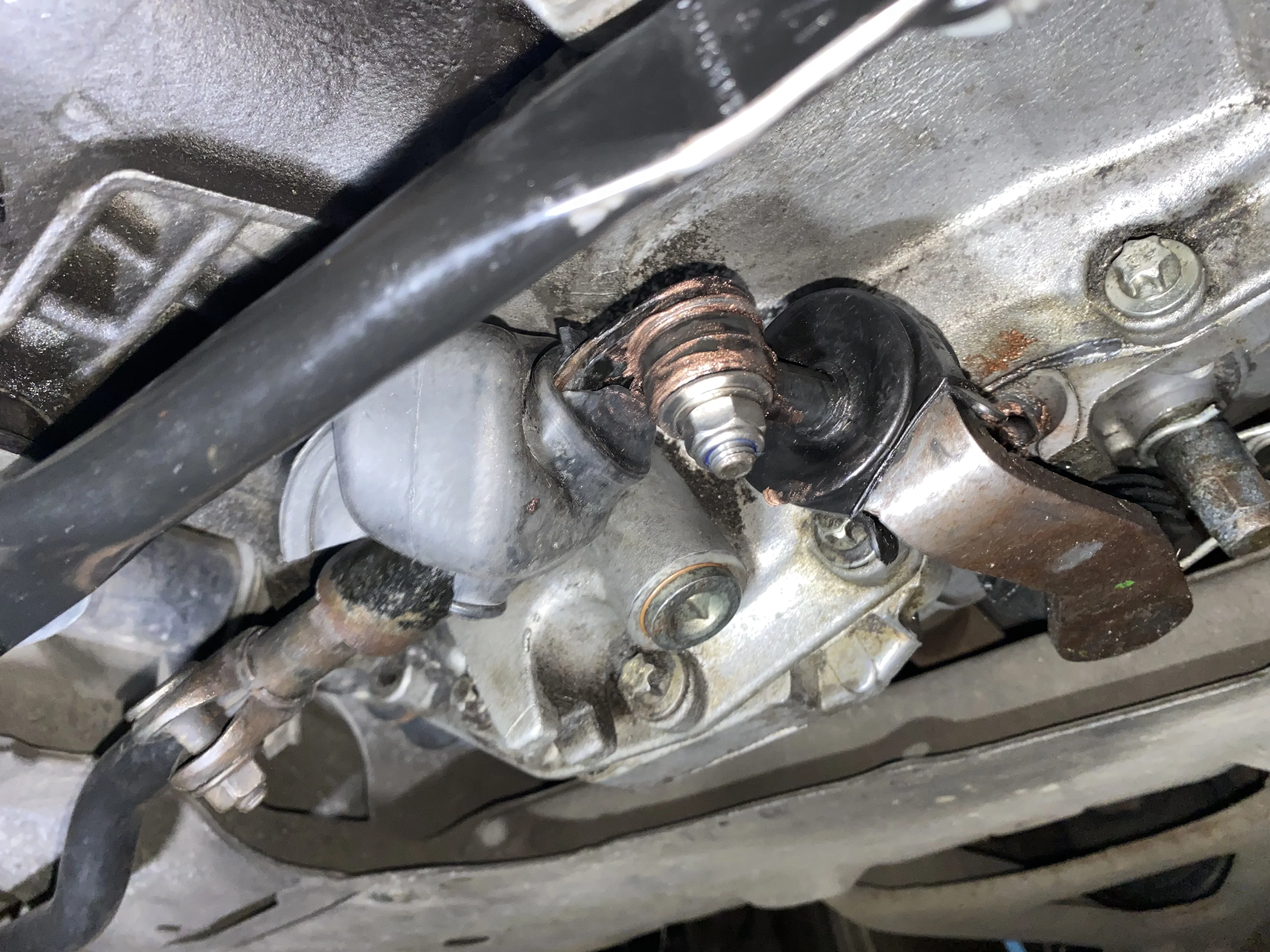

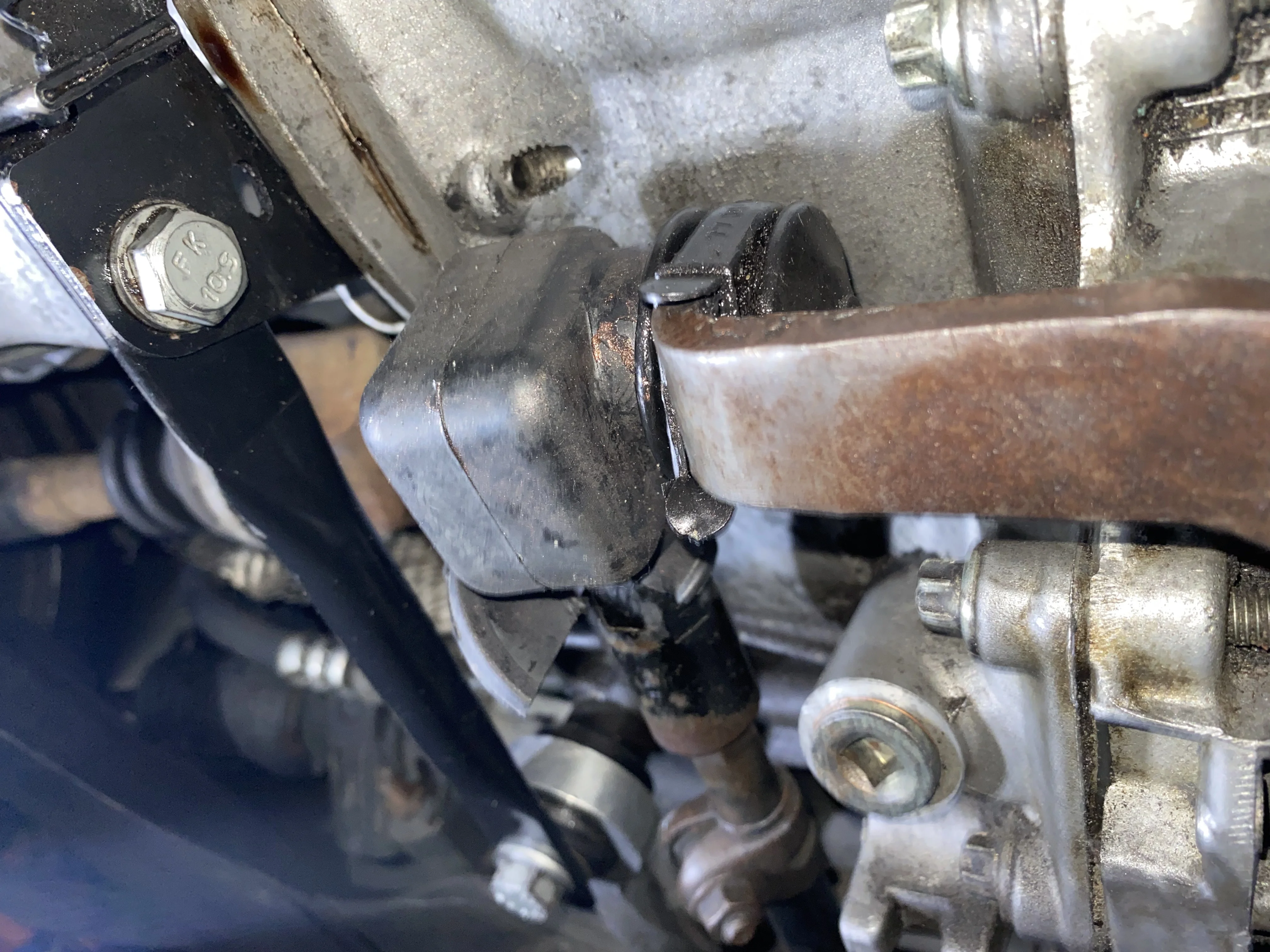

However, the big win today has been with the gear linkage. If you’ve read through this thread, you will know how much of a pain the clunking noise has been from under the car. You’ll see on a previous video that it was traced to the gear linkage rod and selector finger. So today I simply removed the under tray, unbolted the rod from the finger and use some washes and a nyloc nut to make sure the free play was eradicated. A new rubber boots was fitted and also this wasn’t exactly the same as the one that came off. I modified it slightly and it now does exactly the same job as the original one.I’ve been on a test drive and done all the things I did previously that were making the noise and today I can’t hear anything. I’ll have to keep an eye on it because it’s a repair I’ve done myself but I’m putting this down as a major success.

I'll also get the engine mount, an original Renault one, as I remember that a second-hand mount I had on last year did make a strange noise and it could be the same with this Febi part I put on last year.
To stop the rattle from the runner on the passenger seat when no ones in it I had an idea. I cut a piece of old bonnet strip, the piece that sits at the front of the engine bay that keep water out, to fit just inside the track. It's attached to the runner so moves with the seat when it's moved back and forth. Both sides have been done the same and now there's no rattle. Easy fix rather than try to find a decent runner from somewhere.
The seat rattle has gone. Yippee! Such a tiny win.
I got two new parts delivered this week. One is a new rear damper, which I’m hoping to fit later today, and the other is a new original Renault engine mount. I now know why I’ve been getting noises from engine mounts and that’s mostly because the ones I fitted are a bit s**t! You can see from the photos that the mount that I had fitted last year, the one that gave the squeaking noise, and the one that I bought new ( the £37 Febi copy) are not the same as an original part. You can see the gap between the rubber bushes and the solid body evidence on the copies, whereas the Renault part has no gap at all. The photo of the mount on the car has a plastic insert that I made myself to stop the movement. I’m not sure if I’m going to do the engine mount myself because it’s a bit of a pain but when it’s done anyone who wants some engine mounts can pick them up for nothing.

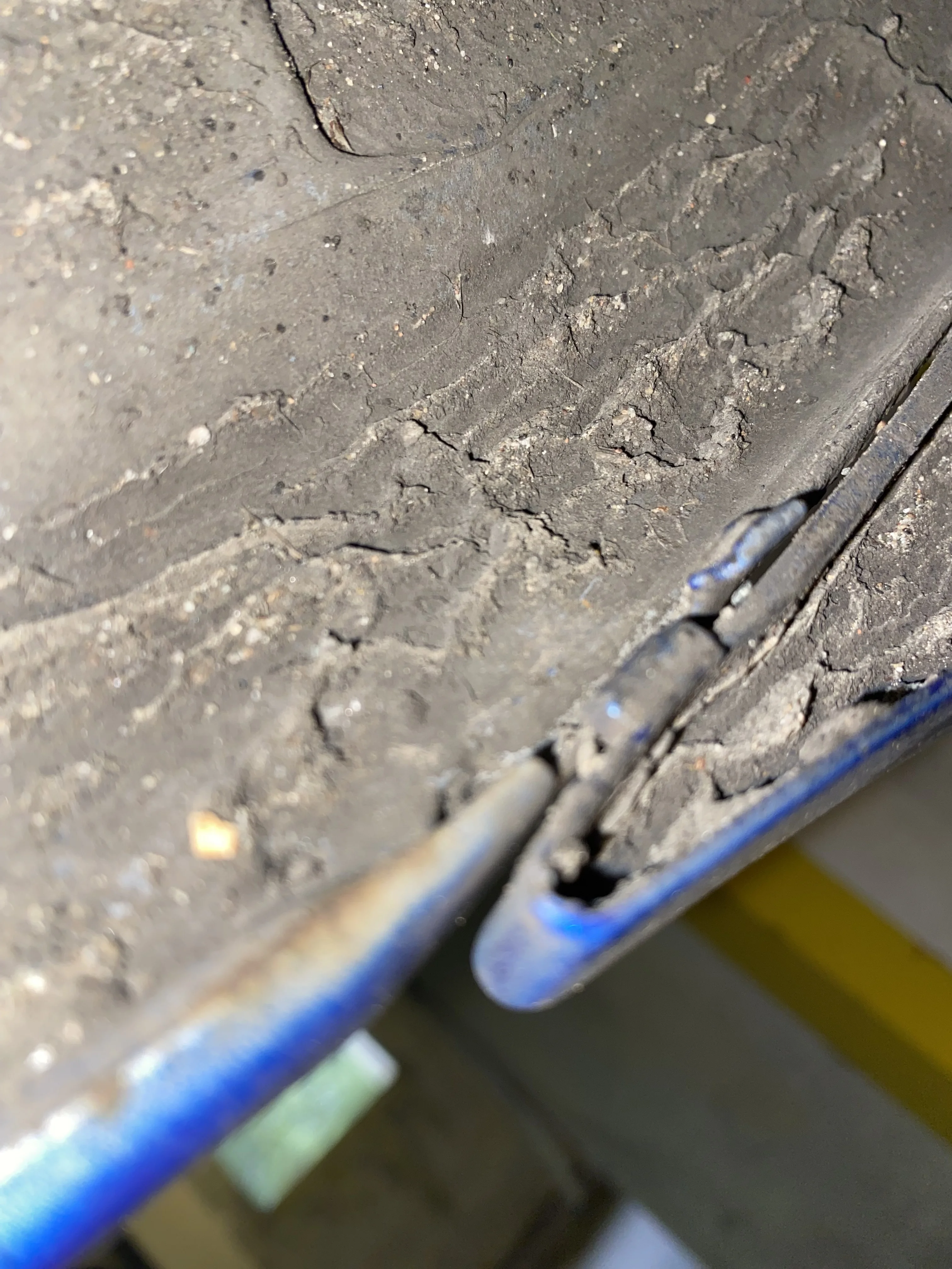

I’ve also been trying to diagnose a noise from the back of the car and I think I have found the issue. With the handbrake off, if I put my fingers through the wheels, I can move the pad carrier about quite easily. I can make it make a knocking noise and I have been told that it requires the sliders packing with more grease to reduce this. I checked the other side of the car and it’s very difficult to make any noise when pressing the slider. I’ve ordered some red rubber grease and I may attempt to do this job myself, but I’m not too sure. This slider is the only thing at the back of the car that now has any loose play or movement. I have done absolutely everything including taking out the parcel shelf to find out what this noise is, but the thing I forgot is that when you apply the handbrake the braking components all go tight and you will never move them with your fingers. With the handbrake off it’s so bloody obvious! I’m trying to look at it positively in that I’ve just learnt something else about my car. No harm done as the two dampers that are coming off are in excellent condition and I can either sell them on or keep them as spares.
Just check the rear pads are fitted correctly, with the tabs on the rear of the pad located within the piston grooves

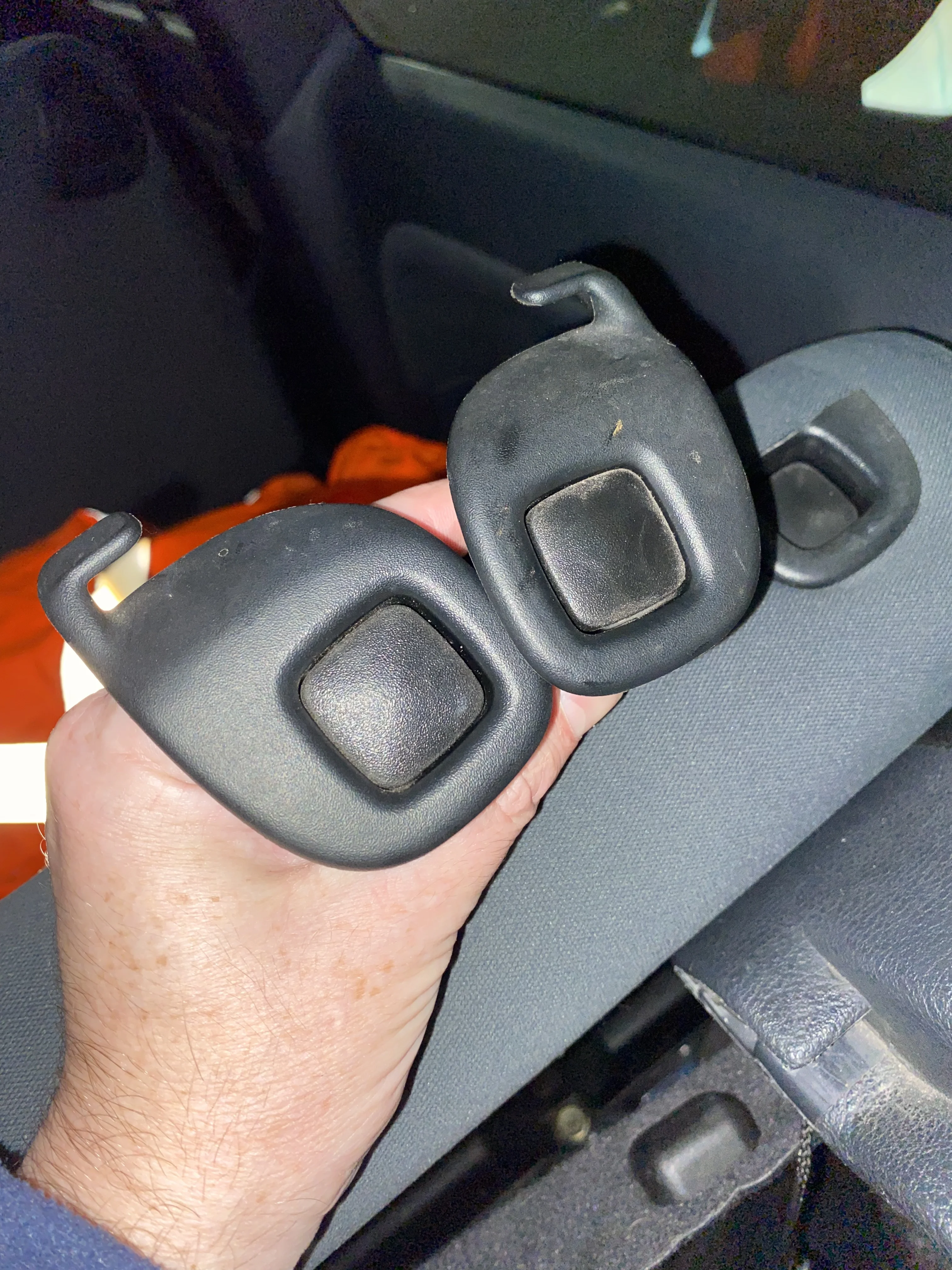

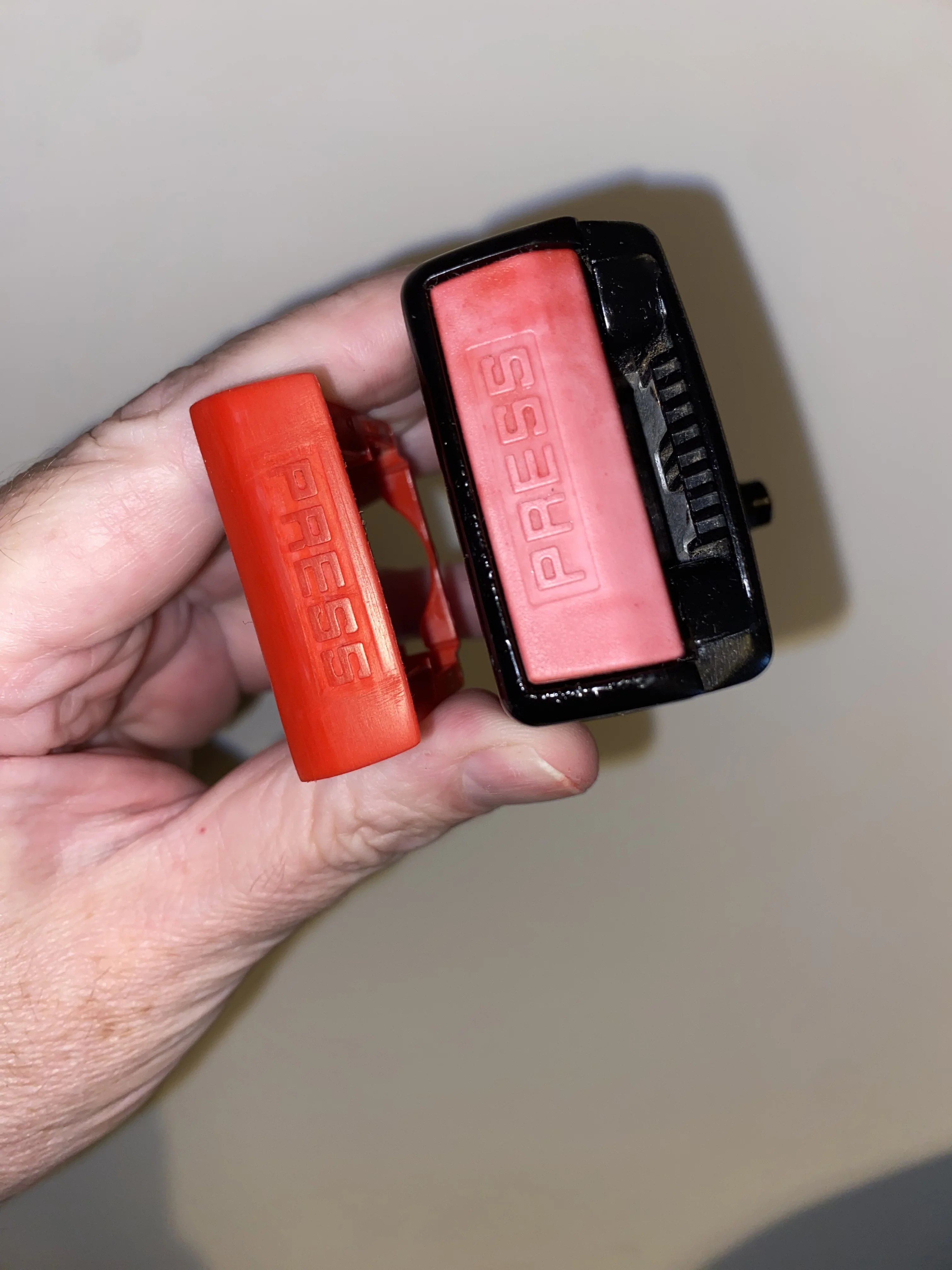

Last night I had a spare hour so I had a go at seeing if the seatbelt release buttons in the front could be improved upon. I had bought some rear release buttons from a Renault Laguna and they appear to be the same size as is in my Clio. I managed to get the unit apart and take out the red button and I tried lots of different methods to see if there was any way that I could restore the red. All the usual cleaning products did absolutely zero to it so I broke out some sandpaper and went through various degrees of grit to get something that looks a little better. It’s obviously extremely difficult to get to the indentation where the word PRESS is on the button so I won’t be trying. I had to start with 180 grit sandpaper as the usual delicate stuff was not touching it as I think the oxidisation of these buttons goes quite deep into the plastic. After 15 minutes or so I had something that looked a little better. I have ordered a permanent red marker but it hadn’t arrived so I just used a red dry wipe marker. That has dried on and even if I wet it it does not come off. There’s a couple of areas that I just need to tidy up with the wet and dry so that you can’t see the scratch marks and then once I have the permanent red marker, I will go over it again. I haven’t yet taken apart the ones on my Clio, but they may be easier because there are two screws holding the buckle casing together. The ones on the Laguna needed a screwdriver to prise it open. i’ll report back once I’ve completed it and post some updated photos. Hopefully the mechanism on my car matches this replacement button exactly.
The photo shows the two that are from the Laguna, and the size of them does match up to what I have on my car.
Did you try the ceratec trim wipes on them? I reckon they will work.
No, I didn’t have any. I have seen some videos that try some ceramic coating and I think the results are a mixed. I did try the heat gun method on the ones on my car and it was a really poor result, pretty much making them worse. I’ve also tried some red paint on the passenger one in my car and the result is pretty horrendous. I did try the heat gun a little on this clip that I’ve been working on and again it did nothing. Even when it was hot, I tried to scratch it with my fingernail to see if it would reveal any red underneath and it didn’t. The rest of the plastic on the clip, that’s not been exposed, is in perfect condition and looks really shiny and new. I don’t think there’s going to be much chance of making these repaired ones look shiny unless I coat them with some lacquer. I think brushing the lacquer on will be a mess but it will be a bit of an expense to buy a tin of spray lacquer just for these two little buttons.
