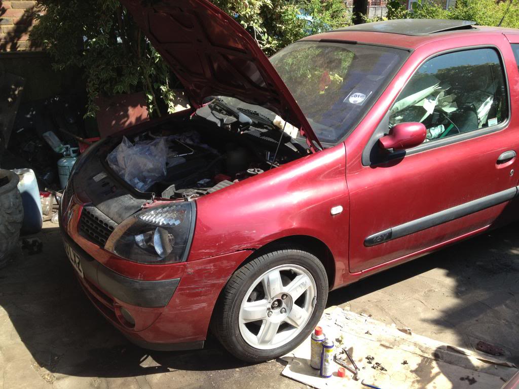

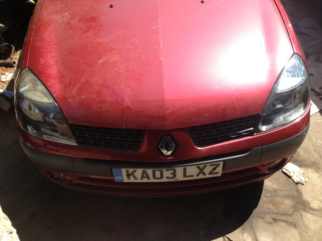

Back in June/July 2013 I was presented with this:
Shame I only took one pic of it in the condition it was in :(
The near side was all smashed in, the light was ripped off and the arch was cracked, both the front shocks and springs were snapped in half, the picture doesn't show you much at all my apologies.
At the time I was only thinking about washing the car as it was green all over even on the inside :L

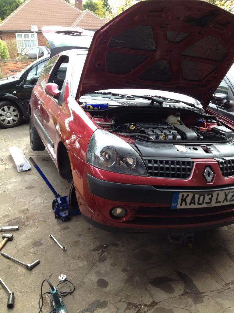

Skip ahead to mid summer when I started work on it:

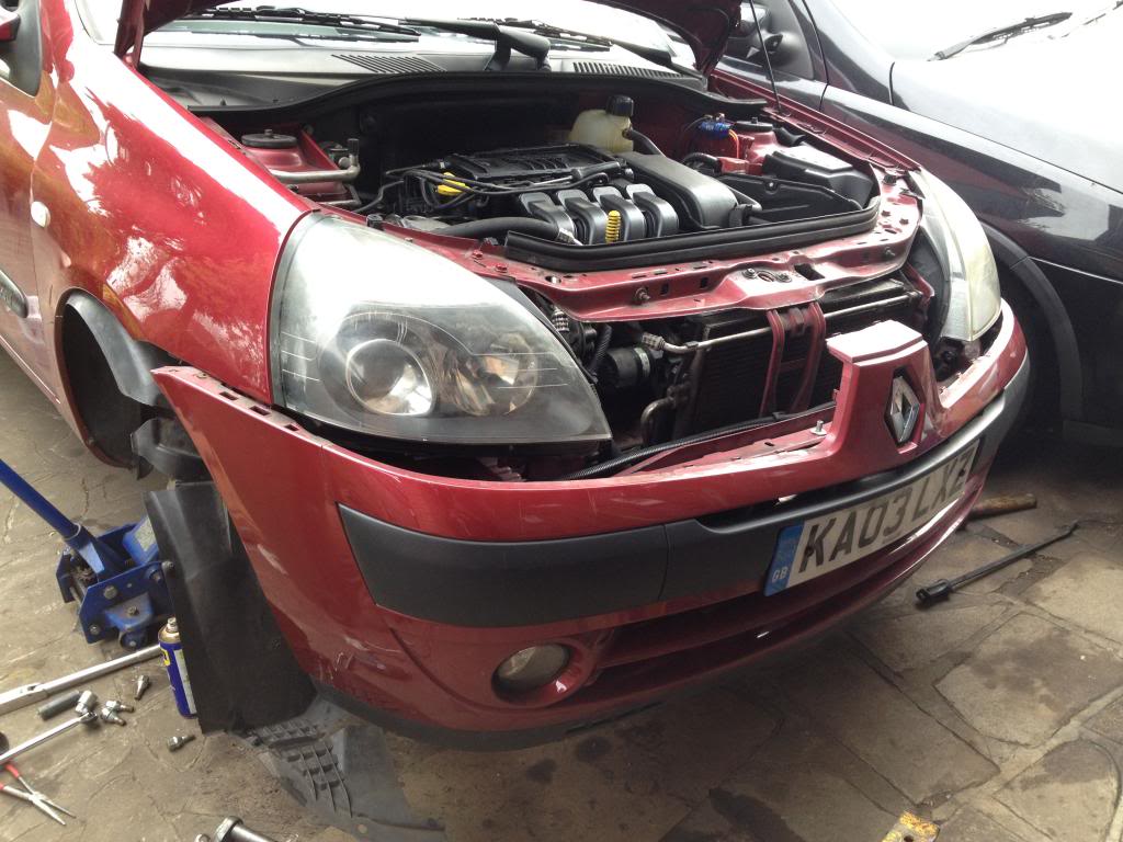

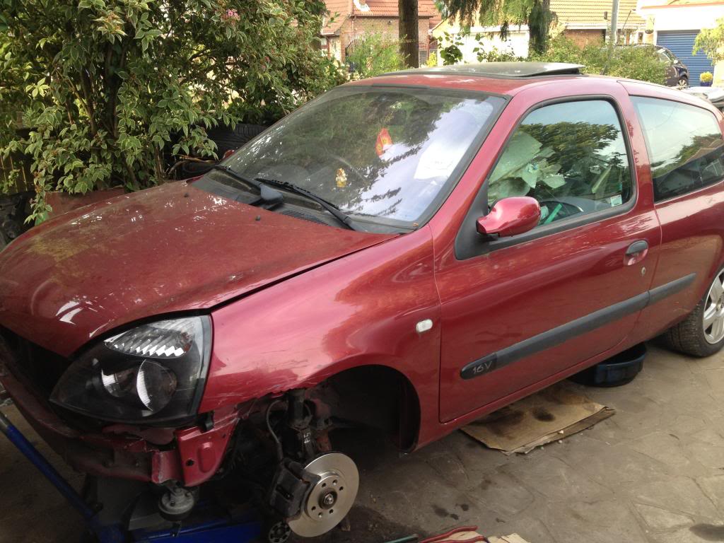

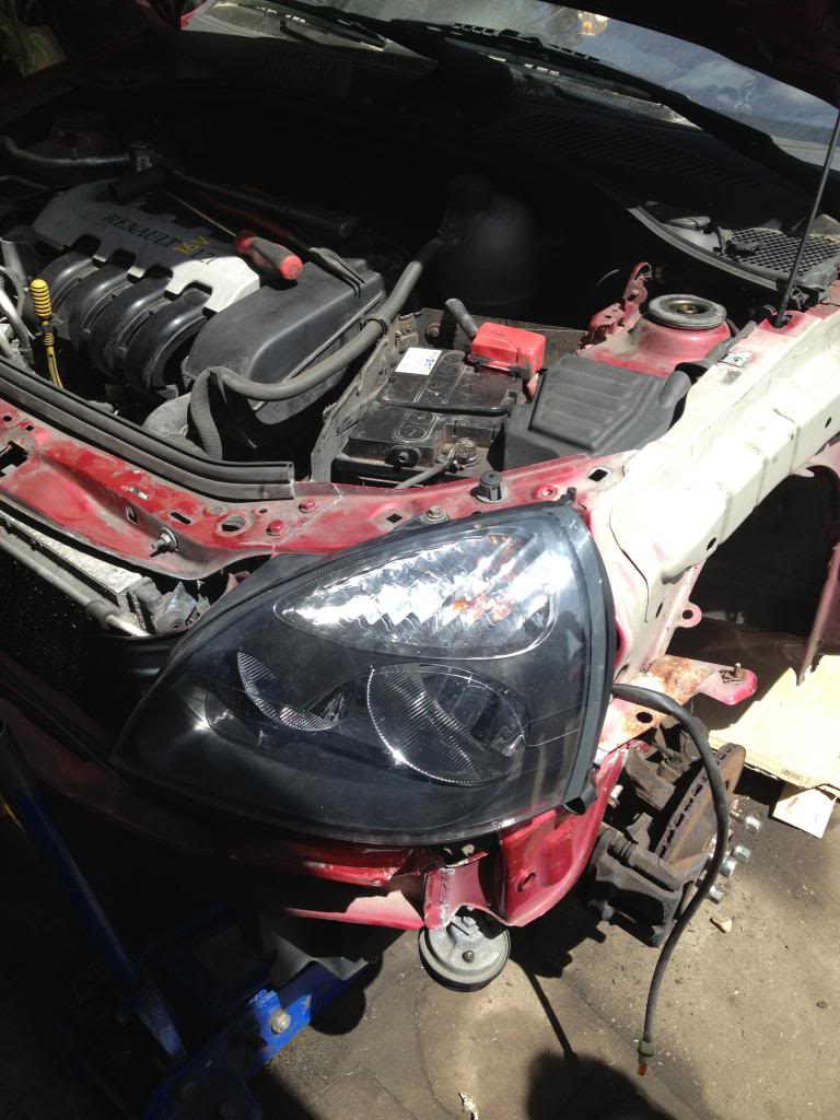

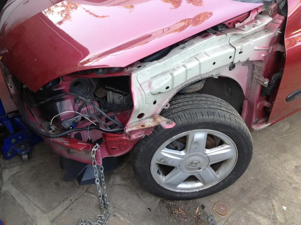

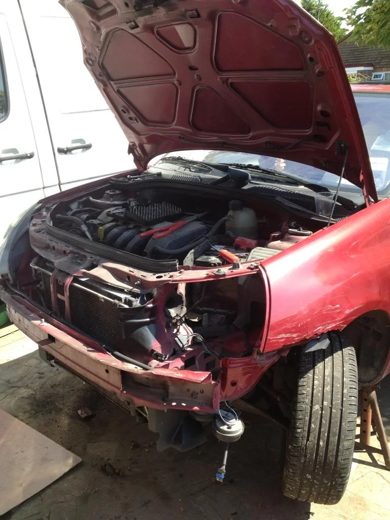

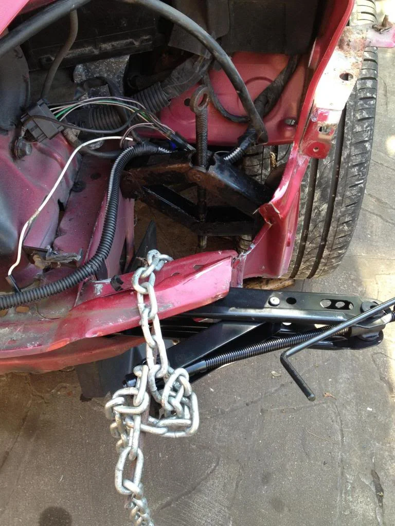

Took the front bumper off to allow more to room to work and to get the replacement light in! But before all that I need to sort out the damage to the support bar at the front (forget the exact name)
So to fix it I utilized a mercedes sprinter that was lying around, got it hooked up via chain to the support bar and then drove past the clio with my foot down which pulled the bar out heres after we done it:
Then I used a series of jacks to pull out the rest of the damage:

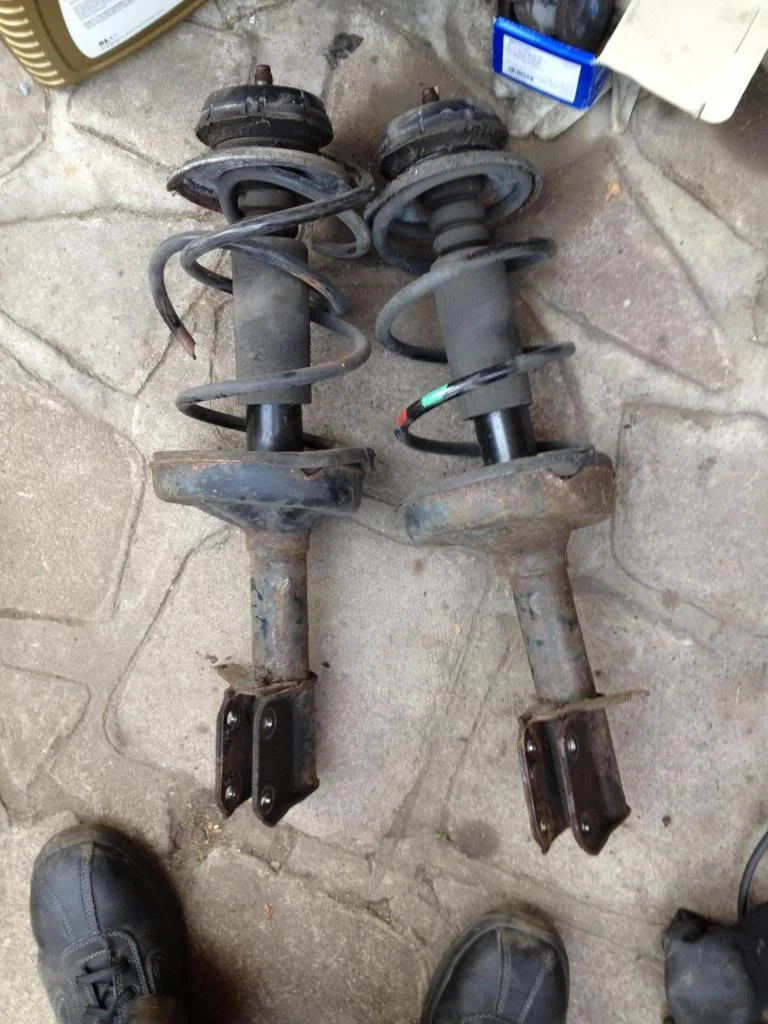

Next up was that broken suspension!
Doesn't look that bad but it was F**ked!!

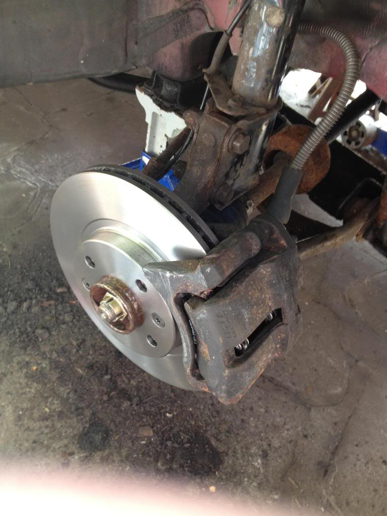

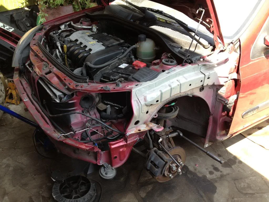

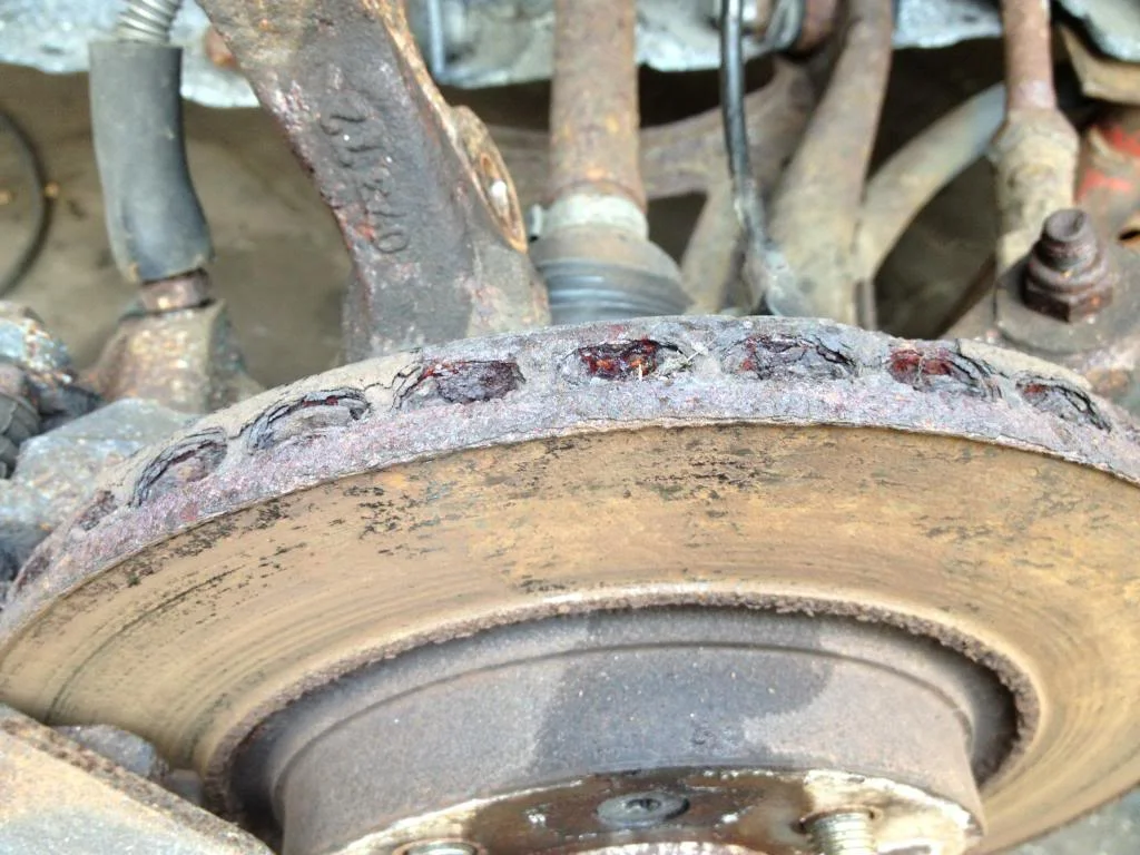

While the suspension was out I thought it would be good to tackle the brakes! The discs were rusted to high heavens and the brake pads were just powder :S
Thats the end of day 1!

Day 2! Finishing suspension and brakes:
Pads and Discs done!

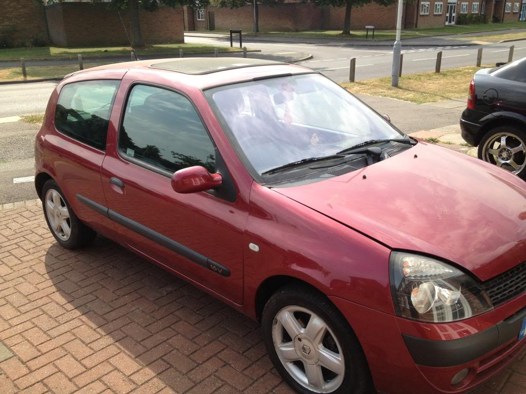

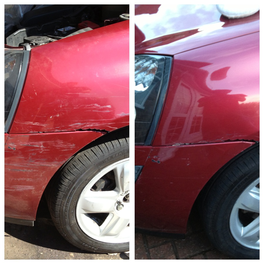

Brought it home for some much needed bodywork TLC!
Before:
After:
Amazing what a bit of elbow grease can do!

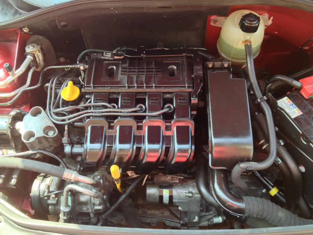

Cleaned the engine aswell!

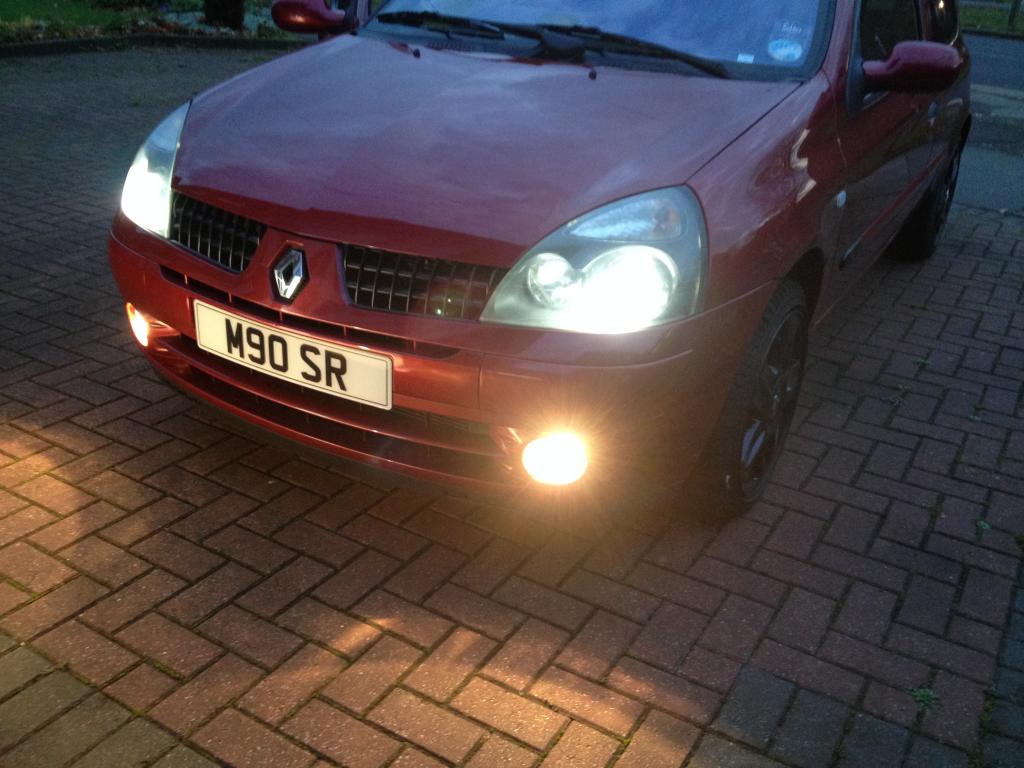

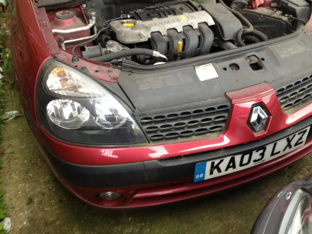

But I have changed the front grill to the RS one and this week I am changing the headlights to xenon ones.

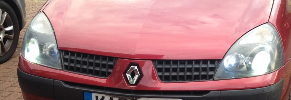

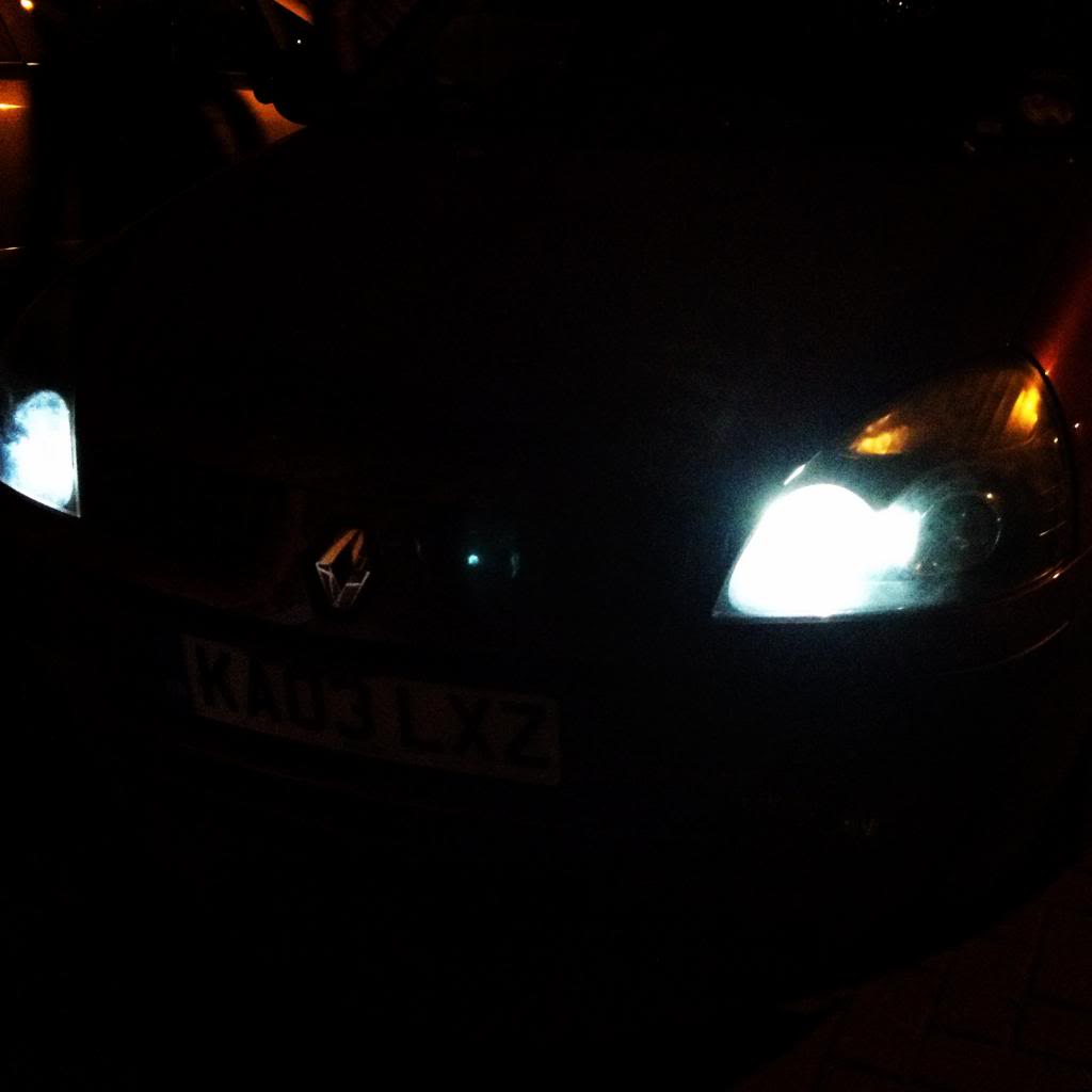

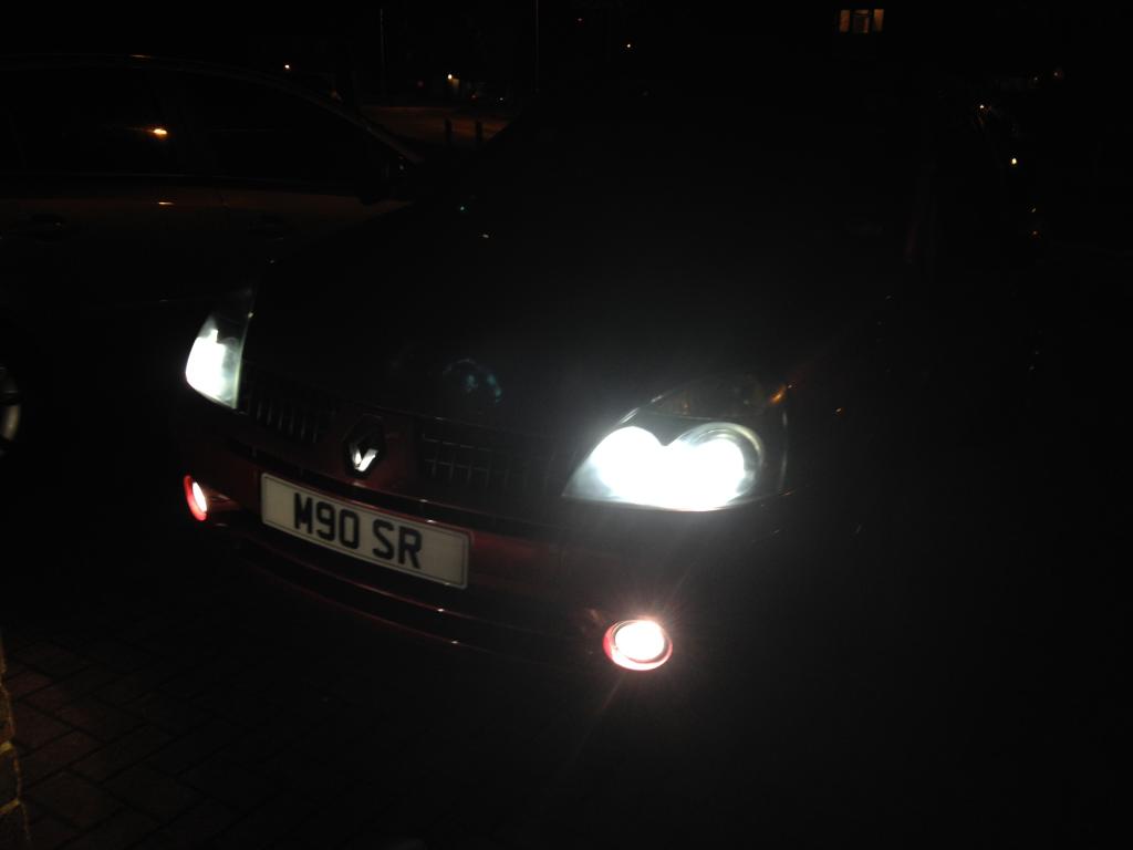

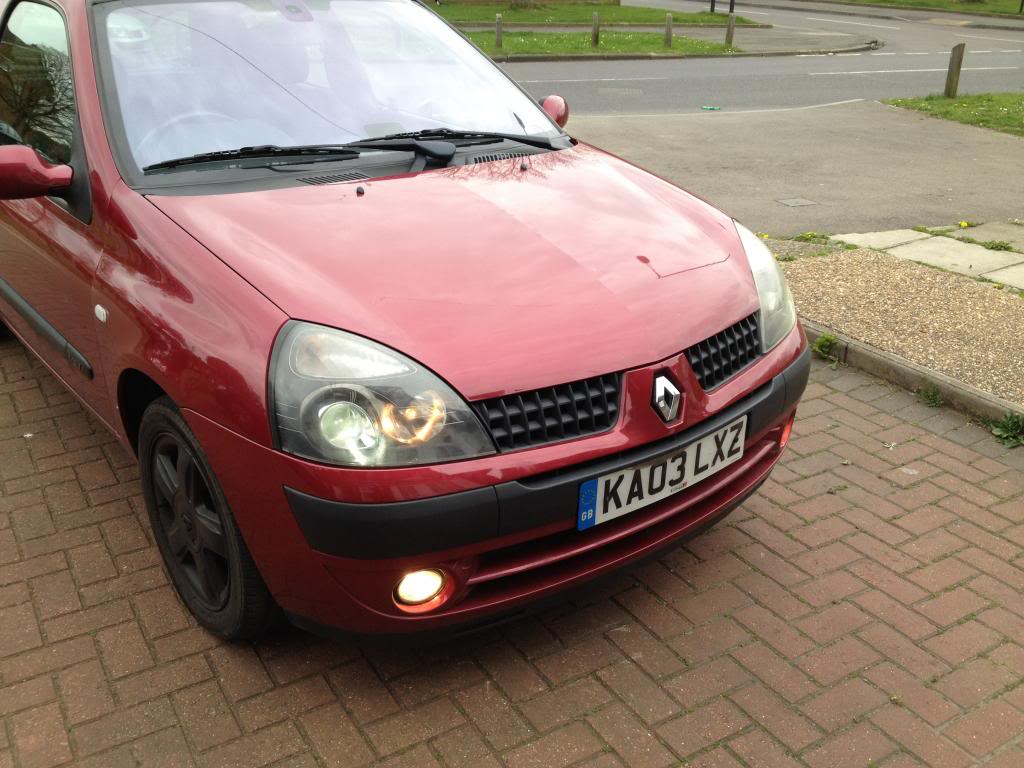

xenon trial fit!
I like them, shame the adjusters are broken :( Sorting the next step with the seller at the moment.

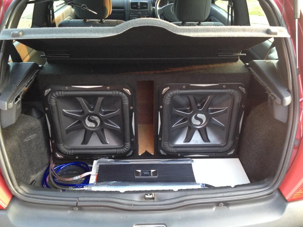

Put in the speakers the other day!
Had these lying around for 10 months and now I finally got around to putting them in, heres the somewhat temporary setup.
Sub box bolted through the chasis, the rear seats removed, the car sound deadened, and the parcel shelf holders cut in half so that the box would fit.

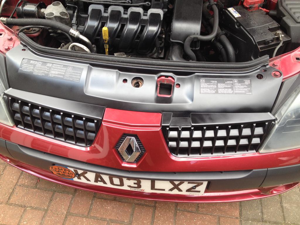

Had some free time and some gloss black spray paint from the old 99p store so thought I'd respray my front grill I got off AlexW a while back to get some life back into it!
Before (looks worse then it is in the pic):
Didnt take pics while spraying but I hanged it on the washing line and sprayed it on a pretty windy day lol!
Took my time with it (about 4 hours total including drying time)
Fitted back on the car after respray:
To keep the plastic finish spray very thin light coats onto the grill. I applied about 7-8 coats took me 5 minutes making sure I covered front and rear of the grill. Very happy with the outcome looks new!

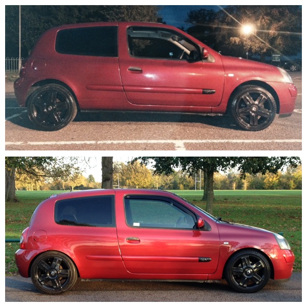

Loving how she looks atm so much has been improved since when i got her:
Before:
After:
UPDATE! Got my coilovers installed last week and I am loving them!! Get my michelin PS3's put on this weekend so that will make the front wheel fill the arch better like the rear.
Car is looking really smart, the ride isn't to bad either its just back breaking lol.
Proud of how far shes come although today after work she didnt want to start for some reason. The engine turned over but wasn't firing I believe it was the immobilizer so I locked the car and unlocked it and then she started!! But stupid me had locked the car with the keys in the ignition (car was running) and the door shut as I went out to shut the bonnet meaning I was locked out of the car while the door was locked and the engine was running 😧 After failing to attempt to break into the car via the passenger door lock I pried open the sunroof (about 1cm) and used a metal rod to press the unlock button which fortunately opened the car!!!
Anyway before and after:

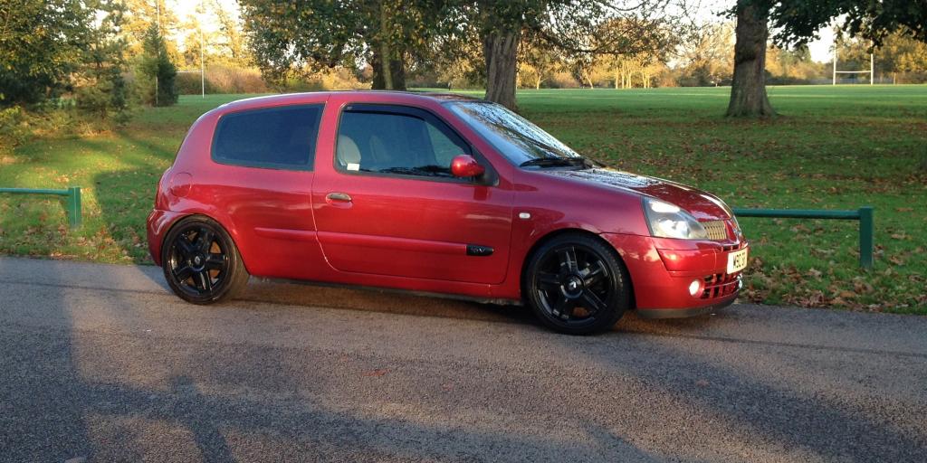

Some more shots of it lowered, looks more aggressive now I must say!
The 'I've taken a photo and I kind of like it'

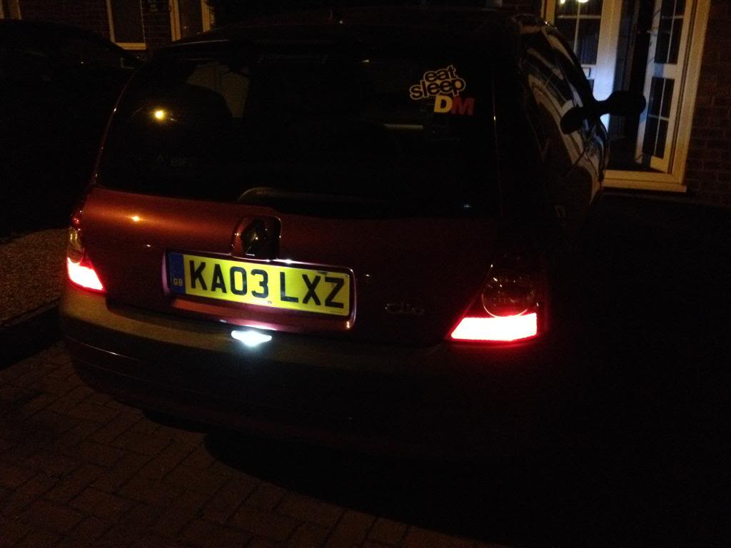

Going to slightly tint the rear lights. Enough so that the clear circle goes slightly dark.
