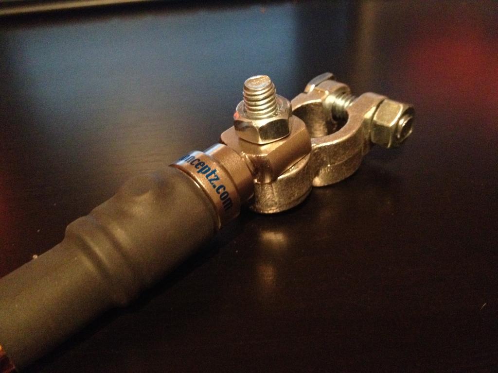

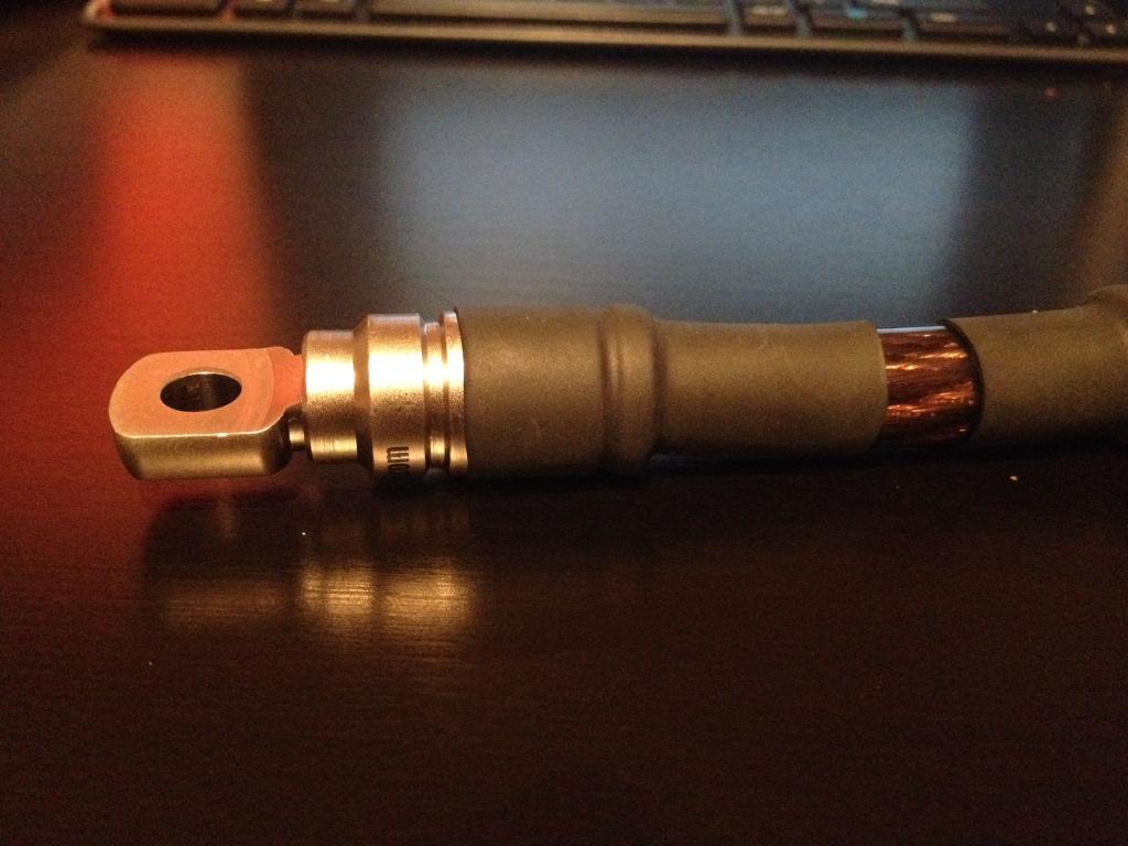

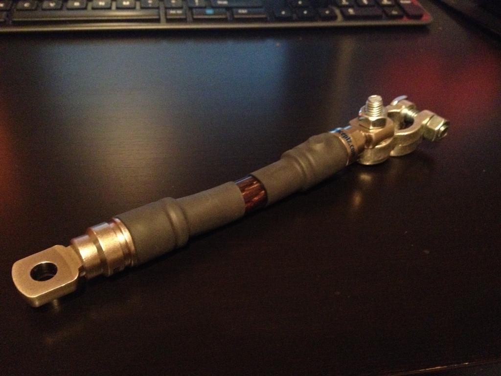

Getting started on the BIG 3 UPGRADE first of all got my 0 AWG wire for my ground and the superb 0 AWG terminals!
For those who don't know the Big 3 upgrade is a wiring upgrade in the car audio world which basically means that the alternator ground and positive, and the battery ground are upgraded to thicker gauge wire. This is to allow more current to flow from the alternator to your battery.
Got myself 2 ring terminals, 0 AWG wire and a battery terminal. (This for the battery ground only)
This is a good kit if your thinking of upgrading your battery ground.
Links:
Ring Terminals: http://www.ebay.co.uk/itm/380800231440?_trksid=p2059210.m2749.l2648&ssPageName=STRK:MEBIDX:IT
0 AWG wire: http://www.ebay.co.uk/itm/400738953997?_trksid=p2059210.m2749.l2649&ssPageName=STRK:MEBIDX:IT
Battery Terminal: http://www.ebay.co.uk/itm/191343237274?_trksid=p2059210.m2749.l2649&ssPageName=STRK:MEBIDX:IT
The finished product should come out like this (varies depending on how long you want your ground, ideally it should be as short as possible):
The ring terminals I have used do not crimp the cable they clamp it. This is not always as robust as crimping it but as you can see these terminals look strong as f**k and in this scenario work fine. If you want to solder these terminals you will need:
- Blow torch
- Solder
Basically put the top of the terminal in a vice and heat the base of it. When it gets hot enough allow the solder to melt inside and allow it to fill up. Once it is filled up push the wire in and allow the terminal to cool down. Be careful not to burn the insulation on the wire!!

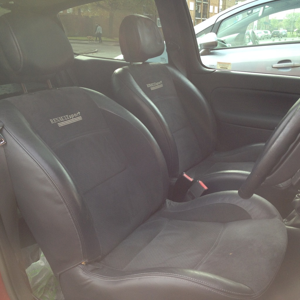

Never planned on upgrading the interior to the sport one but some cheeky haggling and got some 172 half leathers for next to nothing the condition is superb! few kinks but who can complain!
at night
Looks lovely!
M90SR
Questions about the seats:
A) how do you get creases out? specifically one of my headrests
B) my passenger side seat doesn't latch onto the runners (the cable for it has lost tension and wont latch properly)
C) theres some sensor which goes into the runners on the driver side. I think its the seat position sensor but I broke it not sure how serious it is. Think I can live without it cant I?

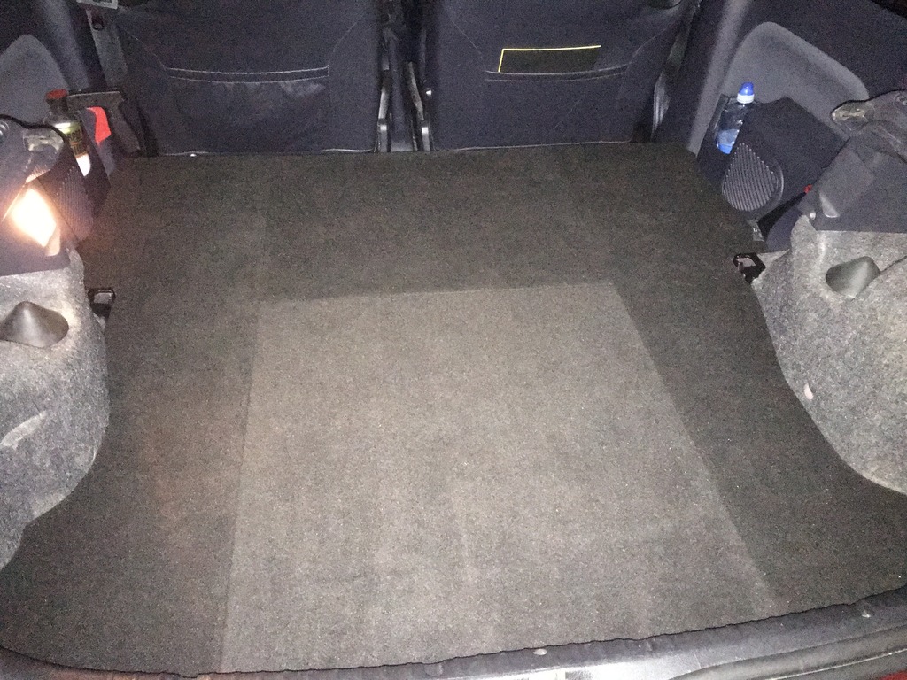

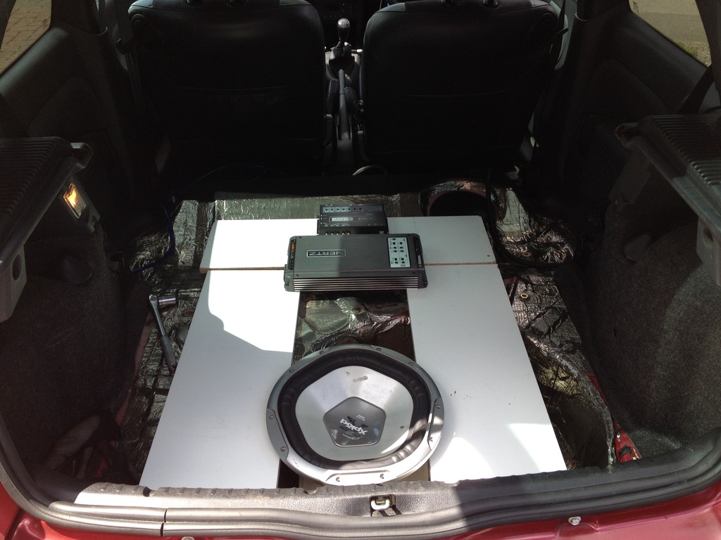

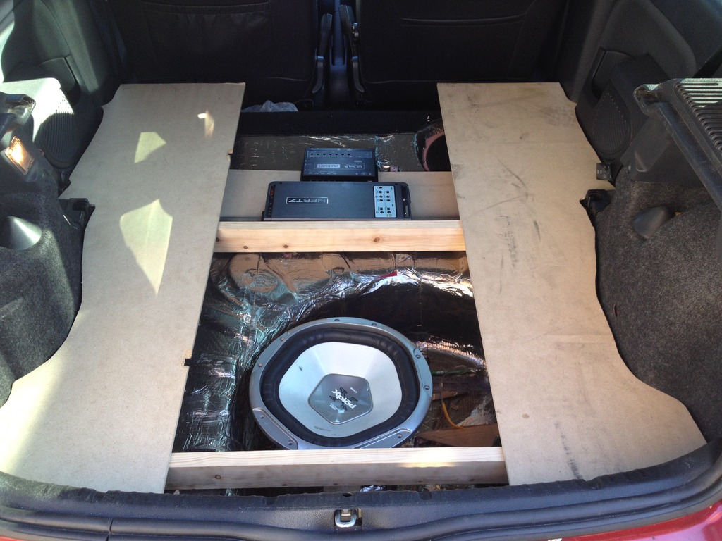

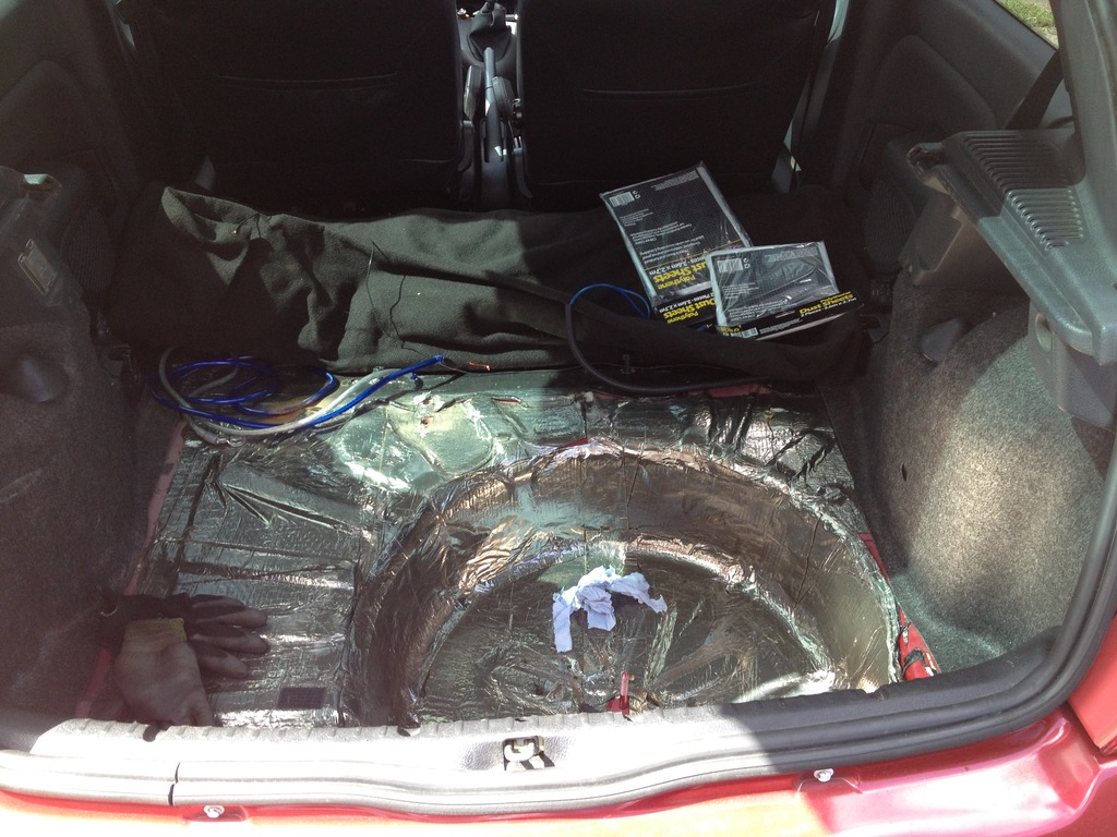

I have built a boot build for my Clio. I decided to do this because I got used to the fact of not having my rear seats installed and I dont think I'll ever need them really.
Another reason for the build is so I can hide all my ICE (Amplifiers, Subwoofers and Audio processor) under it so I can park where ever I want without worry someone might nick £1200+ worth of ICE shizzle.

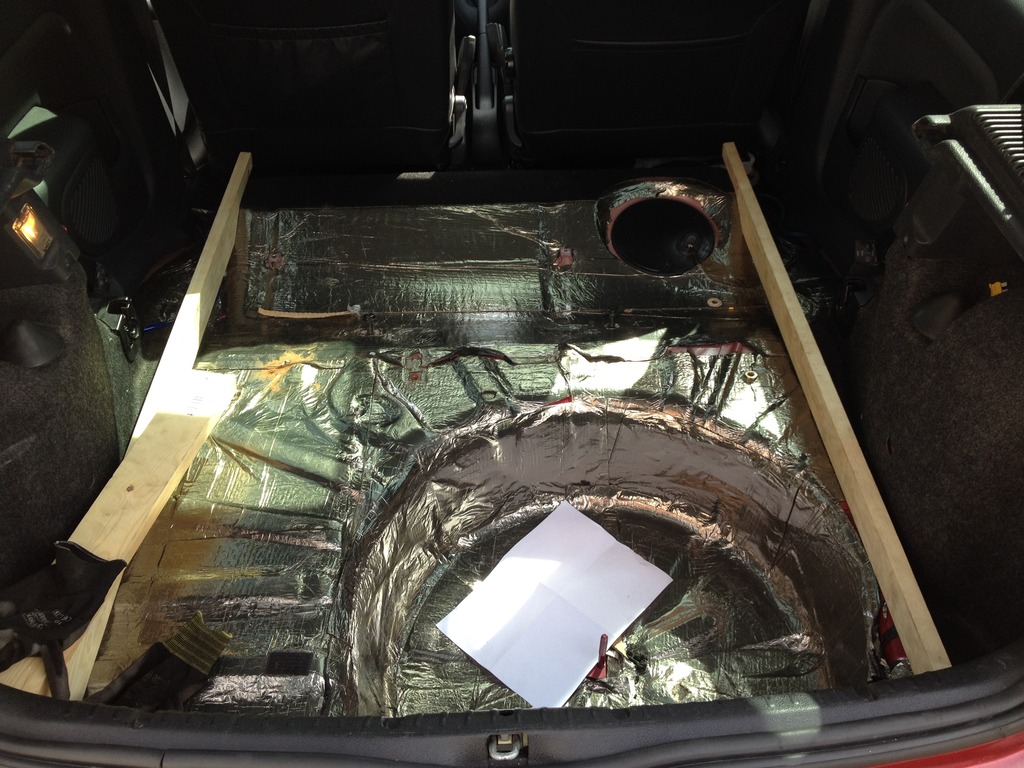

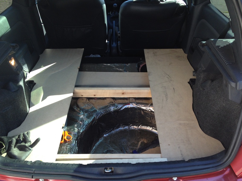

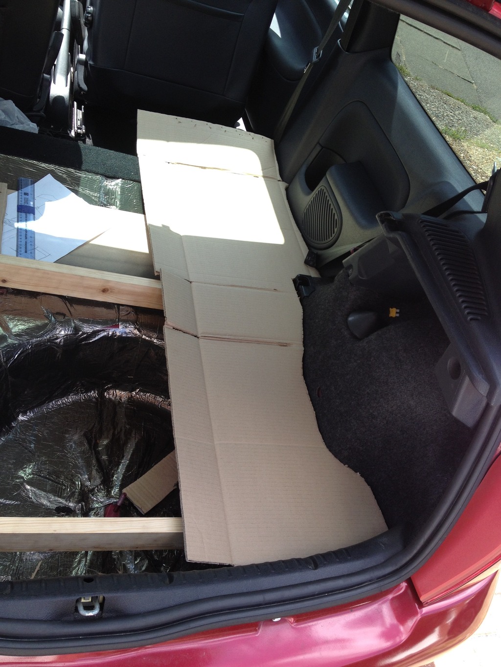

So lets start off with the boot
I had some carpet covering it but I wasn't happy with that...

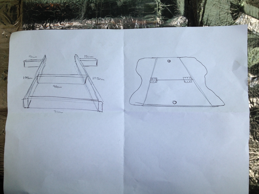

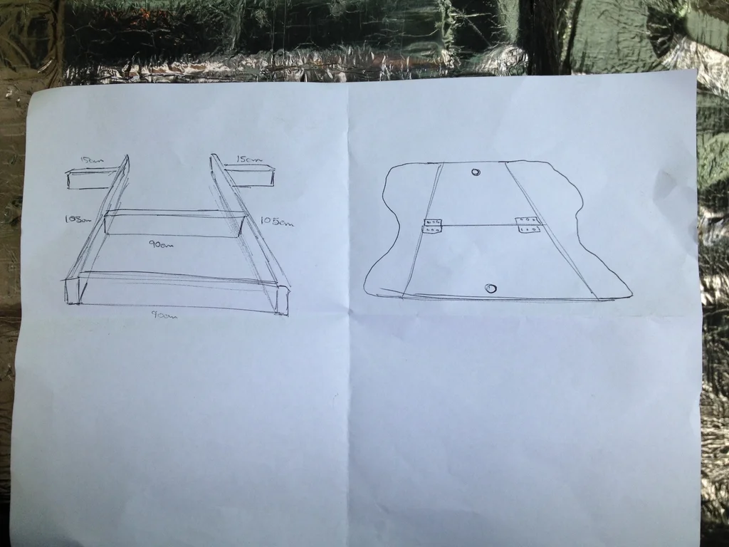

So the plan was to create this (mocked up using scrap pieces of conti-board):
Ignore the measurements:

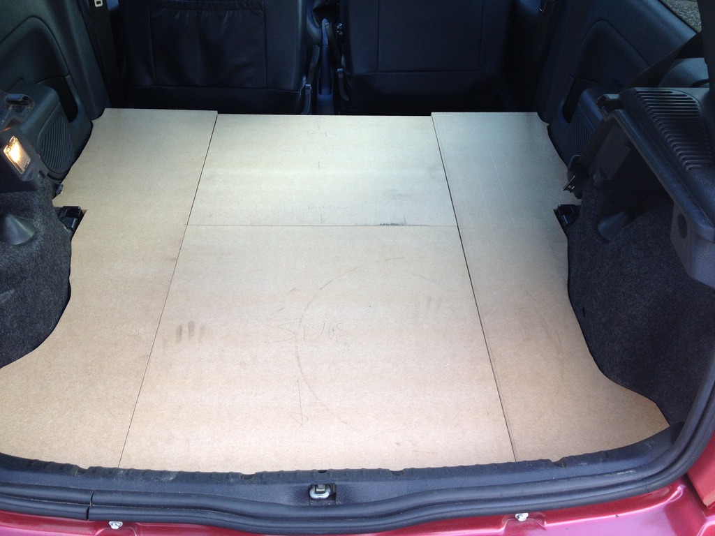

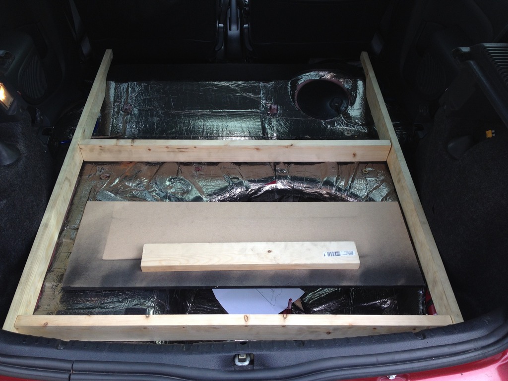

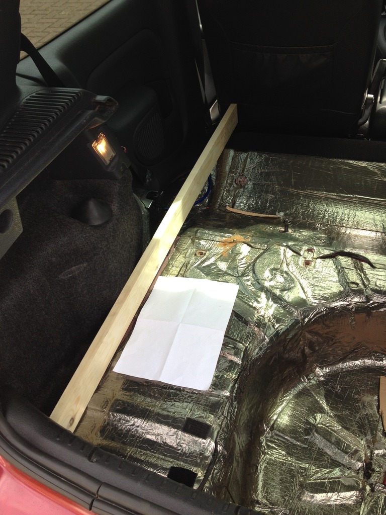

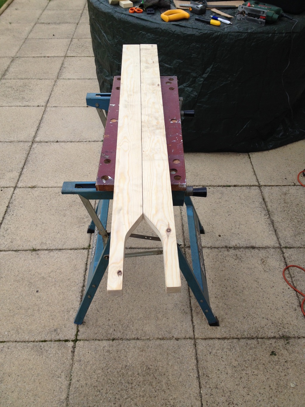

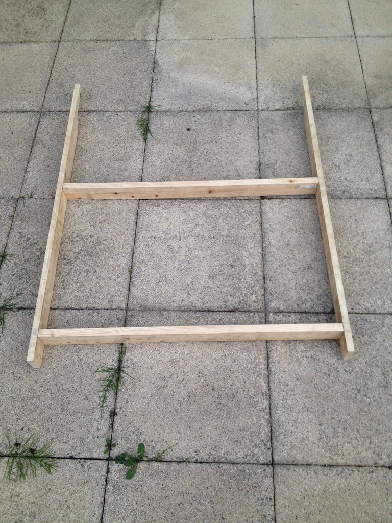

So to begin I needed to make a sub frame for my floor to sit on and be secured to. This will also allow my amplifier and sub woofer to have some breathing space.
I used card board to make templates for the wood. Especially for the odd curves Renault have in there boots.
Then it was to cut the wood I can't remember exactly what I used but next time I go B&Q I'll check.
Now using the template to shape the end of the wood (I used a jig-saw):
Test fit and both fit nice and snug! (after hours of adjustment and tons of swearing)
Now to add the two centre support beams:
After its all screwed together..

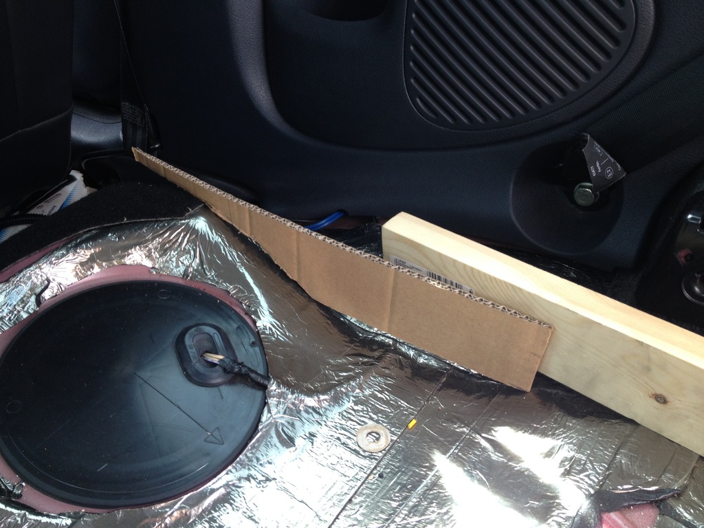

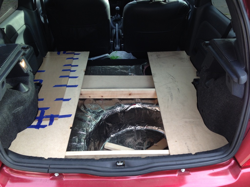

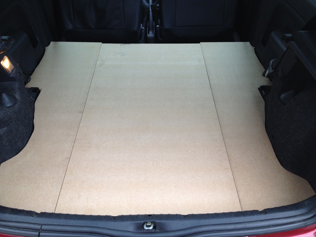

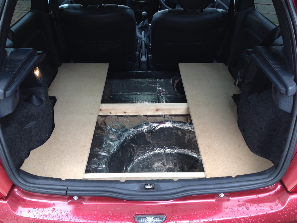

After putting back the sub frame into the car I needed to start making the template for the two side panels.
Card board works nicely but is a bit messy:
After a recent trip to B&Q an attendant was kind enough to let me have pick at the scrap wood supply.
I found some board which was thin enough to cut but still stiff enough so it wouldn't snap. This is good because I can transfer my template from cardboard to wood making it more durable to the fine tuning process.
Fast forward both sides done
Next thing was to see if it all still looked nice, so I did another mock up:
Still on track!
Now for some more fine tuning!
I then set out cutting the actual pieces. I used 3/4 inch MDF for this build, cheap and easy to work with!
Fast forward past all the faffing for the centre piece...

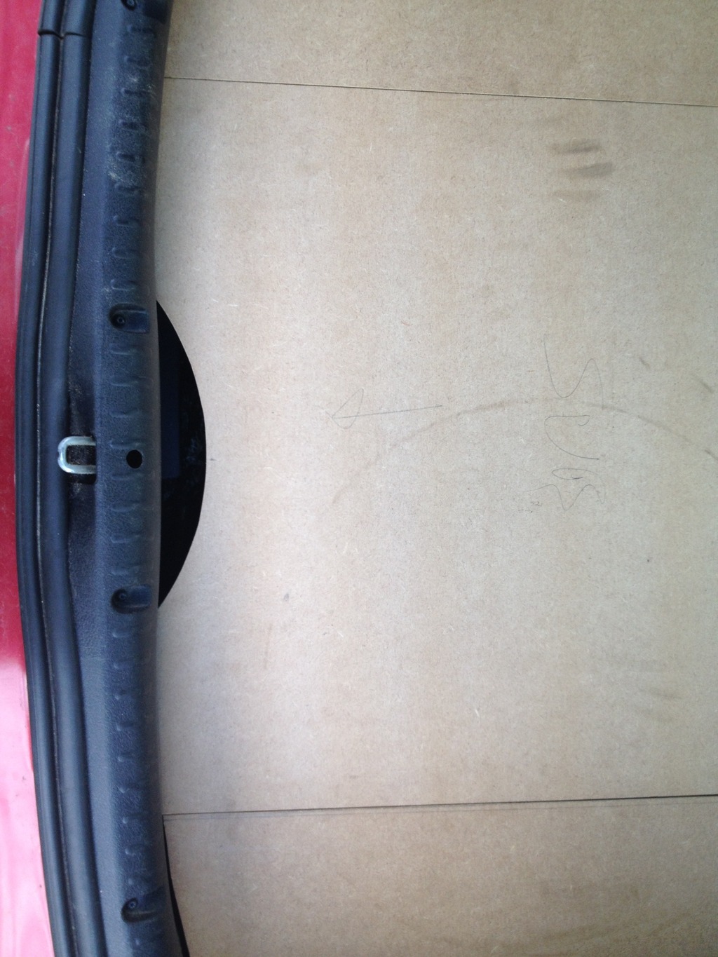

Now to make the doors all I need to do is cut the panel in sort of half
I wanted to make a handle at the end of the door to make it easier to pull up so "heres one I made earlier"

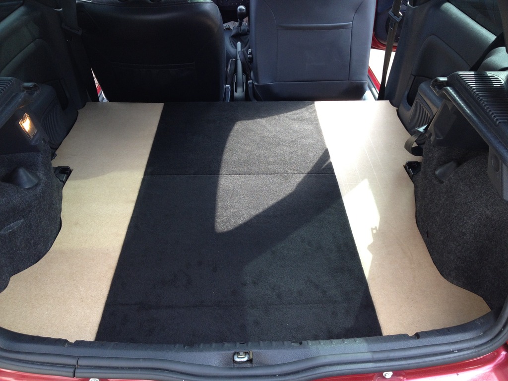

Now for carpeting!!!
The centre section was done first so any adjustment can be made to the two side pieces so they fit better. Rather than carpeting the whole thing and finding out it don't fit...
Once it was fitting properly the rest of the carpet was installed. Now this is not finished still got plenty of sub frame work to do but this it for now.
Oh yeah the reason one panel looks different is because the grain of the carpet is facing the wrong way in real life it doesn't look that bad.
Also the pic was taken in the dark, will take another one tomorrow!

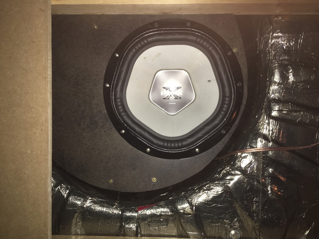

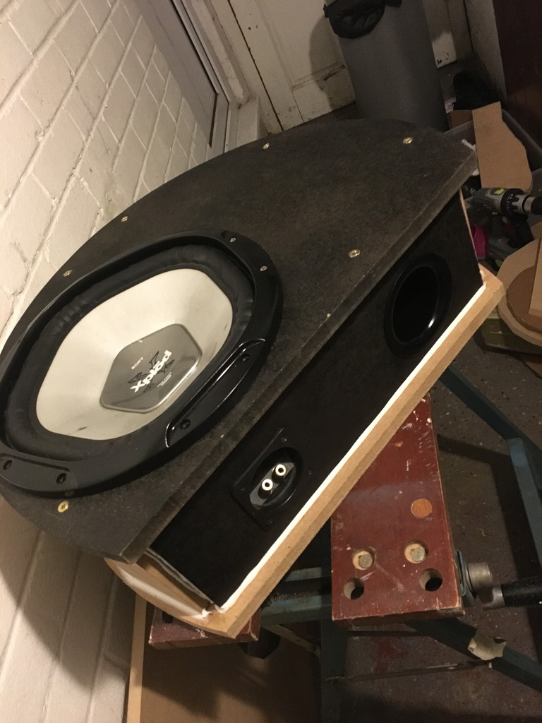

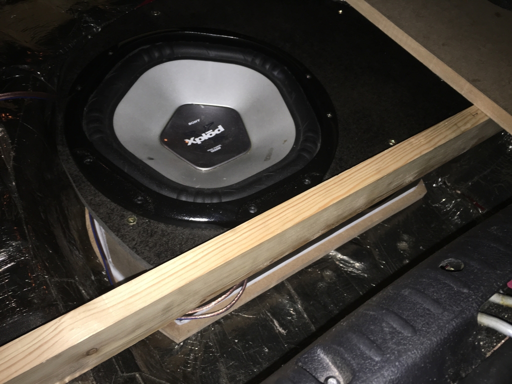

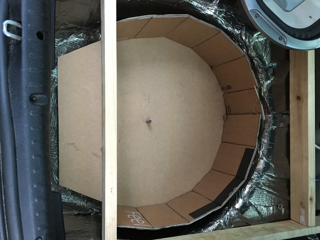

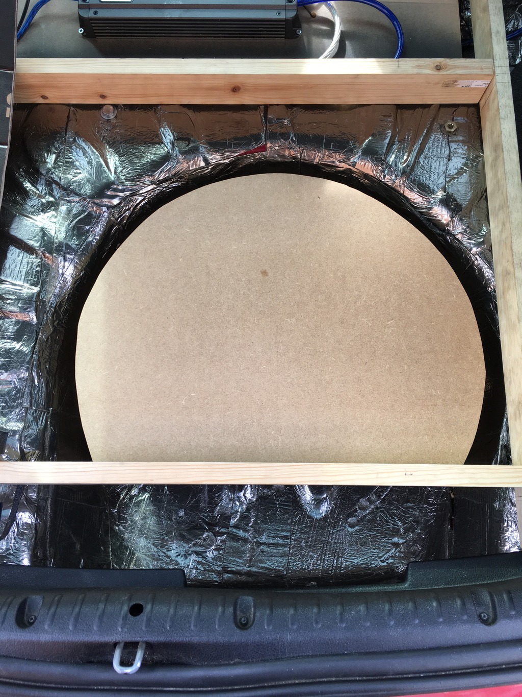

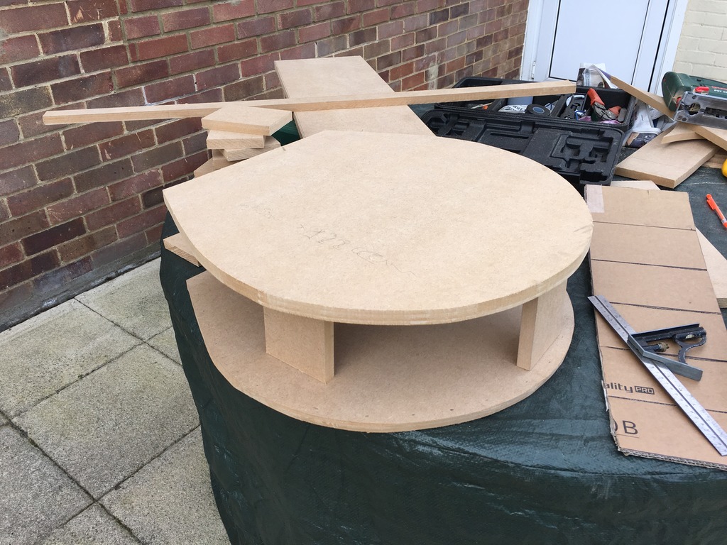

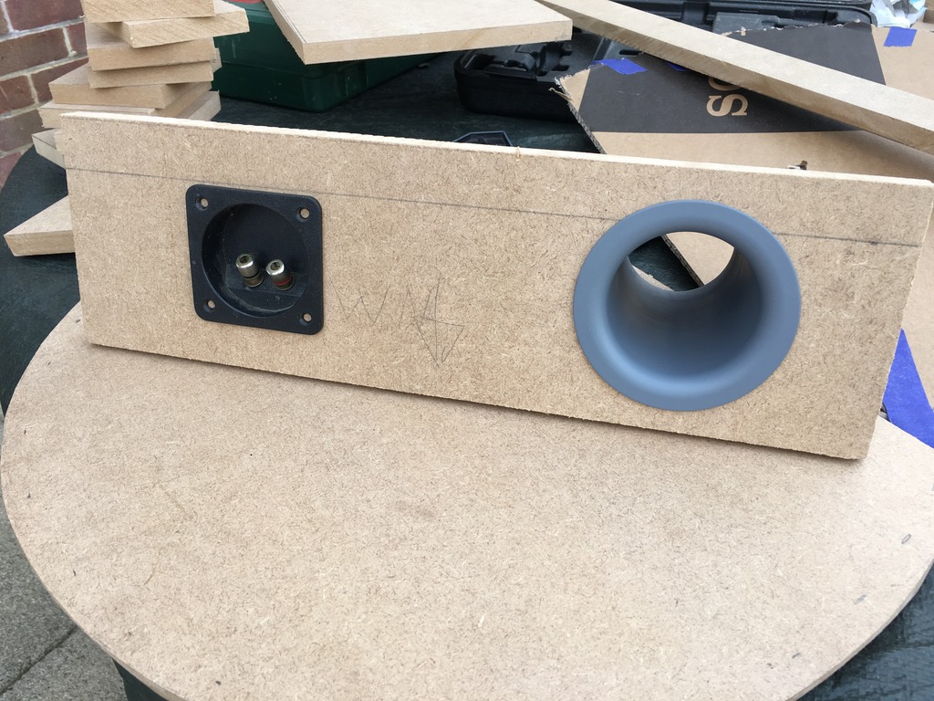

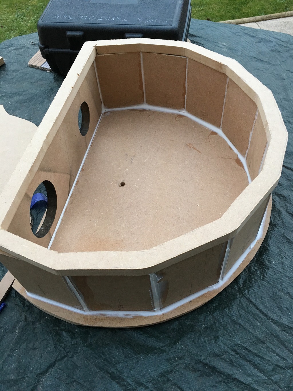

Now another surprise my custom spare wheel sub woofer box!

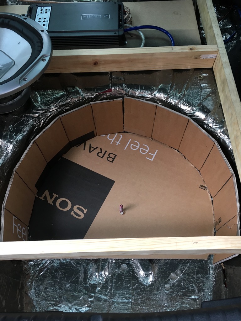

First the design, needs to fit into my spare wheel well with extra space to fit some break down supplies (tire inflator and high vis jacket etc..)
The box also needs to be a suitable volume for my subwoofer which is really old and is due replacement anytime soon but its so reliable that I dont really want to change it yet. Still play hard since day 1 15 or so years ago.
Anyways the box volume looks like it will only be 0.6cu ft and ideally it needs to be 1cu ft so I am not expecting anything magical from this setup.
Card board template of wheel well:
Decided to extend the box to make it bigger for that extra internal volume.
Because the spare tire well has a 8mm bolt sticking through it I decided to drill a hole into the wood for it to sit in. Allowing me to bolt it down for safety in case I accidentally roll my car.
Test fit:

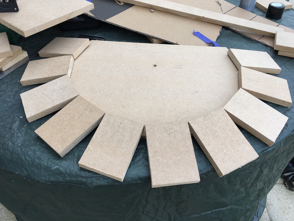

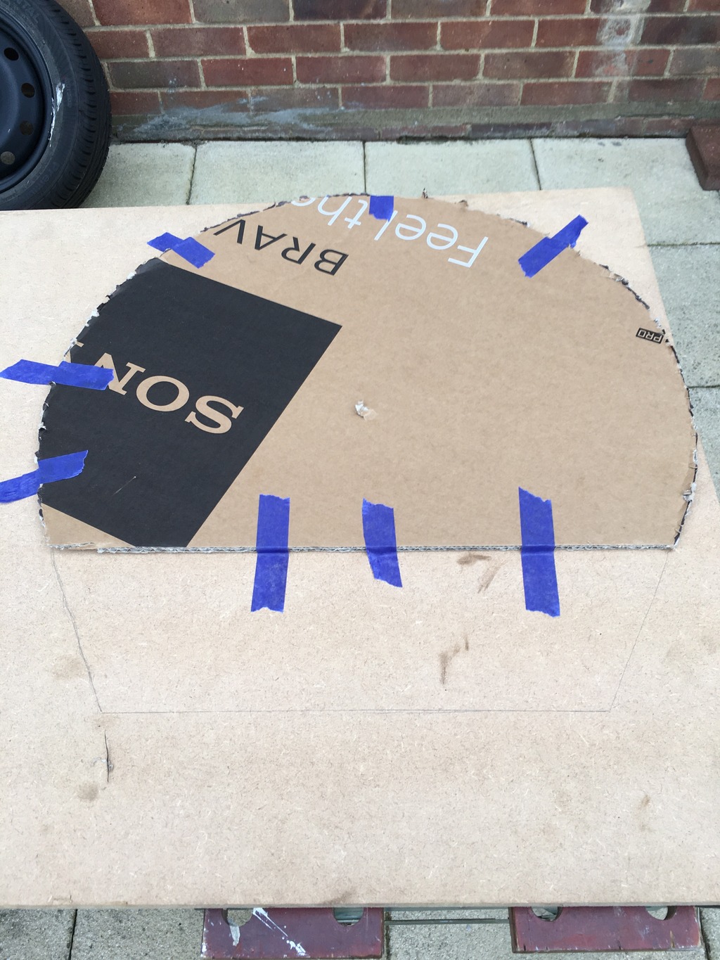

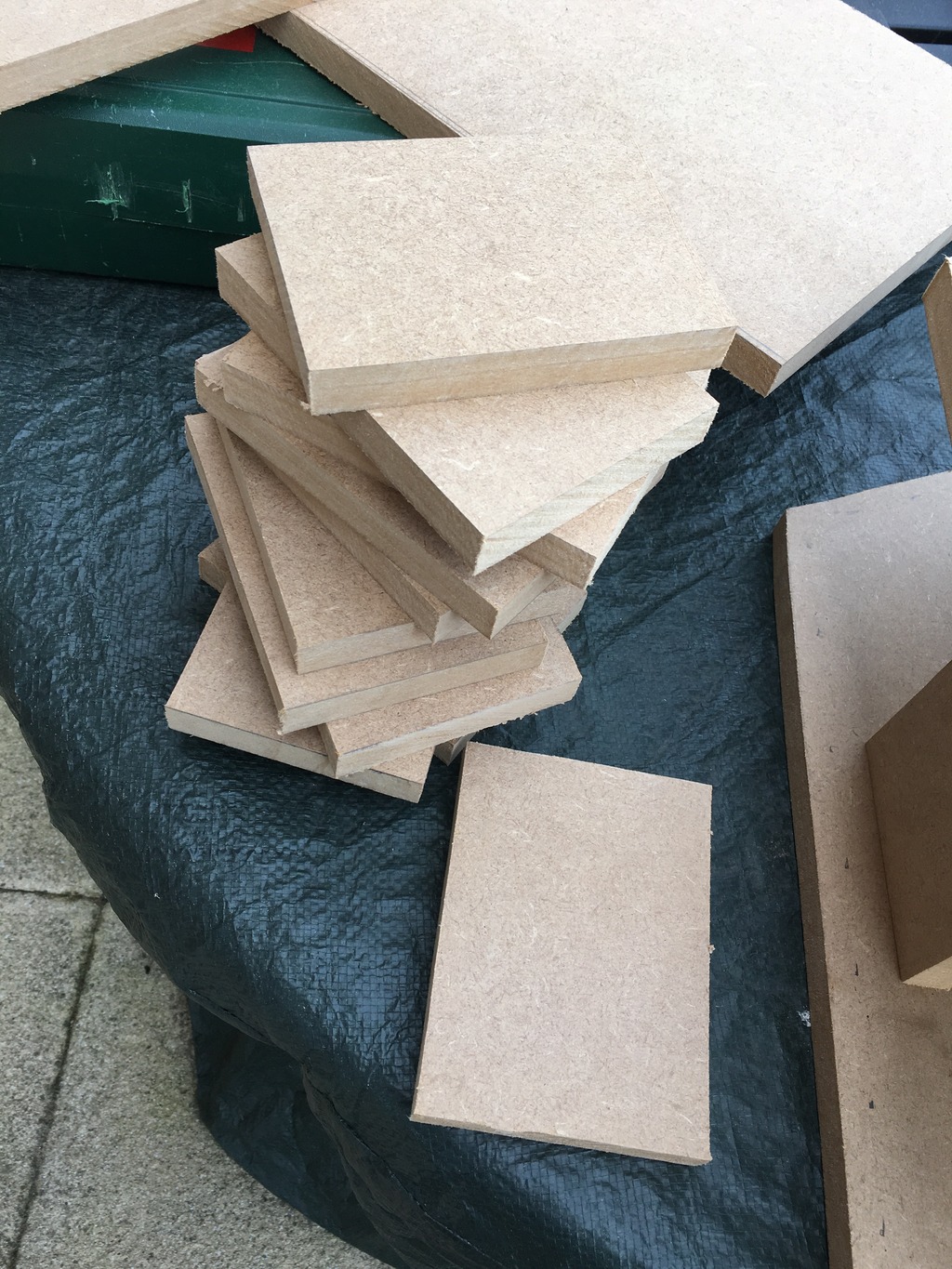

Cut some squares for the sides to help get that round shape.
Used the base as a template to cut the top piece so now another test fit:
I then realised I didnt like how the box looked so decided to make it slightly more like the original template intended:
New length is way better as it sits flush with my subframe

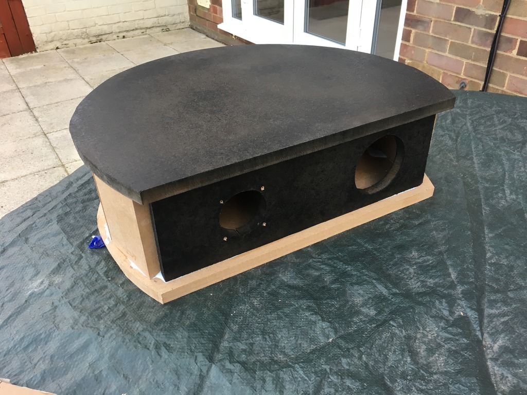

Next step was to make the cut outs for the input terminals and the 3" port
The port was being painted so ignore the fact it is grey everything is going to be sprayed black or carpeted in the end.

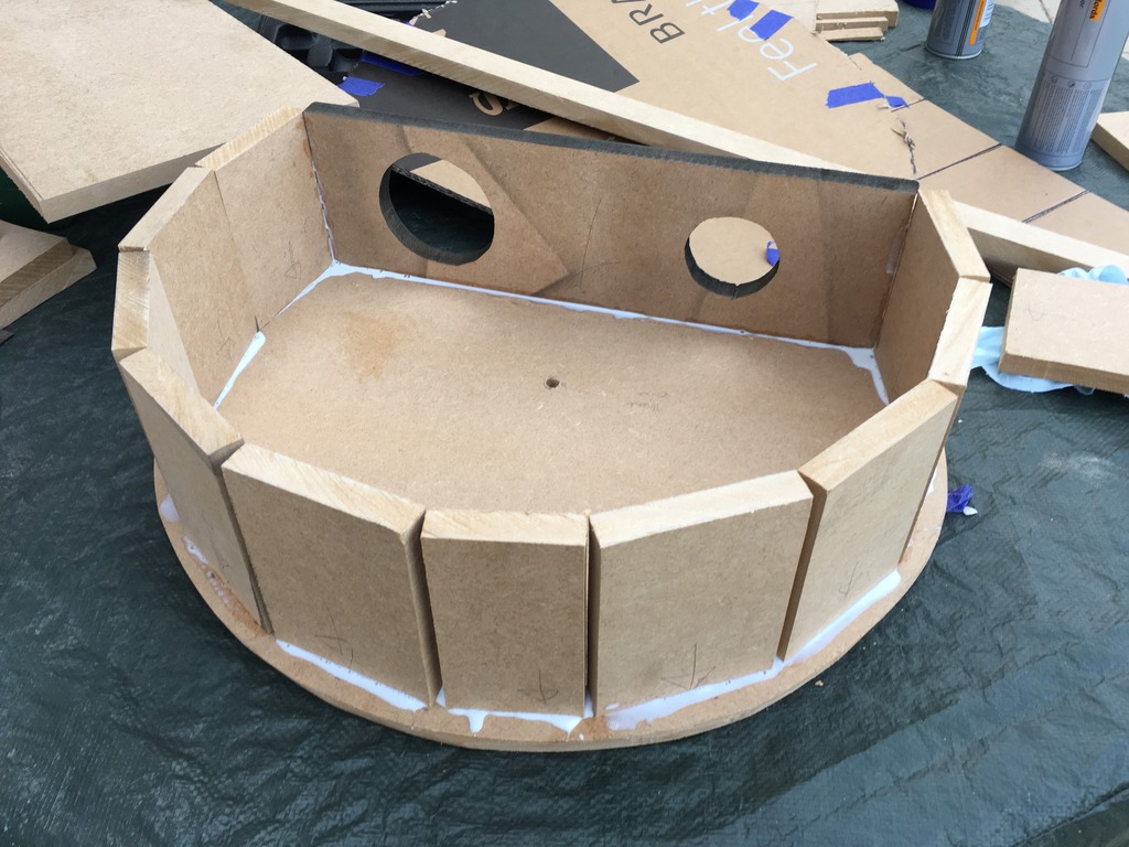

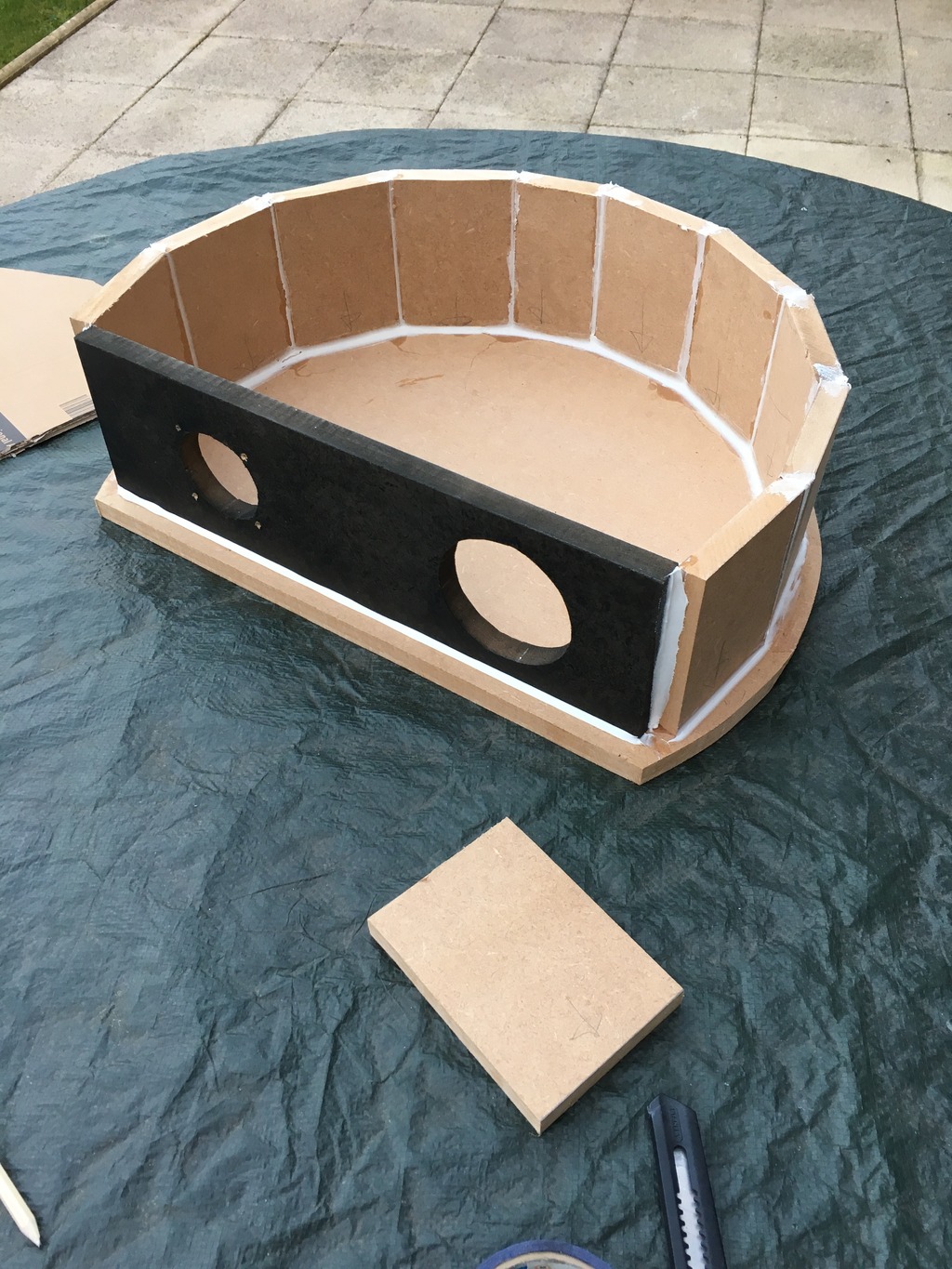

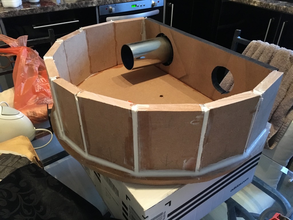

Now onto the more interesting bit the actual box build
Positioning the side pieces making it easier for me to glue them considering I was doing all this by eye and without any plans...
Glue stage 1 the base:
While I waited for the glue to dry I put everything together to see how it would look:
Glue stage 2 the sides:
I then decided I want the box to be taller so I set about cutting a section I can attach to the top. All about them internal volume gains!
So I sealed what I could in the box first:
Then to add the bit I made on top

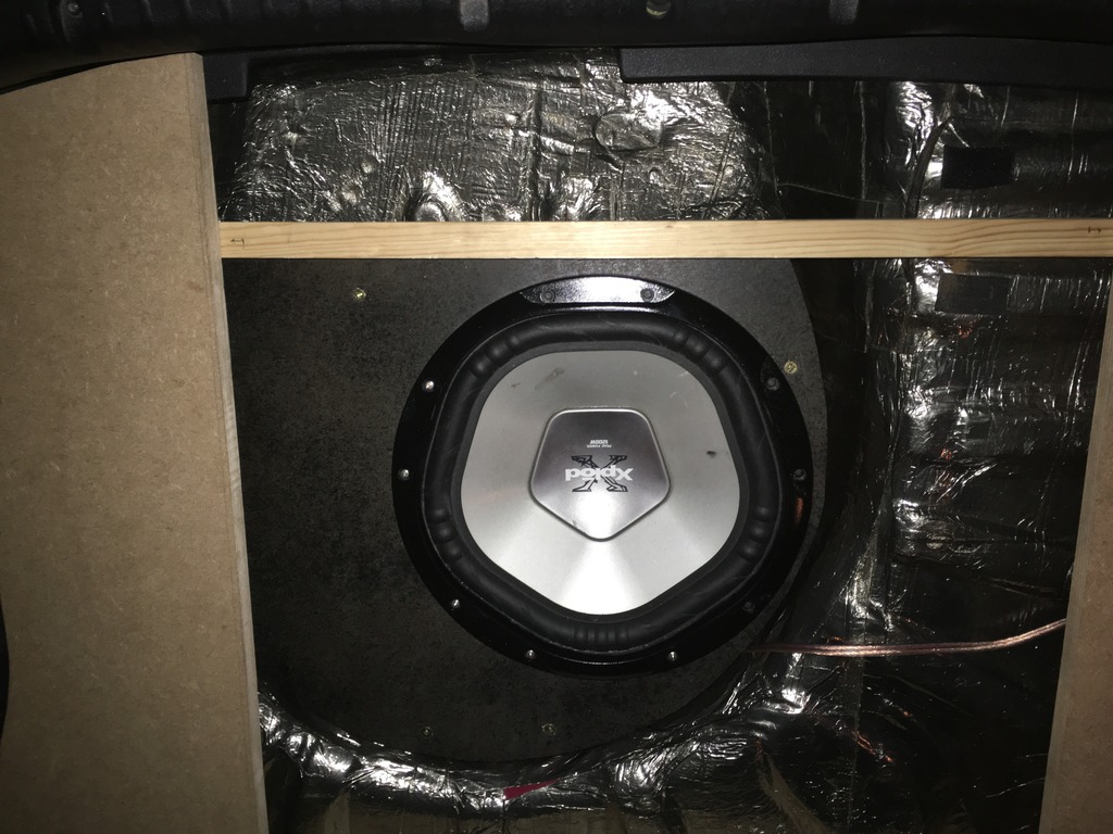

I then free hand cut a hole for the sub which came out really perfect!! Then it was a quick test fit into the spare wheel well to see how it fits.
Fast forward ahead to when it is basically done all sealed (without carpet installed yet) and put installed in the boot :)
Installed:
Thats about it still need to finish it off but its pretty much done.

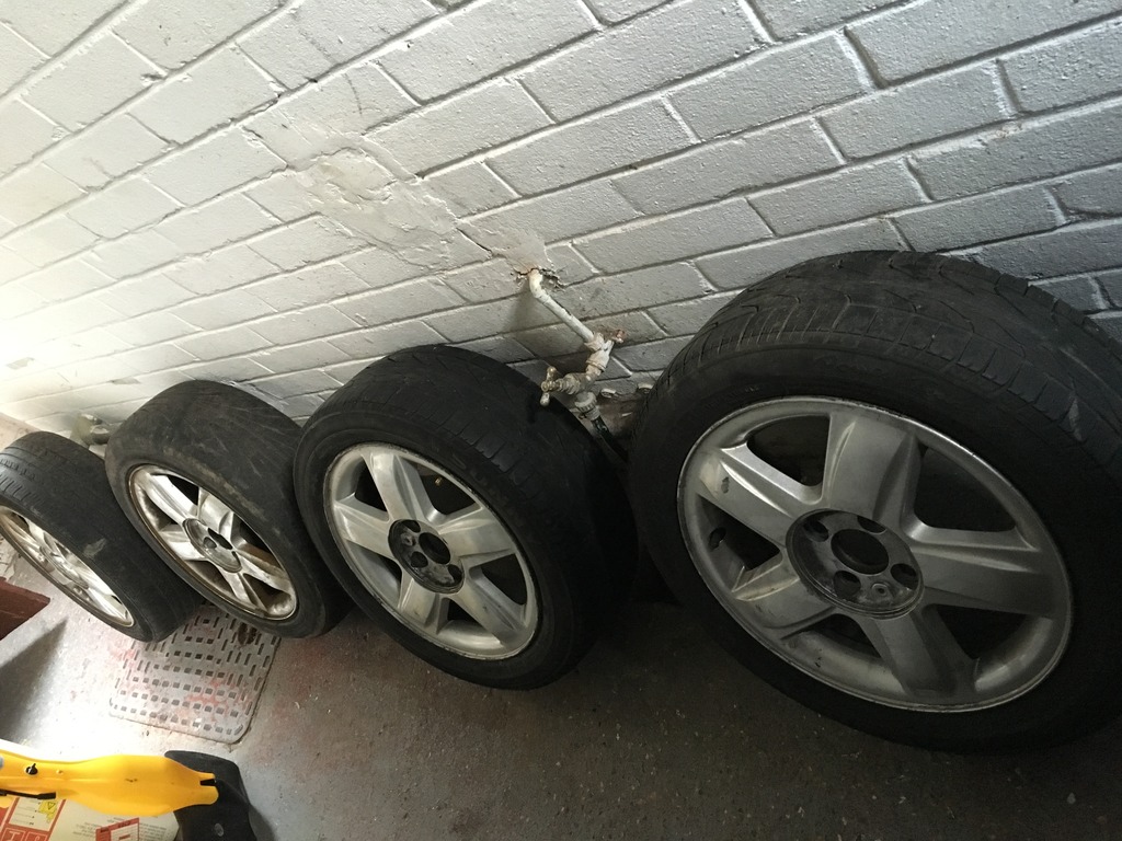

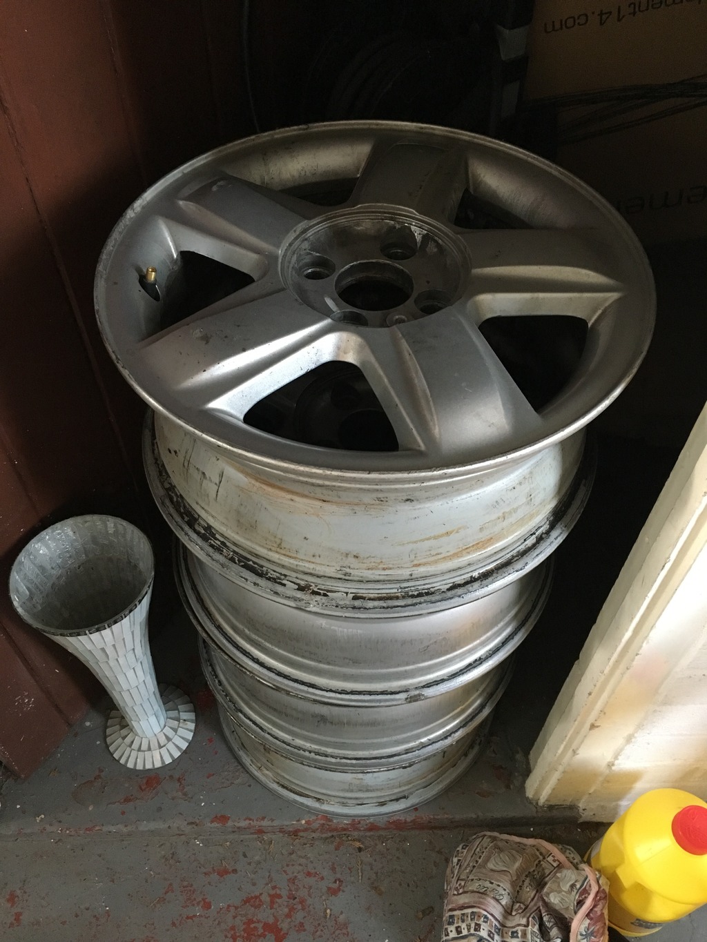

Having sold my Dyanmique wheels I thought I'd better hunt down another set.
Found these guys on eBay for £60 not bad considering they had 3mm thread tyres.
I realized the tyres weren't anything wonderful so I got rid of them and decided to make a start on prepping them for a refurb and respray.
Tyres and weights removed:
Probably continue with it later when the weather decides to improve.
