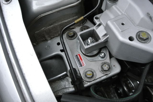

New engine mounts, highly recommended for the clio thats getting saggy:

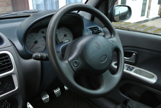

Got a new steering wheel to replace the knackered leather one:

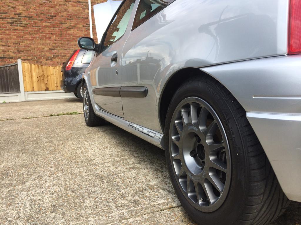

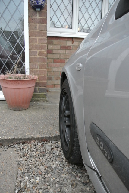

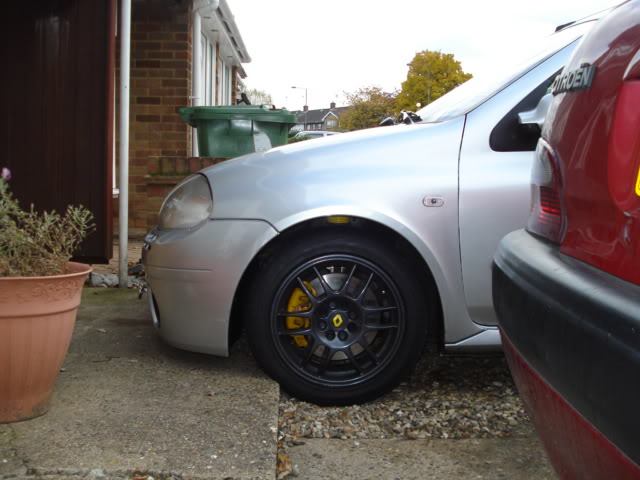

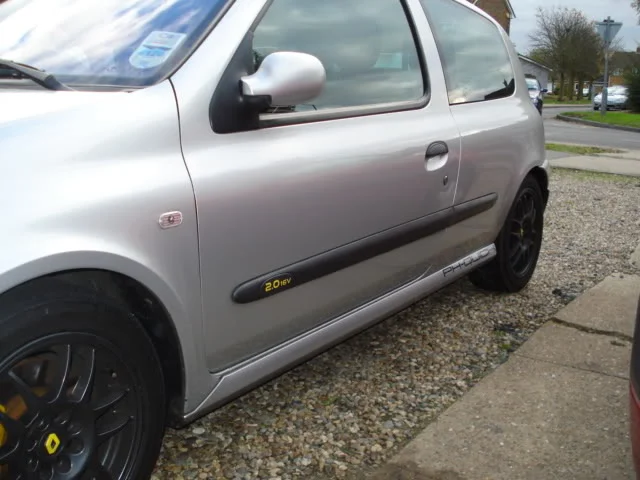

20mm H&R wheel spacers up front:
And 5mm rear:

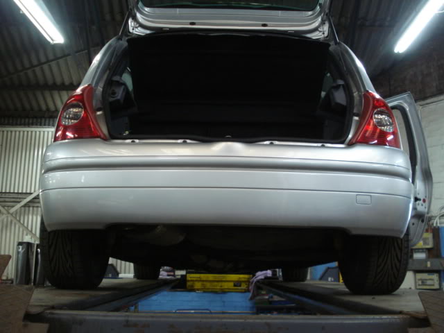

Sits much nicer in the arch now:

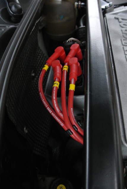

Magnecor 8.5mm HT leads fitted, actually smoothed the drive out a little:

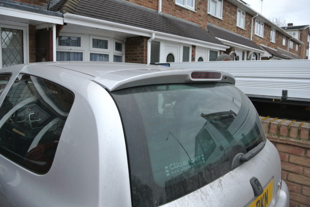

Cup spoiler purchased off here in excellent condition and resprayed in Titanium professionally, really happy with finish and colour match:

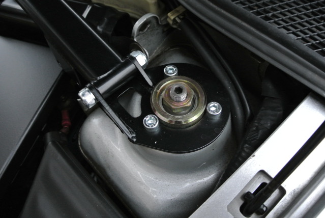

Ktec top mounts had started seizing again and being fed up with my monthly strip and grease procedure decided to bin them for Pure motorsports items:

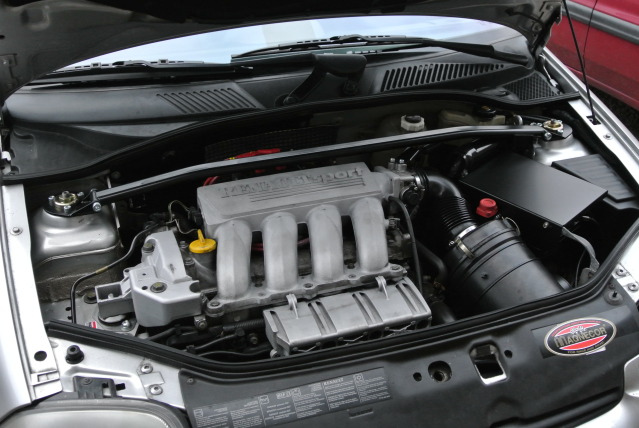

Would have been rude not to get the strut brace package ;):

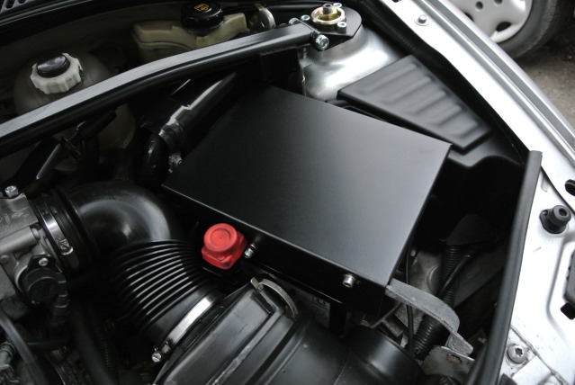

New battery cover to tidy up the bay:

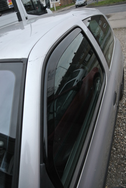

Wind deflectors:

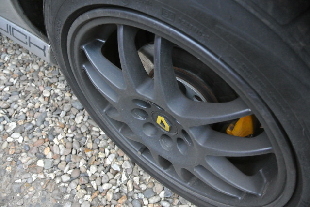

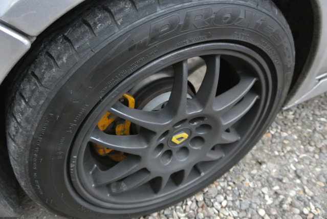

Ignore how dirty it is lol, usually spotless. Thanks for reading and more updates soon when i do something about the wheels and that stupid yellow detailing.

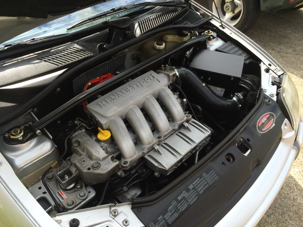

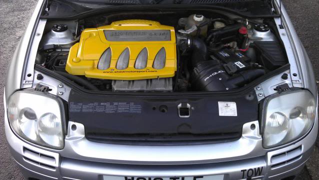

Right first update. Collected a few parts for a good service and refresh, these include:

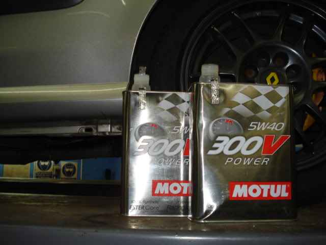

Motul 300V 5w-40 oil, this was in storage at mine for the 197s next oil change but im sure she wont mind :p
Brembo HC front discs, genuine renault rear discs and CL RC5+ pads all round. Reason for choosing this pad? Use them in the 197 and the cold bite, fadeless performance, pedal feel and overall stopping power are untouchable with any other pad i've tried.
Powerflex front lower arm and ARB poly bush kit, along with new lower balljoints for a suspension refresh.
Genuine RS 182 mats, very flash.
Demon Tweeks heatshield to replace crappy old bulkhead mat. IMO easiest way to tidy up the bay. Also picked up a mint engine cover from eBay.
182 silver metal interior door handles, originals had cracked.
Front wheel bearings.

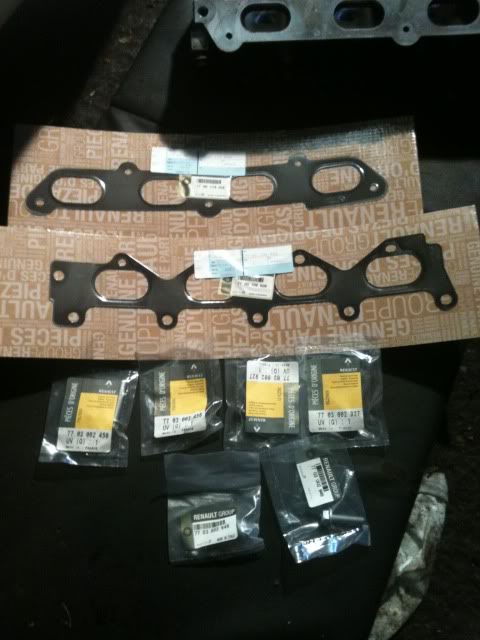

Genuine spark plugs with fresh inlet manifold gaskets and lots of silver VHT paint for under the bonnet.
ITG panel filter and genuine pollen filter/fuel filter.
Prima racing uprated exhaust mount.
New Toyo T1R tyres fitted on all four corners.
Anyway down to work:

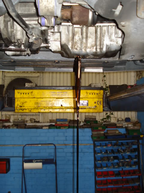

Unknown brand of oil removed:

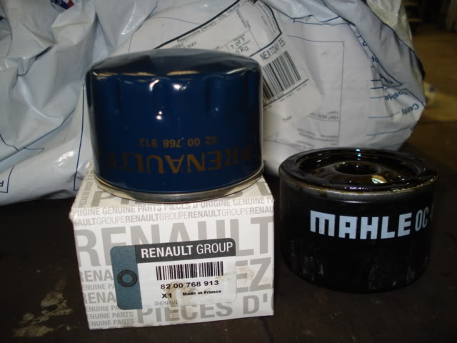

In with some stuff i can trust, only the best for my ph1:
Quality filter, i hate using cheap filters:

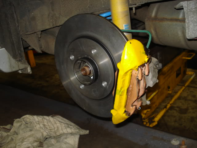

Genuine discs and CL pads fitted all round:
VVT controller seal was also seeping, i hate a messy bay so had to be sorted:

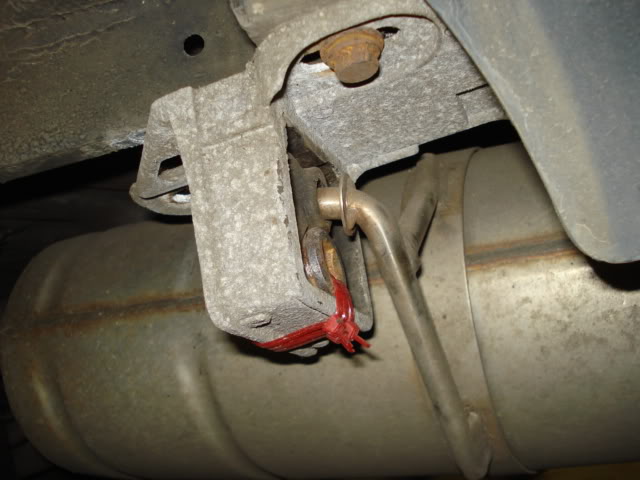

The old exhaust mount had seen better days, nice effort from previous owner though! Replaced with Prima racing mount now:
Stealth exhaust twisted round and fiddled with to actually hide it, also doesnt knock on rear beam anymore, result!:
Before:
After:

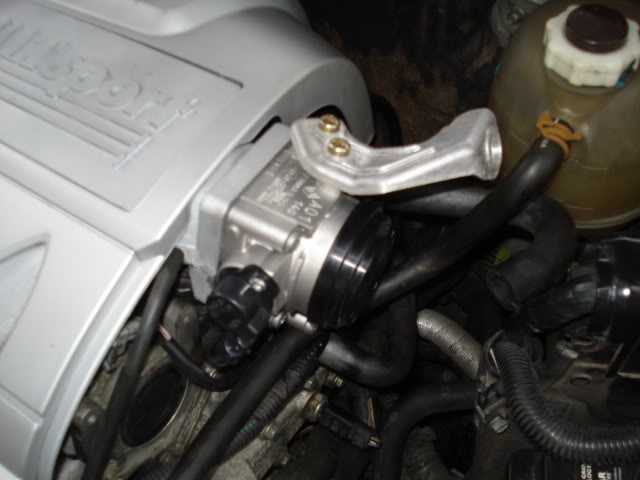

Sticky throttle had become worse over the past month. I tried multiple 'cheap fixes' but they were all only temp bodges, so bit the bullet and bought a new TB, potentiometer and cable from renault at honour of £350 ouch:
Also managed to fit the new engine cover and heatshield on the bulkhead. Gave it a little scrub up under there too. The original airbox was missing 2 clips and i didnt like the 2 way riveted inlet, looked messy. Had an old JMS V6 airbox in the garage so whacked that on to tidy it up with the ITG panel filter inside.

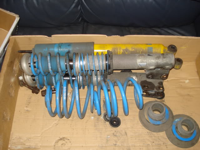

Next plans are to sort the worn coilovers out, they make a very annoying noise on lock and over bumps. Also looking at taking it on a trackday next month so possible preps for that. :)

Mahle is not cheap crap.
For example: http://www.mahle.com/MAHLE/en/Products-&-Services/Motorsports-and-Special-Engines
http://en.wikipedia.org/wiki/MAHLE_Powertrain
I think MAHLE and Mann filters can always be trusted.

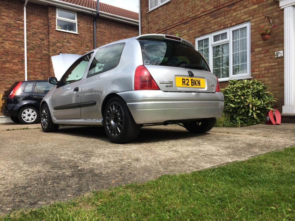

Okay lads here we go with the update at last! Thanks to @Dr Jekyll for the reminder ;)

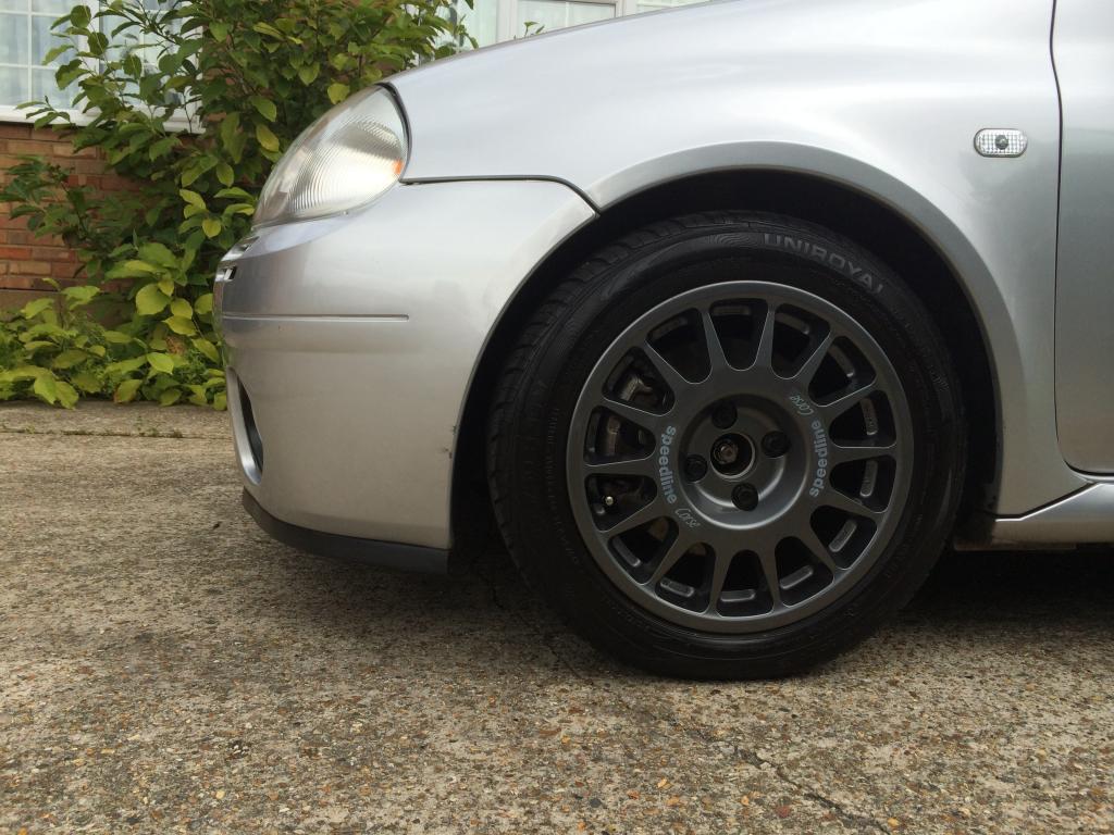

Been using this as a daily for the past two years, just ticked over 100k last month and never let me down. Love driving it every day and makes my commute enjoyable.
Mods since I neglected this project thread:

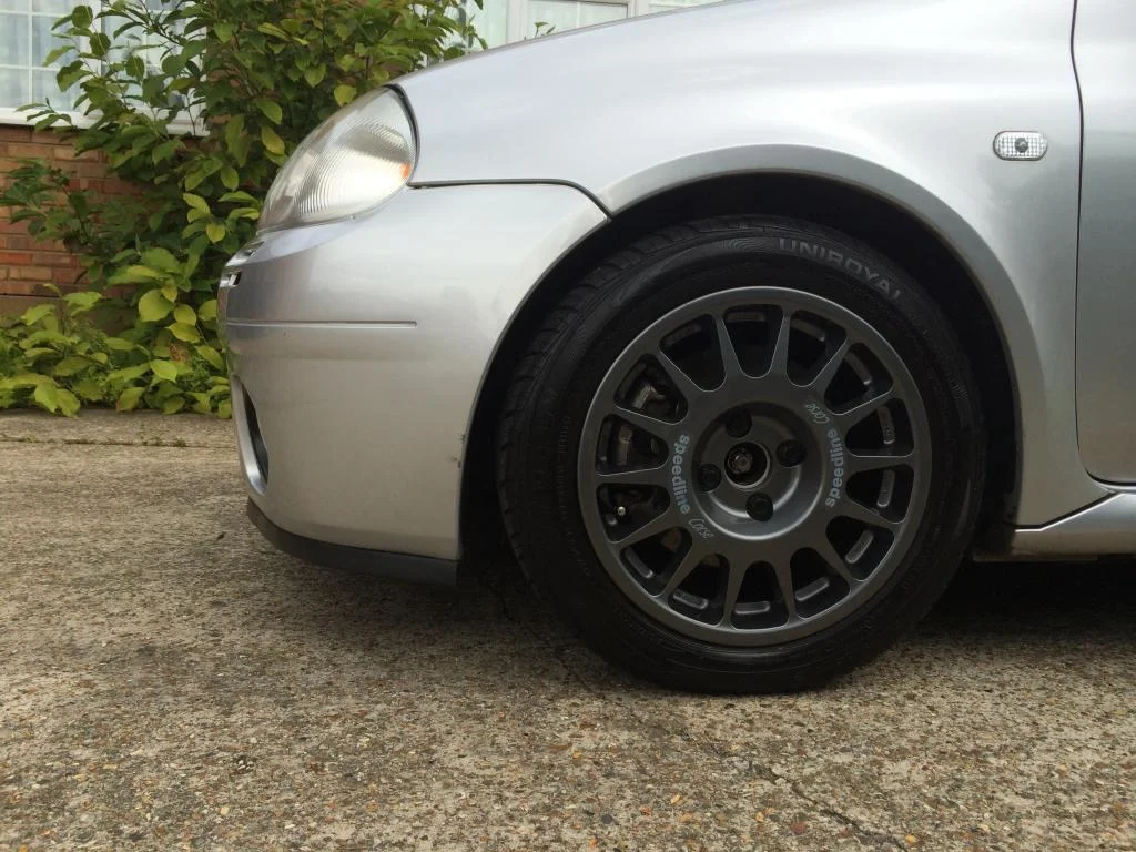

-Speedline 2118s with rainsport2 tyres
-Whiteline ARB
-DS2500 all round
-KTR induction kit, which I can't wait to get rid off :(
After a weekend at CSS seeing a couple of absolutely mint ph1s it's made me feel crap about mine as I have been neglecting it for work and it's kinda been in the shadow of my 265. So now I have a new found motivation for my beloved 172. If I have the funds over winter I hope to embark on a mini restoration, but just having my first born money is tight so it'll have to be a budget refresh. Plans are:
-Insure a cheap mk1 clio I've had at work in storage for a few years, used to be my old daily, this way I can take the 172 off the road for a few months and not being used a daily hopefully have more hope getting it upto my standard.
-Bin the KTR induction kit, it was bought on impulse for a ring trip last year and I instantly fell in love with the noise at full chat, but now I hate it and plan to replace it for a full OEM ph1 setup new from renault.
-Get the front end blown over as it's stone chip central.
-Remove the engine and clean up bay, fit new dephaser, water pump and belts whilst the engines on the bench.
-Give the interior some much needed attention as it's the area which needs most attention, plastic is faded and chipped, front seats are cracked and worn and the carpet is knackered requiring a new one completely!
-New headlights of course
And if I can find the money:
-More performance based coilovers as the V1s currently fitted are nice on road but on track it's like cornering a ferry. May settle for some cup dampers and Cooksport springs yet?
-Some 4 pot calipers to improve the brakes which next to the 265 and 225 feel a little weak.
-Ditch the Pure motorsport air con delete kit for a proper Cup setup as I keep having problems with whining and belt tension.
So there you have it, keep updated to this to see what I can manage. A few pics of how she stands at the moment, I'd like to get it up to a show worthy condition if at all possible. Thanks for reading and watch this space!

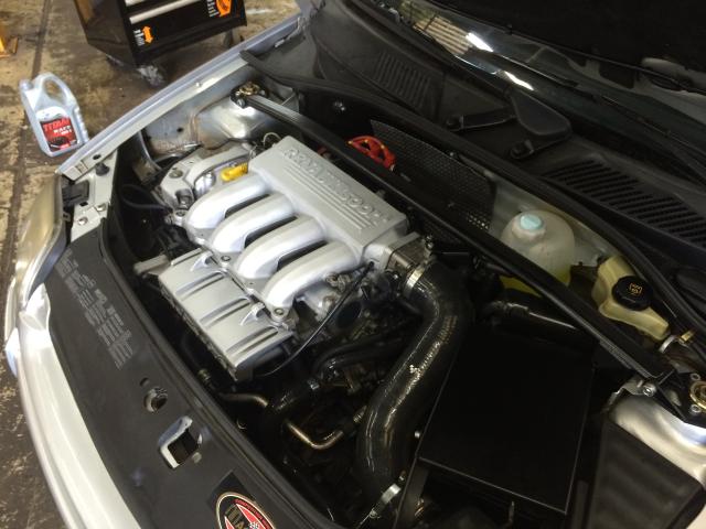

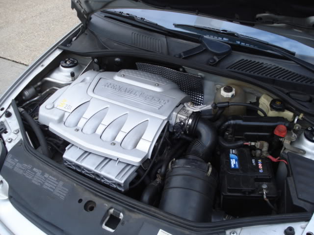

Okay got the car in the workshop this week to do a major engine refresh as the old girls ticked over past 100k. Plans include:
Cambelt, dephaser and water pump replacement.

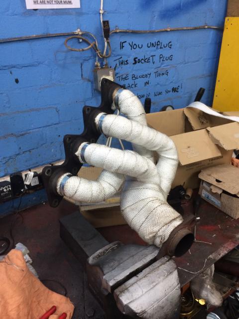

Remove the exhaust manifold and heat wrap it.
Fit a set of silcone hoses I've had laying around.

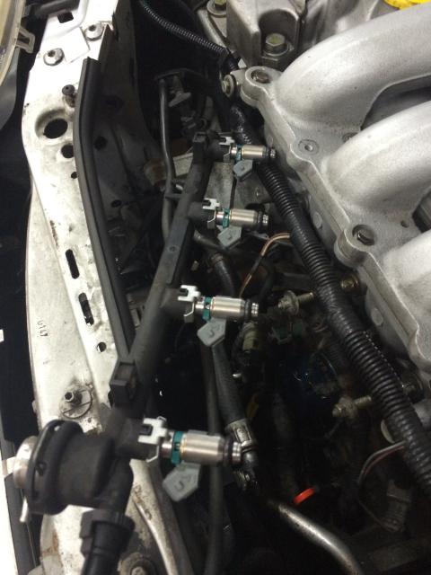

Four new injectors and a new lambda sensor.
New power steering pump and aux belt.
Fresh oil/filter and coolant flush.
Plus a few other niggles I've been meaning to look at. Car was at Renault yesterday for a new key as the original no longer unlocked the car. Parts should start arriving tomorrow morning!

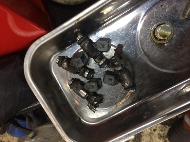

Old injectors out:
New ones in:

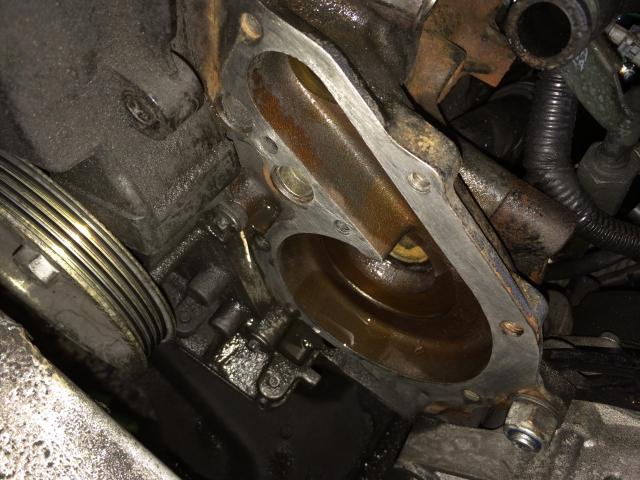

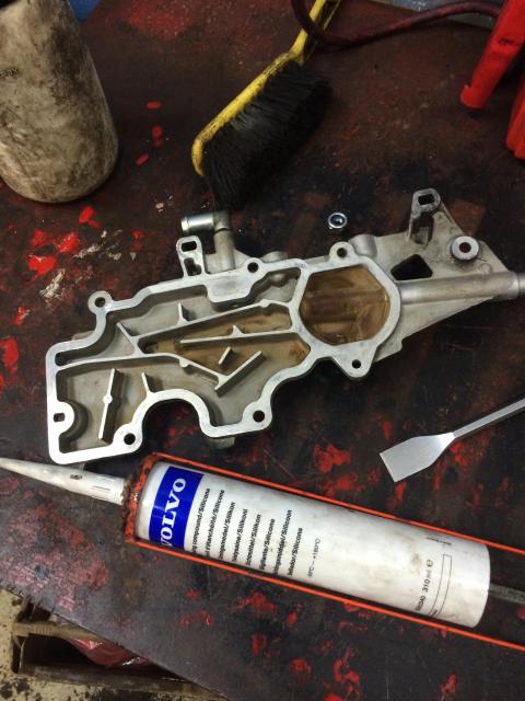

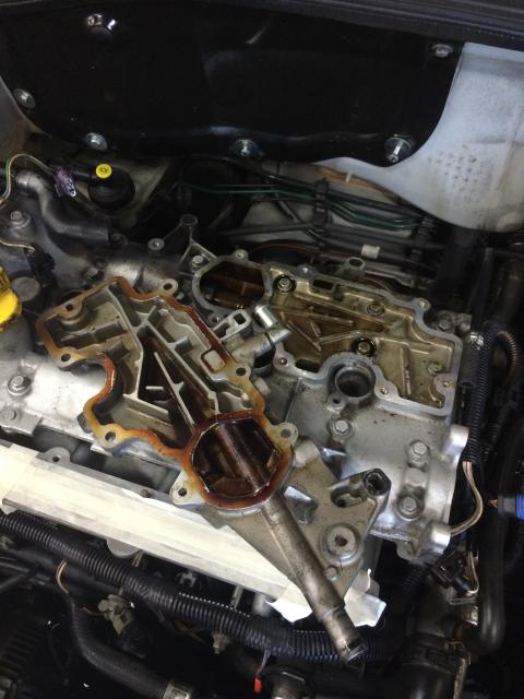

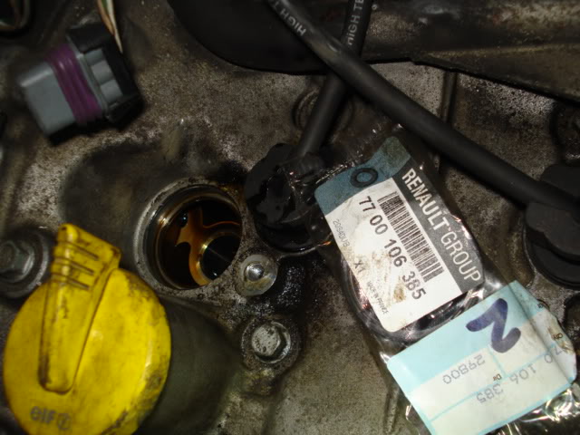

Also had a small oil weep from the breather plate so whilst the inlet was off managed to tackle that:
Cleaned up and refitted with some silicone sealant:

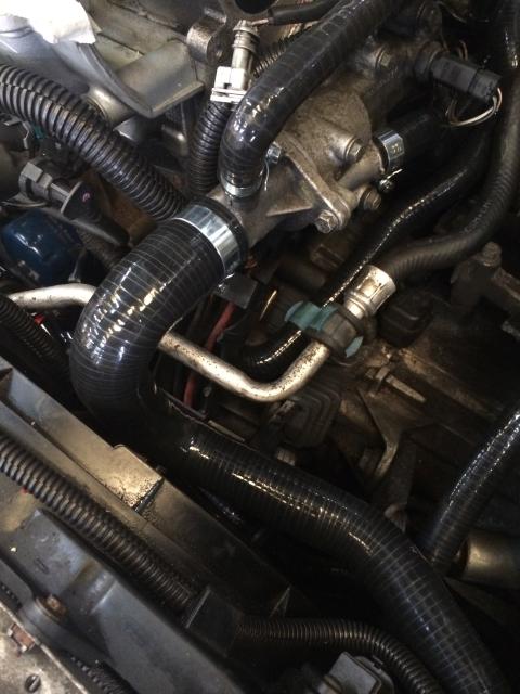

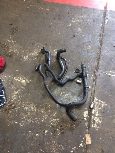

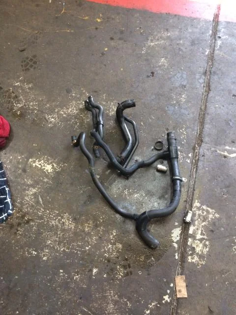

Old hoses out, the heater hose clamps were an absolute pig!

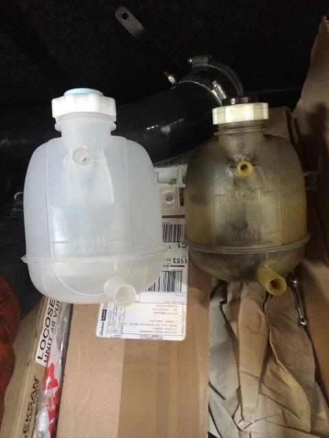

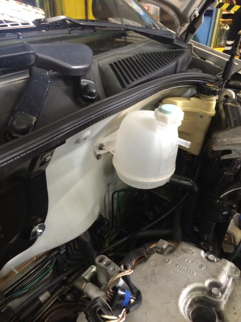

New header tank as the old was looking a little old:
New hoses fitted:

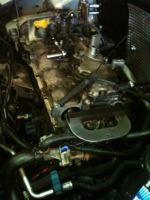

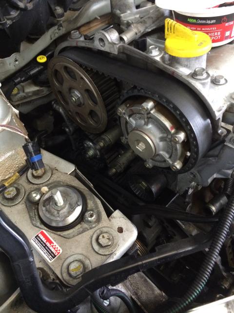

Today I'm getting down to the main job, cambelt!
Water pump came off a breeze however the gasket has been comfortable for 14 years and refused to even lift at the edges. Unfortunately it took me over an hour to hand sand the gasket away, proper PITA

Good progress mate. I have the cam locking tool's whenever you're ready. :)
Cheers fella it may be put to one side for a while as I have other priorities as of next week and Renault have lost my parts. May have to pick this back up in a fortnight!
Managed to finish this over the weekend between Goodwood on Sunday and a trackday on Monday!
In the end just bought a set of genuine renault tools as that way I can use them for the mrs 225 when that's due the belt.
Manifold wrapped:

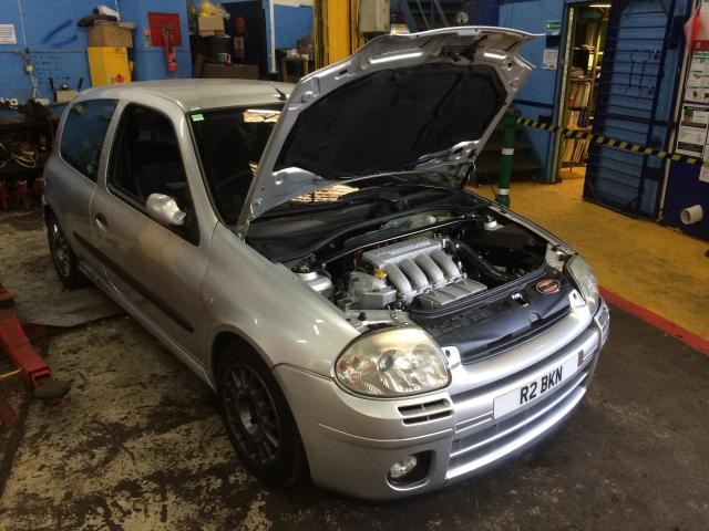

Cambelt, dephaser and water pump on. All engine parts sprayed up again , wanted to get them powder coated but funds didn't allow.
Started first time and after a quick rough idle which I assume is from the fuelling adjusting for the new injectors and lambda it runs absolutely smooth and drives perfectly. Feels just as quick as before but with a better idle and quieter running.

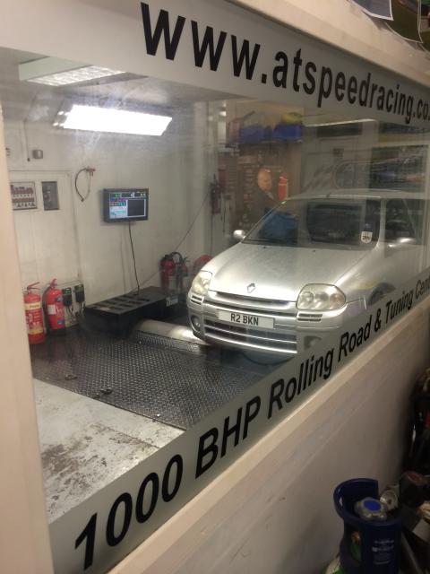

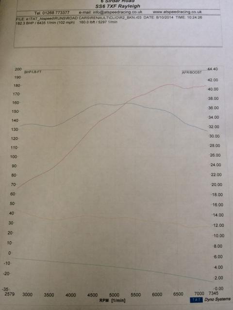

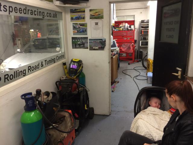

Wanted to get the power checked on a dyno as I wasn't 100% convinced the camshafts were timed to perfection. The horse shoe fitted fine but with a couple fingers force to slot into the inlet. It felt just as fast on the road but I like to be thorough and it also gave me an opportunity to get the AFR checked as it's running a remote Fastchip remap.
After some research on my local dynos I decided against AmD as they have a reputation for running high and after reading up on South Easts dyno day at AtSpeed it seemed all the clios posted honest figures. Popped down first thing this morning, had to drag the mrs and little girl with me to her first ever dyno session ;)
Well what can I say? I know this will be contended by most but the cars always been freakishly fast and I've driven many 1*2s of different spec over the years, I knew this one was a strong motor...
It recorded 182.3bhp and 160lb/ft or for those who don't like the predicted flywheel figure it was 160bhp at the wheels. Whether it's accurate I'm not really bothered just happy the timing was done correctly and it's pulling strong :)
