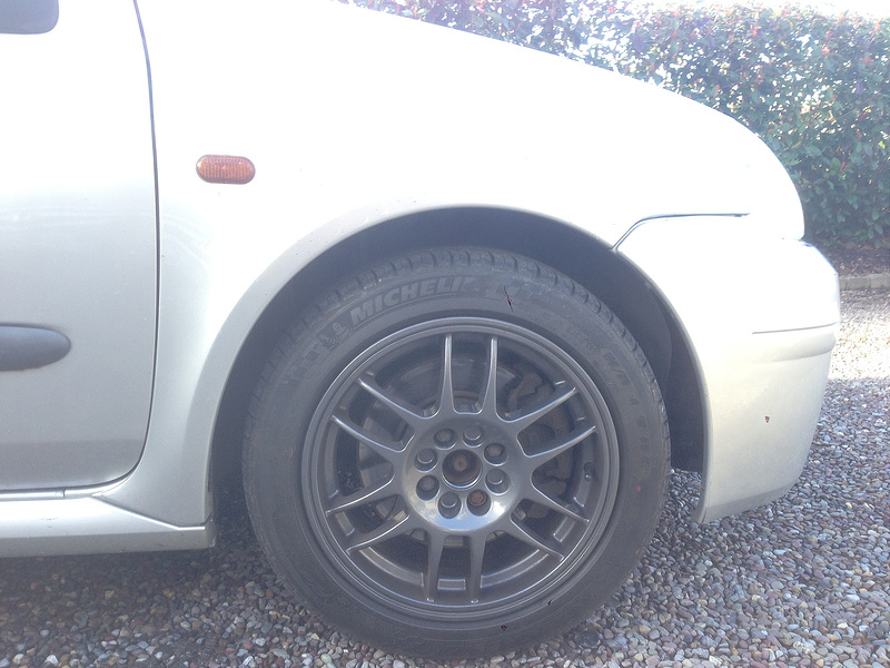

I also have had these alloys that i have been meaning to put onto the car for ages so i forked out for a set of tyres. I bought the same tyres again Michelin Pilot Exalto 2 205/50/15 off eiretyres.com brillant service.

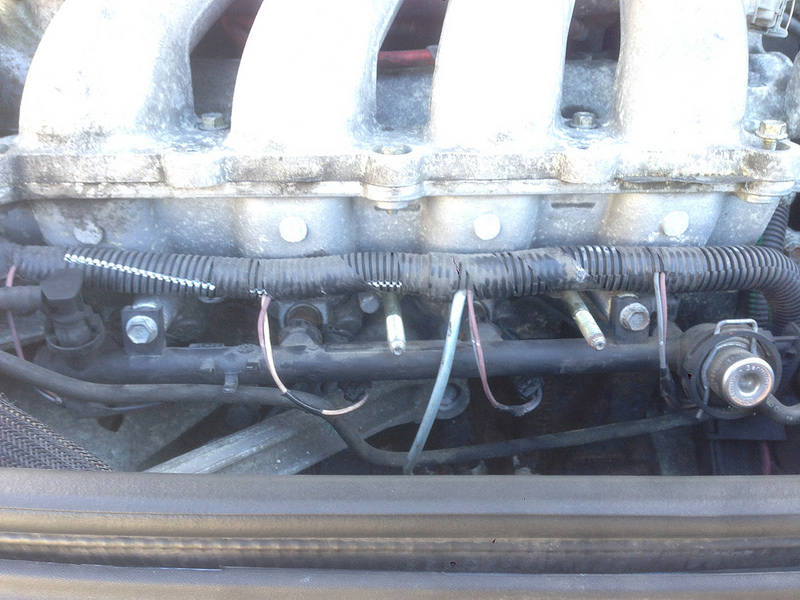

I was able to give it a bit of attention today and replaced the injector. I didn't know if the injector i got was working or not it was secondhand so to save myself some trouble i swapped the no.1 injector which was working into the problem no.2 cylinder and put the second hand injector into no.1 cylinder. This way if the problem was with the old injector everything would work but if there was a problem with the secondhand one then the no.1 cylinder would stop and if it wasn't an injector problem at all potential no.1 and no.2 wouldn't work. I started the car and everything was working fine thank god.
The Fuel rail and Injectors.

The front calipers are in need of some painting. i don't know what color i want but i am not going plain i am thinking red, yellow or blue. Can't decide which i like better leaning towards the yellow any suggestions here is a close up of them.
