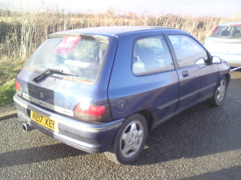

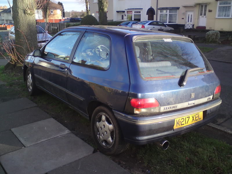

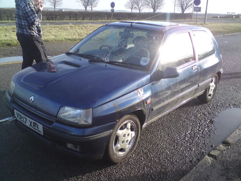

A few weeks ago I saw a neglected Valver on eBay and decided to buy it. It's a 1993 1.8 16v which has seen better days.
Here are some pictures of it:
It needs a new passenger side front wing, new windscreen, new front foglights, new drivers door, replace interior with 16v spec and sort the rust round the rear arches. The gearbox also needs a rebuild but I won't be using that anyway. The car itself has done 141,000 miles which you can really tell.
All that will get sorted as the project goes on, but I only paid £195 for the car.

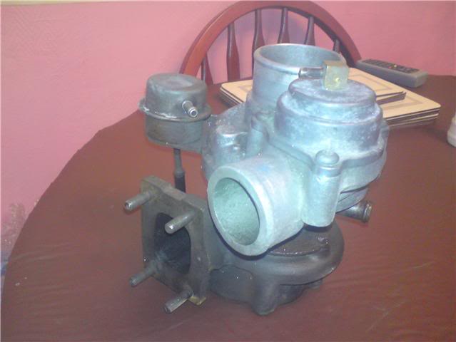

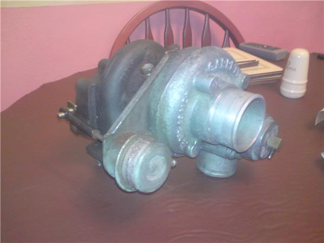

My T25
t25 off a rover, that built in dump valve will want blanking off as the leak at about 12psi, forge motorsport do a blanking plate that will sort that out for you
To get the tomcat to fit the GTT lump you will need to rotate the core so the oil feed in is at the top you will need to rotate the compressor housing you will need to drill and tap the rear of the compressor housing as the actuator will need to be moved, Drill the 2 x bottom holes out on the ex side of the manifold (slightly bigger to mate with the GTT manifold) you will also need to use the water banjo and bolts of a standard renault T2 turbo, oil drain will need modifying and you will need to probably get an oil feed adaptor (pirtex), Oh and before i forget removed the built on d/V and put a blanking plate over it don't forget to use the d/v gasket with some sealant.
Pics of a tomcat converted to fit the gtt
