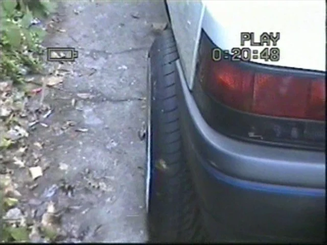

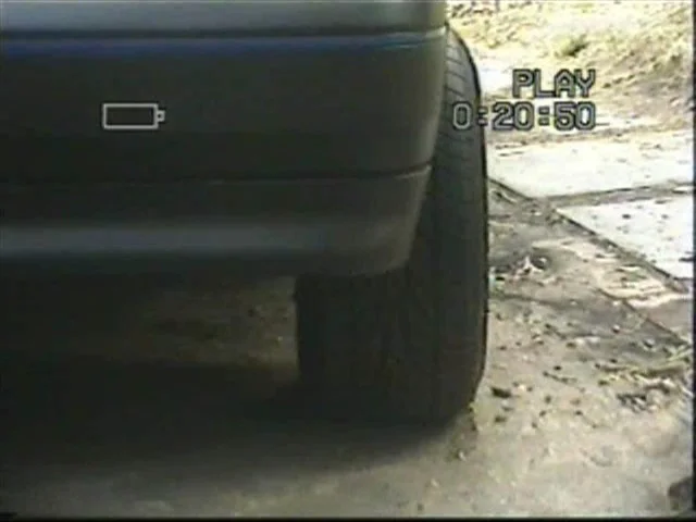

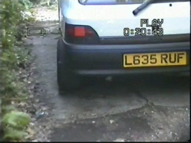

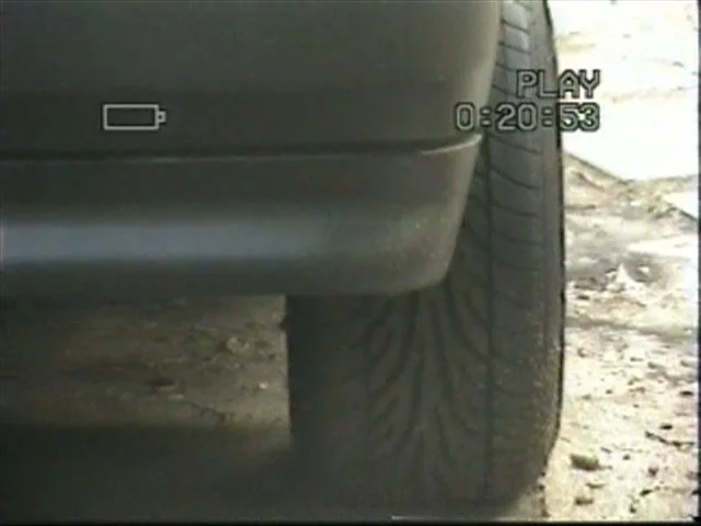

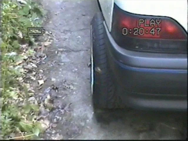

my clio with hydraulics
no idea what rims they are my brother put them on 2 day off his mini. and while i was adjustied the torstion bar a bit 2 high and it was bouncy
alleycats are the rims, but... how the fook did he manage to fit them.. totally diff PCD :S
Same wheels as me. Mine stick out an inch at the front and 2" at the back with valver arches so yours must be a different offset to mine.
Looks good tho.
Matt
What size are they 13x7 or 13x8?
Thats what they look like on mine. Front is fine but i'm puttin a non 16v axle on the back cos they stick out too much.
Matt
here

clowo16v, are they mini wheels? like mini PCD as i thought they do not fit. are you using wobbly bolts to fit them on?
cheers
cheers
yep they are mini wheels the bolts all lined up perfect
Minis are 4x98 so might not have lined up perfectly but might go on.
Mine are 4x108 ford pattern. The front hubs are re-drilled and I need to fit 15mm spacers. I'm putting a drum braked non 16v axle on the back, as to get them to clear the calipers i'd have to run 35mm spacers. With the drums I just need to fit my hub adapters and they'll fit.
Matt
