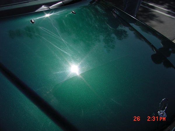

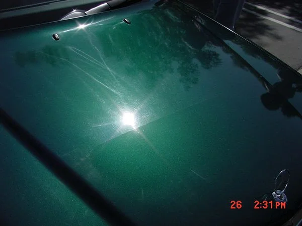

read this http://meguiarsonline.com/forums/showthread.php?threadid=7011
what scratch x can do[not tried mine yet!]
