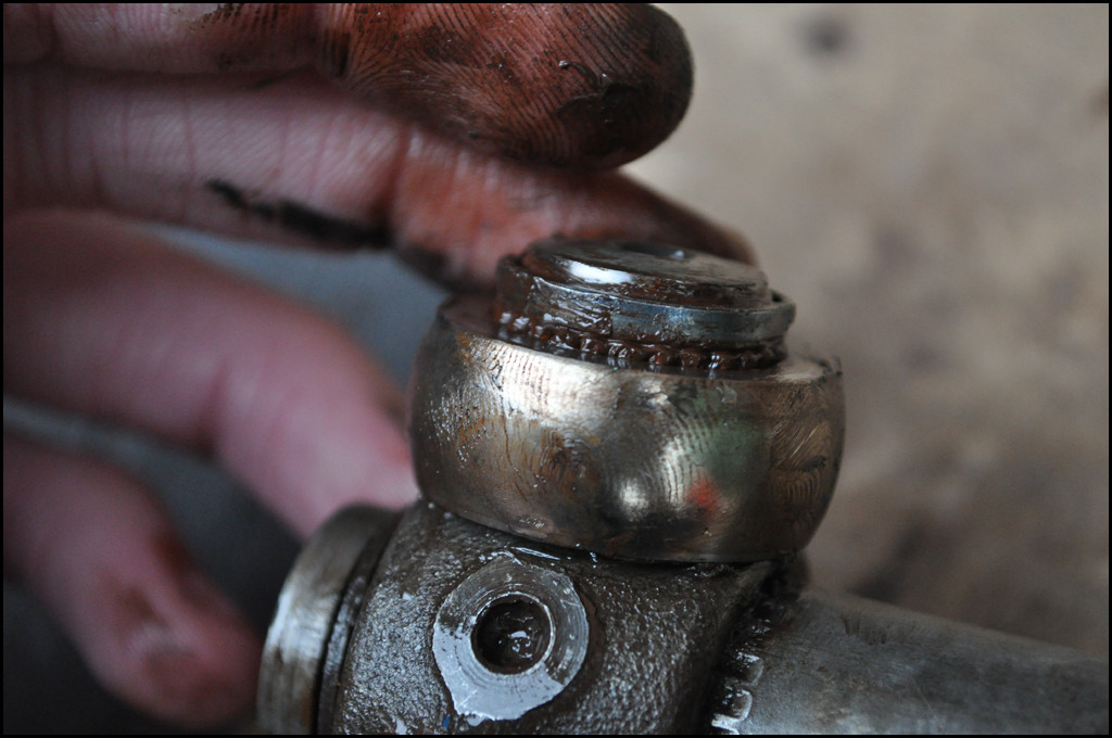

How it should look;

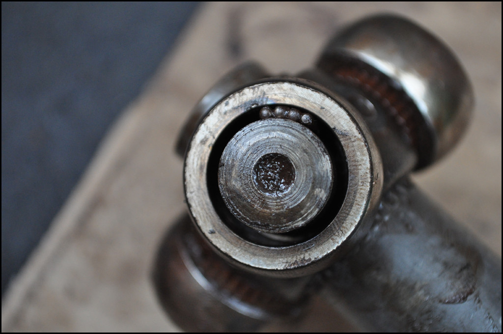

Having popped the gearbox end off and had a look, alittle play between the 3 balls and the shoe which I already knew was there. Popped the hub end of to fine loads and loads more grease, so I thought that may have been the problem as both smelt completely different.
Then noticed the large ring just sat in the box... :S

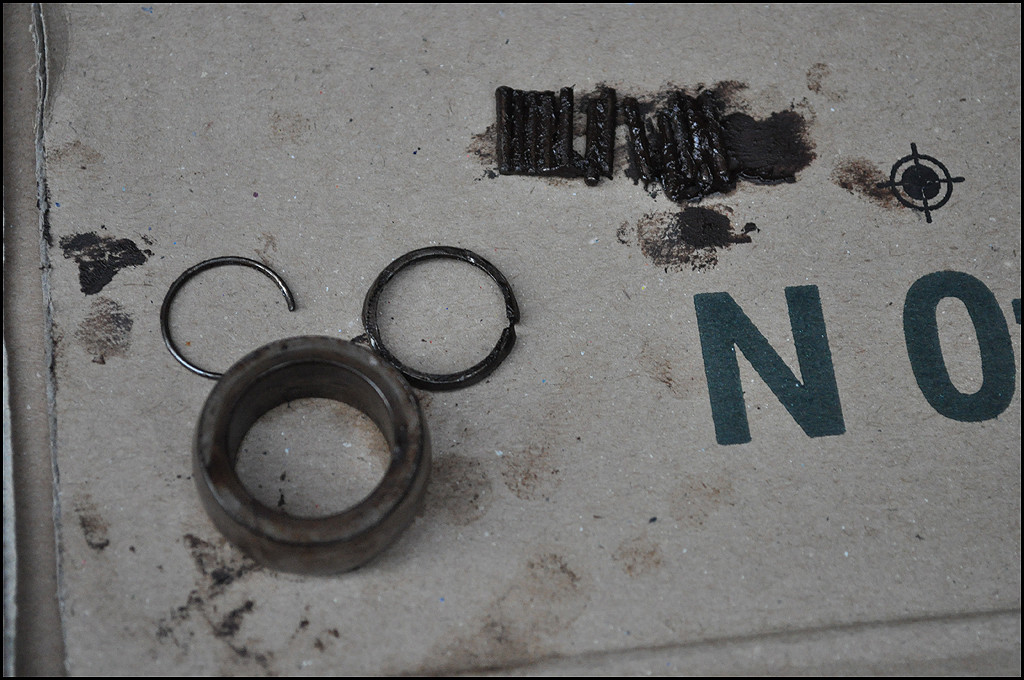

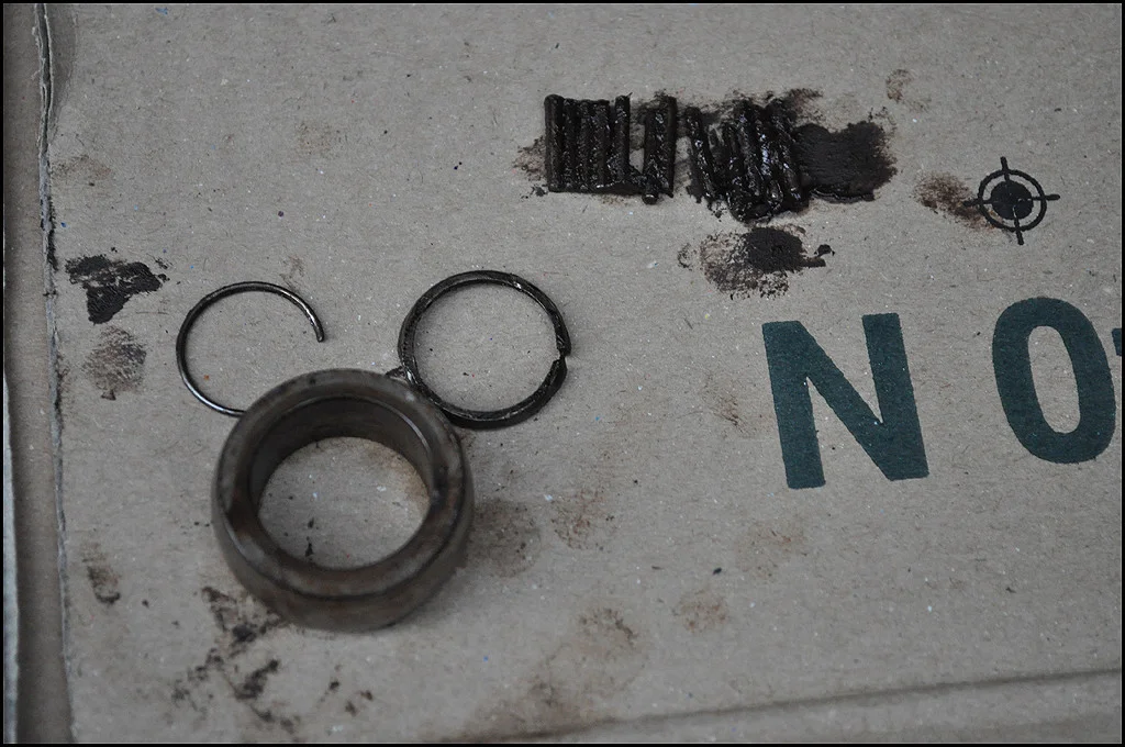

Ends up that the joint had disintegrated somehow, the small pin style bearings where to be found inside all the grease in the main shoe that goes into the gearbox, not on the arm of the driveshaft.

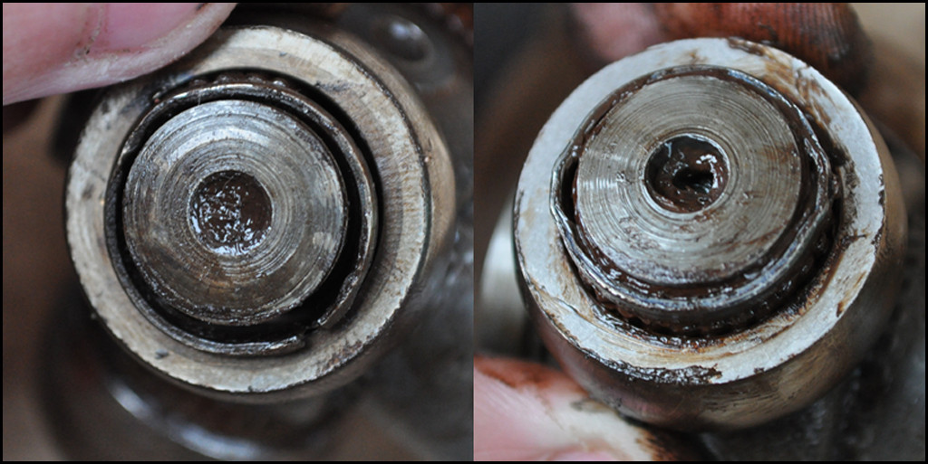

The retaining washer had become somewhat weathered;
Bad left, good right.
Not deformation of the metal, just seems to have simply fallen out, although most of the pins have disappeared?

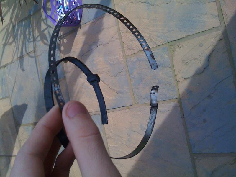

I'm sure it'd be simple enought to repack the plastic boot with copper grease, cable tie it back up (as that's all what was on there anyways), if there was nothing wrong with it.

I know you can use tie's, but I've ALWAYS had better results with jubilee clips, greatly reduces to chance of having CV grease everywhere. Which, lets face it, is never a bad thing!
