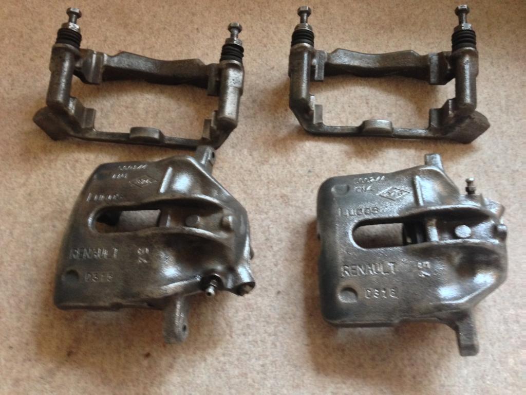

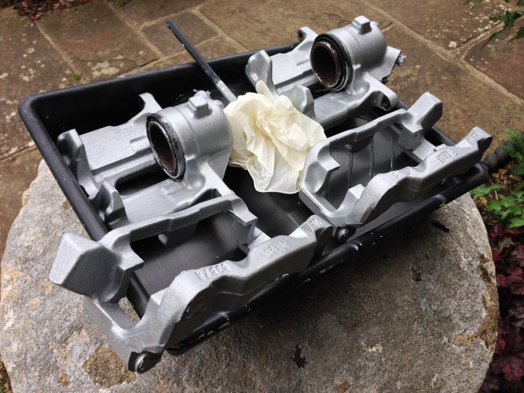

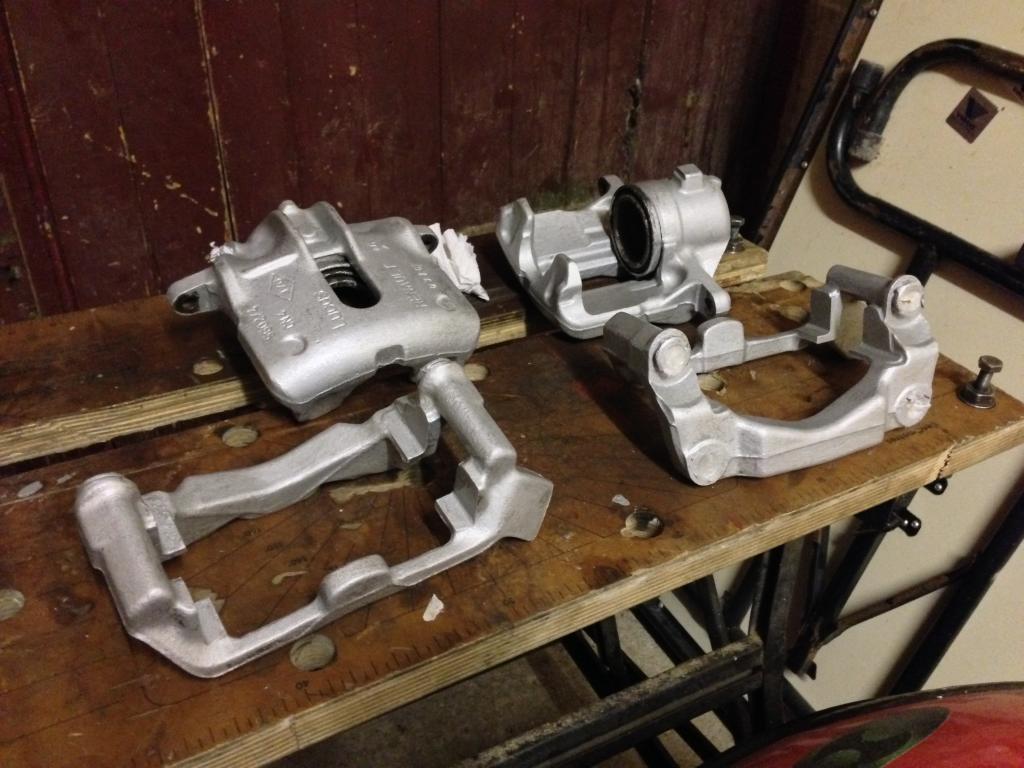

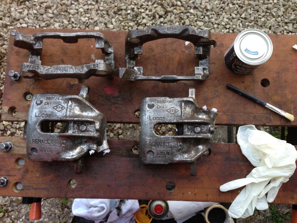

o Brake calipers rebuilt/serviced and painted, undecided on colour.

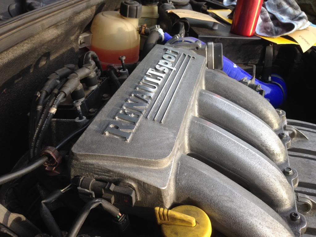

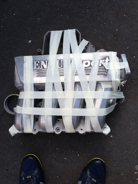

o Inlet mani painted with coloured lettering.

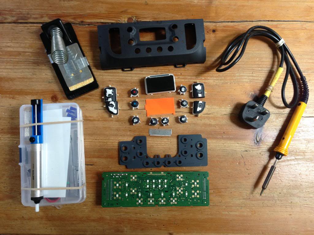

Today I took out one of the vanity mirror lights. Was hoping to find some LED/white light replacements but can't seem to find anything suitable at all! Bulb has 12V3WPLX on the metal ends. Assuming it's a 12v 3wat bulb, no idea what the PLX stands for though? The only LED thin bulbs I could find had flat metal ends though, which lacked the pointy ends to secure the bulb in place. Anyone know of where I can get some replacements?

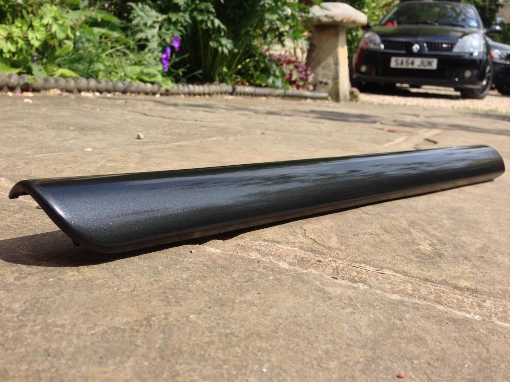

Minor update. Bought some primer, black & clear lacquer rattle cans from halfrauds. Going to have a go at reconditioning my grill(es) as they're really rather faded. Currently debating getting some touch up pens for the red/white/blue flag as I've seen on some others. Actually already have one of the colours so would only be about £6 for the other two. Quite like it myself, what's peoples thoughts?
Example below borrowed from this thread:
Is it's true, credits due to CS member Banderson
Grill respray went badly.
The Grill as a whole, I think was fine. Though I think I'd like to pick up a second hand grill and really take the time between very light layers for a perfect finish at some point. Painting the flag on however, was frankly a nightmare. Couldn't get the masking tape to hold and the paints I had were a nightmare to use. Touch up pen for the white was incredibly 'tacky' after a very short amount of time. Red was rather watery and had a lot of difficulty with the masking tape coming loose. The blue actually worked out relatively well, but upon drying and on reflection, it's too dark from a distance to really notice it in anything but bright direct sunlight. It looks OK from a distance and the blue/white really aren't too bad close up either. The red however massively lets the grill down as it found its way behind the masking tape at the edges.

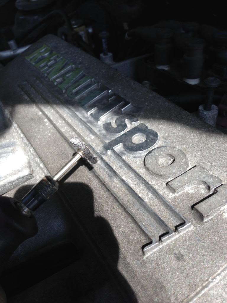

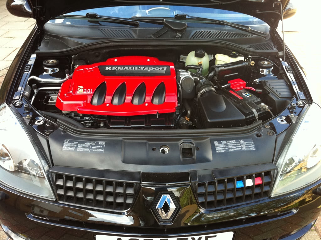

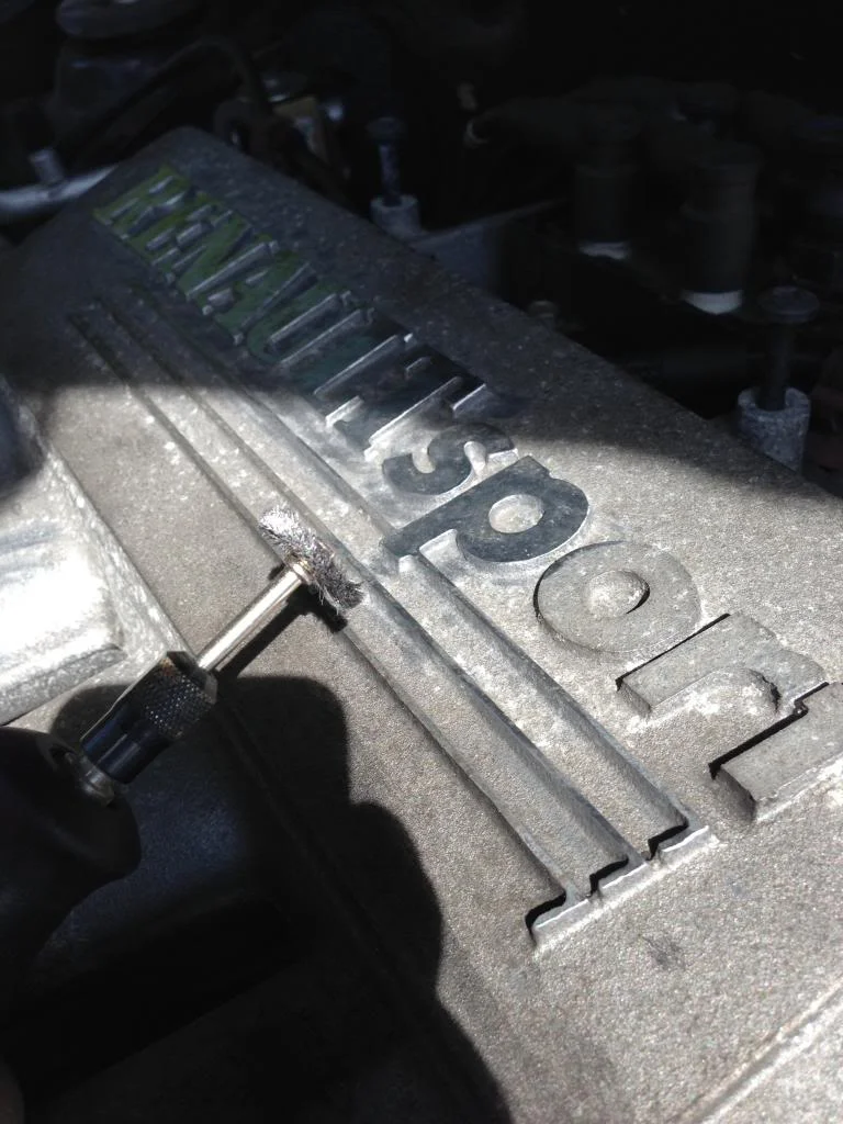

Engine cover is off and has been primered - got a bit trigger happy and now it's dried I'm not 100% happy with the finished result so it's getting sanded back and re-primered tomorrow. This brings me on to the topic of 'theming' cars and whether I like it or not. The guy @ ATS put lime green caps on my valves when he put the Turini's on. When I realised at home I was annoyed at first, but now I actually really like them! It's made me consider a subtle green theme. We're not talking badges of any sort, bullets or lettering. Mostly just very subtle touches like gear knob trim stiching, steering wheel re-trim stiching/center mark etc, green border around the RS logo on the mats (that I haven't even bought yet!!) I guess the theme would mostly be internal/engine bay, perhaps calipers.

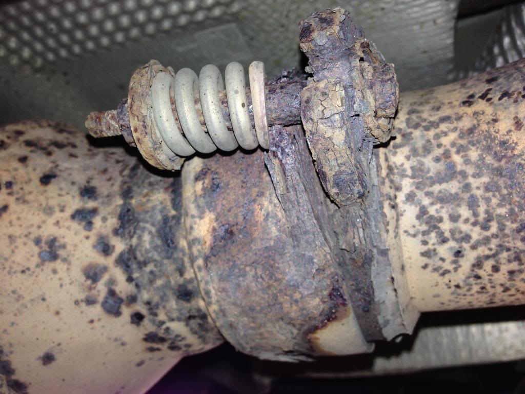

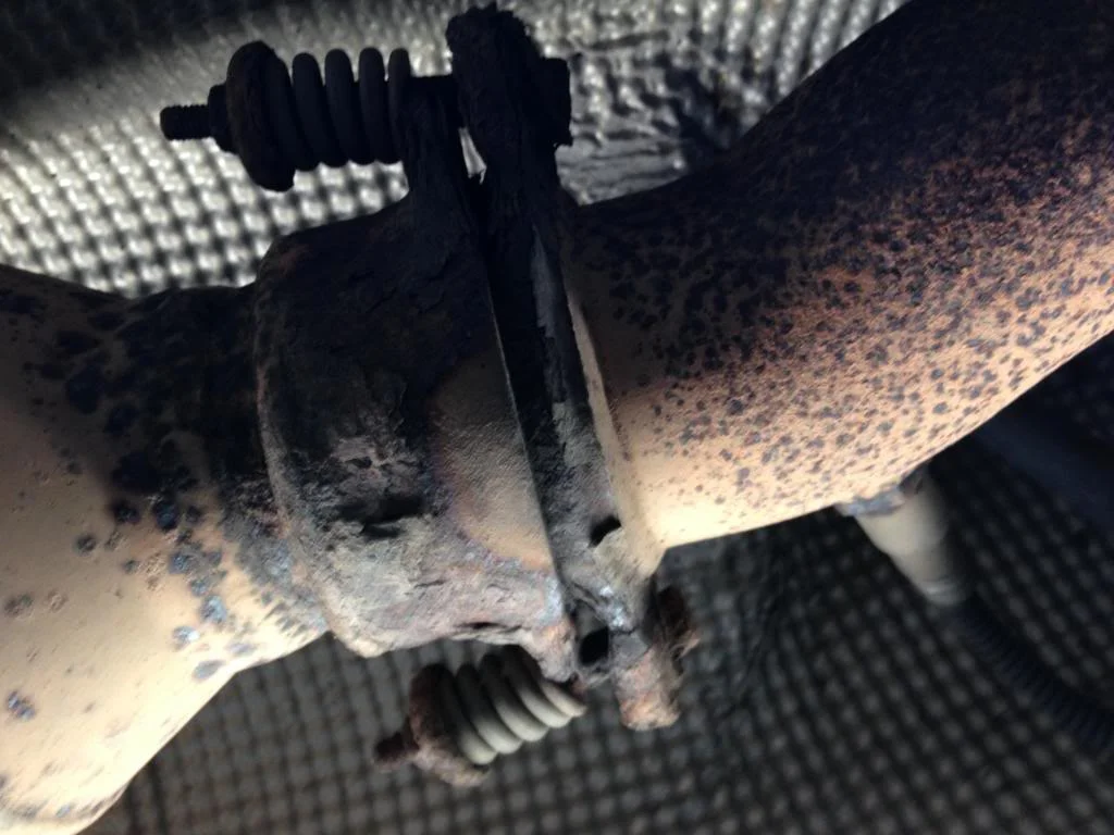

A quick search showed the heat shield is a common enough issue and likely can be resolved with some Water Displacement 40 (only just found this name out!) and some larger washers. Will be giving that a go.
Tackled this earlier.
Was evident once my head went under the car that a previous owner had already deployed the larger washer fix. Without adding saucers to the arse of my car that's not really a viable option any more! For a short term fix I've loosened one of the bolts off and supported the shield with galvanised gardening wire and tightened it back up. Unfortunately, despite letting the bolts soak in WD40 after repeated spraying throughout the day and wiggling loose/tight etc one of the bolts just clean sheered off, despite being cautious and not applying excessive pressure. The original washer, nut and bolt are all pretty heavily ceased together! Guessing the only option there would be to put it up on a ramp and drill it out?

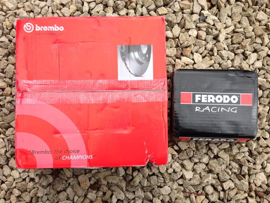

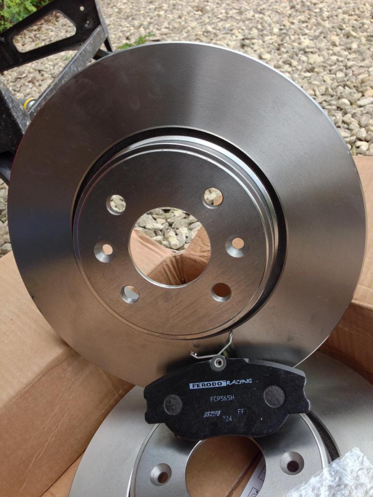

2 x Rear Shocks
2 x Front Shocks
2 x Rear Discs + Pads to go with
Plus new OE oil, oil filter, spark plugs and a few clips to replace broken ones.

Car's into the garage tomorrow for rear discs & pads to be fitted. Mildly gutted actually - I'd already booked it in, but wanted to have a go at it myself just haven't found the time this week. In the mean time a few other bits and bobs happened.

Car went in the garage today for the new discs & pads. Has cured the squeeling so I'm glad I kept hold of the old rear tyres rather than leaving them with ATS when they changed the wheels over! Definitely gutted now that I didn't have a go at getting them on myself as I'm confident I could've done it!
The good news is.. the N/S driveshaft doesn't need replacing and only needs the new CV boot fitting and regreasing. £21 from Renault - not too bad. With the MOT up in September, I'm hoping that getting this done will see it go through with no fails.

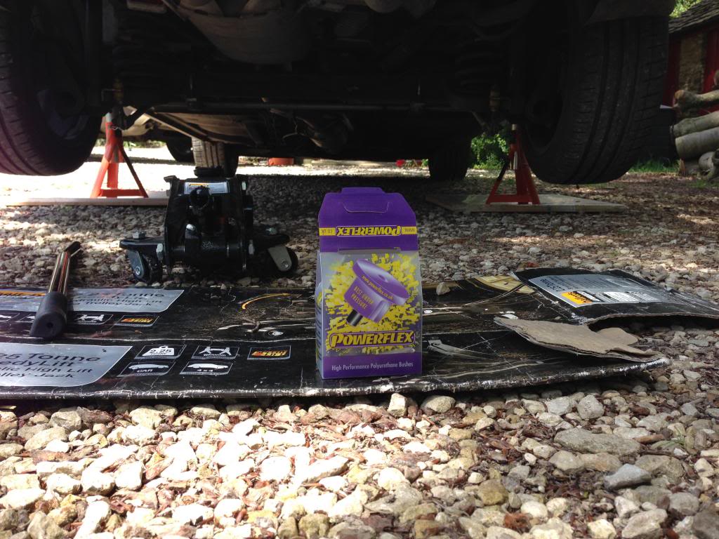

o Powerflex dogbone bushes

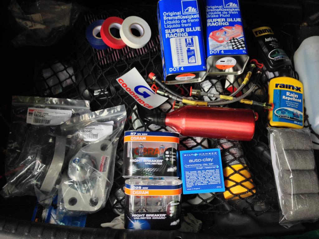

Time for an update. A lot has happened, life as usual getting in the way. I was intending to do one large one including a lot of pictures and more detailed thoughts, comments and opinons but frankly I've done quite a few bits and bobs with more coming imminently so before it all gets too confused or forgotten I'm just going to list some of the stuff that's occurred and I'll come back to it later maybe.
o Goodridge braided brake hoses & ATE blue fluid fitted by myself.
o Osram Nightbreaker Ultimate Xenarc bulbs
o Osram Nightbreaker Ultimate HIDs
o Osram sidelights (match better and frankly the LEDs I put in before were s**t)
o 10 hour detail, sadly already looking a bit dusty and hammered it home that my paint work leaves some to be desired! Rural locations :( (Megs Ultimate compound, polish & wax with a drill attachment DA, everything else autoglym)
o Ktec IK silicone pipe swapped for a blue one

A few bits and bobs arrived before the car went to Dan@SJM.
Bits and Bobs:
I fitted the Powerflex rear shock top mounts straight away, really nothing to see there.. but here they are sat in the box! Not sure why I took this picture but no others!

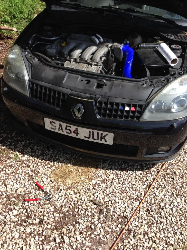

After that I swapped my Ktec hose over. I bought a blue one off the forums and sold the orange one. Might seem sad to some but I just hated the orange colour!
The Osram bulbs all went in at the same time, didn't take any pics as it's the same as every other head light change. Quick check that they all worked and popped the bumper back on. Old tatty number plates & screw fixings came out (had to cut heads off two with a dremel!) and new plates got velcro'd on. Looks much better I think! Lubed/regreased the bonnet catch up as it was getting a little 'sticky'.

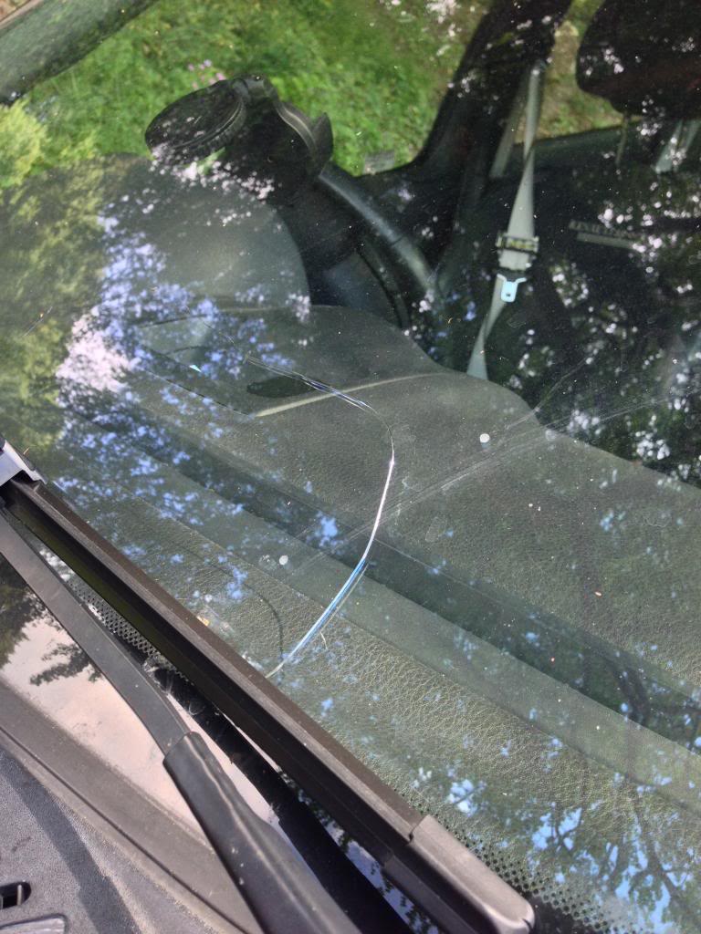

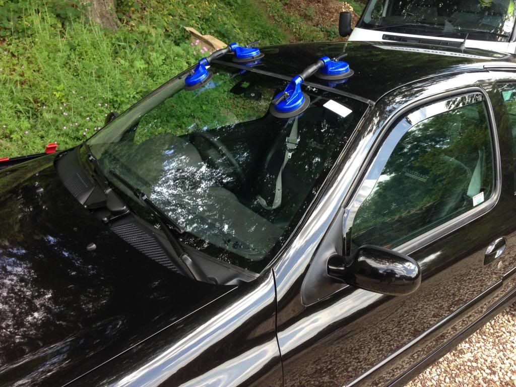

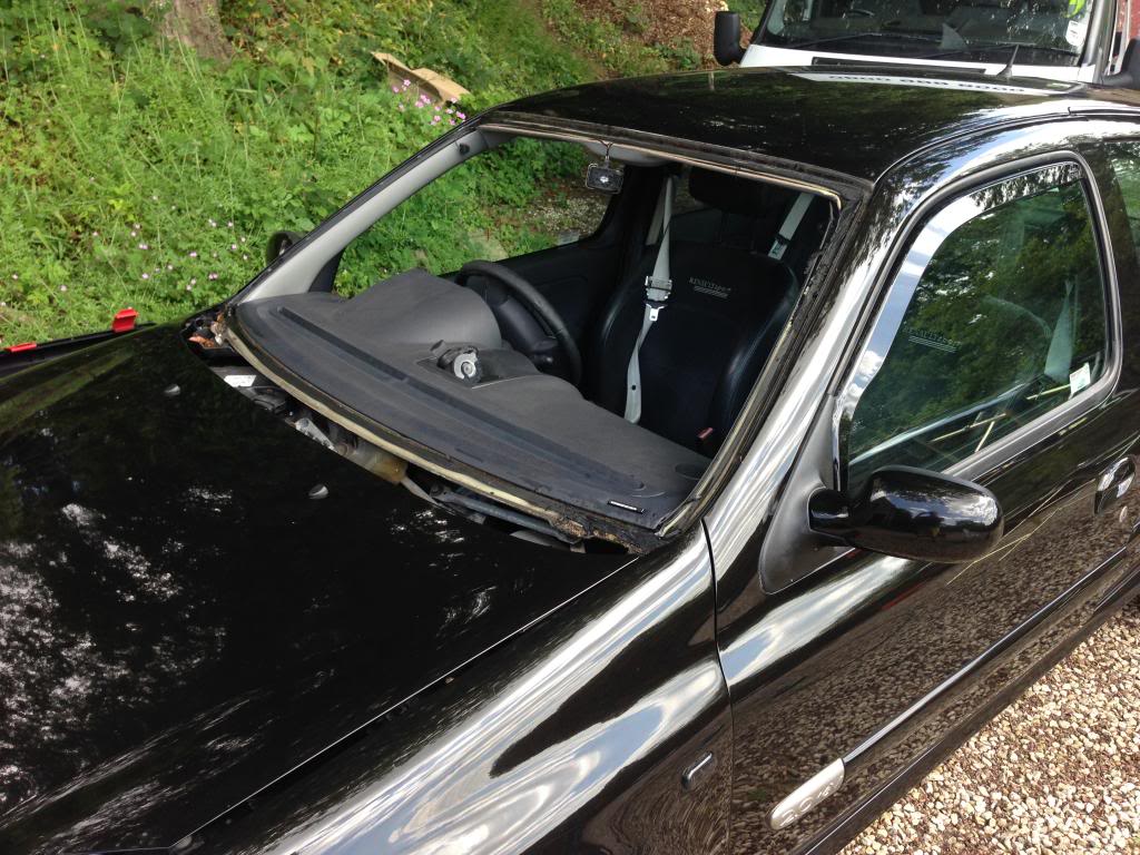

Windscreen replaced:
Then I got the windscreen replaced through Greenlight - which was an absolute pleasure to do - as it had a big crack develop. The guy who came was a top bloke, had a great chat and I even ended up helping him fit the screen!
Having been experiencing that my rain sensor wasn't 'all that', I asked the guy about gels etc (though obviously new screen has a new sensor etc!) and he kindly gave me the end of tub he was using! Bonus. Probably only enough left in it to reapply once, but I wasn't going to look a gift horse in the mouth!

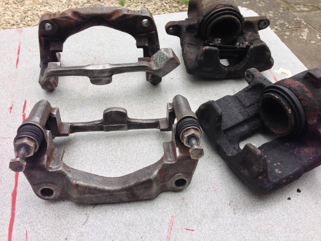

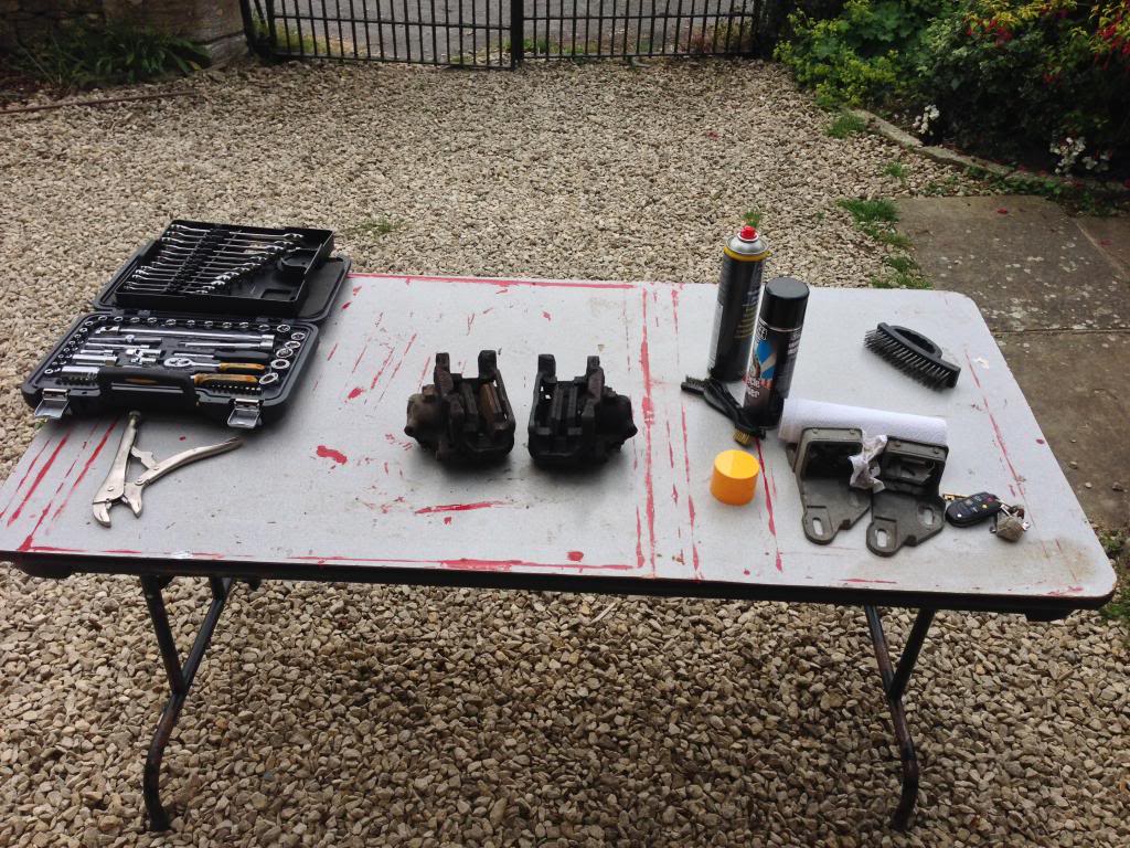

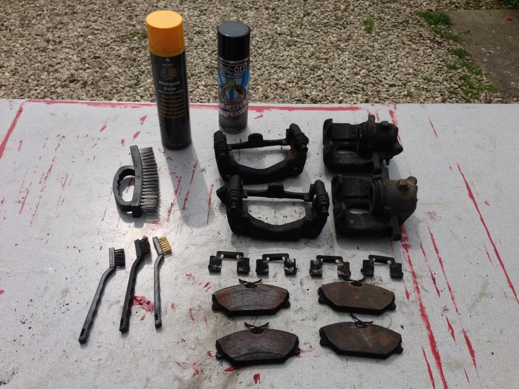

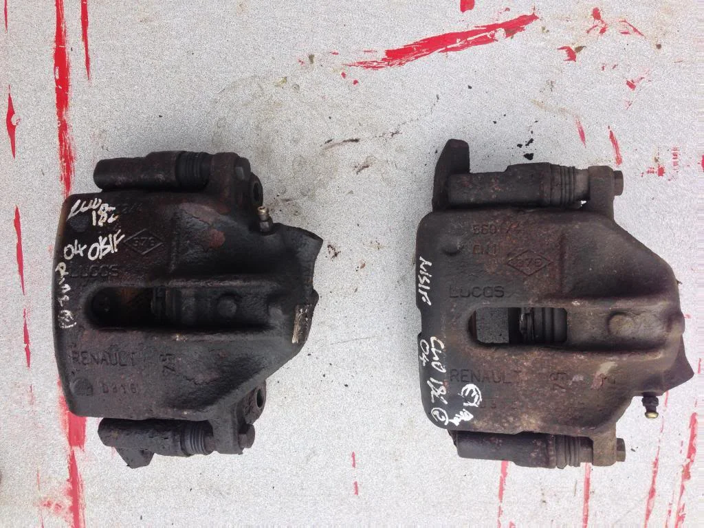

Brake Caliper Refurb:

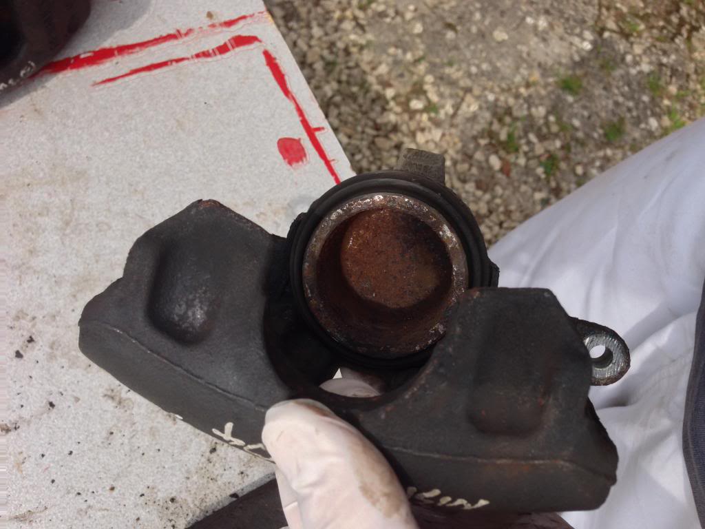

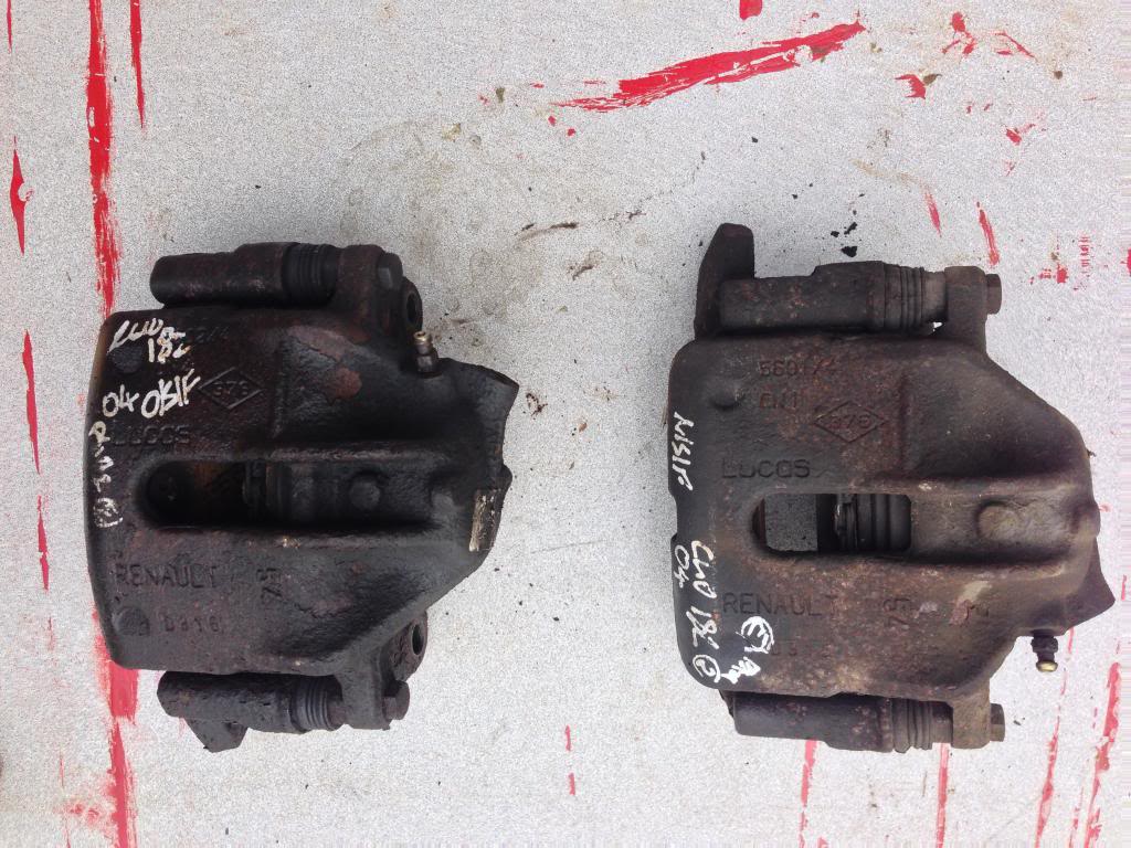

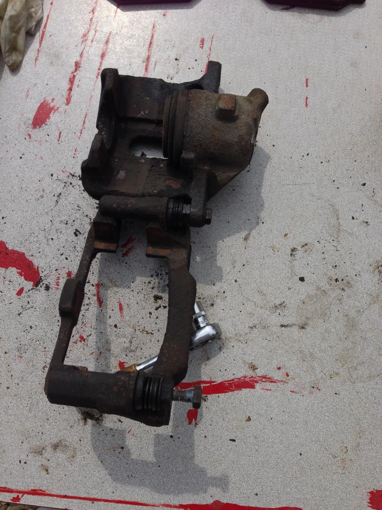

When I changed all my hoses over with Goodridge braided lines & ATE Superblue fluid, I notice the calipers looked pretty rough so decided to paint them. Me being me, that led to reading/watching loads of stuff on rebuilding brake calipers, fancying the idea of a big brake conversion, checking my bank balance and compromising on rebuilding my own calipers completely. I didn't take any pictures of changing the hoses, so I'll dive right into the calipers.

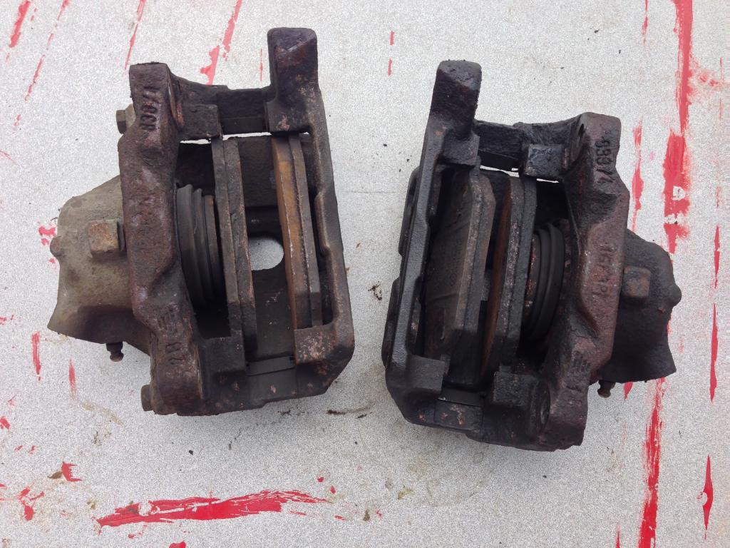

I bought some spare calipers off ebay for £35 as the car is currently with Dan@SJM getting the ECU sorted out. It also meant I could take my time with it and not be in a rush to put them back on. All ready to go on a bench.. you might notice a couple of exhaust hangers I had spare waiting to be powerflexed too, as my centre hanger went resulting in undue stress on the other mounts and they've split. Anyway, I got on with the calipers first. Hoses came off and drained what fluid I could. I checked the bleed screws - both freely moving, nice! - and then pulled them apart for cleaning.

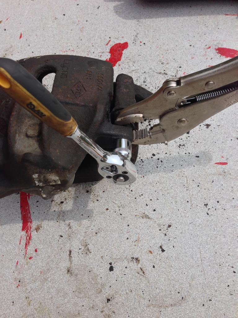

As you can see, they were pretty baked in crap with a nice level of corrosion going on. Fortunately the slider bolts all moved nicely: http://s1378.photobucket.com/user/C...8-4237-9196-44C9C69F8BC0_zpsqao36akl.mp4.html . At first I wire brushed them manually to get the really easy stuff off and used a bit of degreaser and some brake cleaner. Mostly just brake cleaner actually. Didn't bother for too long though, stuck a wire wheel on the air drill and removed the big bits of crap/corrosion with that!

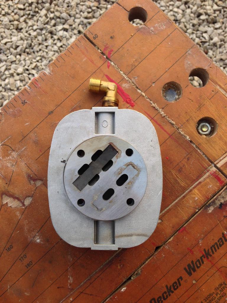

Not before fixing my brand new but arrived to me broken compressor though! Only took them 3 weeks to post me replacement parts and a week to deliver it from paying... Not that I'm bitter or anything! So I fixed that first.. making good use of the blow torch I'd bought! Love it when a plan comes together!

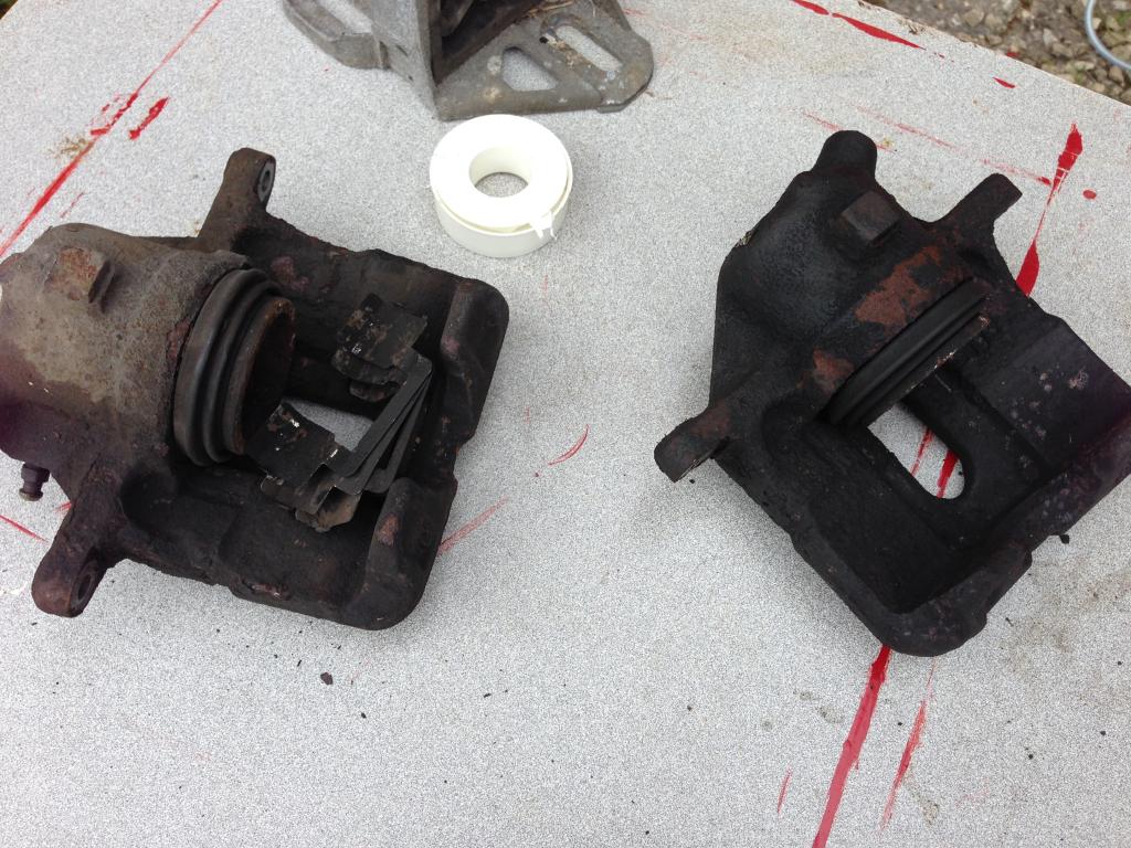

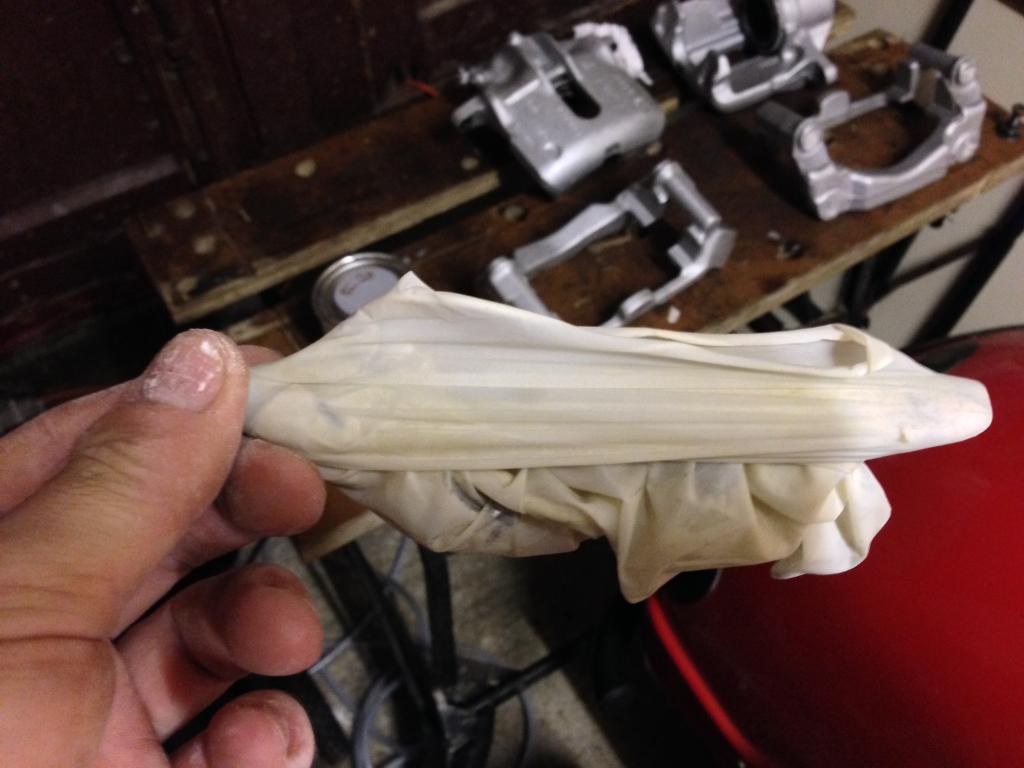

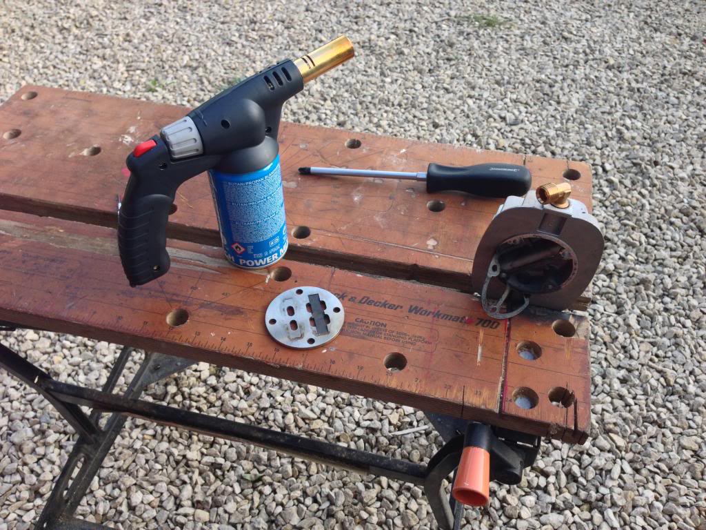

Had to blow torch the sealant type stuff they'd put on from the factory, so I could fit it to the new part/head/thing with heat fins on it. Stuck that back on the compressor did some first time start up checks and then got on with cleaning the calipers
At this point I had to call it a day, packed it all away and started again the next day. Not really masses to show so I didn't take any pictures, just finished cleaning them up a bit...
Had to stop again! But managed to have another crack that evening and was fairly happy with how they turned out, but new they needed a little bit more of a scrub for my tastes..
Then, earlier today I had enough time to give them a quick going over with the dremel and sanding wheels in a final prep for painting. I've ended up opting for Hammerite Smooth. Originally I wanted to use specific paint, but the overwhelming amount of people using it both here and at tons of other car forums persuaded me that I really am most likely best off just spending the £9 on a tin at B&Q opposed to the £30 odd for the 'proper' kits. I had planned to go RAL 5002 Ultramarine blue with these originally, but after reading a lot of threads and looking at a lot of pictures, despite how much I like the colour I have to agree with everyone that making your calipers stand out should only be done with nice calipers like 4 pots. It just seems right! They look dirty in the pictures but the metal is odd, if you don't catch it at the right angle they look dull/dirty when in fact they're pretty clean!! Anyway, I cleaned them down with some brake cleaner and got ready to paint..
Then it started raining and getting dark so had to nip indoors sharpish! I got to this point, one full coat on all of them, and this is how they're currently looking, sat in the garage until I get time to do another coat or two tomorrow! Wrapped the brush up in the gloves, hope it's air tight or brush will probably be solid! Probably worth mentioning, I read/saw a tip somewhere about cutting the brush bristles down to about 1.5-2cm before you start painting to give more control and a stiffer brush. I cut mine to 2cm and I do think it worked well/was a good tip. Got a nice, even coat with no excessive paint.
And that's it for now.. plenty more stuff I'm doing/done/have photos for but some of it's not far along enough yet to write about.

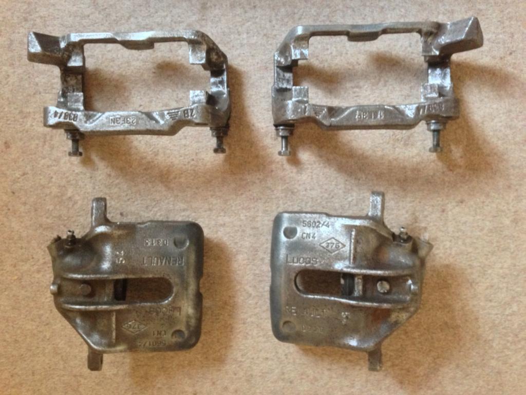

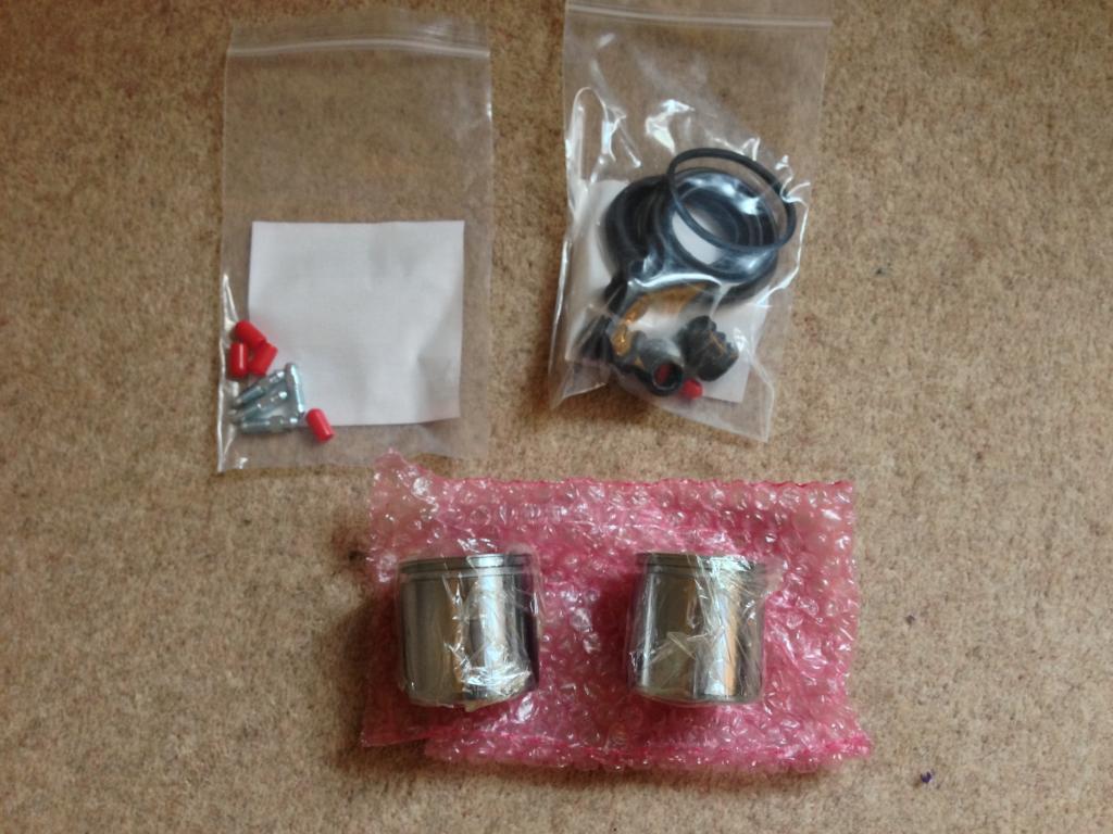

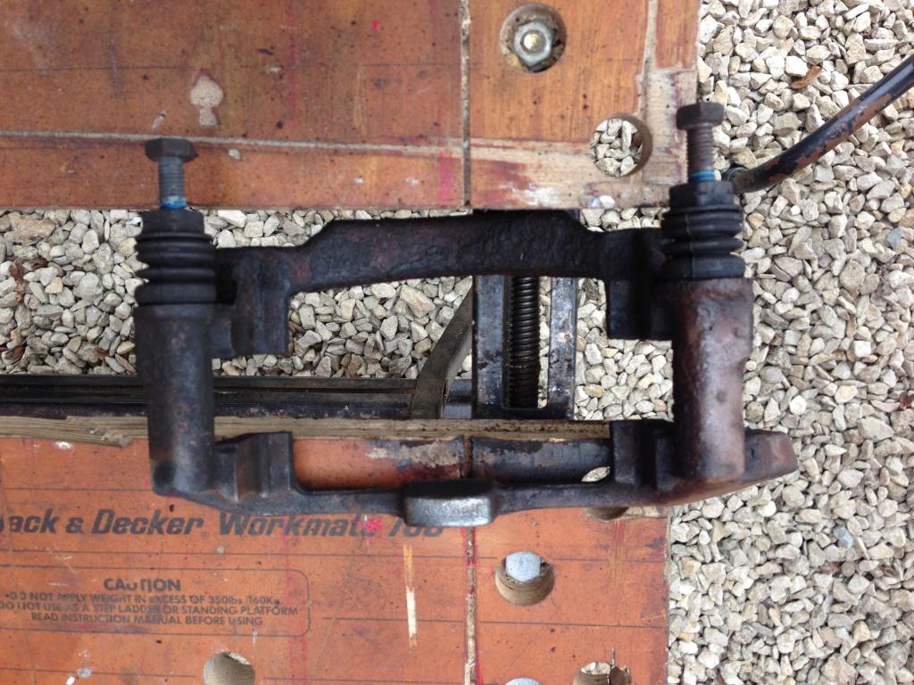

New seals, bleed nipples, dust covers, slider boots and two shiney new pistons!
Calipers got another lick of paint..

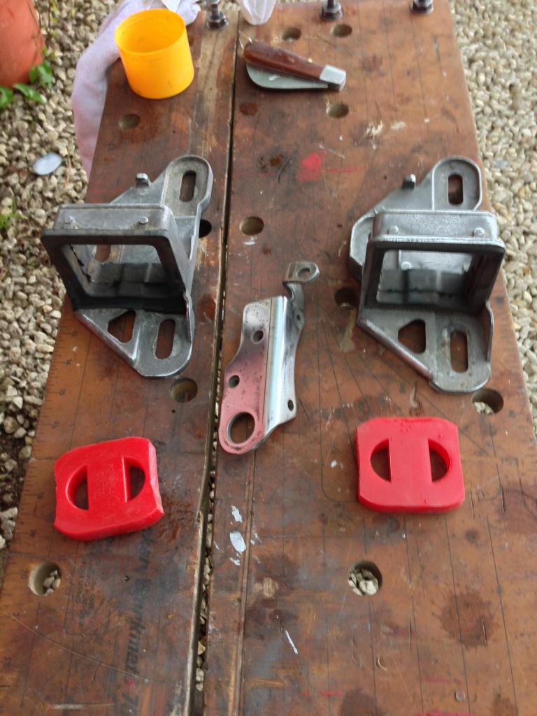

Took the bushes back out of these and gave the brackets a quick scrub. Not overly concerned if the finish on these isn't exception, for obvious reasons.
Then I got rained off... again.

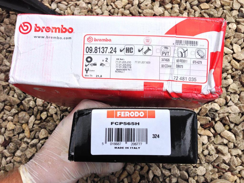

But just before that, these arrived! Top notch service from G172, my first buy from him personally but he's got a sterling reputation and now I can see why! Ordered and paid for over Saturday/Sunday and arrived by Tuesday lunch!
Catalytic Converter:

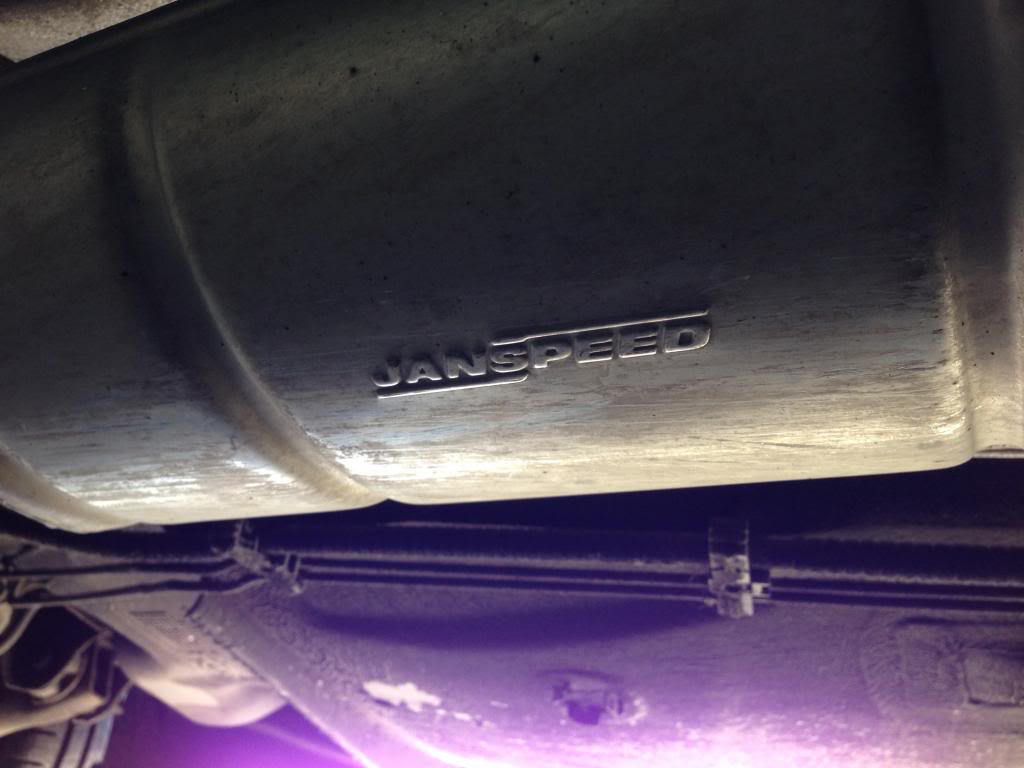

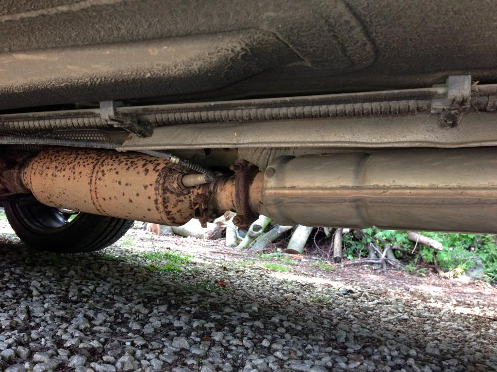

My cat was nearly falling off due to flange rot (lol, couldn't resist!).
Random pic of the Janspeed..
Didn't get any pictures during as I just needed to get it done. I was due in Cardiff for dinner and had to pick someone else up from Bristol.
The bolts were practically welded on! In the end I used a hacksaw to cut the brackets and bolts off, I did both you can see in the pictures, when in Rome and all that jazz. Careful if you do it, the springs do like to pop off the manifold end! Can get quite exciting if you're under the car on your driveway!. Tapped the ends of the bolts out of the manifold with a hammer - which worked a treat as they came clean out - followed by tapping the bolt cups out, using said bolt ends and the hammer. Very quick little brush of the big bits of corroded crap and started fitting the other one. I used the jack to hold the cat in place whilst I got the bolts in and nuts on, then jacked it up higher to tighten them a bit and get the clamps on for the olive joint etc.
Finished up went for a quick drive, was all solid, blowing but solid. Went to Cardiff and then the next day sealed it up by using some Loctite gasket stuff in the clamp around the olive joint. Went for a gentle drive (half a mile) it smoked a bit, pulled over and let everything cool off. Drove home and everything was good! No more blowing that I've heard, though obviously Dan has the car still!

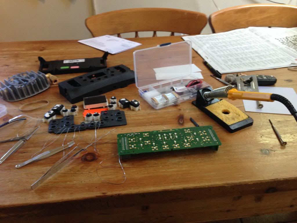

Dashboard Colour Conversion:

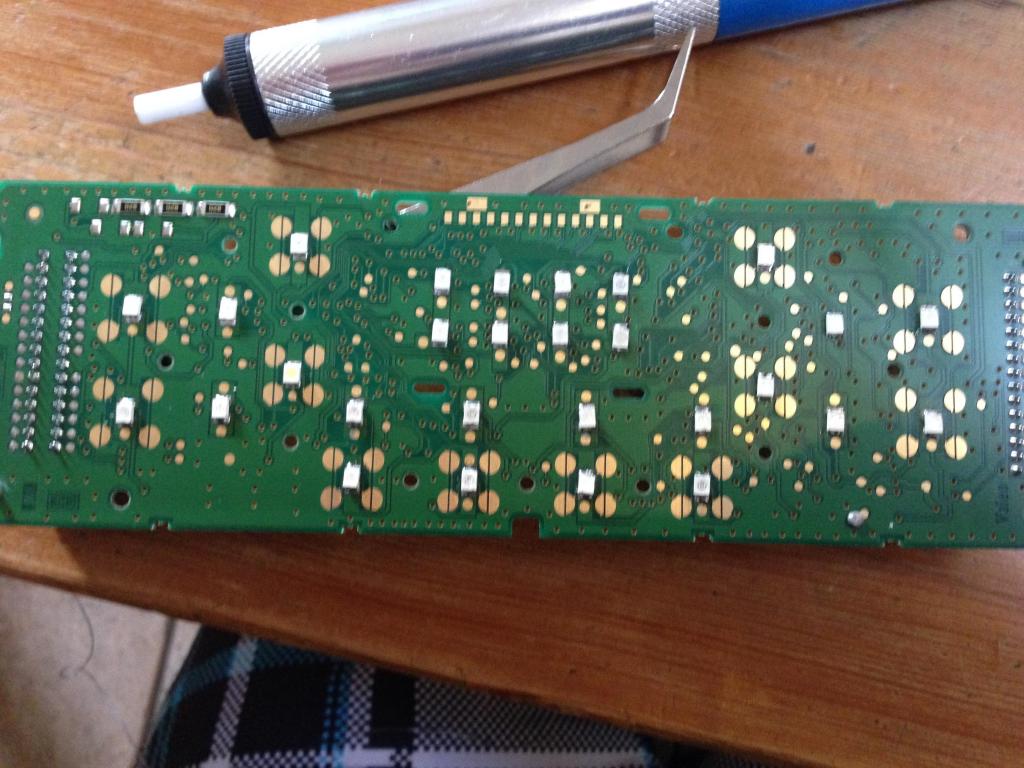

I've seen the blue SMD/LED dash conversion and really liked it. It looks sooo much nicer than the OE orange in my opinion. I started doing a bit of research and (famous last words) decided it 'can't be that hard can it?'. Picked up some cheap soldering supplies off ebay and after a lot of looking around I ended up buying a complete dash/interior kit from CrazyLEDS.co.uk. You can do the kit yourself a bit cheaper if you want to, but I thought £22 quid was a pretty good price and saved the hassle of sourcing everything independently and (should) guarantee I have all the right parts - so far so good!
I've read the climate control panel is the hardest part (pretty much because it has the most SMDs to de-solder and then resolder. I picked one up off ebay for £15 to practice soldering with. I've ended up getting it free as the guy had listed it as in good condition but when I got it all the buttons were heavily worn. Whilst it was fine for my purposes, I wanted to leave him negative feedback as if it was anyone else who actually needed the buttons etc then they'd have been royally peeved. He offered me a full refund if I didn't leave negative feedback! Can't say fairer than that really!
This is before I de-soldered anything. I forgot to take a picture when I finished and for safe keeping I've put it back inside the plastic casing. I'll try and remember to get a picture when i take it out again to fit in the car.
Largely I feel like it went fairly well. The kit came with a couple of spares which was useful as this is really my first time soldering since school. I took my time with each one and was pretty careful. Got a little sweat on the go. Took a break for coffee and then when I came back it hit me!
I had soldered 18 SMDs on... upside down! This meant the Positive/Negatives were in the wrong position and would have to all be redone. f**k! I got on with it though and sooner or later they were all on. Can't wait to get it in the car and see if my soldering skills were good enough and if it all works!

Painted the dash strips, engine covers and door pulls. Only have this photo as I haven't pollished the latter two up yet after clear coating. Mainly because I don't think I like it very much for the interior and I don't think I want an engine cover at all. Considering respraying, replacing with OE in good condition (mine were fubarred, especially the door pulls and that horrible sticky crap) or leacing them as is and going the extra mile to change the entirety of the interior plastics colour from the blueish look to a matt/satin black. Undecided! One for the future.
Here's the long dash strip anyway, was fairly pleased with how it came out for my first real effort with rattle cans.

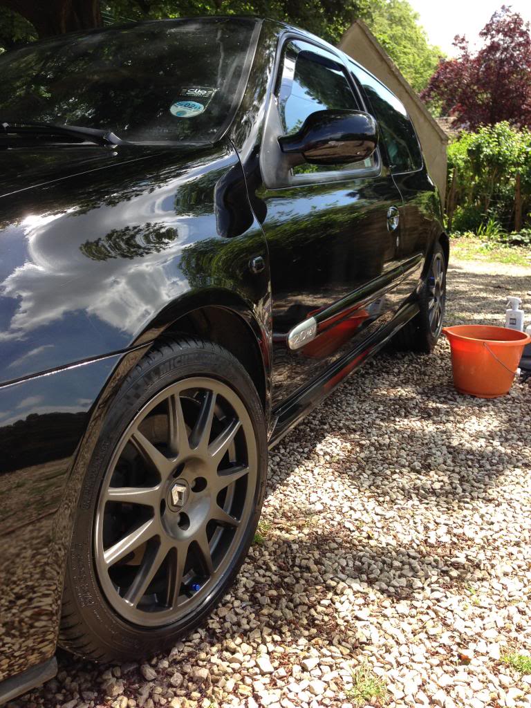

Cleaned the car. It was a right state if I'm honest. Should ahve taken a before but I'm not sure I'd have shown you all even if I did! Haha.
Redid all the plastic trims, scuttle panel etc and polished the exhaust tips back up to a nice gleaming shine! It's also the first time I've ever used a clay bar and I've never felt my paint work so silky smooth!! It was Bilt Hamber and it was definitely worth it! Didn't have time to do the wheels on the same day so that's why the look a bit scruffy and the tyres aren't dressed at all. Though dressing tyres is something I really only do after a proper deep clean. Did the wheels the next day but foolishly didn't take many photos at all.. certainly not that do the car/detail justice!
I also got the dremel out and attacked the inlets.
I was thinking about polishing the 'pipes' up to a mirror finish, but I think I'm going to opt for no engine cover, paint the rocker cover in blue to match the Ktec hose/samco hoses, paint the inlet manifold matt black, sand down the lettering and then possibly paint the 3 stripes in the colours of the french flag. Undecided on that one too!
