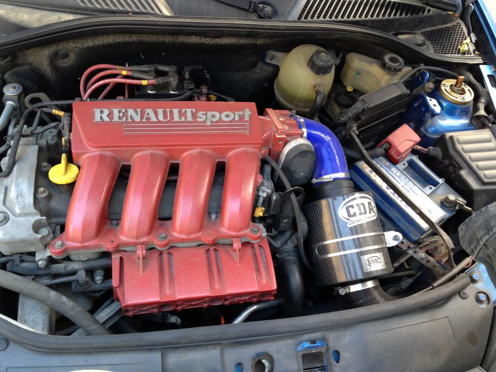

Car is a 182 with the following power mods:
Milltek cat back with decat pipe
fastchip rs tuner remap
BMC CDA induction with silicone elbow
The IK setup is as bellow:

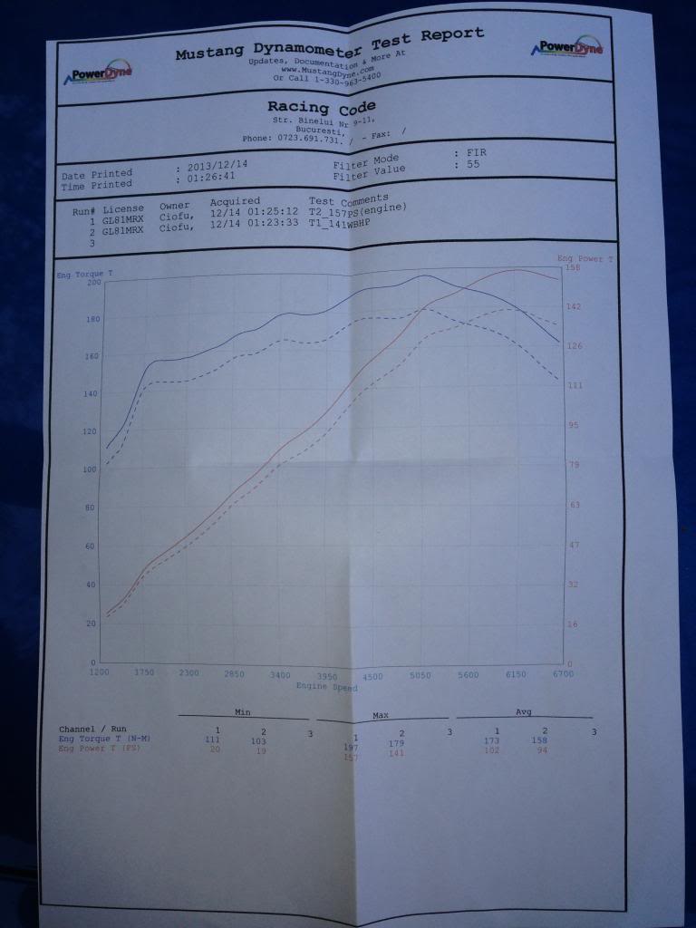

So it came out with 157 ps at the fly and with 141ps at the wheels
Obviously I was expecting more from it and the fly power seems a little low compared to the whp.

Torque came out at 197nm as seen in the graph-this sounds closer to reality though..
The guy owning the dyno is well known around my place, he's in the tuning business for about 15 years or more, he also advised that I throw away the BMC and put back the std airbox with a K&N panel inside (so he seems to know some clio business), he also stated that all clios who came in got low readings -from 155-to 162ps with basic mods.
He than recommended to have a custom map on his rollers, and together with the std airbox he claimed to bring back some 10-15hp on my car.

I'd say the dyno is off, the torque and power lines should always cross at 5250rpm, the graph has them crossing at more like 5550rpm.
  182
???:S
OP its about 13-15bhp down compared to the average 182 power output.. Good Dyno setups the mustang imo ,viezu use them here in the uk.

IMO, the way the torque curve nose dives at 5k in thinking the timing is out. The few I've had in with a curve like that has been due to the crank being locked in the wrong place.
