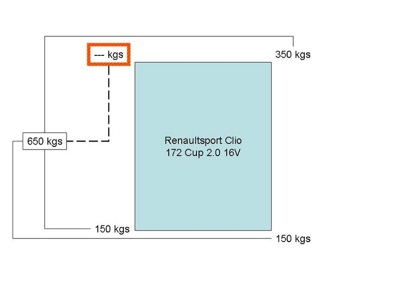

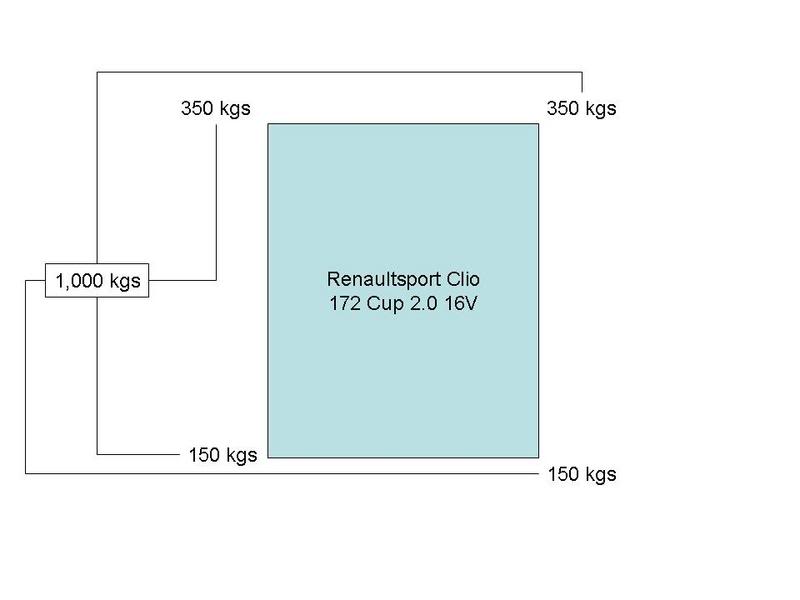

There are 4 scales, 1 under each wheel, each saying (for arguments sake) 250 kgs - so total weight equals 1,000 kgs. That works according to your theory.
Now imagine 3 of them are not scales, but platforms exactly the same height as the scale. Does the one wheel on the one remaining scale suddenly get heavier? No. Has weight distribution changed to affect the mass over each wheel? No. The car still weighs 1,000 kgs apportioned as 250 kgs under each wheel - you just happen to have only one wheel being 'weighed' at a time.
Whether I have one scale I move around each of the four wheels, or four scales I can use simultaneously should make no difference to the result.

OK then, consider the £800 + VAT scales I pictured above that everyone seems to agree will work...
Now, let's say that you disconnect one of the scales from the main display...
The other corners that are still connected to the main display are still giving the same reading for each corner that they were when all 4 were connected. The mass of the car at the corners does not change depending on whether all 4 or only 1 scale is actually connected; each scale gives an accurate corner-weight.
What's important to that is that the car is dynamically stable. I could do other pictures showing just the one scale connected but I'm sure you get the idea.
What I am trying to do with the pallet scales is exactly the same, to weigh each corner - I do not understand how you can argue that would not work?

Well I still cannot see the logic to your argument.
So what if 3 wheels are on pallets. They are static and do not affect weight distribution of the wheel being weighed. It still weighs 350/150 kgs as per my diagrams above.
Can we agree that if I go down this route, and do everything consistantly, and end up with a result between 950-1,000 kgs (which is where I should be)...that I'm right?
