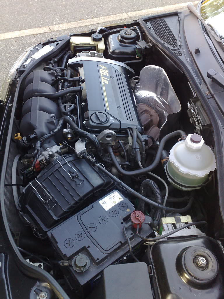

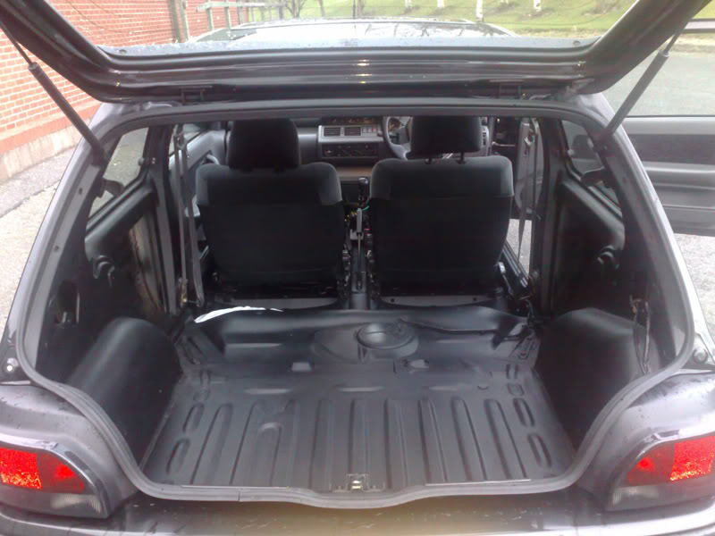

I then added some Williams wheels, some clear side repeaters and got started stripping it. I also painted the inside matt black with some of halfords finest. I also added a de-cat and itg panel filter with fog light scoops from tweeks witch improved things quite abit oh and some nice 1.2 badges lol and a Williams steering wheel. all this over a period of a few months .…
Then I got bored didn’t really want the car so started looking for a integra type r. the car just got to me abit needed new tyres, tax, cv boot doing, power steering was making a awful noise (turned out it just needed more fluid) and I just couldn’t be arsed so was close to selling. Then I sorted all that and got the bug back.
With the bug back I decided to start playing again I painted my inlet black (was meant to be gloss but came out satinL) added another cold air feed to the air box to help it breath a little more. I took to old air feed chopped it up abit cut a hole in the air box and had the feed running alongside the battery to the hole behind the passenger side front light.

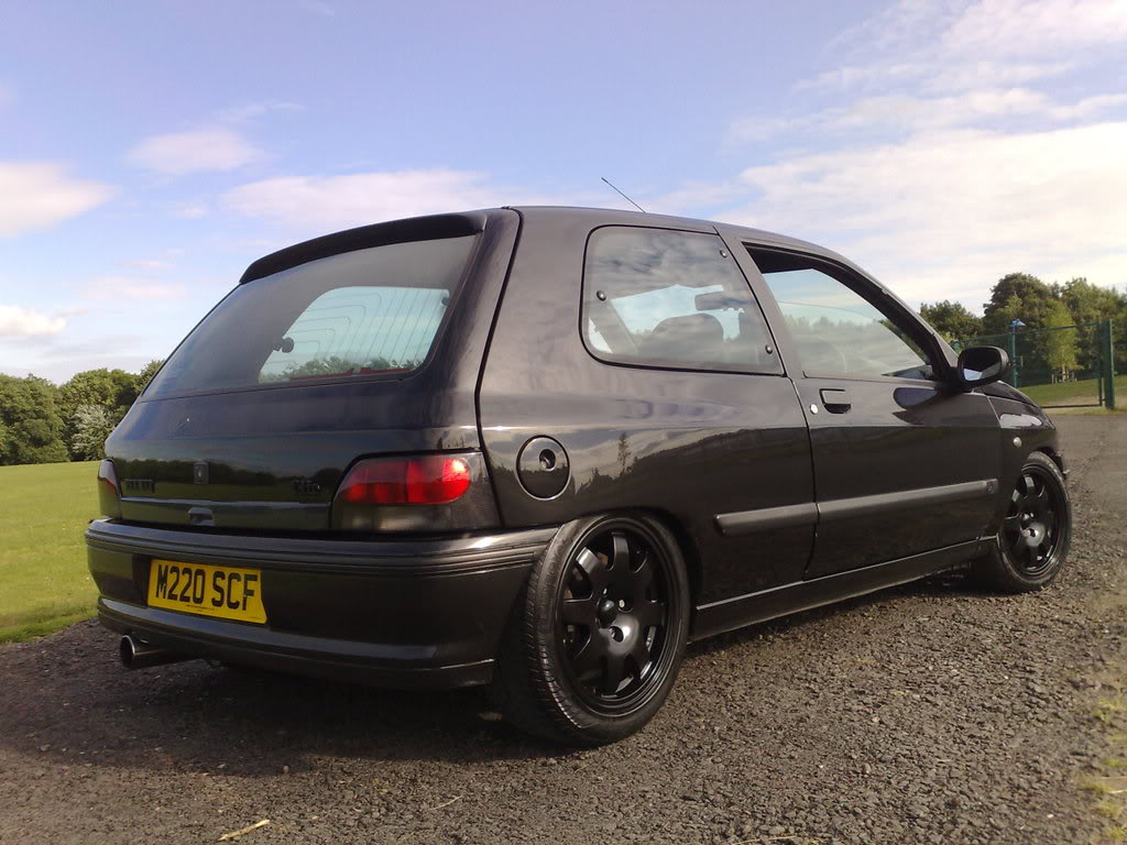

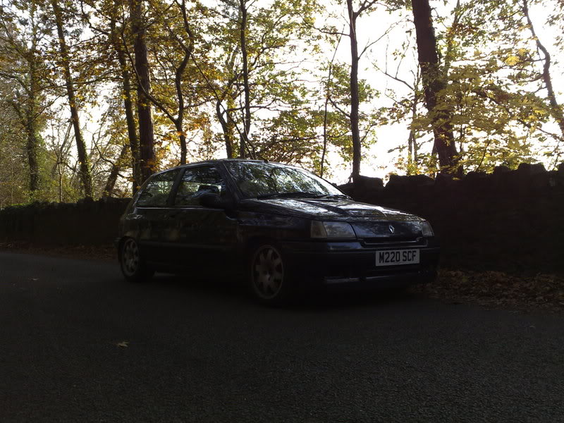

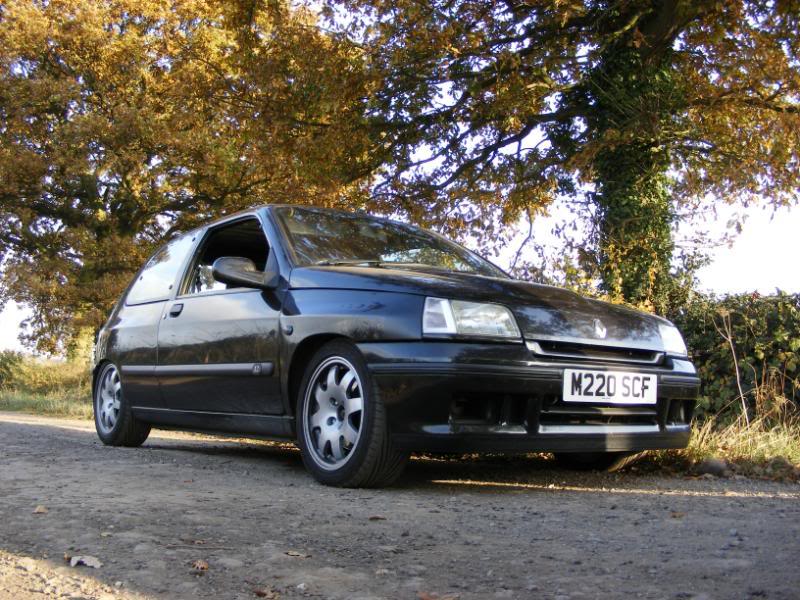

Pics of a car around this point

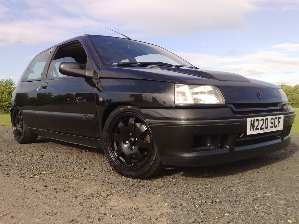

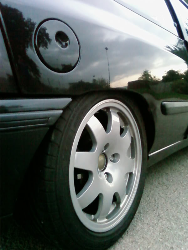

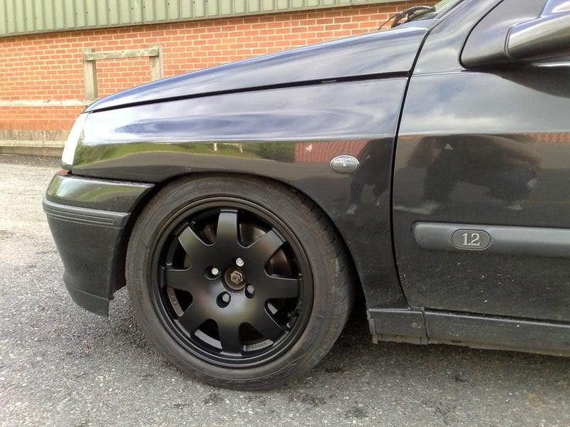

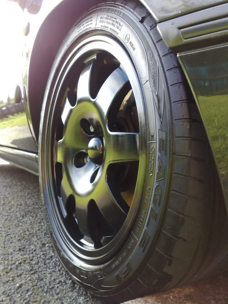

I was getting bored of the silver Williams wheels so bought some center caps for them as they was needed badly and was unsure what colour to do them but decided on satin black painted one side and it looked good.
but in the end I thought id put a layer of laquer on to give it a cleaner look and think I made the right decision in the end.
At this point I also painted the front diamond and rear badges satin black and removed the rear wiper covering the hole with a ghetto fix of black tape lol.
Before…
Satin…
With laquer

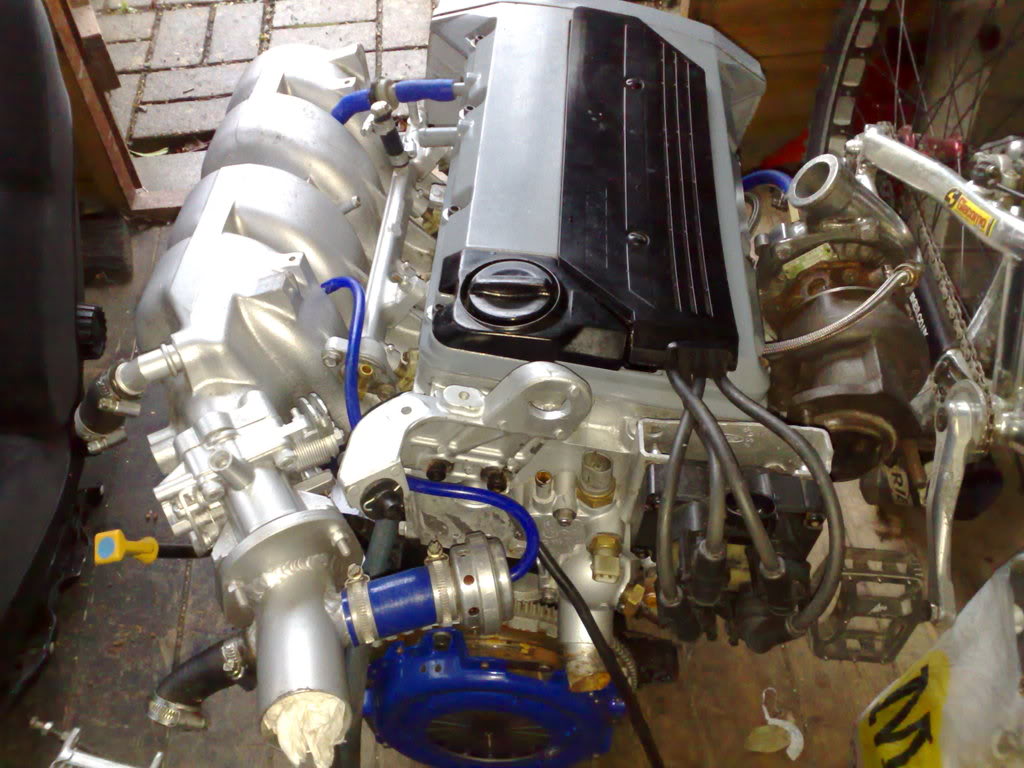

since ive added some cobra monacos and bought a new engine that should be going in this weekend sometime heres a quick spec list of that..
-Clio 1.8 16valve engine
-Turbo converted
-Block rebored 0.5 over size
-Block modified for oil return
-Block chemically cleaned and painted black
-Wossnor over size low comp turbo forged pistons with jap spec ringd
-Wossnor forged h section rods
-APR race spec rod bolts
-Big and small end bearings
-Autosprint lighten balanced flywheel re faced
-Spec stage 3+carbon clutch
-Refurbed oil pump
-Oil seals and gaskets
-1.9mm turbo spec head gasket
-Autosprint full race spec head re faced 3degree seats shortened valve guilds new stem seals. re shaped combustion chamber extensive metal removed from head all smoothed.
-highly polished inlet manifold enlarged 2 suit smoothed and polished
-in and out ports enlarged as much as possible Williams valve new seats/guides/re faced
-Autosprint 265degree camshafts
-Enlarged and re shaped throttle body flowed and polished knife edged butterfly’s
-Bb turbo manifold polished internally modified 2 fit t3 turbo
-Cosworth t3 hybrid turbo
-1 off turbo back down pipe
-Bb turbo oil feed
-502cc dark grey injectors
-Mocal 13 row oil cooler
-Pipercross foam cone filter
-8mm silicone ford ht leads
-In car adj boost 9/22psi-31 actuator
-Hi tensile head bolts
-Go tec mfi pro stand alone management with custom wiring loom and 36/1 trigger wheel
-Group a dump valve
-Heat wrapped down pipe
-Custom oil catch tank
-Custom charge cooler
-Bb throttle body adapter
-Bb braided oil feed
-Uprated fuel pump
-De cat
pic of the engine just sat in my shed
It’s a big spec list and should hopefully see around 300 brake so its gonna be lively

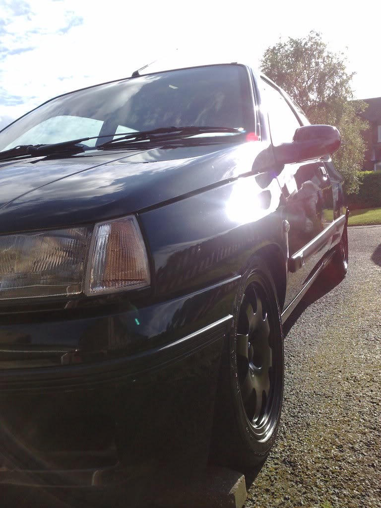

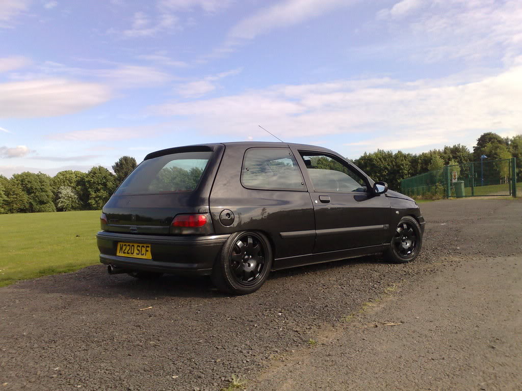

Heres some current pics of the car ill add more at the weekend when the engine goes in and when they upload if photobucket stops being homo.
Along the way ive had a few fix’s replaced a load of little bits and bobs and so far ive loved working on it every time I get under it or remove something I learn something new witch was the point of the car. And in my opinion its looking spot on its just a matter of cash holding me back getting it exactly how I want it but isn’t that always the case lol.
