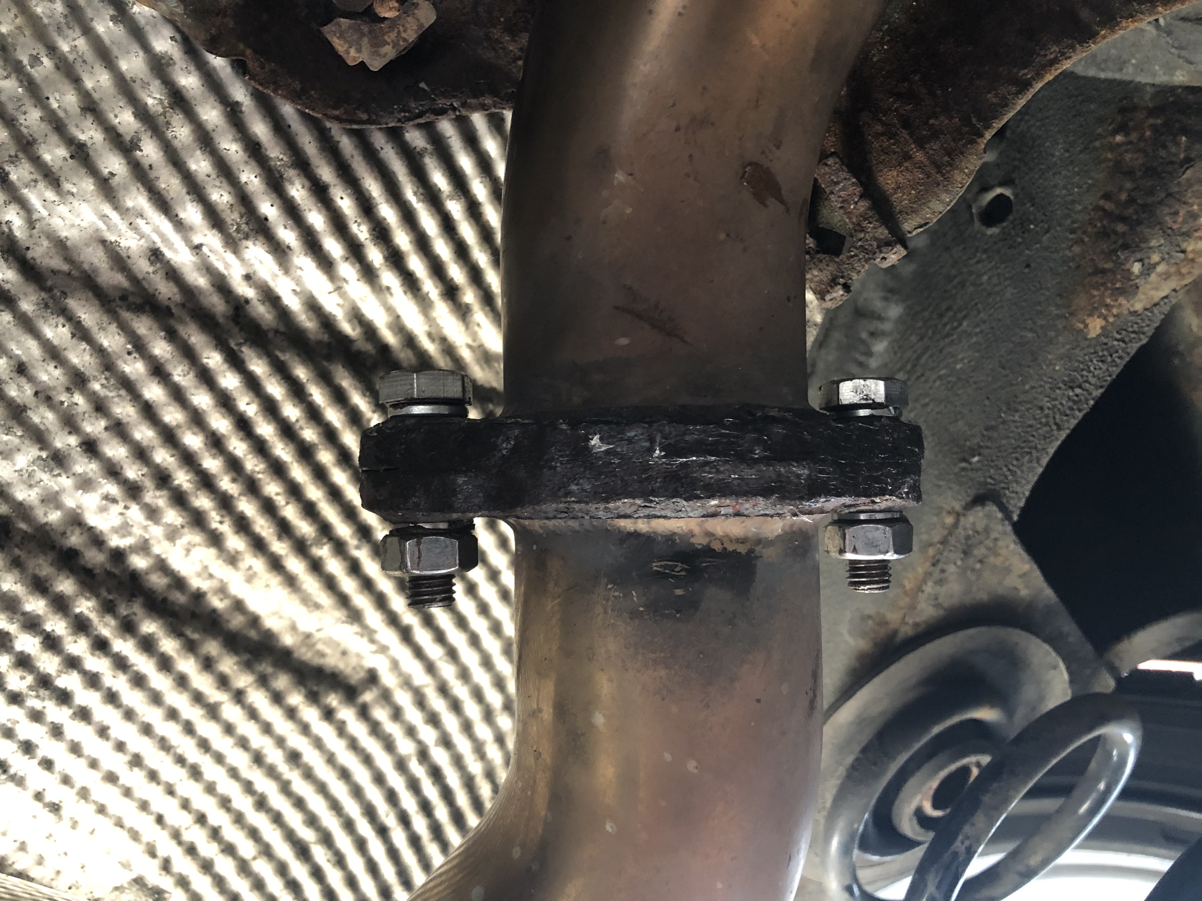

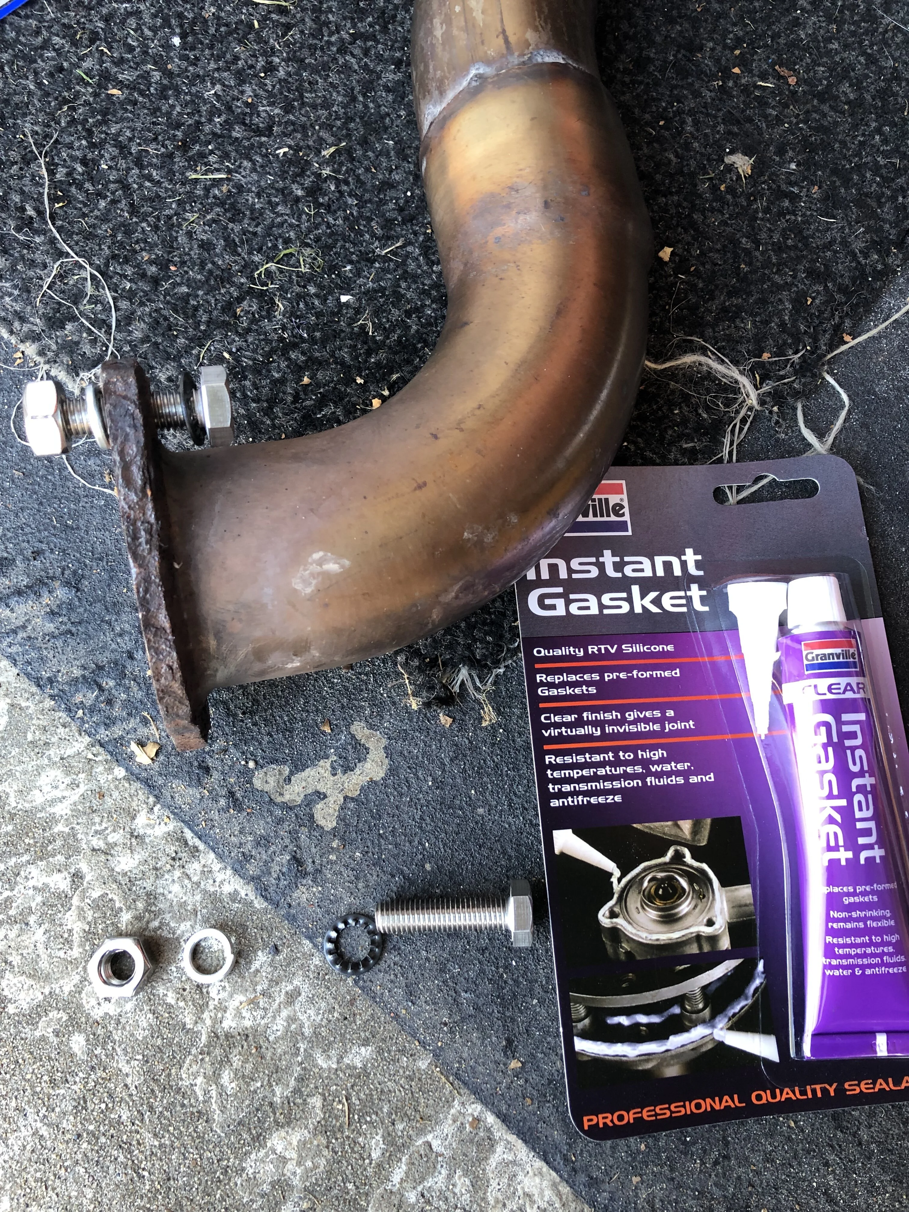

So I am just home from collecting the Yozza fro @-Rob Thank you again but my thought now turn to mounting said exhaust.
After a quick search on here I'm shocked to discover that UHT exhaust silicon is all that is required for gasket material!!
I would have expected there to be a proper gasket of some description not just silicon!! :eek:
So do i stick with the tried and tested UHT? or is it worth looking for someone local to me who can put a V band on it??

Silicone will be fine, works better than exhaust paste. I had a slip joint on our megane milltek blow like f**k, used normal clear silicone and no blowing since. High temp not even necessary any general purpose clear will do. Dont use it pre lambda as it can knacker it.
t90_lle
East of England
Cheers @Brigsy I'm very surprised by the use of silicon though I must admit!! But i guess V banding would be better??

Vband is better if they are the type that have the locating groove. The vband that have no locating groove are ok but not amazing. Also make sure they do not warp when welded on or they can blow.
frayz
Wouldn’t bother with a V band unless you’re 100% set on having that exhaust and you’re happy with it. VHT silicone is more than adequate and all the BTM exhausts are like it. Mine wore a BTM for years with just VHT silicone between the flanges.
If you fit it and you love it, get a V band added at a later date if you really feel the need.

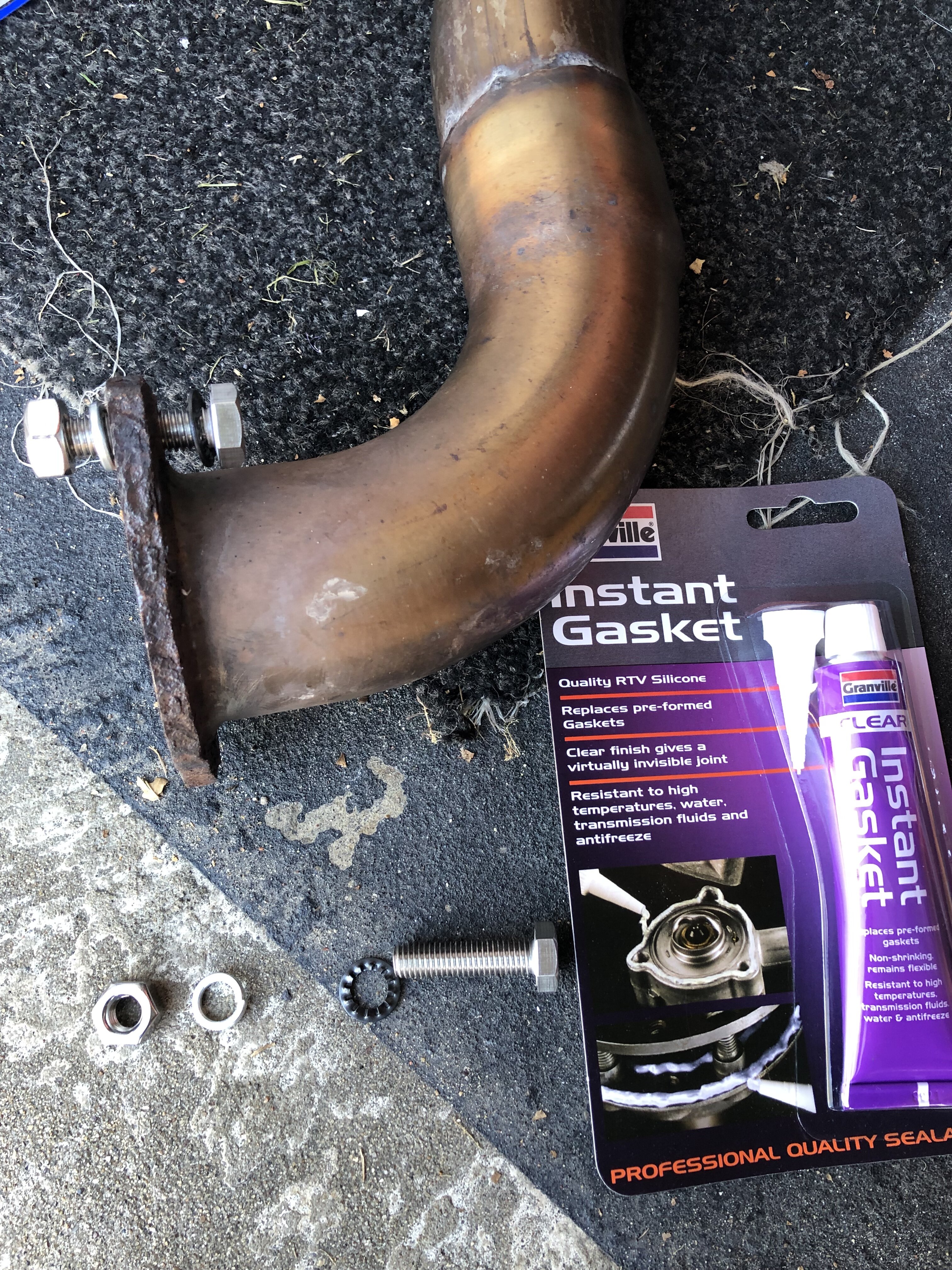

So this is what I’ve gone for… The silicone is good for -40 to +250.
Nut and bolt combo is m10 x 40mm with 2 type of locking washer, other suggestions welcomed 👍🏻

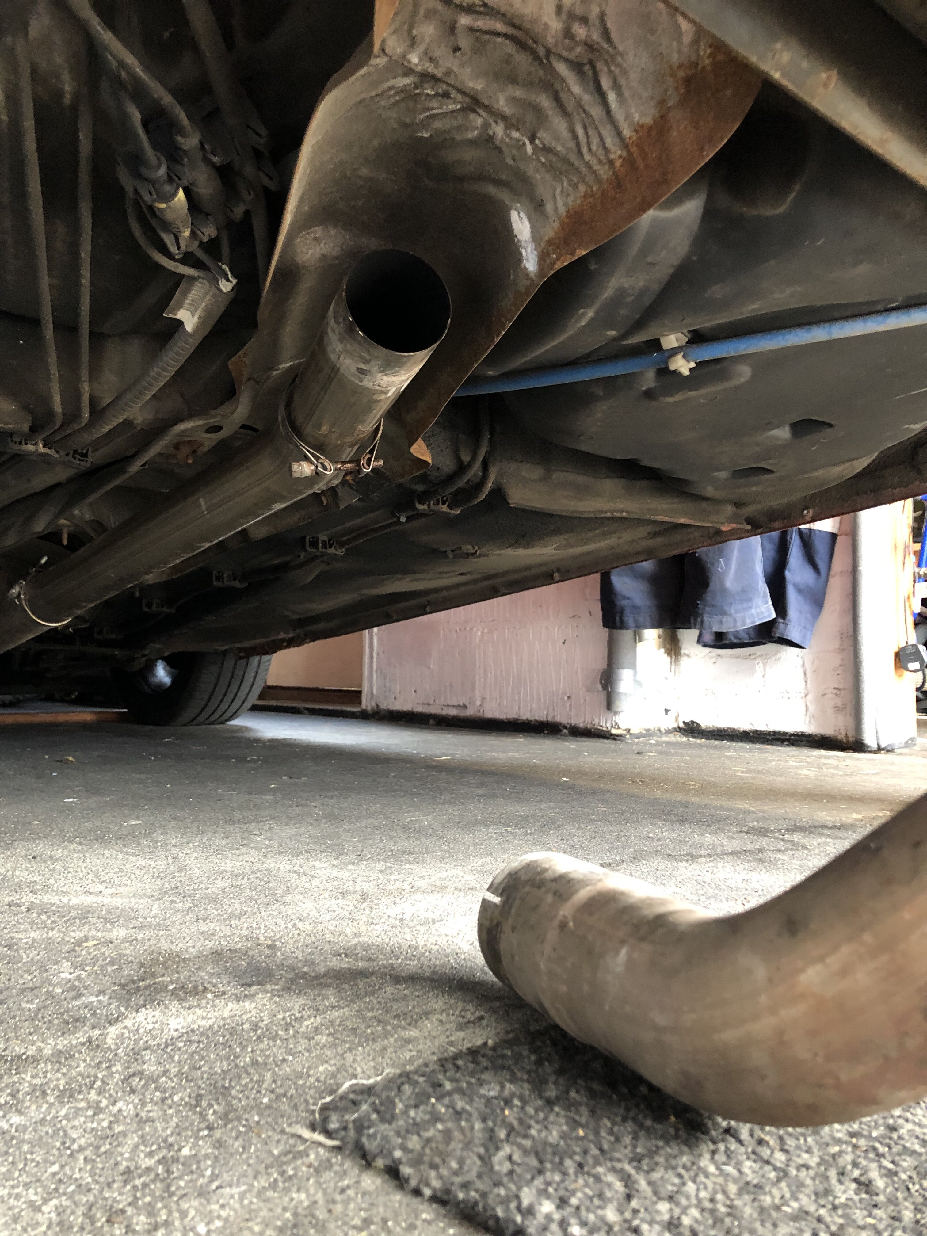

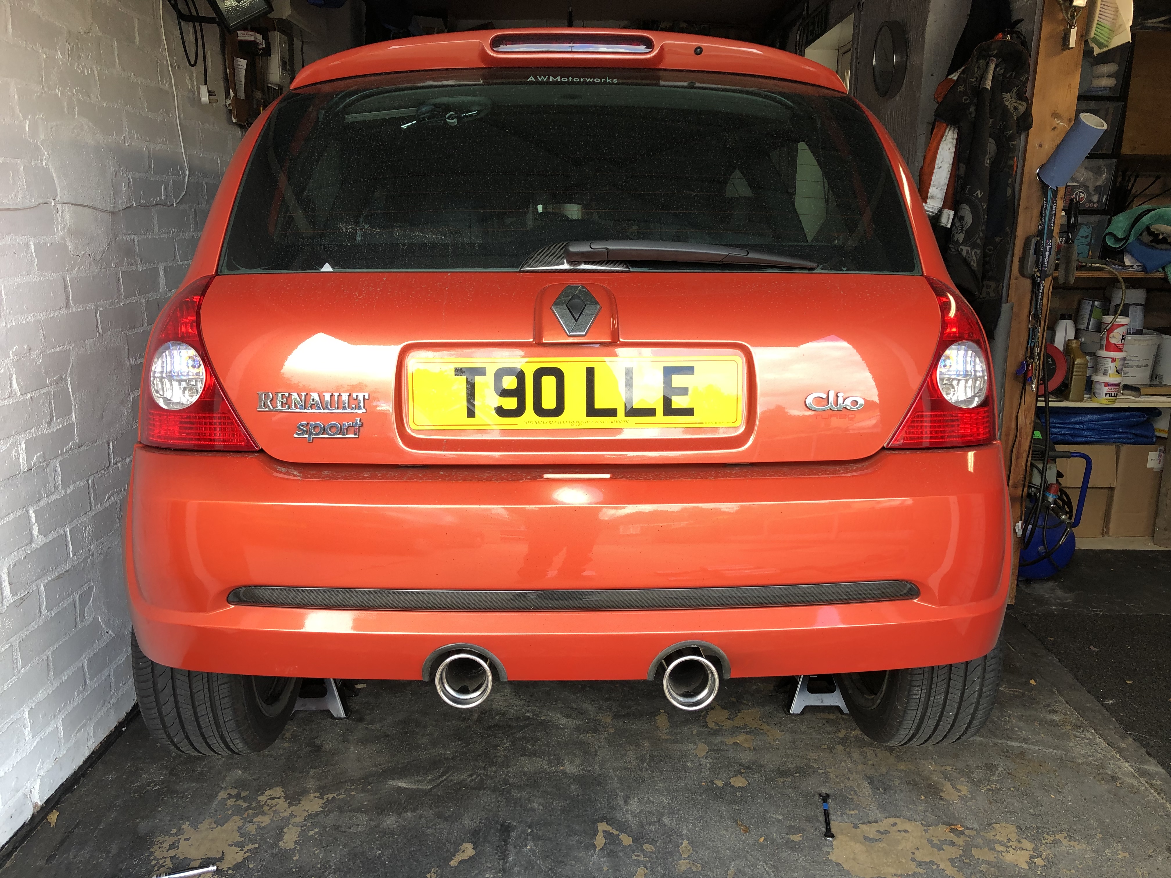

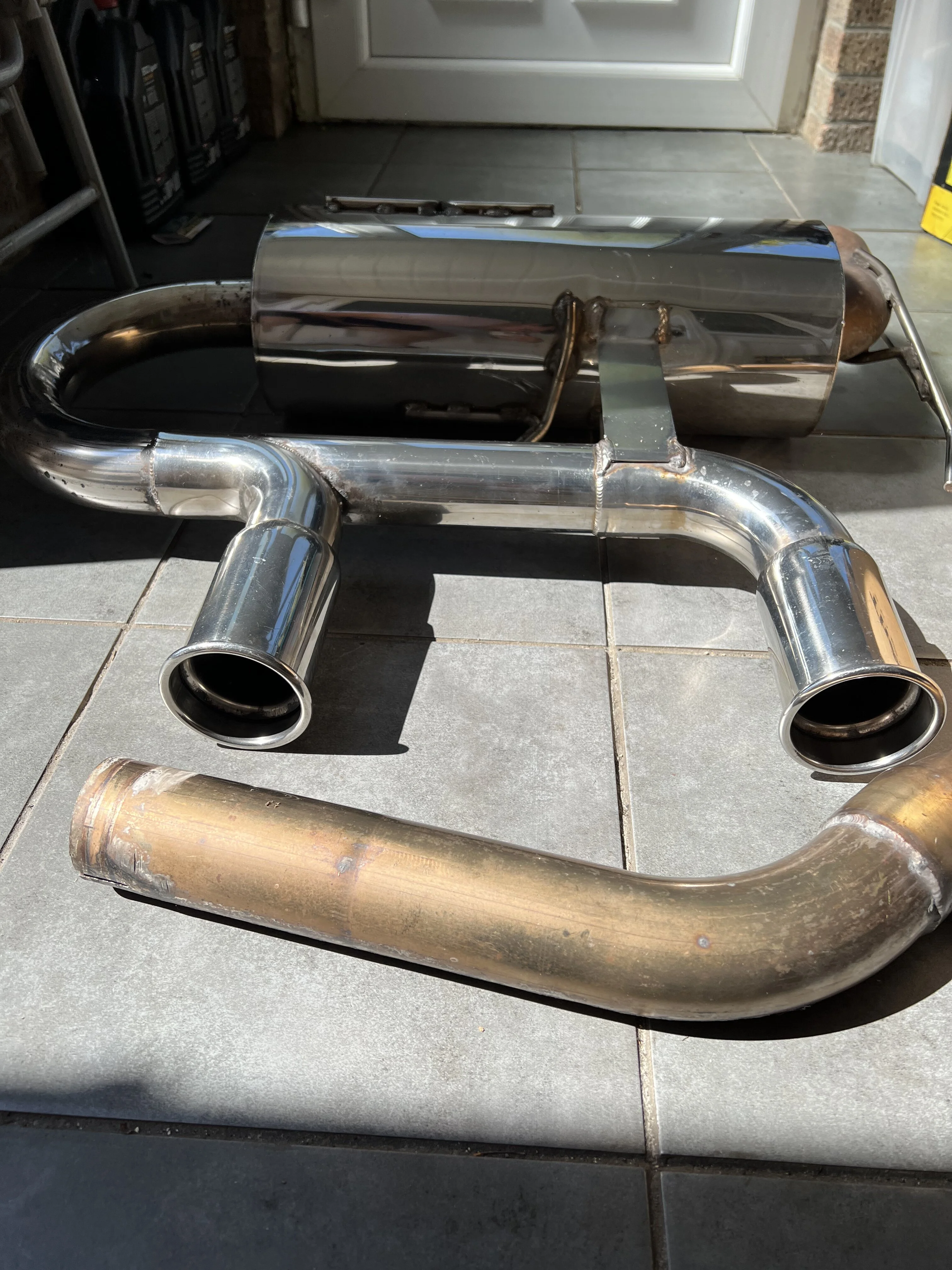

So I’m going to start this post how I should have ended it… The Yozza is fitted!!
But the link pipe is not!
I went to the car full of joy this morning so pleased to be fitting such a piece to the inferno but my joy soon turned to despair.

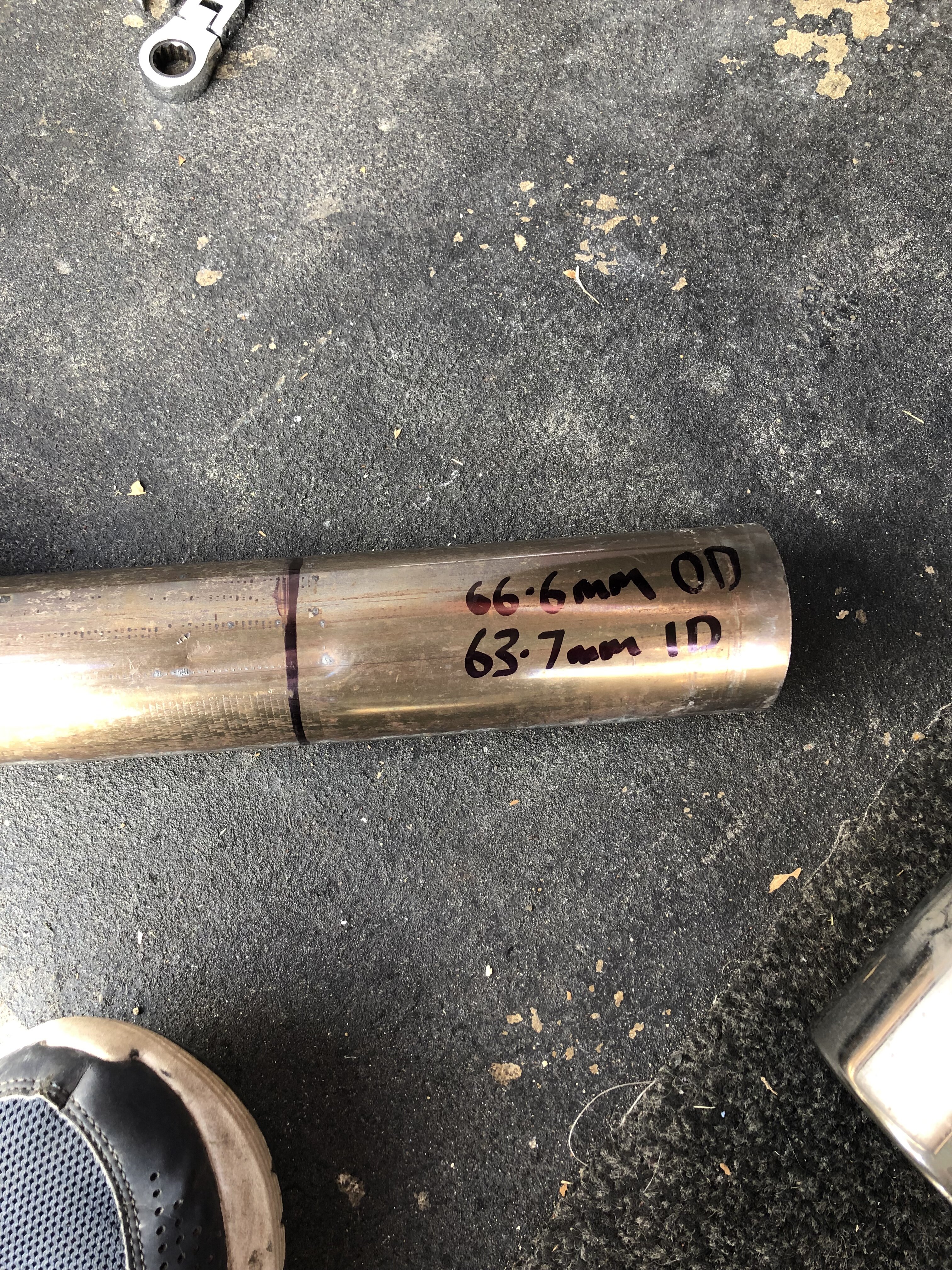

I had the Milltek off the car within 6mins, the Yozza hung and sat perfectly within 15min but when I grabbed the link pipe I soon realised it wasn’t all going to fit!
The Milltek is sleeved on the back box section as seen in the picture below where as the picture above shows the link pipe, a standard size pipe with no flaired section. Frantic calls made to mates to see if anybody had a expander tool to which no one did prompted a £30 purchase from the local Wilco which won’t be here until Tuesday lunchtime. Hopefully I’ll be able to stretch the link pipe enough to slip over the centre section

I'm struggling to see why you can't slide those two together on the bottom picture? They'll be tight but they'll fit together.
t90_lle
East of England

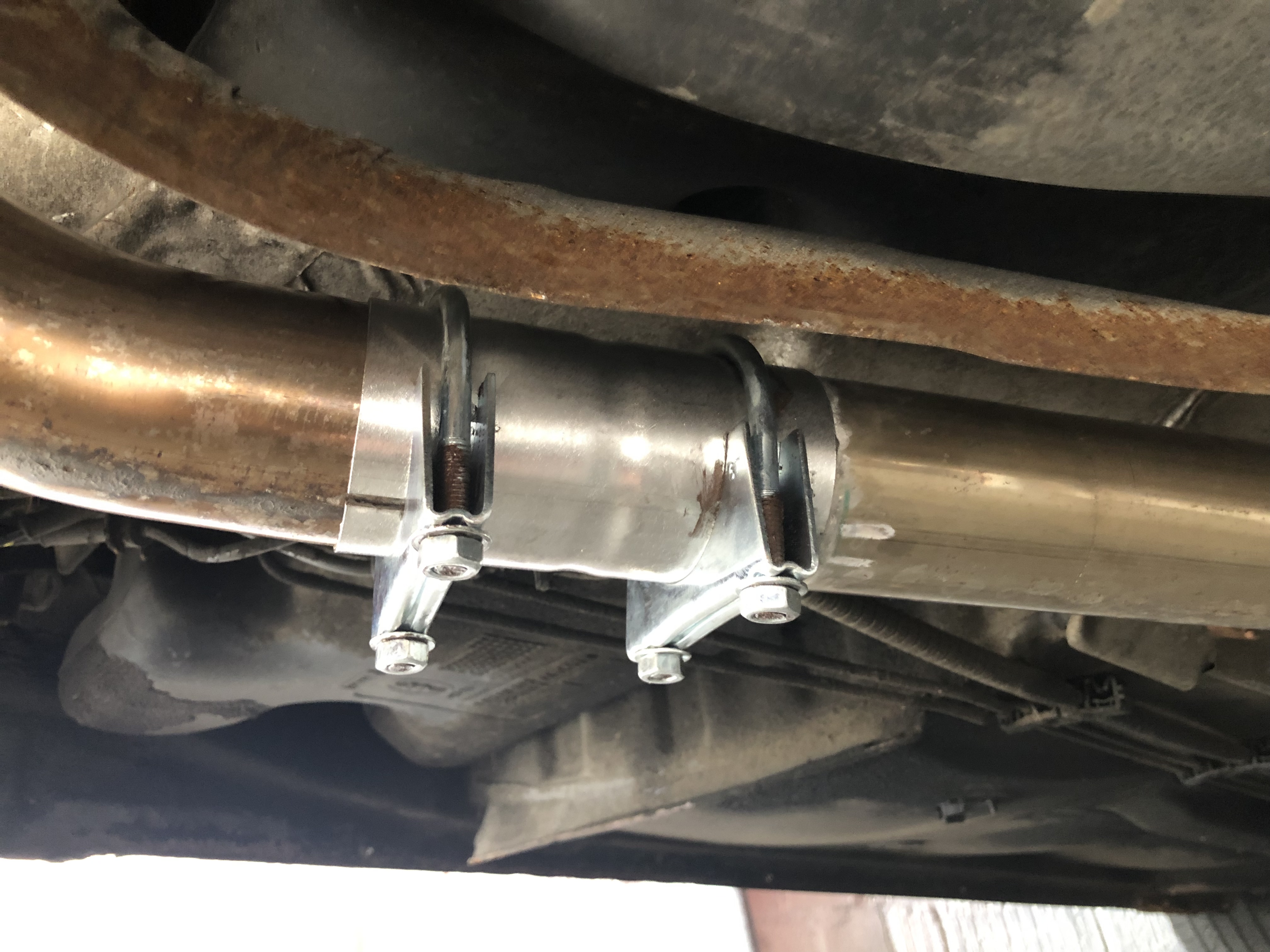

After watching numerous videos of exhaust expander tools I’ve decided to cancel the purchase and instead go for a sleeved option. Not only is this cheaper but will save a fair bit of hassle and grief when I can’t flair the link pipe due to wall thinkness, strength of the steal and cheapness of the tool!
I will however have to trim the link pipe back a bit to allow for the sleeved joiner section but this shouldn’t be an issue as long as I follow the golden rule of measure twice & cut once.

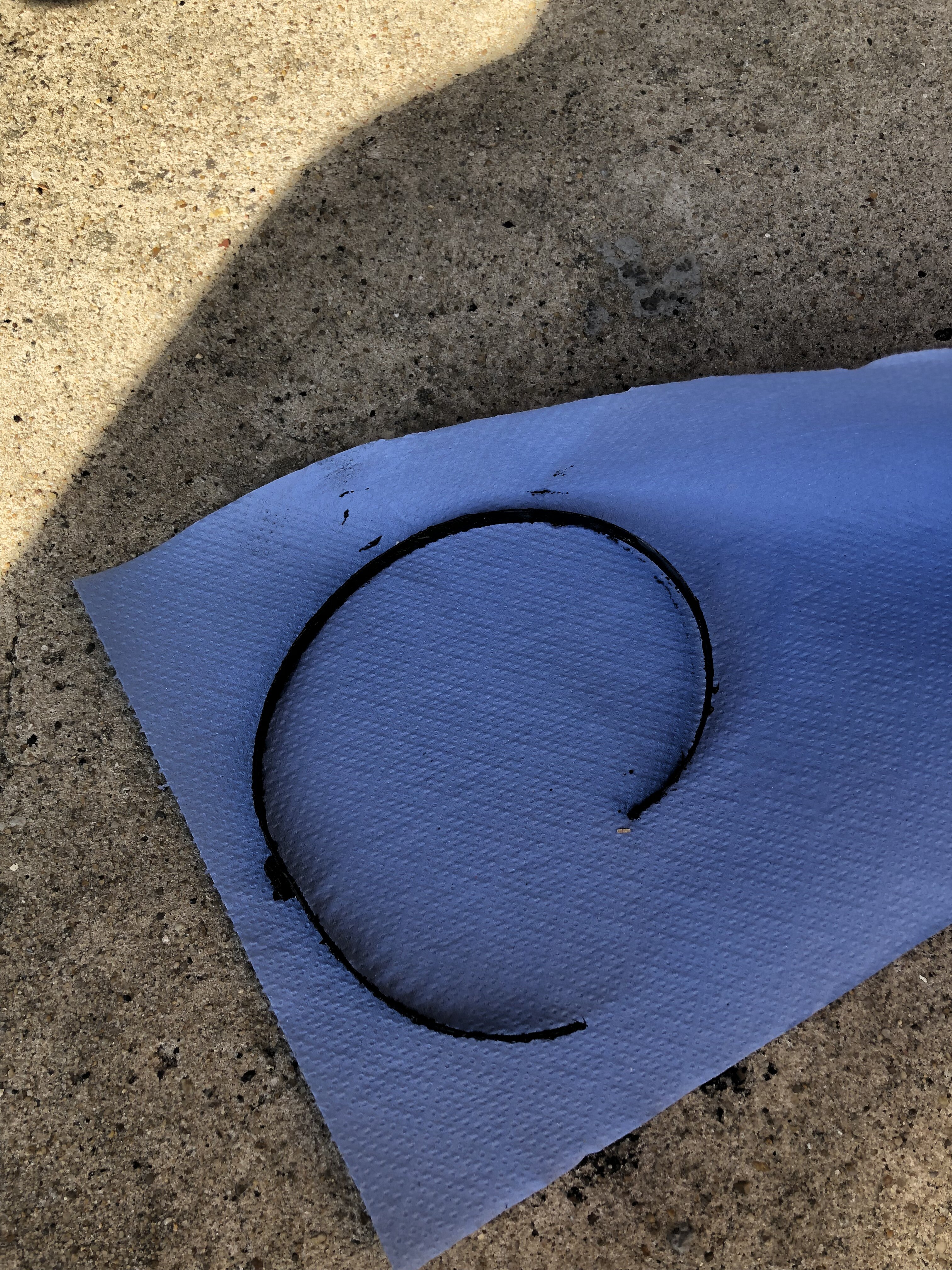

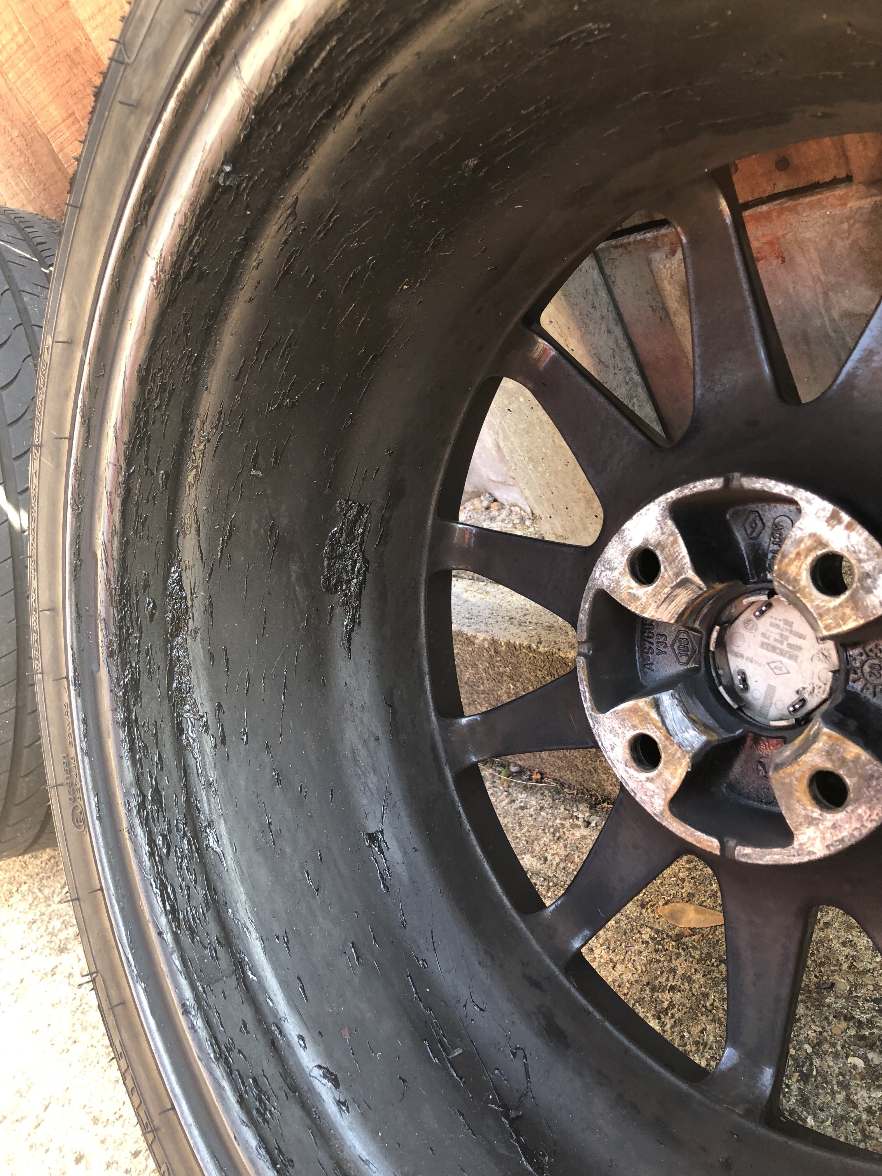

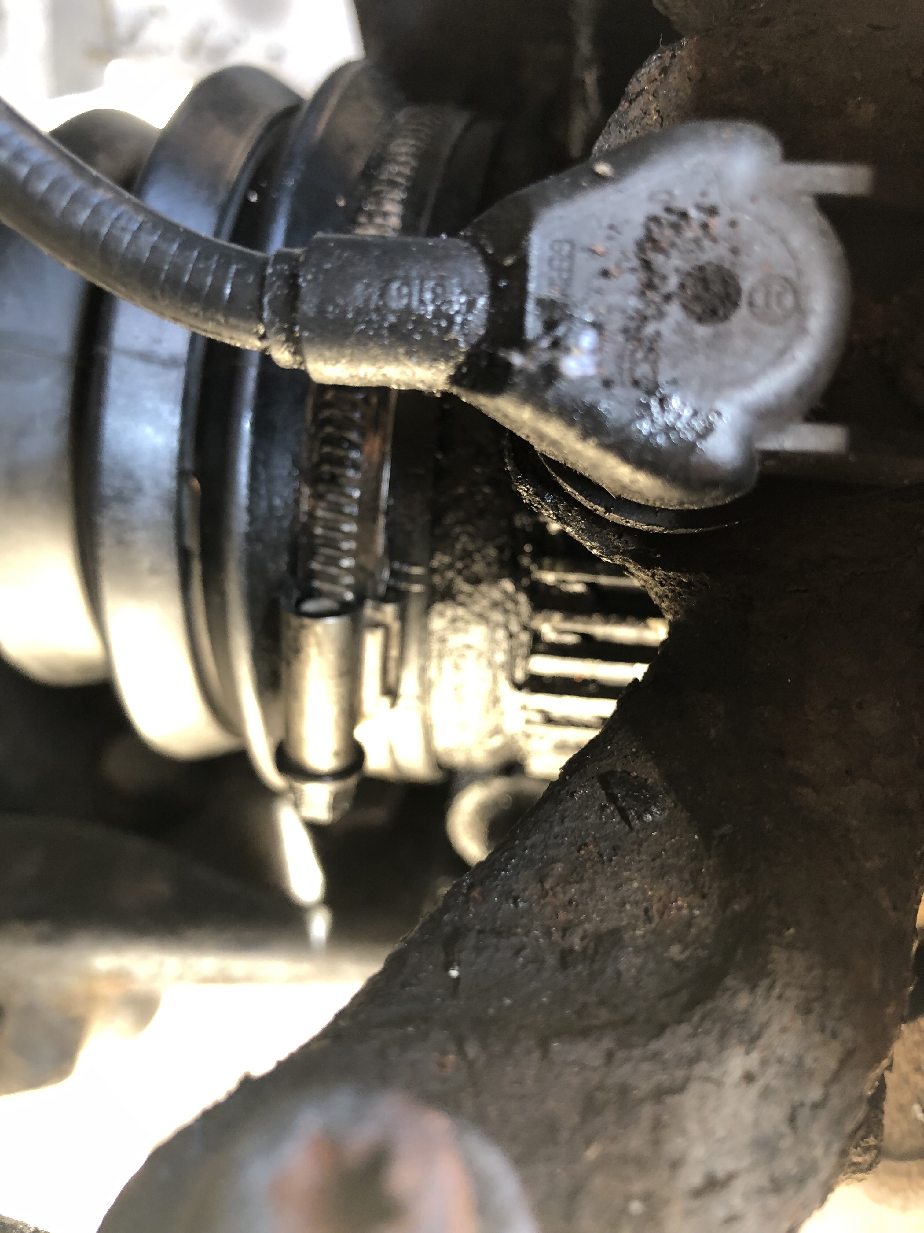

A bit more time spent on the Clio this afternoon, It was supposed to be a wheel clean after the cv boot repair and a quick rinse over. It in fact became a wheel clean, another cv boot repair, filing and sanding the wheels & spacers and nipping up the lower Evol mount leaving no time for washing.
I ended up going with the classic jubilee clip to repair the cv boot as clearly the oem clips are crap.
The wheel sanding is a result of damage caused by them not being done up properly allowing the spacer to “slap” around on the bolts. I just wanted to smooth out the mounting face to see if it would clear a little wobble I have, This was infact the case and has sorted the issue. The company which did it was disappointed that their staff had done it and offered free service and check over of the car.

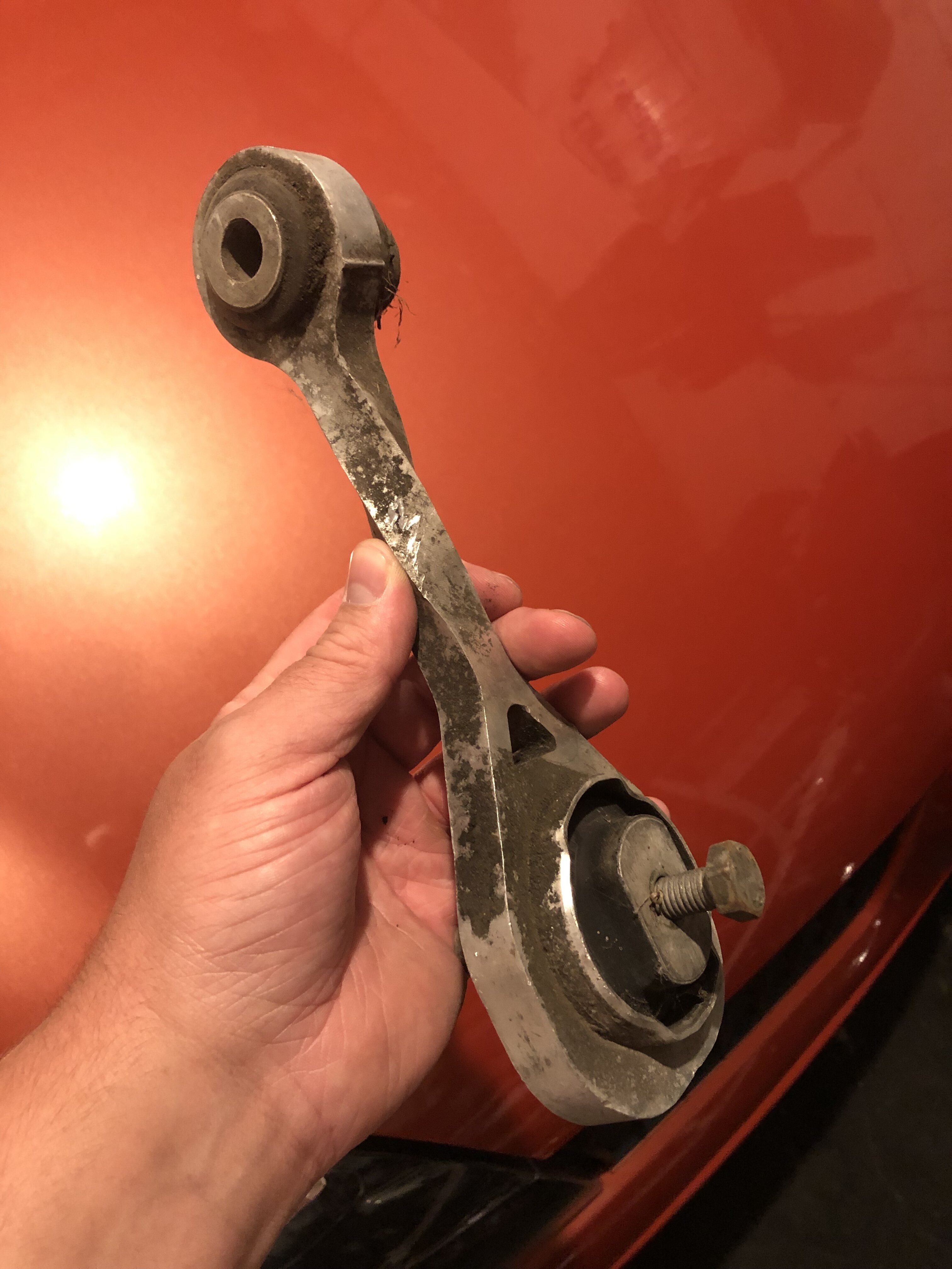

The gearbox bolt issue is a reoccurring fault I seem to be having and I think it is due to worn/damaged Evol mount. The bolt seems to work loose over time which shows through the shifter lurching about inside the car when coming off throttle.
To try rectify this I have purchased a new to me oem twisted mount form @plees .
It just needs a wipe over and then I plan on putting purple Powerflex bushes in, I’m hoping this will take some of the harshness away allowing a bit more flex than the Evol.
Possibly put some loctite on the bolt too! 😂

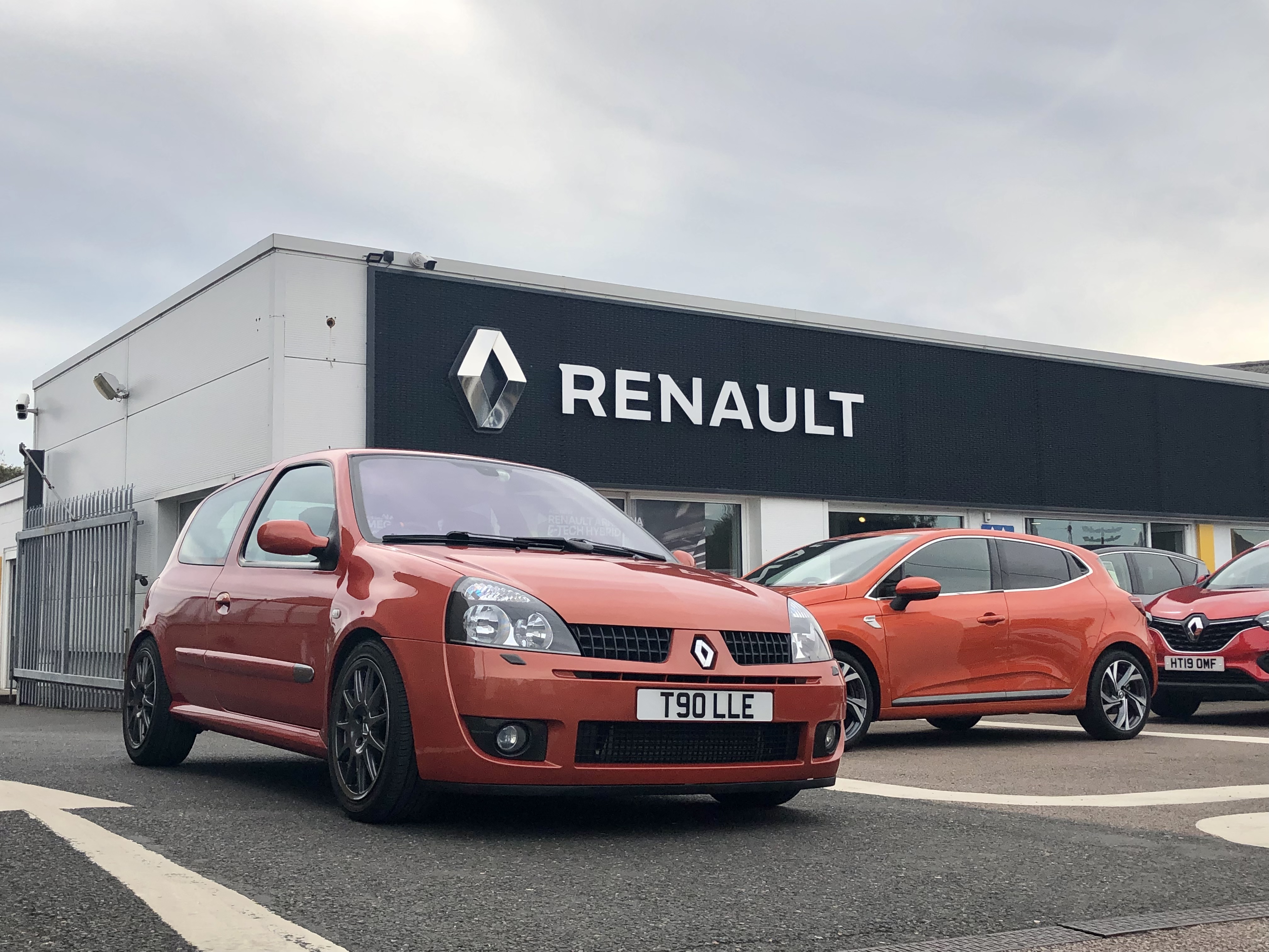

Today was MOT day… It passed but with a couple of minor issues but clearly it was a day for orange cars at my local dealer.
Firstly it appeared that I have some play in my N/S drive shaft,
Secondly I have very very slight play on the in O/S inner rack ball joint,
Thirdly my high level brake light appears to have stopped working and lastly both my washer pumps have given up.
As soon as I got home the car was up on a jack and the N/S wheel was off. I backed off the nut a touch and torqued it back up to 280nm and refitted the wheel. This instantly removed the play the tech had shown me in the garage.
There’s not much I can do about the inner rack ball joint myself so this will get booked in to be sorted soon.
The high level brake light is a known common issues so I’m on the hunt for a non sport light to strip down for the internals to replace mine with.
The washer pump again known issue, Reanult wanted £55 each for these but I have sourced 2x Febi Bilstein ones from AUTODOC for £22 so I’ll see how I get on with these when they arrive.

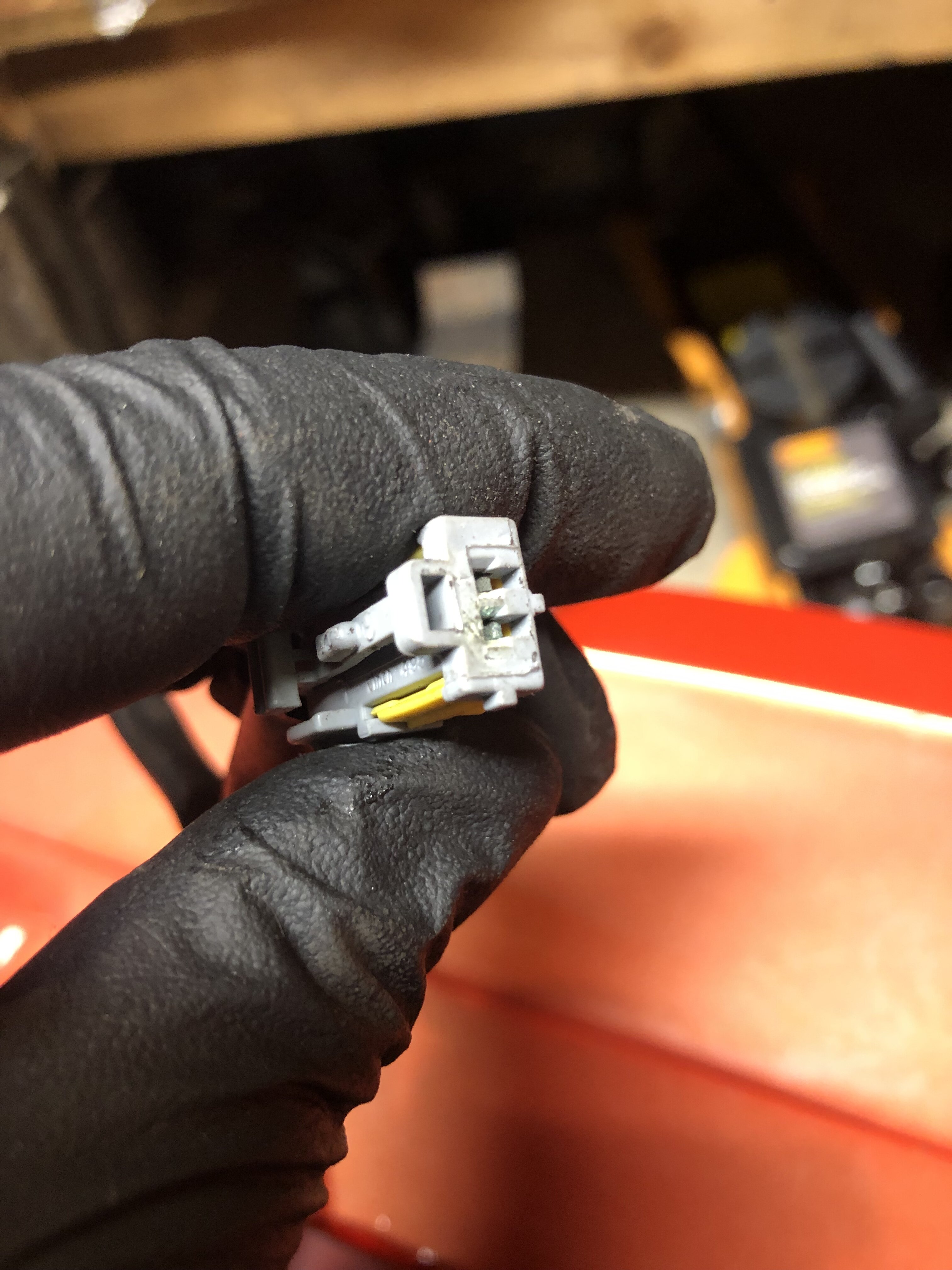

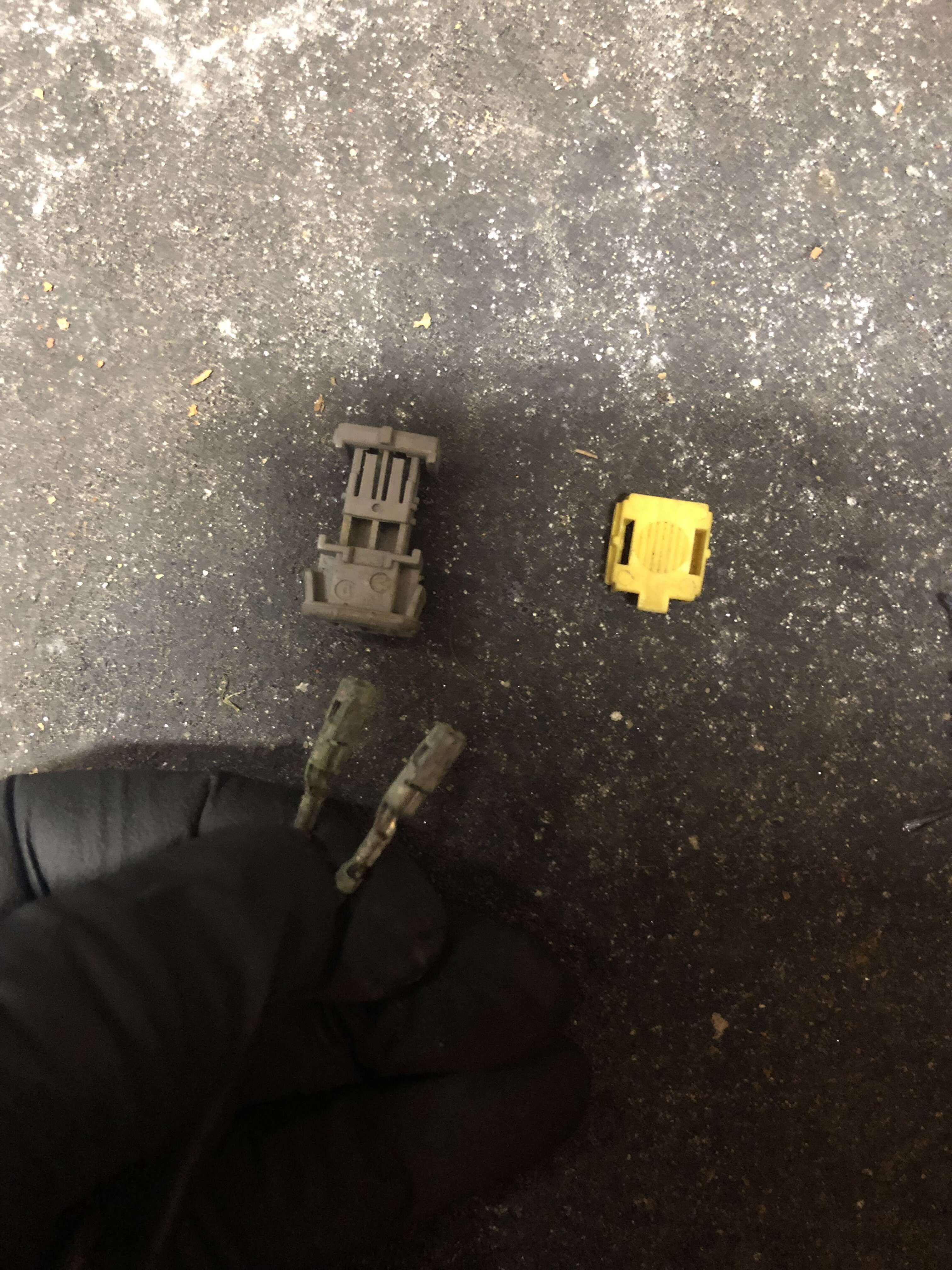

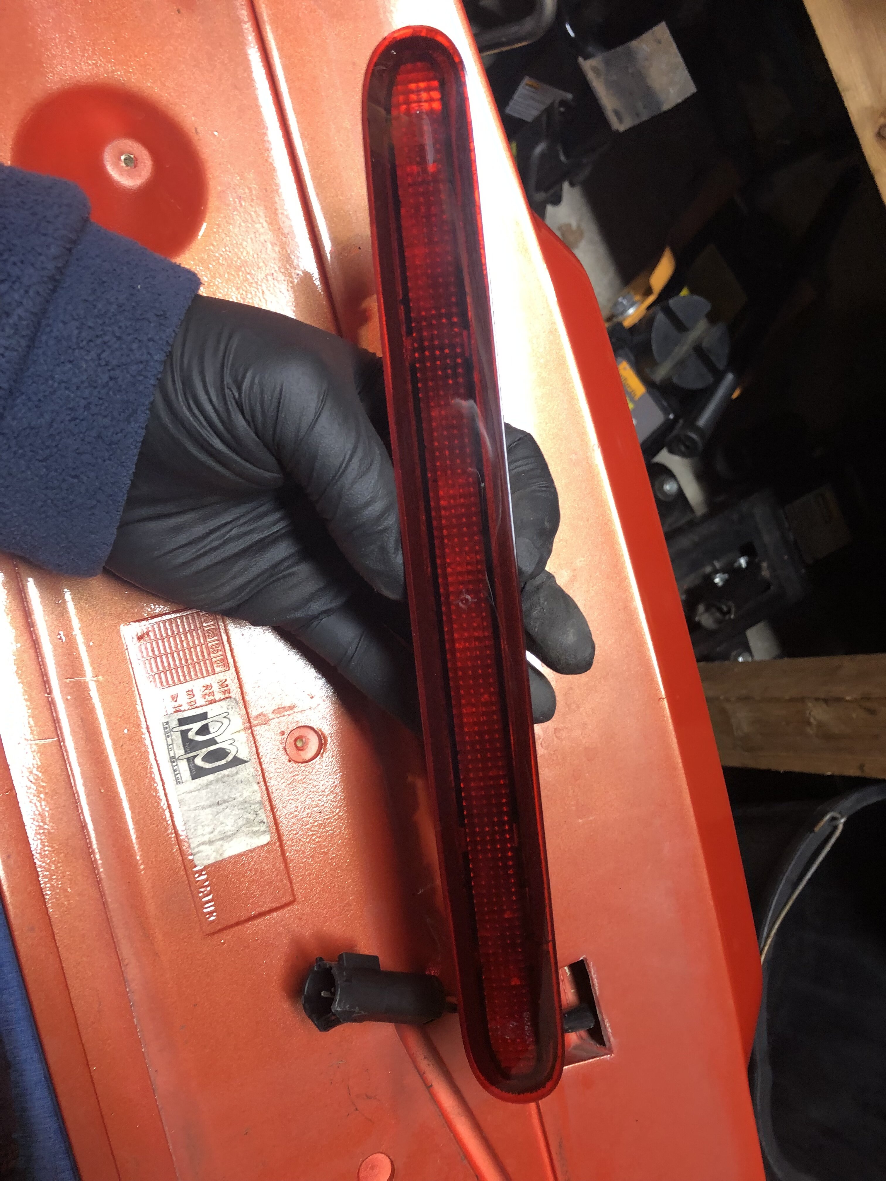

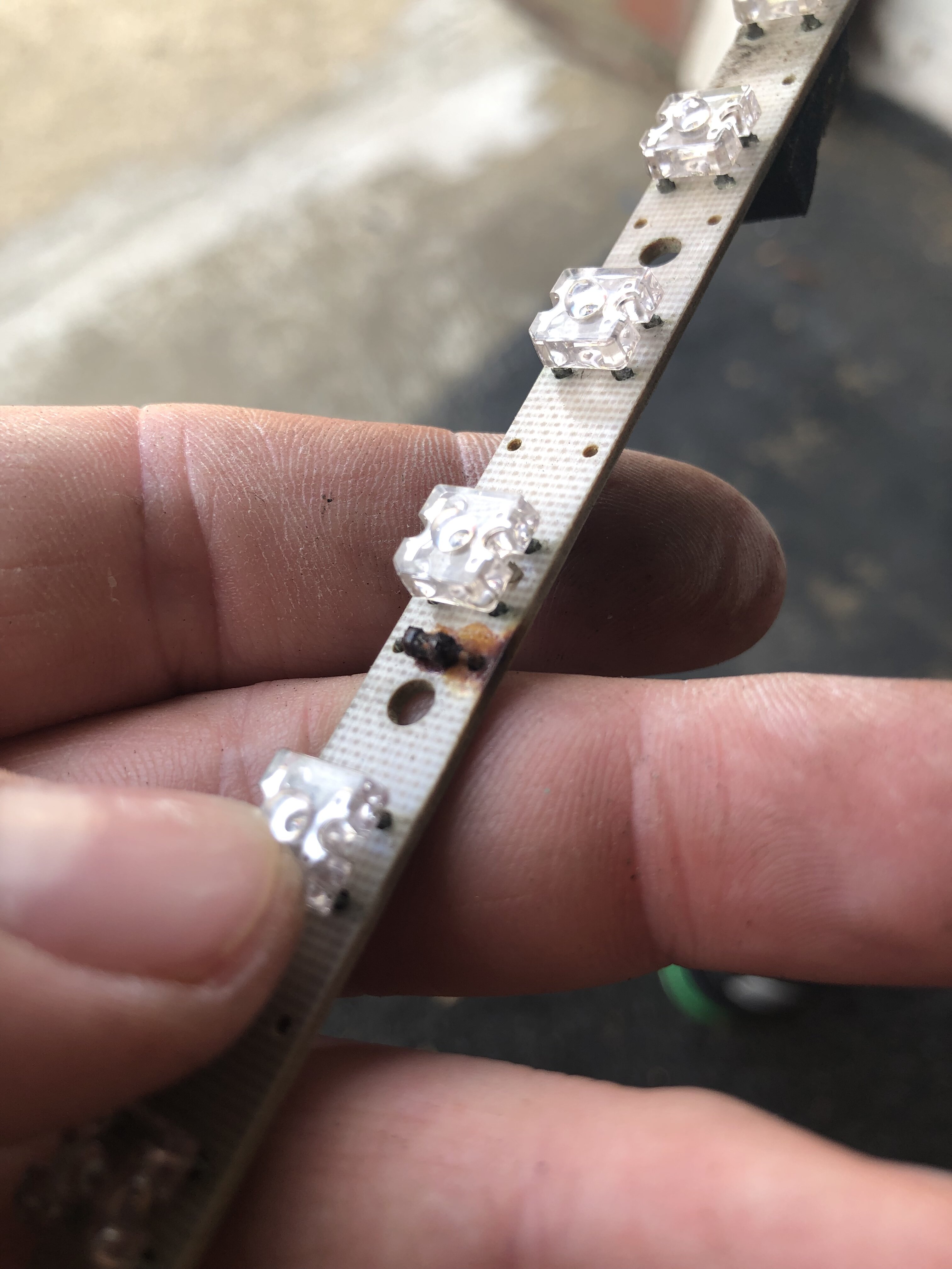

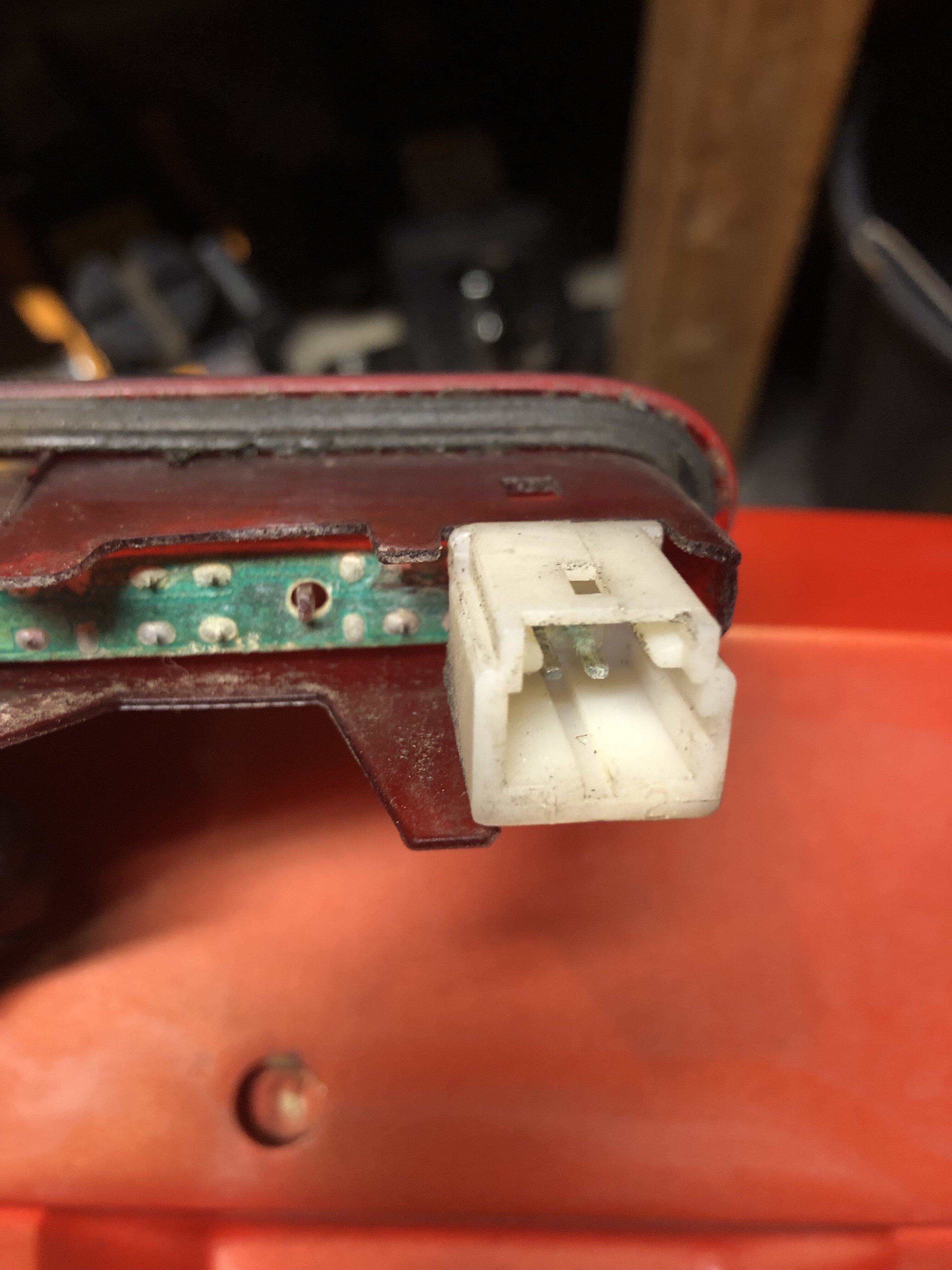

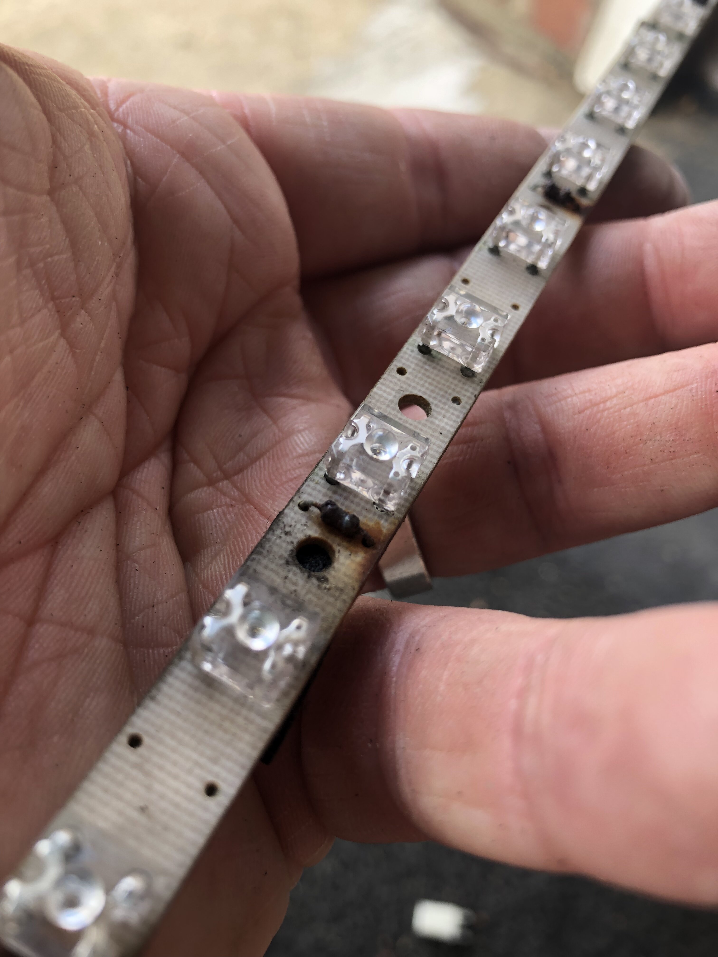

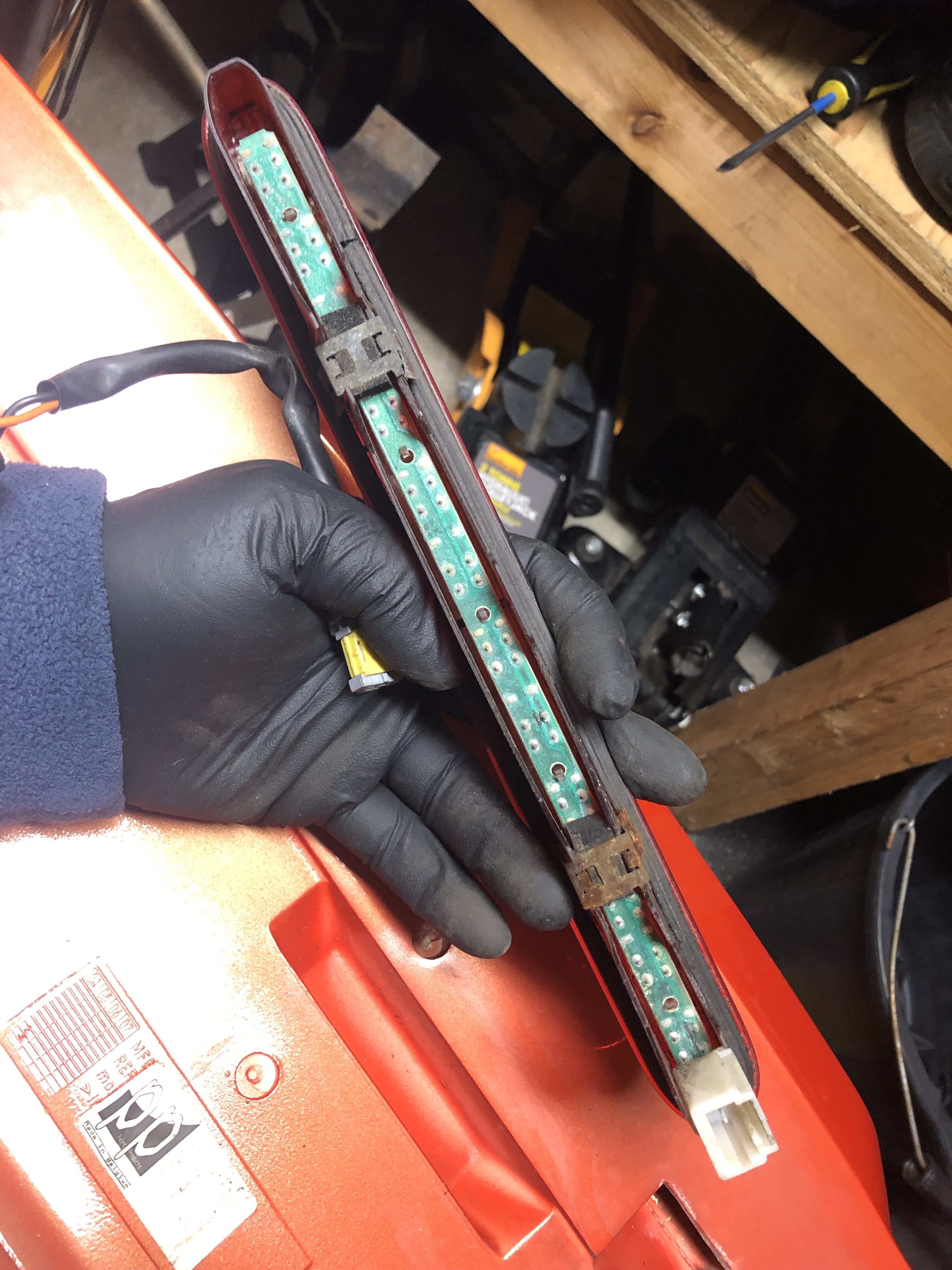

So I’ve been out and stripped the spoiler brake down but with no joy unfortunately… But I did get it out without breaking in so 👍🏻
As you can see from the pictures it isn’t in the best condition on the backside of it. I de-pinned the connector and give them a clean up and a spray with electrical contact cleaner but when testing it continued to not work.
I think I’m going to have to go back to my original idea and strip a non sport spoiler and do an internal swap over.
Louis
I Love Ed Sheeran
View attachment 1610889View attachment 1610890View attachment 1610891View attachment 1610892View attachment 1610893
I can still see green corrosion on all the board component solder joints?

So been out to the 3rd brake light again this morning and stripped it down fully, cleaned and sprayed everything in sight and still nothing. I suspect the corrosion has gotten inside one of the resistors and done some damage. Threw it back together and will be sourcing a non sport light to change internals over and hope that works.
bowen86
When I had the rear spoiler light issue on my silver Clio, I whipped out the worst looking resistor and it worked again?! Honestly. No idea how or why.
