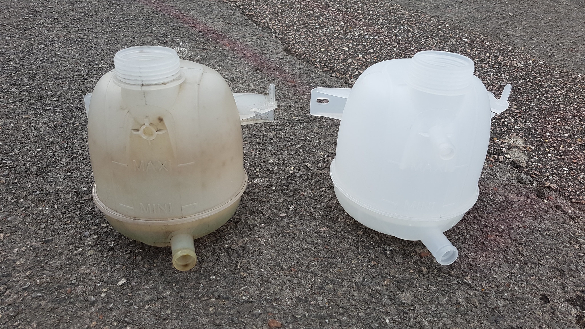

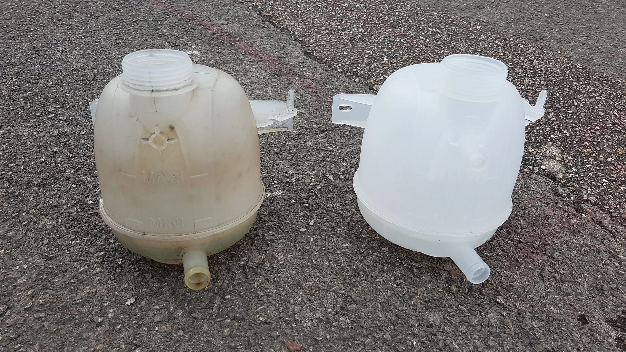

Just checked, bought 4 years ago and a recent-ish pic shows that it's still looking good and not discoloured. I think you'd be wasting your time trying to clean up the original and youll never get it look as clean as new.
RustyMojo
Bon Jovi Officianado
I have had one of those ECP ones sat waiting for me to sort for a couple of years, they look exactly the same as the Oe ones to be fair…reminds me I need to sort a coolant flush out!

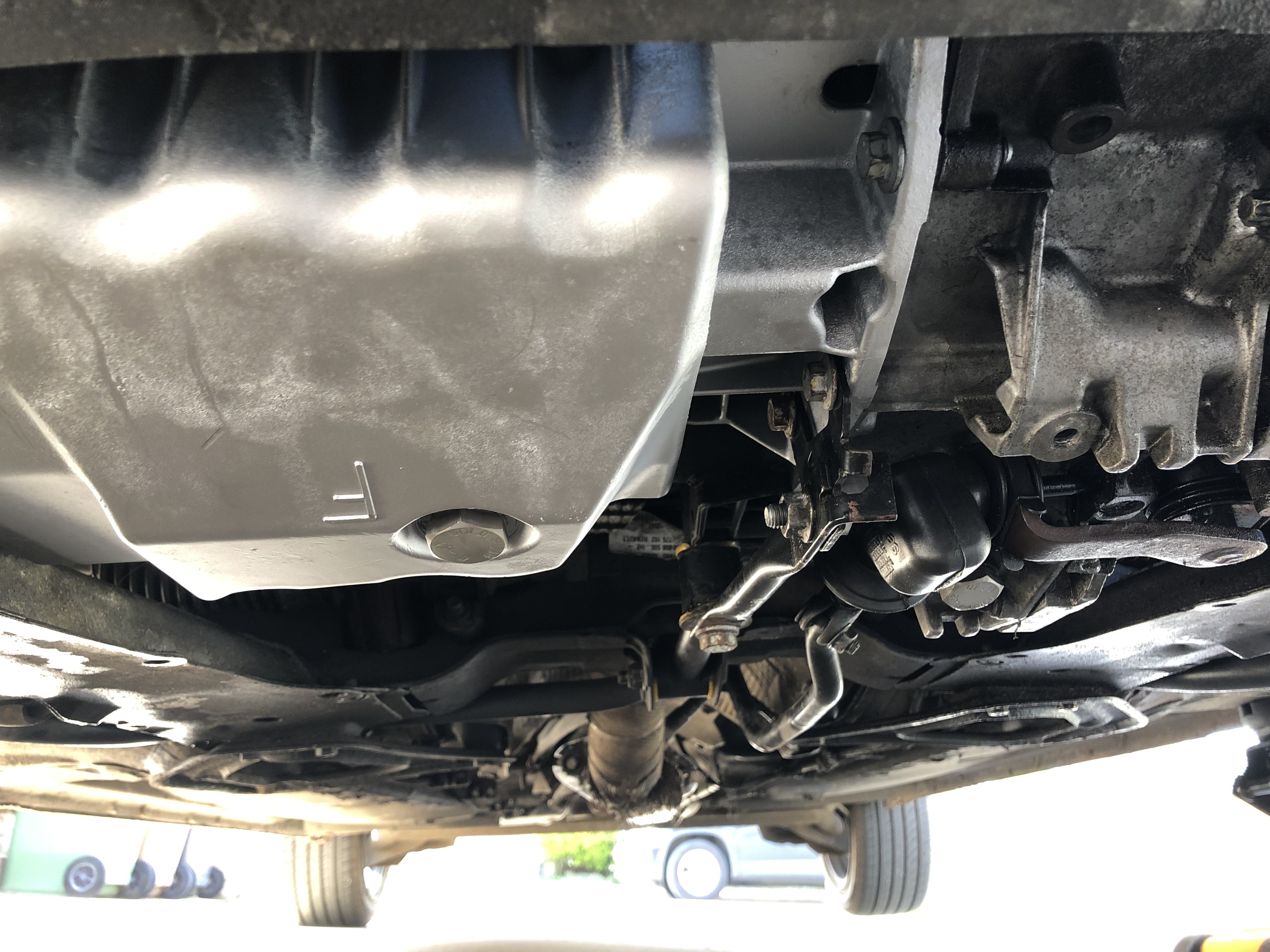

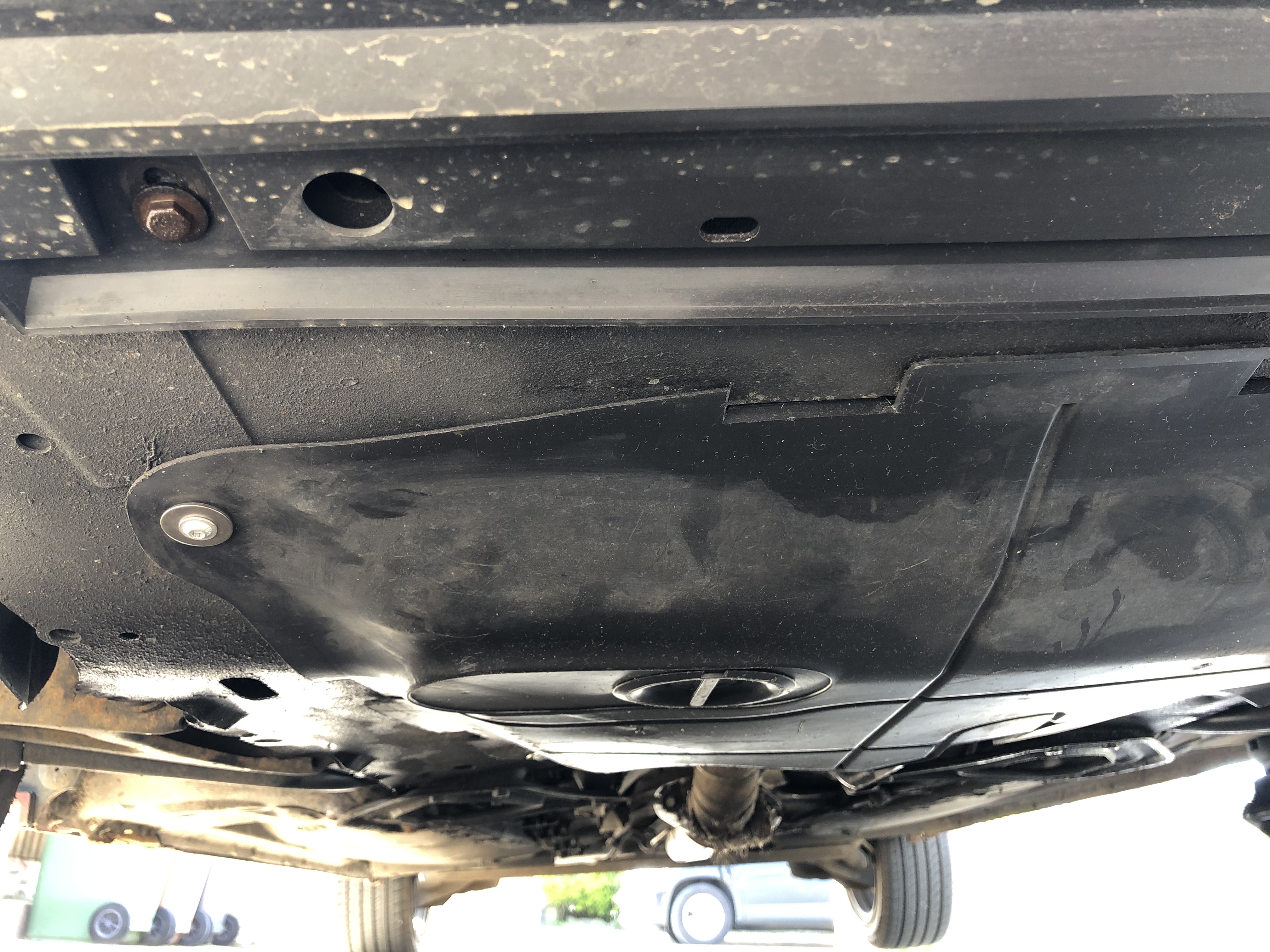

As soon as I got home I was underneath the car fitting the parts that I’d aquired lately.
Firstly can we take a moment to appreciate how clean the underside is featuring the magnetic sump plug.

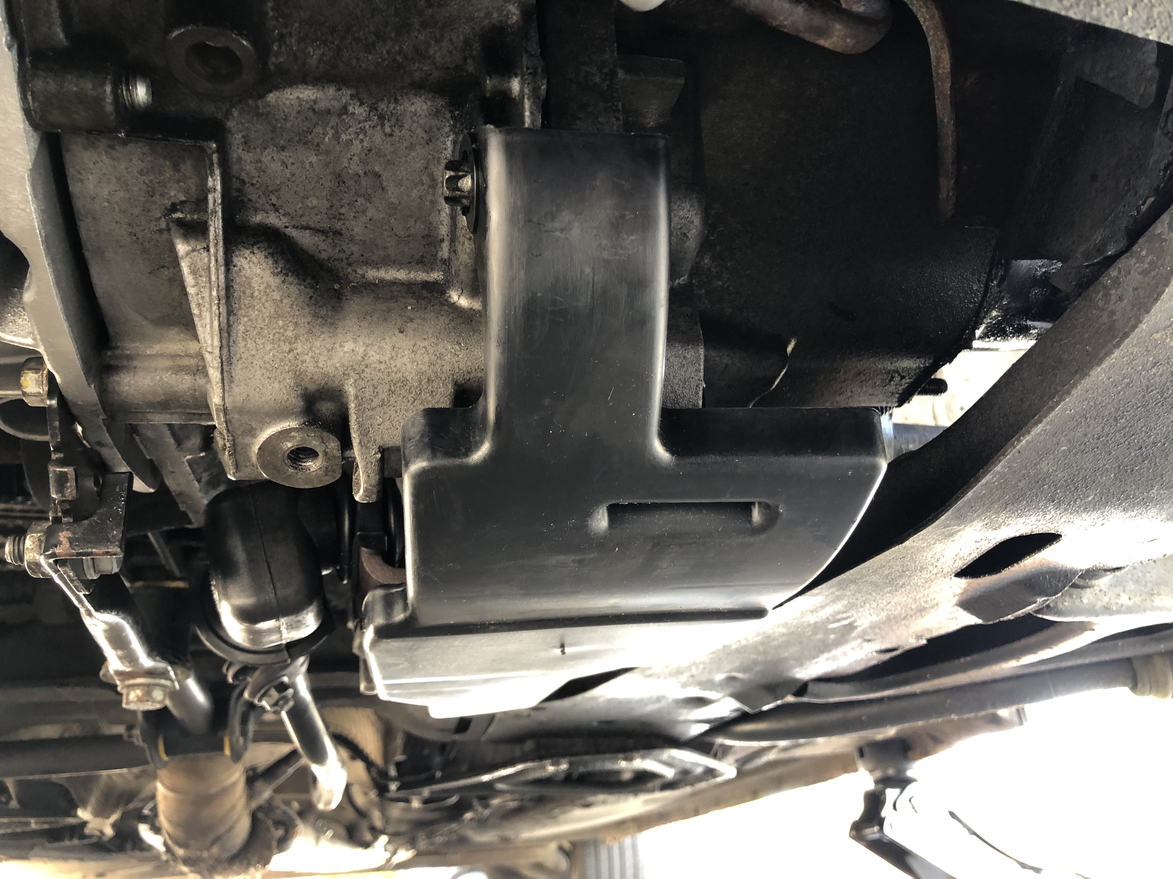

1st to go on the car was the 1seven2 Developments engine/gearbox drip tray but I think this is an oem part anyways.
@plees can confirm?
Next up was the undertray complete with the rarest of parts, the cover for the sump along with new fixtures.

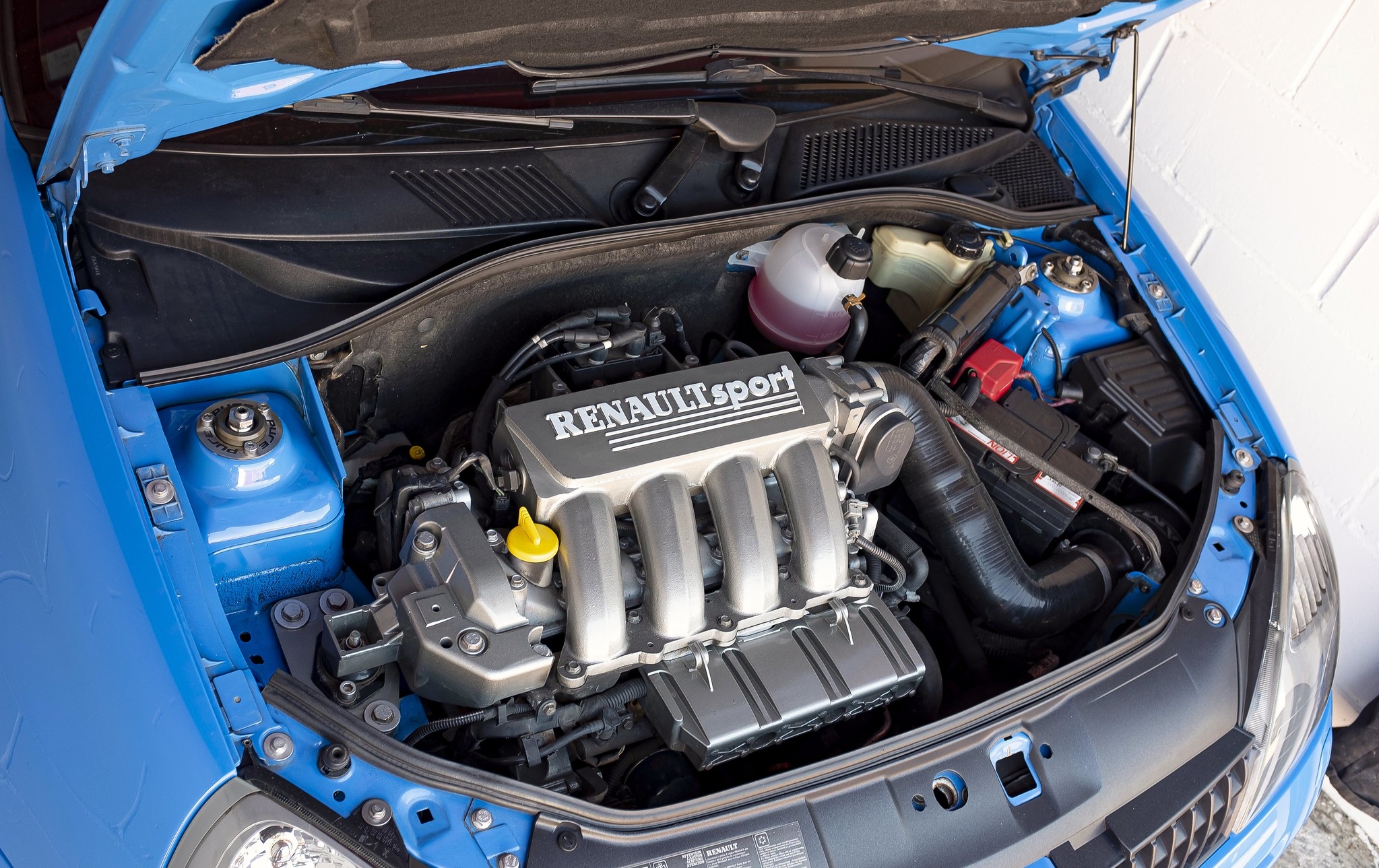

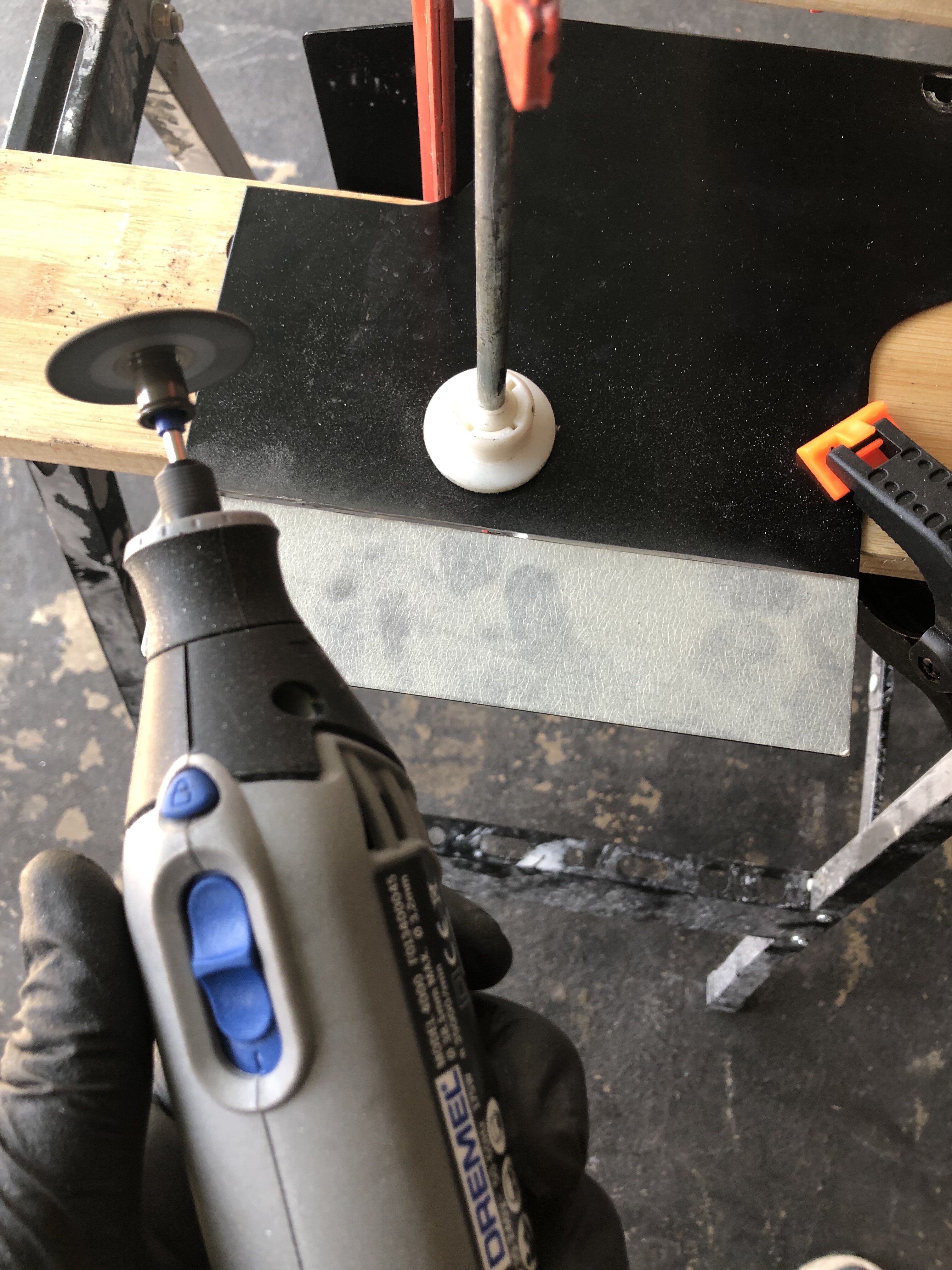

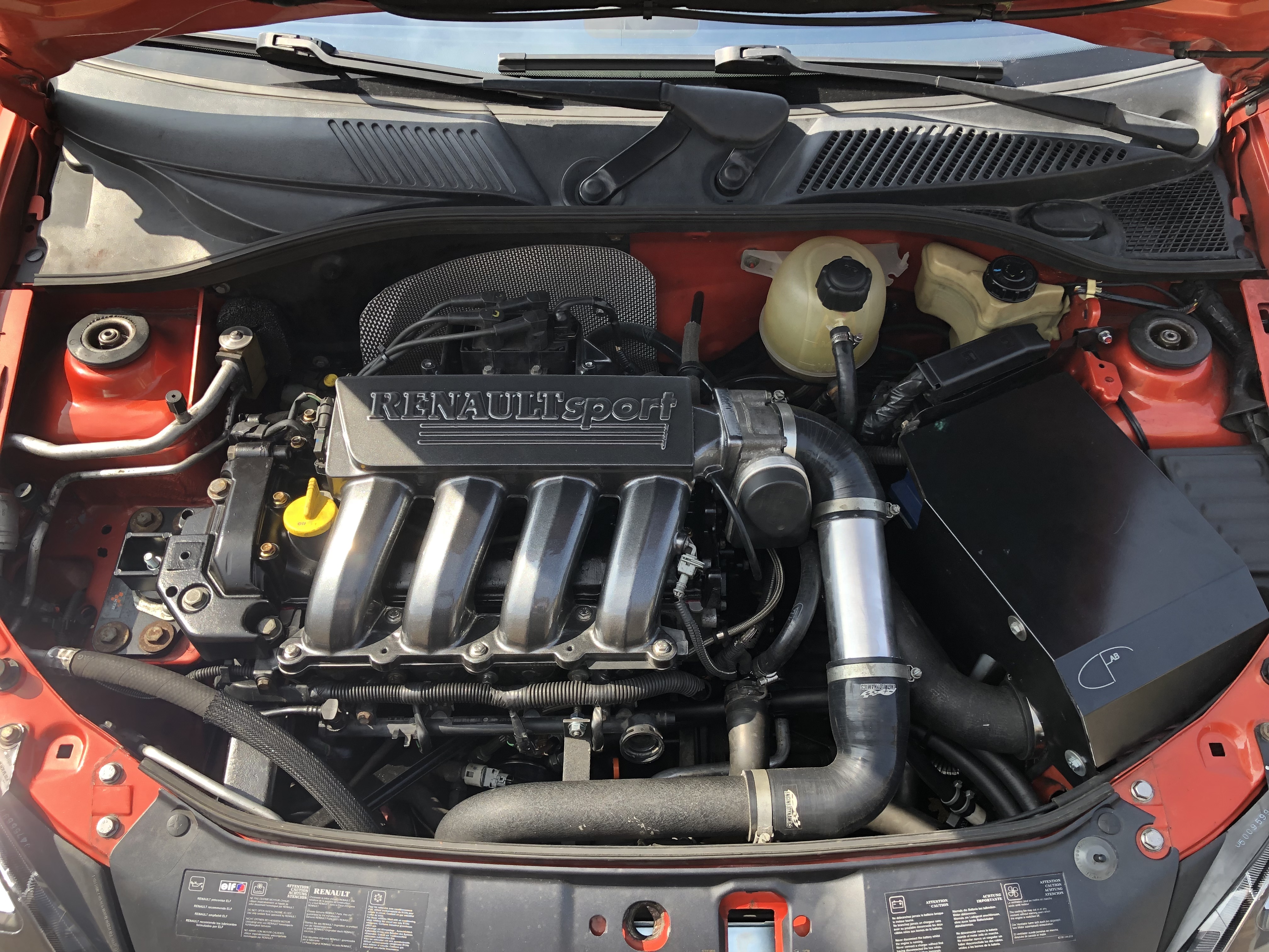

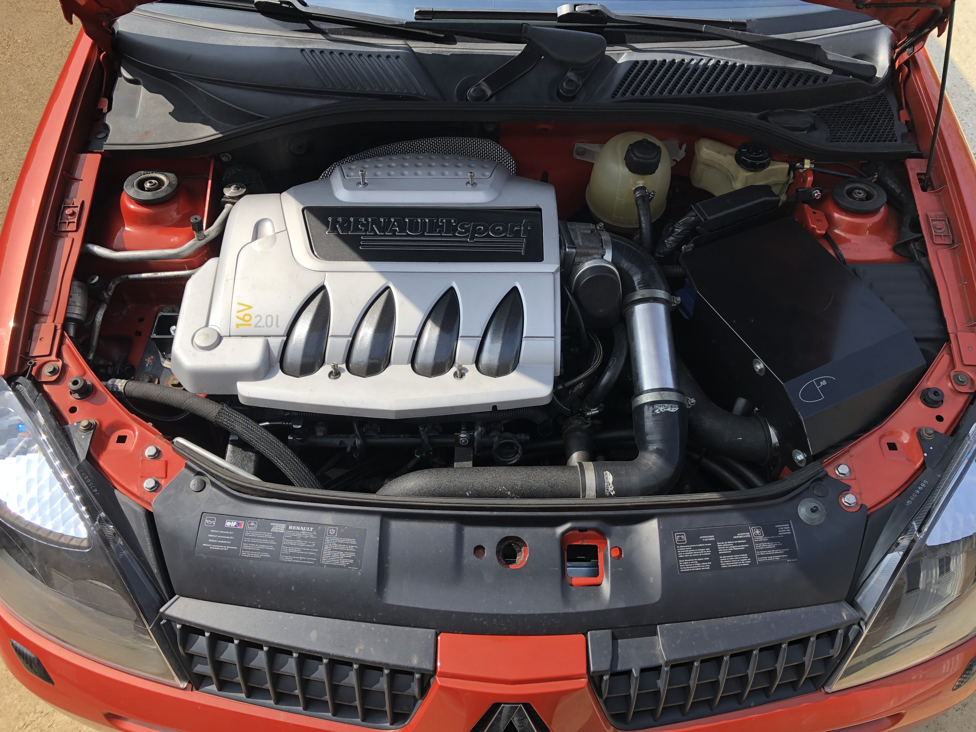

Once that was done I moved to the top of the engine. I had to get physical with the Cfab battery cover as it no longer went on due to one of the boost pipes, Out comes the dremmel!
Next up was the engine cover…
I’m very much undecided on this part so have removed it in the interim and gone cover-less.
The plan would be to spray it inferno coloured to add some contrast under the bonnet but Alex pointed out some potential heat issues.
I can say I never had any on my Monaco so we shall see on this idea. The chrome pipe has replaced the ultrasonic megaboom dv and will be painted crackle black in due course.

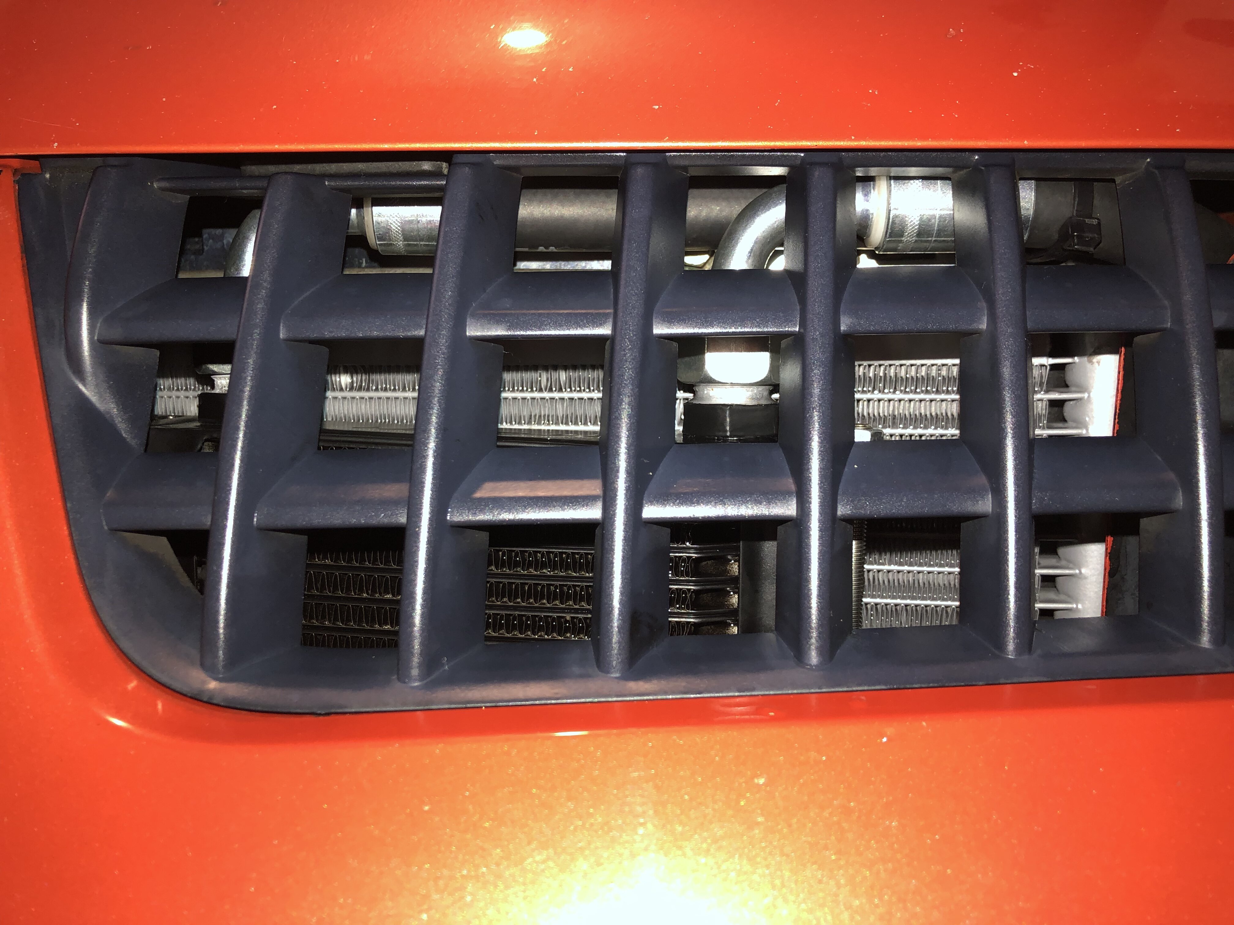

Cheeky oil cooler picture.

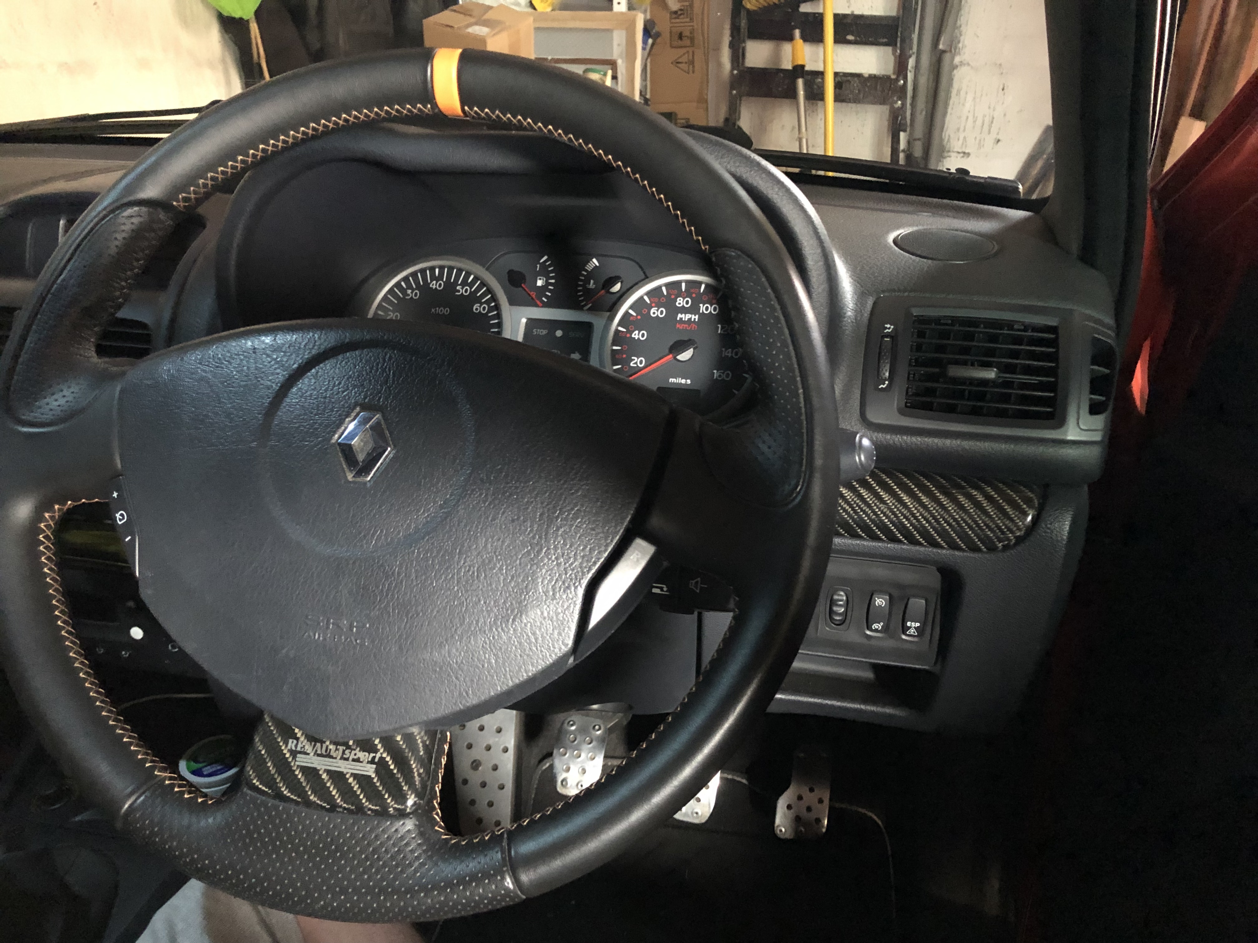

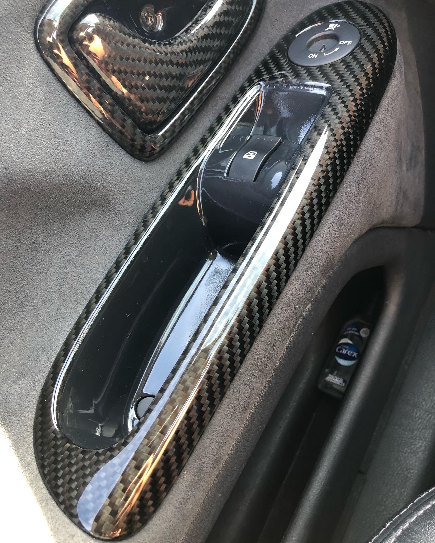

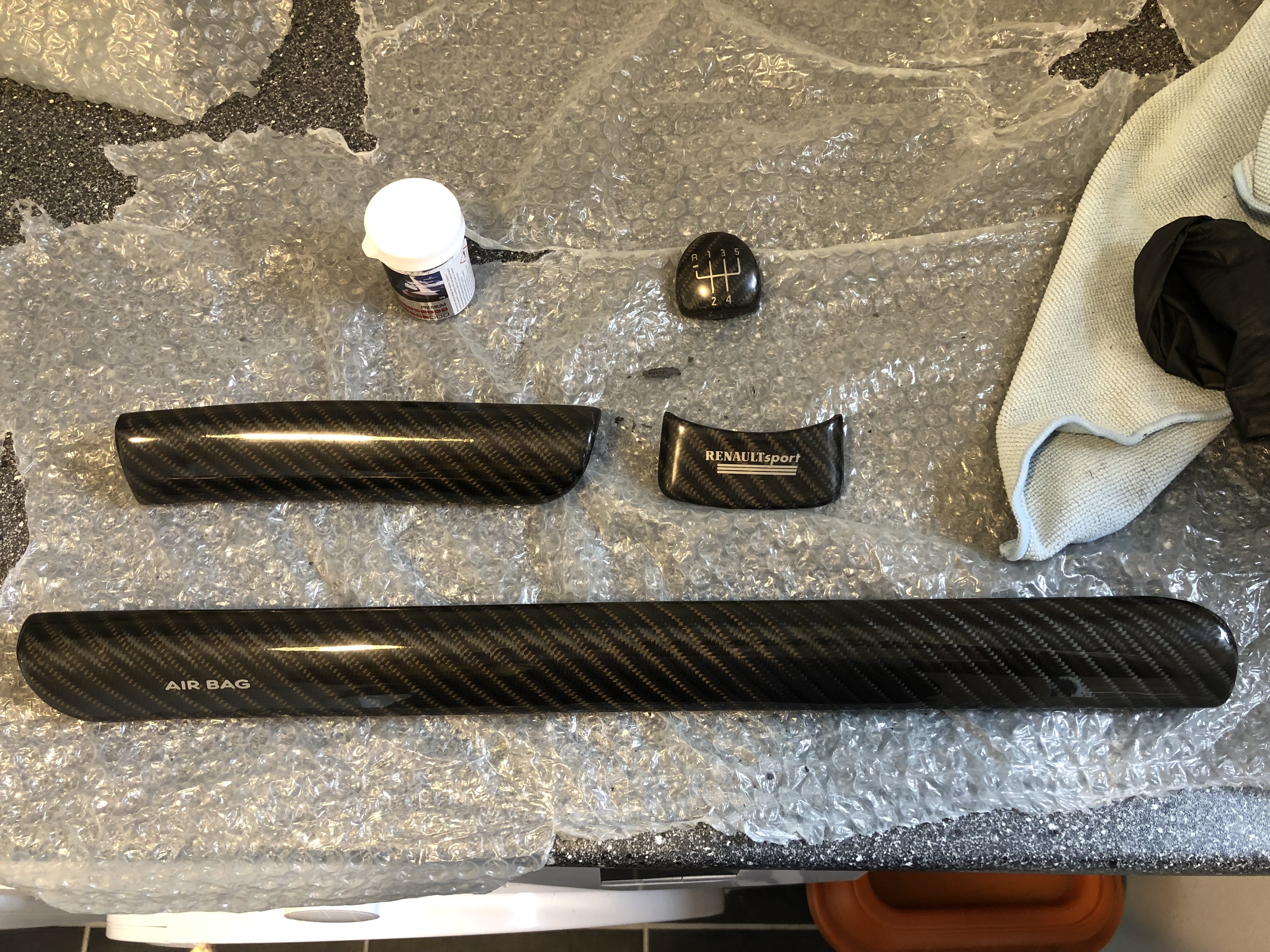

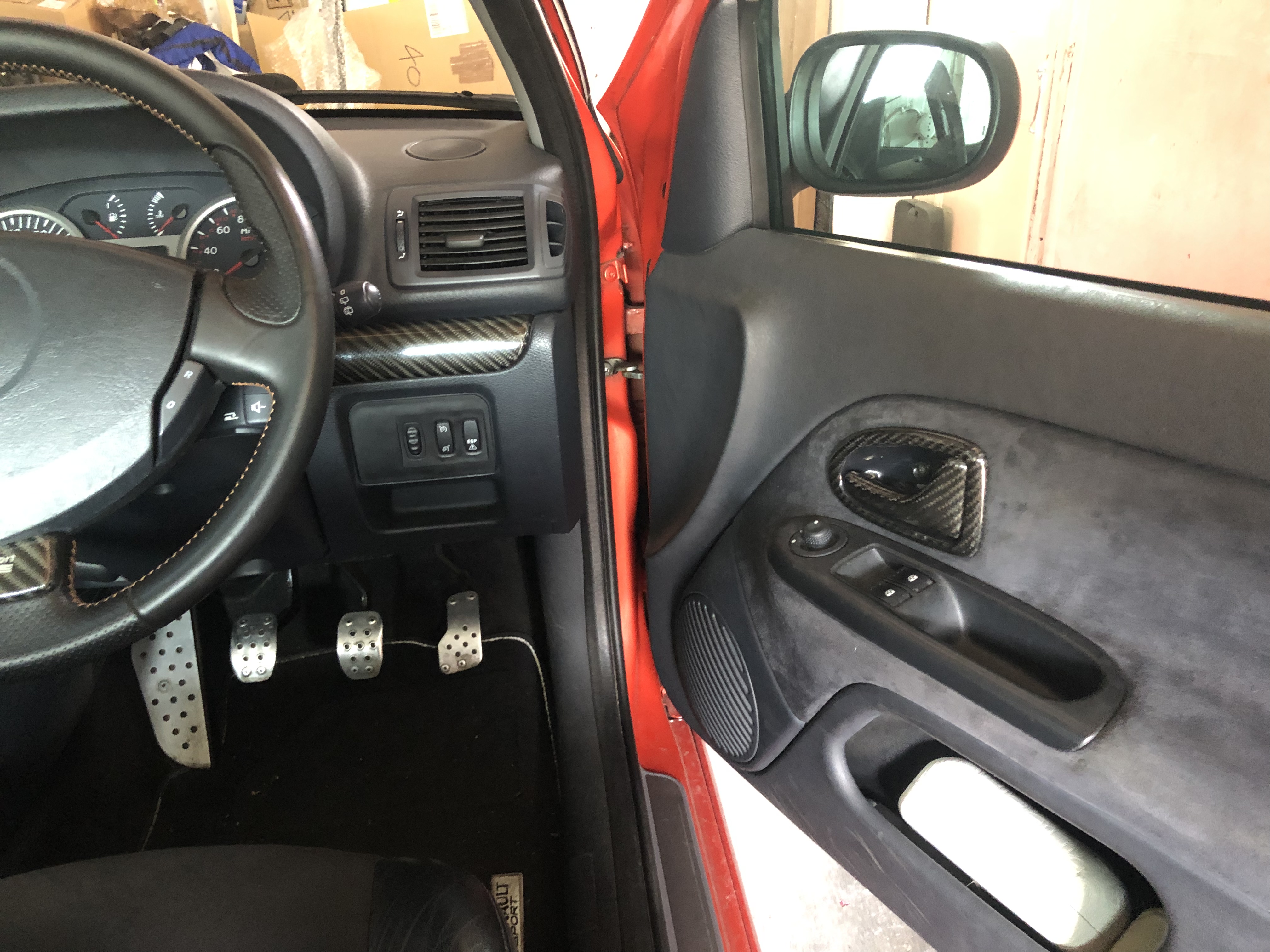

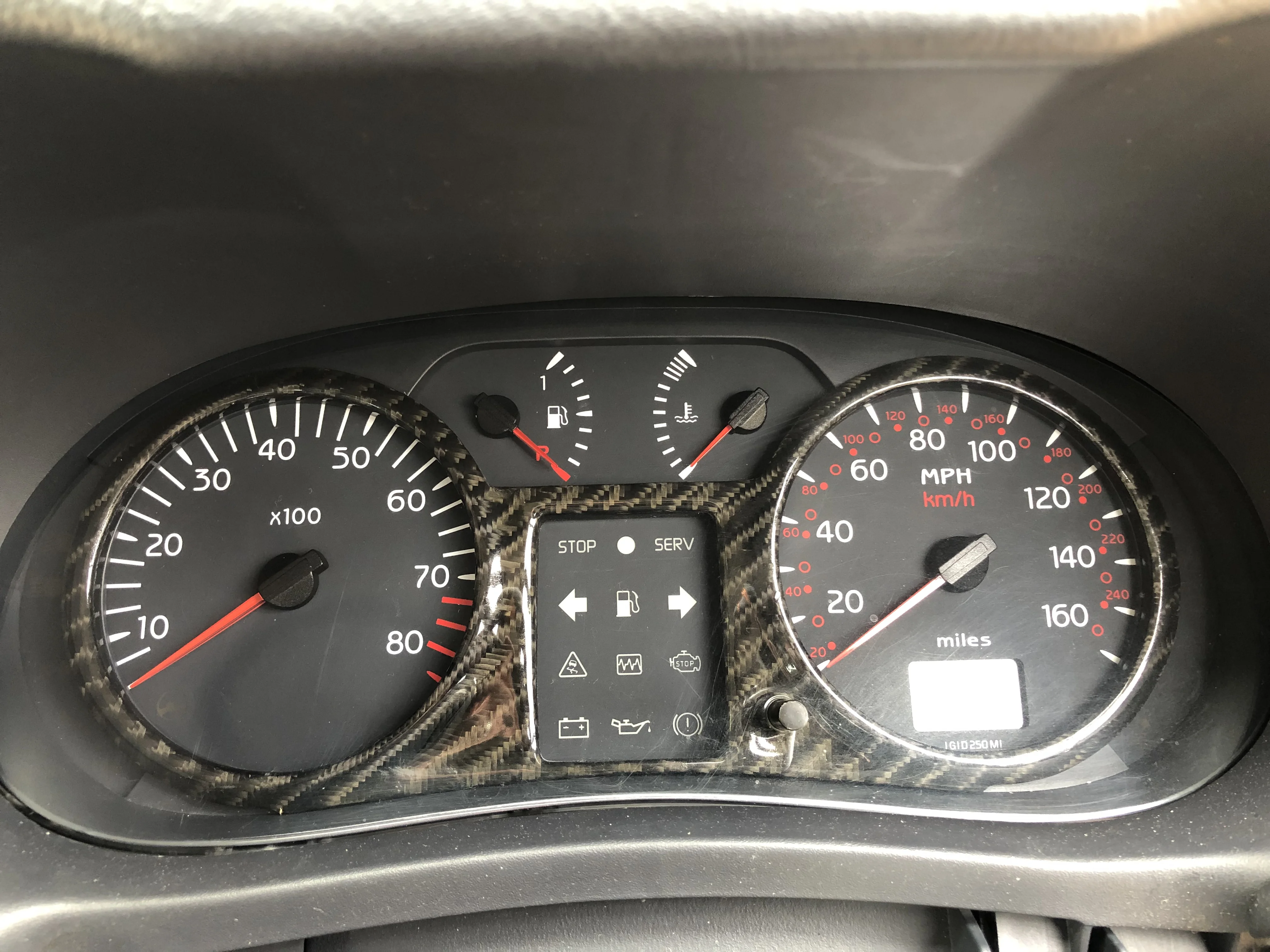

Nothing major to report apart from 400 run in miles completed so 600miles to go and new to me dash trims.
I got some carbon effect wrapped ones form @Mbeau in January of this year but it bugged me that the steering wheel one was silver and the fact it wasn’t real carbon.
I see this current set on an ad for seats from @plees and promptly made an enquiry to the availability of them and here they are. Much happier now I have a full set! So what’s next??
More carbon and running in miles!!

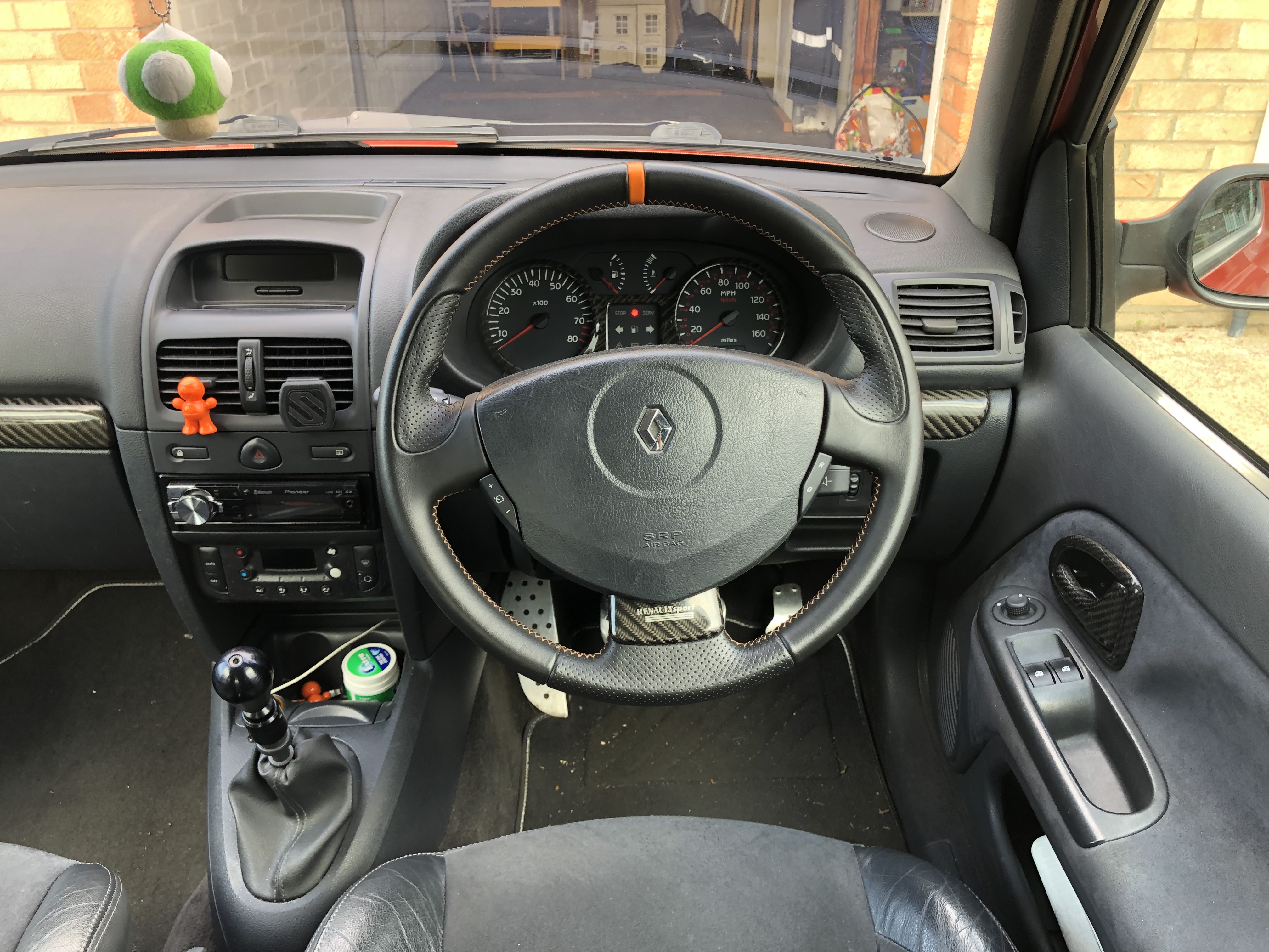

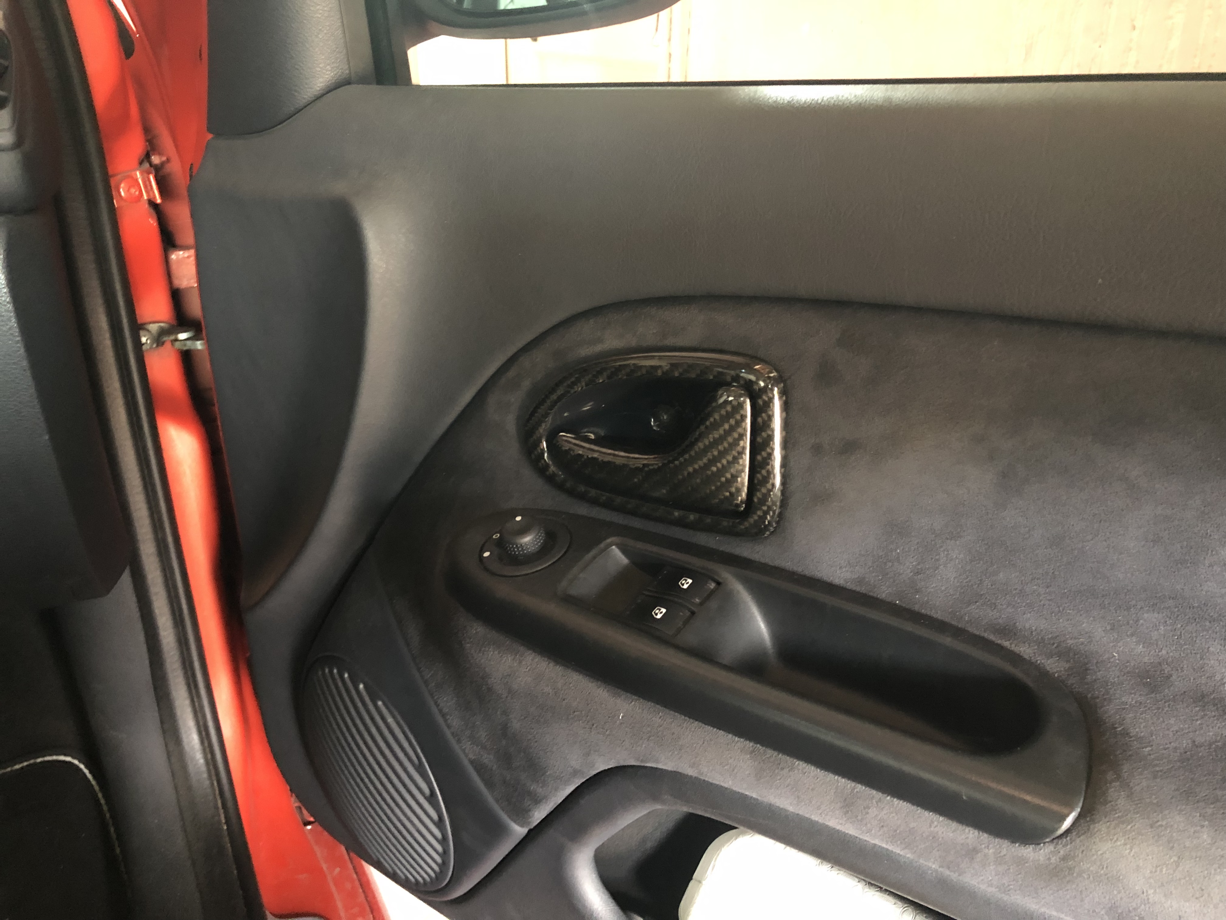

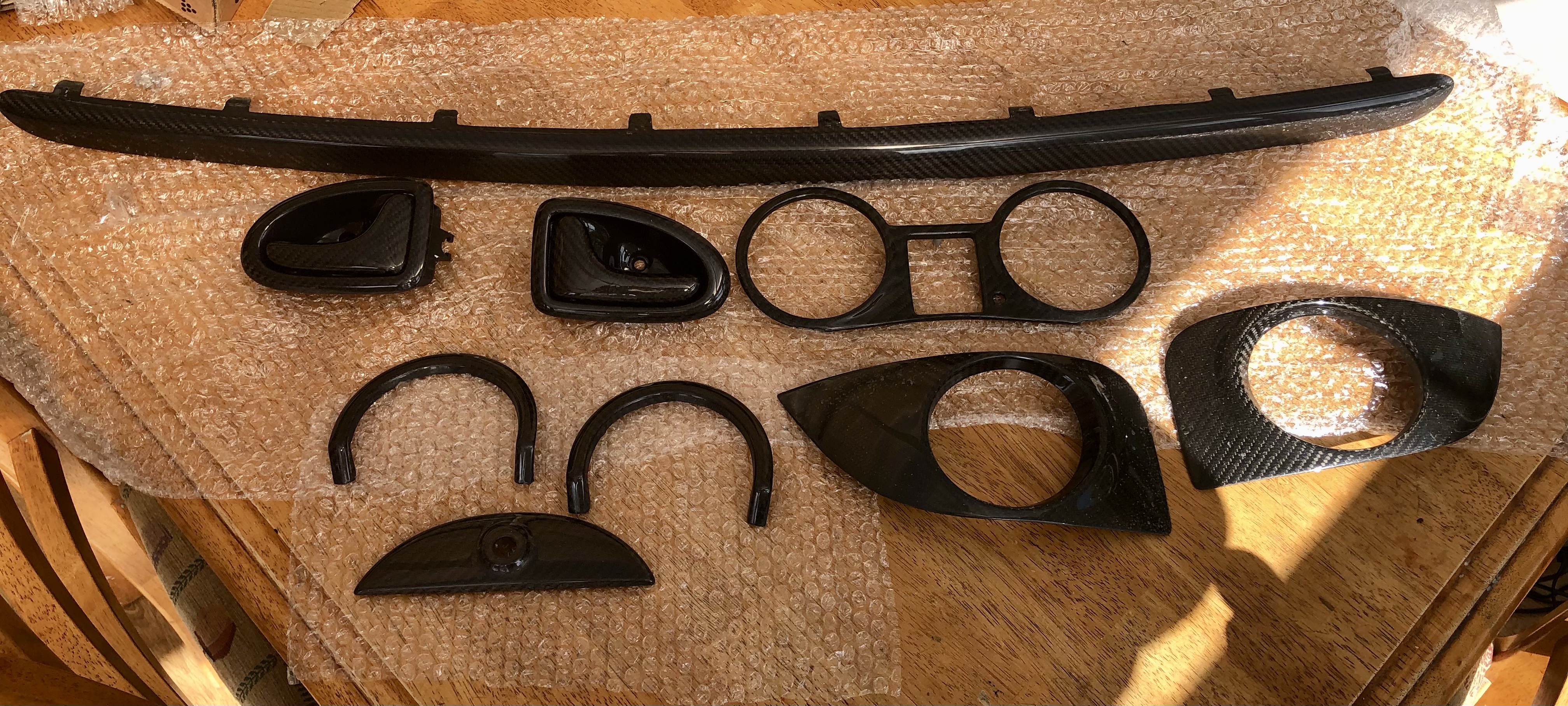

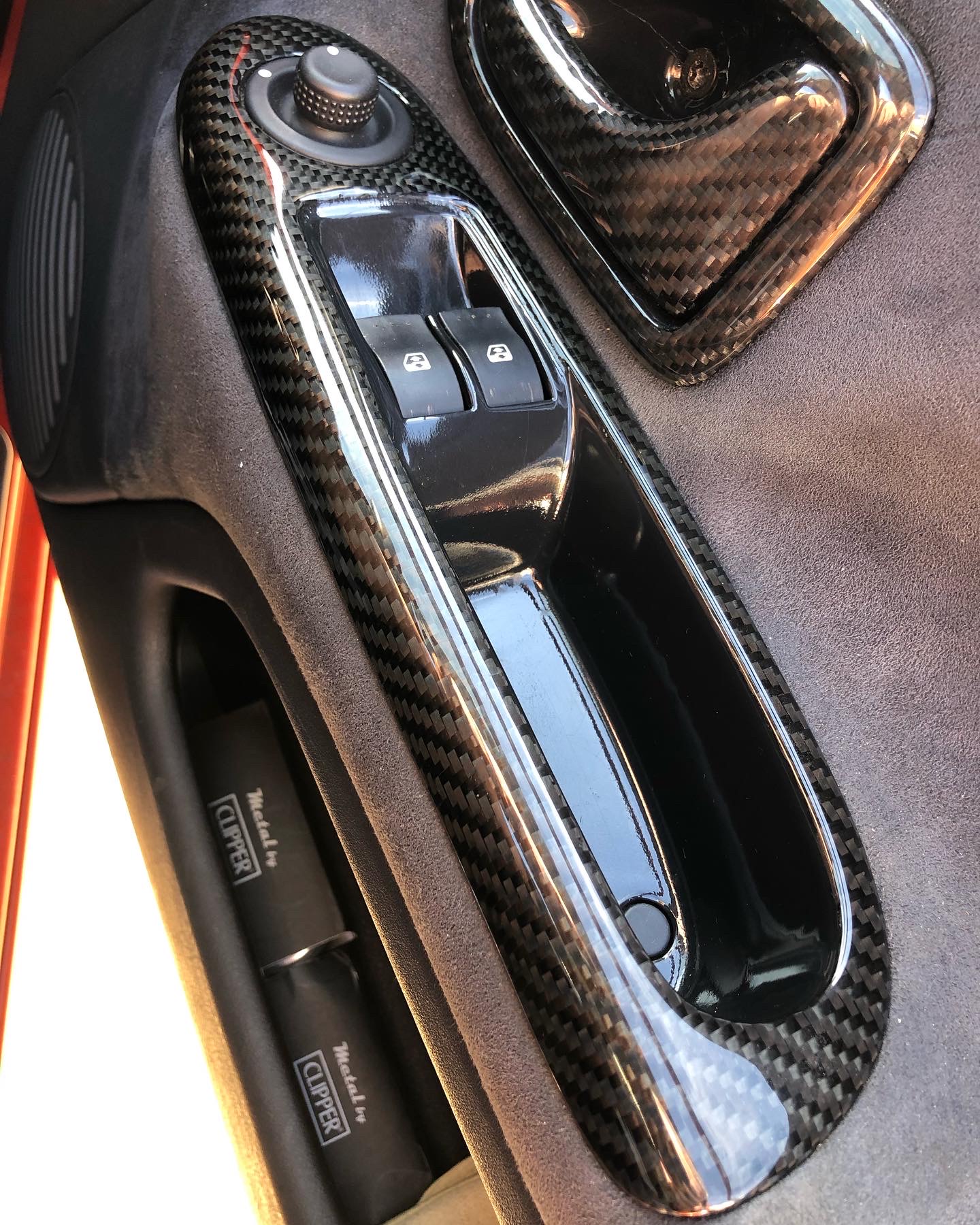

Carbon fibre update…
Thanks to @Clio_fool for getting these door grabs out to me, they finish off the carbon in the cabin very nicely without being ott!
As it stands carbon fibre fitted…
Clock surround
Door grabs
Door pulls
Dash trims
Steering wheel centre
Washer blanks
Rear bumper trim
Still to fit after getting clear coated…
Fog surrounds
Exhaust surrounds
Rear washer cover
And I’m on the look out for or may buy new carbon splitter!

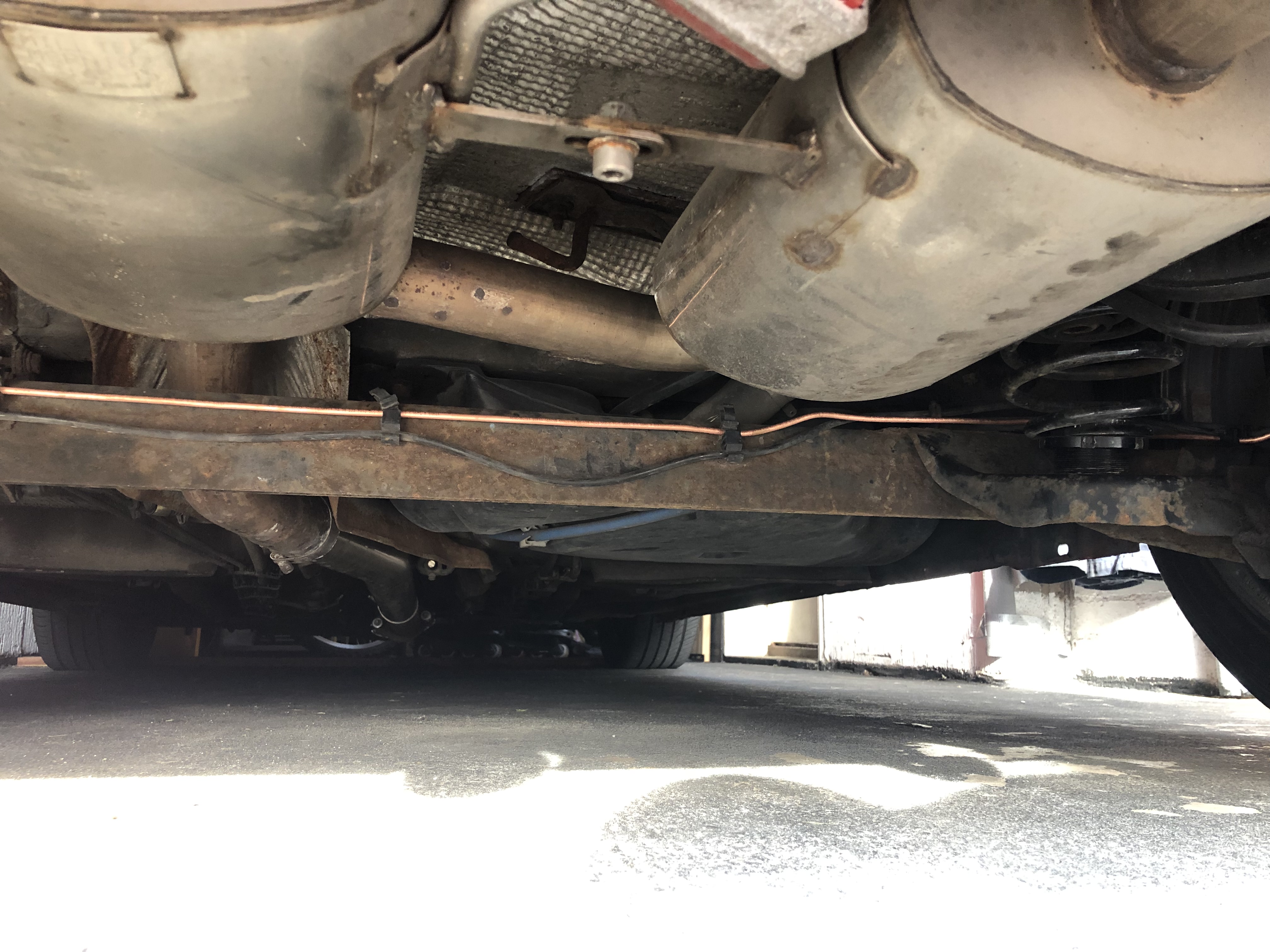

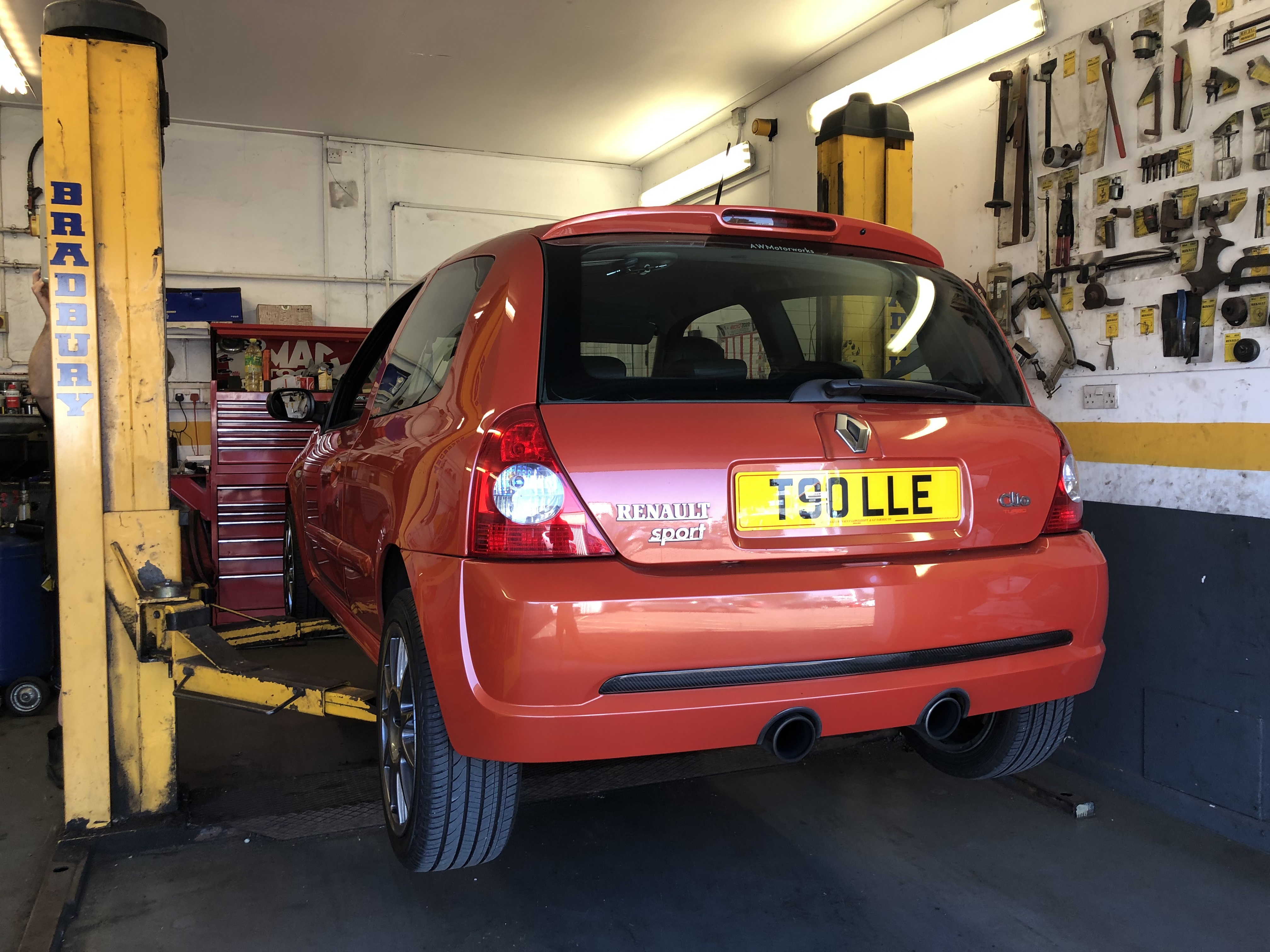

So today was investigation day with my local trusted Renault stealer!
The noise under braking hadn’t got any worse or better but having checked everything myself a fresh set of eyes always helps

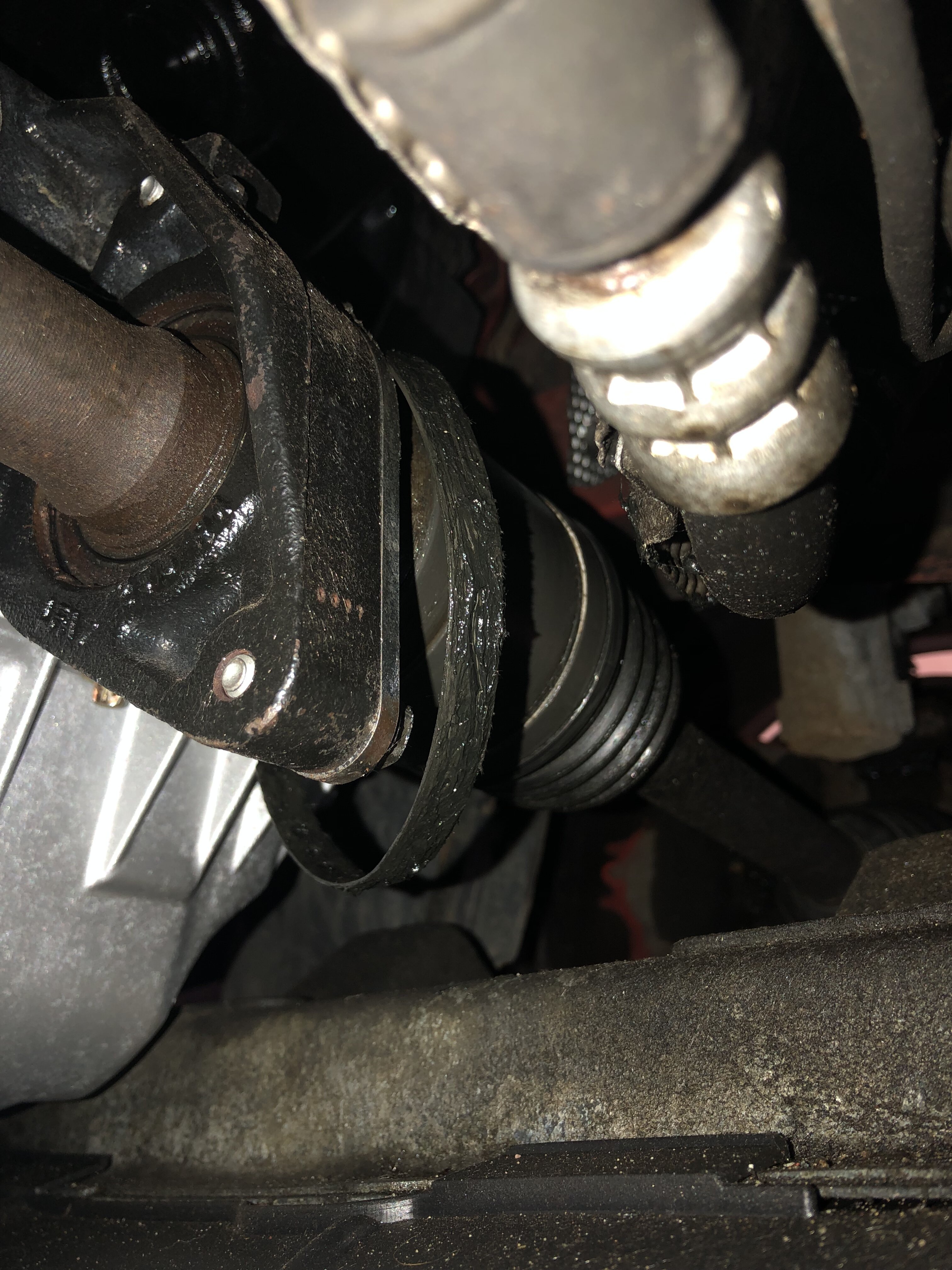

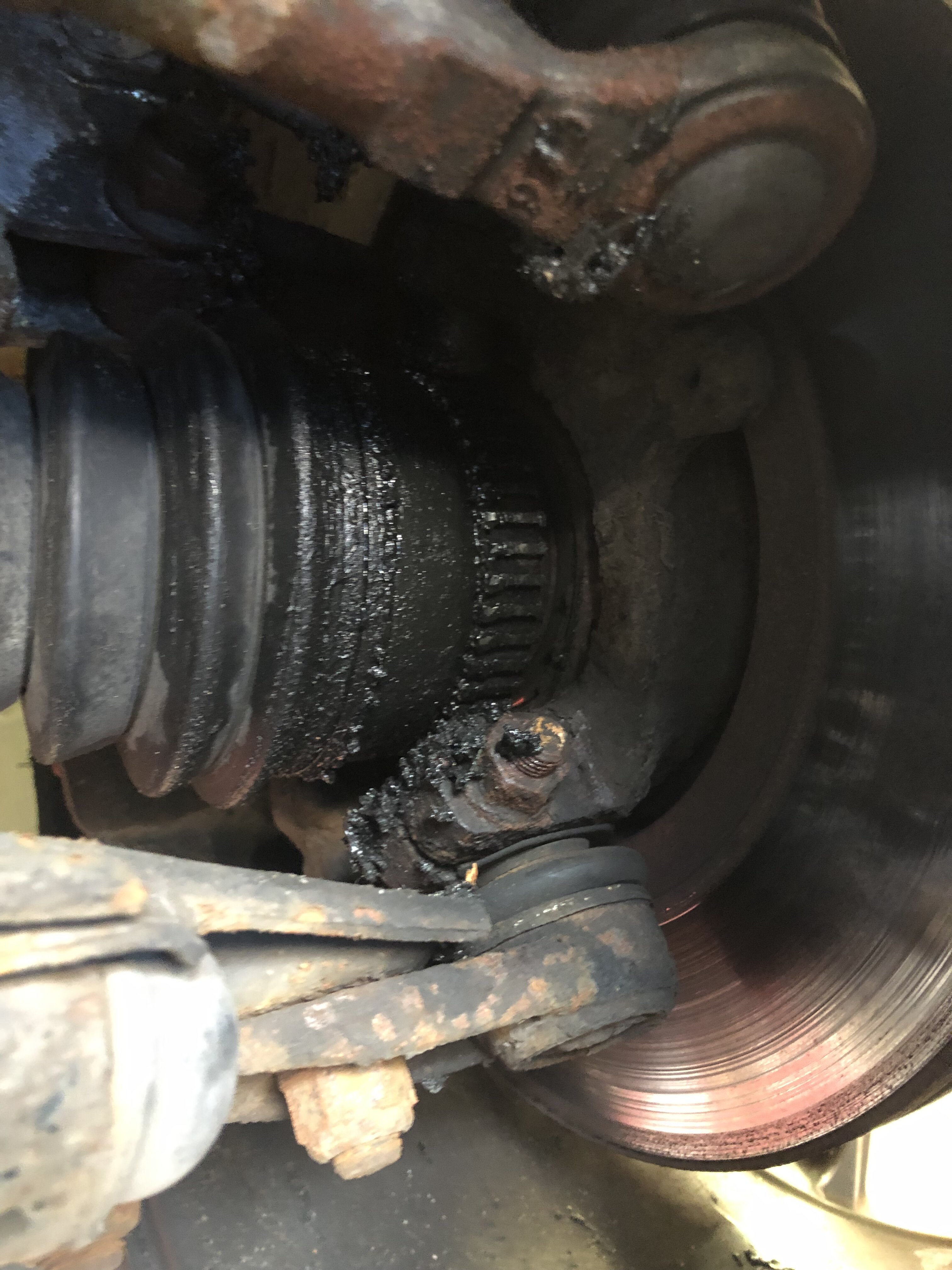

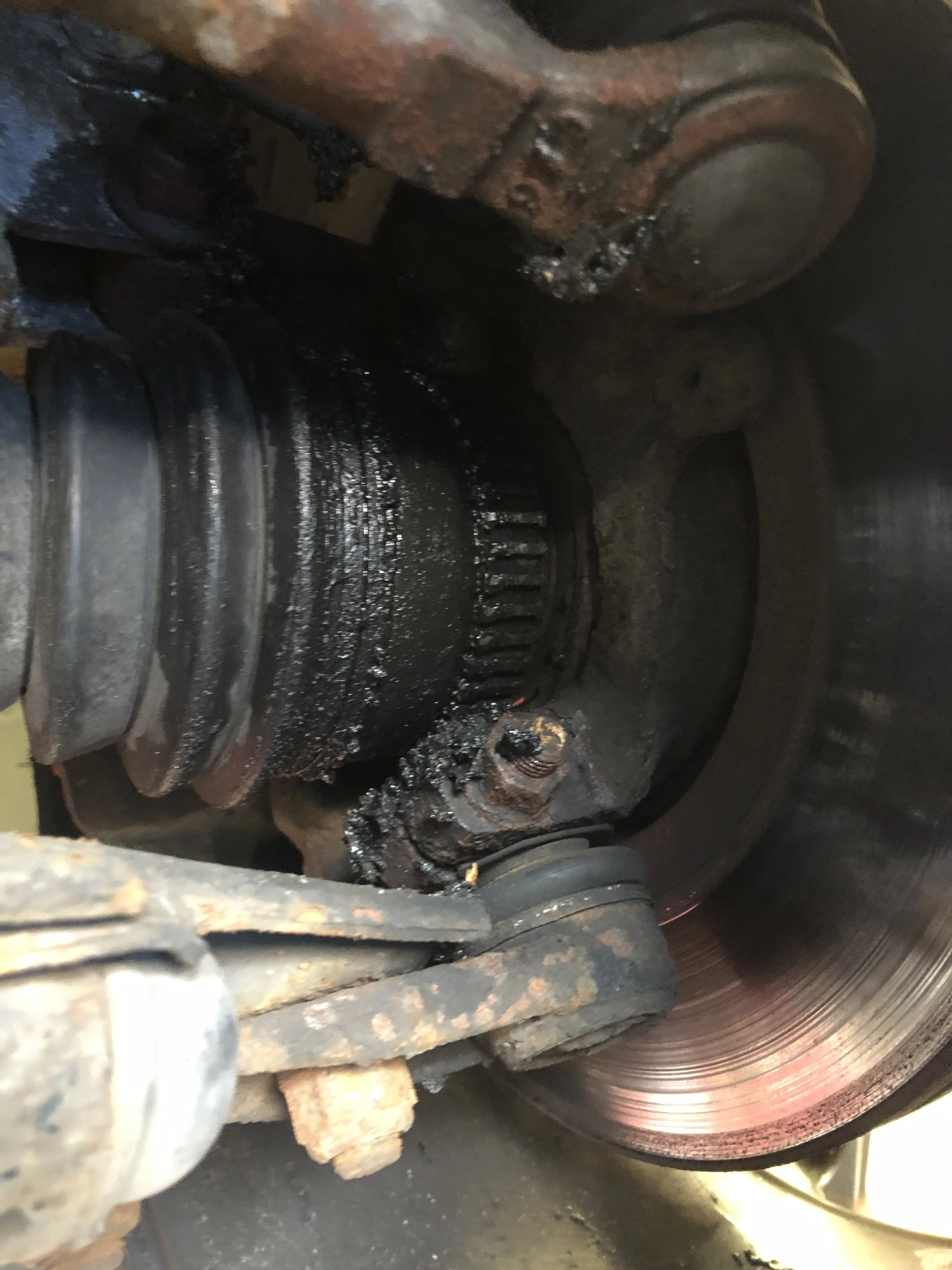

Upon getting the car in the air a couple of issues were spotted instantly before even checking the brakes. The 1st issue was the lower gearbox bolt being loose, this is the 2nd time this has happened, I’m not sure as to why but if it does it again it’ll be getting loctite’d in!!
The 2nd issue was a bit more messy…
The CV boot had come off and worked up the drive shaft expelling a fair bit of grease everywhere. This was replaced fairly easily and cleaned up but the wheels still need doing.
When we got to the rear of the car the nsr wheel/brake assembly was checked and everything was found to be torqued correctly. This led us to remove the calliper and disc to check the stub.

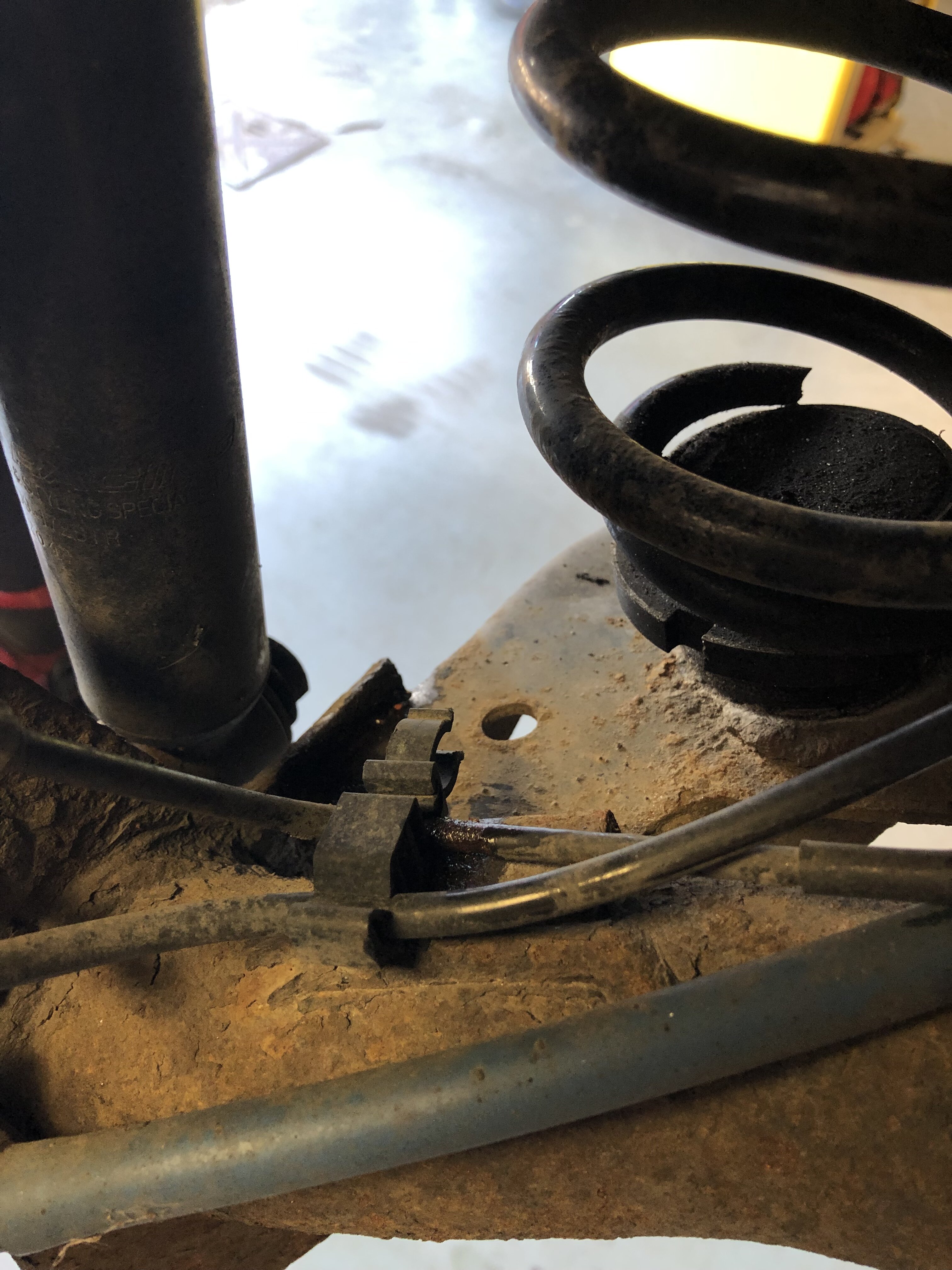

With everything seemingly in order the idea was to swap the discs side to side to see if the noise transferred side but in doing so caused another issue.

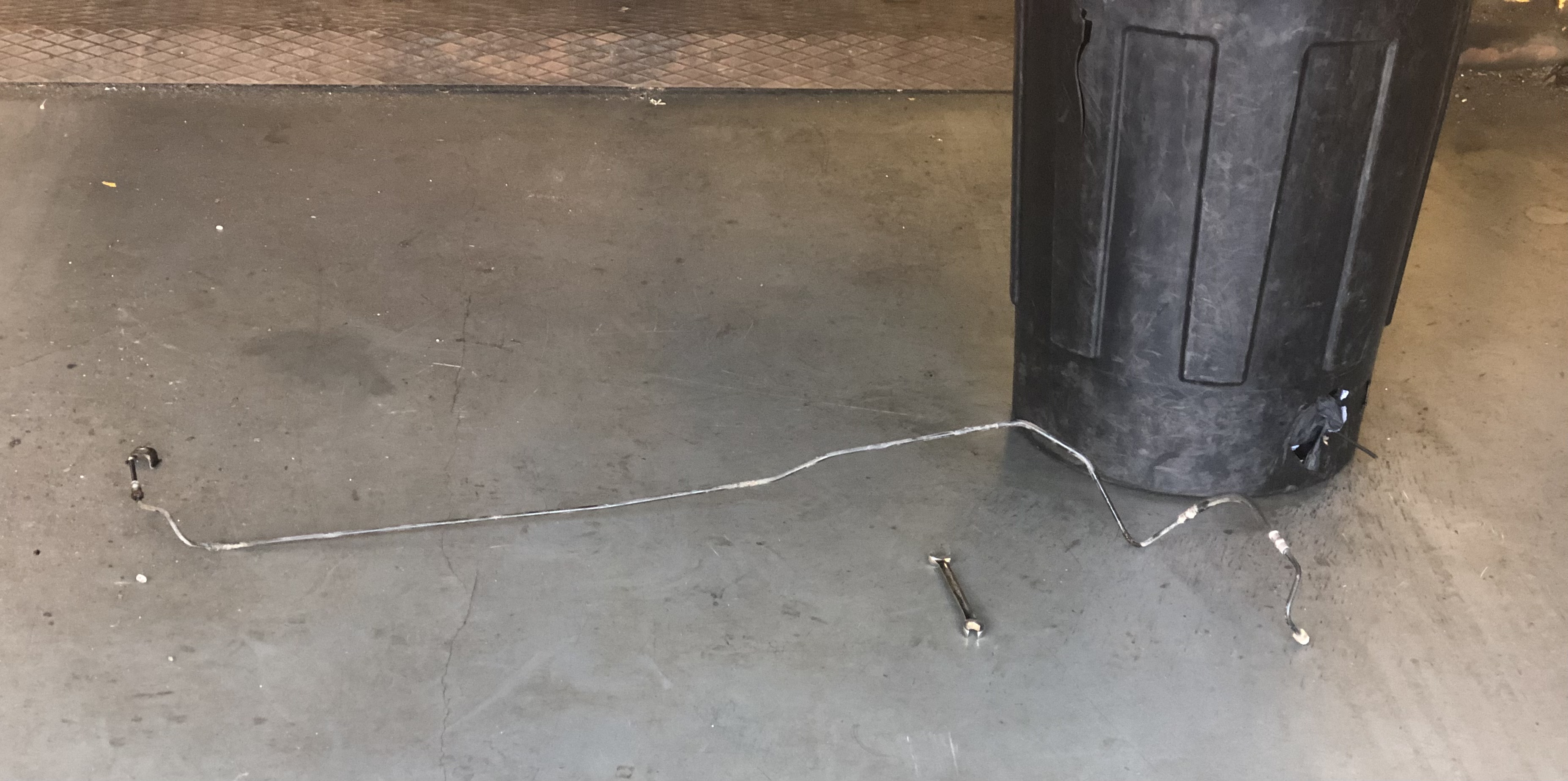

The osr brake pipe decided it didn’t want to keep the brake fluid inside it anymore. I know it was scabby but didn’t realise how bad! Lucky escape tbh as if this had let go out on the road it could have been much worse!
We removed it, measured out the length and made up a new pipe joint it to the existing flexi.
Once that was sorted the road test didn’t show the rotational knock/clunk sound anymore having swapped discs side to side so am unaware of what the issue was or anything.
The bill was only £120 which was pretty good considering the car was on the ramp for 4 hours in total but only got changed 2hr, the price of the brake pipe and a cv clip which overall I’m pretty happy about.
