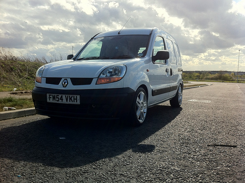

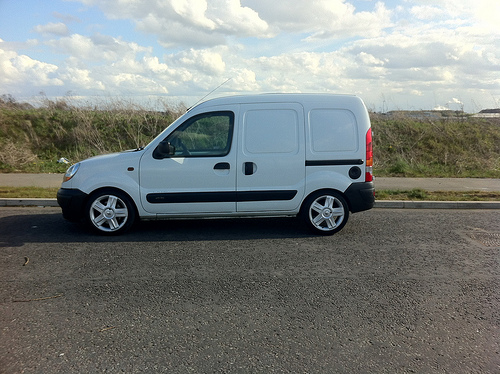

Decided to give it a quick clean today, so here are a few pics.
1 by ashleyt33123, on Flickr
2 by ashleyt33123, on Flickr
  Clio Mk2 PH1 1.4 16v
quality looks good. your right about the rear torsion bars on theres. nightmare when theyve snapped too. weve done a few
