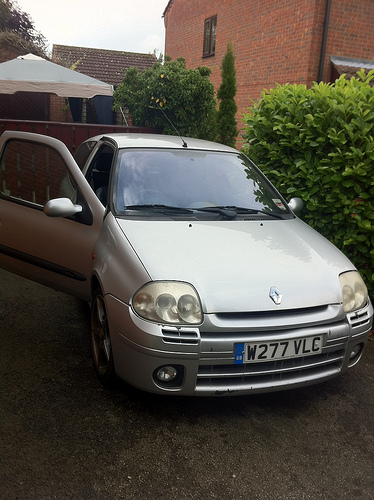

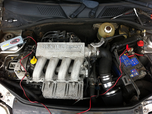

So, started a few bits and bobs on my donor car today, so here is a quick pic before things get dirty over the next week.
clio by ashleyt33123, on Flickr

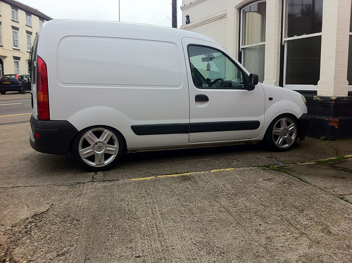

Well folks, loads of progress on the donor car today, which I will get onto shortly, but here is a quick pic of how the van sits now since I fitted the coilovers and dropped the rear beam a little more as I have not uploaded any pics in ages! Excuse it being dirty ;)
Van by ashleyt33123, on Flickr

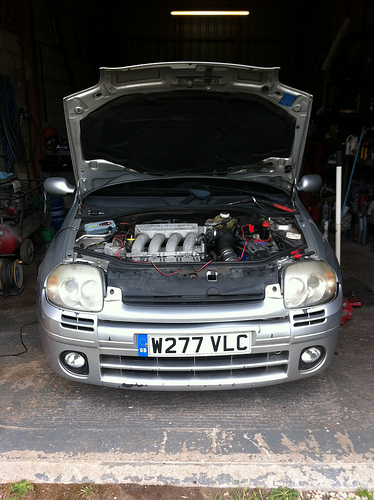

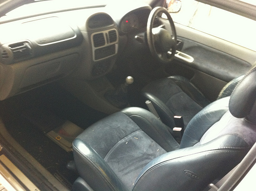

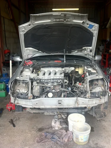

So, took the donor down to the unit this morning and started work. Its quite a clean phase 1 to be fair, the shell is mint with no sign of rust at all, engine looks like it has never been touched and the interior is just as tidy! Shame to pull it apart, but its for a good cause ;)
Few pics.
1 by ashleyt33123, on Flickr
3 by ashleyt33123, on Flickr
2 by ashleyt33123, on Flickr
  Kangoo 172 Cup ;)

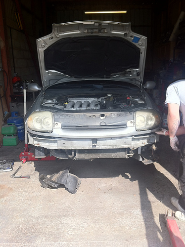

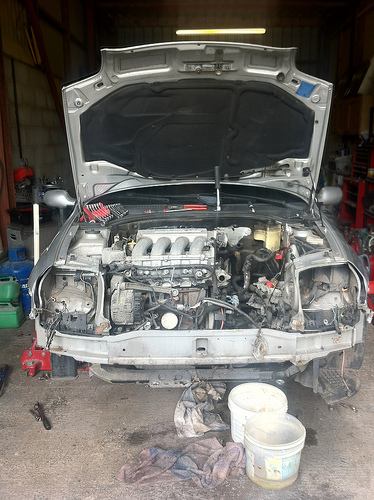

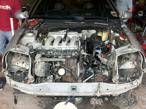

We started with the engine, running gear, wiring and ecu at around 1pm today.
First point was to make a little space by removing the front bumper and wheels.
4 by ashleyt33123, on Flickr
  Kangoo 172 Cup ;)
So with all that out the way we dropped the exhaust manifold out the way and removed the wiring from the starter and lambda sensor.
Quick pic, more or less the same as above.

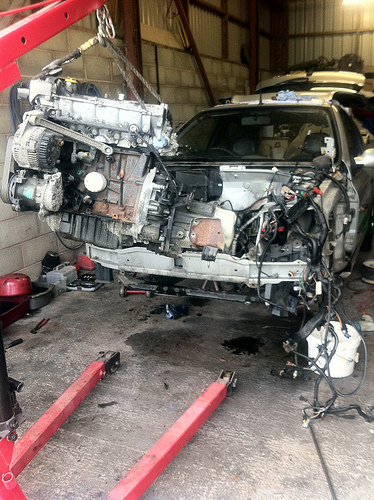

Next on the list was the wiring loom, including every part at the front end, so engine, gearbox, lights, indicators, carbon canister, aircon, heater box, ABS pump and sensors.
Last thing was to pull the lower arms with struts, hubs and brakes still attached, both drive shafts, gear linkage and engine mounts and the beef was out!

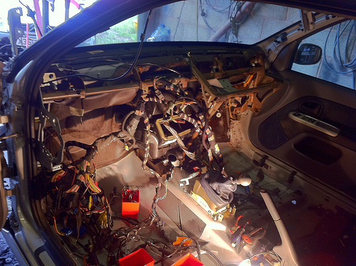

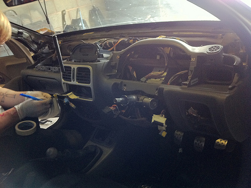

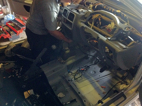

We had to ditch the comfort of working while sat in the front seats due to needing to remove as much of the wiring loom in 1 piece as possible, so out came the seats, carpet and plastics from around the handbrake and gearstick. Dash was nearly out!
Untitled by ashleyt33123, on Flickr
  Kangoo 172 Cup ;)

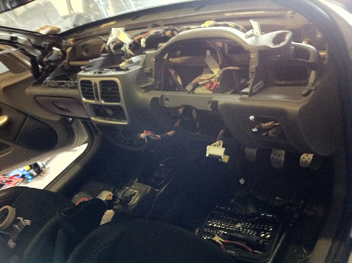

We unplugged the door looms and removed the 2 T15/20 Torq screws at either side that hold the wiring in place, disconnected the loom on both sides where it runs towards the back of the car, removed the dash, unscrewed the fuse box and UCH and called it a day.

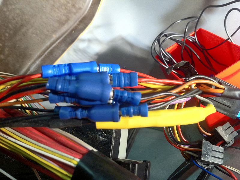

Had an annoying problem when pulling the dash out.
Part of the wiring loom to the Cobra alarm boxes was wrapped around the passenger side air vent pipework that is plastic welded to the back of the dash. Stupid design / idea. So i had to cut part of the loom in 2 places to get the dash out, and rejoin the cables, which was a nightmare.
If anybody has any idea what these cables feed from that would be great, they run to the 2 multi-pin connectors that plug into the cobra control box.
Just seen this after you PM'd me mate
That's not the same alarm as on my 172/182's - they don't have a control box in the car they just have a single plug going into a siren/box under the scuttle panel :(
