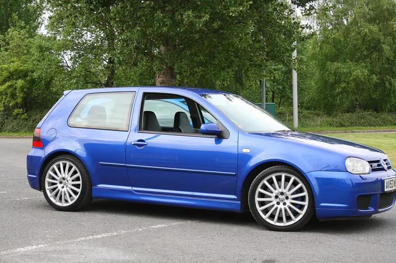

Going to give ze golf a good detail over the next few weeks, Im going to be doing a pannel per night as work is sooooo busy at the minute!
Paint is in OK condition at the moment, the car had autoglym life shine from new, so its held up quite well! But swirls and maring are starting to appear.
The wheels are f**ked from my project U pads and the previous owner has curbed each of them, these along with the front bumper are booked into the body shop for two weeks time so would want to get the detail done and dusted by then.
Im using a PC not a rotary.
My list on CYC at the moment stands as
Menzerna Polishing Pad x 2
Menzerna Finishing Pad x 1
Clay Magic Perfect Finish Kit (100g clay) x1
Menzerna Power Gloss S 34 A
Menzerna Intensive Polish PO85RD 3.02
Menzerna Final Finish PO106FF
Menzerna Final Finish PO85RD
Collinite No.476S Super Double Coat wax
Ive put them in order of use, anything to add/remove, I do already have SRP & EGP so could add them after the 85RD?
