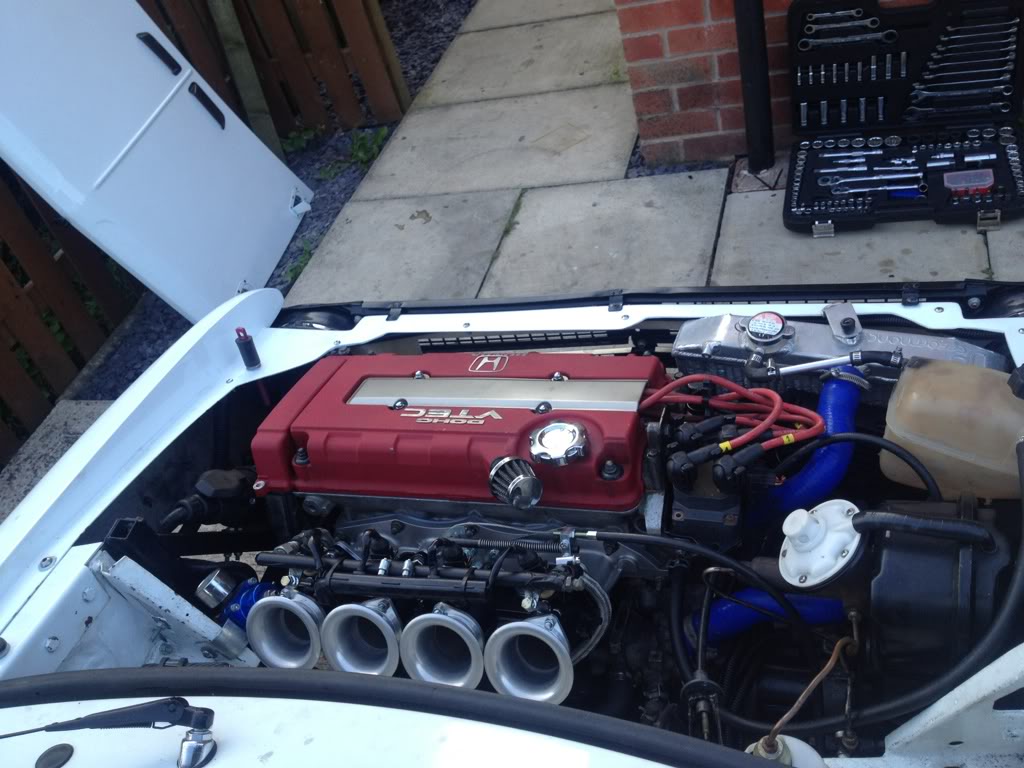

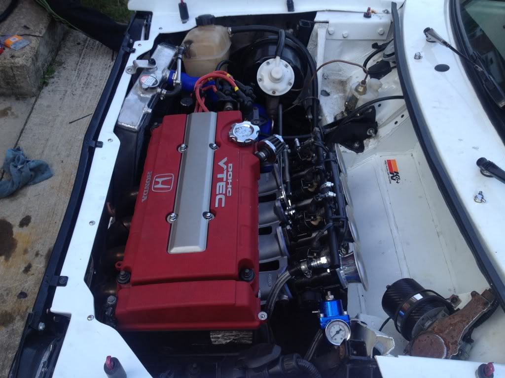

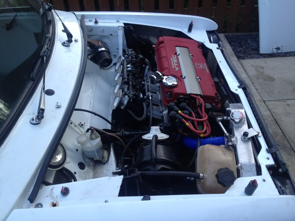

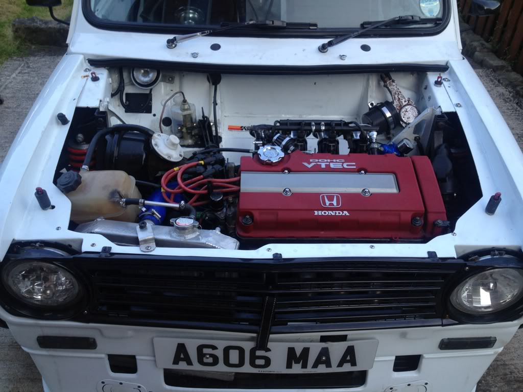

my mini b16 now running a dc2 type r lump
  e91 330d/type r mini

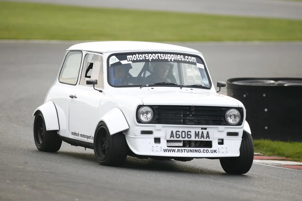

well after i built my b16 mini which turned out to be the fastest na b16 mini in the uk at 13.3@104mph i craved that bit more so i bought a integra dc2 type r engine which i have fitted high compression pistons to along with polish and ported head and a nice 4-1 manifold.
then to finish it off i aquired a nice set of 48mm jenvey throttle bodies.
today i managed to get it running so over the next week or so i want to run it in then down to rs tuning for mapping which id like to hope will make 200+ bhp :)
heres how it sat at the end of play today :)
now lets see if i can break into the 12s :)

Very cool car :)

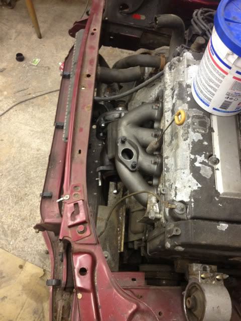

I reckon with a radiator on just the drivers side you could fairly easily fit the same turbo manifold I have for my mk1 clio with one of these engines:
That said though, in something that light, you probably dont need anymore power realistically anyway!

Fantastic as always mateyi bet that flys, think you will break into the 12's? whats the rev limit? ! seriously need to pop up and have another one of your cuppa's lol

You've done it right. Hats off sir. Surely it'd break the 200bhp barrier with ease though?

Wow wish i had the skill and patience to build something like this .. hats off to you
It should easily see 200bhp but more pics needed please

cheers for the kind words,for the people who mentioned turbo's i did go out in a 400bhp b18 turbo and if im honest my previous itb'd b16 felt quicker as it actually gripped and went somewhere unlike the turbo'd one which when came on boost just broke traction then torque steered all over the place but in the turbo's defence it was a little damp when he took me out.
if i was to boost i would supercharge it as i think it would be a better application for what i want to use it for (trackdays) because of the more linea power delivery.

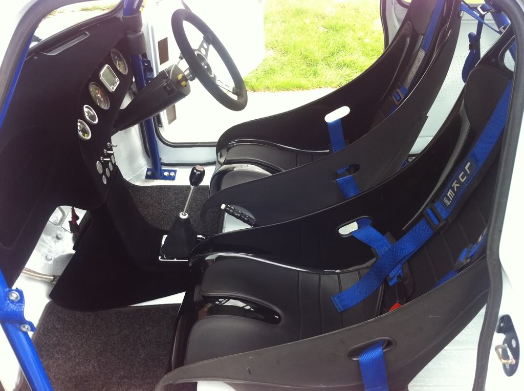

as requested a couple of pics of the rest of the car

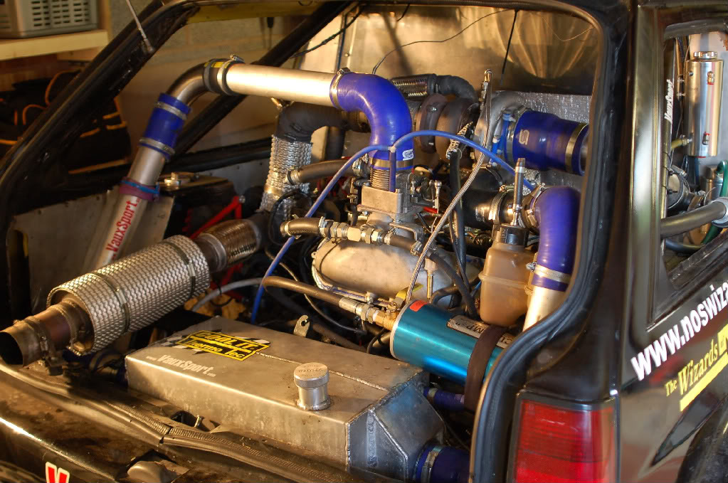

A decent intercooler is far better, and thats coming from someone with the biggest charge cooler you are ever likely to meet, mine holds 19 litres of water in fact, lol

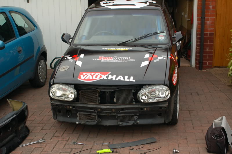

Agreed, the problem with them is that the radiators are never big enough to actually lose the amount of heat you need to in order to keep the water cooler, so they are great for a couple of pulls on the dyno but not great for a 15 mins track session.
Mine is a bit of an exception to that as unlike most people I have attempted to address it so these are the radiators for it shown when I was initially testing for space:
