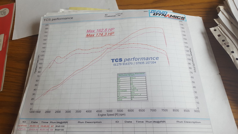

When i bought the car it was advertised as 162bhp but i found the RR graph in the paperwork which shows it was 162bhp prior remapping and is now 174bhp

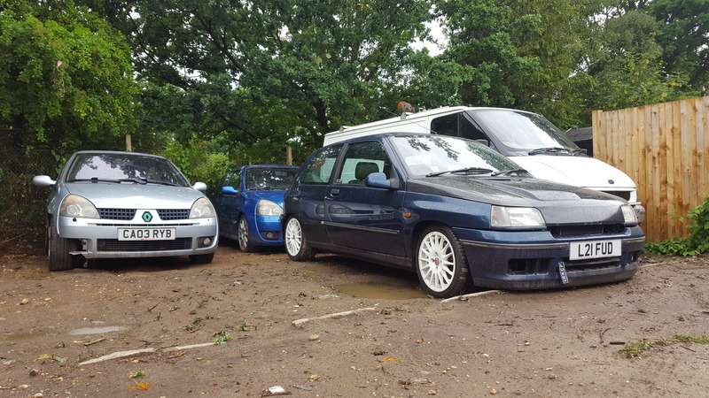

Here it is with the cup ive been taking parts from

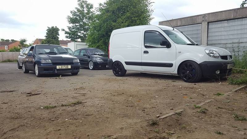

With my friend 182 van

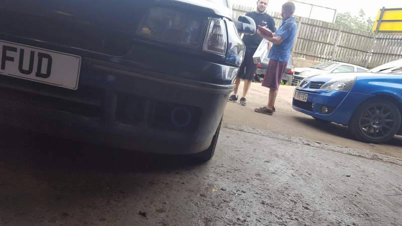

A couple of the pics aren't working now as i moved them in to a different folder on photobucket but ill update the thread anyway, the car was dropped off at a friend of mines to get some bits done as i simply dont have the time to do them and it would have taken me a year with half hour here and half hour there + he has a ramp which makes life easier
The car was dropped with him with a list of things to do which included fitting the 172 track on it which was done with standard 172 shocks and cup wishbones but the ph2 arb would not fit with the supersprint manifold and the 16v one was obviously far to short que a panic to try and find a williams anti roll bar, which i managed to do, the same day we found i needed one!

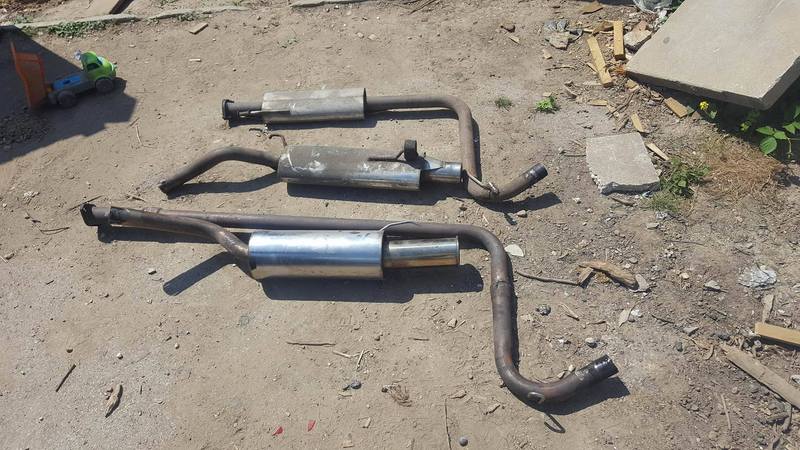

So i traveled to Chelmsford and picked up the williams anti roll bar, i also bought a magnex exhaust, a spare rear bumper, steering column and a drive shaft, i went to my friends workshop the next day and we fitted the ARB with the bushes on the ramp (a task that is much much easier with 2 people) we also bled the brakes and i brought the car home with the following having been done -

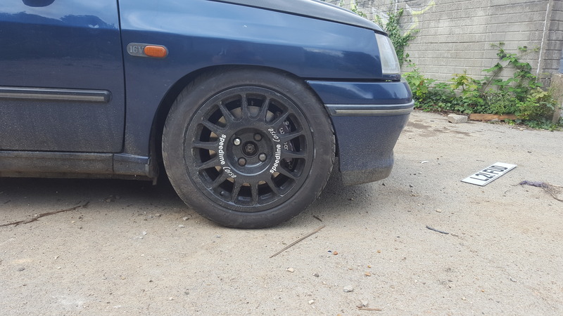

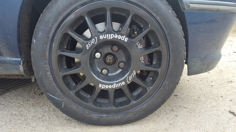

speedlines fitted

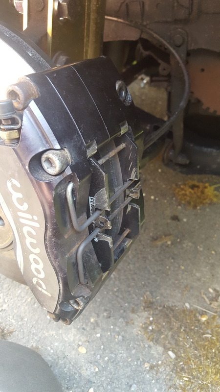

Wilwood 4 pots with braided lines

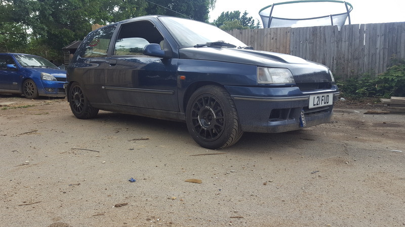

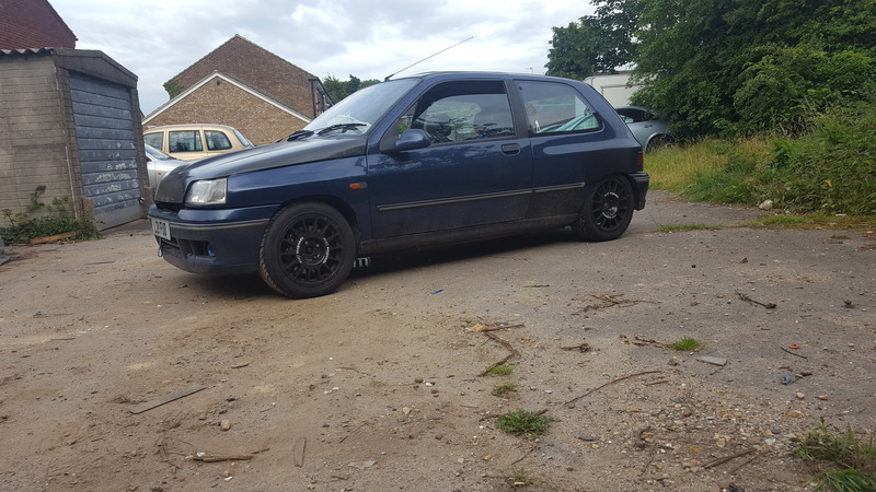

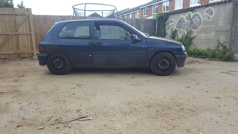

and this is how it currently sits

Wilwood k-tec kit i got from Steve, designed to fit under 15 inch wheels with no spacers

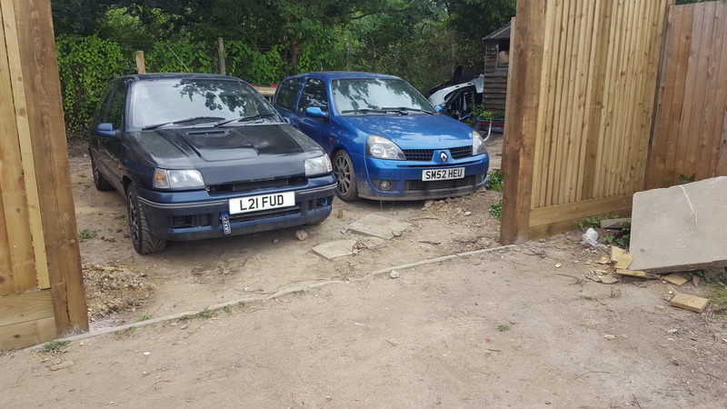

In my very own 'Yard'

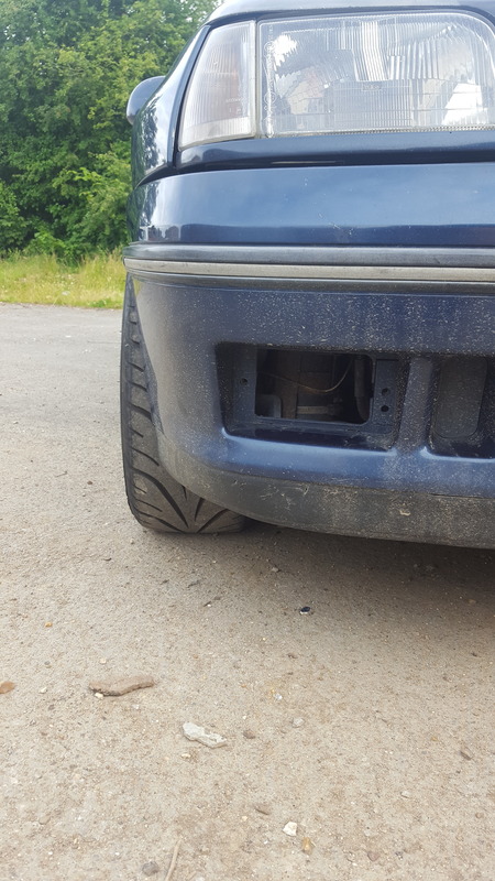

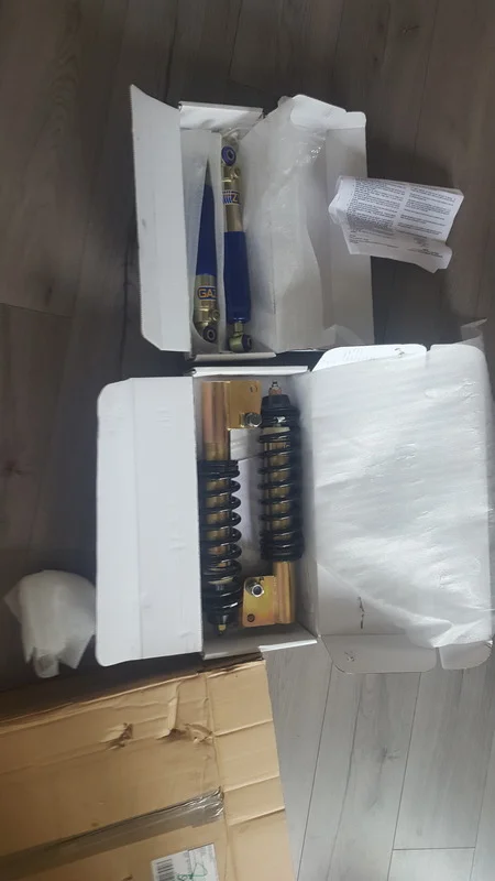

Im hoping to get the coilovers on this weekend, then the 4th mount and start addressing the stickers on the car

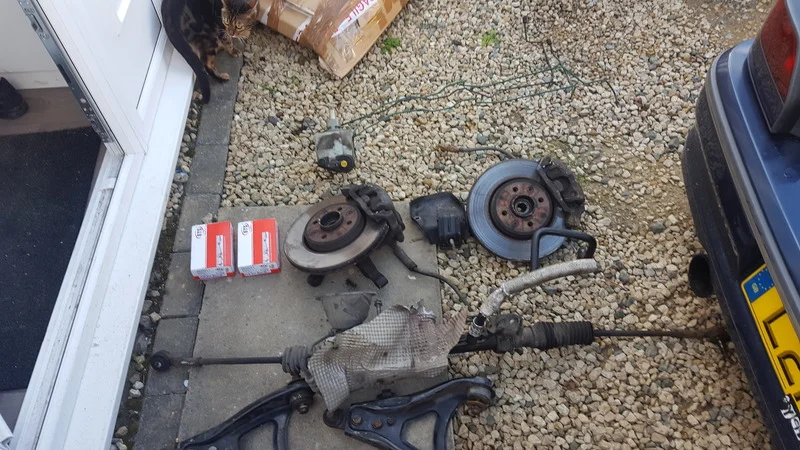

I do have to change my steering rack though as it has play in it, a mk1 rack is hard to get hold off and new bushes even harder so im going to fit a mk2 rack with the black polybushes and the 172 high pressure hose as it is different

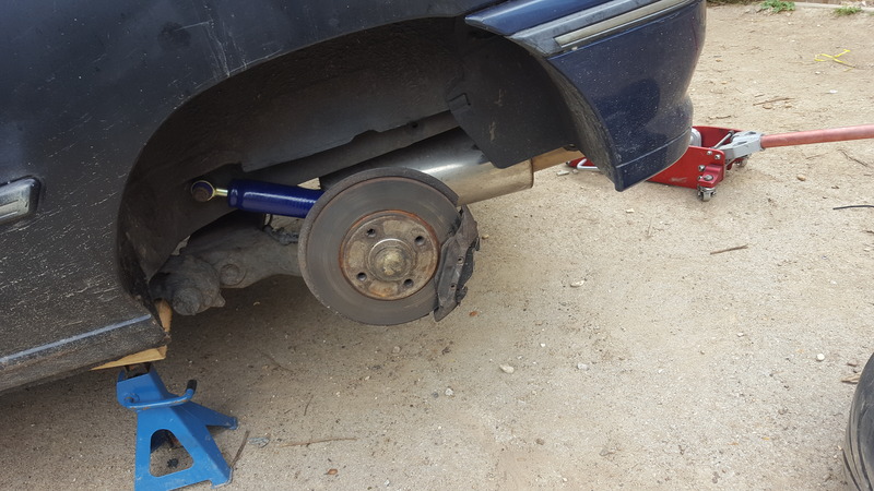

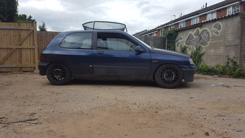

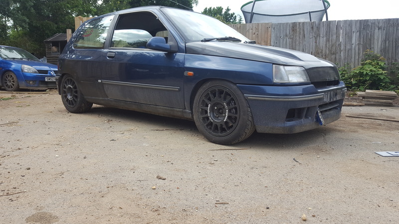

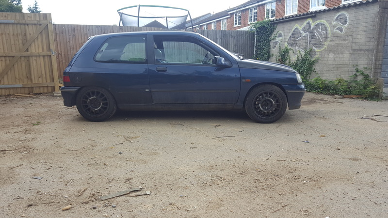

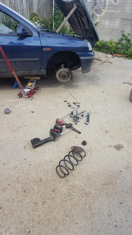

Got the coilovers fitted yesterday
Got lucky with my first guess of the height

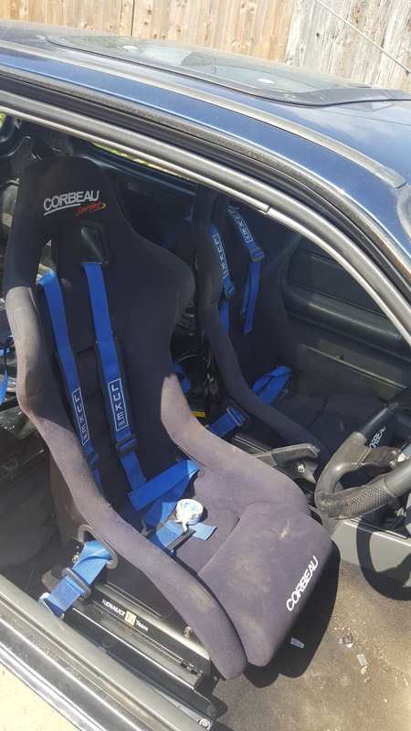

Seats bought and fitted (car hoovered afterwards) -

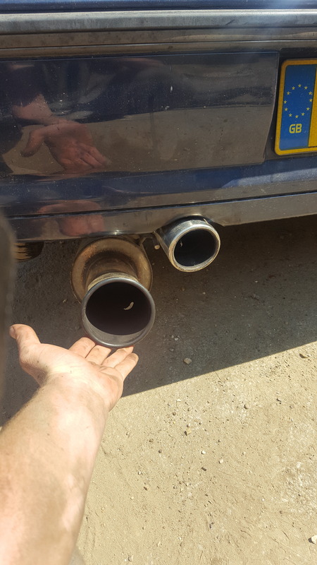

Magnex exhaust fitted -

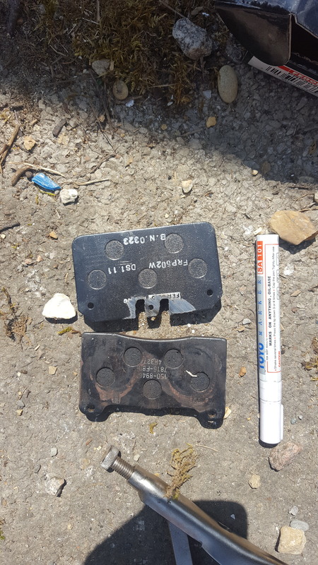

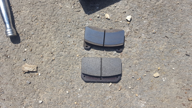

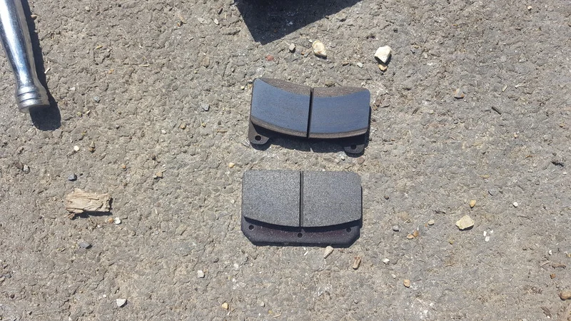

I then sorted out some better brake pads, on Georges advice i bought some DS1.11 they dont come int eh right fitment for my wilwoods but a bit of grinding sorted that issue out -

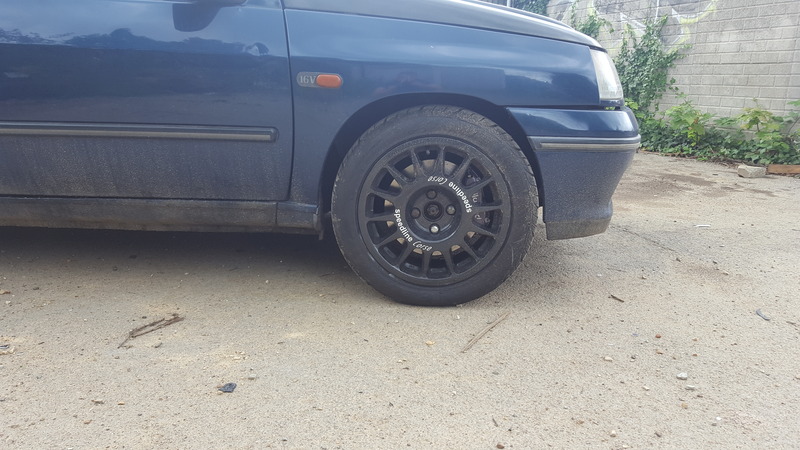

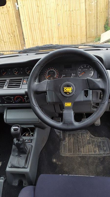

OMP wheel bought and fitted -

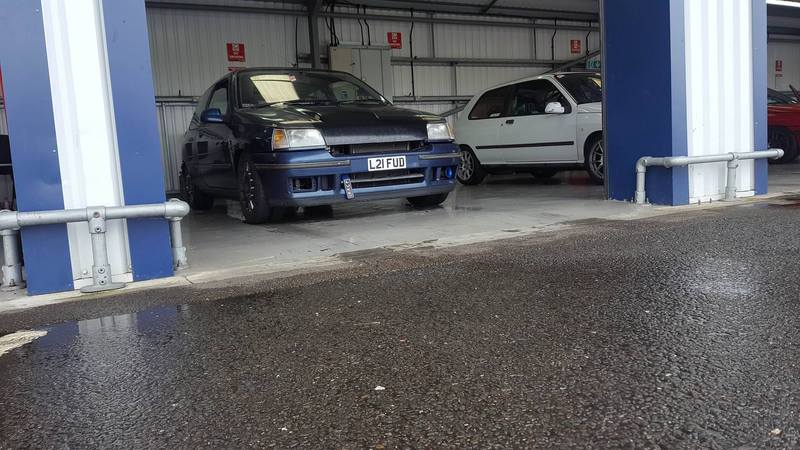

I did the renaultsport trackday at Bedford, it rained all morning and made driving around the track difficult however it dried up in the afternoon and i was incredibly impressed with the grip of the car, however with just 160-170bhp and not very much torque it really showed on the massive straight at Bedford, there was a couple of instances where i was much much quicker than cars in front on the corners and then on the straight they would pull to the side but because they didnt back off i couldn't get past them!

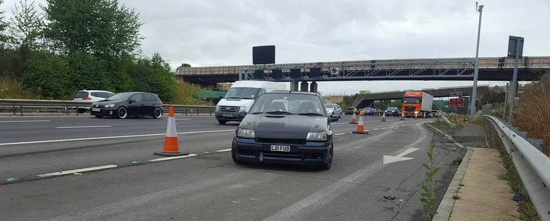

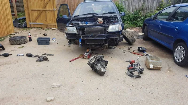

My day was cut short however with a CV joint rumbling really bad! so i left early to make a steady drive home, i got past Toddington services and lost the clutch to what i initially thought was a snapped cable, i got free recovery back to Toddington services where i waited until it was 9pm ish and drove home rev matching the gears, i got around a mile from my house and i lost all gears except 1st!

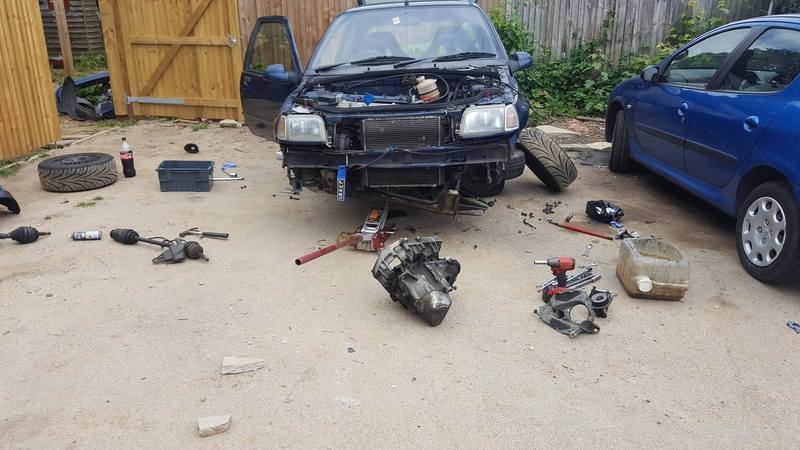

So the Following weekend i changed the gearbox to a 182 one i have, at the same time i also fitted a pair of ph1 shafts i had and a lower gearbox mount (not standard on a mk1) along with a brand new genuine clutch cable

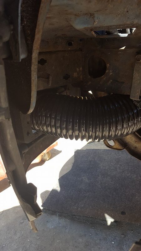

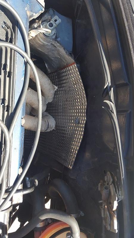

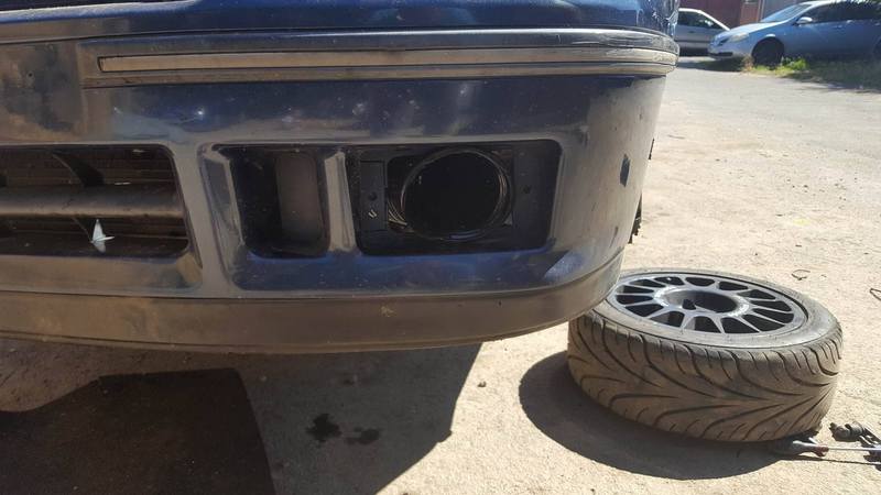

And today i changed the crappy air feed for a proper sized one and fitted a proper heatshield

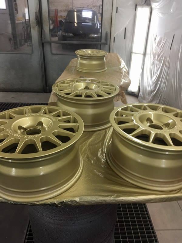

Lastly, im waiting for these to come back from France, then apart from bodywork im finished with the car (unless things break) im very very happy with how it performed at Bedford, it does lack power but i think once you start chasing that you dont stop!
