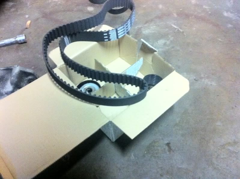

Got on the blower to my mate who's still working at Renault, he priced me up a genuine timing belt kit & genuine auxiliry belt kit, they were ordered immediatly.

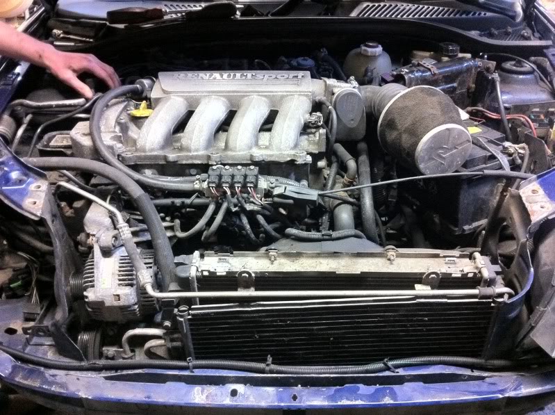

Couple of my mates were off on Friday past and waiting on my belts coming in and my mate being able to borrow the engine locking tools for the weekend we had a cleaning session at my bit.

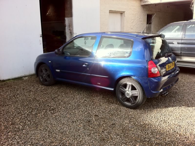

So Saturday past i went up to my mates farm where we get the use of his shed in exchange for mutual respect.
Arrived (The furthest i've driven the car, best 4 miles i've drove :lol:)
Some of the parts -

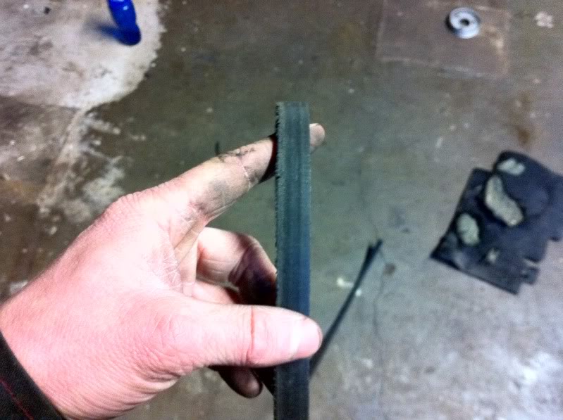

State of the auxiliry belt (Upon removal it became apparent the alternator was sitting like a bag of s**t)

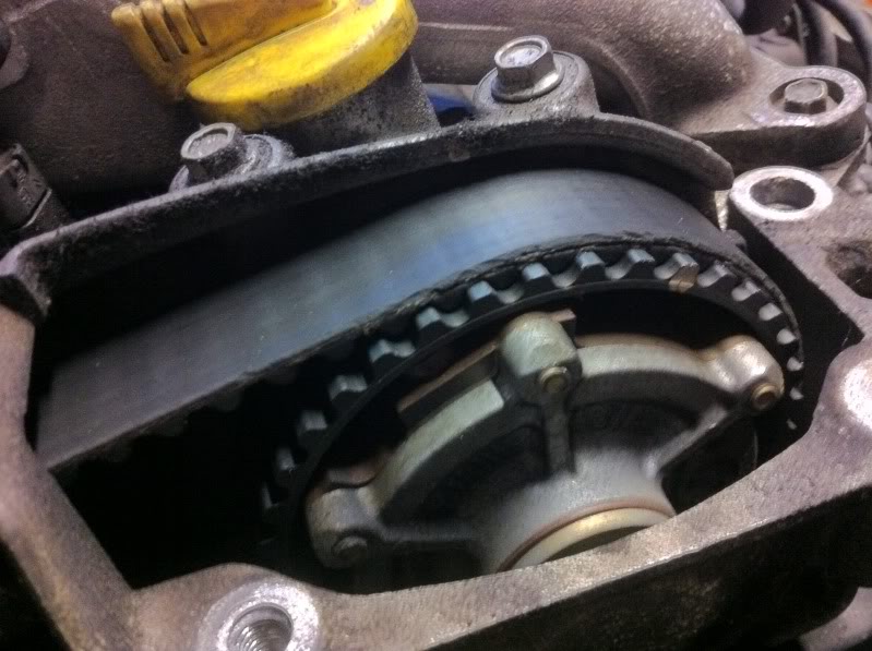

Timing belt had seen better days (And was also fitted the wrong way round, your meant to be able to read the writing from where i was standing, it was facing the engine)

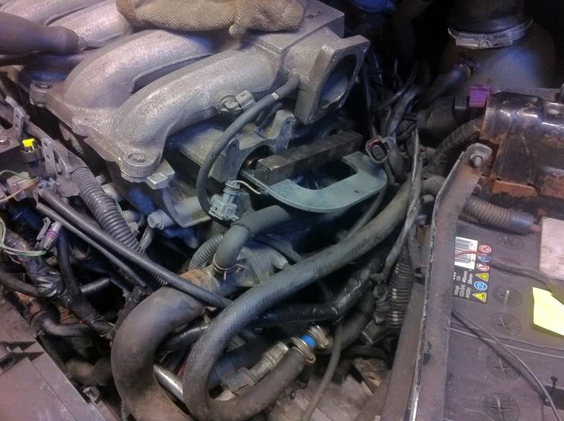

Cams locked up, crank pinned -

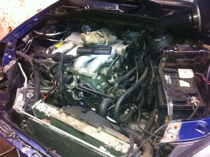

Various during shots.

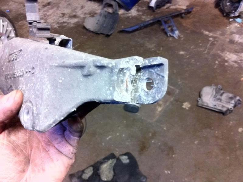

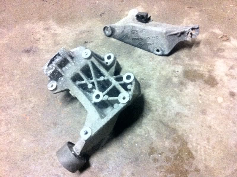

Timing belt is all done, i removed the alternator to investagate it's ill fitment.
Found that both of the mountings points were damaged and had been cowboy'd back together, which would explain the chewed belts.
So it's currently up in my mates shed in bits awaiting replacement mounts. :(
I dont know why someone would put it back together like this.

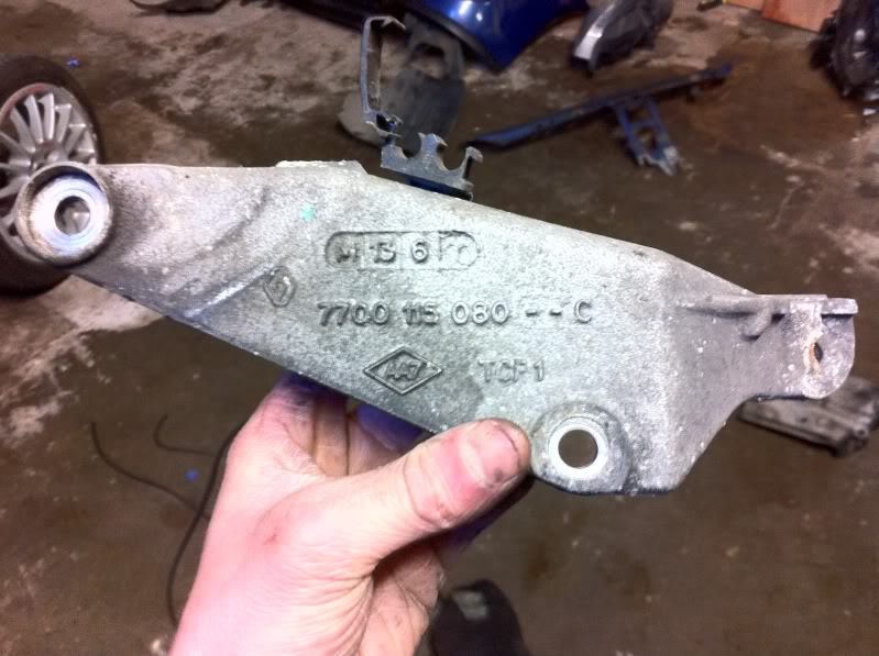

And the mount in the left of this picture is broken on the top left corner :mad:

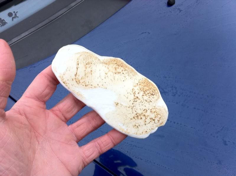

Just a little pointer about the claying - use about 1/2 of 1/3 of that .. if you drop it, it's game over but if it's only 1/3 of the bar you've no need to waste another one :)

I have a couple of claybar's i've gathered over time, already lost one through dropping in a puddle lol.

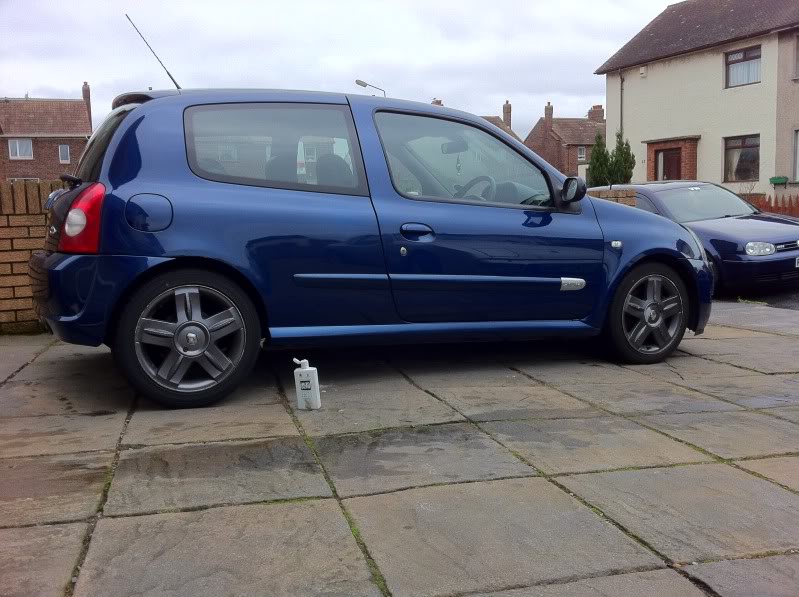

Out and about in the recent good weather.

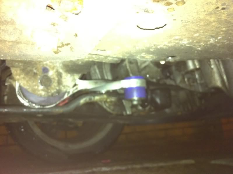

That dogbone is fitted upside down and you're supposed to remove all of the old subframe end bush before fitting the new one.
Can tell you used to work at renault ;).
Yeah i did notice i had put it one upside down after i took the picture i've flipped it the other way now.
I dont get what you mean about removing all the subframe end bush ? The old bushes were fully removed, and i was left with the bare mount minus bushes ? Maybe the picture isnt very clear.

Might just be the picture but looks like the metal outer of the subframe end bush is still in place with just the rubber removed.

It was pissing down with rain, i was soaked to the f**king skin, i took a picture, realised what i had done in haste, corrected it and went inside to dry off.
