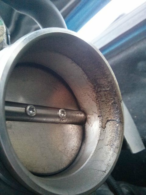

Also, revs were sticking and also had a rough idle so had a go at cleaning the throttle body...

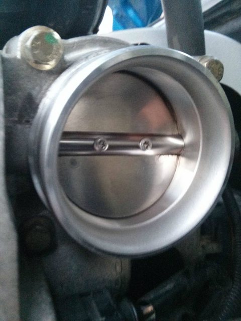

and after...
Car is pulling quite a bit better now and also idleing better... fingers crossed.

might want to remove the throttle body to clean the back of it if you can. Vast upgrade from a 1 litre corsa, a mate of mine drives one and well I dont really have words for its performance and refinement or lack of haha
