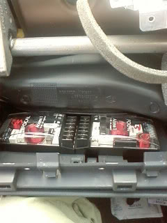

Fitted some infinty kappa comps over the weekend sounds great much better!! i know the locations of the comps wont be to everyones taste but i like it heres some pics
with this not sure what to do ??? want the speaker on show like this but not sure how to go about it?
if i cut out the grill part then would look ok at the bottom but not sure how to go about the top part as it wont look flush if you get what i mean?
any thoughts on what to do ?
Thanks
Without seeing the extent of the problem, I would be looking at bringing the speaker to the door card rather than cutting the trim up.....You can usually achieve this using multiple MDF baffle rings as spacers, but obviously this all depends on any curvature of the stock plastic shrouds, (always best to obtain a spare set to work with & save the originals for future use)......
