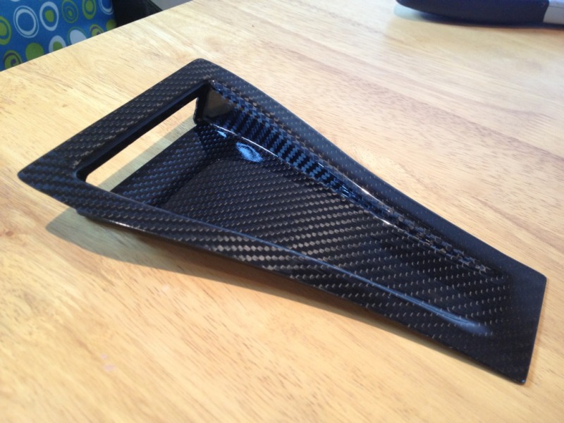

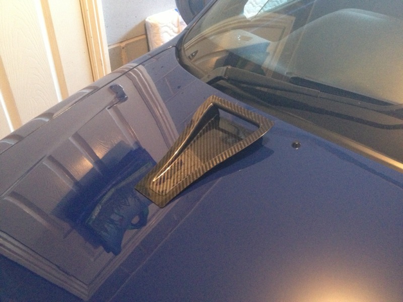

that duct was exactly what i was planning to do wont bring in much air but itd help you could get some large pipe cut it in half cut the bonnet back at the back and bolt it to the bulkhead. to give the same kind of effect as the type r intake just scoop the air in.

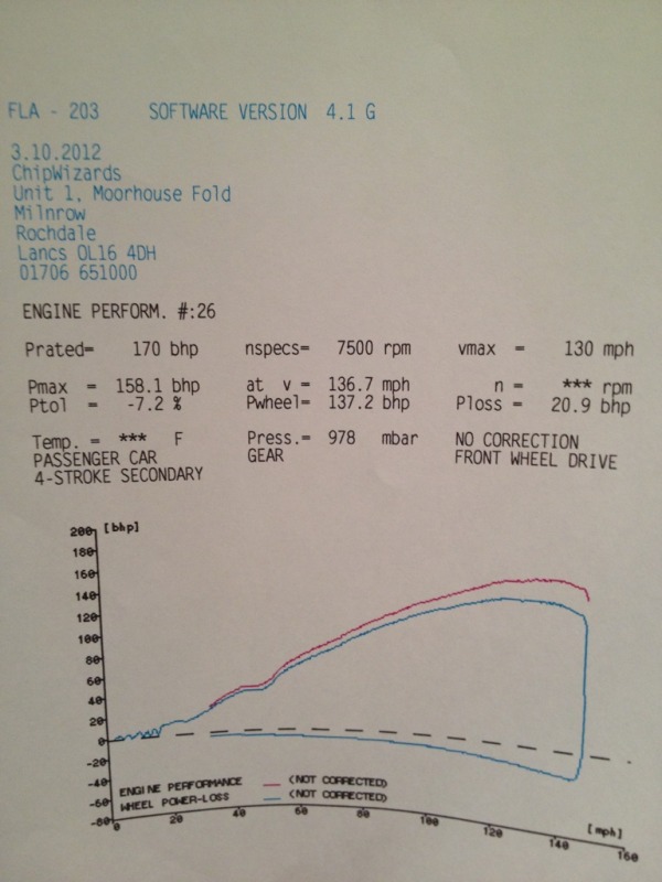

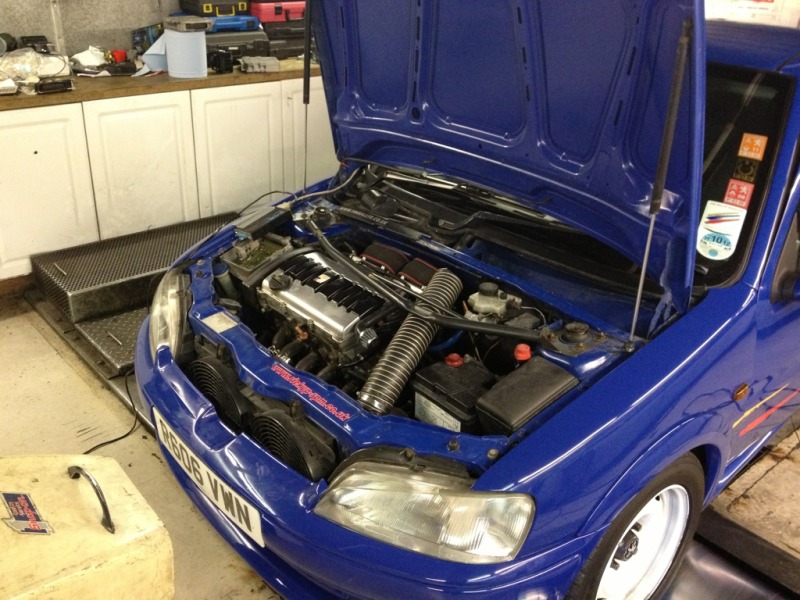

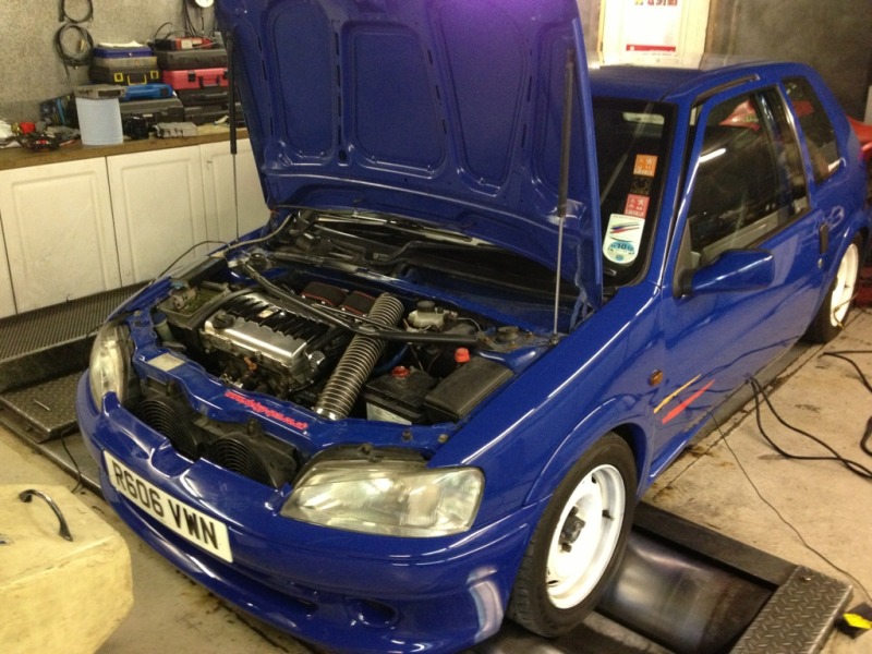

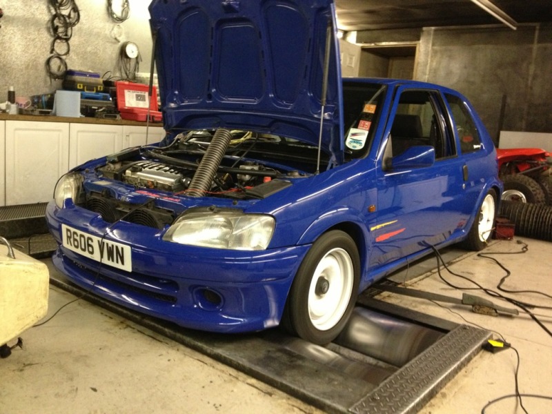

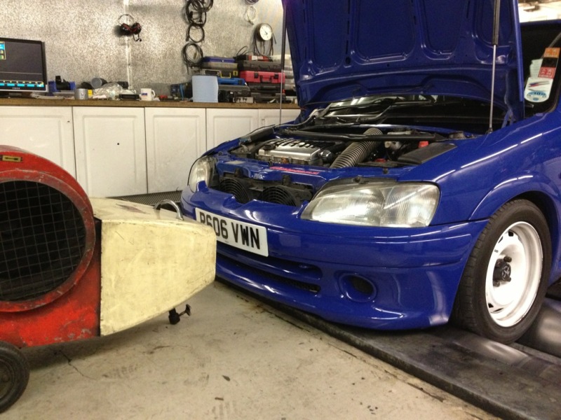

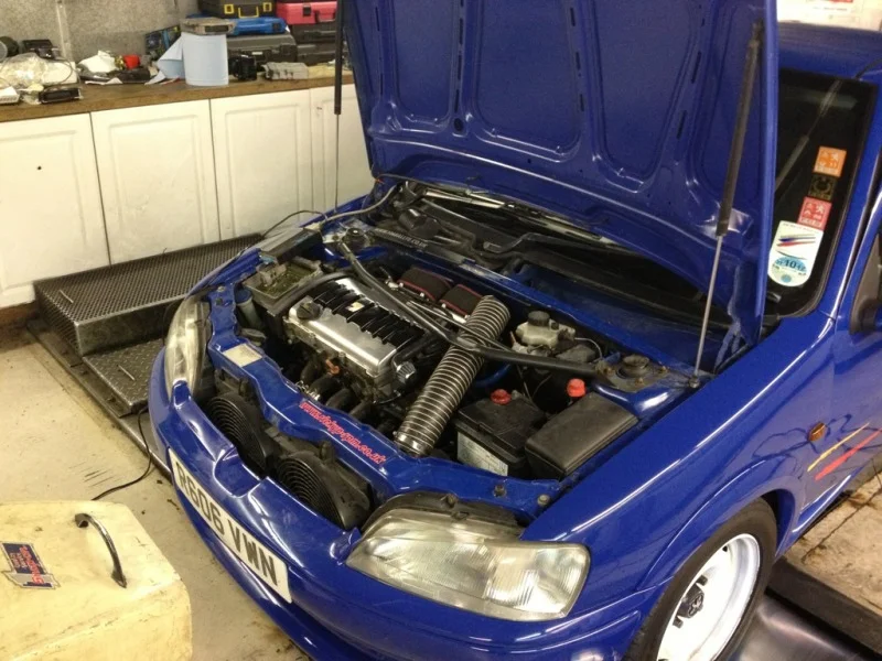

Had the car mapped today as just wasn't running right on the ecu I had bought. I had it done at chipwizards as Wayne there is one of the best at mapping the standard ecu.
The car made 158bhp ATF and to be honest I was wanting more. The filters im using are no doubt holding back the horses a little. The disappointment though was short lived as the remap has transformed the car. It just feels so much smoother and more responsive and a far better car to drive.
Some pics;

Almost 2 weeks until this update, there's me thinking you were going to announce you'd sold it :p.
Carbon should look epic.
leeds_182
North Yorkshire & Humber
Not had it fitted mate. Cars running like a dog so have just put it in the garage and am pretending its not there.
