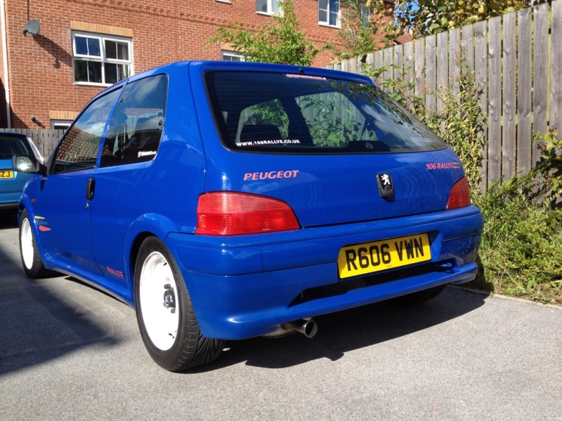

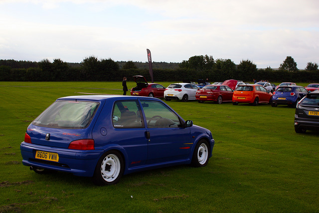

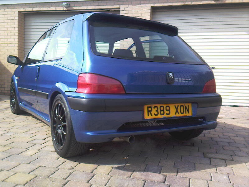

You may want to check the pugsport is on the right hangers mate, seems to be sitting very low
Pugsports sit wonky, you need to cut the mounts off and reweld them on :( s**t quality exhaust but you won't get much else that will rasp like it.

Just had a look at the kam racing 'version' which looks a better quality and better fit exhaust..

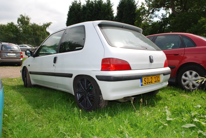

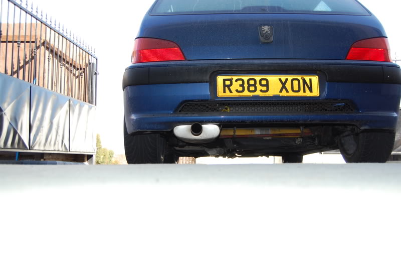

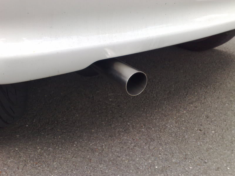

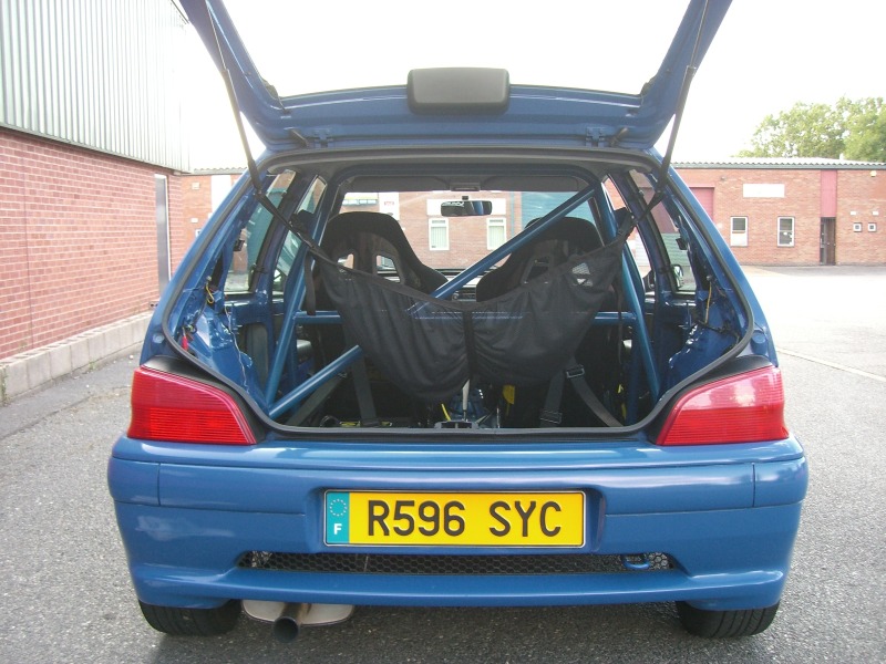

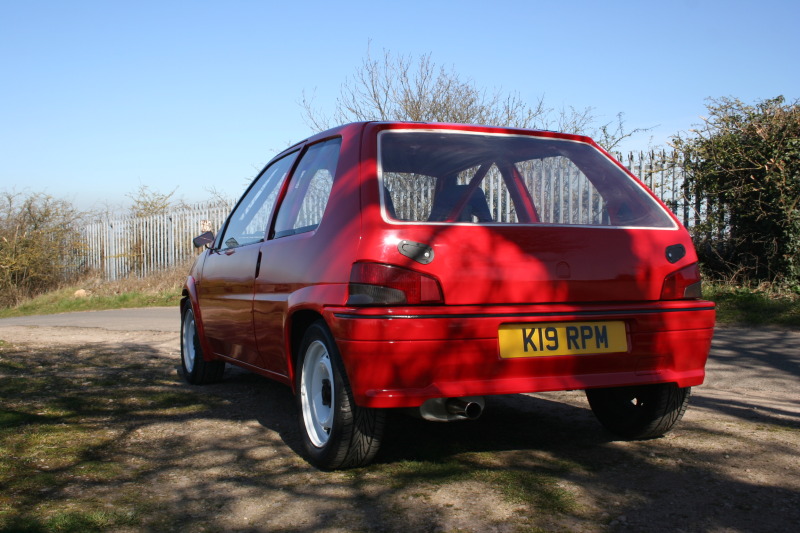

mine used to sit fine on my old s2 and again on my s1, i could find pics of the other 2 rallyes ive hasd with pugsports but im sure you get the picture.
Chris205
  Many Things
All of mine sat propper too

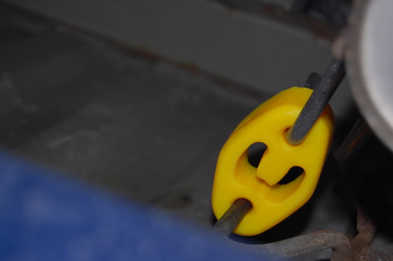

Always used the powerflex exhaust hangers on mine, much better and no movement issues

Nice mate, mine was only on one hanger at the back! The rubbers look fooked though so gonna order some others. Was it a specific size you ordered for yours?
Chris205
  Many Things
I used to get them from halfords mate, just take the original off and take it down there, most larger halfords stock them from memory, although that was around 4 years ago lol
I cant from the top of my head remember what size it actually is, they did a few different shapes and sizes so I matched up my original to the ones above
Marv off 106owners told me that was the case. A friend of ours bought a 2 inch pugsport to replace his 3inch system and it sits wonky. I suggested the mounts were on wrong but got shot down as soon as I mentioned it.
leeds_182
North Yorkshire & Humber
My cable tie exhaust fix lasted a mile so ordered some powerflex mounts which should hopefully solve the problem.

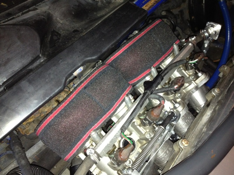

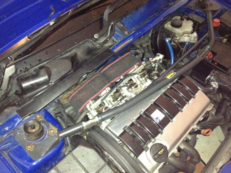

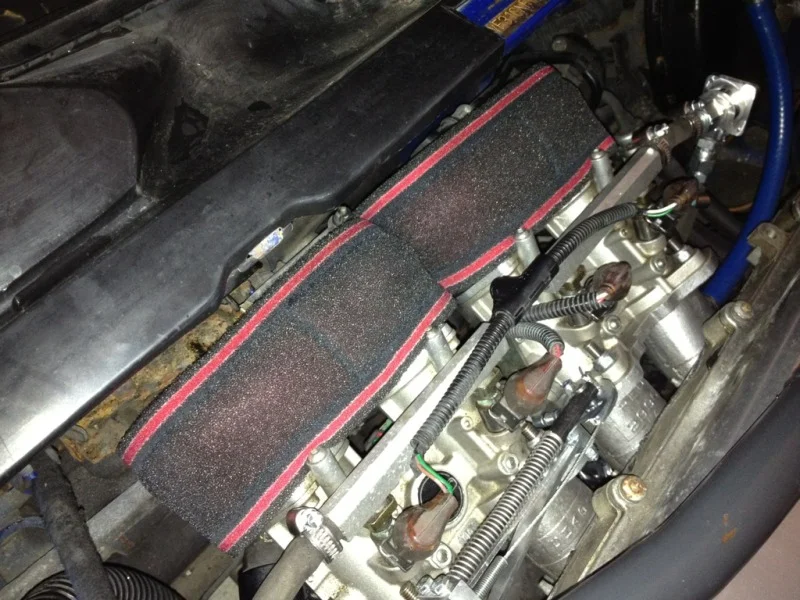

Due to having no space in front of the trumpets I've had to resort to dual piper cross trumpet socks to give me a little filtration;
