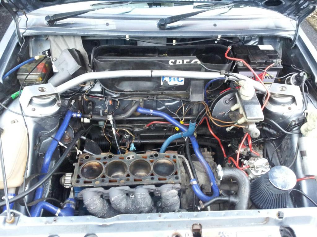

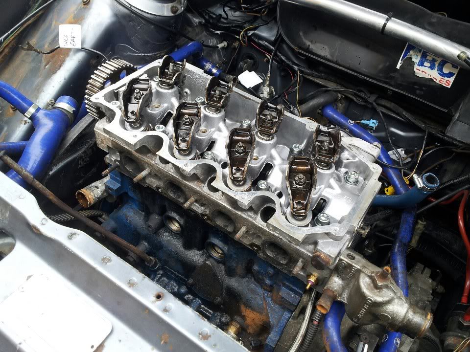

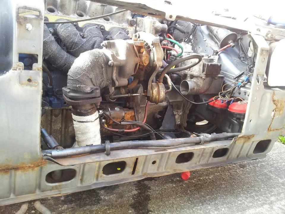

Got the head back on

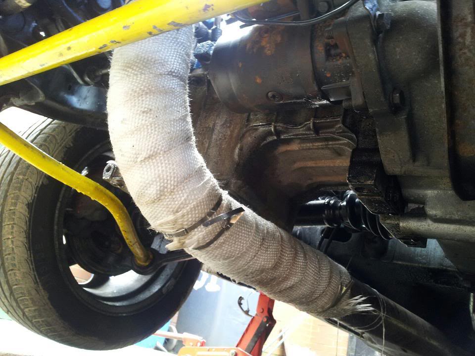

Downpipe wrapped
Threw it back on

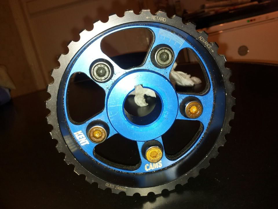

Kent vernier involved

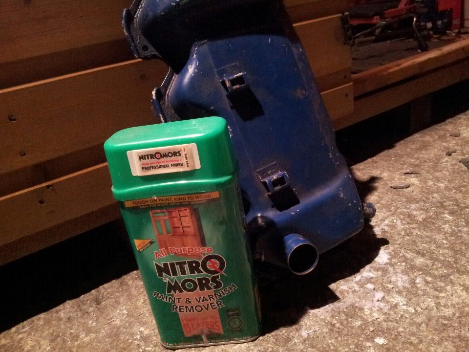

So a quick brush with the good stuff
That will be being painted up soon.

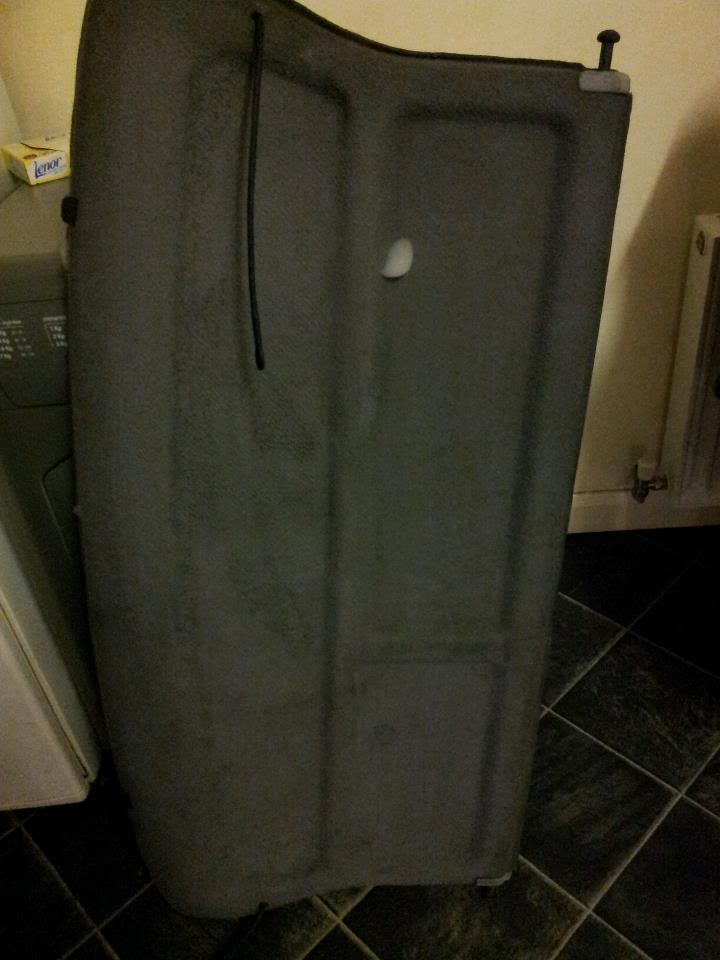

New parcel shel;f as mine had some awful 6x9s in there

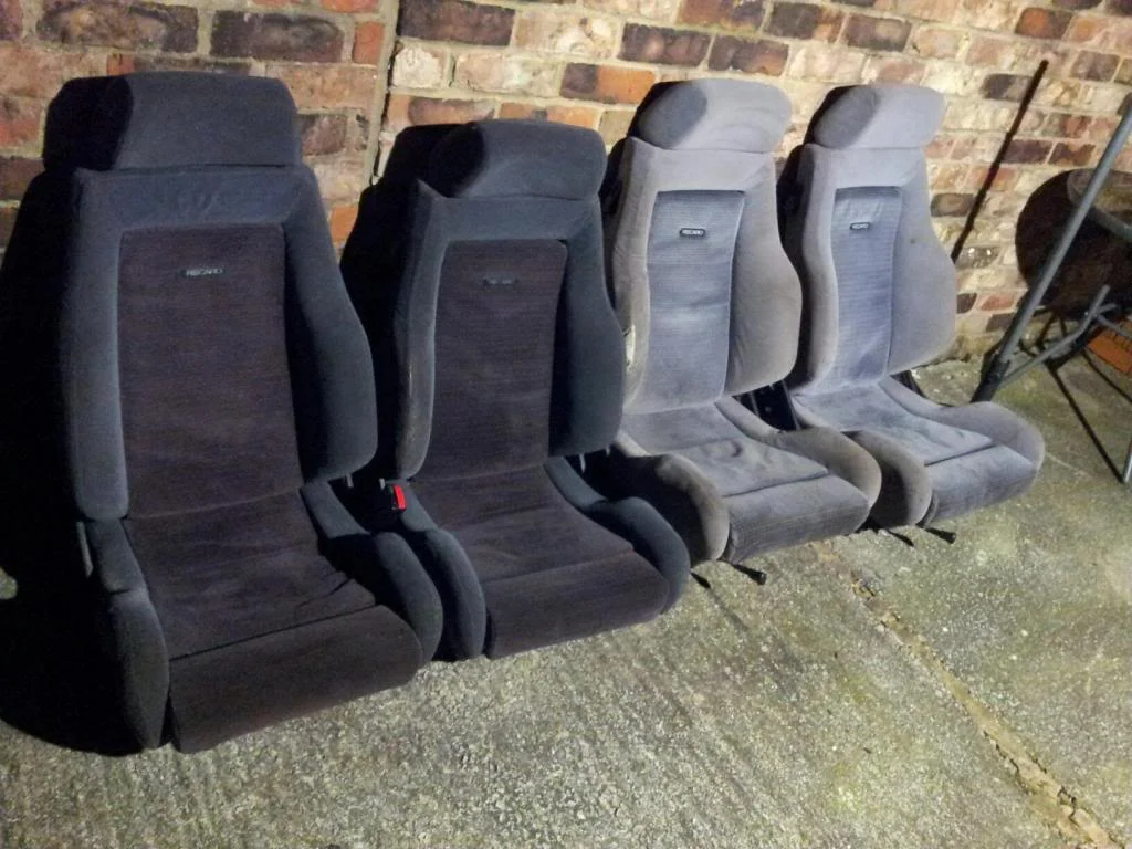

The other night I sent to put my 88spec seats in

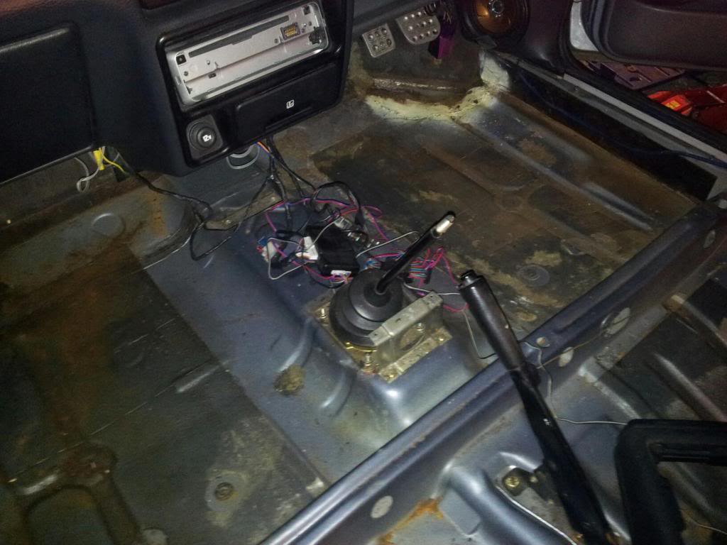

However, on leaning in, I noticed the passenger footwell was proper piss wet through. Annoyed by this, I went all out
Ripped the lot out and soaked the car. Turned out to be an old threaded hole from the previous batter tray. So a quick bit of loctite and a 13mm bolt solved that.

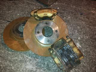

That will be my brakes then
Sierra cosworth 2WD 4pot calipers and pistons!!! WINNING

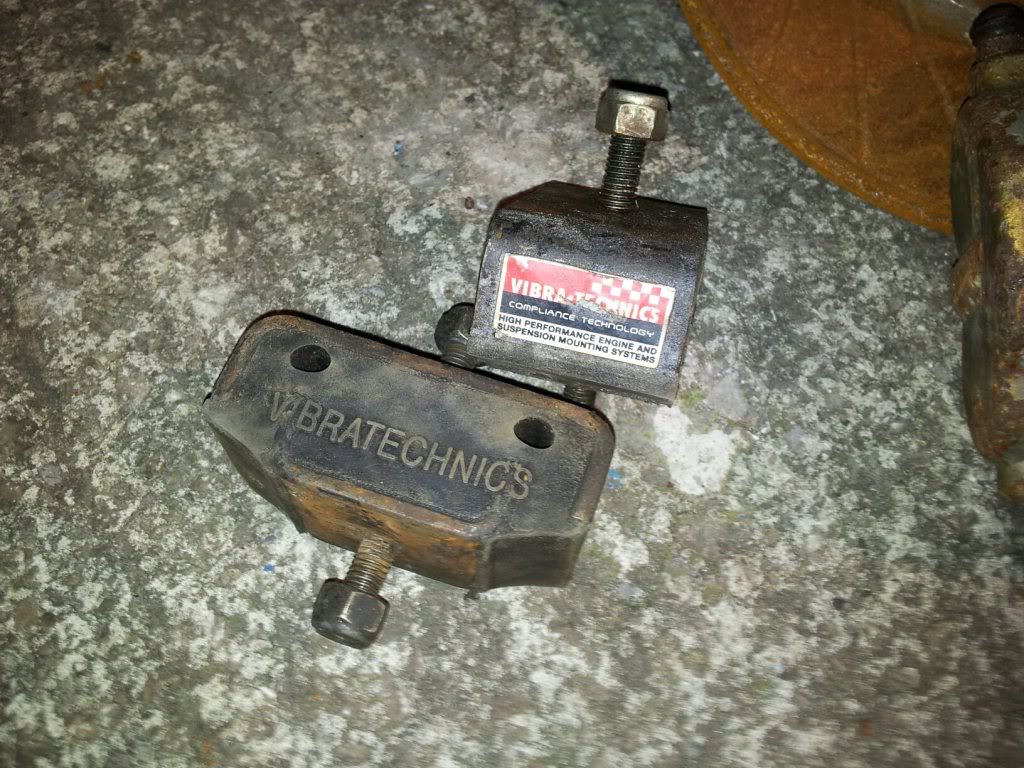

Oh, and some vibratech gearbox mounts

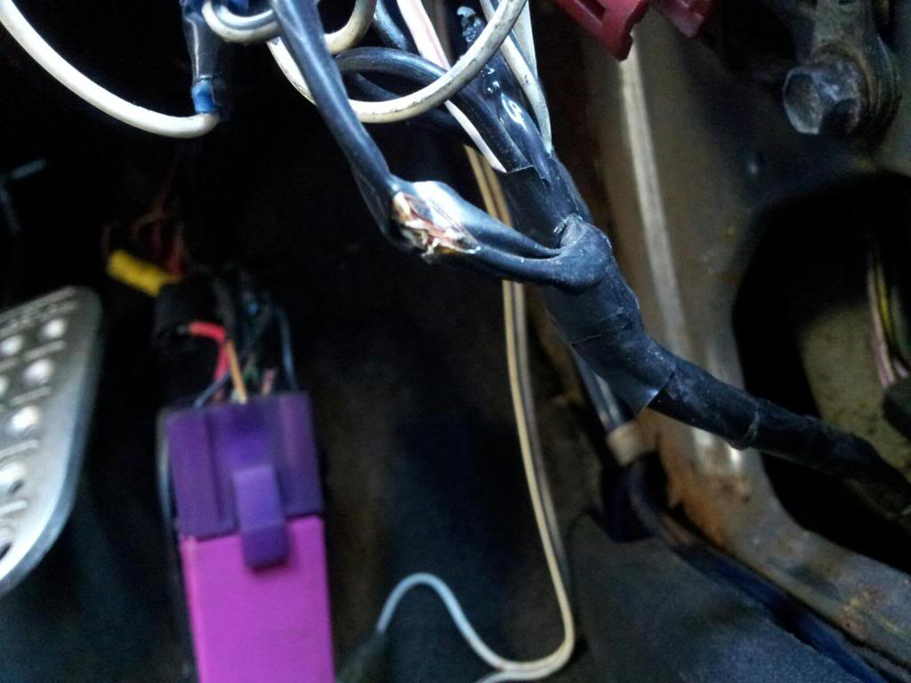

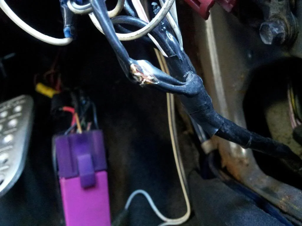

My mate is having it next weekend to sort this lovely bit of wiring out
Once that's done we will know if its getting the proper amount of juice to the fuel pump to flow properly, and it can be set up.

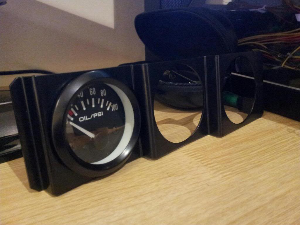

In the meantime, will install my gauges where the radio was, so I can keep an eye on oil pressure, oil temp and boost

Diod some r****d have it before you?
3 in a row I think mate.

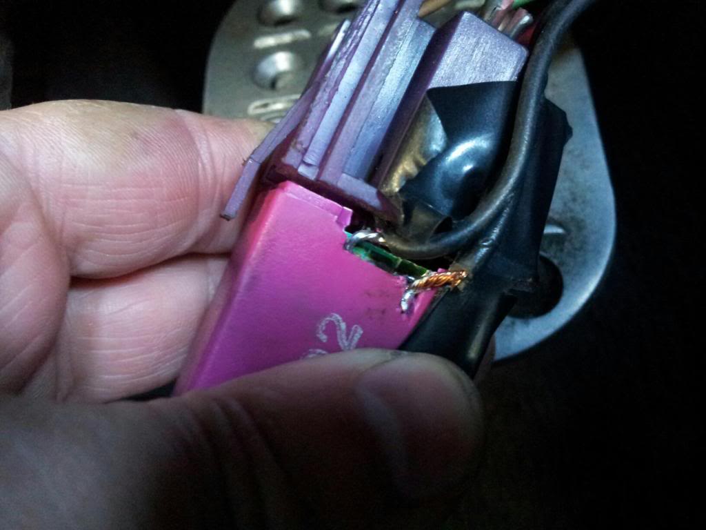

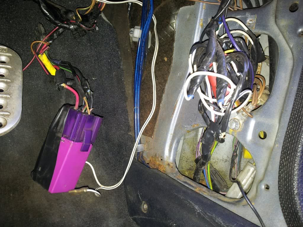

The last owner I spoke to him the other week and he was moaning about wanting his stereo back. He can f**king have it. That badly wired sack of s**t was the reason the battery kept draining. f**king speaker wires used for power :mad:
It's on the mend now anyways

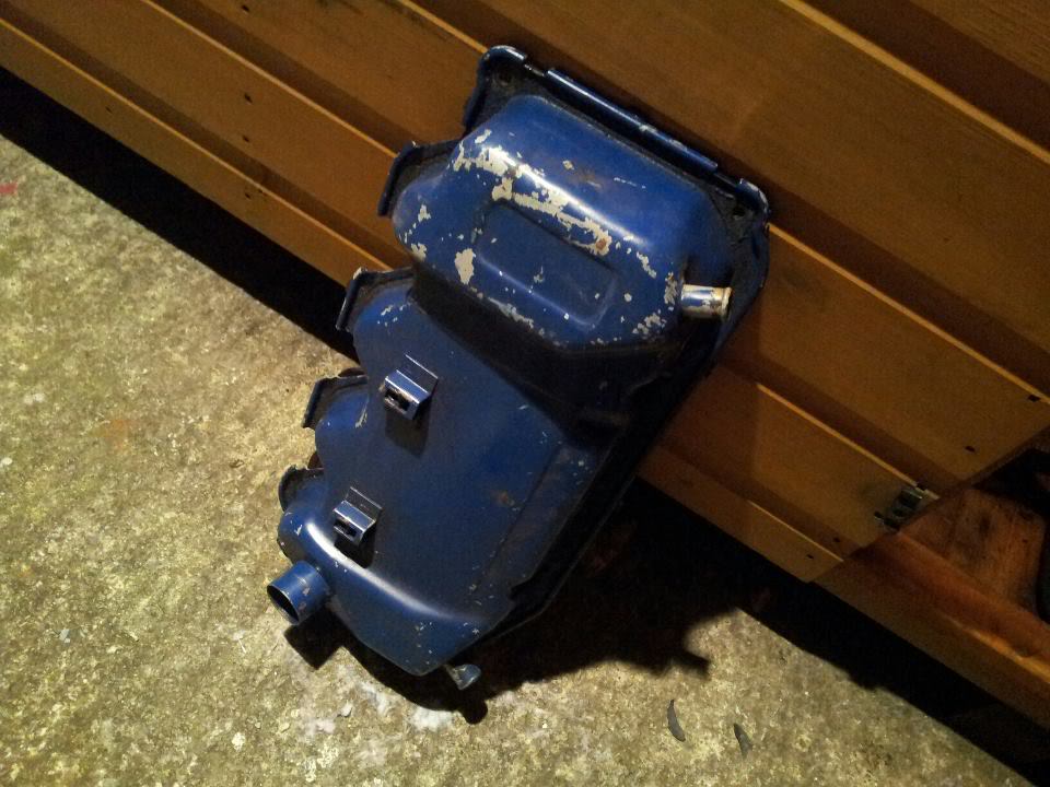

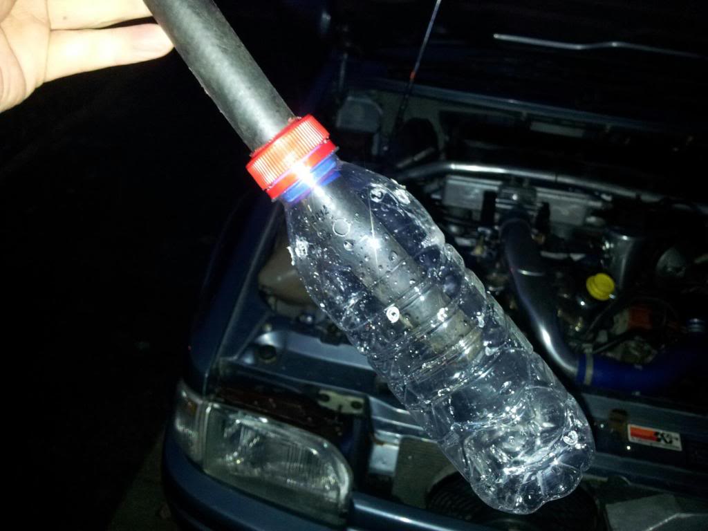

So, bottom end seems to be breathing a little heavy at the moment. I am not sure if this is down to where the oil return is plumbed in, or whether the rings are fucked. I will do a leakdown test this week. In te meantime, homemade catch tank FTW

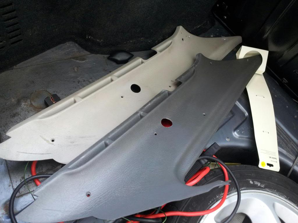

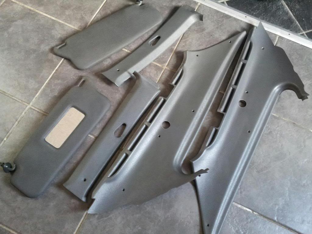

Then I took to installing my older 88spec trim panels instead of the creamy 90 spec ones
You can see the difference here

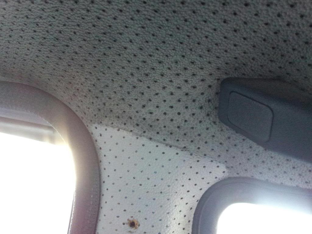

and on removal of the panels, I was greeted by a lovely sight
ewwwww, thats f**king GRIM!!! I cant wait to find an 88 spec head lining

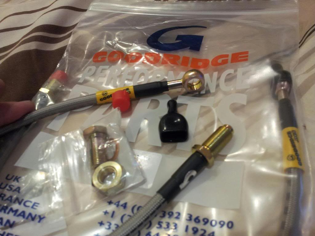

On the upside though, my Goodridge banjo-ended brakelines have turned up
That means I can now fit my cossie 4 pots and 283mm grooved discs.......... AWESOME!!

So, had the car running for a little while. Used it for a couple of trips here and there. Had it booked in with my mate for its rewire this sunday. However, on thursday night, the car had other ideas.
Drove to Morrisons in the rain to get some food. Car started to misfire a little, then cut out. Rolled it into a space and went to do my shopping. Got my mate to come tow me home and ditched it on the drive. No way I was pissing about in the rain.
So lay in bed later that night and though "I am sure that fuel computer was beeping at me when I set off, but the gauge said 1/2 tank" LOL. Ran out of petrol havent I.
Next day, waled to the garage, got 10litres of suer, poured it in, and proceeded to turn the key.............. f**k all. Just turning over. Hmmm.

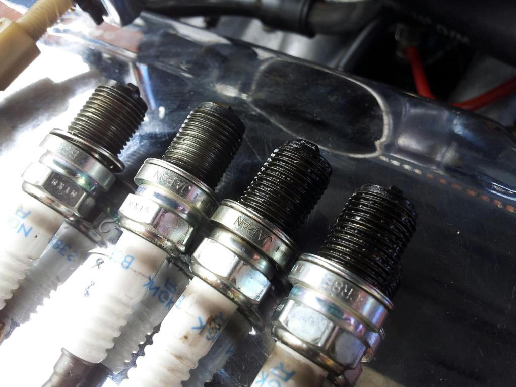

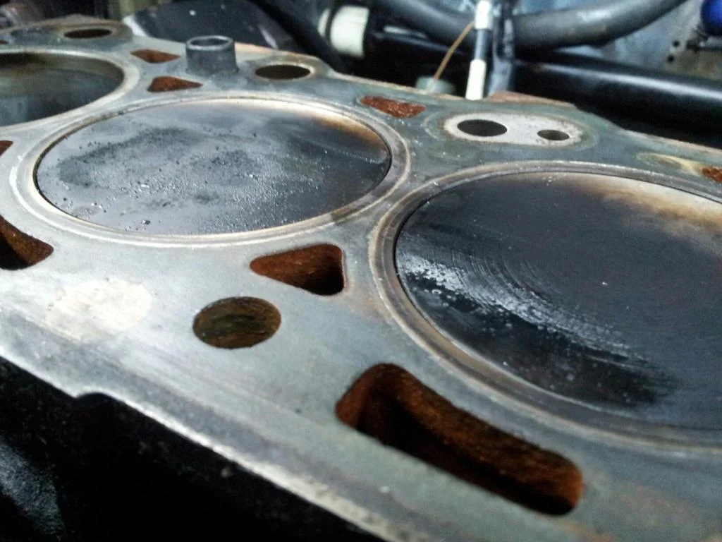

So, I whipped the plugs out to check them

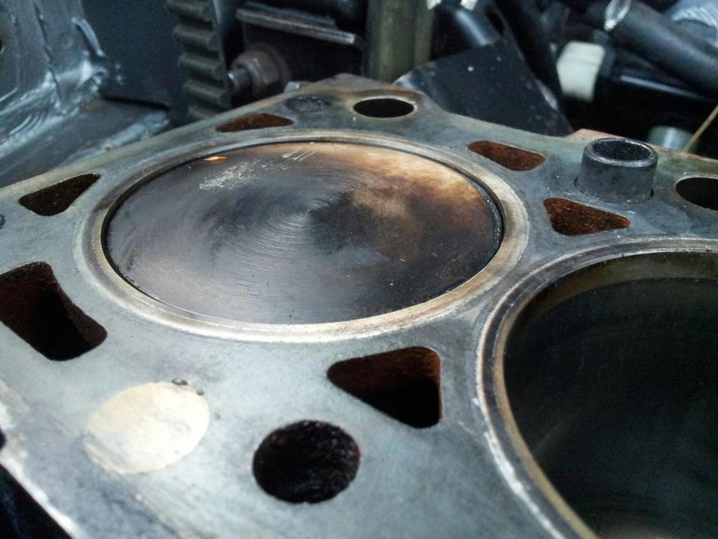

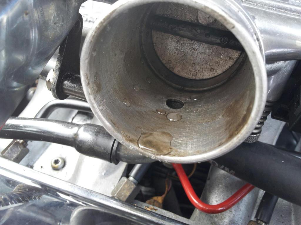

Oh deary me. They shouldnt look like that. So, then took off the top boost hose
At this point, I just wanted to take an axe to every panel

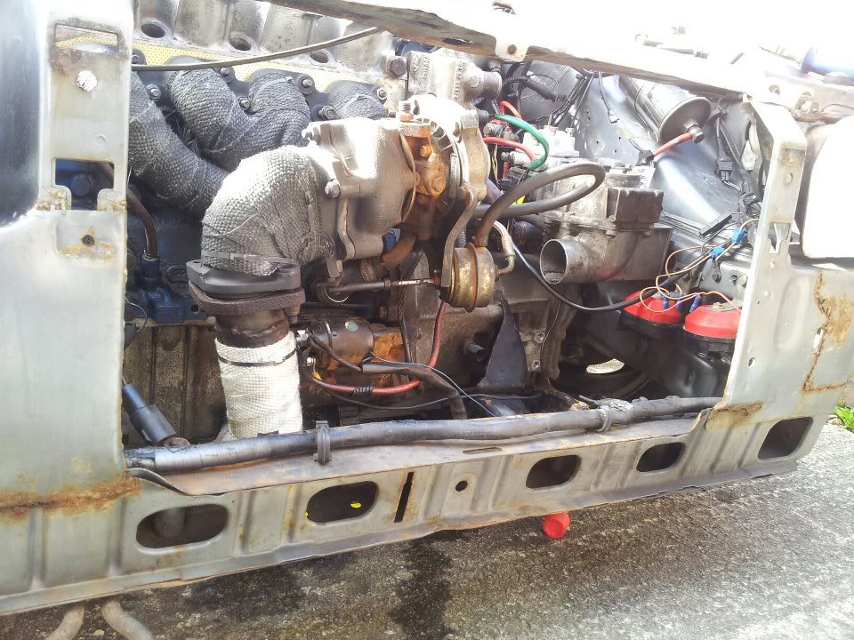

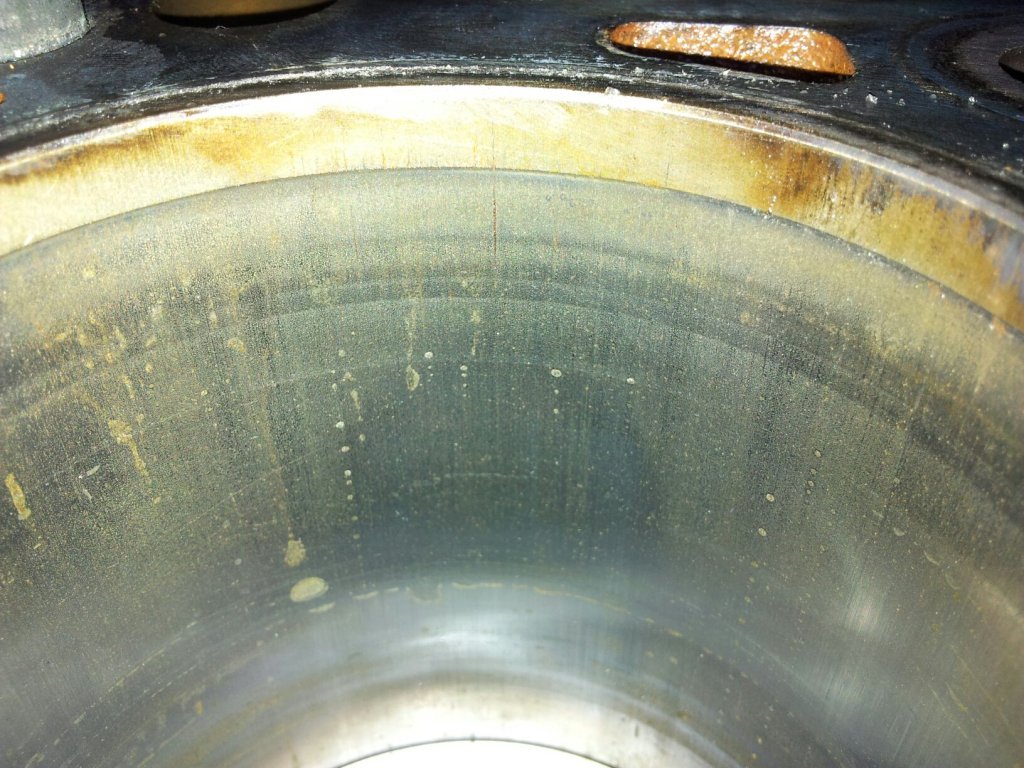

Seems the rain has been pissing through the bonnet vent onto the shitty K&N cone filter, seeped through and collected in the metering unit. As I have turned left into the car park, its all poured into the boost hose and been sucked up into the engine, hydrolocking it, probably bending a rod. So, all that hard work over the last couple of months has gone to s**t, and the bottom end is now scrap.
So I better get stripping it down ready for a replacement engine
I think thast rod may be bent
Bores seem to have a lip on them anyways, with no hone marks

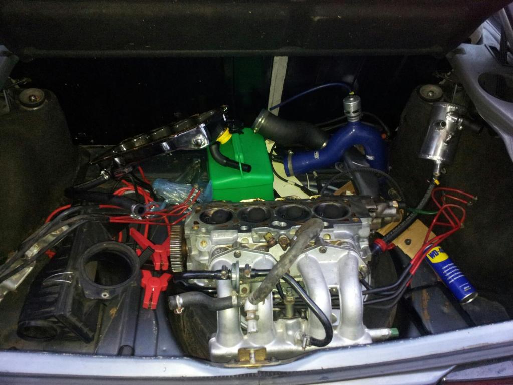

and as it stands, a boot full of bits
Plan for this week is speak to engineers, see how much to block oilways in another zetec bottom end and braise oil breathers into the block. If that cost is going to be sky high, I will throw a standard 1.6 CVH engine in it.
