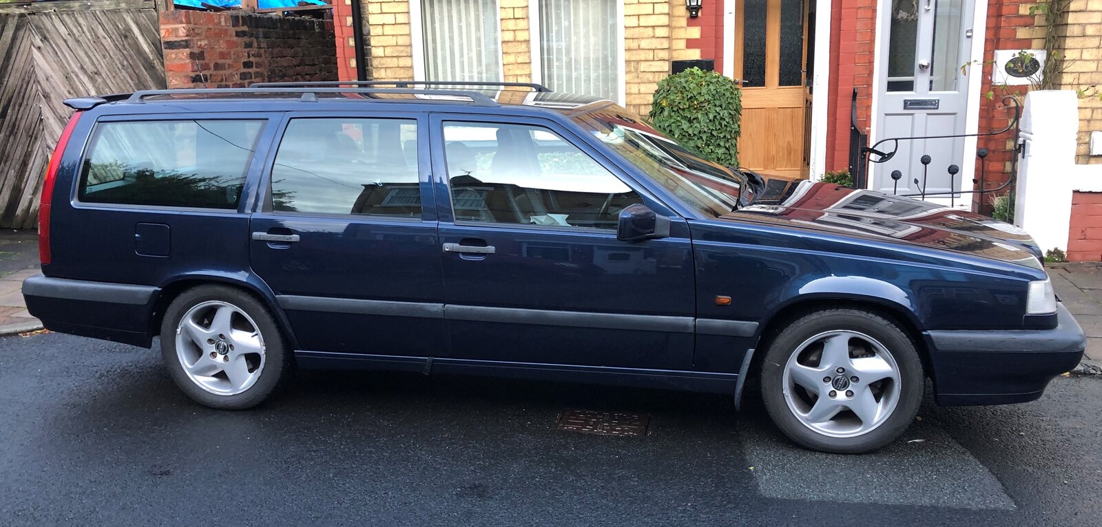

My New Volvo 850 T5
charltjr
Mine.
All mine.
It's an absolute cracker. Few issues I need to sort - bit of a vibration under braking sometimes, a battery drain which I strongly suspect is down to the crappy old immobiliser and the windscreen has picked up a stonechip.
Such a pleasure to be back in an 850 again, sure other cars are technically better but it's just a lovely old thing to smoke around in. Seriously comfortable, and what a lovely engine.
Funny how things work out!

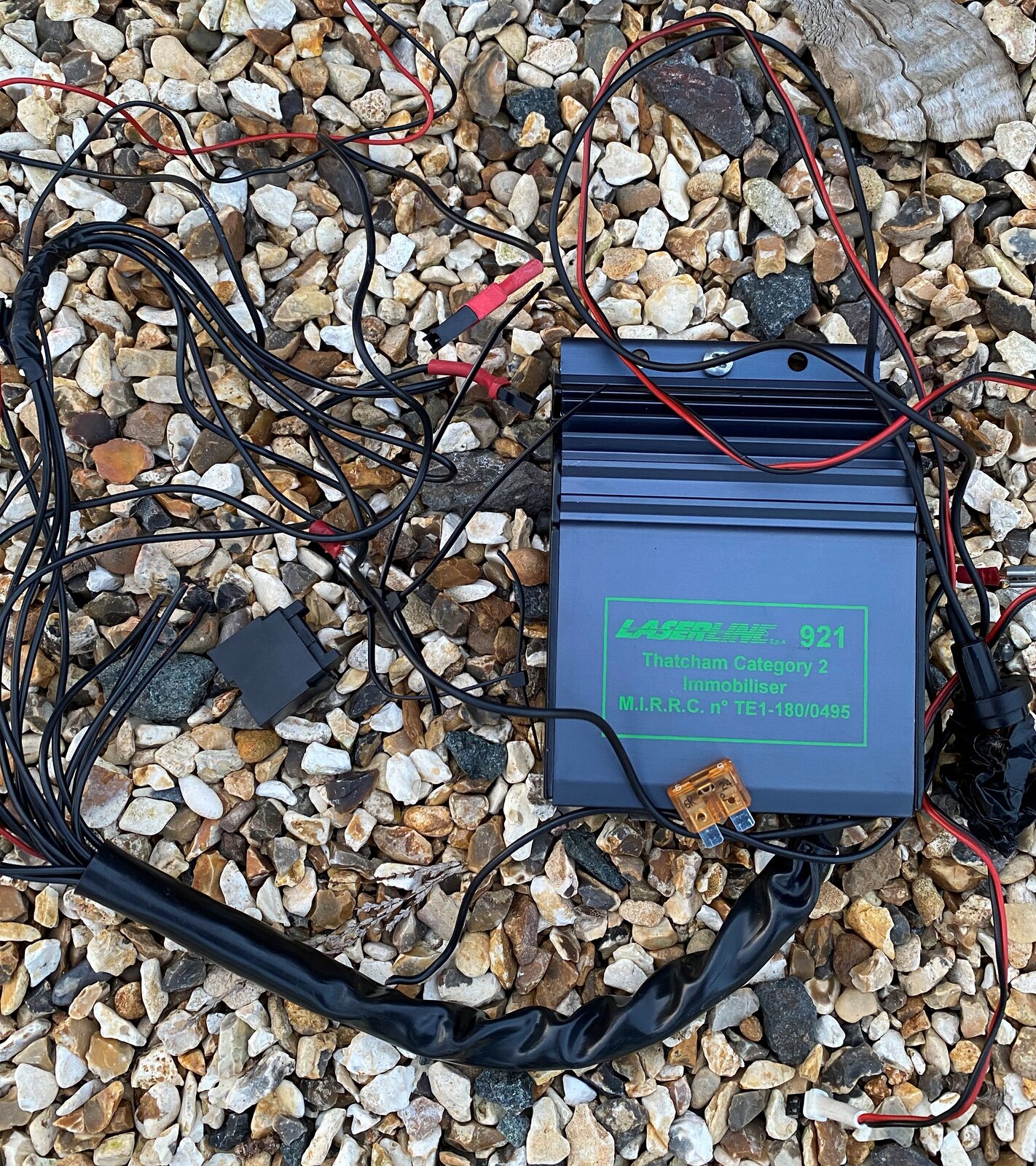

Then I decided to chase down the battery drain, got my meter attached to the battery and pulled each fuse one by one. No change. This is actually a good thing, because that tells me it's likely to be something aftermarket which has been wired directly in and my suspicion was always that it was the aftermarket immobiliser which wasn't actually doing anything other than flashing it's LED all the time.
So out came some trim panels and half an hour of really intense swearing later - victory!
And the car still starts!
And the battery drain is still there!

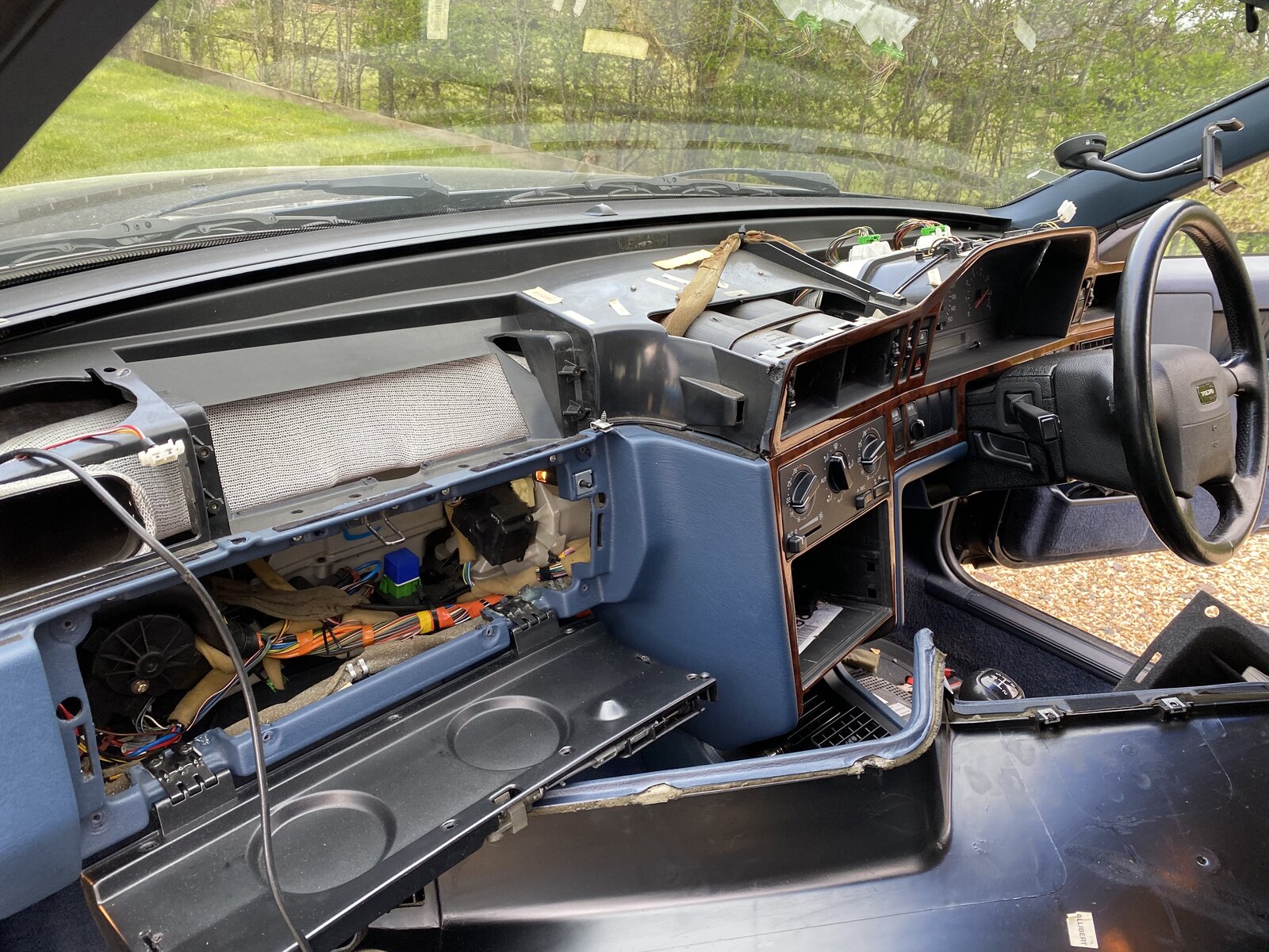

So I'm running out of ideas. I know the car did have a mobile phone kit installed at some point, so I'm chasing that down too. More panels removed, glovebox out, wiring traced. It looks like I'm going to have to take the dash off to get at what might be the control unit for that. I'm wasn't really that bothered about the battery drain, as long as the car doesn't sit for more than a few days it's fine, but now it's a matter of honour :ROFLMAO:
I will sort it out, oh yes. Or I'll get bored and say "f**k it". One or the other.
charltjr
I may have got carried away hunting for rogue battery draining components. I found a wire which was clearly part of an old mobile phone install and decided to chase it back to the source. Yeah......
Anyway, it was the (unpowered) lead to the antenna. Balls. Still, it all went back together fine and it was nice to find no nasties. It’s a seriously clean car.
