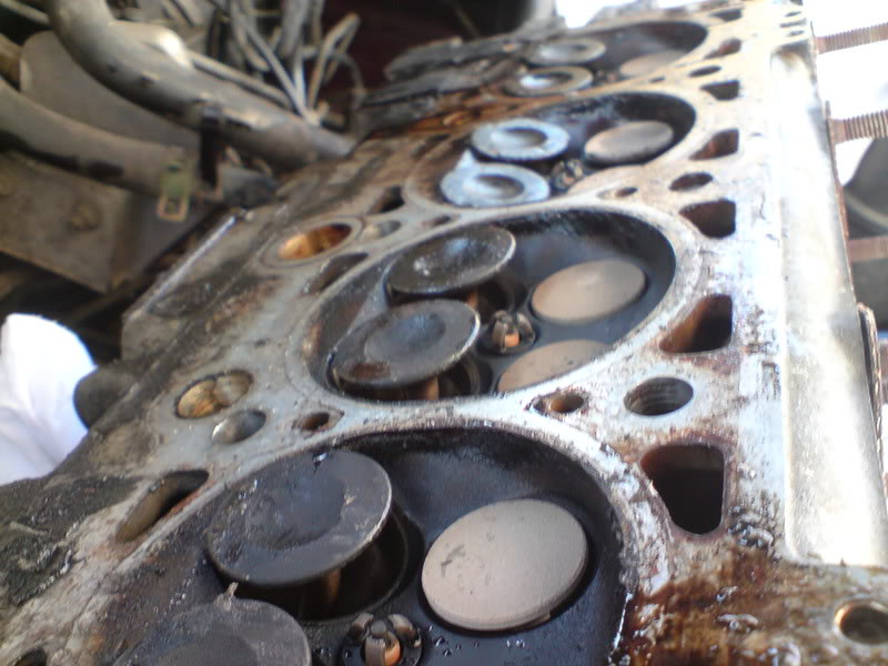

i got this for free,still taxed and tested,a mk3 golf gti 2.0 16v,just wouldnt start
sounded like the starter wasnt engaging,till i noticed the alternator spinning..............no compression,so off with the filler cap,no cam movement,took the belt cover off and its stripped all the teeth of the bottom of what looks to be the original belt lol
so with cries of 'off with its head!' 2 hours later and hello bent valves:
so as i work for vw il be ordering some new valves tommorow then lol
