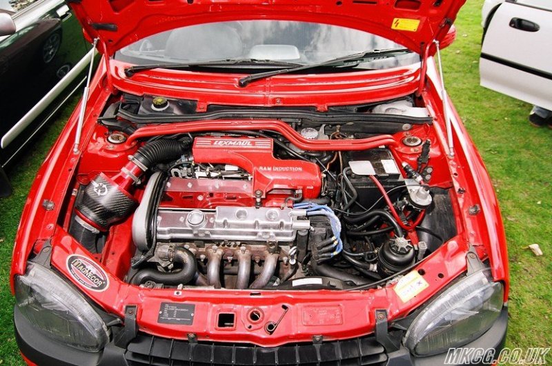

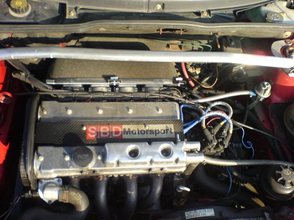

Started life as a 1.4 16v corsa sport, however i soon got bored and fitted a 140bhp 1.6 16v engine:

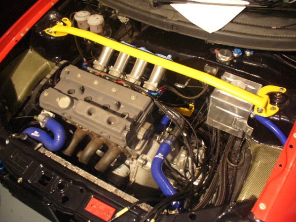

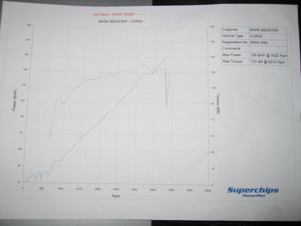

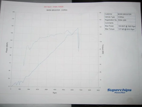

this was how it stayed for a while, however i still hankered for some more, so here started my relationship with Jamie of JAMsport, originally i was just going to be fitting throttle bodies and gotech mfi pro, however we decided to try some newman 288 duration cams aswell....
the result:
190bhp, not bad for a 1.6!

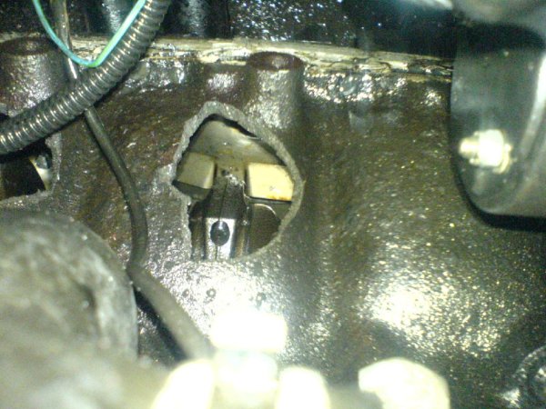

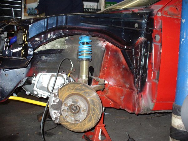

this was all good for a while, however after 11months of use and one fateful moment at craner curves this happened:

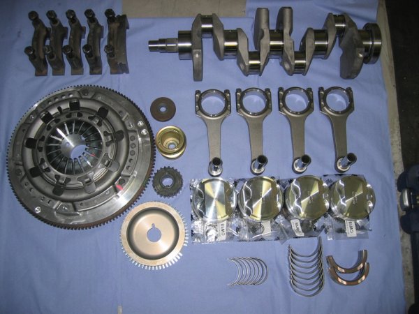

after a day or so parts were ordered to get it up and running again, spec list includes the following:
Pace dry sump kit
DK Engineering steel crank
Sainz H section rods
Woosner forged pistons with deeped valve cut outs
Broddled block
JAM-sport ported head
Newman cams to suit 10500rpm limit
stainless 1 piece valves
BTB 4-2-1 manifold
electric water pump
pedal box
lots of earls fittings
prolite 350 fuel line
along with a few bits form the old engine:
Jenvey 45mm taper throttle bodies
quaiffe atb

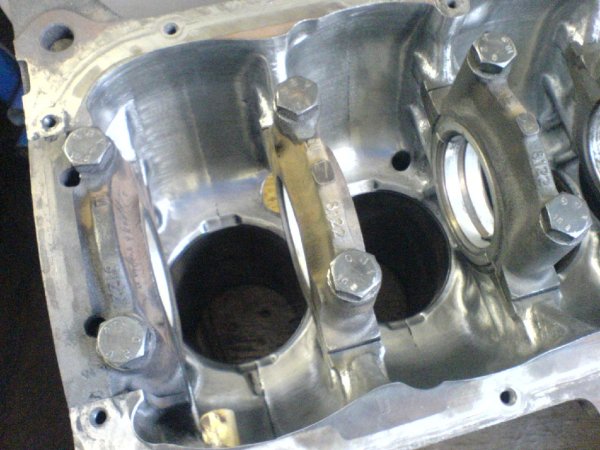

the block:
the bits:

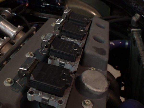

BMW m3 individual coils so i can run full sequential ignition:
the engine:

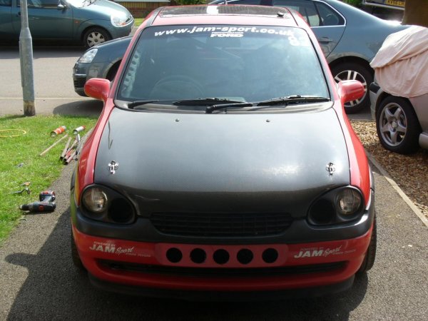

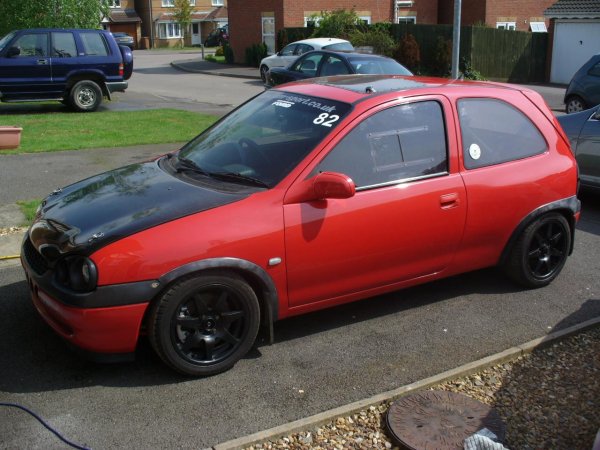

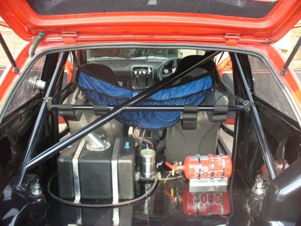

the car:

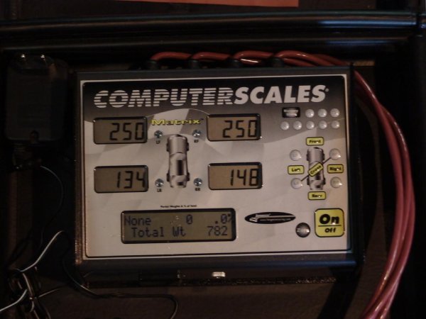

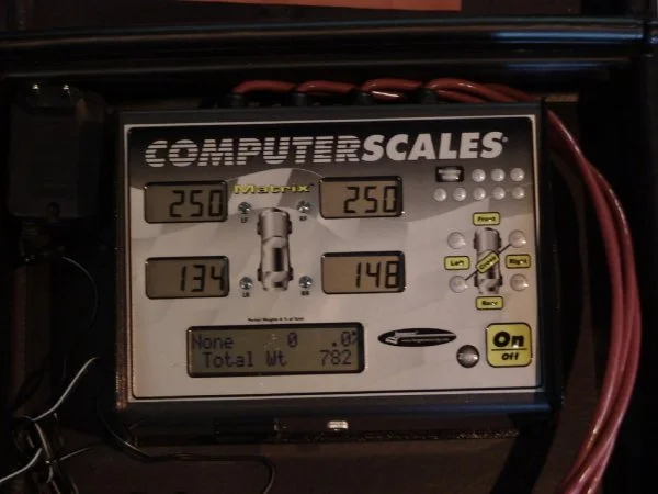

how heavy is it:
any way thats it really
we hope to see 230-240bhp from it with the 10500rpm rev limit.... should be interesting!
recently MOT'd and being run in!

forgot to mention that bit....
bilstein pss9 kit
compbrake adjustable top mounts
uprated front and rear anti roll bars
atb diff
thye all help with the handling, with it all set up properly its awesome so much grip
