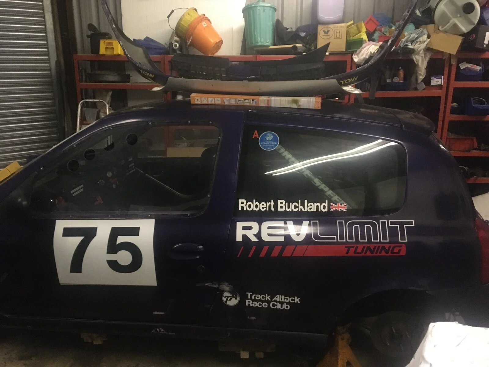

So car is running bearing rear beam with pms strengthening kit and camber shims.
Roll correction kit and bump steer kit
Fibreglass doors , boot lid and bonnet with polycarbonate windows.
High compression engine with throttle bodies , ported head with cat cams and supertec valves.
Lots of other bits and pieces but that’s the main of it

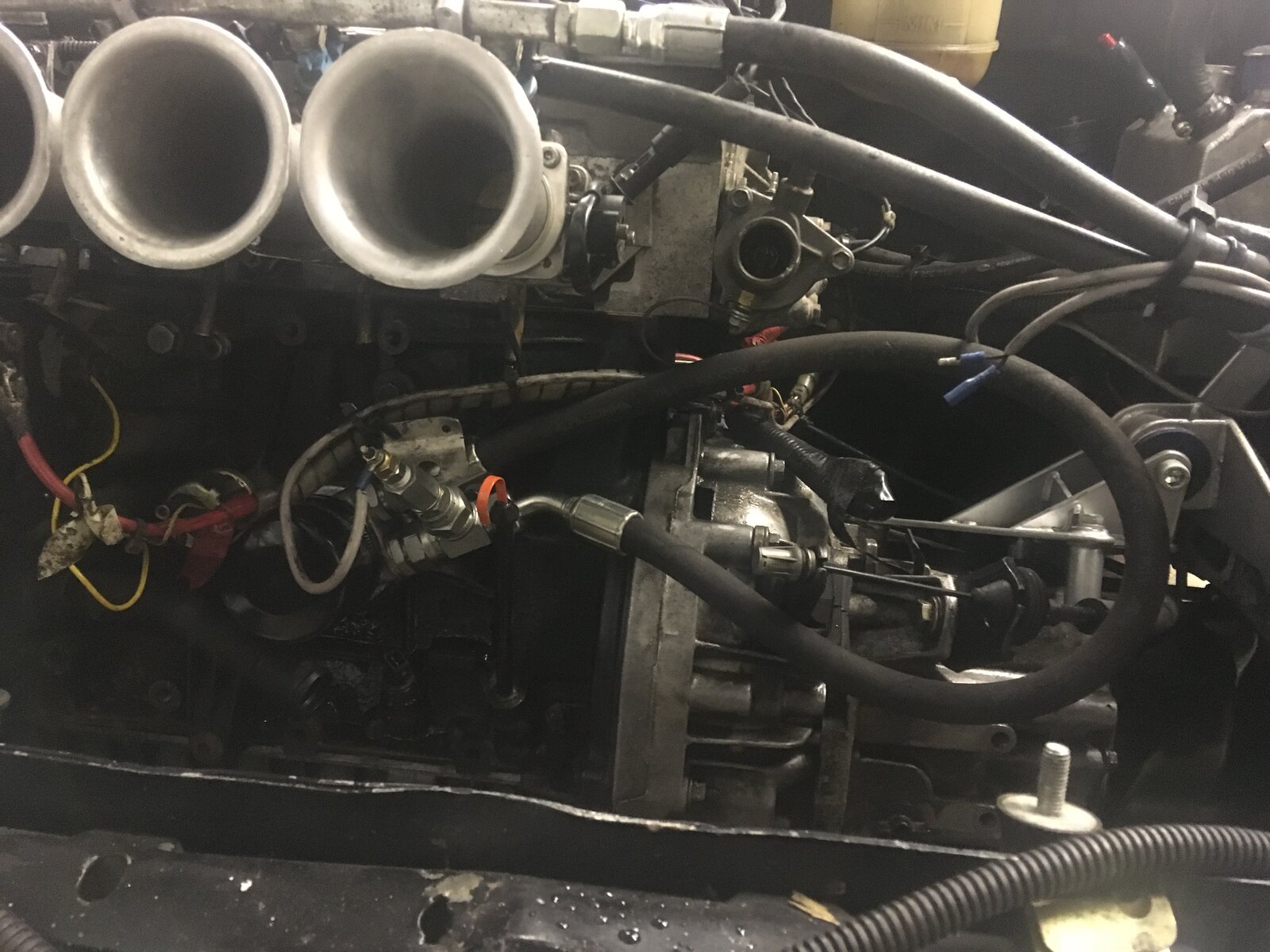

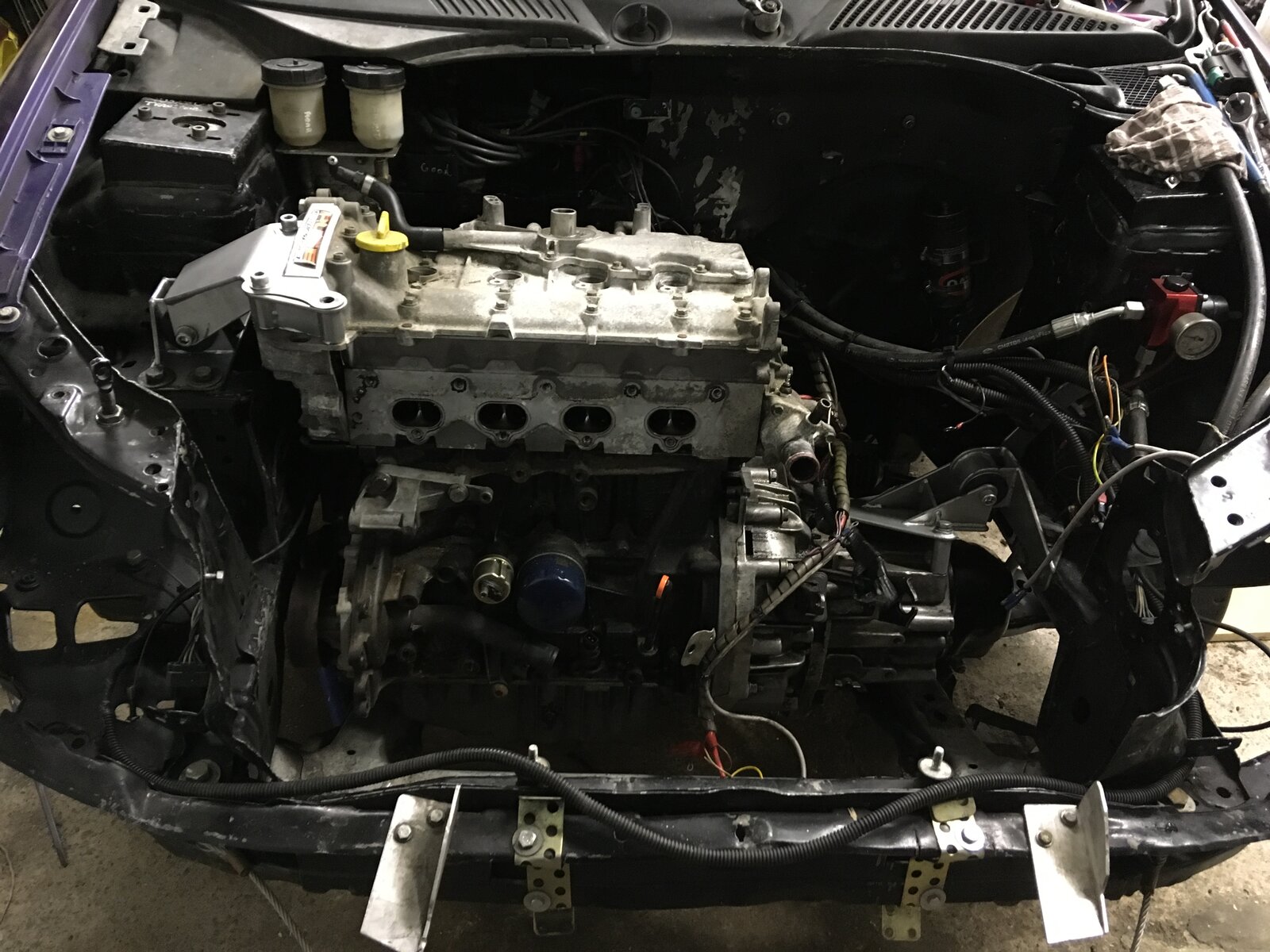

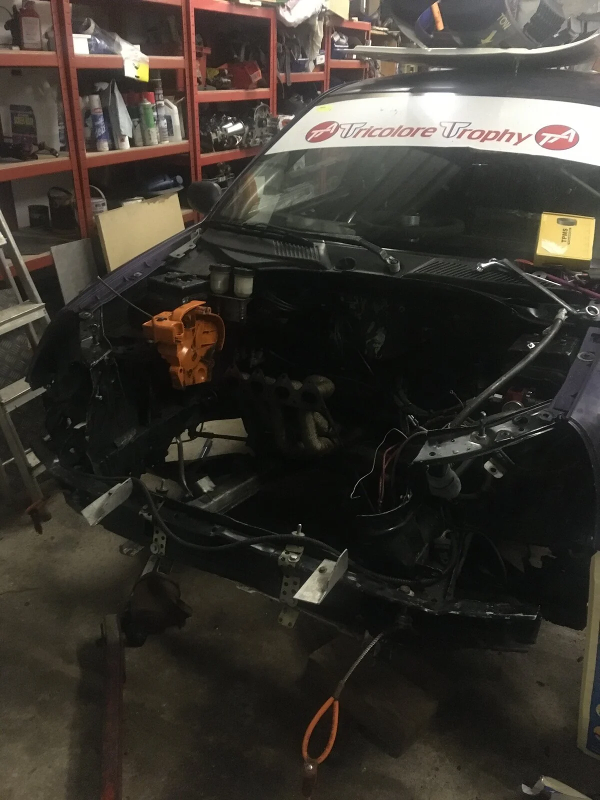

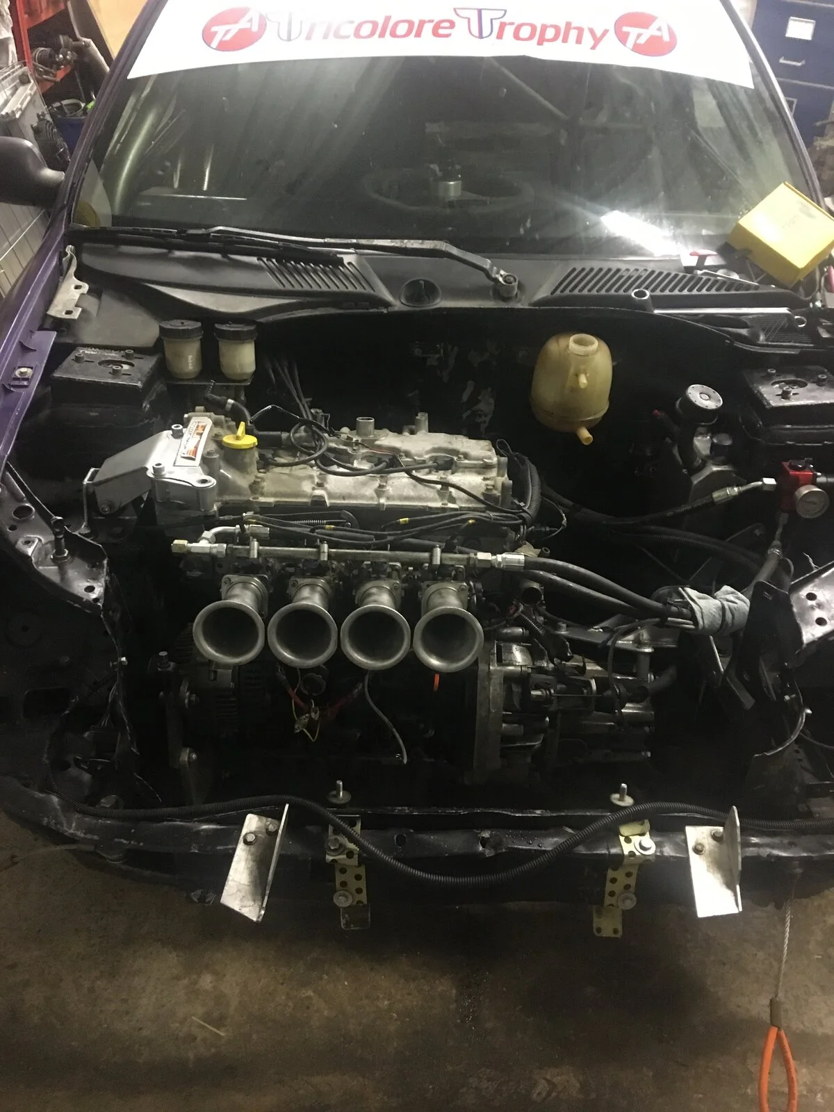

Bit more progress tonight. Got the engine wired up and a quick test run before connecting the rad back in.
All seams good and engine sounds well.
Only thing I have noticed is the increase in vibration with the pms mounts, also it sits a bit lower as can no longer fit front gearbox mount but can’t see this being an issue.

Are you using the Oe loom? I need to figure out out how to wire in the TPS sensor
no its a omex loom and ecu.

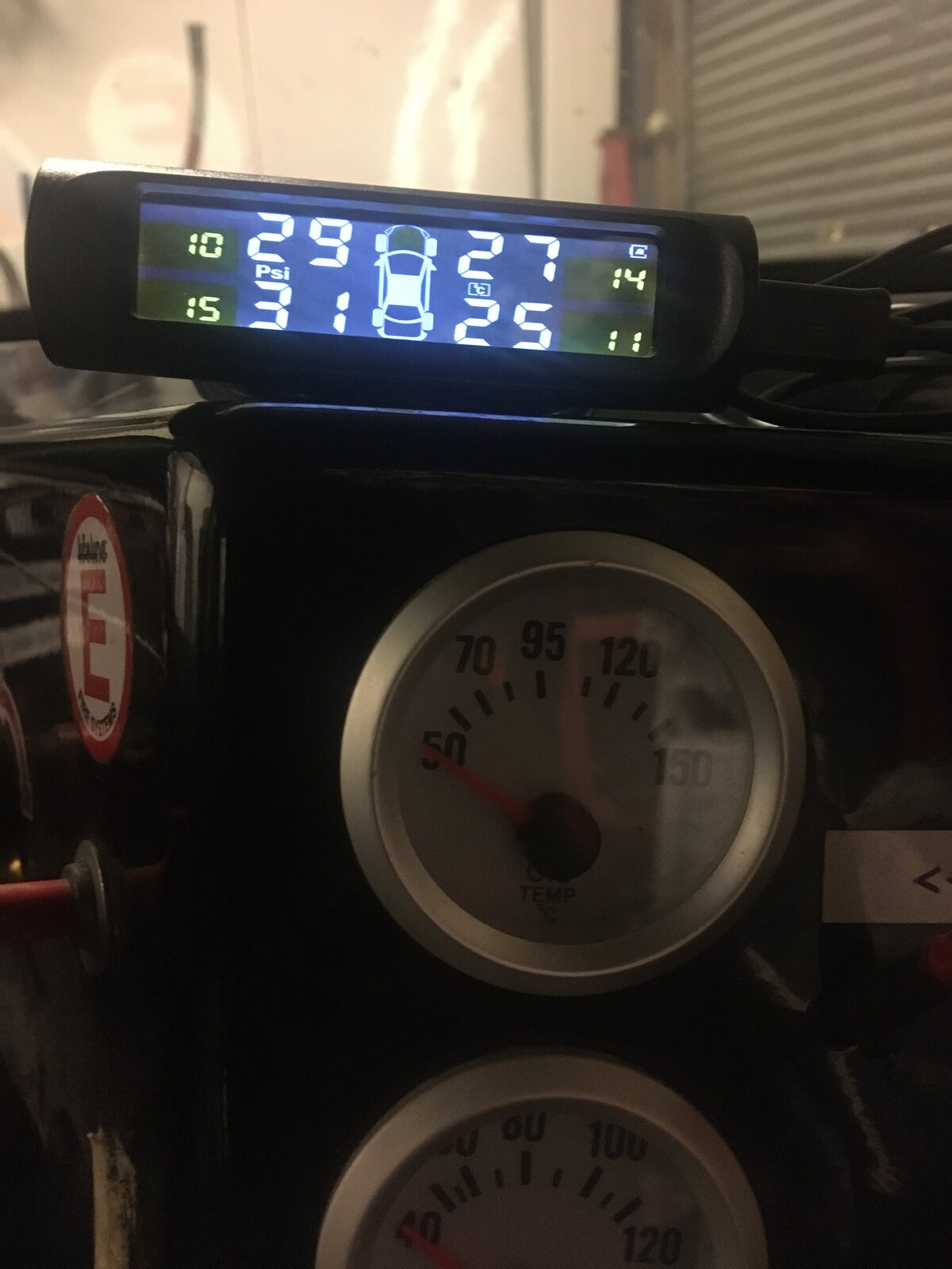

Also fitted a new little upgrade, not sure how much use it will be but thought I would try it.
It’s a tyre pressure monitor for each wheel
Word of warning on these. I ran them in a race at Brands this year and had some contact with another car. As the sensors stick out further than the wheel they ripped the valve out of the tyre. Full deflation and an early bath. I’ll not run them again in a race. Quali/Track days and testing for data etc but not a race

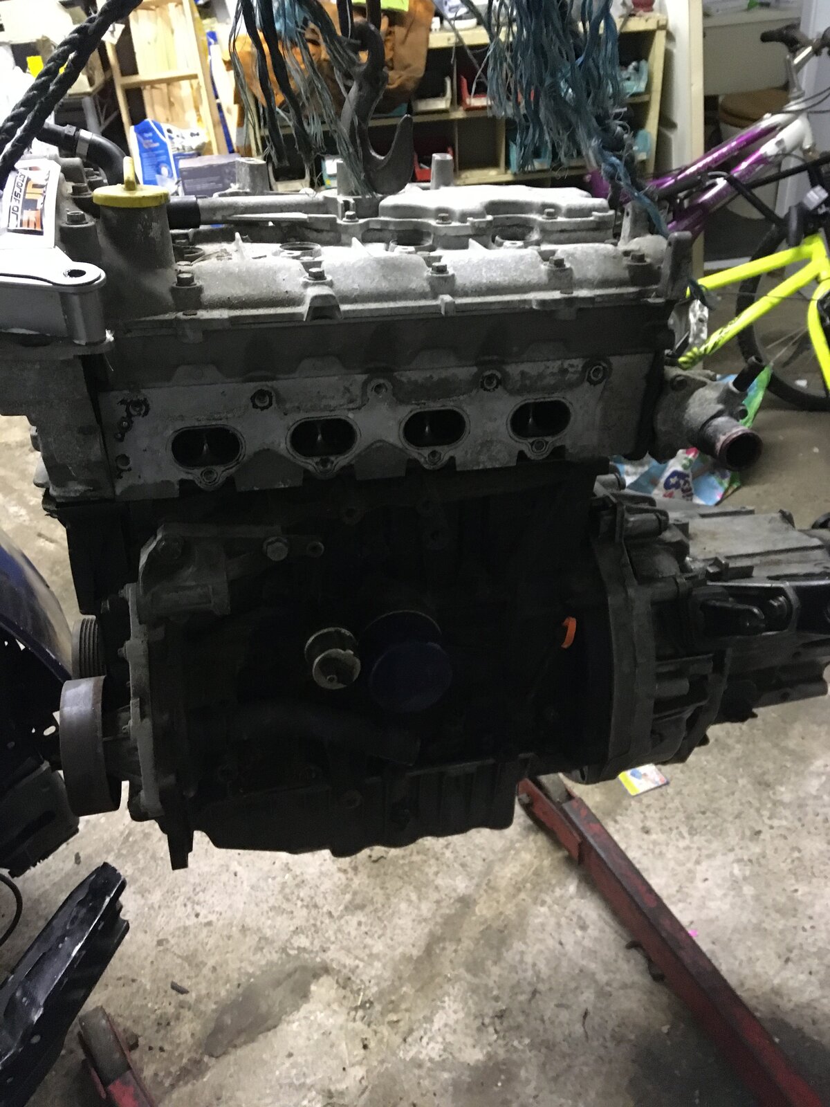

So bit of an update.

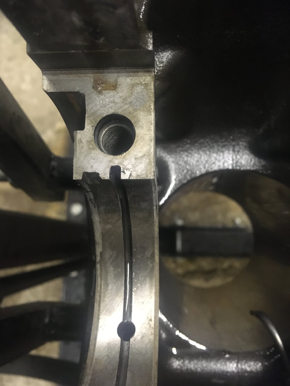

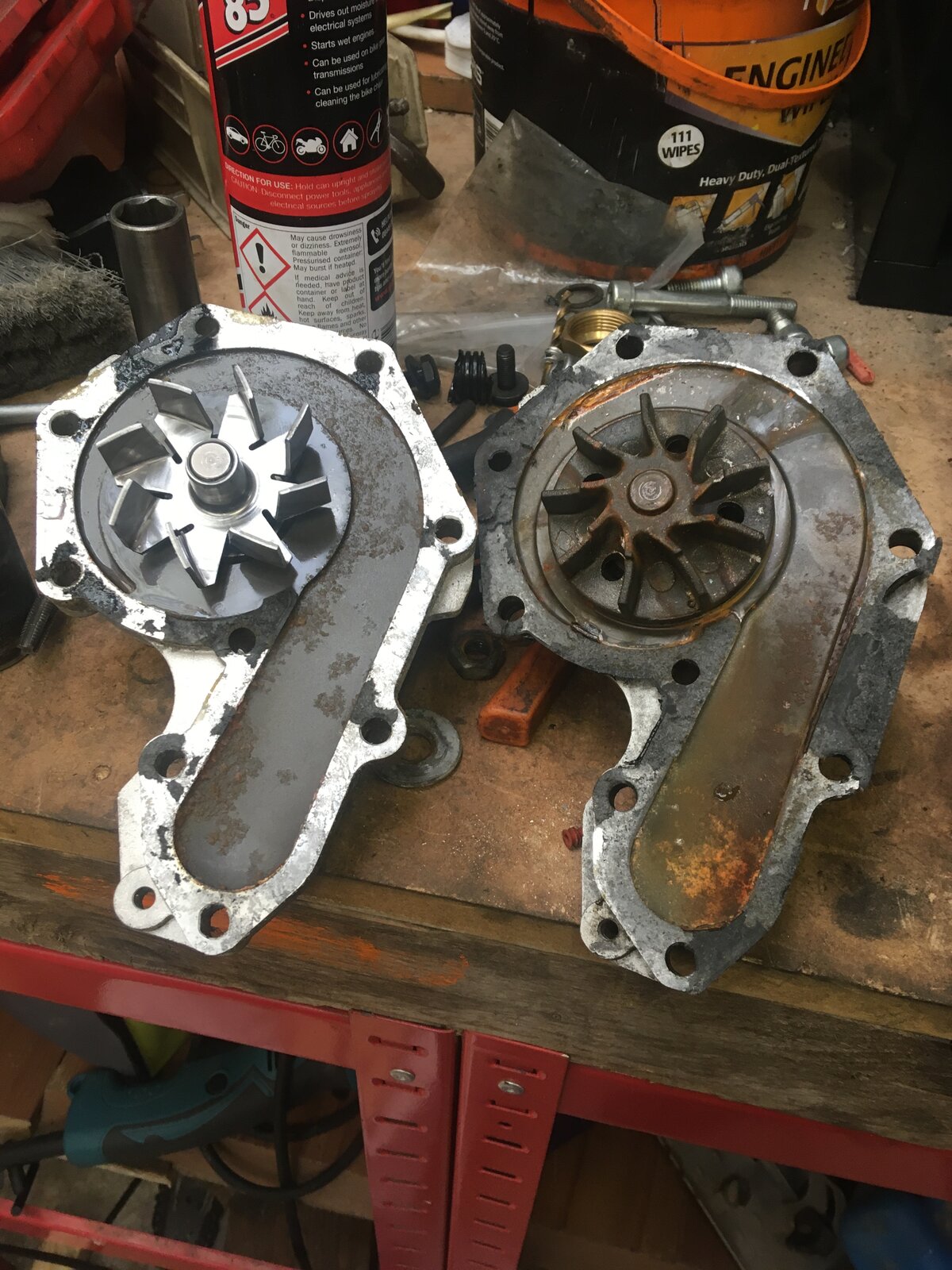

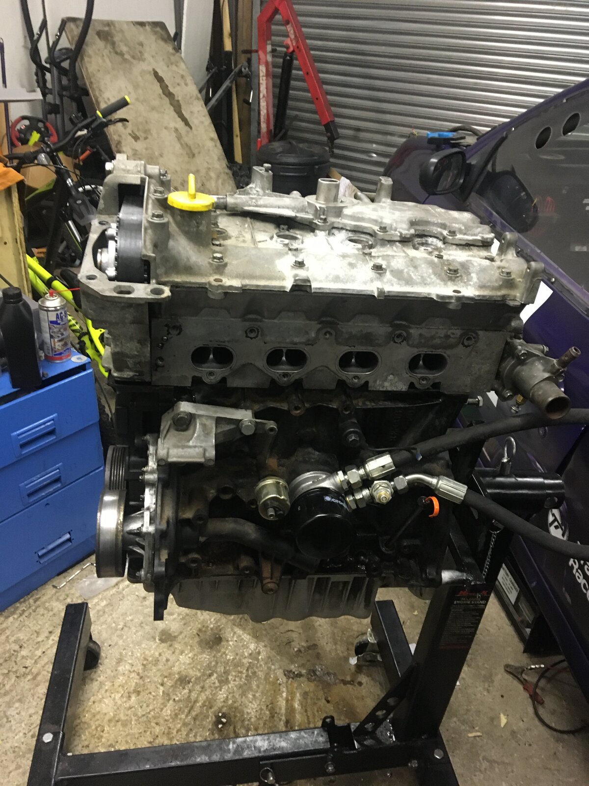

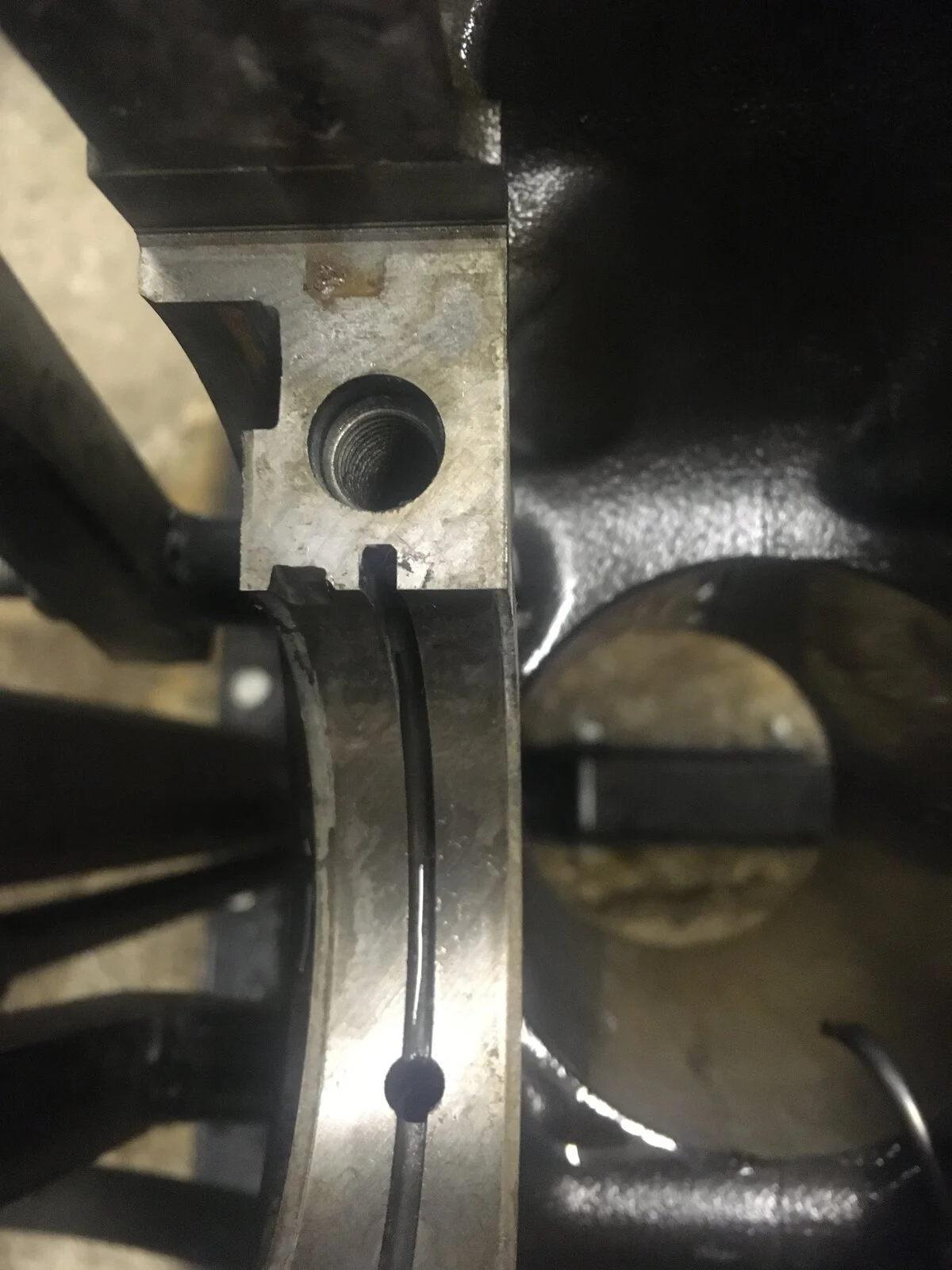

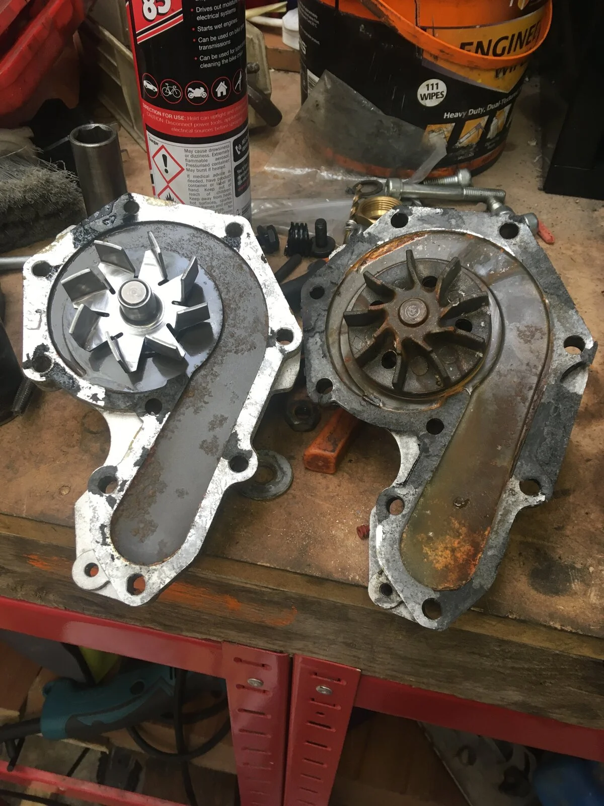

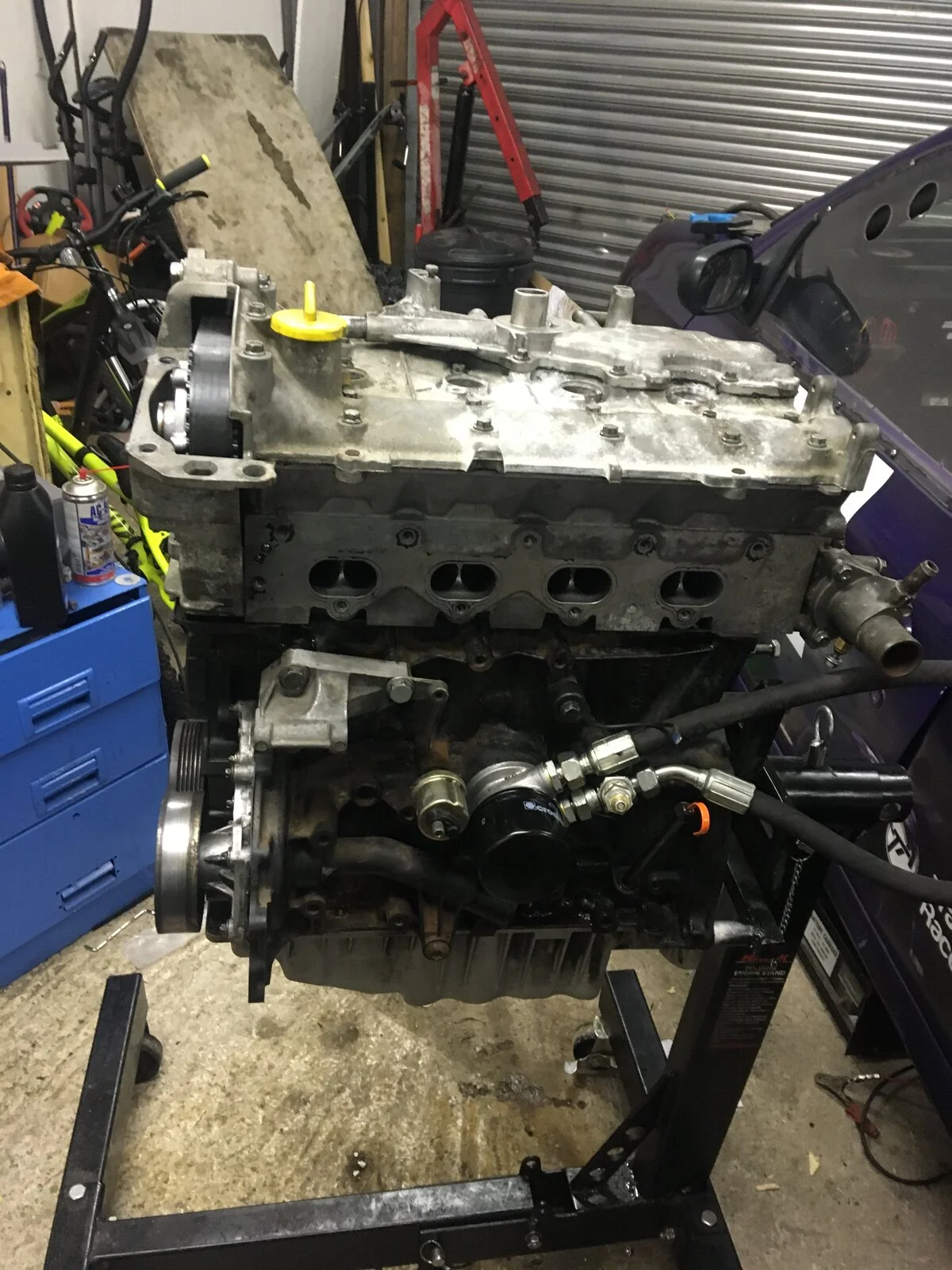

After a few issues with oil leaks then overheating lost all faith in the engine so have pulled it out and stripped it. (Was built by someone else) .

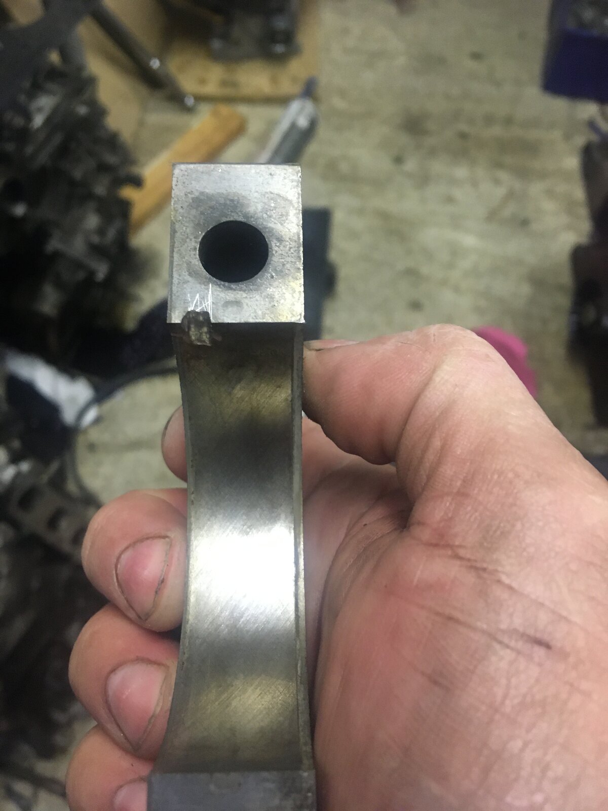

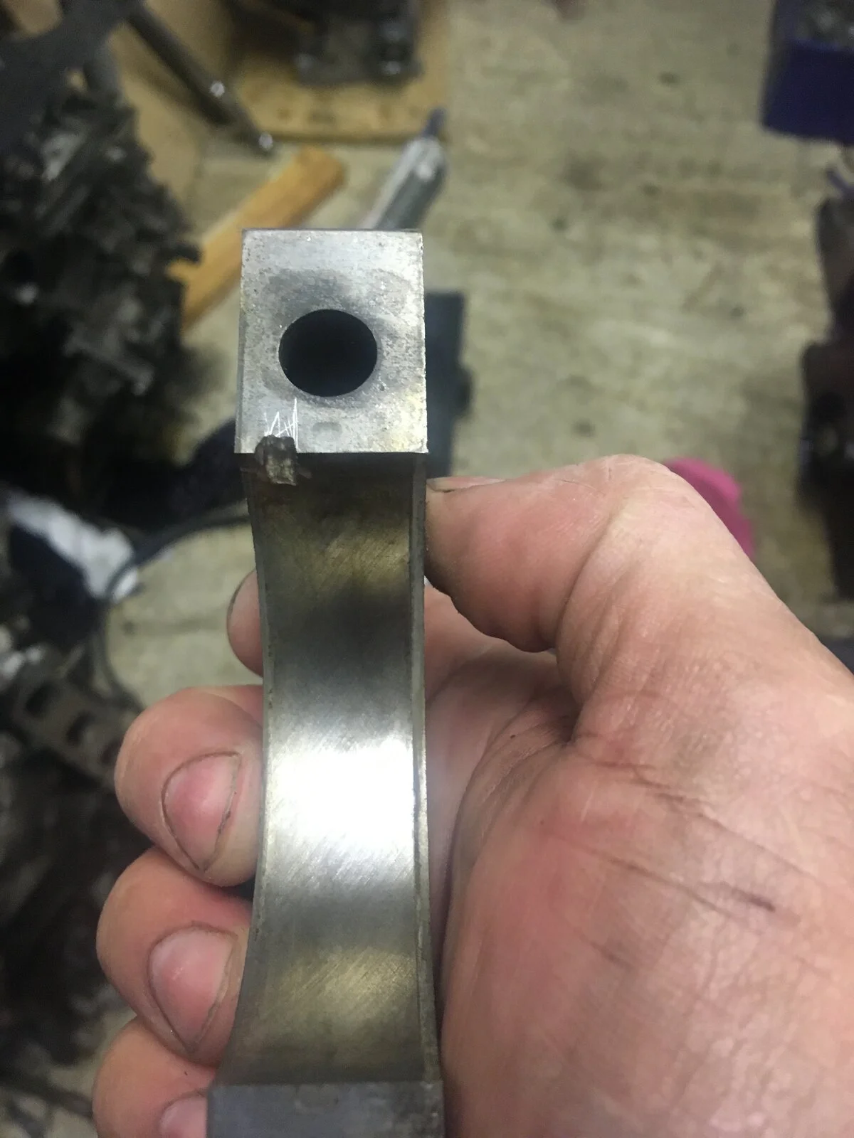

Glad I did as although it has had some big money spent on it the build quality is a bit rough. Found loose bolts cheap water pump, standard main bearings , oil jets in wrong position so rebuilding myself.
So first job was to dremmel the slots for the acl tanged bearings and remove oil jets ready for new ones.

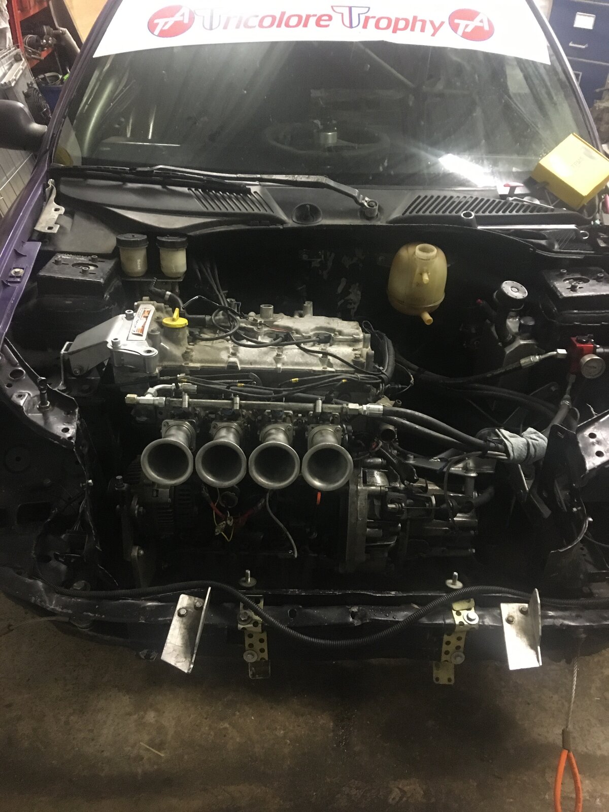

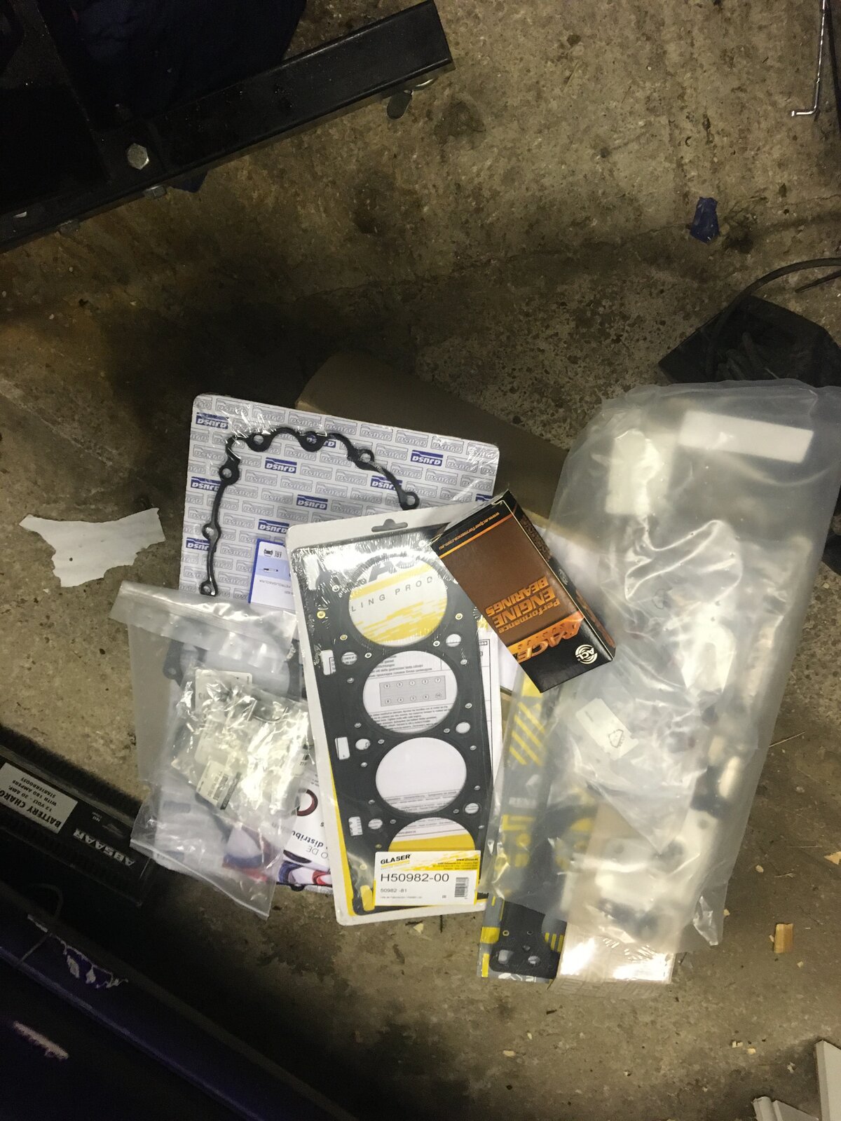

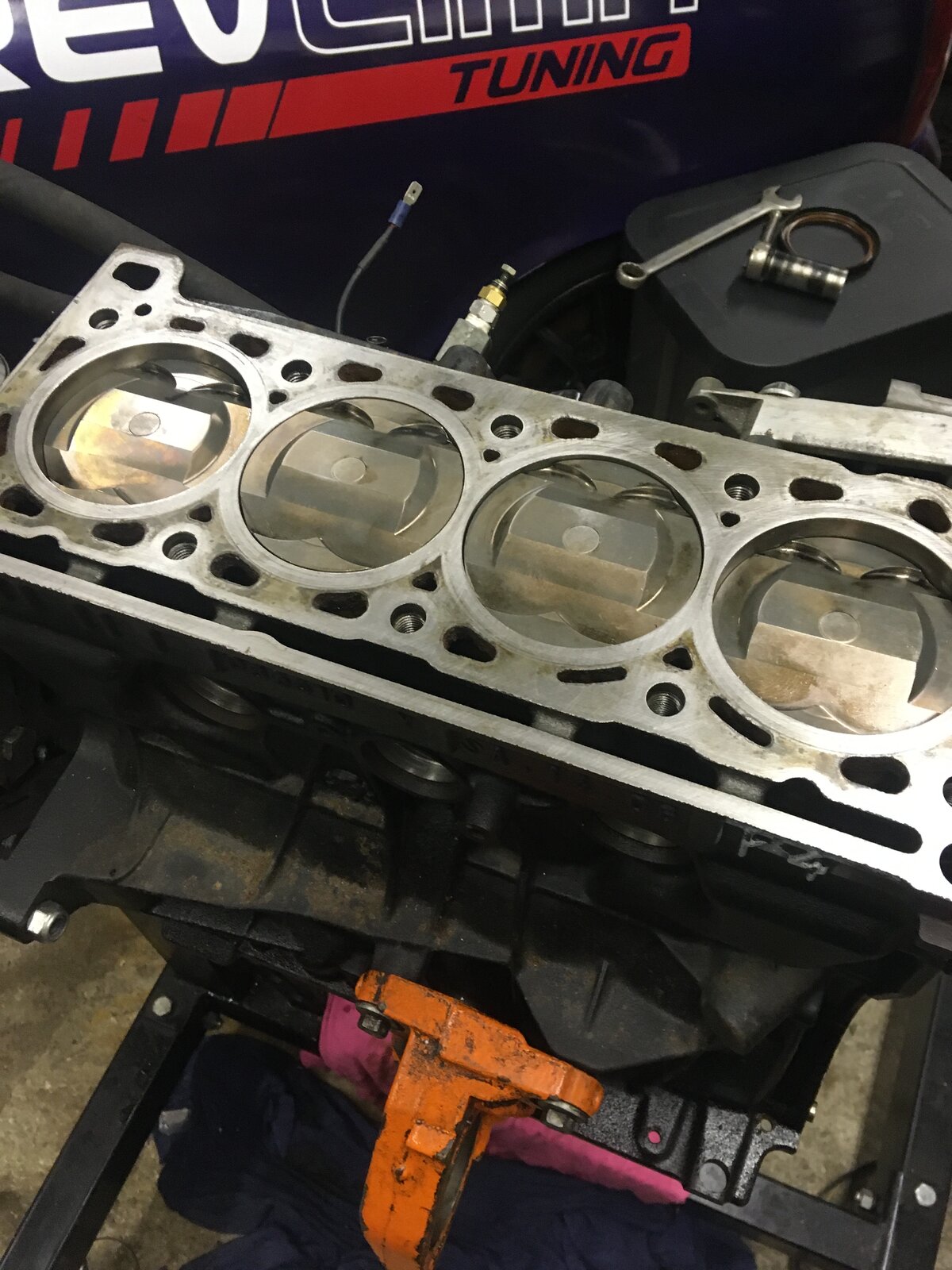

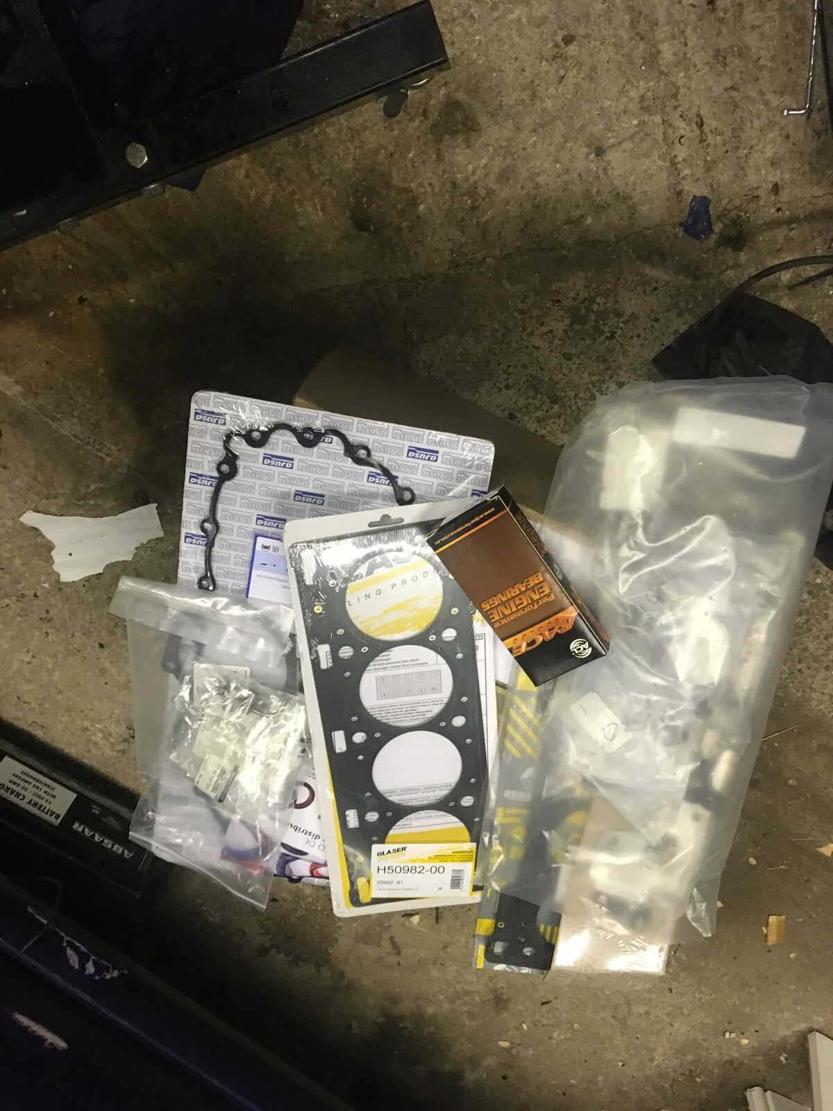

Got some time on the engine tonight after another fast and faultless service from nick at pure motor sport.
It back together ready for putting back in tomorrow and testing.

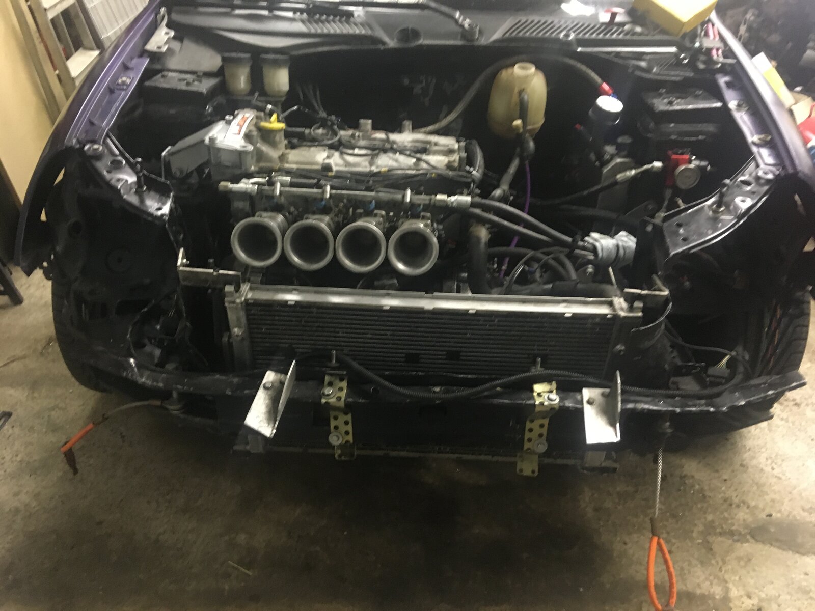

Well she’s all in and run up to temp with no problems this time
Even managed to wire up a knock sensor as suggested by my mapper.

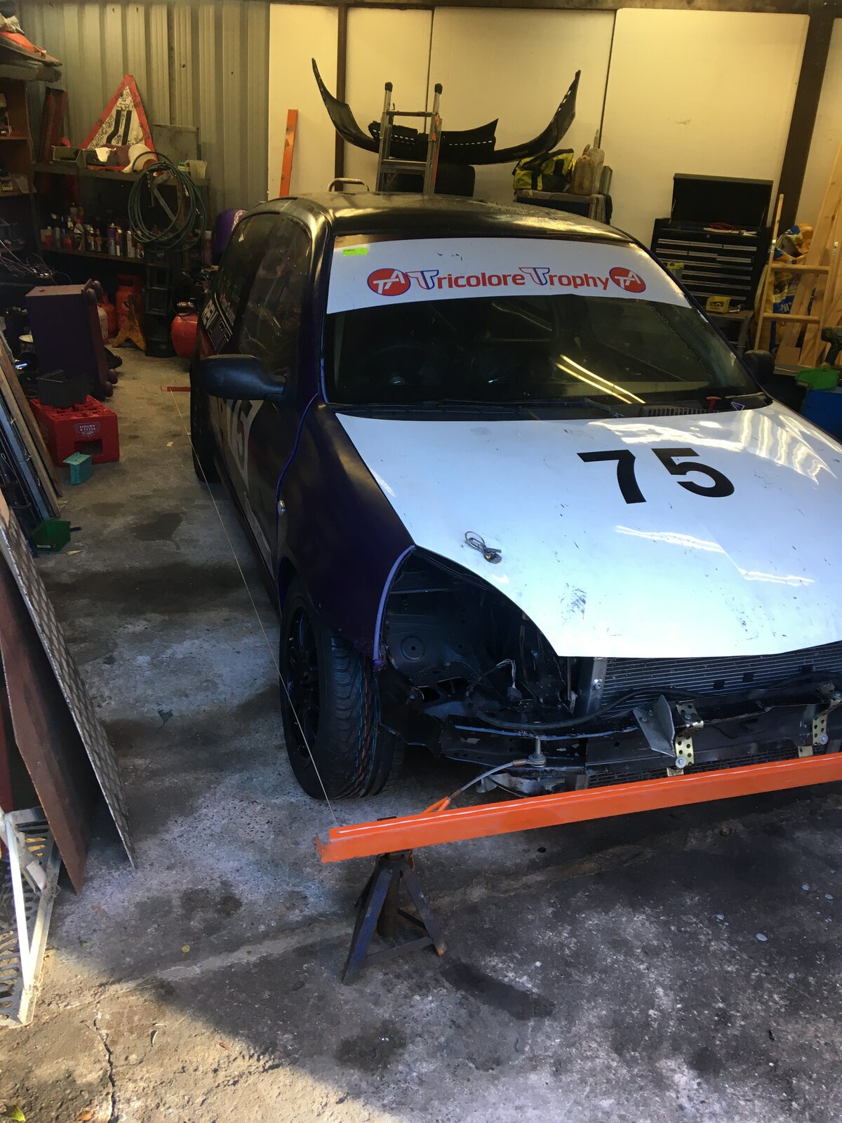

Next getting the string line out and check all cambers and toe then off for mapping.
So had a play with the car this weekend . Got the fire extinguisher serviced for the last time as from 2022 it has to be a 4ltr with min 4 nozzles.
Also string lined the car and was surprised that it wasn’t too far out from setting it up from last year.

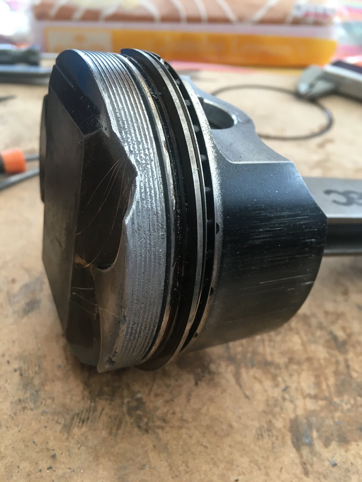

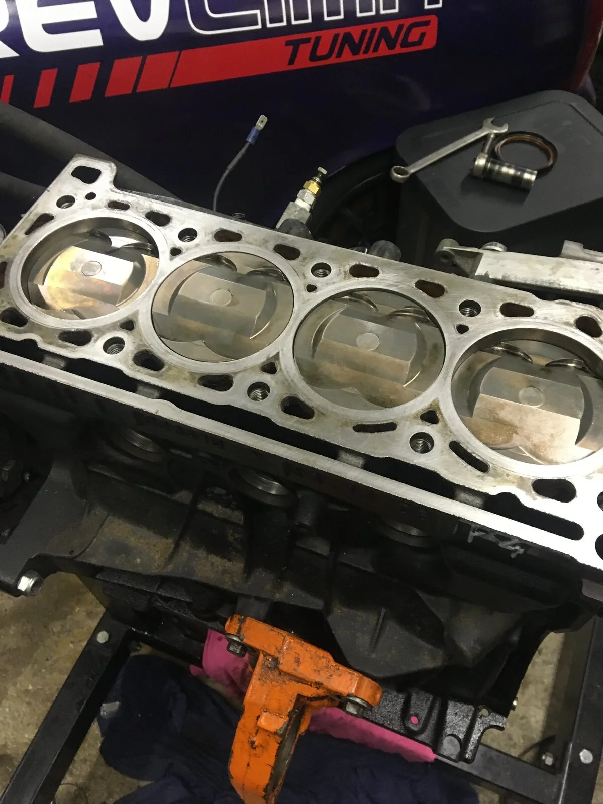

had a play with the pistons from last years engine that suffered some det to see if I could clean them up to reuse to have a spare engine just in case.
