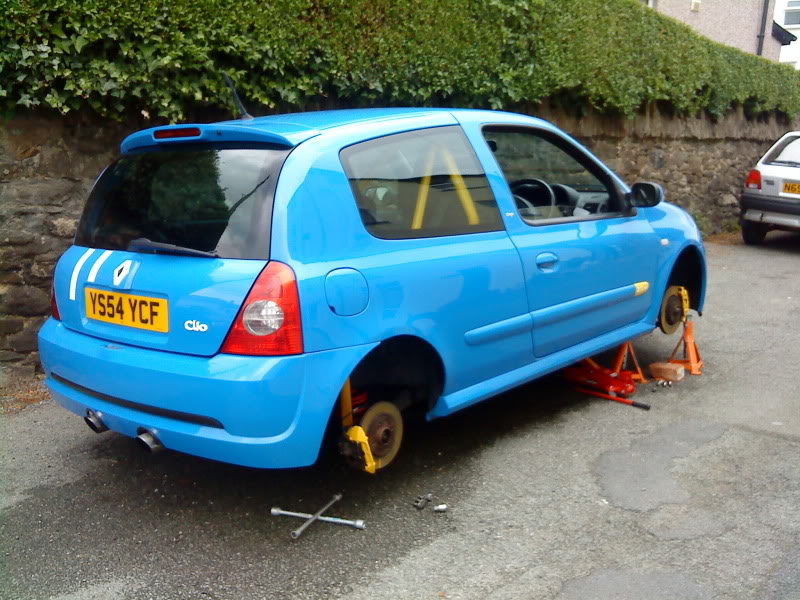

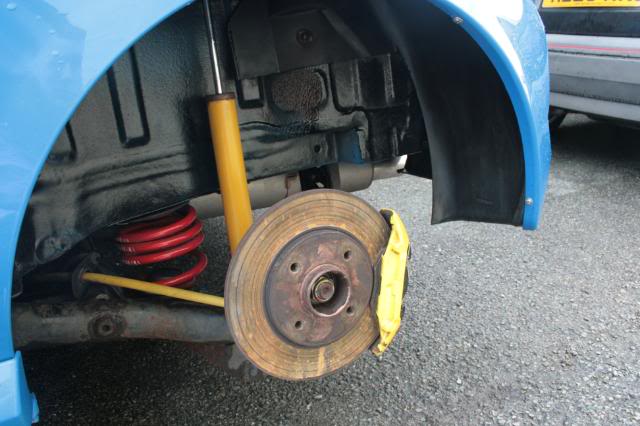

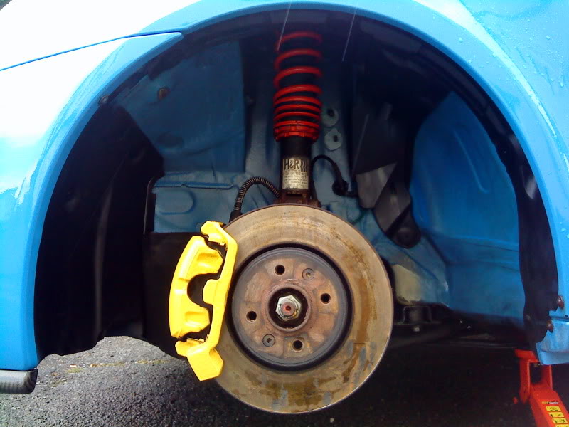

Arches/ Wheels First
Wheels cleaned with autosmart G101 and Valet Pro Bilberry wheel cleaner, tardis for tar spots and various brushes for cleaning ze wheels, the sealed with FK100P sealent

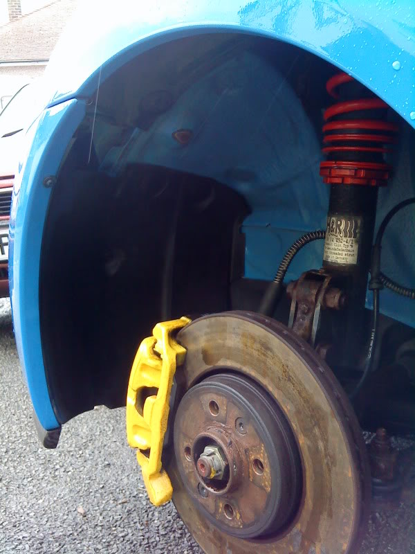

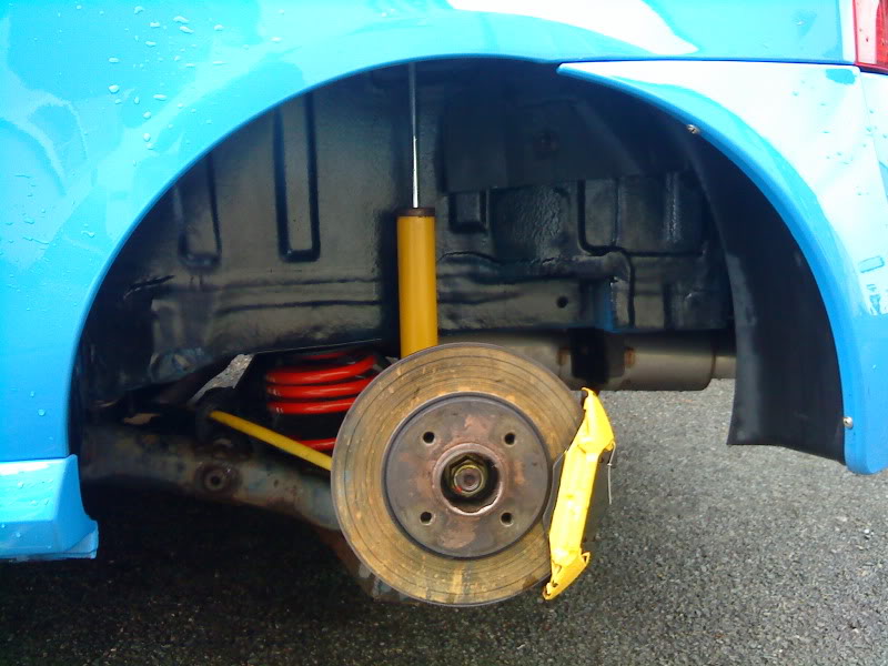

Arches cleaned with Autosmart G101 and various brushes and AG Tar remover, then dressed plastics with Megs Endurance Gel

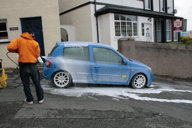

Foamed first with Bilthamber auto foam
Rinsed
Foamed Again
Rinsed

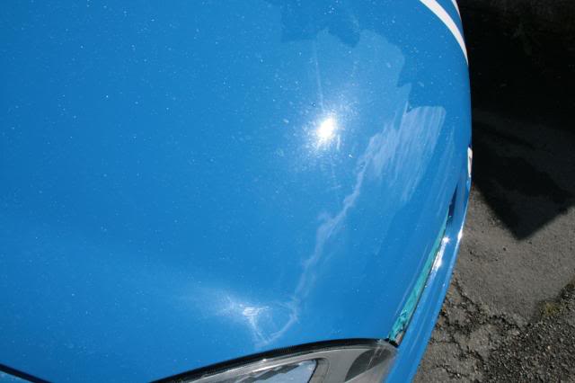

Clayed with Gloss it mild to get rid of as much overspray as possible

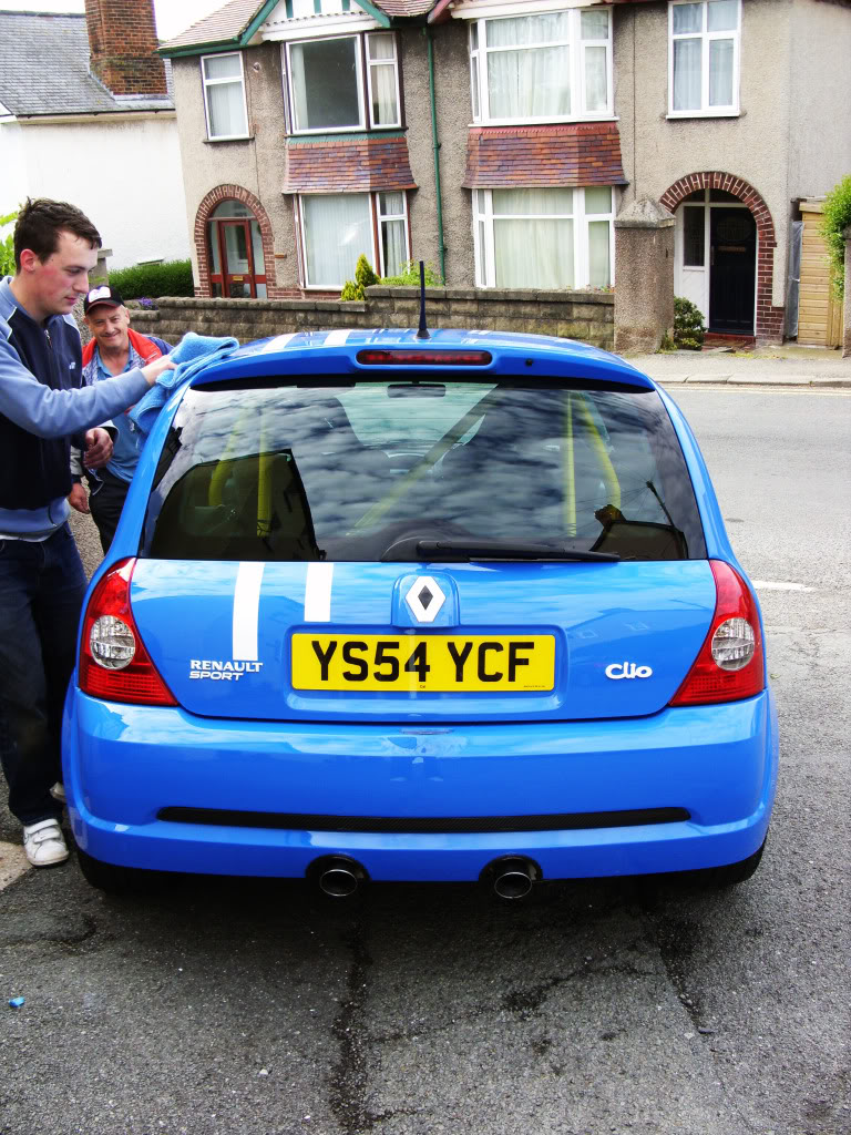

Dryed with Poorboys Waffle Weave Towel

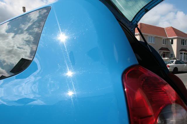

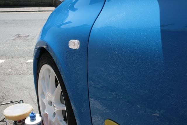

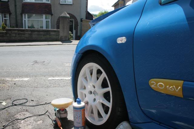

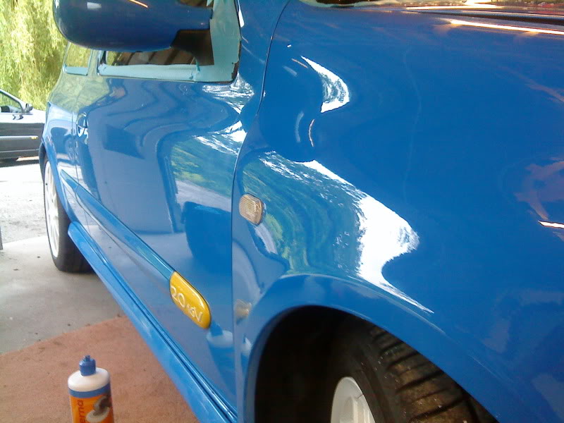

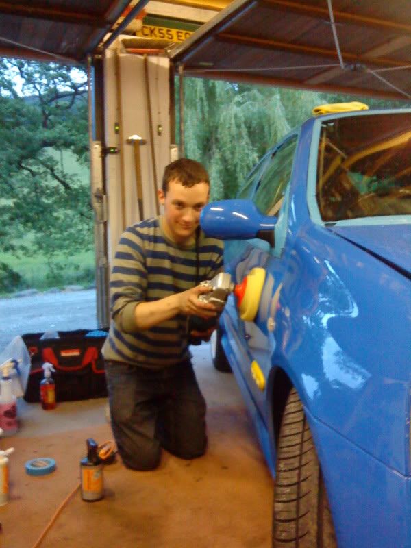

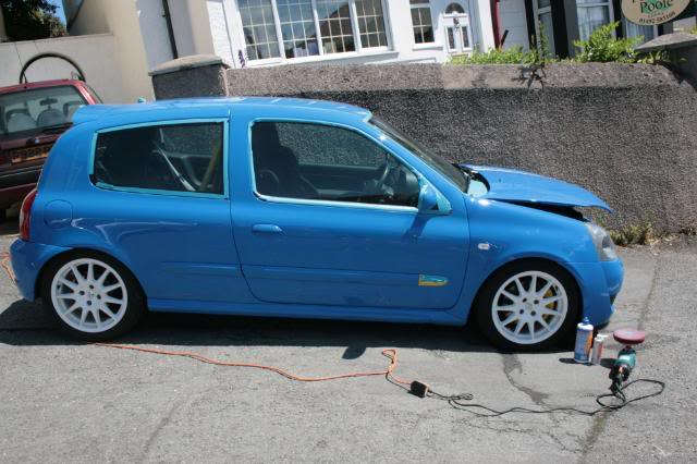

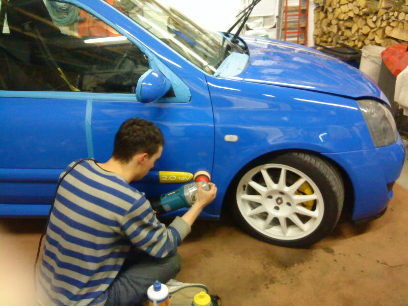

Polished with Megs Cutting pad for the worst areas with 3M Fast Cut Plus and Menz Intensive Polish 3.02
Smaller areas with a spot polishing pad and Menz Intensive Polish 3.02 and Menz P106FA
Also used A Megs Polishing pad With Menz Intensive Polishb 3.02 and Menz P106FA for lighter swirls areas
Refined With a 3M Finishing Blue Pad and Menzerna Final finshing Polish 85RE

G220 it with Lime Prime Lite, Then buffed off 5mins After
Waxed With My Special Dodo Juice Supernatural wax:P

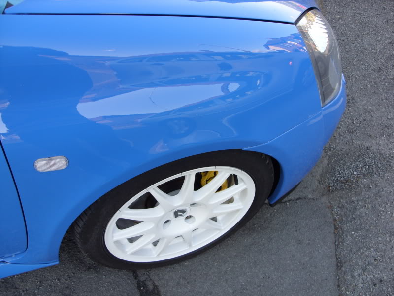

Exhauts Polished with Autosol and Wire wool as they were full of soot.

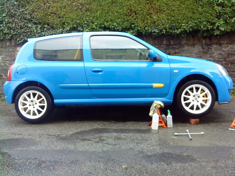

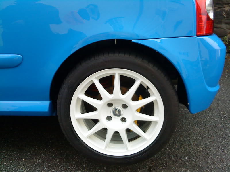

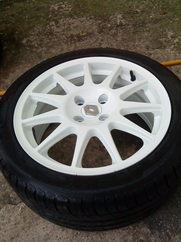

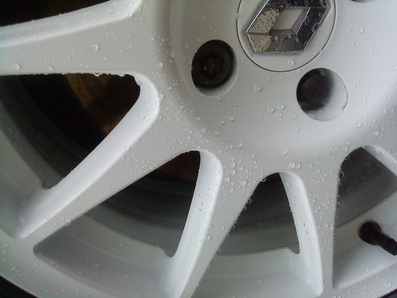

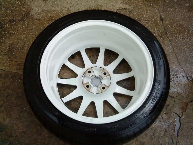

Wheels;
Archwork;
Wheels back on;

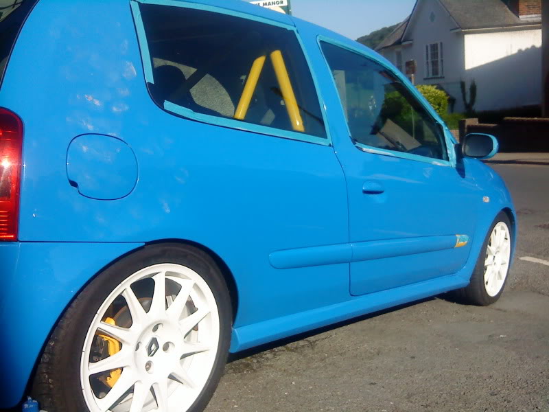

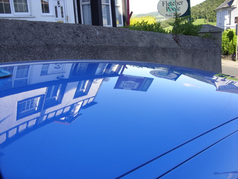

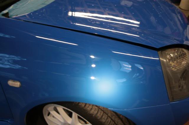

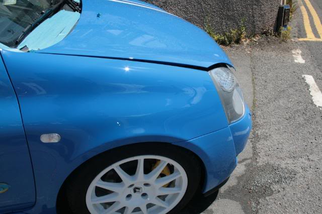

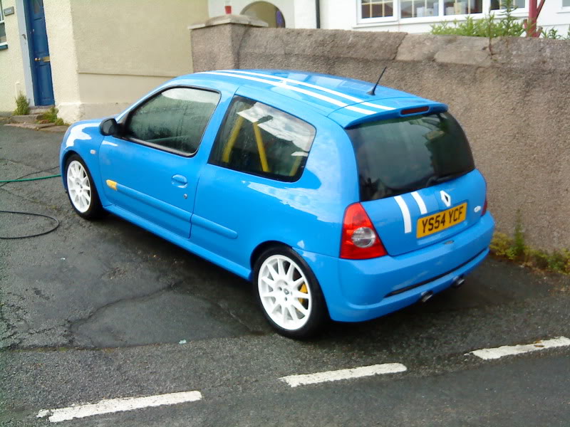

Notice how dull the colour looks, very oxidisied

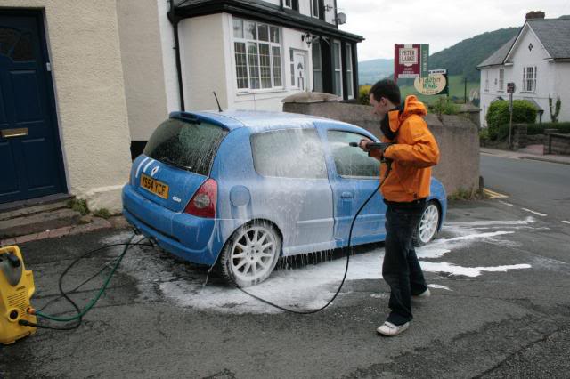

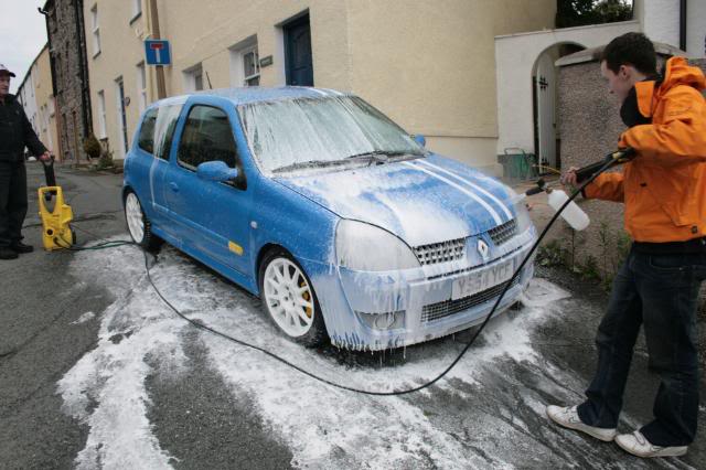

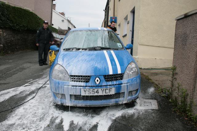

Snow Foam;
Rinsed looks much better:)

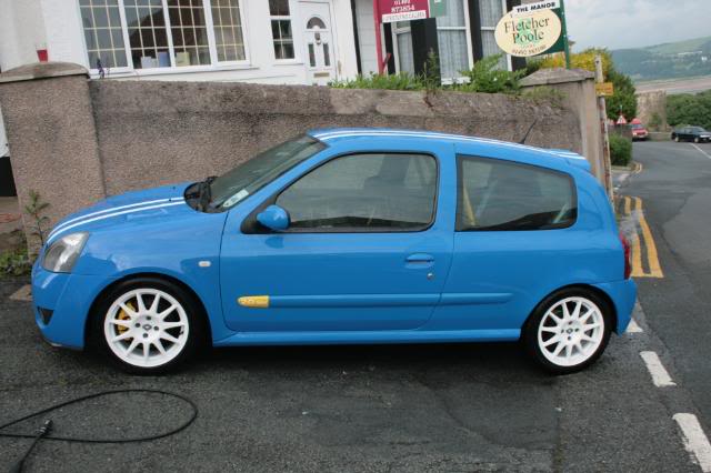

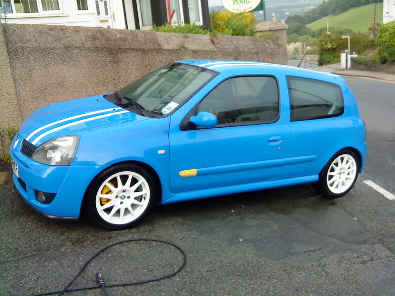

Two Bucket Method, Rinsed And Clayed Rinsed, Dryed

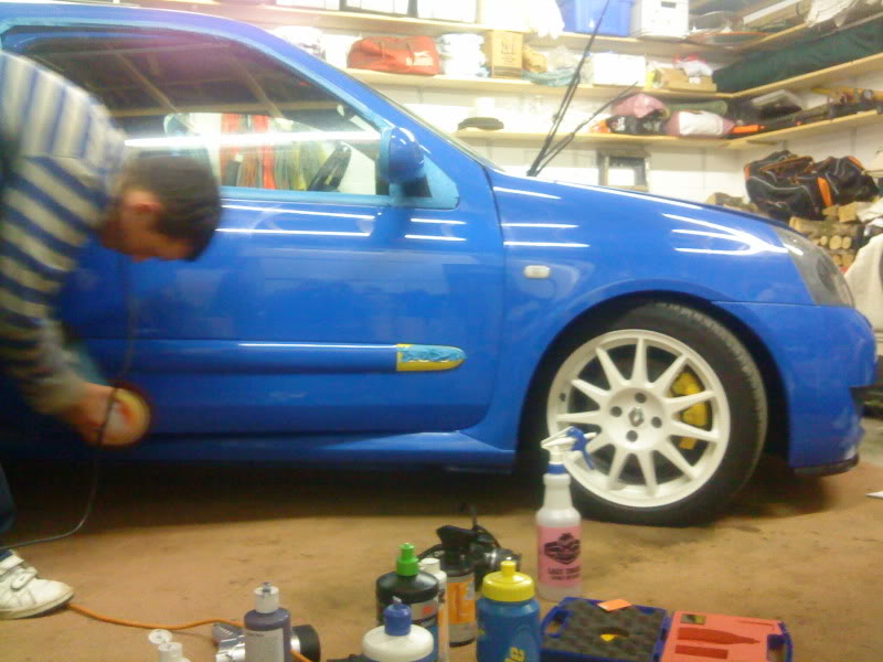

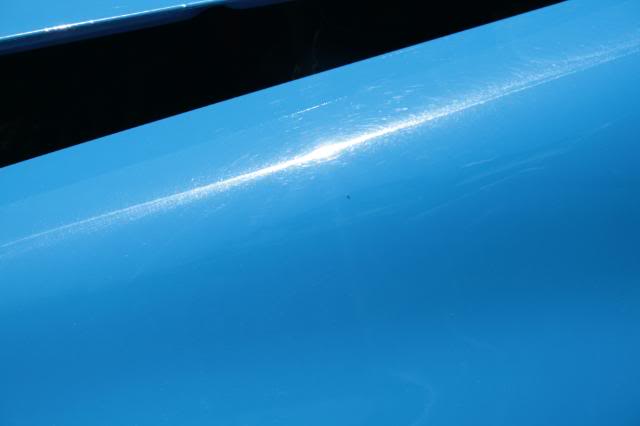

Polishing Before's at Tom's garage;
Before's at Cal's place;

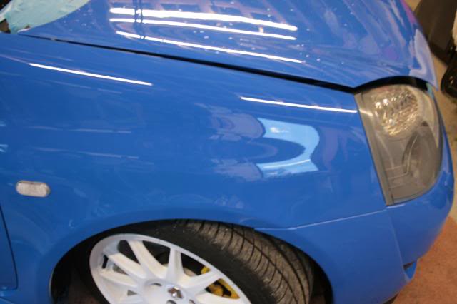

Afters at Cal's place spent all day on it lol

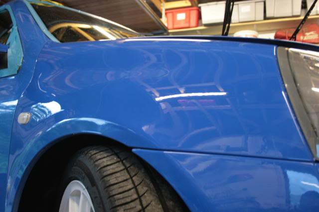

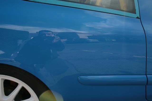

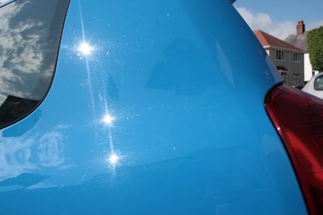

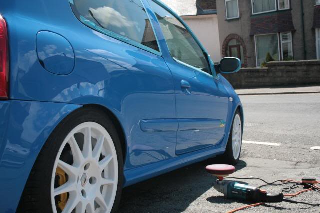

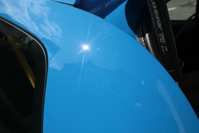

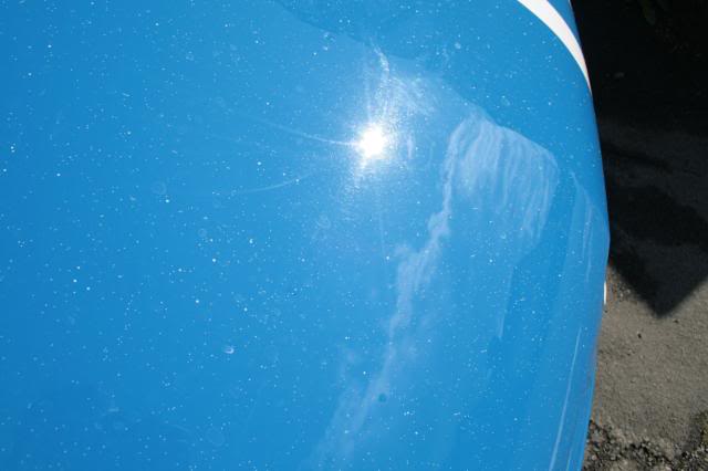

Polishing rear quarter;
Wing/door;
Roof;
Better clean pics! Ziiiiiiiiing.... from cal ;) on his digi cam as my SLR Battery Died:(

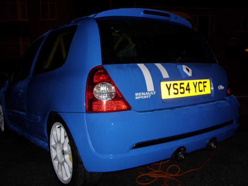

Me applying the Dodo Juice glaze at gone 1am lol...

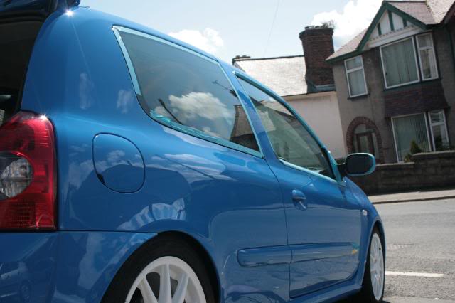

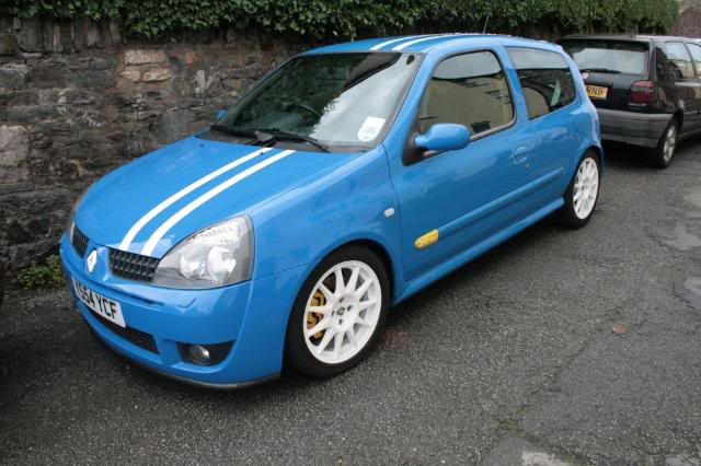

Finished pics of Dodojuice Supernatural Buffed Off, Glass waxed with Dodo Juice Supernatural, trims and tyres dressed with Megs Endurance Gel, You'll Have to wait for some more pics if Cal takes some more or i take some more of ze clio cleaned at FCS

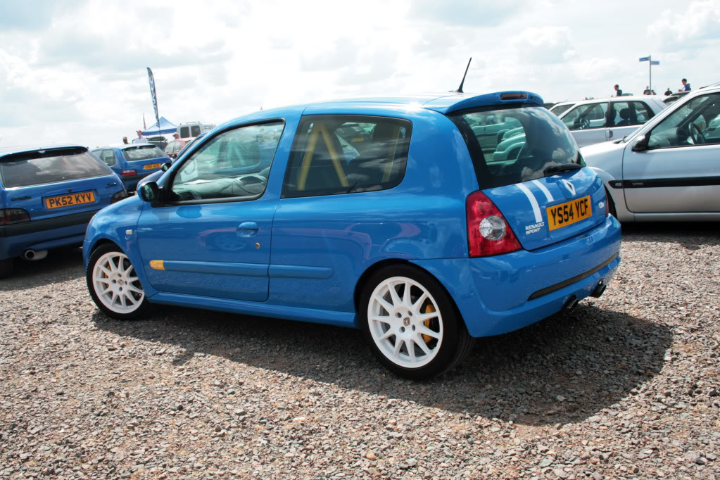

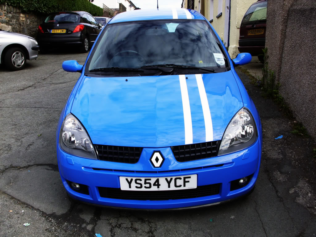

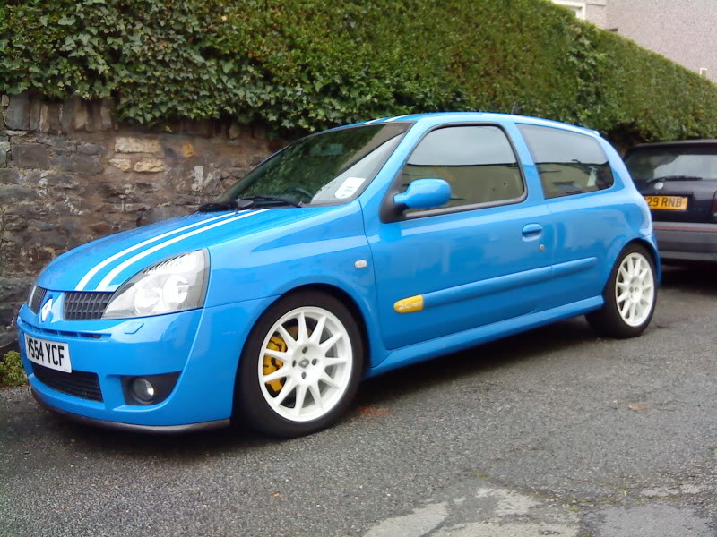

'Finished' pic at FCS 09
